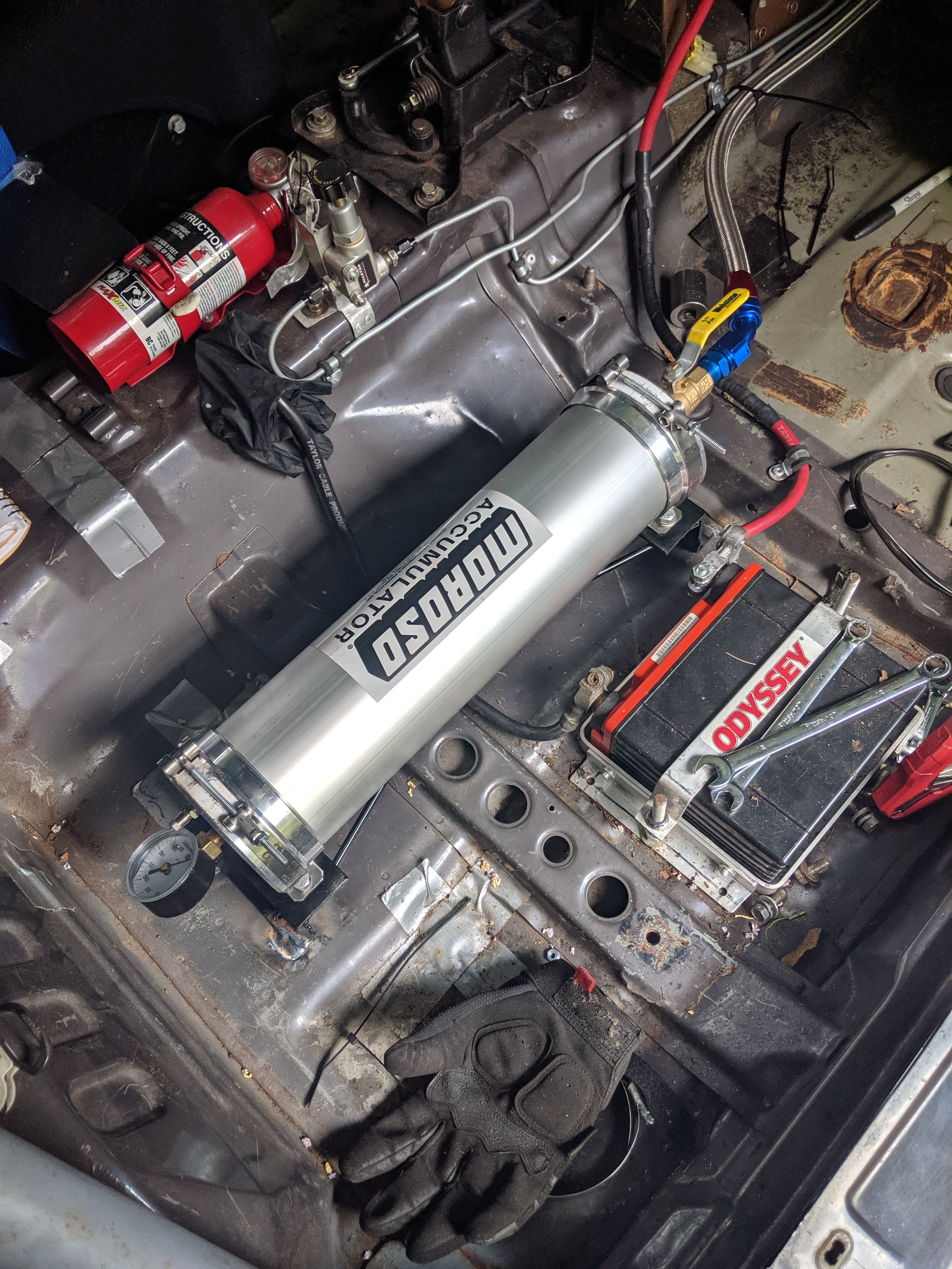

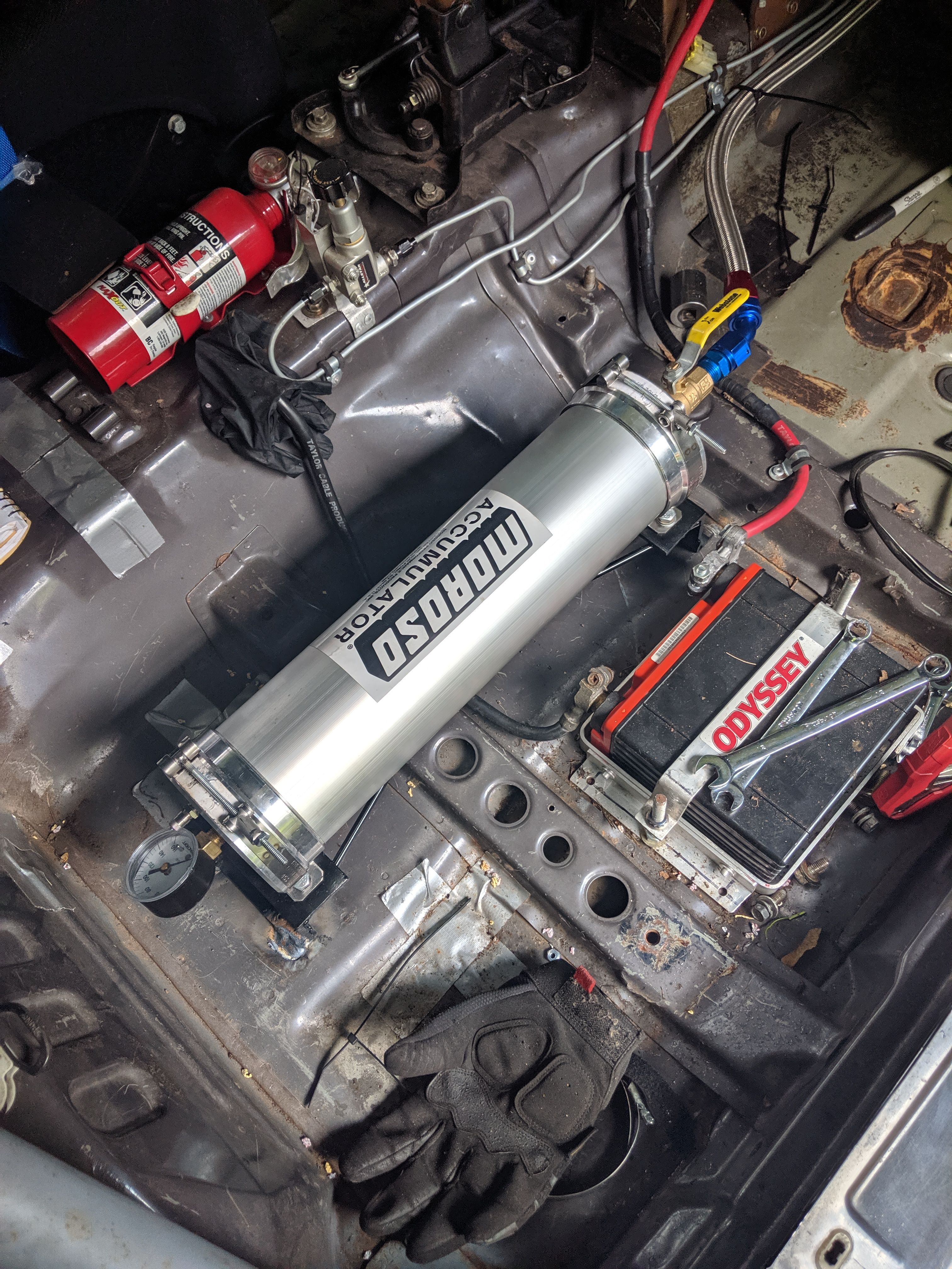

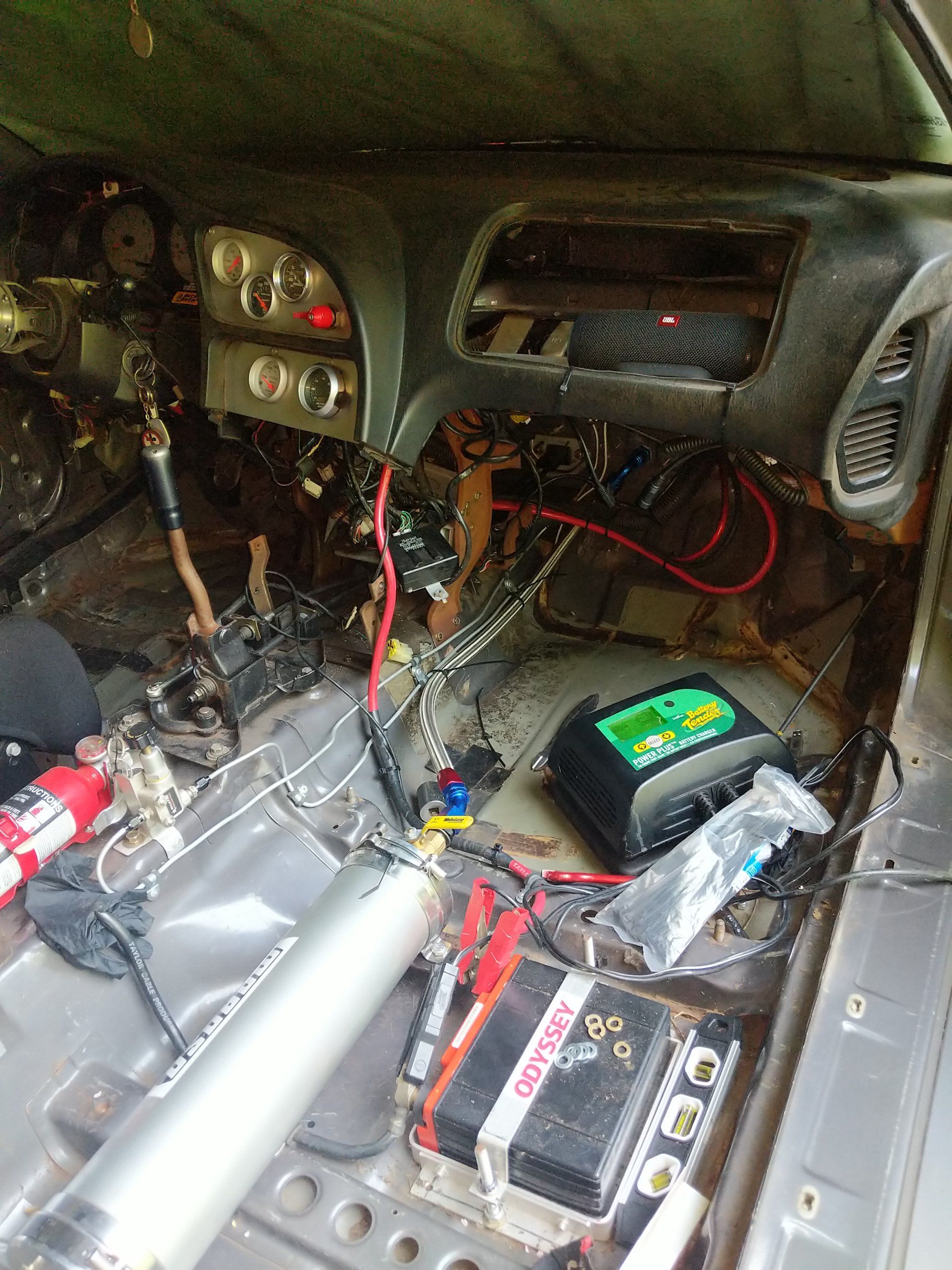

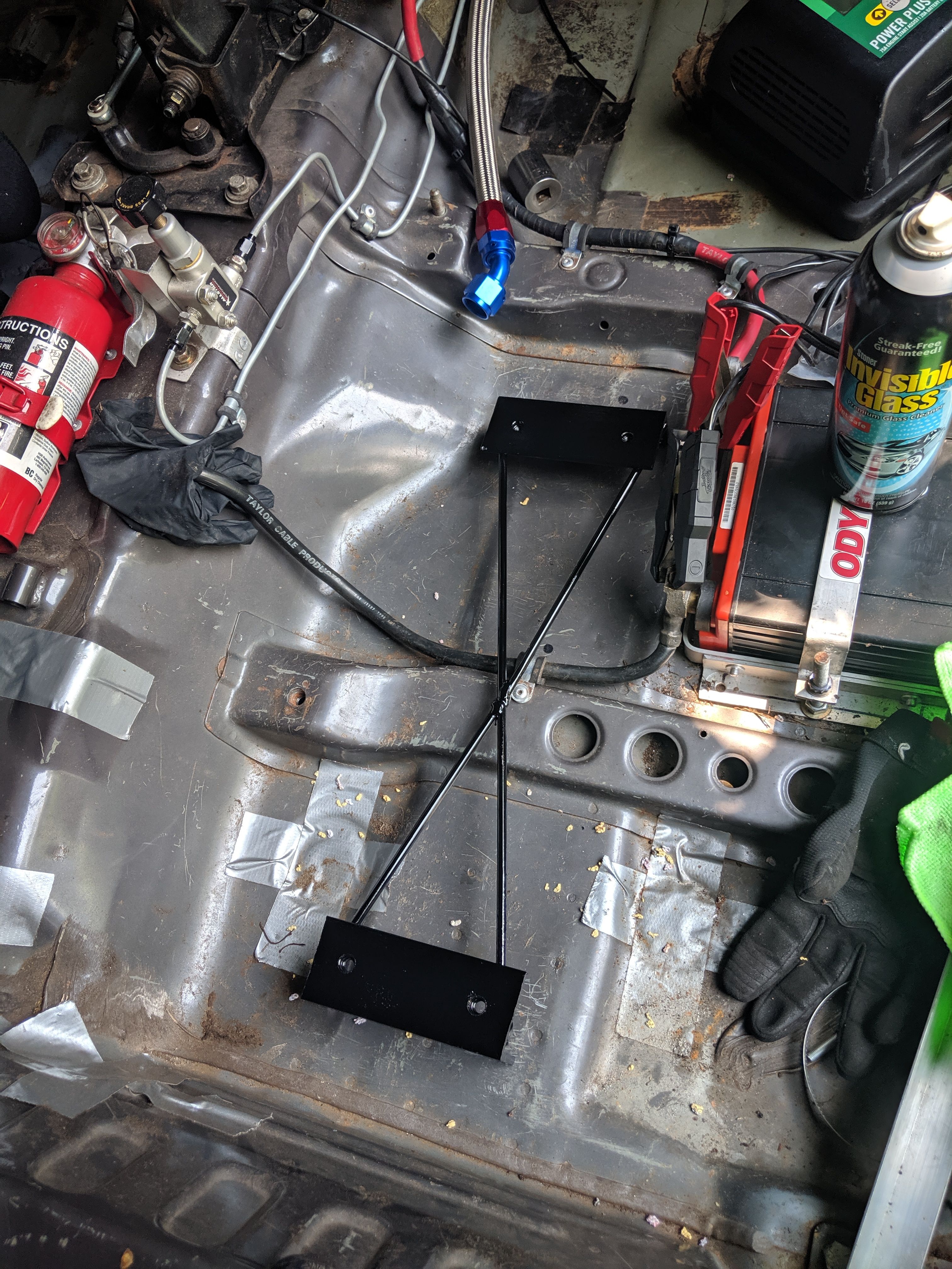

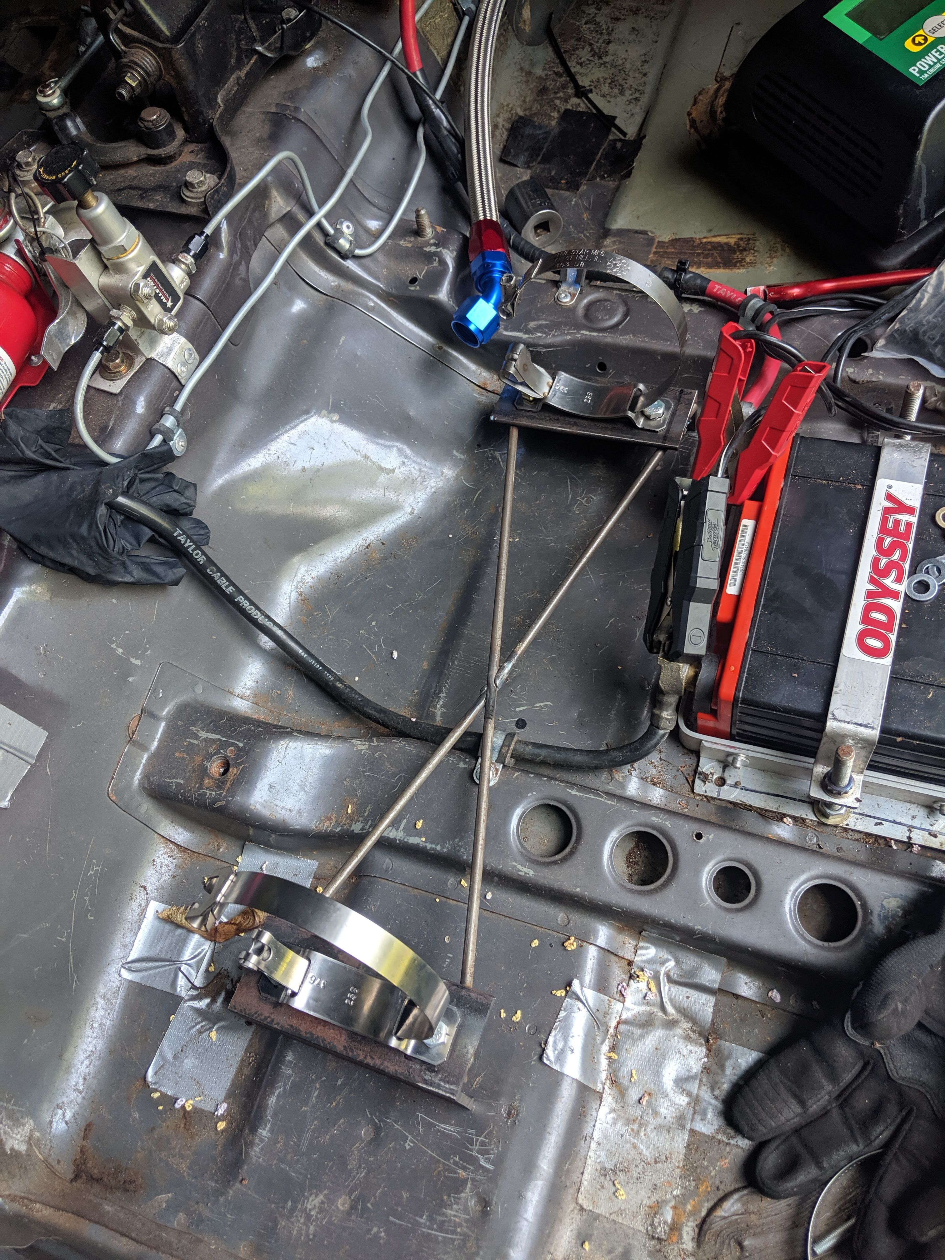

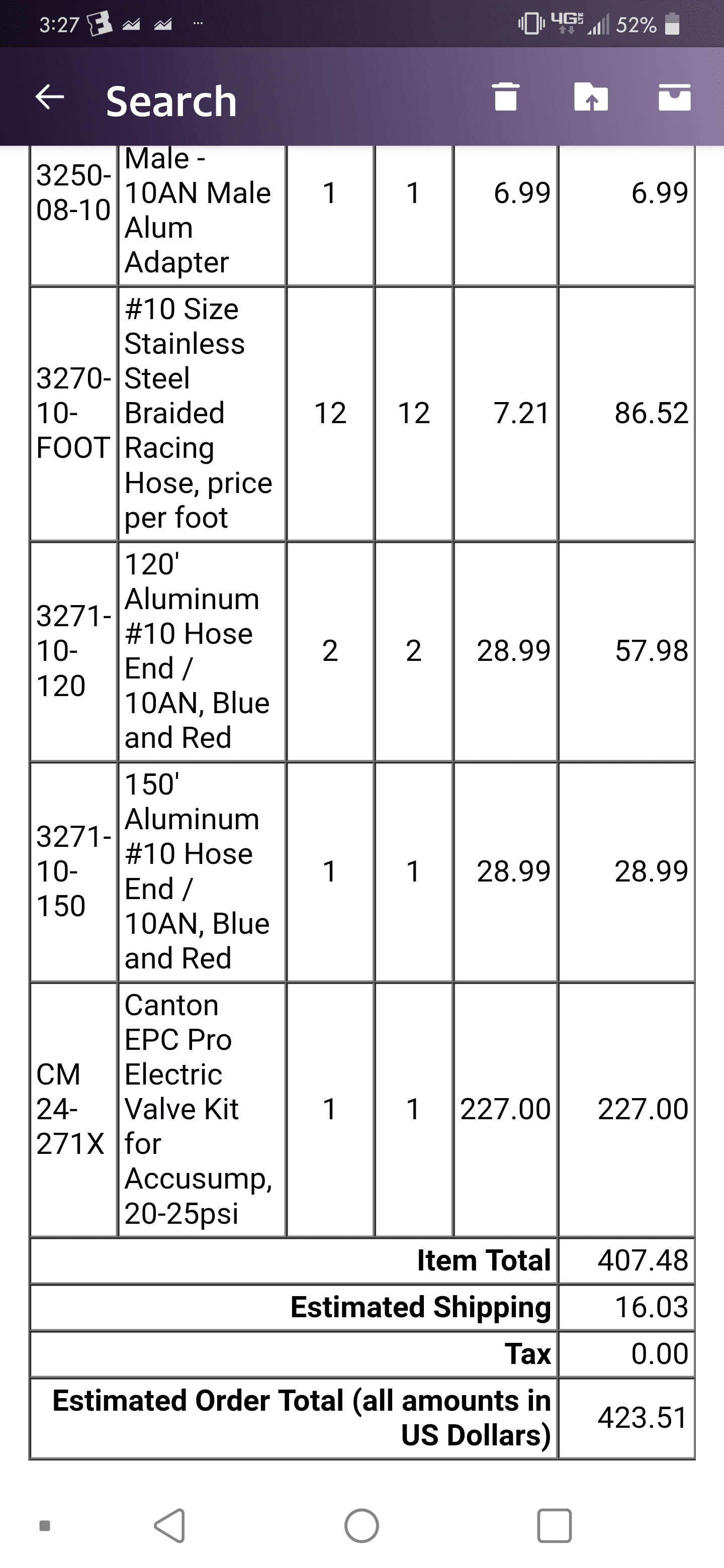

Another update for y'all. Went to the house Saturday and started making a mount for the accusump. Also plumbed up to the firewall. Used a -10 bulkhead fitting in what was the drain hole for the evaporator. Mount came out well. Next time I'm there, I'll mount it fully into the car. My only question at the moment about that is if I should weld it or bolt it to the floor in case I ever have to remove it. I'll figure it out before I get there. Just ordered a couple more fittings to finish plumbing the accusump in. Hopefully this weekend, I can finish it all up.
. My budget has me pretty tapped out for this race next month.
