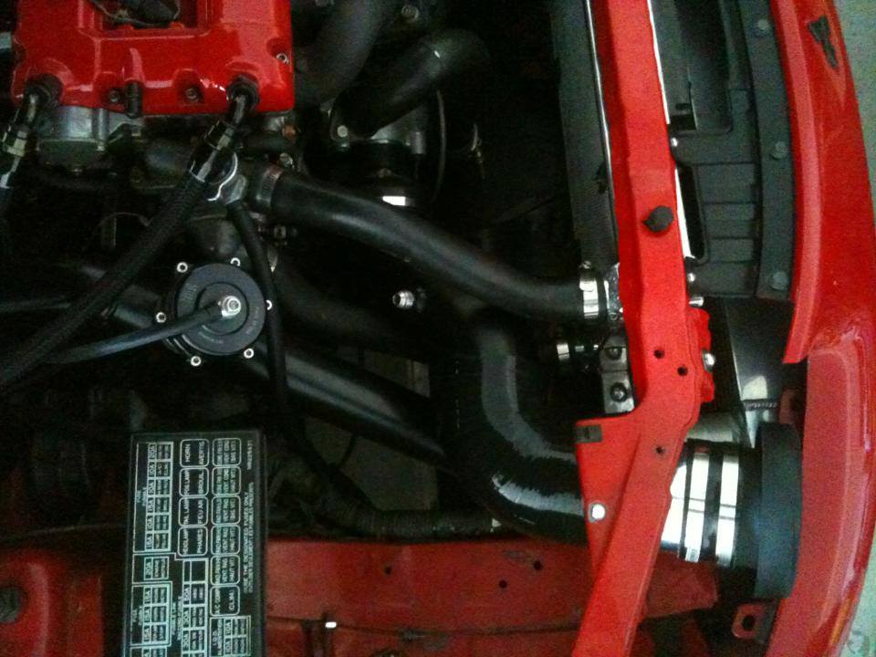

22APR2014 - Velocity Stack Headlight Mod
I was getting ready for another Test and Tune event on the 25th and still trying to hack this HTA68 to flow more. Even though I was having issues launching, both my NLTS issue (launching and going into clutch cut) as well as my valve float break-up if I hit the rev limiter, I was still trying before summer to hit that sub-11.5 pass.
I'm subscribed to the 14b Drag Race Discussion Thread, I know I've got a HTA68 but those guys push that turbo to the limit and know a lot more about these cars than I do. Using some of their advice, I thought I'd try picking up some airflow at the track installing a velocity stack and replace the K&N air filter. Here's the specific post I was referring to in the 14b thread ---> @SBStar Velocity Stack Upgrade
I bought the BLOX Racings 6" opening and a 4" neck, ran around $30, and a 4" 90* coupler so I could make the turn into the headlight opening. It wasn't long enough to reach outside the frame so I bought a 4" HVAC duct from Home Depot to push the VS out further in the opening. It worked out great for a <$50 setup that I threw together a few days before the last track event before summer hit, I was looking forward to seeing the results...

Prior to making my second pass I did install the velocity stack and drop my launch limit from 5250 to 4750, unfortunately I didn't get to see what 3rd gear airflow or IAT's looked like but lowering my launch limit worked. I didn't get a time slip because I bumped the rev limiter coming off the line and once again, the car wasn't drivable until after I let it idle (reducing oil psi in the head). Previously I was really watching the tach and making sure to short shift it, trying not to hit the 8k rev limiter... Well, it was obvious I wasn't ready for a MFBA launch and the DR's did what they were supposed to and hooked up.

One successful thing that came out of all this, look at that airflow in 3rd!! WHOA! 51.3lbs/m with that velocity stack and IAT's started cooler @ 82* and creeped to 91* which still wasn't ambient but still cooler than with a filter on the intake.

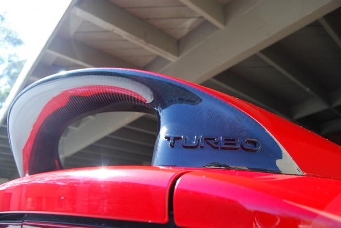

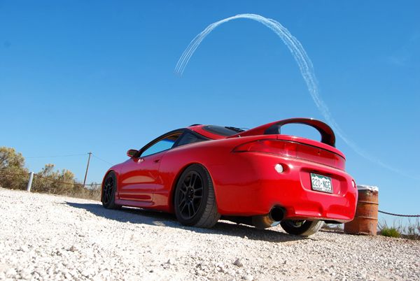

01OCT2009 - Photos of the CF Spoiler​
Picked the spoiler up from the body shop and they couldn't have done a better job. They color matched the red and followed the lines of the spoiler just like I had asked, PERFECT!
