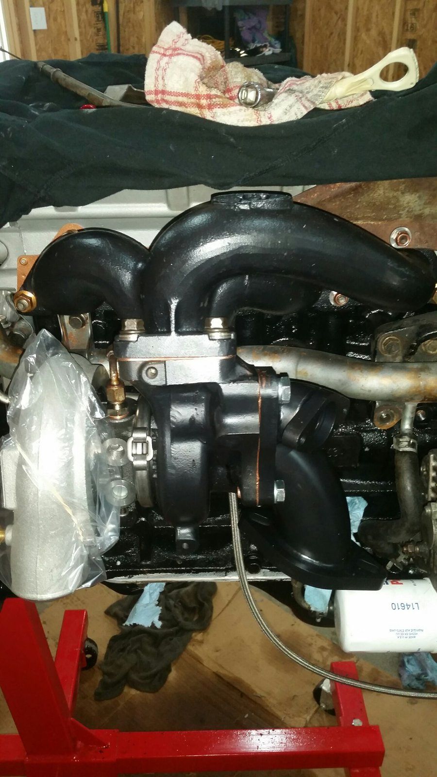

I just have some pics of the finished coated parts mounted up.

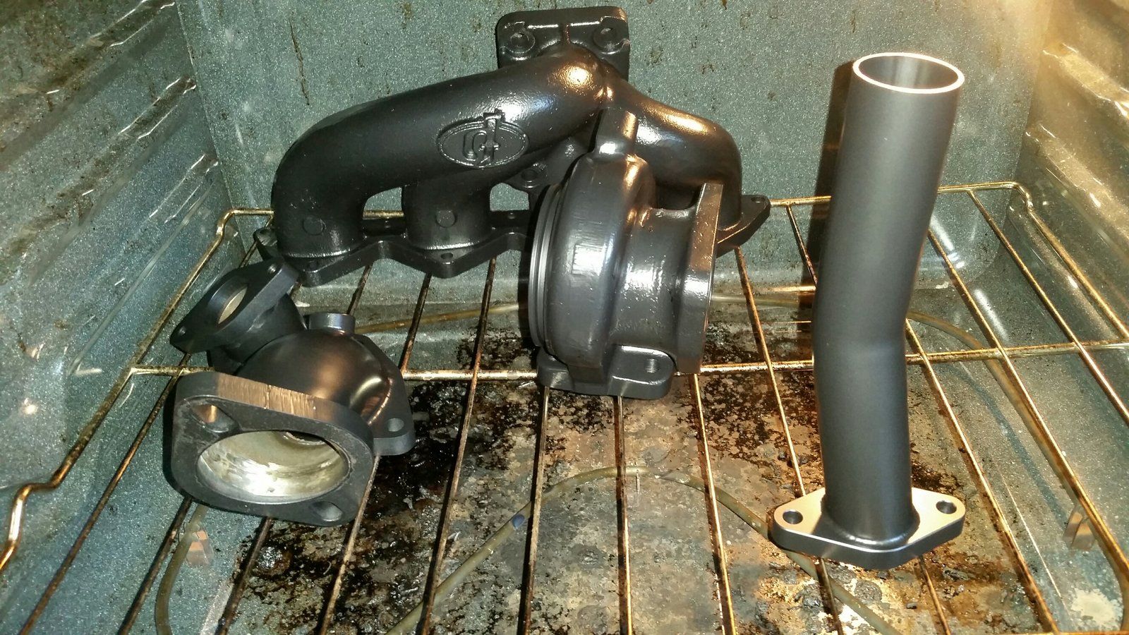

Here's a pic right after the baking. They were all cooling down right here but that's what it looks like. Trying to upload a pic of them mounted now.

And a pic of them mounted up. Waste gates were not baked actually. there's such a tiny area that i coated on there that i'll let the actual engine heat do the curing on the wg. My copper spray on my gaskets may have got a bit out of hand LOL, i tried not to mess up the nice coating much at all though.
Good lord, dude, do you ever clean your oven? /chef mode off

You hush up, my oven isnt THAT dirty hahaha. Ok, ok, it's not the prettiest but whatever.
