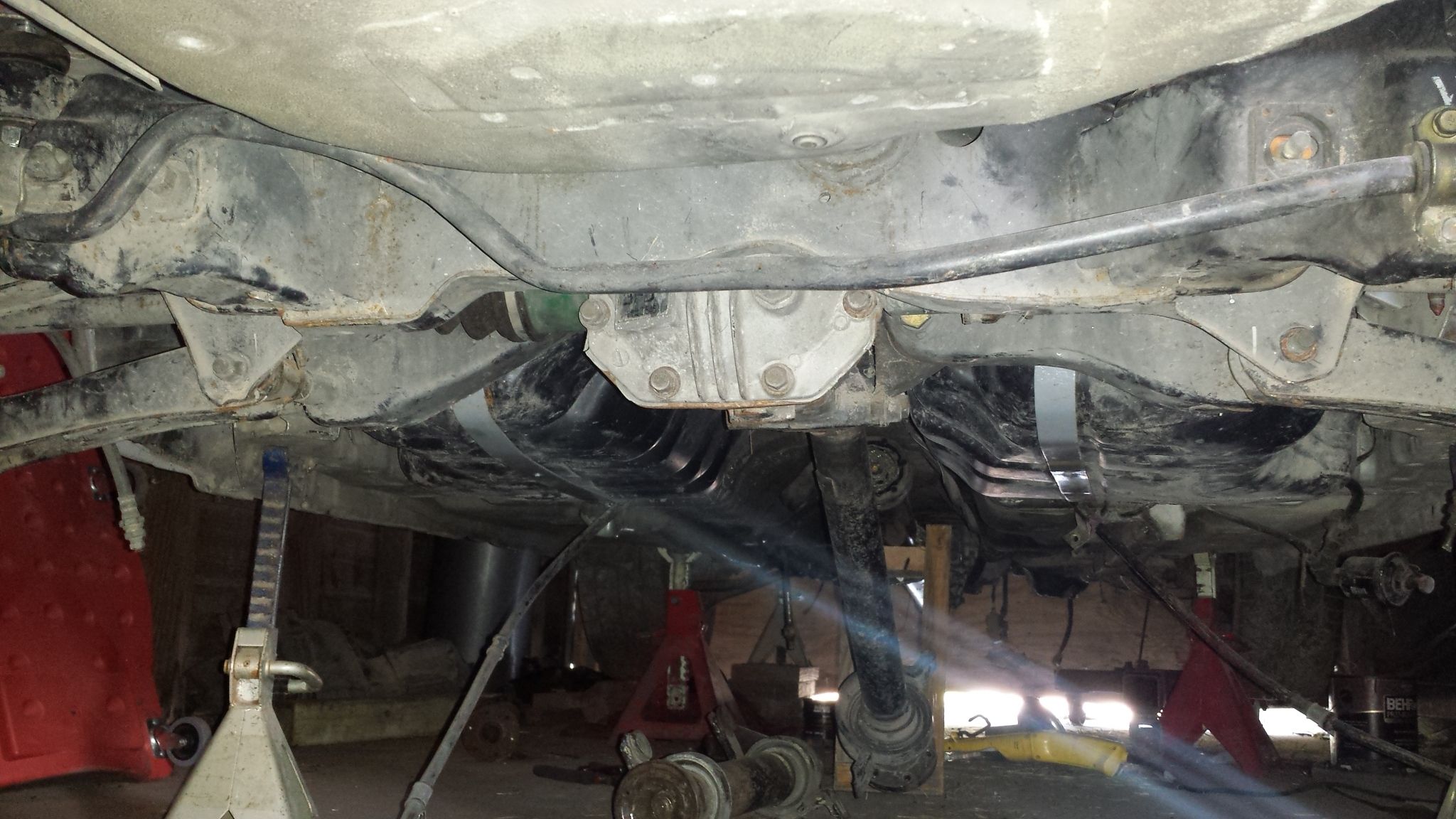

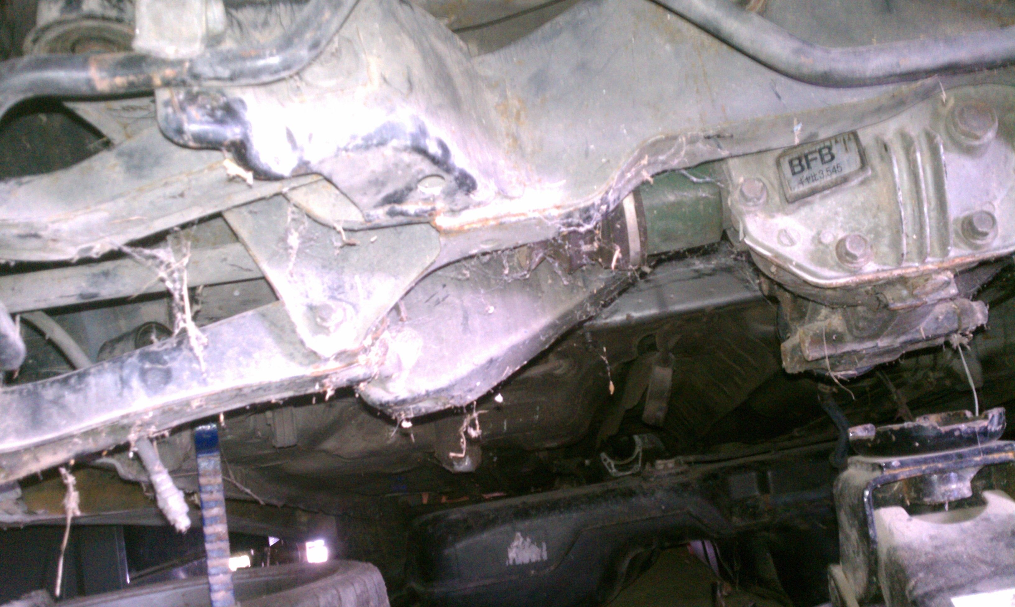

The car seats right now with a awd swap from a 95 gsx rear end and gas tank.

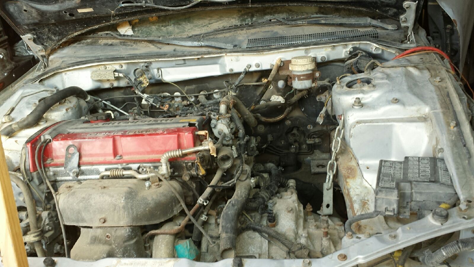

I have the motor inside in the car.
Yes the motor drops right In.
The only thing you have to do is move the transmission mount down .

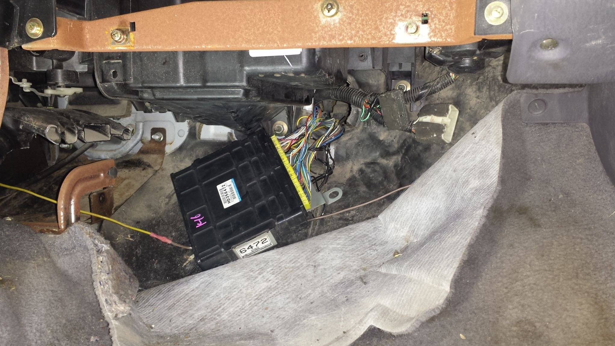

Right now I am working on the wiring part.
Dose any one knows where I can Get a pin out of the instrument cluster wire diagram.
So I can wire in the cluster to the ecu.
any help will be appreciated.

What rear end did you use with the Evo Trans/T-Case.

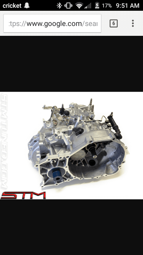

Can you not just run the evo trans without the t-case. Our awd has the Center Diff in the trans, but I believe the evo trans has the center diff in the t-case...
