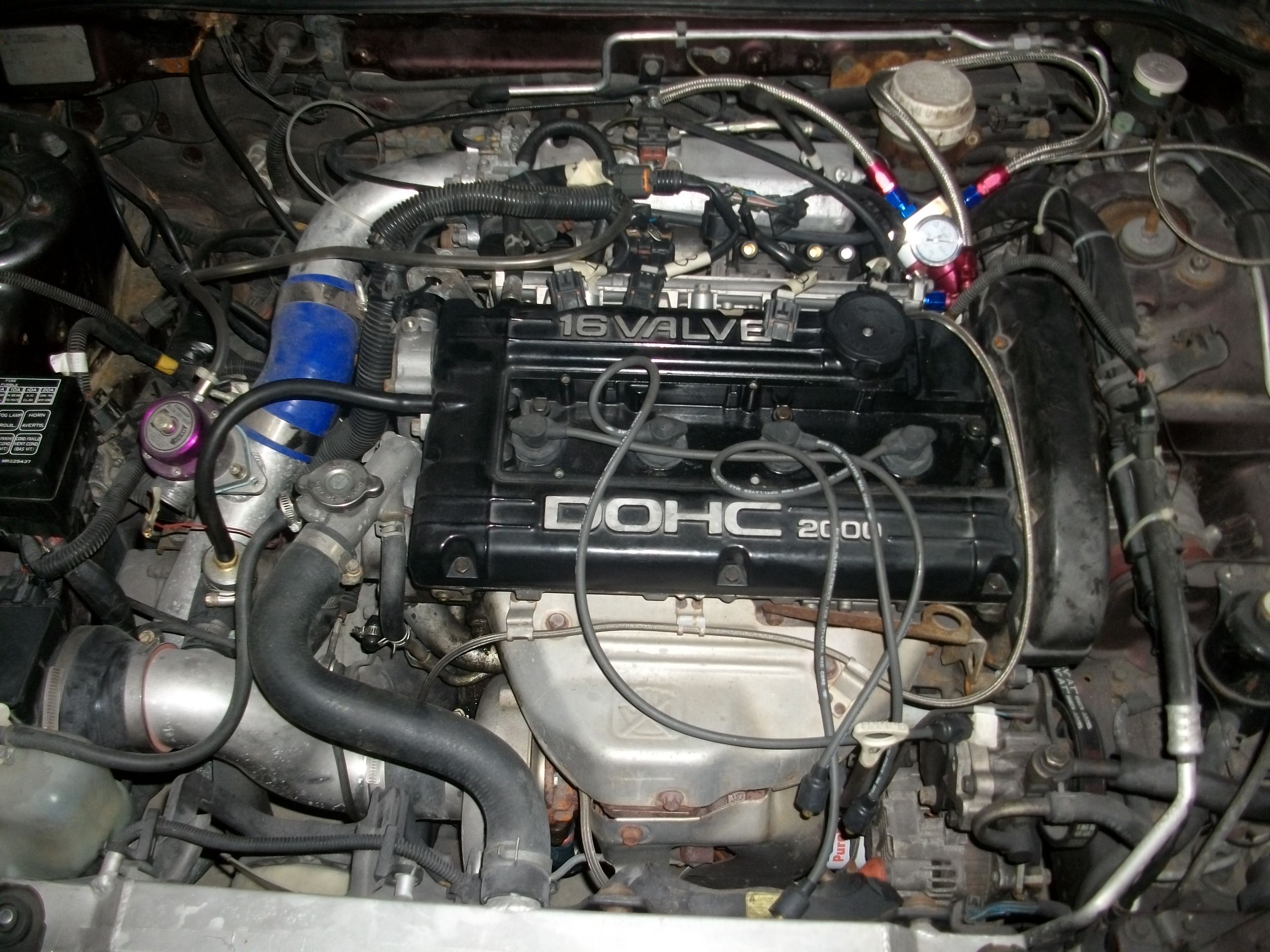

Ok....... I think im finally ready to do the swap and build this car RIGHT this time. Im ashamed of the wiring. Its a fast car, dont get me wrong. Body and paint done recently. I just dont like fwd anymore and found a 95 auto gsx as the donor car. It happens to be in pretty good shape too but after spending so much money on the 97 i cant justify having all the body work done and paint all over again. I have less rust on mine as well. So heres a few pics. Literally nothing done so far. Just showing the donor(100% stock btw) and my car and the wiring mess under the hood. I need to shame myself into getting this done haha. Seriously.
i will attempt to get better with the pics and my descriptions of what im doing as time progresses.
This will stay 2.0, metro auto, shift box, all the goodies i have currently and PLENTY more to come. Im sure ill run in to a million things. Going to try and do a wire tuck or a "half" wire tuck. We'll see how much time i have with work and the newborn baby. This may go slow. If you live in the st louis area and would like to make some money i could definitely use the help! Just pm me

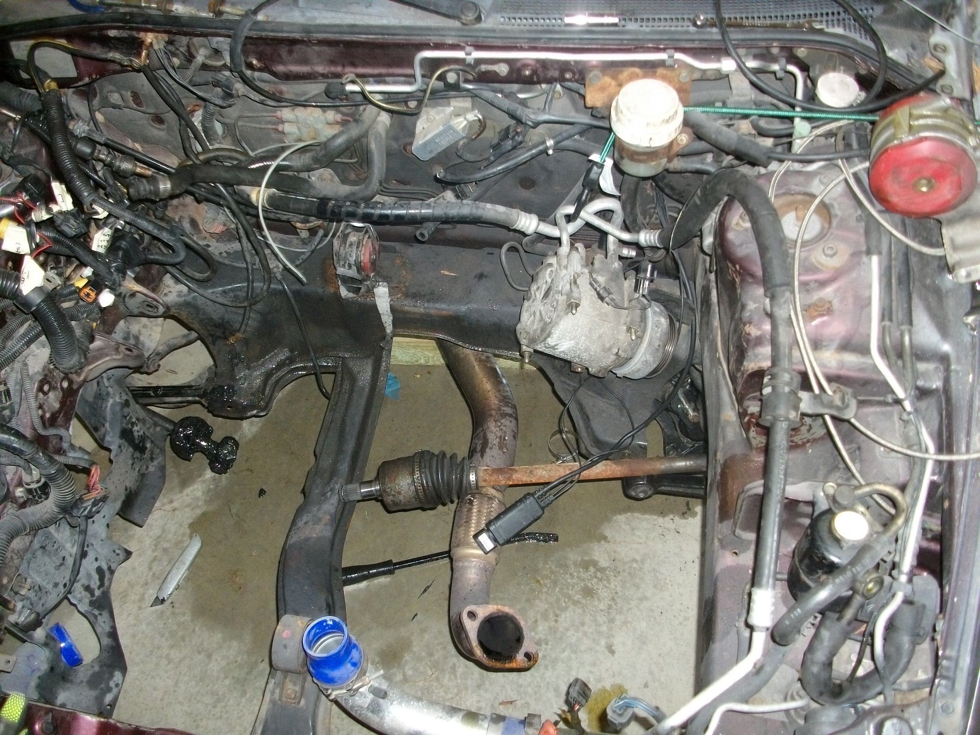

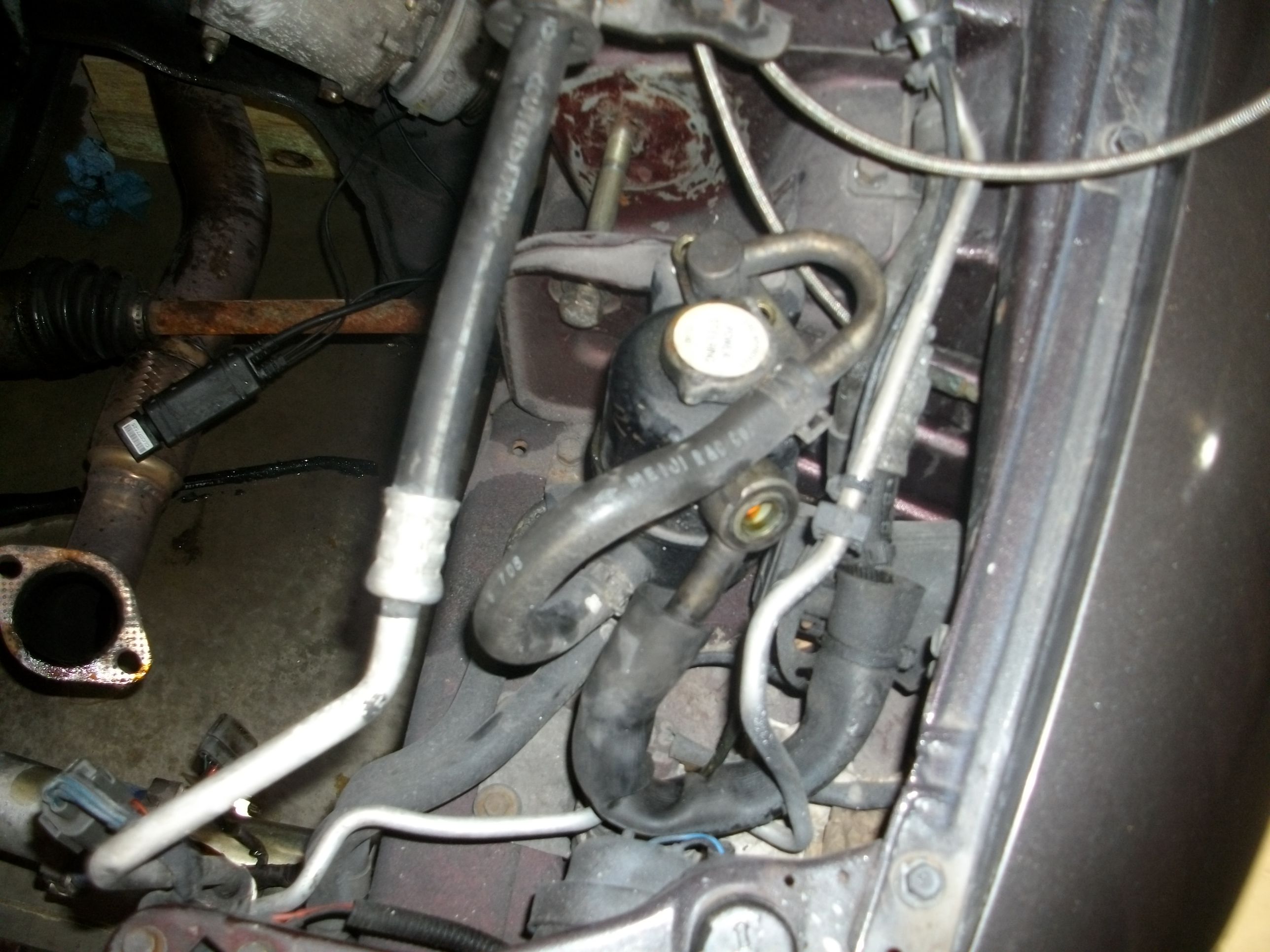

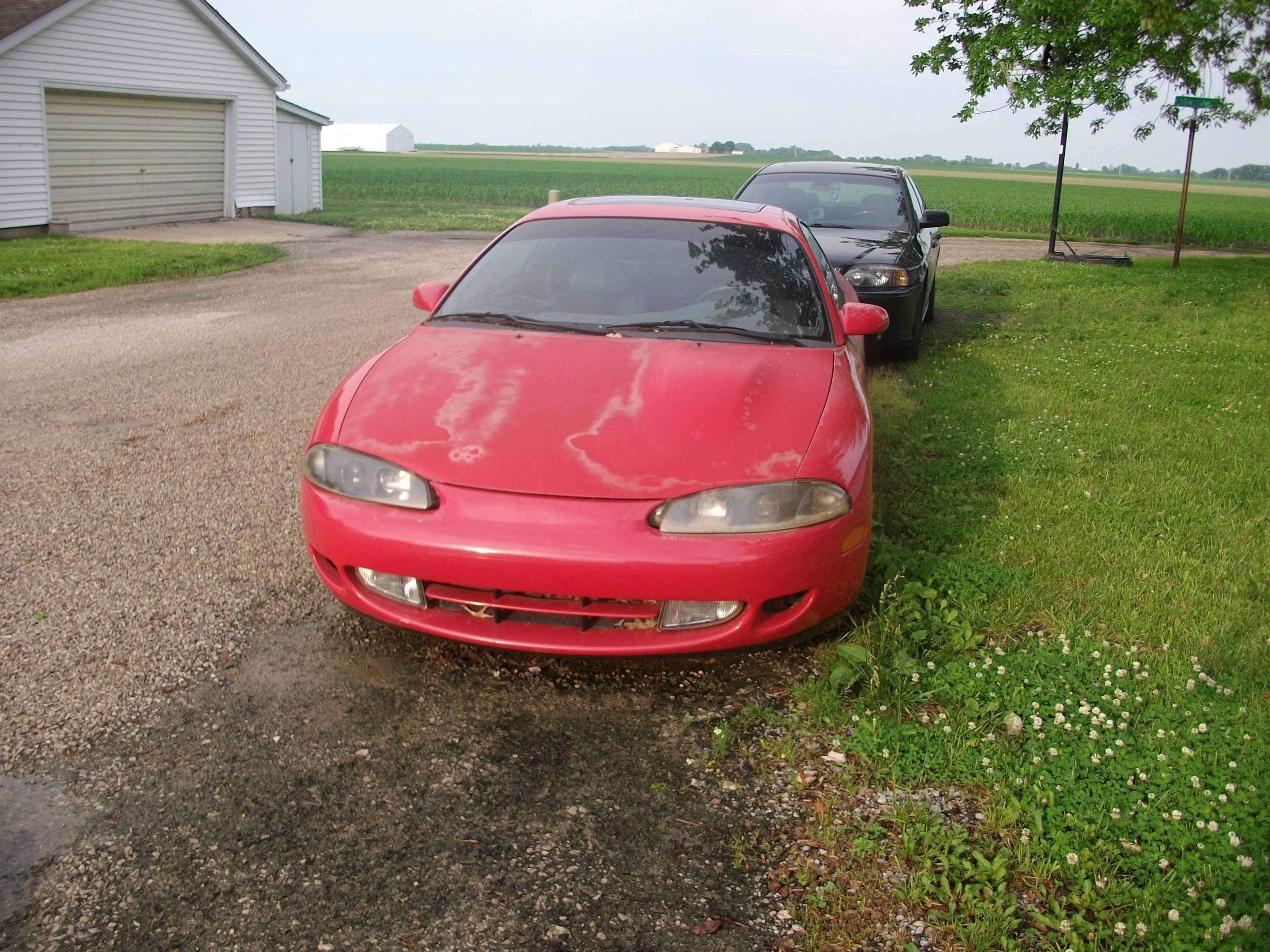

Draining tranny now. Then pull axles, unbolt ac and power steering and engine will be out!
Cant wait to see the #2 piston. Thats ultimately the reason for this major rebuild. Have Mahles in there w eagle rods. about 4500 miles. Great comp and leakdown on all 3 but just the #2 cylinder is down around 95psi w 35% leakdown. No smoke, idles and drives great, pulls like a mule..... Only reason i checked it cause i noticed sputtering up past 40lbs/min and i had changed everything. I know fuel n spark were good. Found a good local machinist and the head will be going to Bogus for porting and valvetrain work. My crower 272s will become (Delta) kelford 272s after a regrind.
More pics of the headache coming soon.

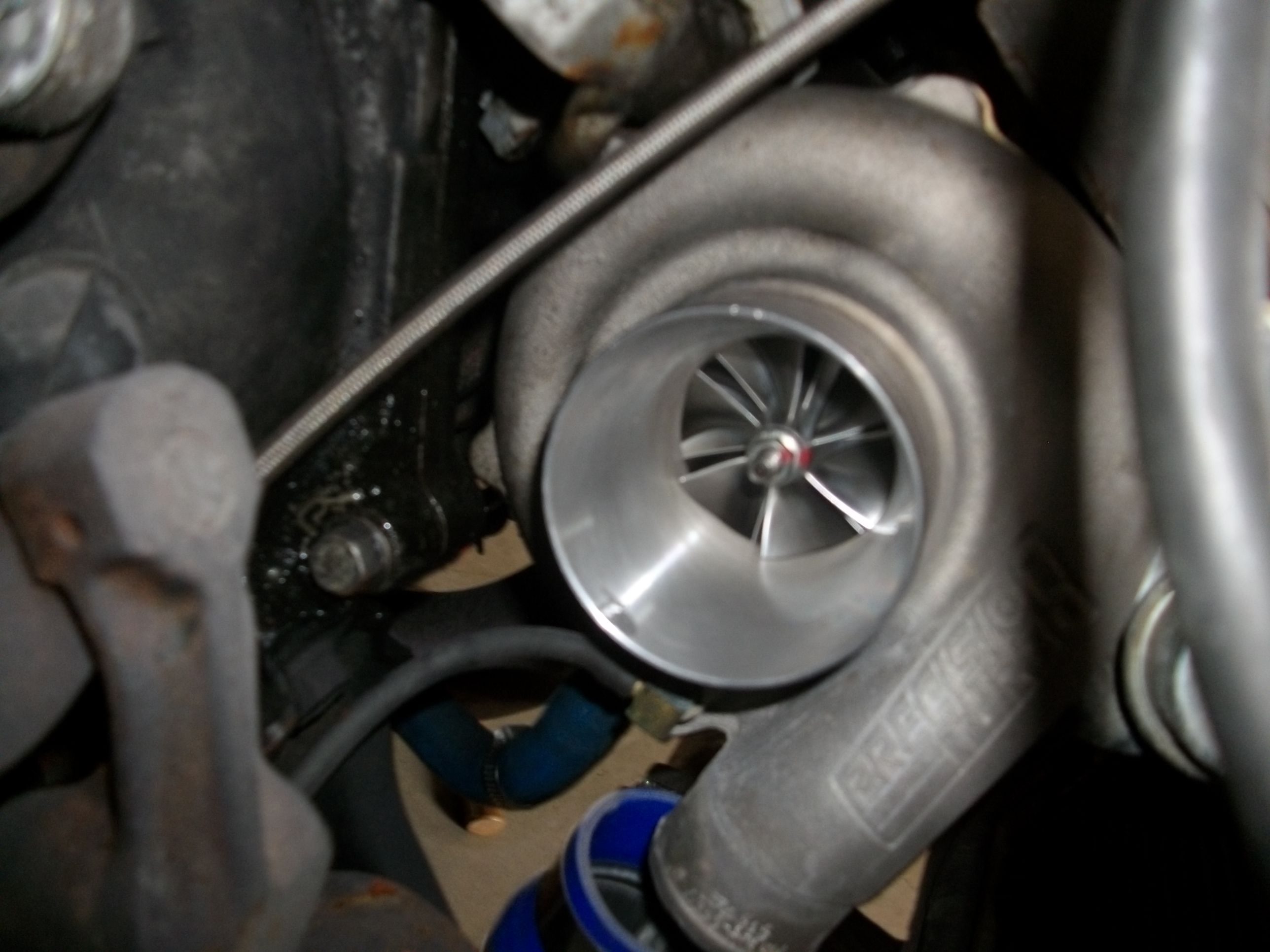

BTW: After 4500 miles and pulls over 30 psi the PTE 5558(not a 5858 as i had said before, checked p/n DOH!) is holding up GREAT. Ill take pics of that lil guy as well later
I couldnt even remember what turbo i bought and have it listed as a 5858. Shame shame. And old age hehe

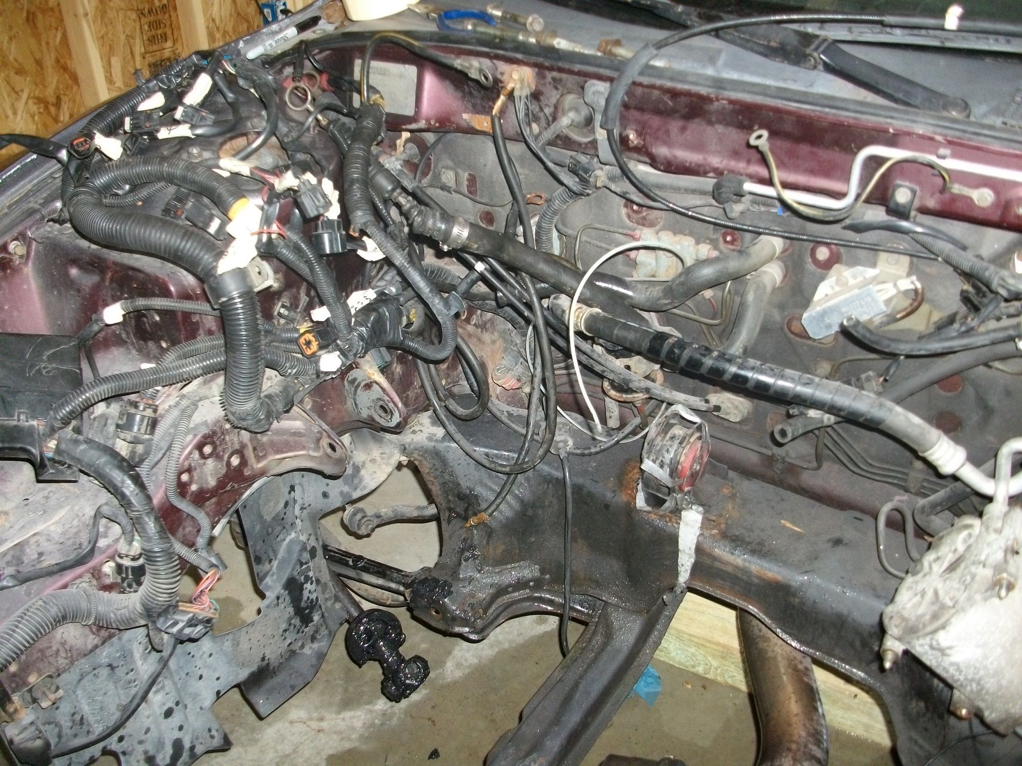

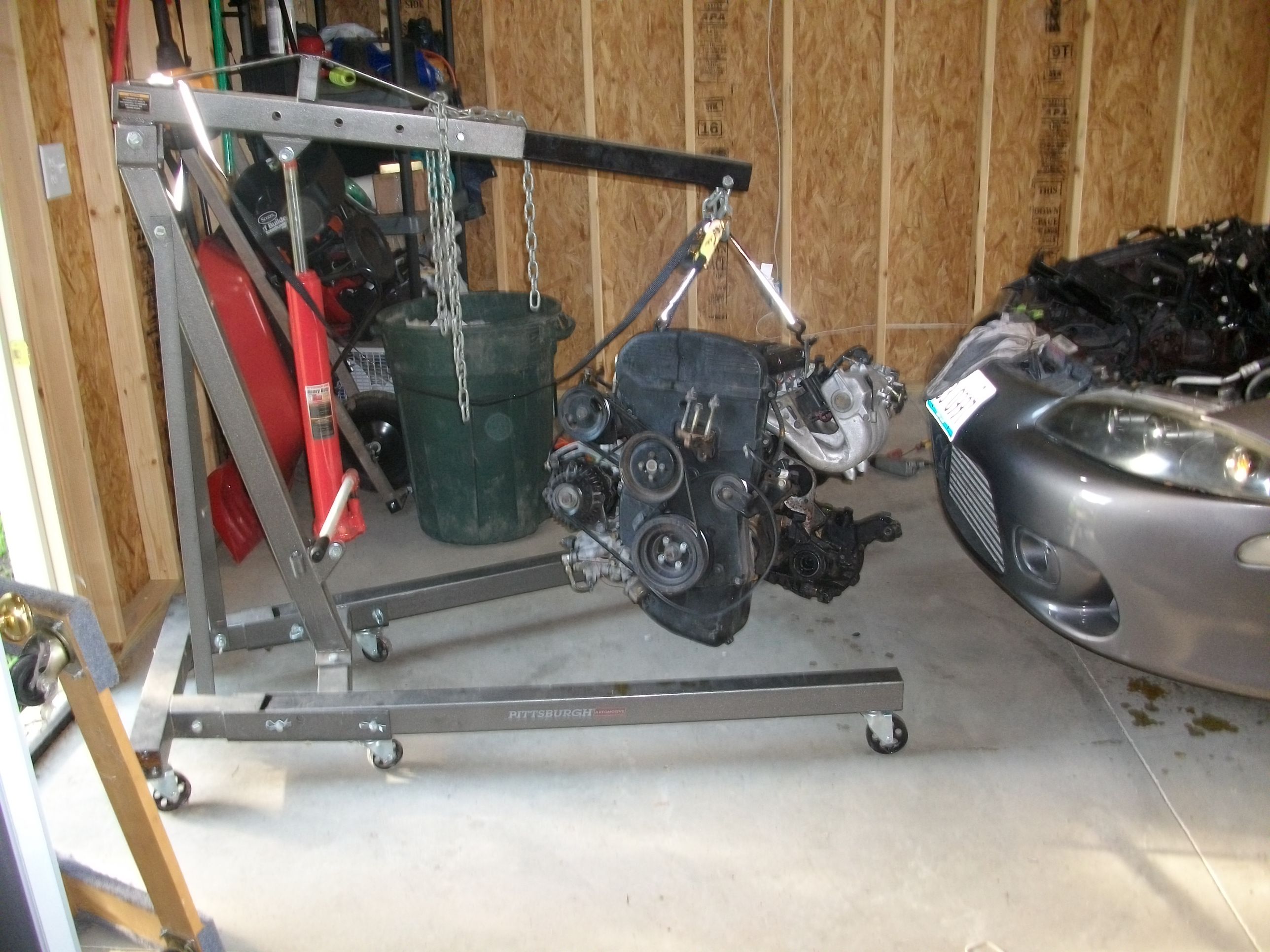

Edit: Got it out. NEVER pulling engine and tranny together by myself again. Damn that was dangerous and stupid. Ran in to a million problems, hardest pull ive done on a mitsu so far. This would be the 5th, iirc. So much easier to drop tranny out the bottom then pull engine. When the auto goes in it should be a lot easier i think. Had to cut the drivers side inner cv boot. It was frozen in the tranny. Matters little though, i wont ever be using either shaft again.
Subframe has the mount welded to it LOL. So i guess im swapping front subframes now too........
Makes it a real bi*** to pull when its WELDED. You can see in the pics ill post up later along with the wiring!!!!! Thats the best part.

Damn bro, I thought I had it bad LOL. That welded bracket is crazy. Some people have no business working on cars. Hope you don't find more odd surprises. Keep up the good work!
Yea...... it didnt want to come out. Thats putting it easy LOL. Toughest pull ive ever done on a 4g or any eclipse or any Car!!!

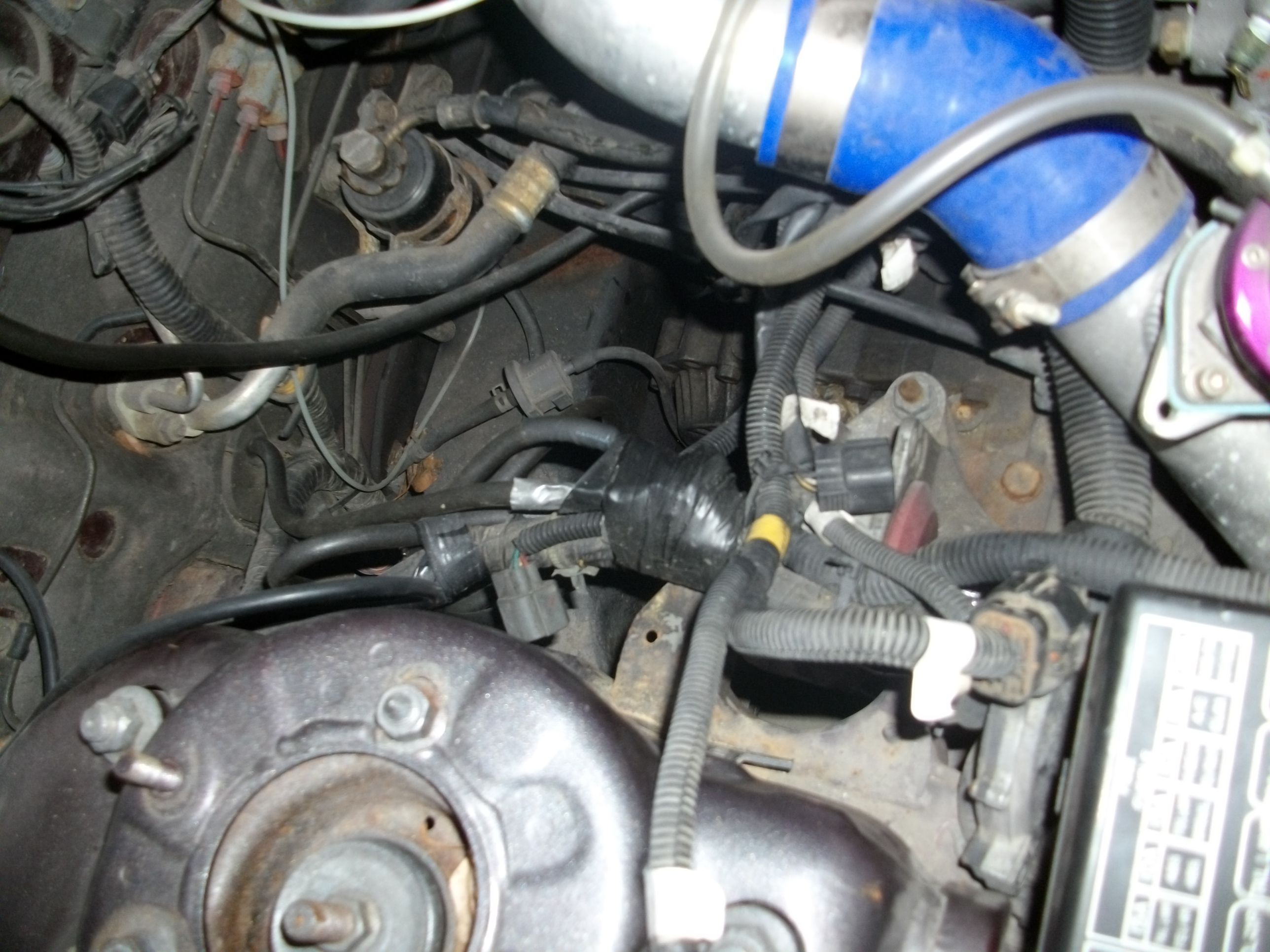

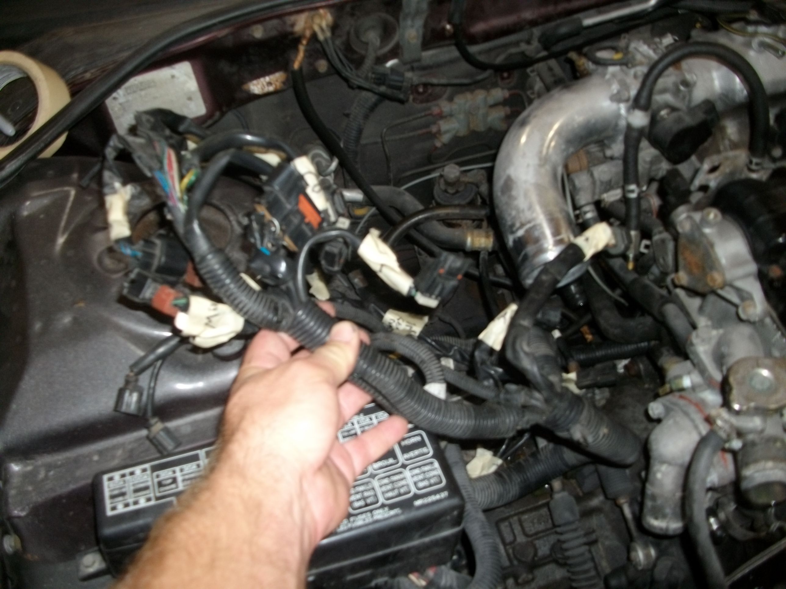

Came up with a plan of attack for doing a wire tuck. Not removing dash, fenders, all that. Just going to extend the in-bay fuse/relay box wiring so i can get it mounted in the glove box. Only new wiring will be 1 single 4ga from the alternator. Going to run it along the side.
The engine harness im just going to carefully separate and then cover it with the wrap from JEGS. Should be able to run that along the back firewall and up through the IM. Not messingwith TCU or coils til i upgrade Intake manifold.
Thats the PLAN at least LOL, i know how that shit goes. Ill find one or 2 wires that HAVE to go around the hard way and end up pulling both fenders and doing it the Professional way.

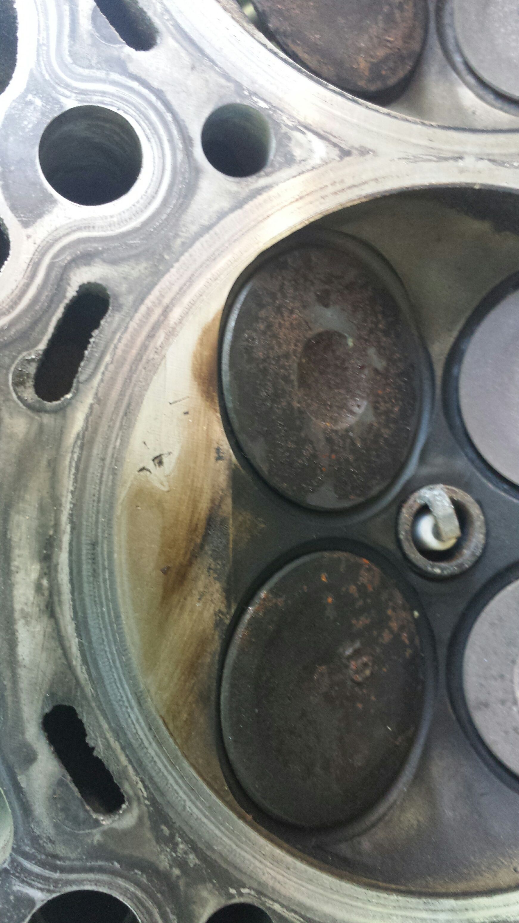

The build shall continue. He vac tested all 4 cylinders and they came out perfect. He tried pulling vac on the head(cyl 2) and it would even go below 0, thats how much air was moving past the intake valve. I have no idea how i missed it and it cost me an extra 300 bucks for no reason. Oh well, shit happens and I learned a lesson: Take the head to get checked first if the block looks perfect.
I will post a hi res pic if possible, of the valve up close. You can see burn marks right where the valve seats. So the head is probably staying std size valves but duel springs/K272/adj cam gears this go around. After reading a bit i dont think 1mm OS is gonna be worth it and its basically something else to possibly be cut wrong and end up in the same boat.
Overall: Things looking up. Oh, and if you live near st louis and want a 2006 lincoln LS for cheap or a showroom condition 08 zx10r w 7k miles hit me up!!! Too many cars and too many toys.
Intake valve: Notice burn mark and notice the pit on the flat part! I fear this is un-millable(not a word, you get it though)

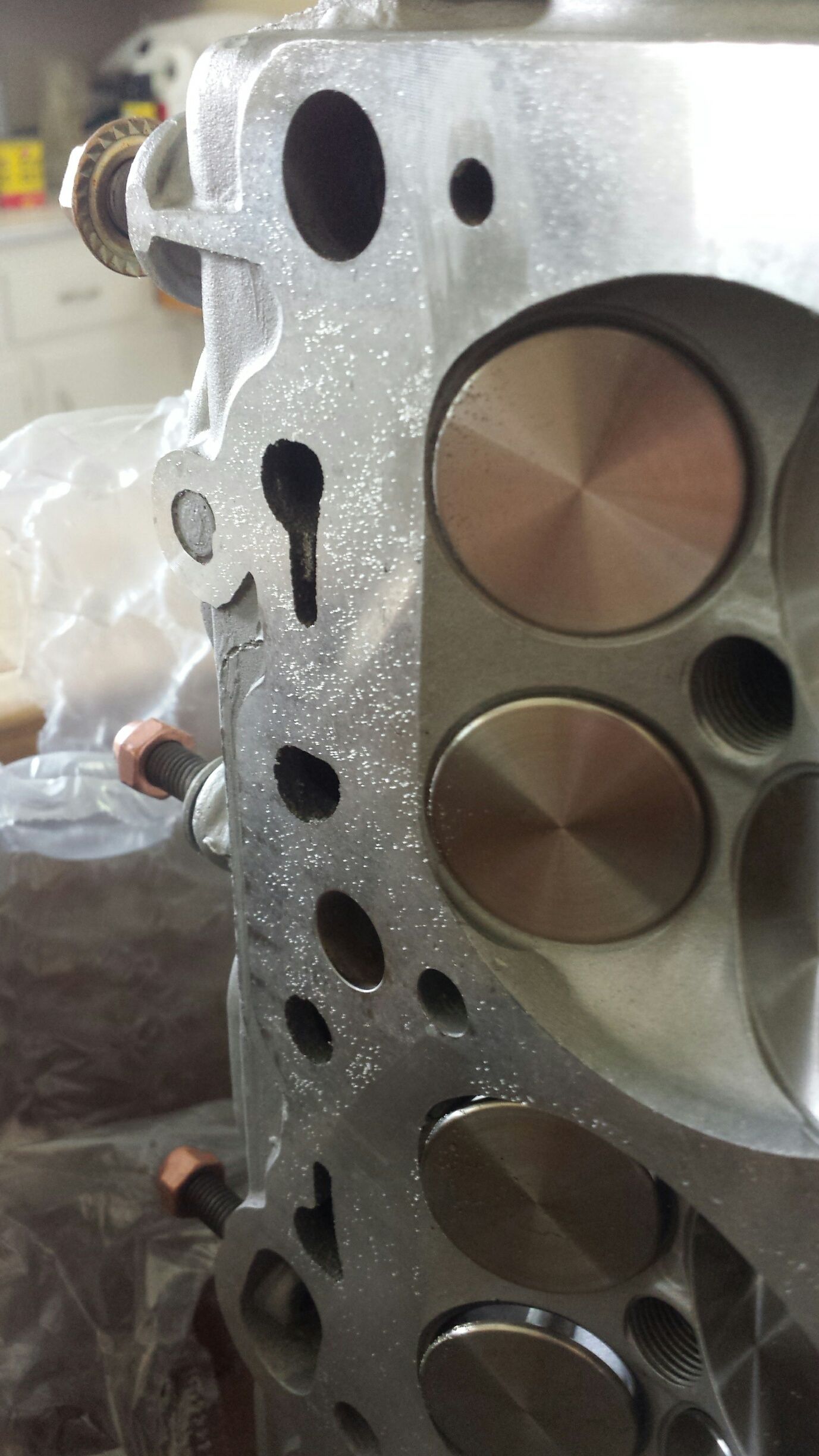

Pics coming soon. Just opened my box from SIM. Everything looks great. HOWEVER, sand/blasting media is ALL over the head. Good god man........ I just cant catch a break! So now idk if i have to tear it down or just flush it with water or take it to a machinist to have cleaned. I sent this off specifically because of the bad experiences ive had with local machinists.
Well, the port work looks great at least. One step forward 2 steps back. Getting used to this.
Anyway, the plan is now to have the head cleaned properly, get it torqued down and immediately to a leak down test to verify my block and head are sealing properly.
I'm calling SIM now to let them know they sent me a beautiful head covered in blast media. SMFH.............
Just talked to Alan. Said he would pay for return shipping no questions asked if i didnt feel comfortable washing the sand out. Im going to give a shot cleaning it myself but if i have doubts this build can wait a little longer, im in no rush. I'll just send it back to them to clean it again. What a HUGE hassle though. One grain of that shit could cause a major very very expensive problem.[DOUBLEPOST=1409005081][/DOUBLEPOST]Cleaned head of all media. Wasnt a lot and was only on the deck. Found a minimum of 5 separate places i can catch a fingernail on. I'm not sure if thats acceptable or not. They're not big "divots" but they are there nonetheless. In combustion chamber of #2 cylinder is the largest. This will create a hotspot no doubt. I took vaca time this week to assemble longblock. grrrrrrrrrrrr.
Idk, i might run the head as is with the nicks in it. They're not that bad. Im just freakin out cause its like no matter what, no matter WHO does work on your car that isnt yourself shit just gets squirrely really quick. Not in a fun way. I mean, SIM is a supporting vendor. I get THIS from a TRUSTED vendor? Im all happy that they are not being dicks and accept responsiblity but that doesnt magically make more time in my life to work on a car.
If anyone is reading this what do you think i should do? Send it backa nd wait a month or are small nicks ok? MLS cometic HG, btw

I gotta say, that FP black is going to shock me if it's much of an upgrade at all over my precision 5558. The Black is TINY. It looks silly with that little compressor housing and HUGE wheel inside.
God knows how this thing will perform. It's a turbo that has no place in such a tiny housing, on both ends.
This thing would be a monster on a Evo twin scroll(10cm??) with a bigger turbine wheel. Oh well, it was cheap, under a grand. Let's see what she does before i bash it too hard. Just tough to see such a tiny turbo attached to a built engine i plan on laying down 500-550 awhp with
