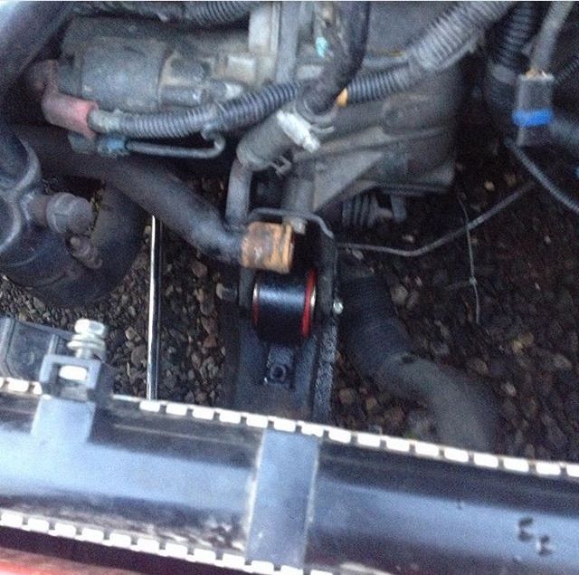

Urethane motor/transmission mount inserts

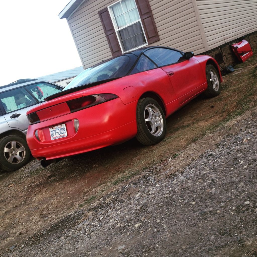

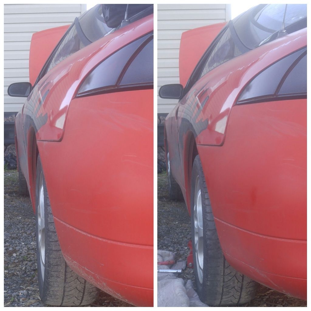

First thing I did, was tint the tails.

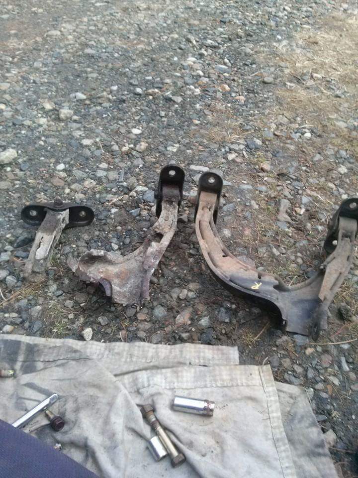

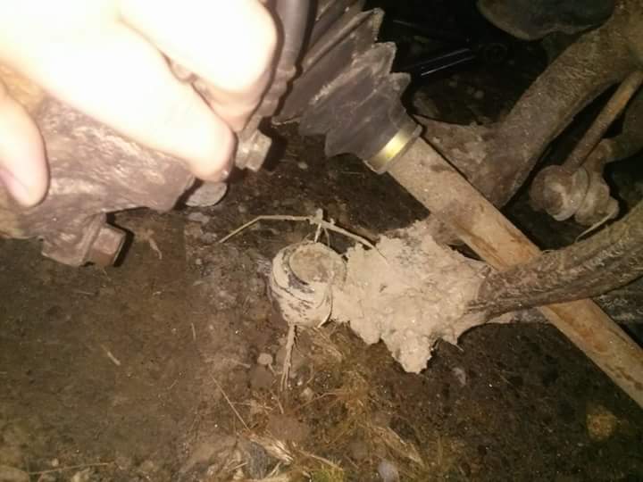

Not even a week later.. the right balljoint failed.
Ordered brand new Control Arms, and replaced that one as well as the other side.

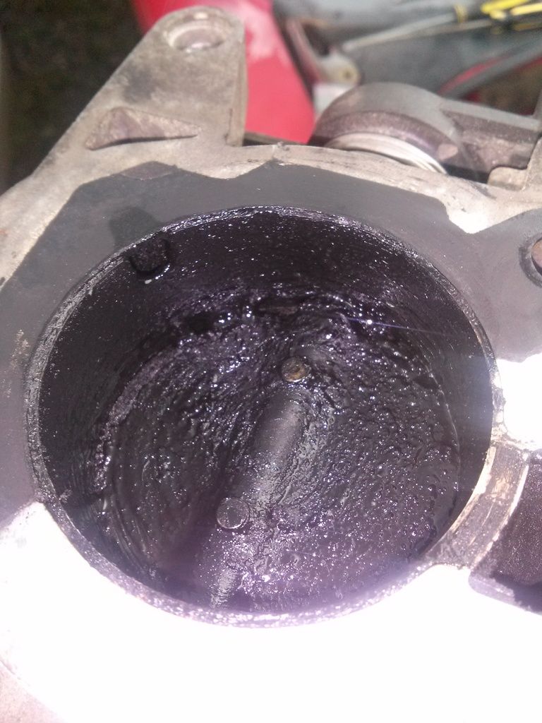

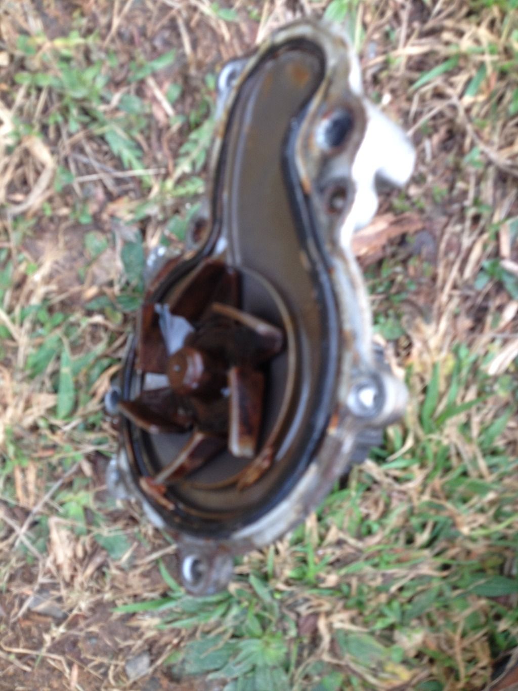

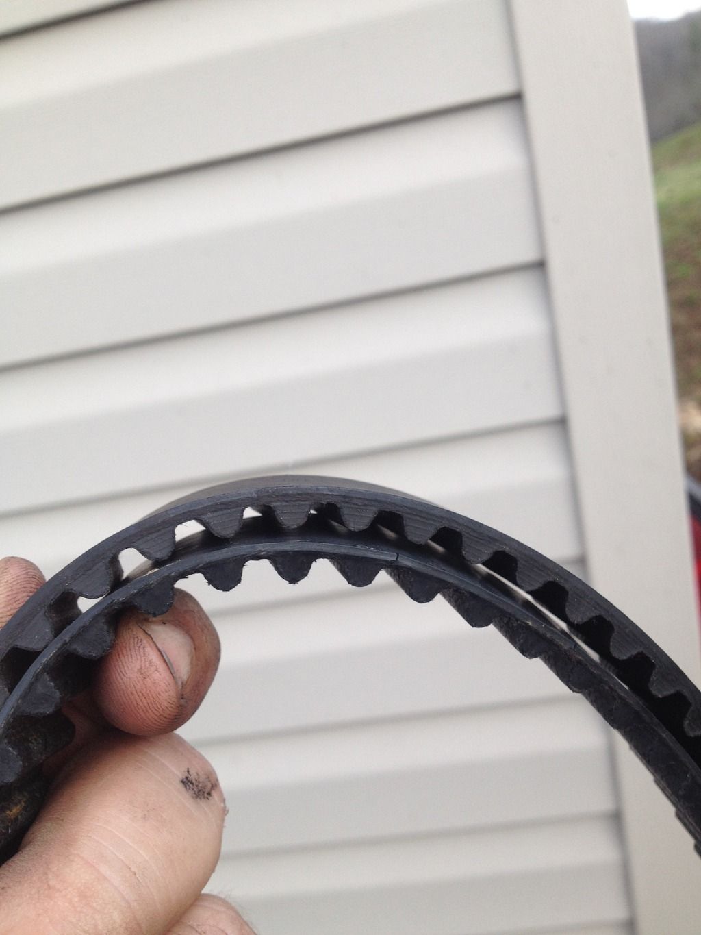

Drove it for about 2, maybe three months and one night the rubber hose on the coolant line above the header ruptured, I didn't realize until it was too late, HG blew.
So my friend who has done lots of work on 2G's, especially with the 420a offered to help.
We loaded it up, and thats when I realized I had problems....
But I'd worry about that after I got it running again, had to get to work, bumming rides off of friends and family sucks.

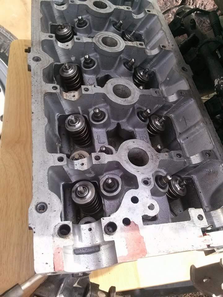

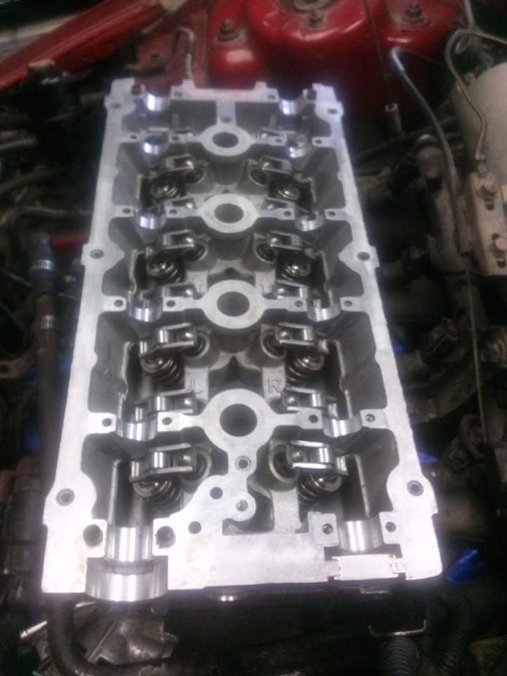

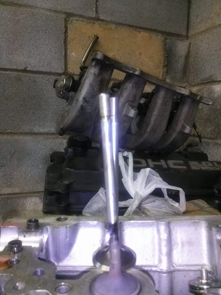

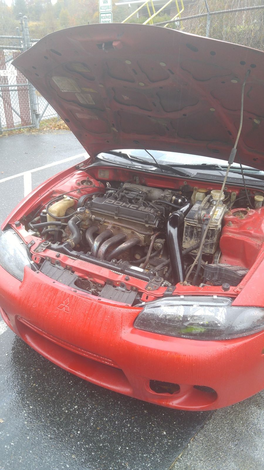

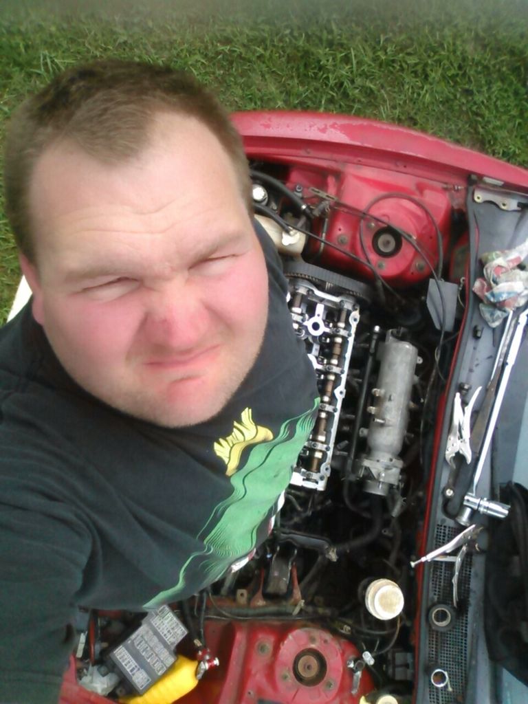

So decided since I had to replace the HG I would go ahead and replace the two valves in the built head and swap it on, and we did.
Surprisingly only the two #4 exhaust valves were bent, all the other cylinders were fine.
Got it all finished up and running.

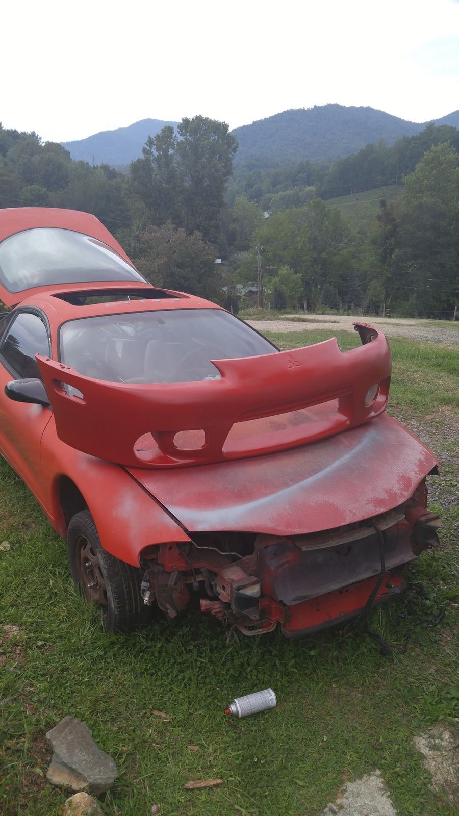

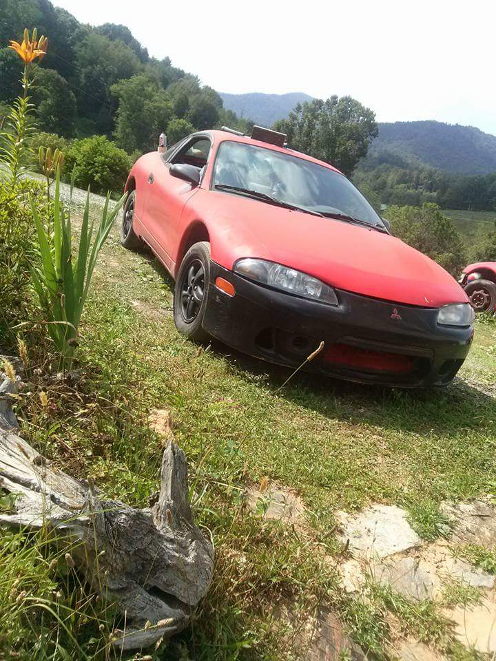

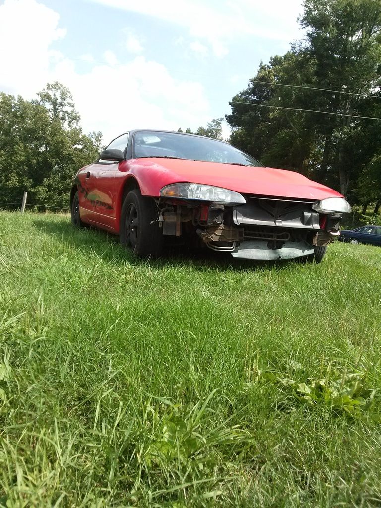

And then... THIS happened and I knew enough was enough, time to find a new shell before somethings really bad happened.

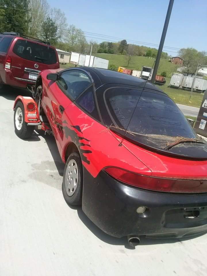

And here is where the Talon story takes over.

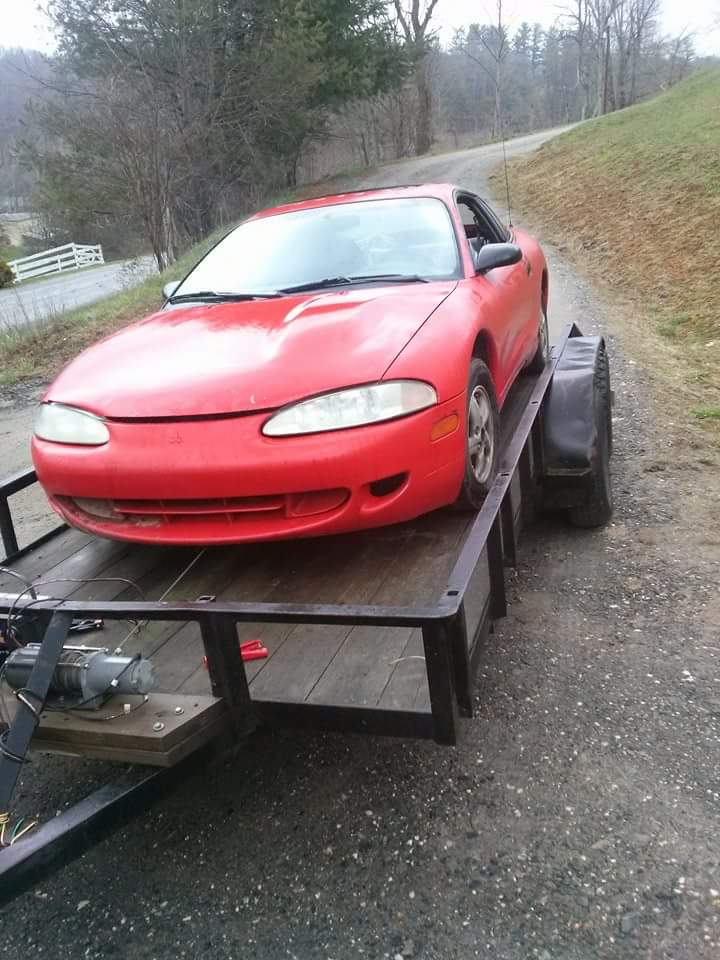

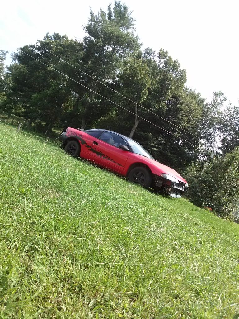

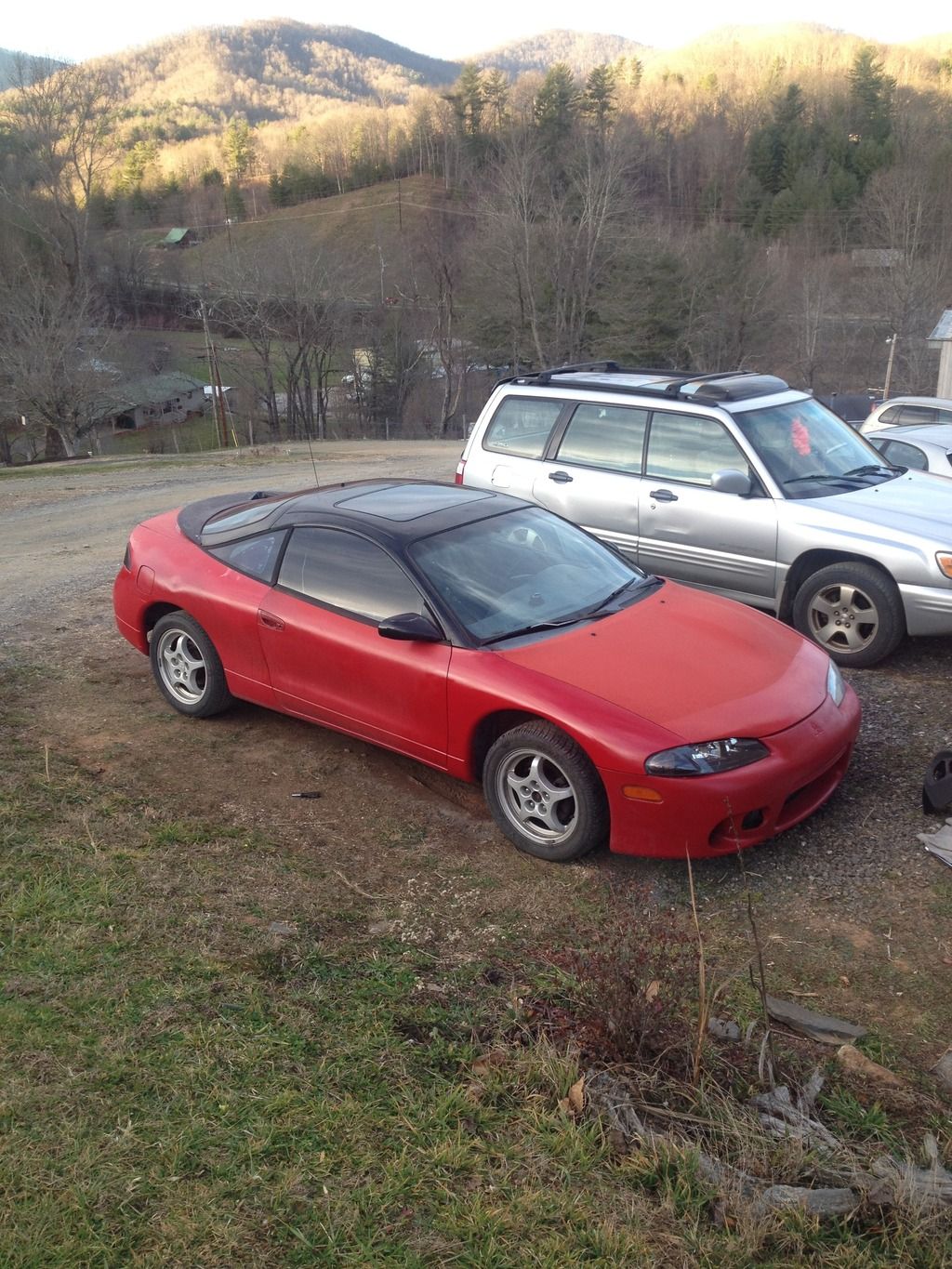

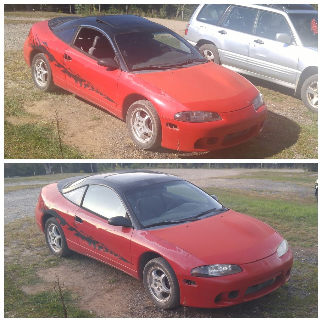

SO I got real lucky and found a 95' Talon ESi with 2Gb eclipse bumpers only an hour away from me for $200
Thanks to a early bday present from my dad, we went and picked it up.

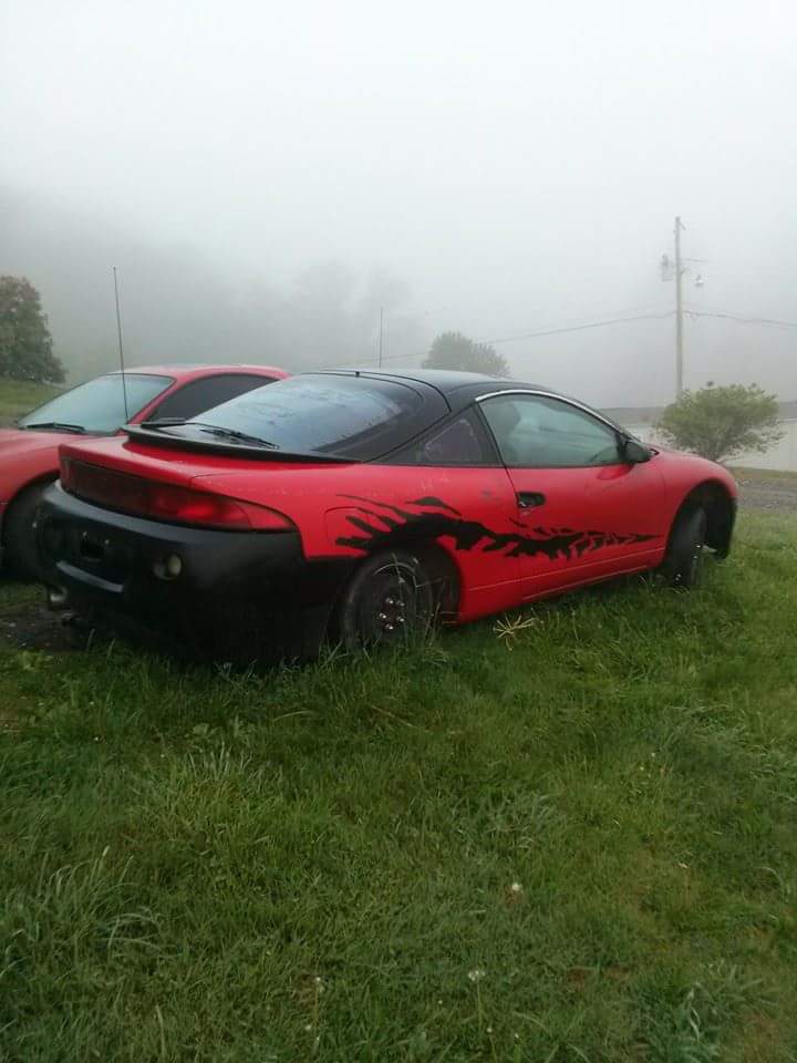

First thing I did was look over every inch of the body for ANY signs of rust, and besides a few spots of surface rust under the hood, its a clean shell.
Well besides the paint.. and that decal on the sides. But hey a paint job is a lot easier to deal with then huge rust problems.

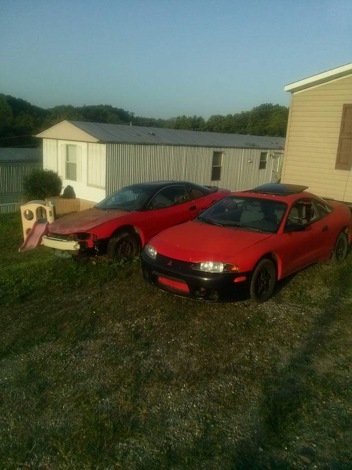

Parked it where it would sit for almost 2 months while life kept sadly me from getting the project up and running.
However got a few things done during this time, swapped the 2Gb front onto the Rustbucket and ran it like that while I was forced to drive it.

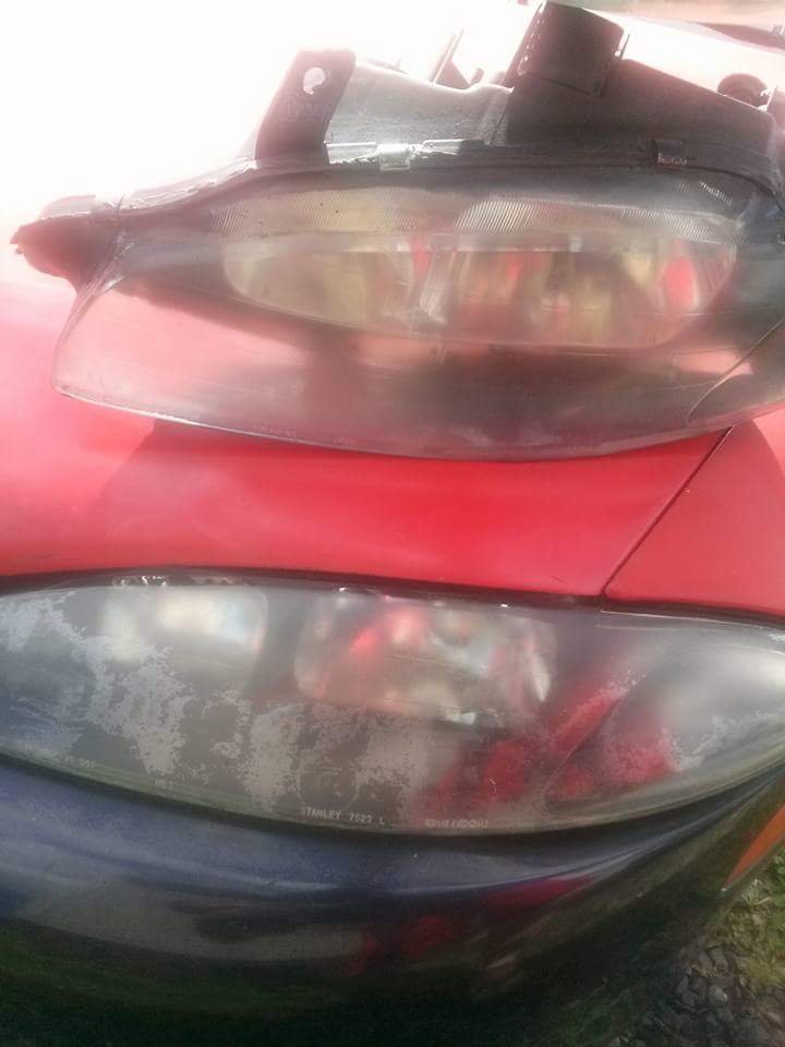

Traded some extra parts I had between the two cars for some new(er) headlights.
(new on top)

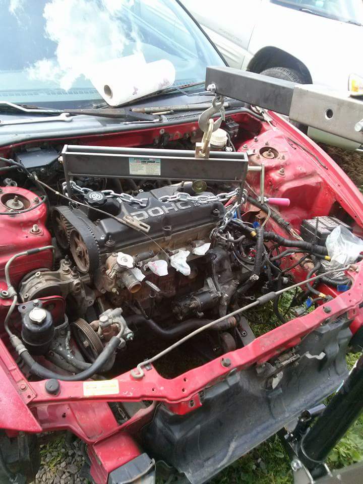

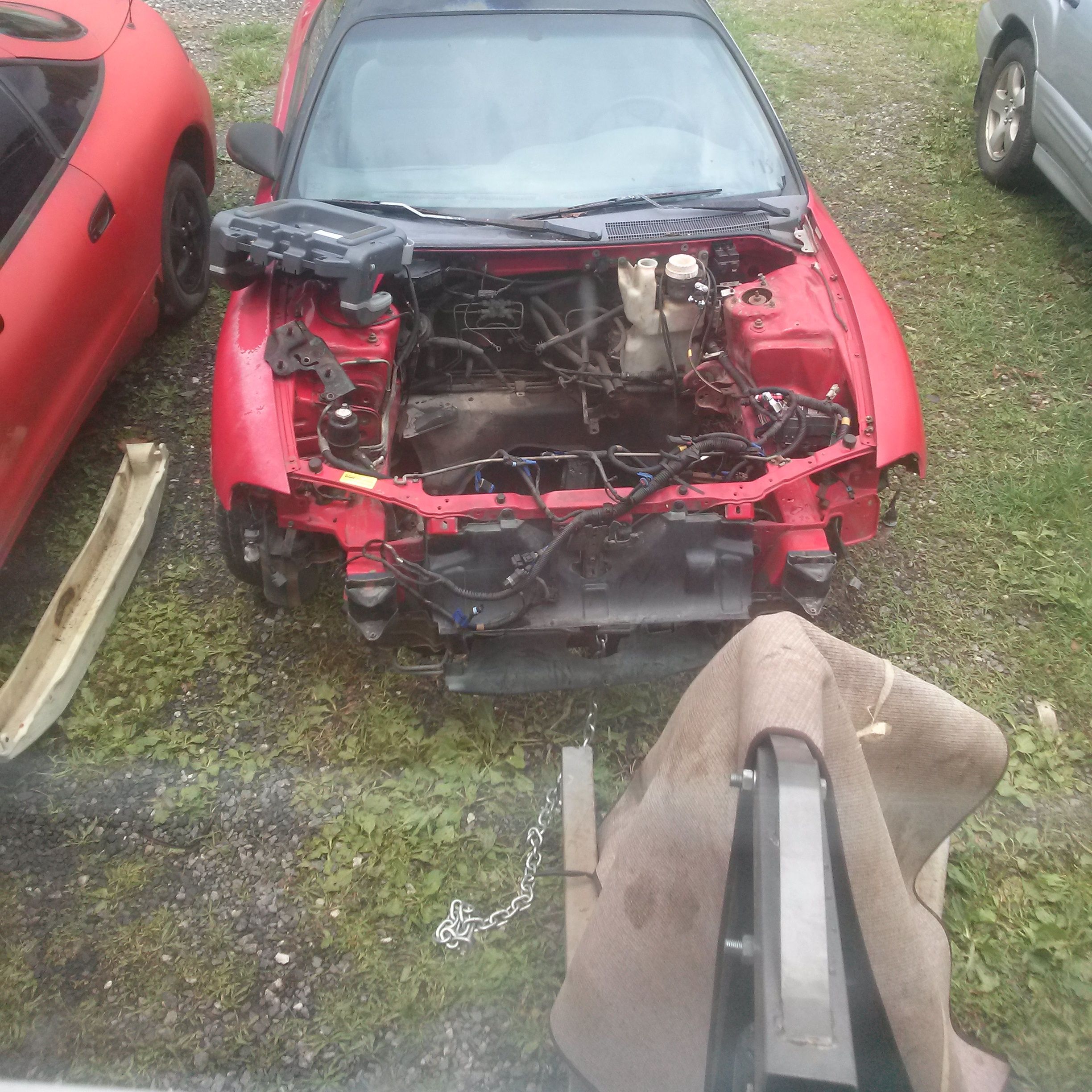

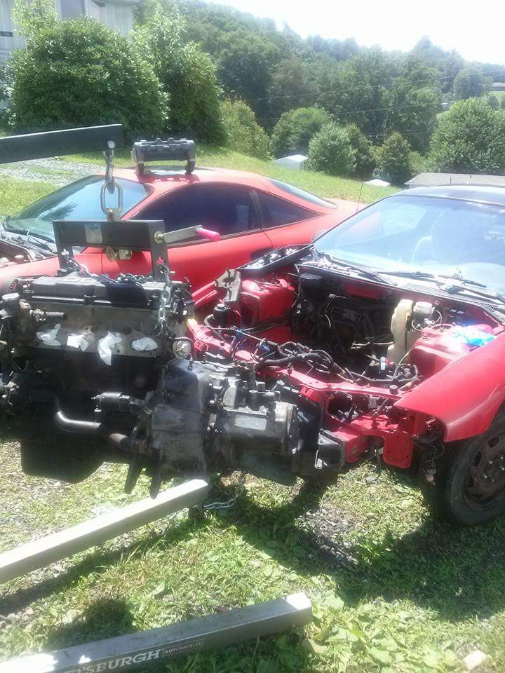

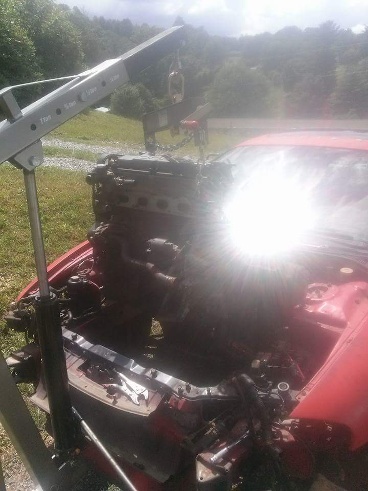

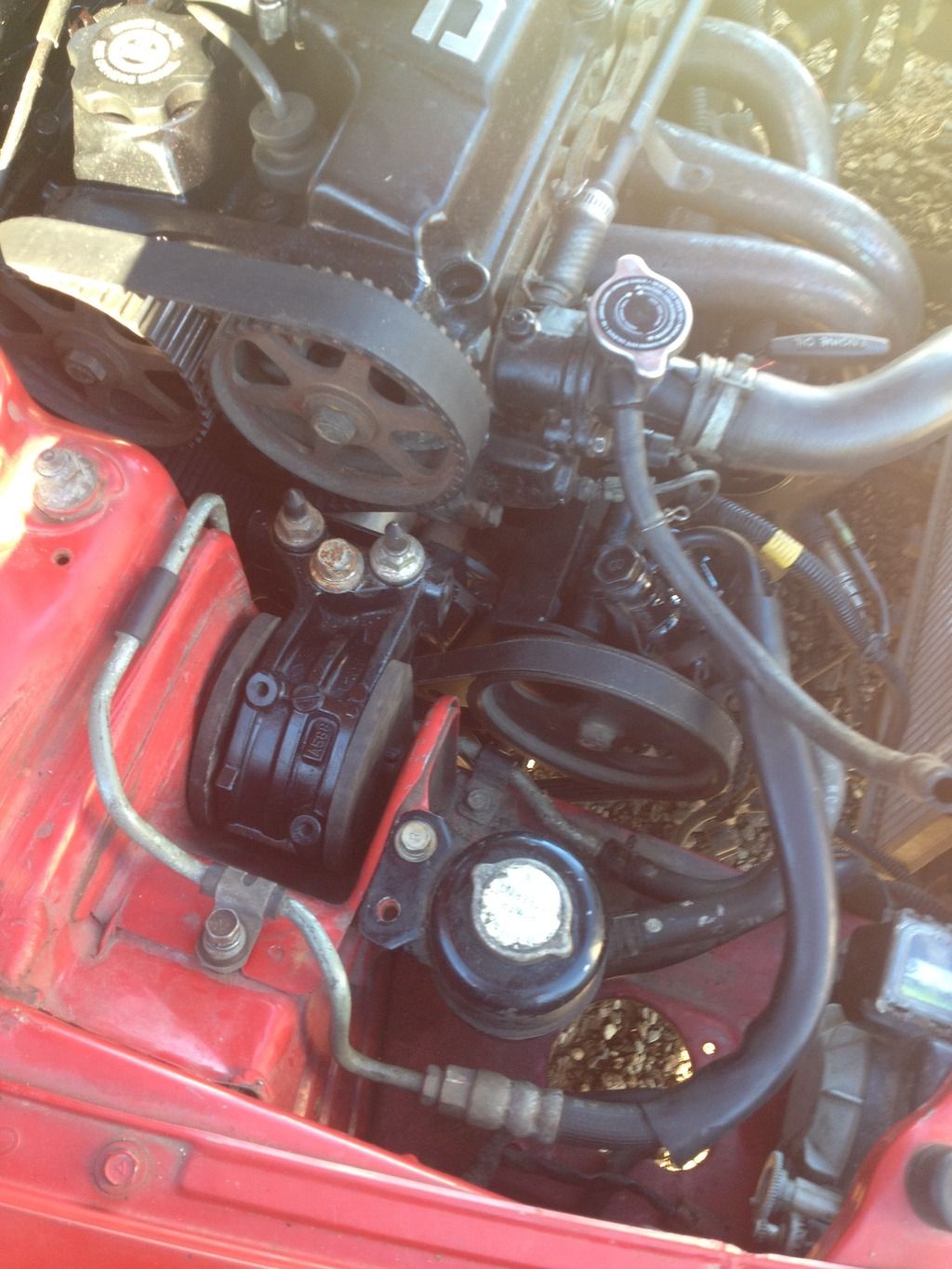

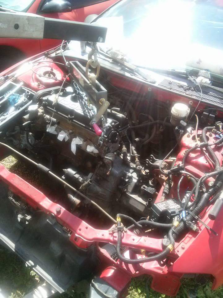

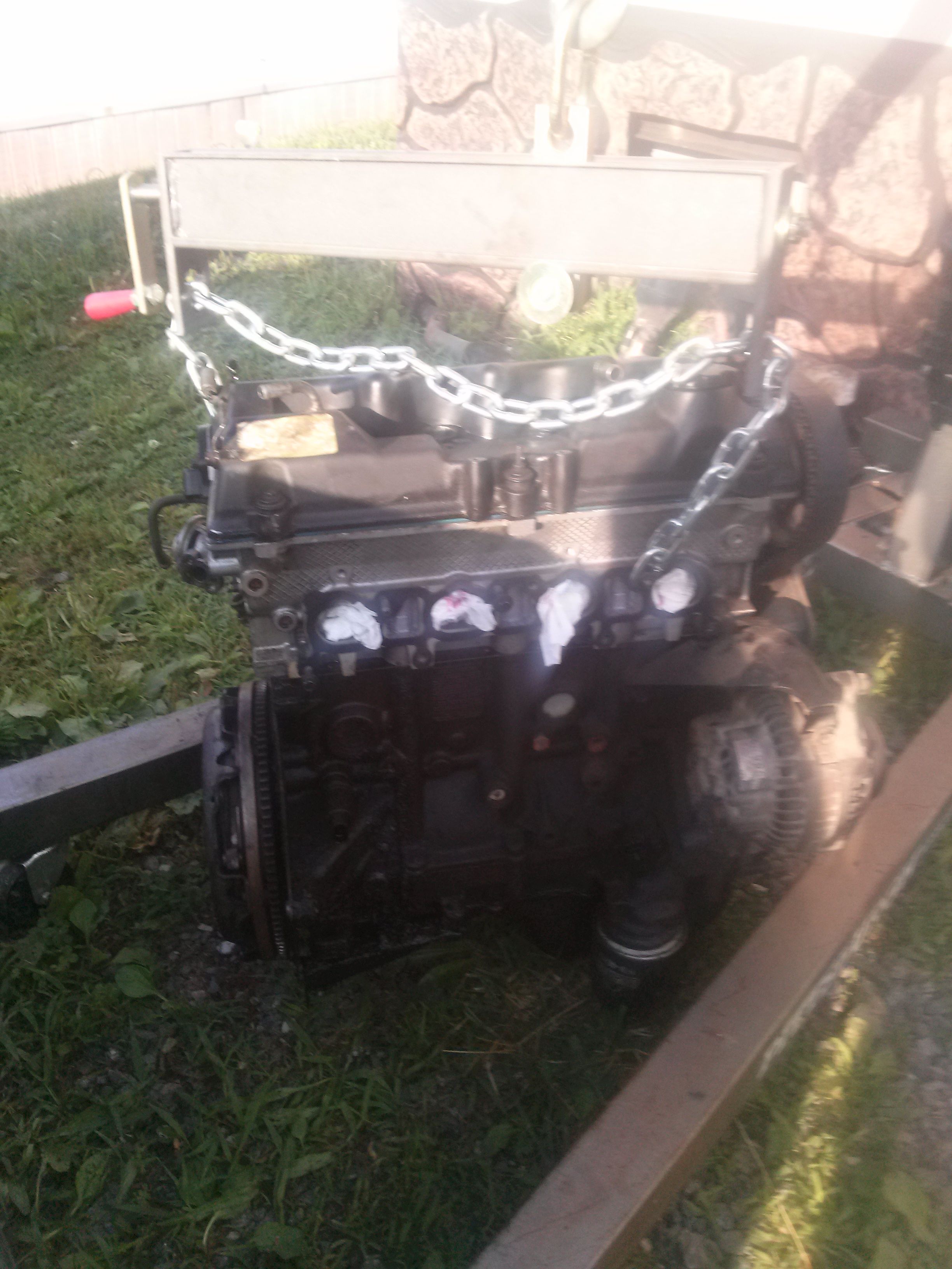

Well FINALLY got all my cards together and started to pull the motor this week out of the Rustbucket.
When I first got the Talon home, I didn't even think of needing to have it turned the other way around for the motor swap, so yesterday with help from my dad's truck again we turned it around, and got it lined up for the motor to go in.
Before anyone says anything, YES I know the engine hoist is on wheels.
But 500lbs of weight tends to make moving it around on gravel next to impossible, so we found it easier to move the shells than the hoist.
Sadly no sooner did we get the Talon to this point, it started to pour rain, so we called it a day.
(working third) when I get off in the morning I will get the motor hoisted up, and we will get the shell rolled up and the motor mounted up and I can finally begin to get the Talon resurrected.

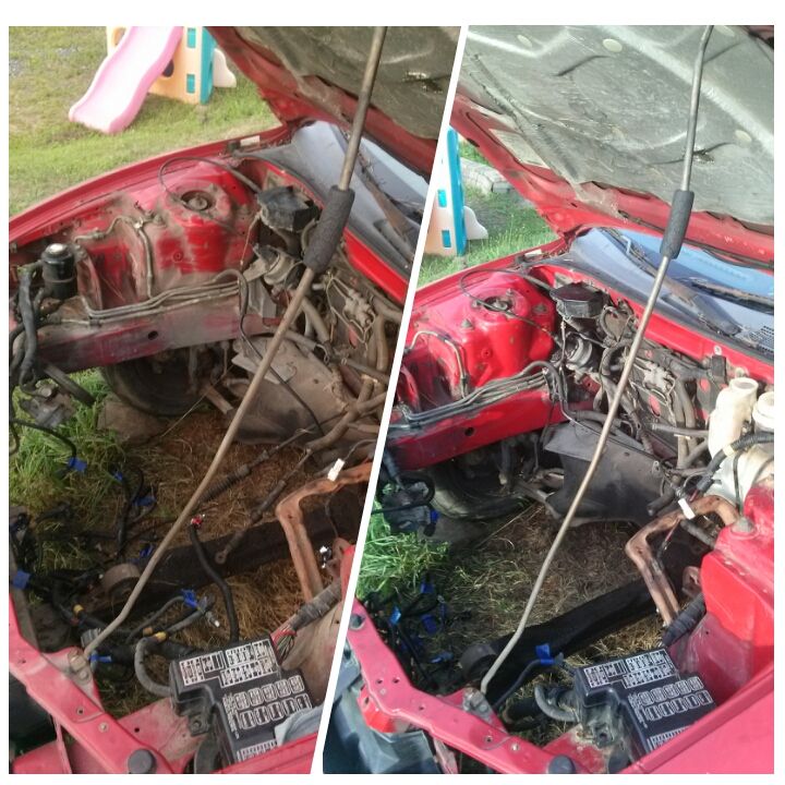

While the Talon has been sitting, got a few things done in prep for the motor swap.

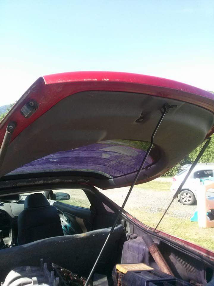

Found the missing hatch panels
(Hatch area has been used as a temporary storage area up to this point)

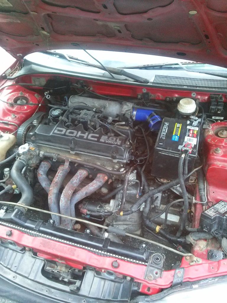

Cleaned up the engine bay a little

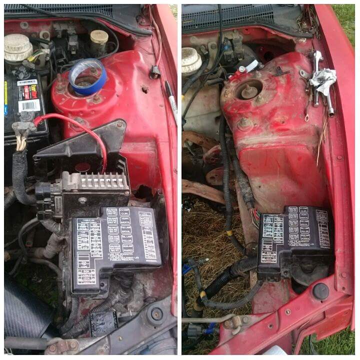

And relocated the ECU to under the fender, I know its not a full tuck(Fusebox is still visible), but it looks better than the stock set up.
I plan on making some raised brackets using the stock mounting holes to secure the fusebox so it doesn't bounce around.
*before picture is of the eclipse*
Once the motor is mounted in the bay, I will rerun the engine bay wiring into my own harnesses and tuck/hide as much of it as I can.

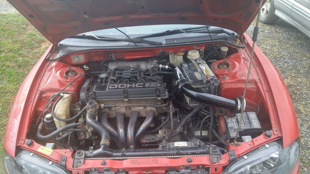

Well managed to get the motor bolted into the Talon today, and that was all I had time for.
Sadly probably wont be able to work any on it tomorrow due to work, but Tuesday-Friday evening I'm off and will be hopefully getting it on the road.
Here are some OH so exciting photos from today.
Tuesday going to spend the day breaking down the engine harness and making my own so I can run the wires out of sight where possible.

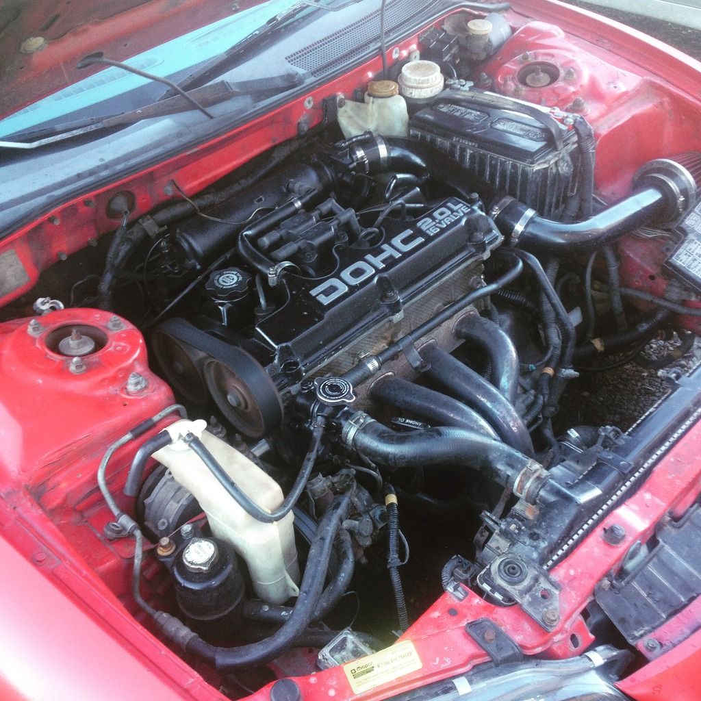

Well the Talon is running, has a bad misfire underload, but it is running at last.
Didn't take a whole bunch of pictures of wiring it up, and getting it all bolted in, but did wanna show the condition of the old throttle body.
Yummy.

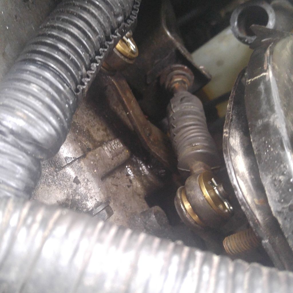

Only issue I had while getting it all back together was finding out one of the heater core hoses was bad.. so had to pull intake manifold off again and replace the hose.
Then the Cruise Control throttle cable kept getting stuck at whatever position the TB opened at, so swapped the non-Cruise Control cable over from the Eclipse till I can replace the CC cable.
But its running under its own power, and now to start the slow process of swapping over bumpers, interior, etc from the old shell before scrapping it out and getting the Talon cleaned up.

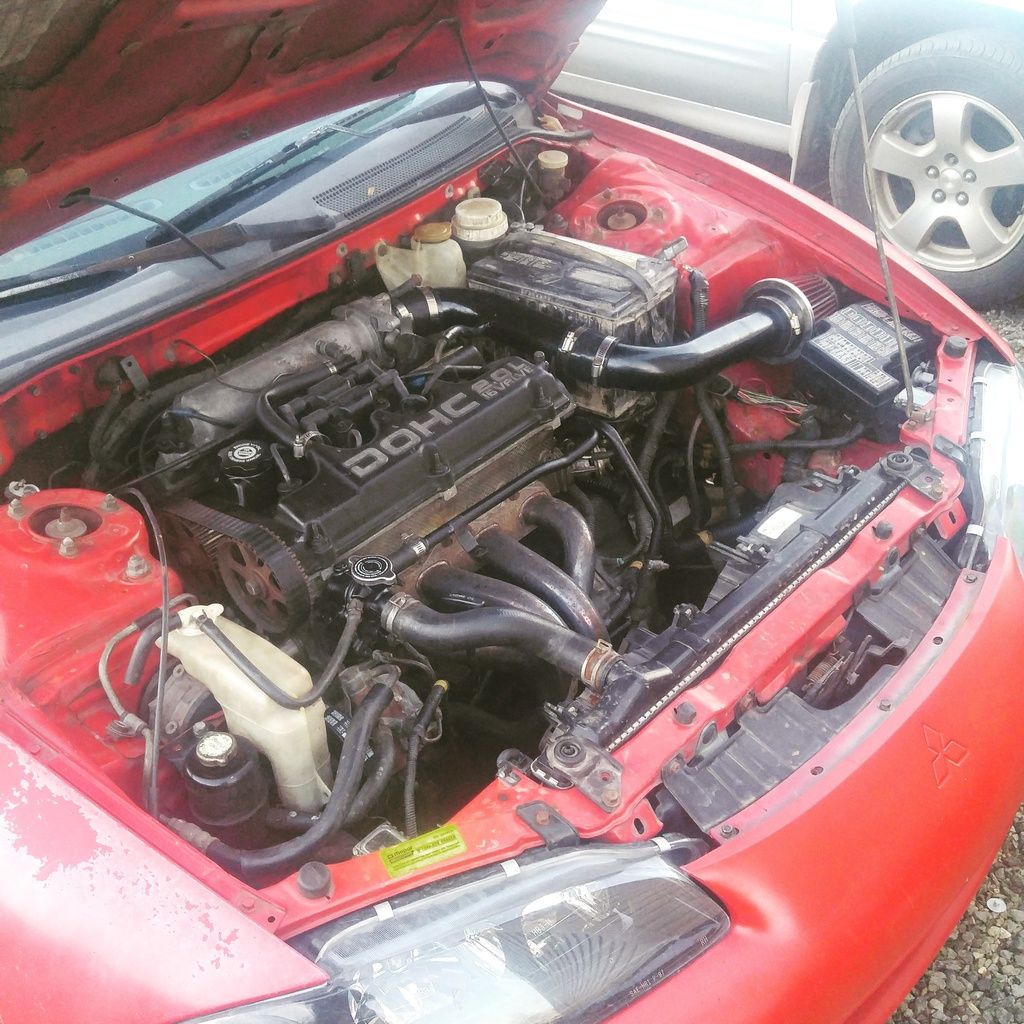

it does have a intake/filter, just wasn't on in this picture.
Well the biggest accomplishment was solving the misfire issue.
Seems it was a combination of bad/stale gas and spark plugs.
Not sure if it was just because they were worn a little, or because they were Autolite, and not NGK.
But the misfire is gone and runs like a champ now.

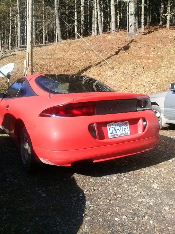

Also got the 2Ga rear bumper swapped over, and the 2Gb front bumper put back on.

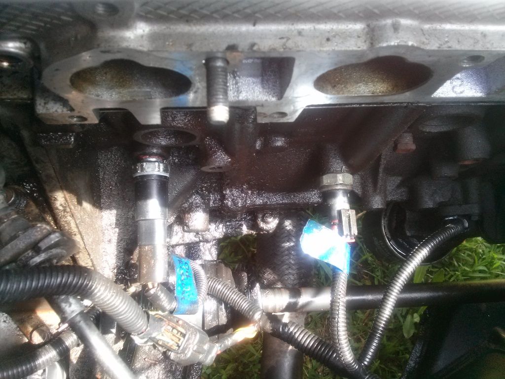

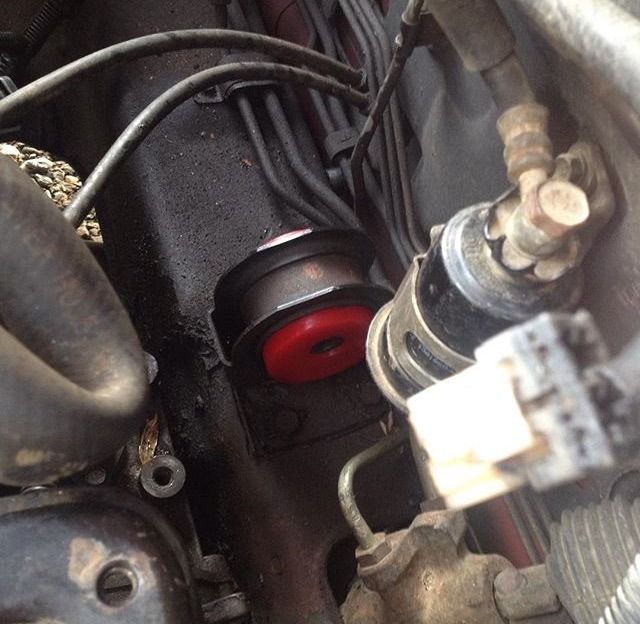

Shortly after taking the previous photos(like the next morning) I discovered a bad oil leak from behind the block.
Turned out to be the oil pressure switch.
So I replaced that, along with the knock sensor and replaced the CPS gasket and all 8 valve cover bolt seals.

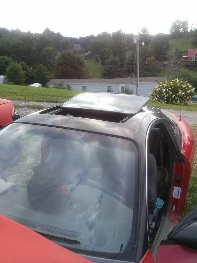

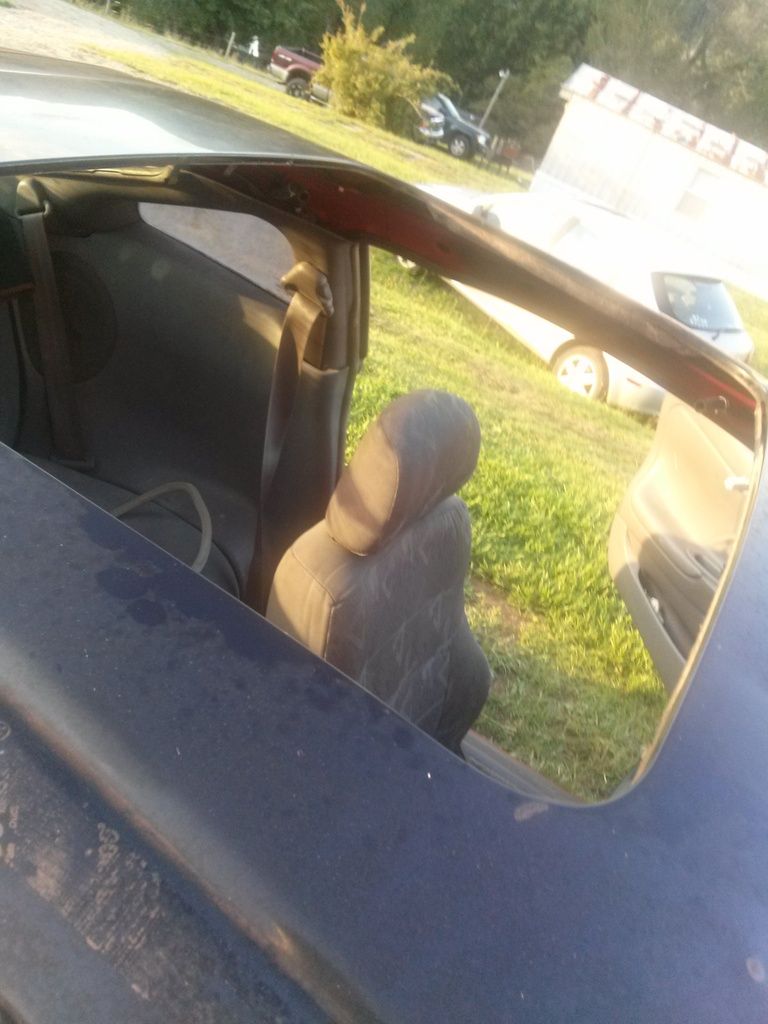

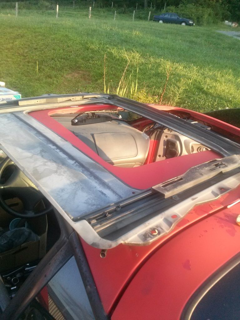

Next small project was swapping the sunroof assembly from the Eclipse into the Talon.
Took all of about an hour, much easier job then I expected.
Old one out.
Eclipse assembly ready to go into the Talon...
And finally a working sunroof again.

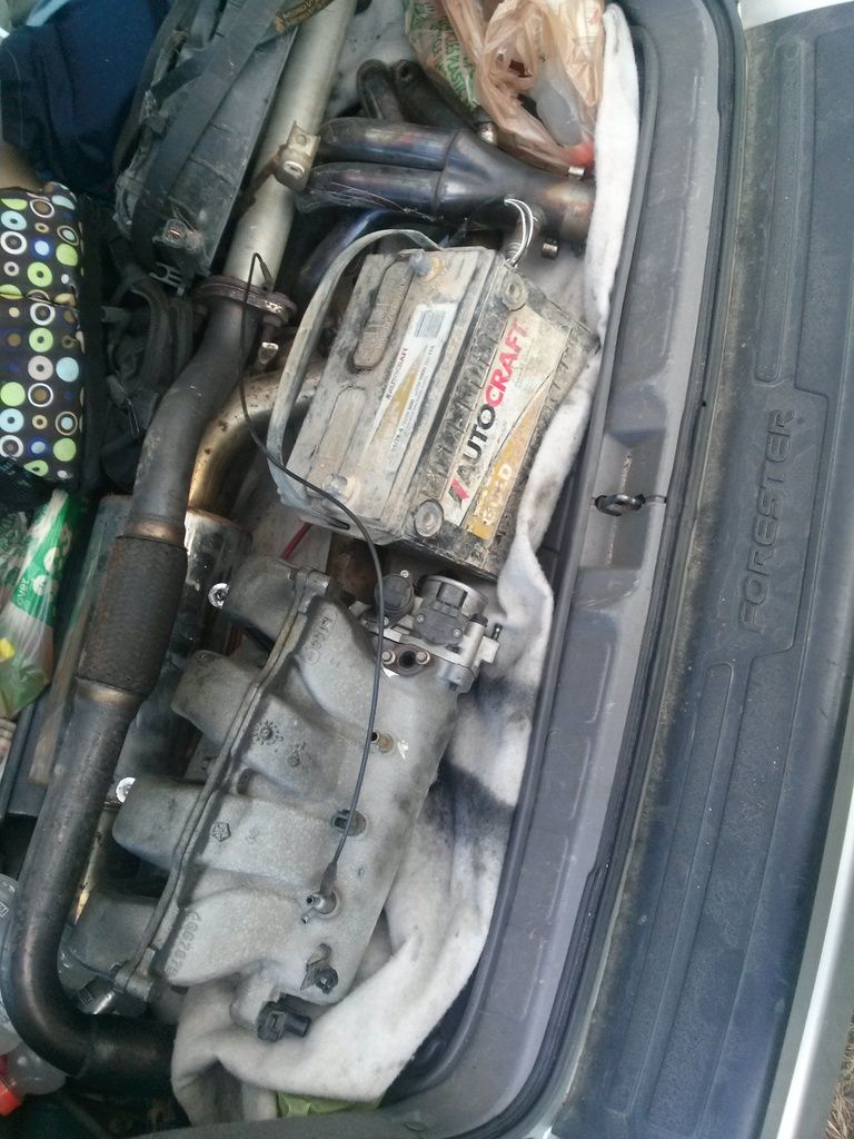

Thanks to a local DSM-er on a 420a Facebook page I went and picked up several goodies
Including;
-Complete(ebay) header to muffler(Spec-D) with a test pipe in place of the cat
-Left radiator fan
-Center Console cup holder/ash tray parts
-Rear wiper motor(turns out the wiper arm needs replacing as well)
-Needed a TPS, walked away with an entire low mileage intake manifold - gonna clean it up, paint it and swap it over

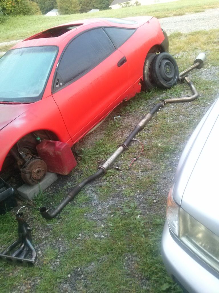

The exhaust, which I hoped to be a bolt on affair, is turning out to be a head ache as the previous owner had a universal muffler welded on and looks like completely removed the stock hangers.
As well as cut the bushings for the cat rubber hangers off, luckily I had these on the eclipse still.
Hopefully the cat back piping up to the muffler will still be stock and all I'll have to get welded on is the muffler.

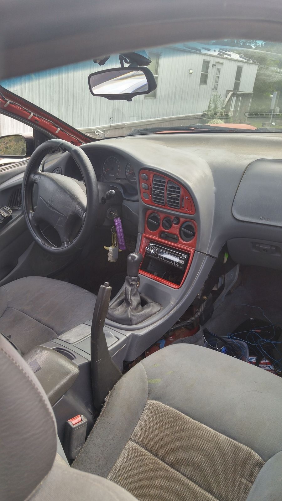

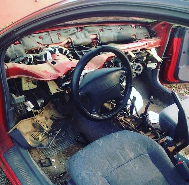

After this I started getting the last few interior parts pulled out of the eclipse for the Talon, carpet and dash along with a few interior panels I swapped over.

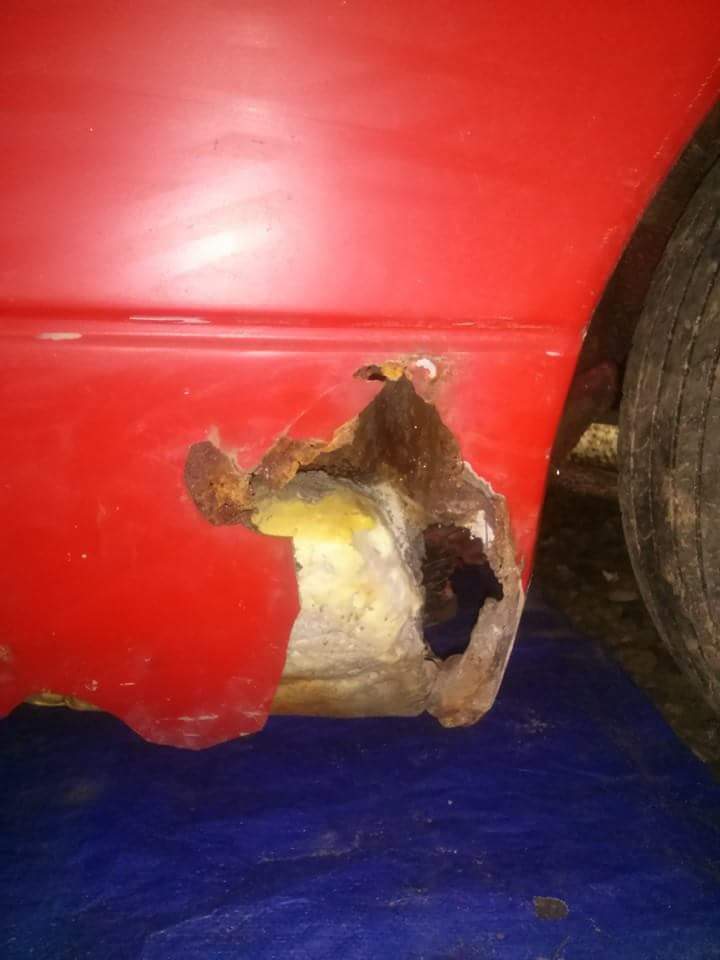

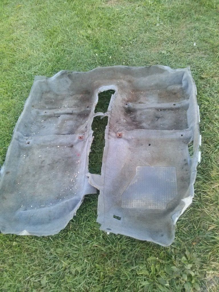

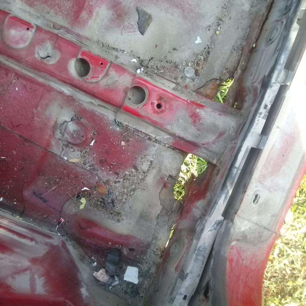

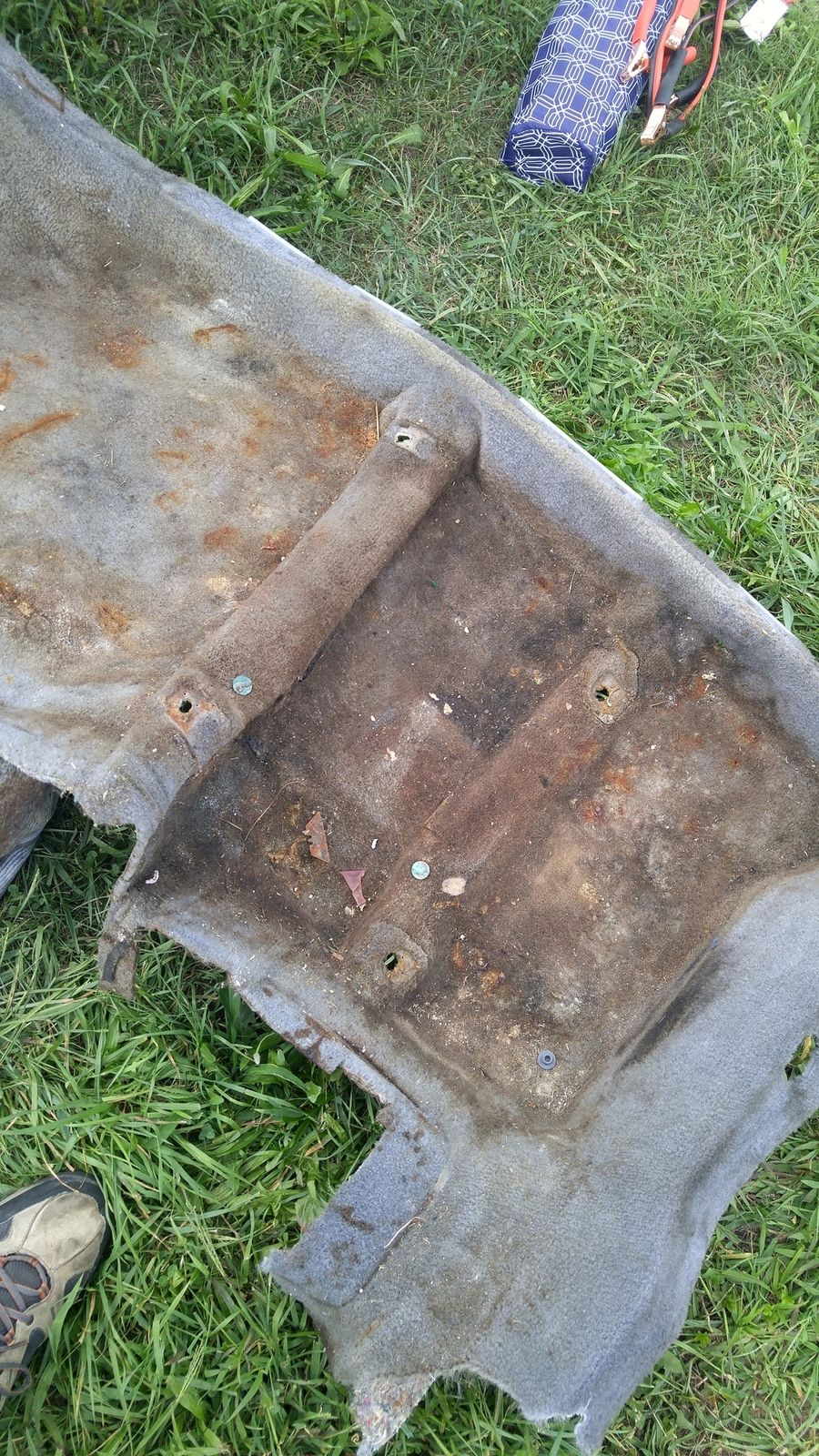

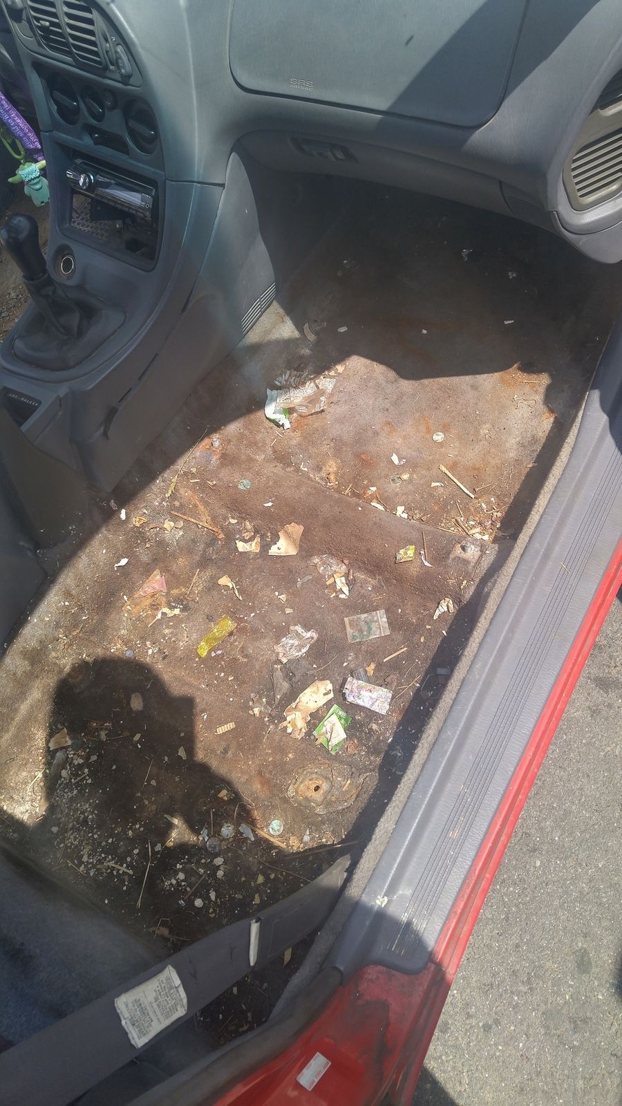

After pulling carpet out I found this in the junk car(eclipse)
This pile of rust just gets worse every time I take something off -_- so glad I got a new shell.
The carpet isn't perfect, but SO much nicer than the ripped, moldy and smelly carpet that was in the Talon.
Compared to what came out.

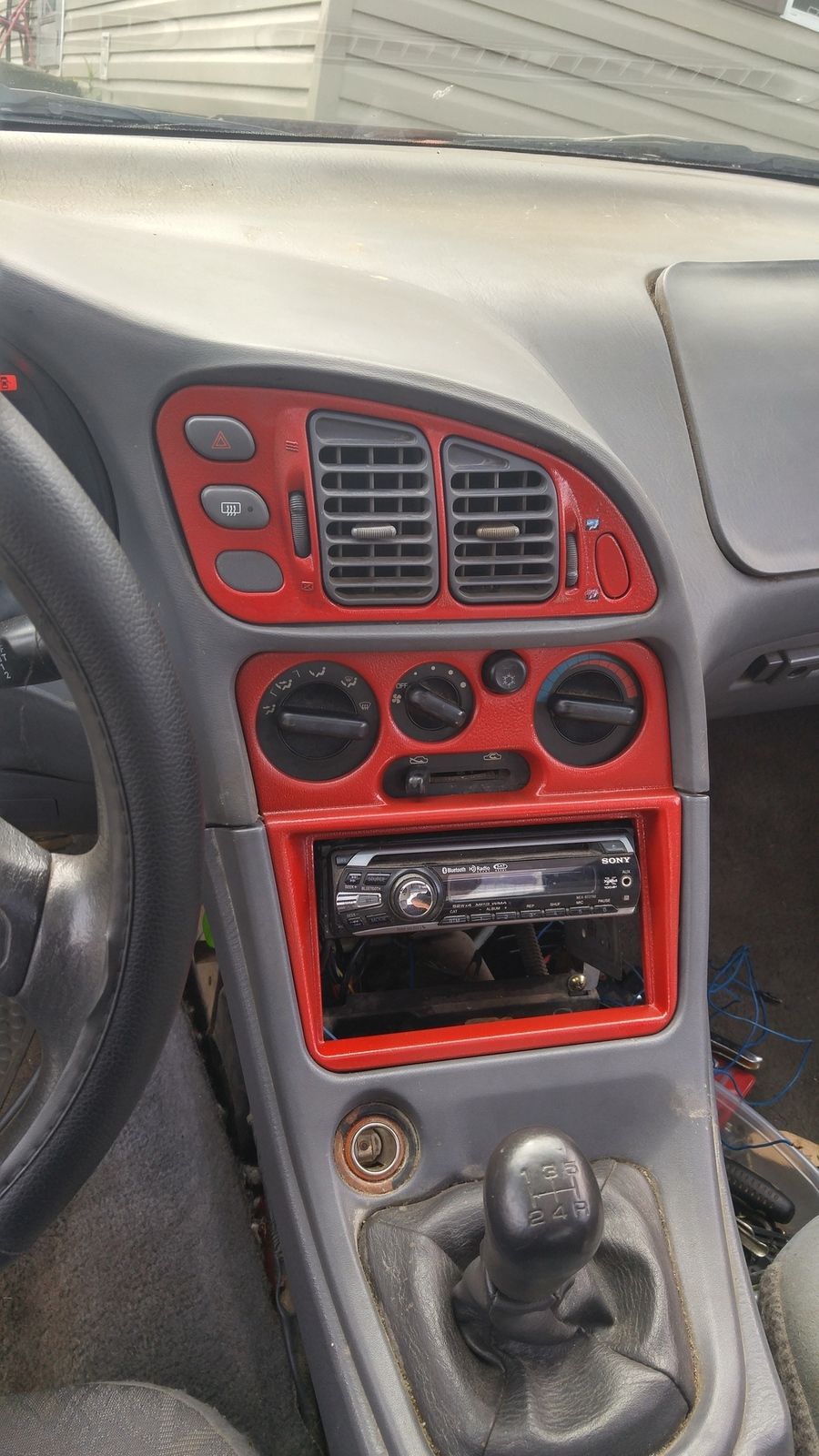

Finally got around to replacing the factory tape deck with my aftermarket headunit, and decided to add a little "rice" by painting the radio and hvac bezels body color.

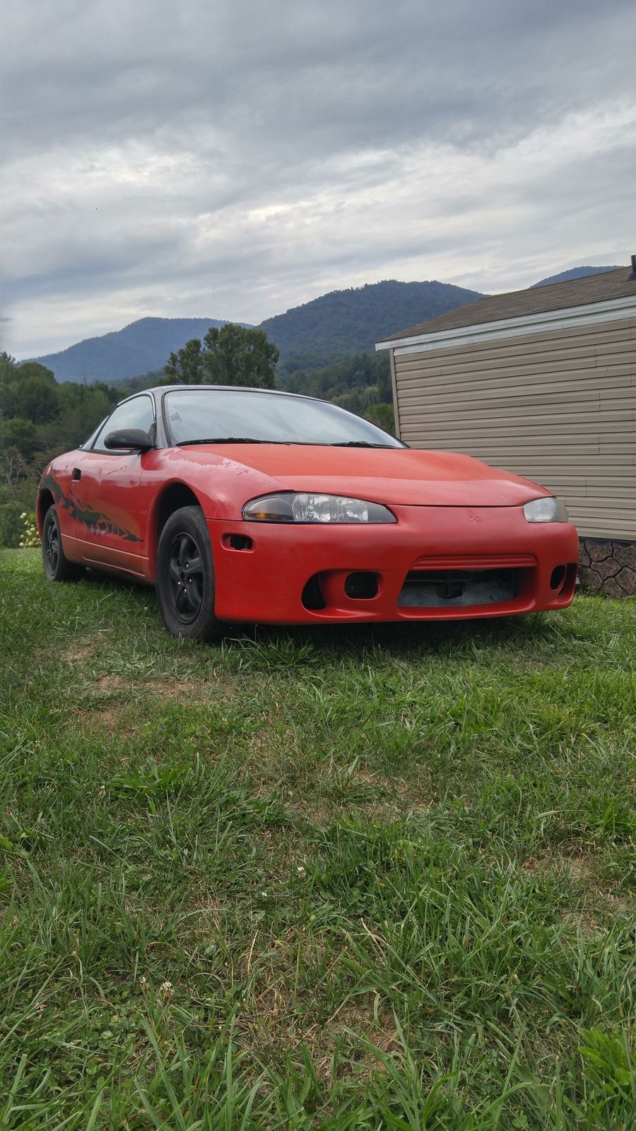

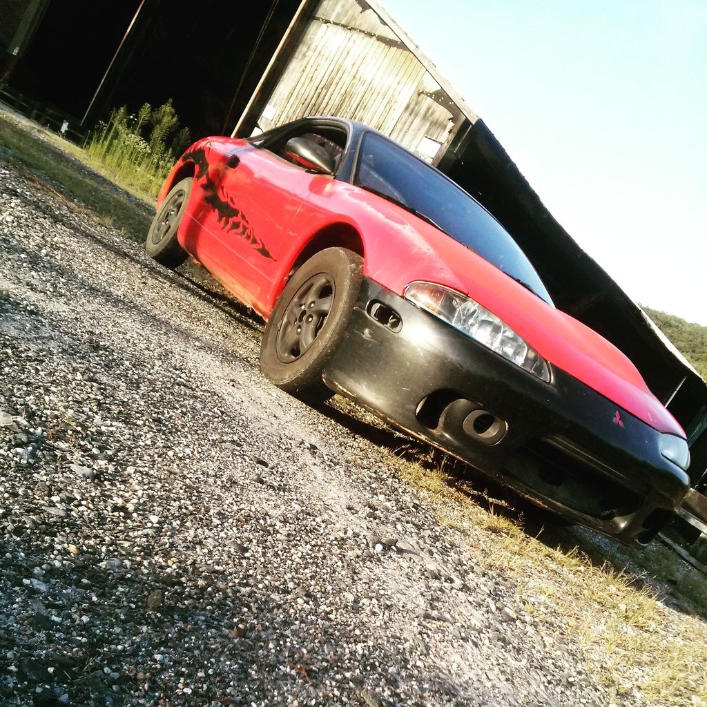

Next big project was to paint the black front bumper.
I sanded it down, primered it and then sanded again and painted it.
its not a perfect color match, but its VERY close.
Probably gonna end up re-painting the entire car this color once I deal with those decals.
Its slowly starting to come together at last.

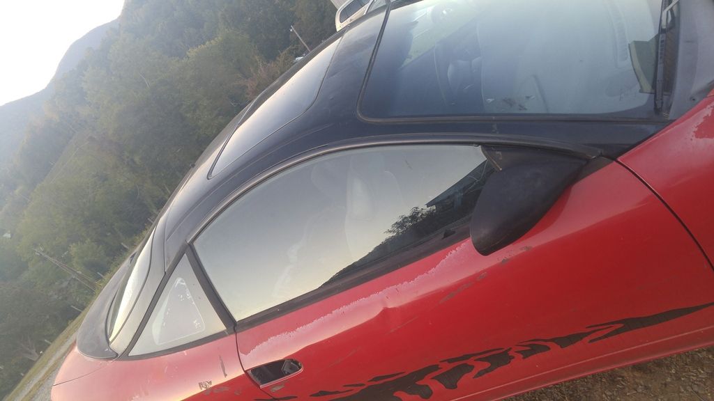

Decided to use the doors off the Eclipse, while I'll be trading power for manual windows(personally I prefer manual) it will solve several issues;
-Door handles arent broken
-no decal to deal with
-speakers aren't blown
-Windows are tinted
-Weather stripping around windows aren't cracked and broken

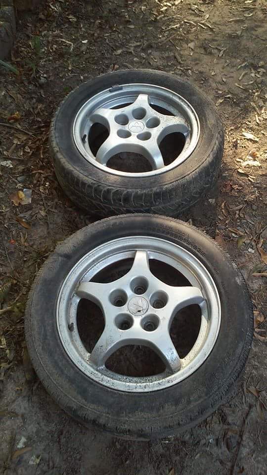

But I have picked up the GS rims, test fitted them and love them.

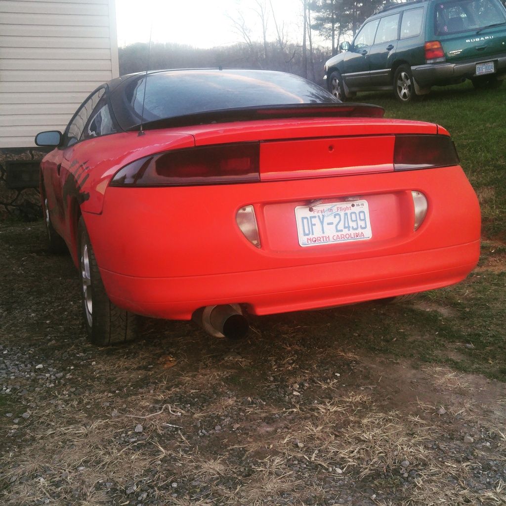

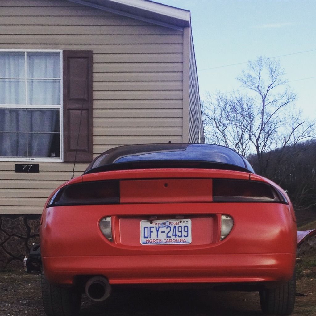

Well managed to get a few things done finally.

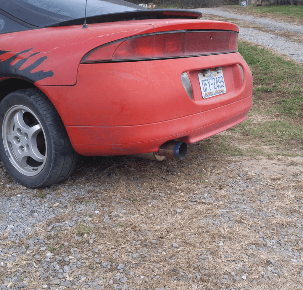

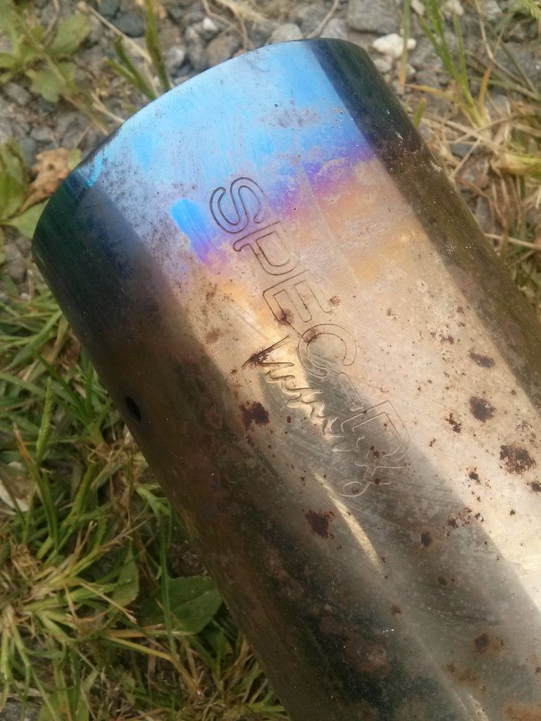

Exhaust is now completely hooked up and sounds pretty good.
I need to take some video of the exhaust and put it up.
But here is the muffler... needs a little adjustment.

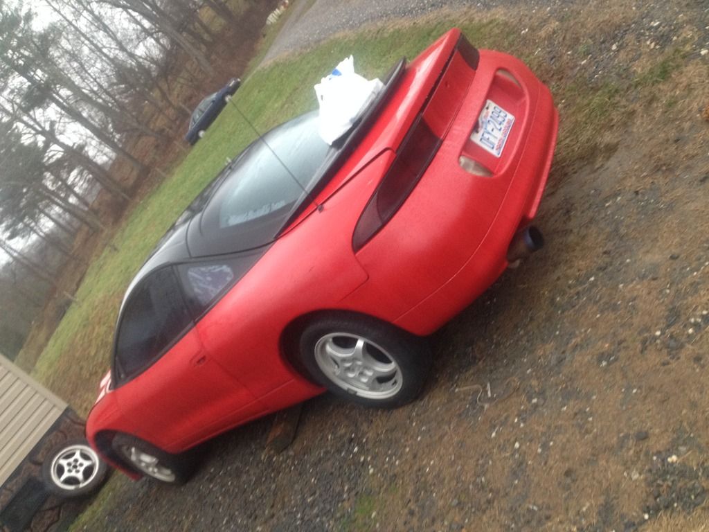

Obviously the GS-T rims are finally on for good.
Also got the RS doors swapped over, only stupid decal left is on the rear quarter panels.

Finally replaced the nasty make shift intake the previous owner cobbled together with a proper CAI.
Going to give a few parts on the motor some fresh black paint in the next few weeks, mainly the thermostat housing and heater core hardlines and intake manifold while I have tem removed to replace heater core(and hoses) and thermostat.
Also on the way are brass solid shifter cable bushings and front/rear urethane transmission inserts.

Not mentioned before is I gotta get a new battery for the wife's Subaru as she's using my mini battery as this one won't hold a charge but I can roll my car off where her automatic won't roll off.
Once I get my battery back the intake won't be so crammed in there.

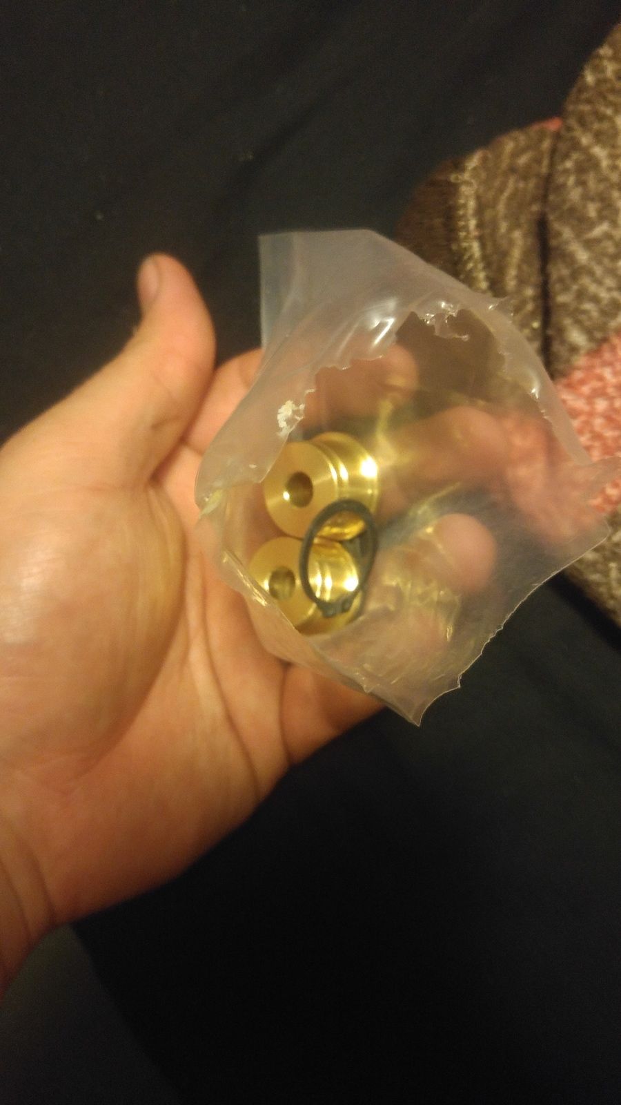

Well these arrived while I was at work tonight.
Can't wait to install them tomorrow.
Solid brass shifter cable bushings.
Also swapped to my blacked out factory tails, and finally re-wired the tail light harnesses so they work properly with the eclipse tails(it's a Talon shell).
So now the inner two bulbs function as running lights and brake lights, while the outer bulb is strictly a turn signal.
I tried using the harness from the eclipse tail lights but when I turned on the blinkers, the dash lights blinked too. So I spliced over the proper bulb connectors and not only do they work right but I can use the tail light interior cover pieces again. Woot.
Tomorrow hopefully my Energy transmission inserts will be here.
Also had an issue with the cold air intake knocking against the frame and making an awful racket. And didn't wanna take a chance of hydro locking the motor as the road coming up to our trailer floods at the slightest amount of rain, I trimmed the intake so it sits where the ecu used to be.

Not a whole lot was accomplished this week sadly, did get the brass shifter bushings installed though.
While obviously they didn't improve how fast the shifting happens, it's a lot smoother shifting and especially shifting quicker each gear is much easier to locate and doesn't feel "sloppy" in neutral.

Well got a few small projects done today.
Added 5mm spacers to the rear wheels, fronts never bothered me but the gears are just too far sunk in for my tastes.
And once the Talon is lowered it'll really make a difference.
Painted the panel between the tail lights, seen it done a few times and loved the look.
While not a huge improvement, painted the thermostat housing and heater core hardlines.
Now if I could just replace that battery... Such an eye sore.

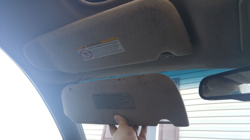

But did grab a 3G sunvisor to test fit it.
Love it, much larger.
will grab the passenger side Next time.

Also got the rear bumper painted at long last.
Got the decals on the quarter panels dealt with... for now. will be completely removed next summer when the whole car gets repainted.

Heater core died a few months ago, never was an issue until the sudden cold weather we had.
So replaced it.
Managed to break the plastic radio bracket when pulling the Talon's dash, but was able to clean up the eclipse dash I saved(forgot I did).
Even looked better in the end.

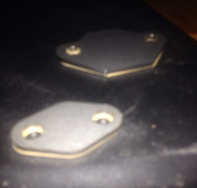

While I had the intake manifold and related parts removed to access the core lines, intake/valve cover/few other parts were painted black.
front/rear urethane bushings were installed along with EGR delete plates.
More recently the water pump decided it didn't wanna push water anymore...
Also removed the rest of the EVAP system.
So i replaced it along with the timing belt.
And the old belt was a lot worse than I thought it was.
And the pump.
And since I had the power steering pump/bracket and motor mount/bracket off... they got painted as well.
