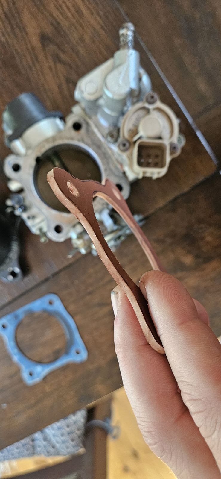

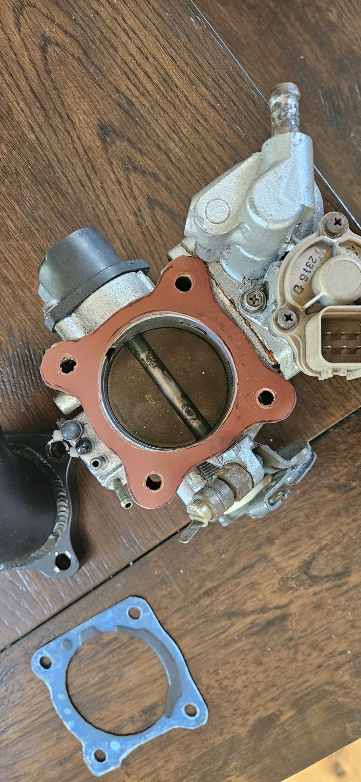

The throttle body was still bothering me, so I did something I vowed to never do and raided one of my other cars. This TB is a turbo unit that I rebuilt and worked perfectly. Installing that will be todays task. Last night I cut gaskets for it. Some things never change as I went back to my roots with Home Depot Racing. If you go to the plumbing section, there are 6"x6" squares of this rubber that I have been using for various gaskets for many years. This makes OEM gaskets look like a sheet of paper.

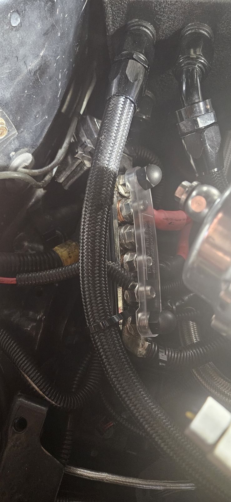

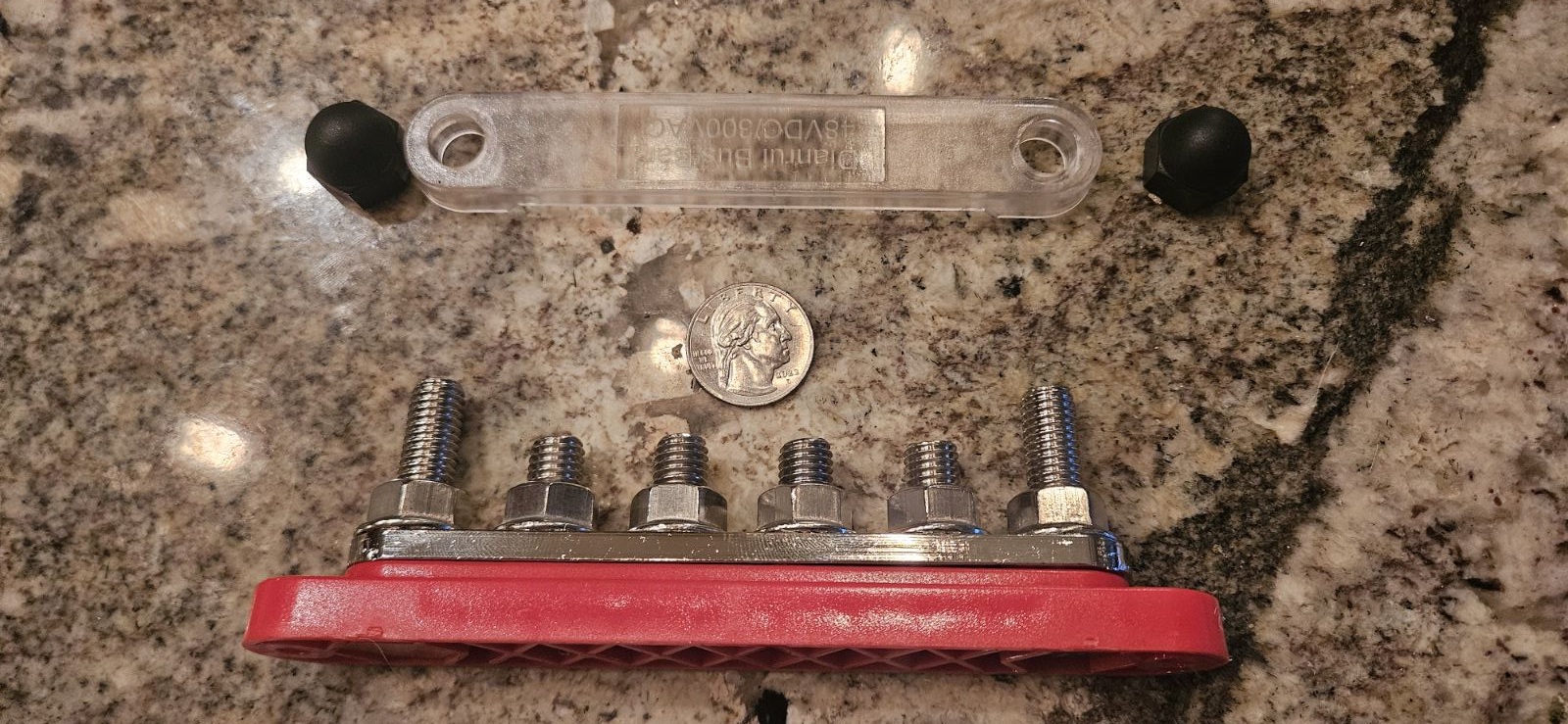

There was one spot that I wouldn't call bad or wrong, but room for improvement. It's the positive connection point where the positive terminal of the battery used to live in the engine bay. Today I put in a distribution block, this thing is oversized to say the least. It's firmly in place on it's own just by the nature of the wires attached, but I did a zip tie for peace of mind. This winter I'll be making a proper bracket for it.

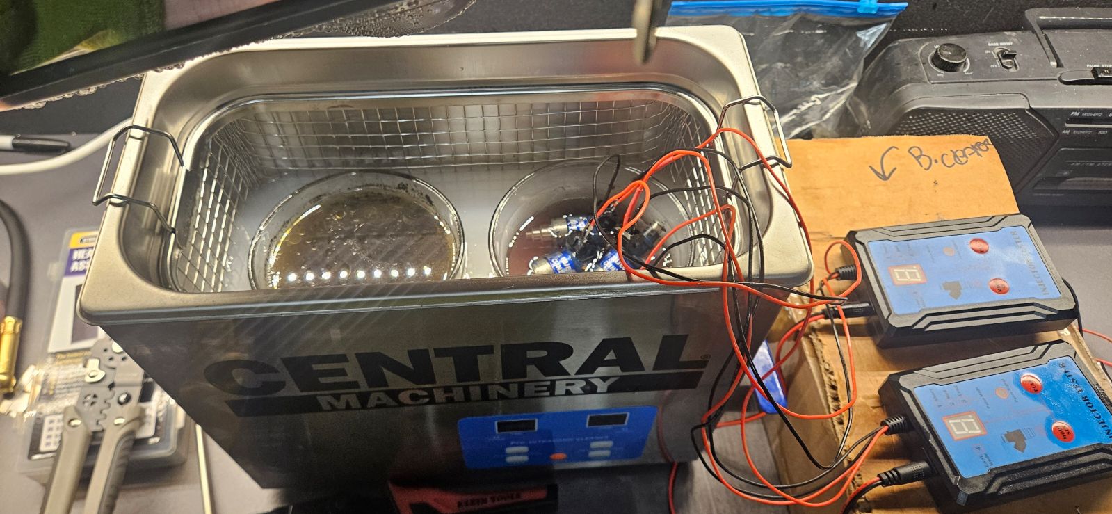

It became very obvious the injectors where giving me a ton of grief, I could see it diminish each time I tried to start the car. I had a theory the injectors were not fully closing, dumping all the fuel in the rail into the head after shutdown making it a bi*** to start and who knows what other issues go along with that once it is running.
I pulled the 2150s out and there was zero fuel coming out of the rail when I pulled it apart. I put in another set of 2150s that I've been hoarding for a few years, but these turned out to be completely gunked shut so I walked away from the car for quite some time out of frustration. When I did go back and pull the injectors out a TON of fuel came out of the rail, so that did confirm my theory of the original 2150s not fully closing.
FIC and other places wanted about $25 per injector to clean. I guess that would be fine if I had only this car, but I have a few DSMs and multiple sets of injectors. I decided to try it myself. I bought a ultrasonic cleaner and 2 fuel injector pulser units. The injectors I put in glass bowls and filled the rest of the tub with water. After brining it up to a temp of 80c, I would turn the vibrating on the ultrasonic cleaner itself and at the same time toggle the pulser units to open and shut the injectors. The units are connected to a battery charger I set at 20amps and 30min timing along with the ultrasonic cleaner timed at 30min. It was pretty satisfyingly to have both shut off at the same time.

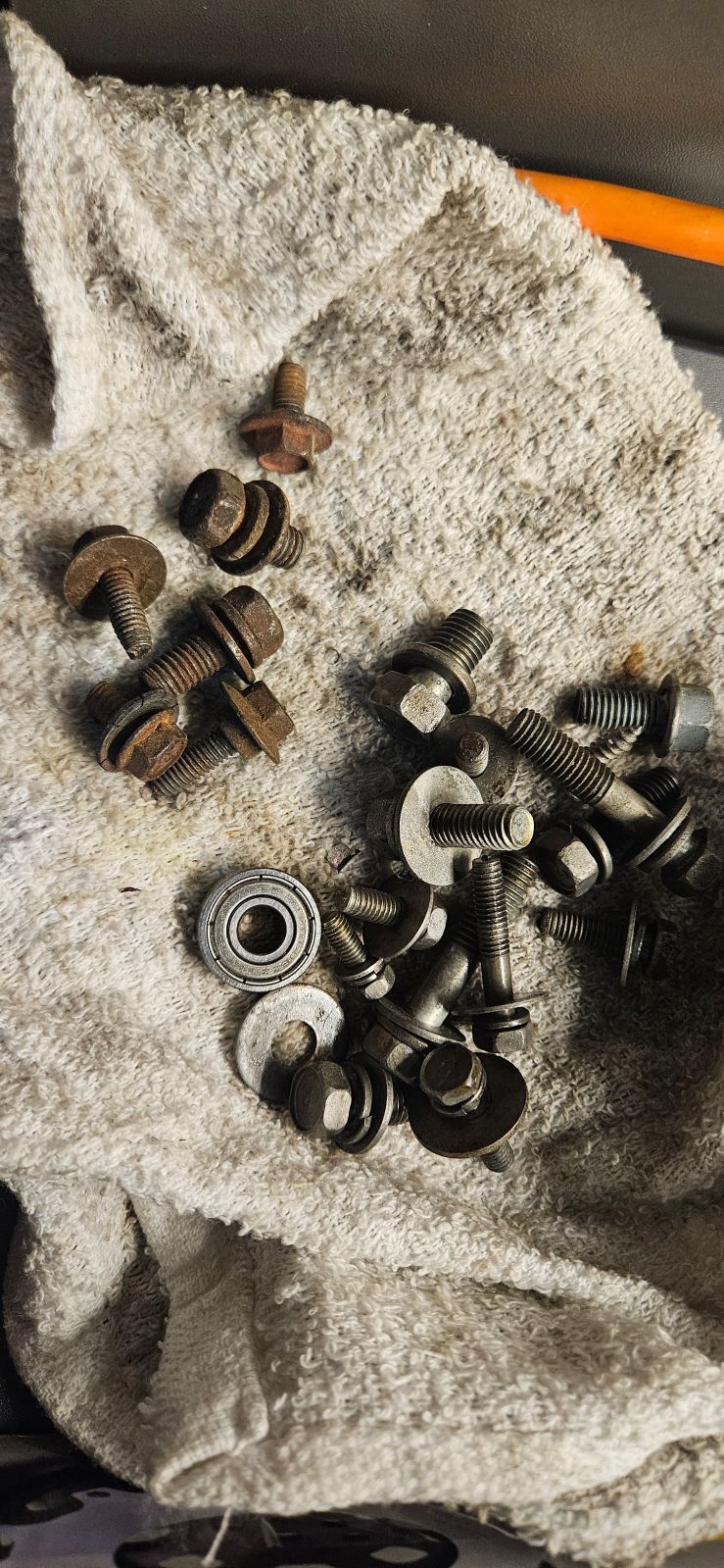

The injectors went through 4 stages of chemical for a total of 2 hours run time. The first round would be brake cleaner, followed by WD40, followed by Evapo-rust, then finally Lucas injector cleaner. I wasn't punctual with this process going immediately from one chemical to the next, the injectors did 'pickle' overnight for a couple of those rounds.
(1550s pictured with some nuts/bolts in the left bowl)
Before/after cleaning my bin of OEM nuts/bolts/etc
When I went to put my cleaned 2150s in, I noticed the wires on injector connectors were loose and a couple just slid right out of the plastic clips. This is a giant problem I'm glad I caught. Rather than epoxy the wires back into the clips I decided to be an adult and solder in some new pigtails.
Upon starting the car it fired up pretty easily, held idle great, and voltage was improved. The behavior of the car was very much so improved, driving it was very nice. Anything over ~1500rpm would give me 14v and at idle it would creep down to 13v at best. I think I can live with that for now. I have no interest in pulling the alternator out yet again to experiment with pulley sizes and I'm not interested in idling the car at 1500rpm.
I think I can take cleaning the injectors to another level by using a modified rail and fuel pump to actually push the cleaning fluid through the injector while toggling them to open and shut, but that's a project for this winter. As of now this cleaning method seems to be a success.

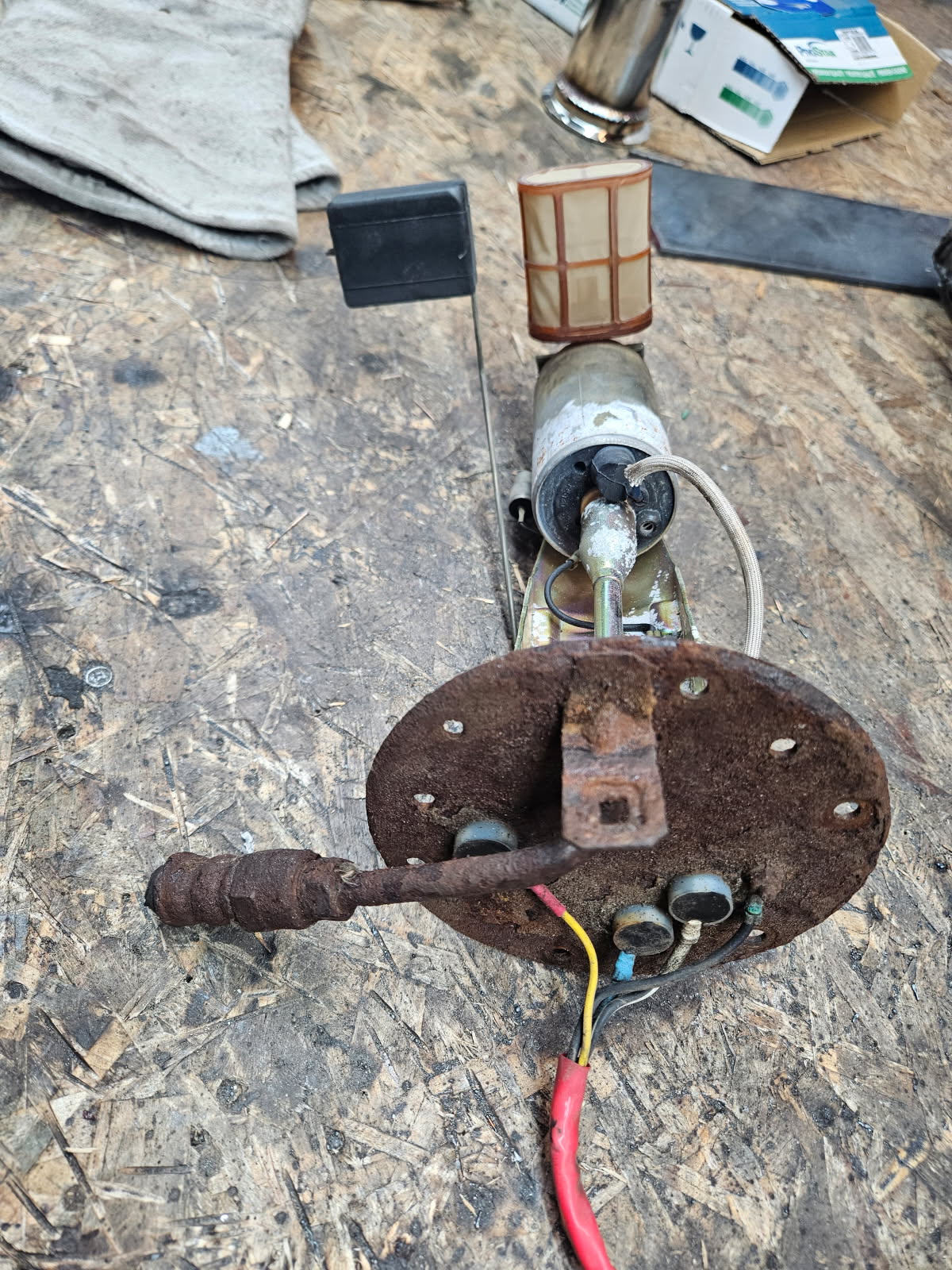

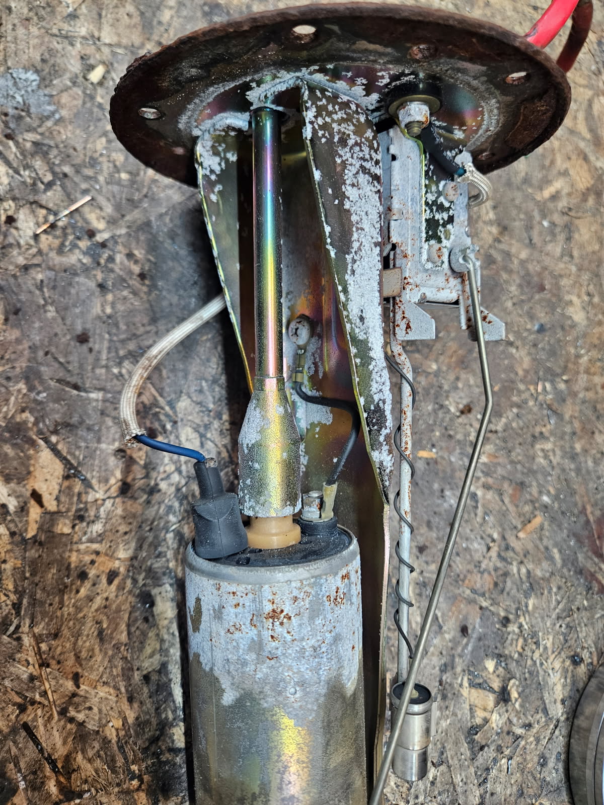

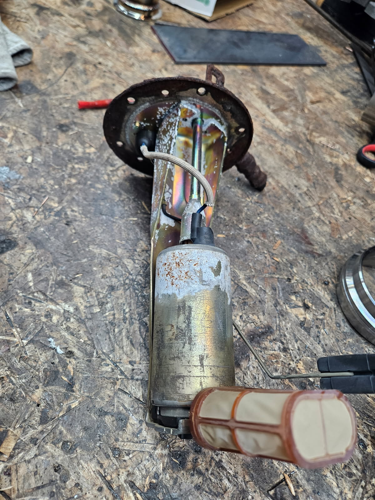

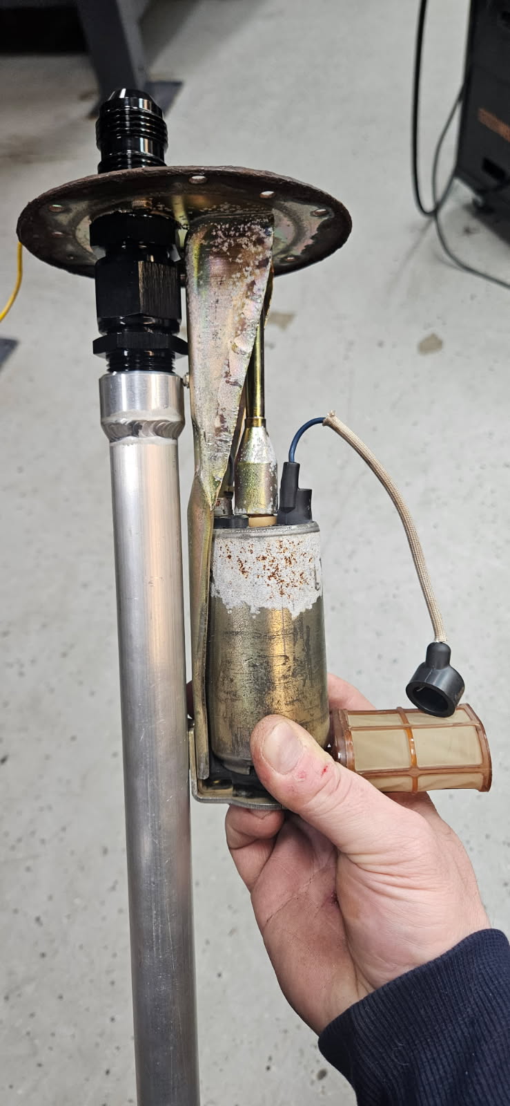

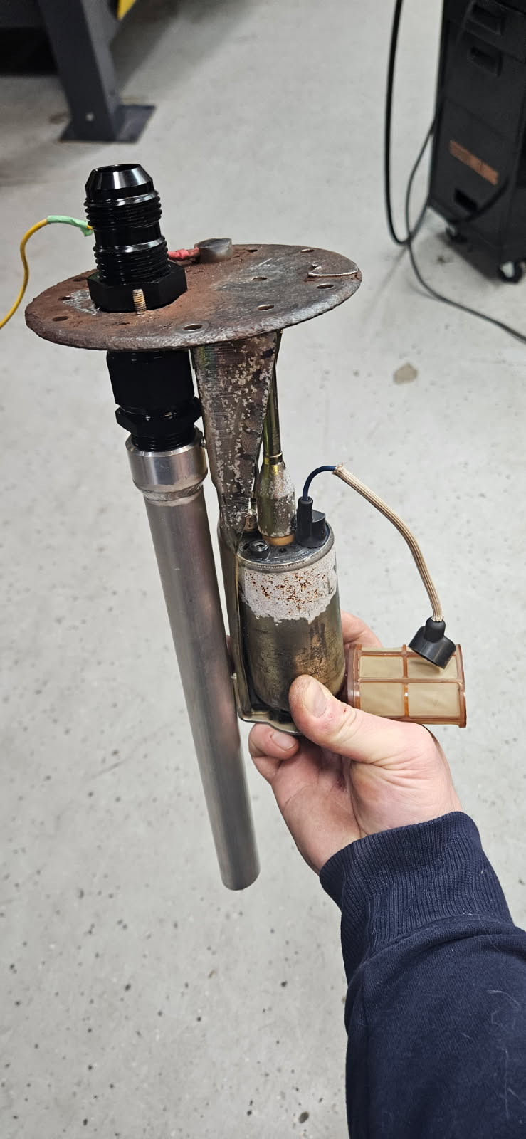

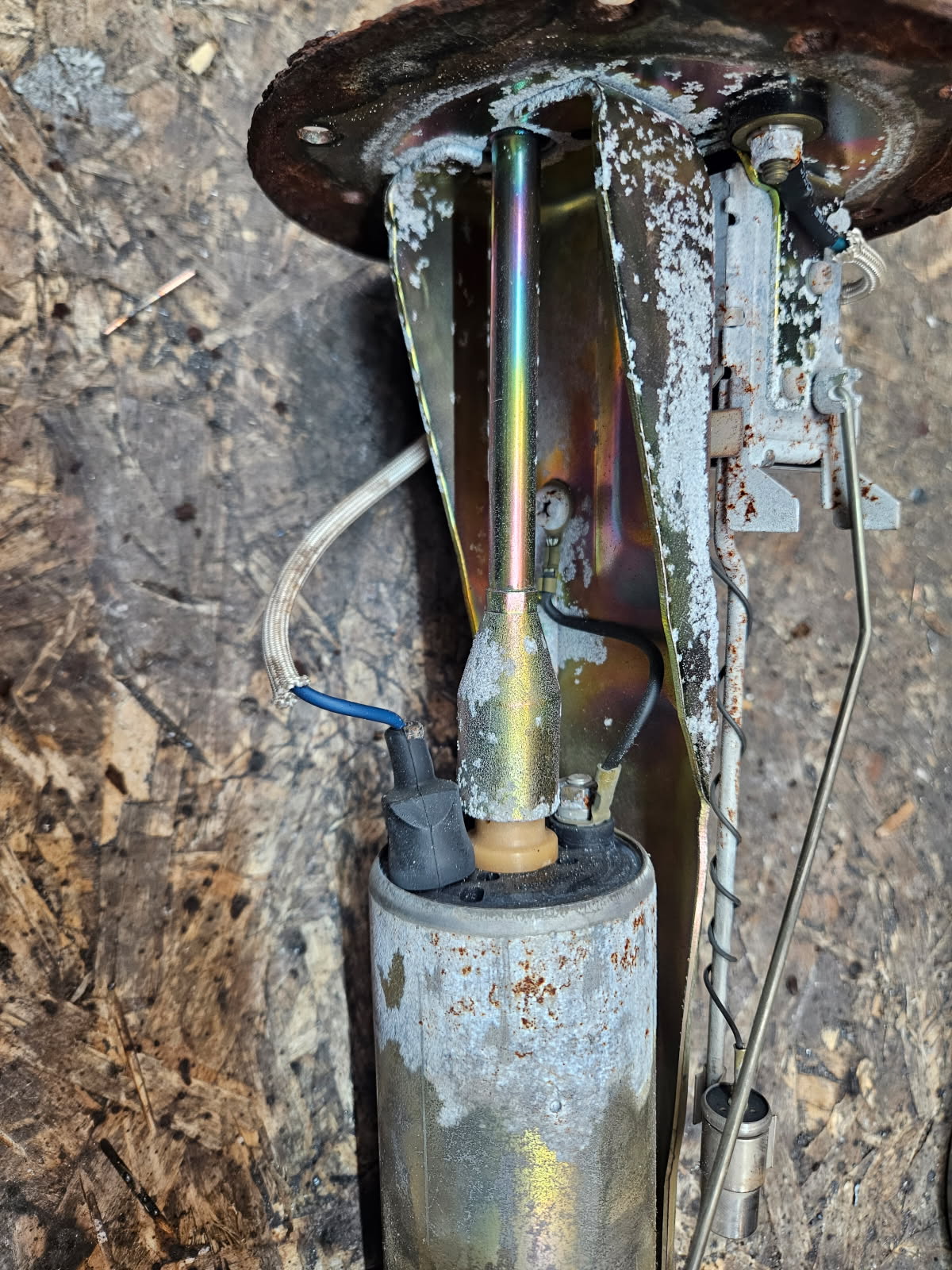

My new fuel setup will be as follows. A stock fuel pump hanger with a "stock" pump. Outside of the hanger this will go to a check valve and butt into a -10 T fitting. Next to the "stock" fuel pump will be a -12 pick up tube. It will exit the hanger to a Weldon 2345A pump, check valve, then to the straight through part of the -10 T fitting. Under normal operation the car will idle and cruise like any other DSM having a stock fuel pump or 190 or whatever I have. At ~5psi boost, the 2345A pump will kick on. I talked with Jim @ Weldon and he was a class act and verified my plan will work while giving some strict must do's and don'ts. This setup is a bit much for a 6262 turbo but I have a divided T4 super99 setup here I'm itching to use along with trying out nitrous for spool. Cost-wise this puts me at about the same as a mechanical pump, which is the all end all, but I don't want to redo the entire system and installing the pump is a whole thing I just don't want to do.
Soft update. After months of looking for a 1g awd hanger this is all I could come up with in that time. It will be workable so long as the rust didn't pit the top of the 'hat' too bad, which I don't think it has. The hanger is so damn simple I've had thoughts of just making one from scratch.
The only thing I really have to do with this is weld on a -6 push-lock fitting to the exterior where I cut off the hardline, install a 190 pump or whatever I deem reliable that I have here on hand, and finally put in a -12 hardline from down next to the pump sock up through the top hat to a -12 push-lock fitting. There's no wiring at all and if this hanger/pump was in excellent condition I would really just be drilling a big hole in the hat for the -12 line, seal it up via weld, and move on. It's very simple compared to the current setup.
Aside of cleaning this thing up the best I can, next step is learn a little more about push-lock then order the fittings/hose and go for it.

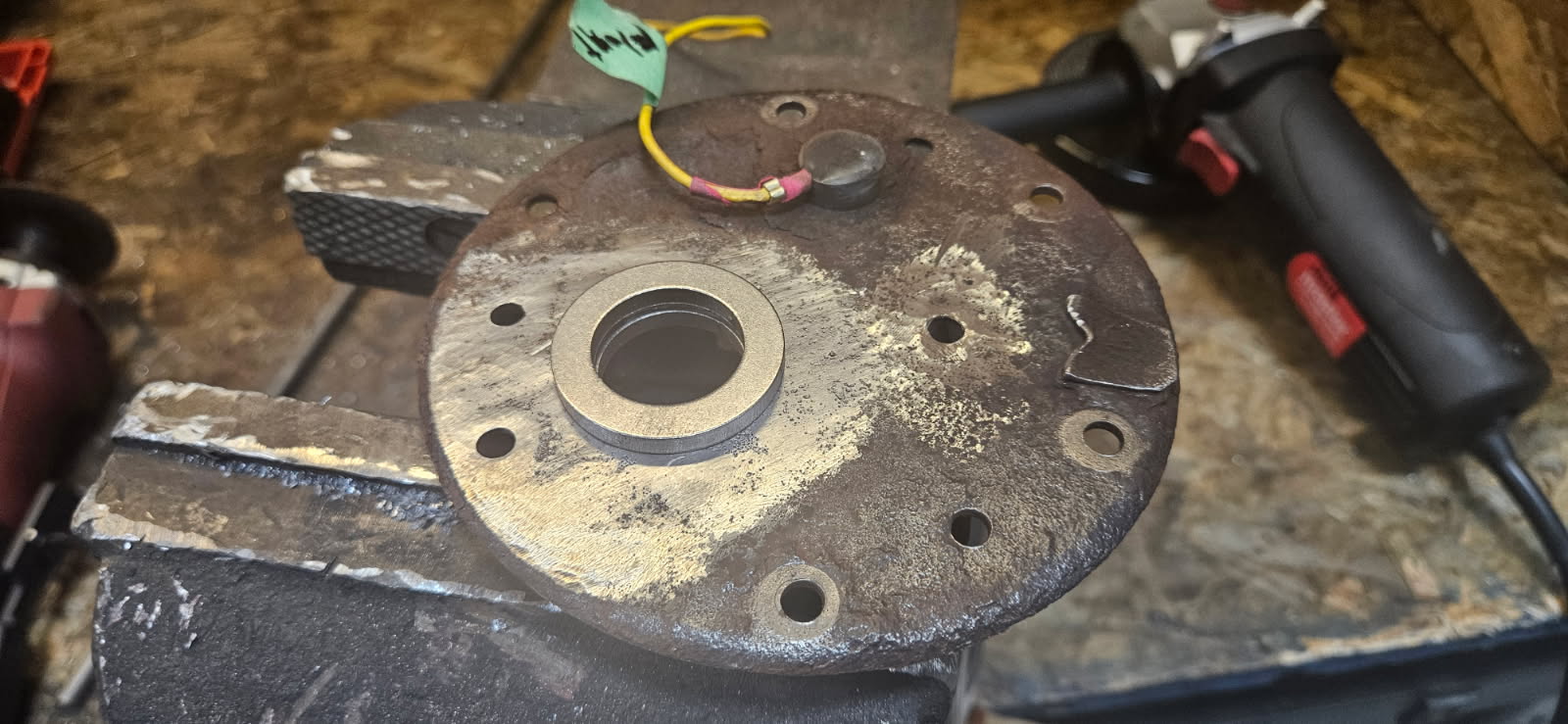

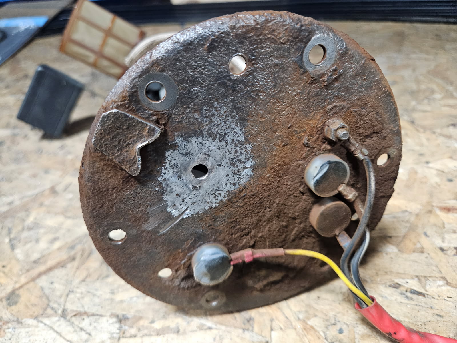

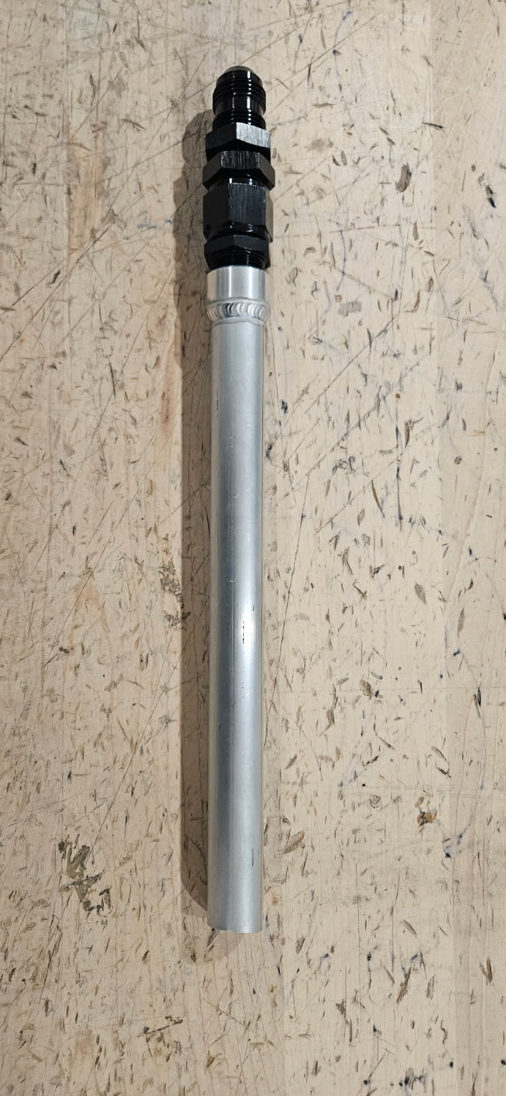

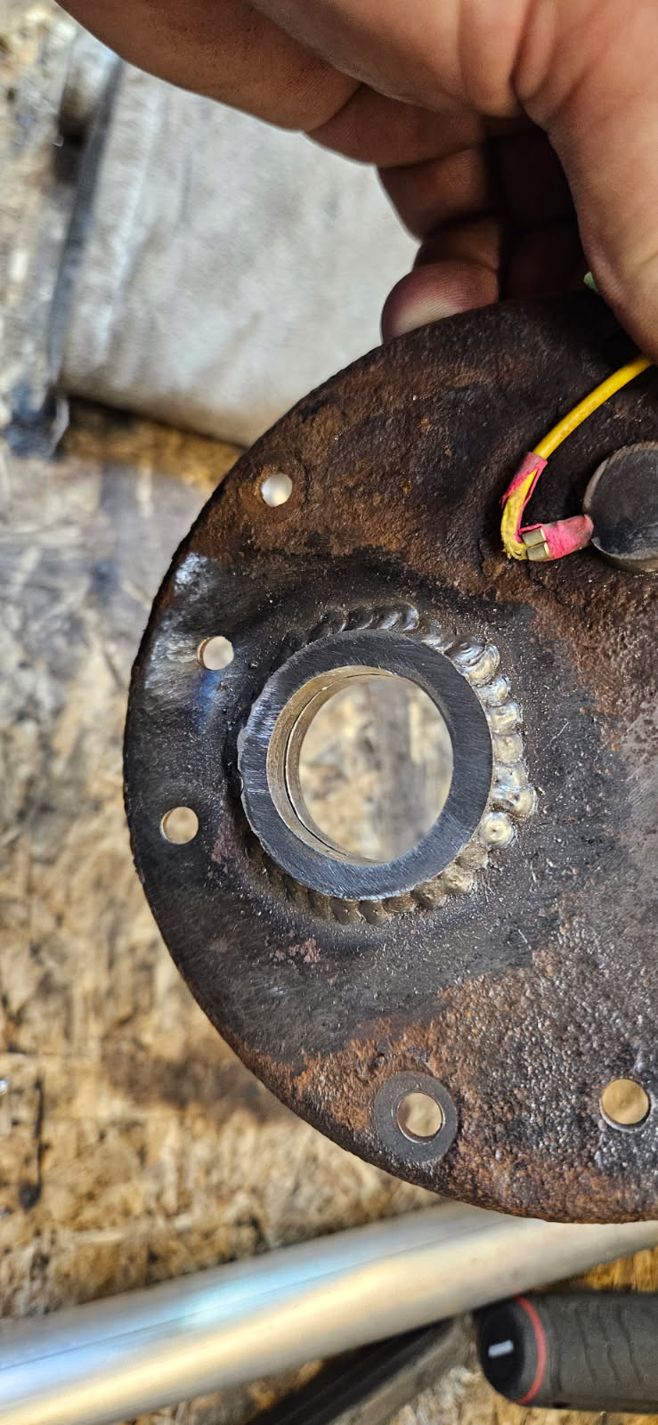

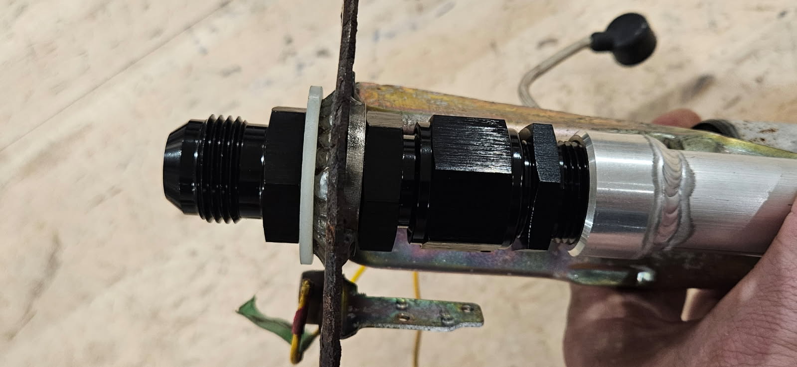

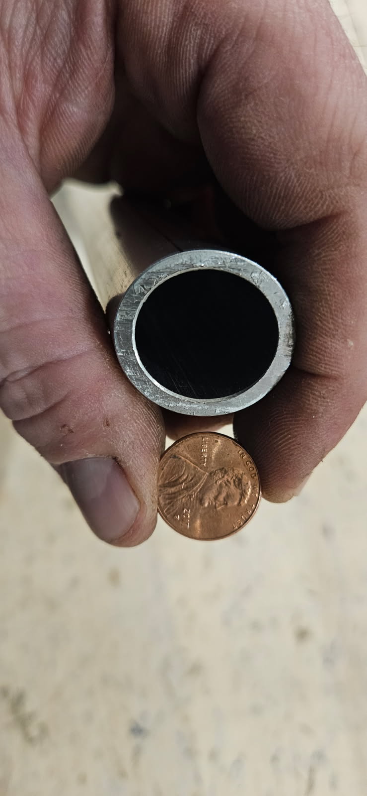

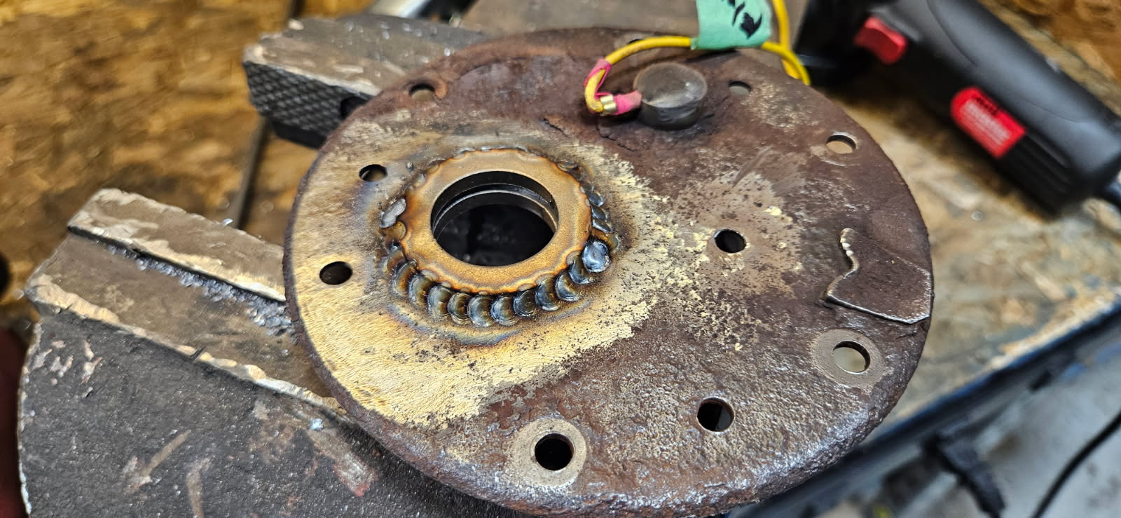

I had a 3/4" pick-up tube made, paired it with a 12an bulkhead. For the stock housing, all I had to do was delete the stock electrical bulkheads for the + pump wire, ground wire for assembly, and the low fuel sensor. There is just enough room for this tube and fittings. I decided to order some washers for the inside and outside of the assembly 'hat' for a clean pass through for the bulkhead. Between the condition of the outside of the housing and leftover passthrough holes from the electrical bulkheads, big washers will be the ticket. Lots more to come.
On to the washers for making a proper pass-through. I couldn't source them local, so off to McMaster. After the shipping fee these few washers added up to almost 30 bucks. I sat there and stared at the monitor for a few minutes before going F-it, order the parts. My pocket is still hurting.
Measuring the OD of the threads on the bulkhead I needed washers with an ID of 27mm. The nylon washers were spot on while the stainless washers needed some help starting at 25mm. Never thought I would be carbide bit porting my fuel pump assembly, but here I am.
