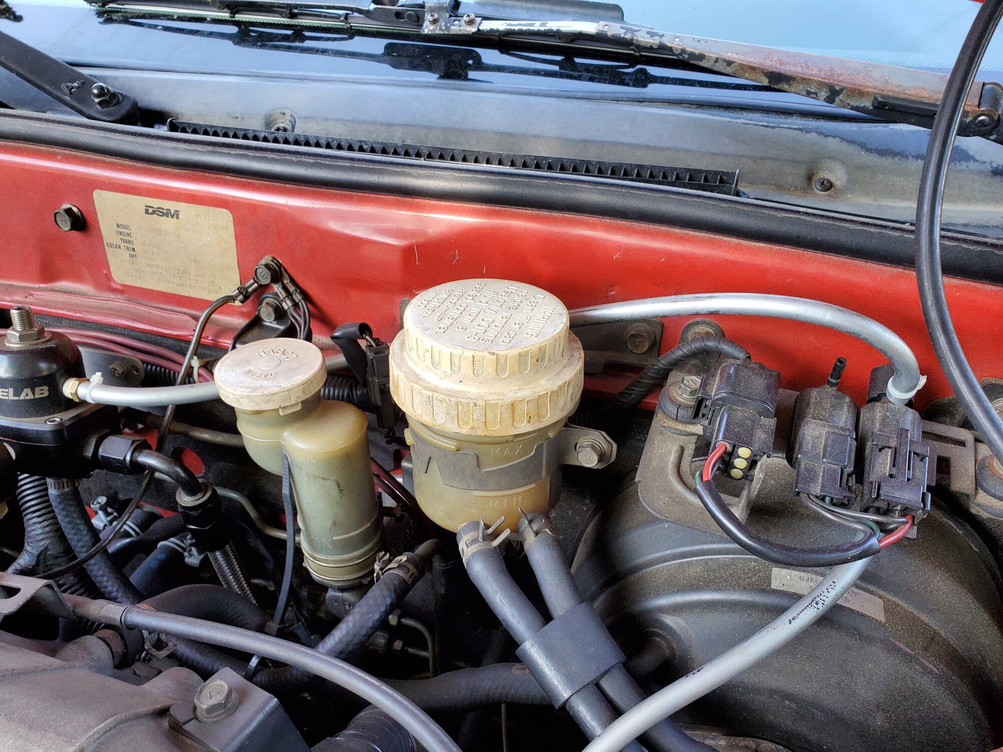

My experience is the FPR solenoid is beneficial for cold starts. It increases base fuel pressure when the intake is under vacuum. I have my solenoid hooked up but still deal with the hot start issue.
That being said, I think you have your solenoids backwards. The FPR solenoid is the one on the right with a vacuum/boost source on the front. The left one that you have hooked up in your last pic is for the EGR.
edit: You're right! I did use the wrong solenoid. Thanks tons for pointing that out.

Normally open is right. Here's mine, and I'm 100% sure that's the correct solenoid. My dsm was bone stock when I got it.

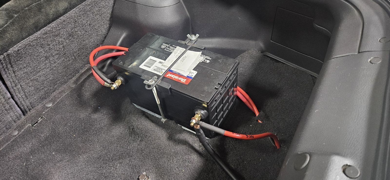

I did put in a big battery to rule out that variable. For 20 years I was running the smallest battery I could to save weight, but I have always been curious about how a huge battery would work out. And the answer is... nothing magical aside of adding 20 something lbs to the car.

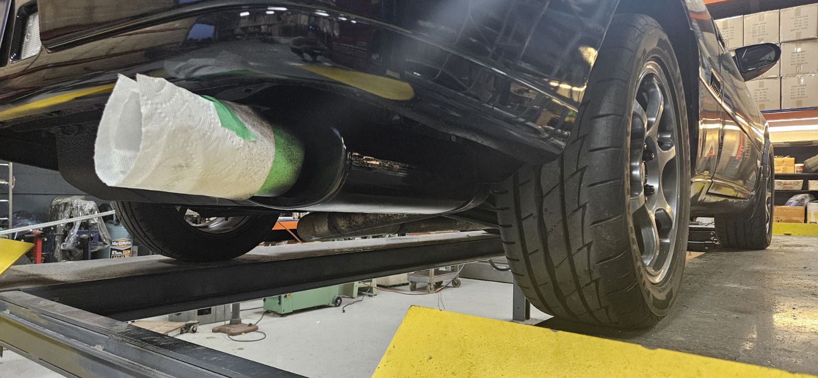

All of that aside, I did have a little fun and hit the muffler with some paint to lose the chrome and it's worlds better.

From the alternator to the old battery connection on the passenger side of the engine bay I ran 0/1 gauge wire, from there I ran 0/1 gauge to the battery terminal. The + stud on the alternator has the B wire and this new wire.
The alternator case is grounded with 0/1 gauge wire. The battery is grounded to the spare tire bolt with 2 gauge, I read that was a poor ground so I also ran a 0/1 gauge wire from the battery to the rear seat belt bolt.
