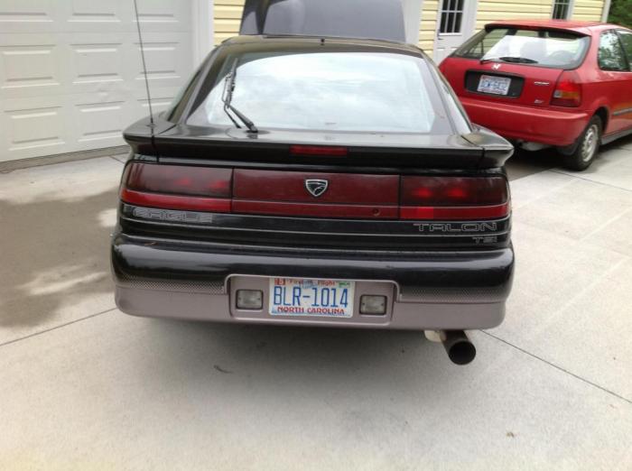

This is my talon that I bought on deployment. I have several goals for the car.
1. Super clean inside and out
2. Keep the car reliable
3. Make decent power on the stock bottom end
4. Keep interior simple and to the point

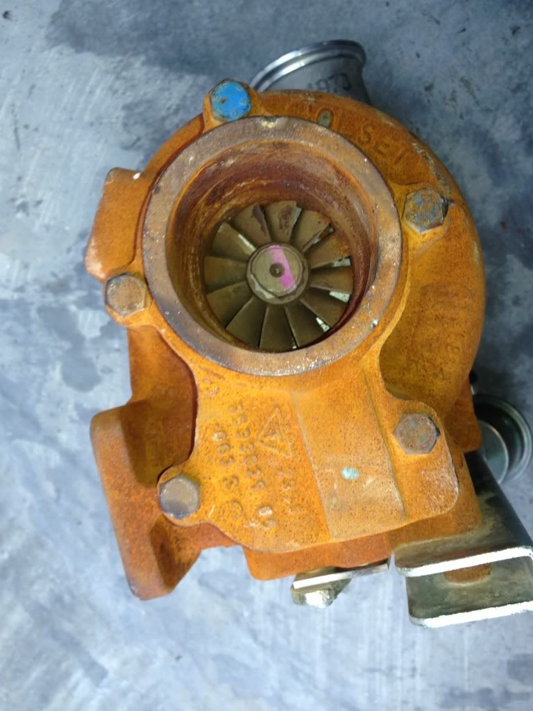

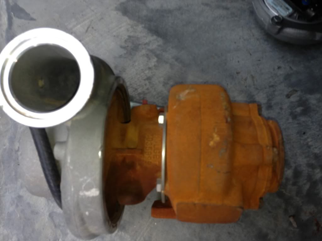

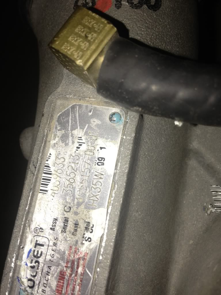

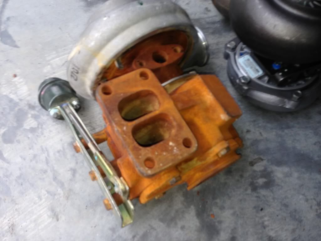

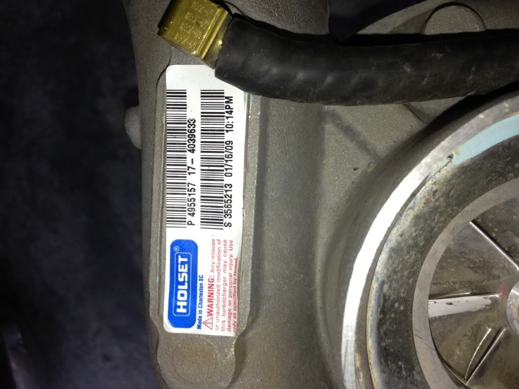

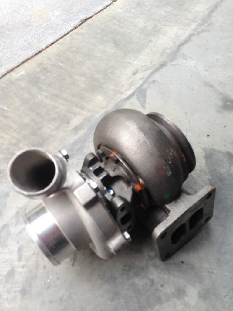

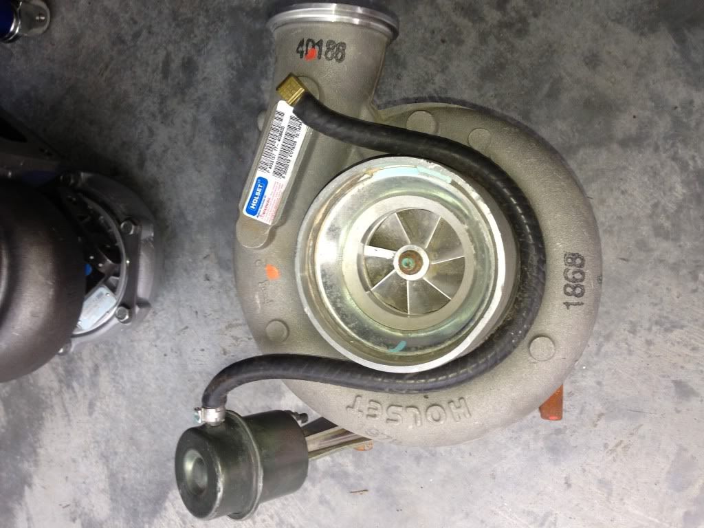

You should look for some casting numbers on the housings and research what you have, but if that is a 7 blade hx35, they are pretty easy to make respectable power with, and reliable, assuming the oiling setup is within holset specs. On top of that, being that you can get bolt on housings pretty cheap for the holsets and the 50-trim turbos, I'd probably lean towards one of those. Just my opinion.

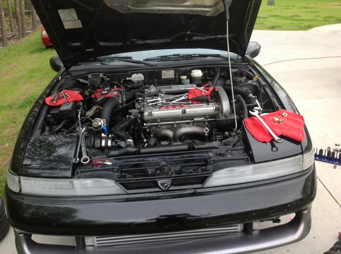

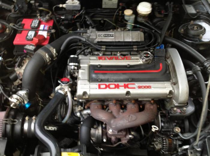

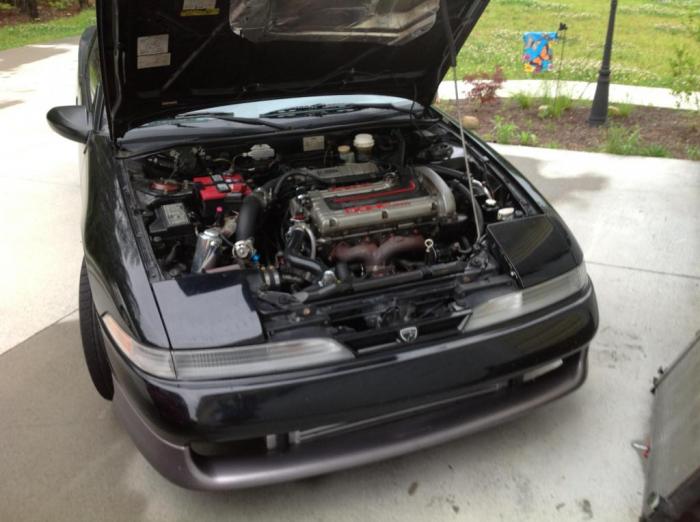

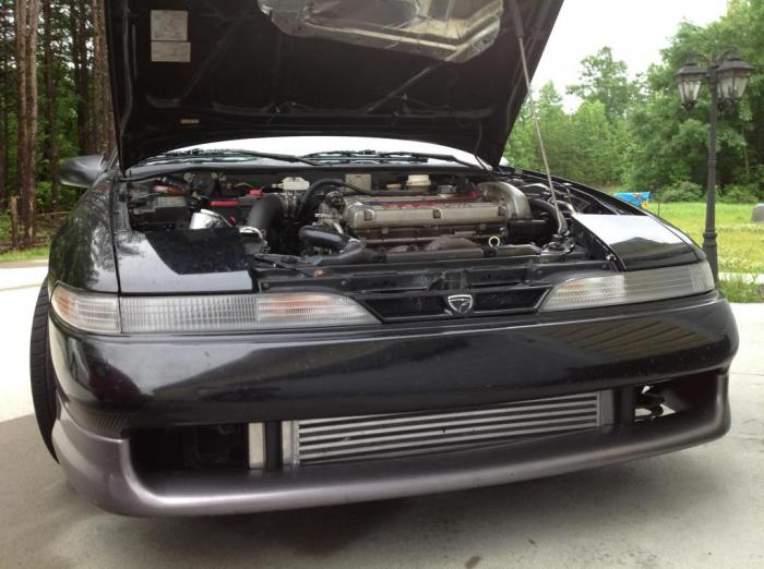

Here is an update changed jobs to a much better one as a heavy equipment mechanic. My radiator went so I bought a mishimoto during extremepsi's Black Friday sale for 200 shipped. I also got the proper bolts and crush washers for the turbo oil return. Many upgrades to come just bought a walboro 255 pump. I hit fuel cut if I get in it so it's 2g maf or gm maf with a translator. I also need 550 injectors or bigger if I get something to tune the car. I also need to boost test and looking for one currently.

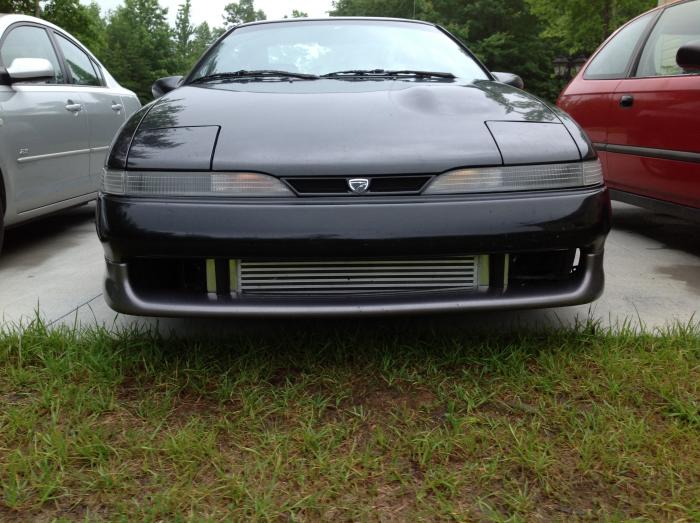

That's a CX-racing or Punishment Racing 1G FMIC kit. They are better than the VRSF 1g kits, as they are thicker, and have held more power, and are way more resistant to heatsoak and pressure drop. It'll get you where you want to go. :)
