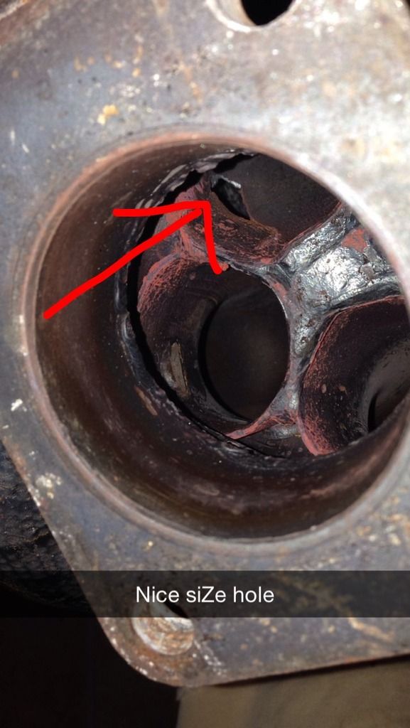

Well I hit the track again last Friday 6/19/2015, was having issues with spark breaking up around 25lbs of boost before leaving, got down to the track and lowered the gap on my plugs to nearly closed imo .015 and it helped but car was acting really funny, thought it was a boost leak but couldnt locate it so I said f*** it and made a pass anyways.. Ran a 8.7 at 85mph banging and poppin all the way down the track..
At this point I was frustrated that I couldn't find the issue and was going to be done for the night and just enjoy the show but when i heard there was only 4 cars in the running for the AWD class that night and the fastest time was a 7.9 I entered my time and got bracketed up against the Subi that ran the 7.9.
Lined up and launched hard and strong but was breaking up bad about halfway down the track and he passed me.. I ran a 8.5 he ran an 8.01..
I noticed after that last pass my issue was 15x worse than it was before the pass and i was worried about the 1.5 hour trip home with the unknown issue but attempted it anyways.. Car died everytime i stopped, couldn't get it to idle nothing.. but made it home and parked her for the night.
Next day i was determined to find the issue and i decided to check over the manifold, pulled the wrap off of it to find a pretty decent size hole in one of the runners...:notgood:
Purchased a used 2g manifold off a buddy and am going to get it ported nicely, also ordered a new exhaust stud kit and copper gasket from STM today and will have that installed later this week.

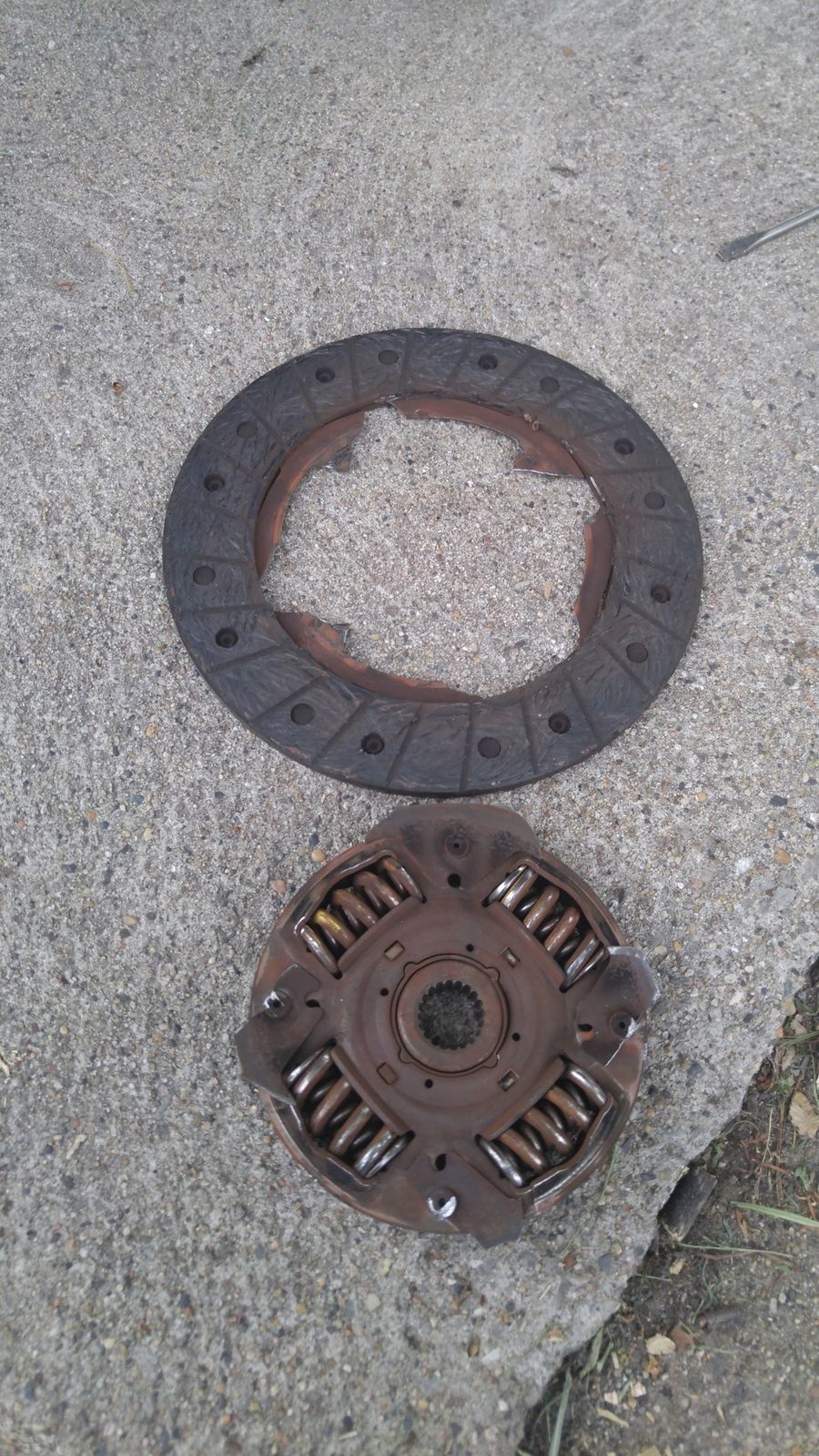

hmmm found my vibration LOL ACT 2600 Street disc couldn't take the drag launches.
going to try out an XTD Stage 4 and see if they are actually as good as everyone says they are
Unfortunate, but on the bright side we risk it every time we slip the clutch on a hard launch, and I'd rather replace clutches than trannys all day haha. How long did the ACT hold up? It's what I have as well and I have no complaints yet with 20K miles
Good luck on the new clutch install.
I had ~15k miles on this and just started making drag passes a couple months ago, maybe had 10 hard launches on it within the last 2k miles.
Being a street disc it just couldn't take the abuse i'm somewhere in the 400 awhp range i'd assume. New clutch is in just gotta button up the small stuff and add new fluids.
