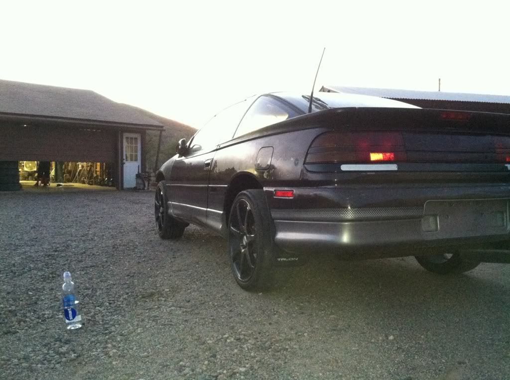

91 talon Operation : PURP
Nice progress! What did you use to coat the underbody? Looks good
really like your garage and great progress.

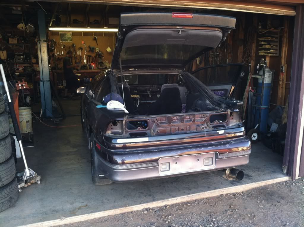

Thanks guys I hope its running before the end of the year! Its my buddys uncles garage but I sure wish it was mine has every thing you could need an more. Duplicolor undercoating make sure you clean an SCRUB what ever your painting so it sticks well.

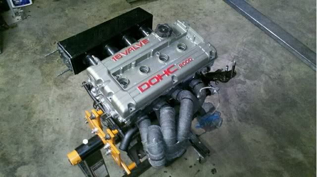

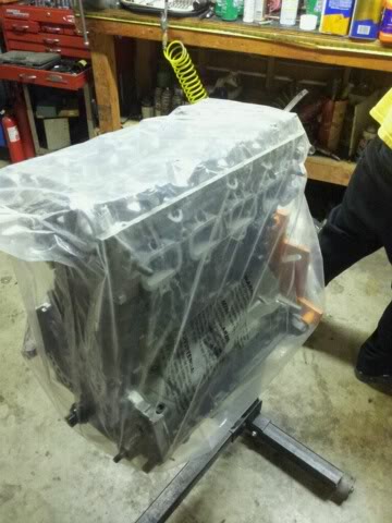

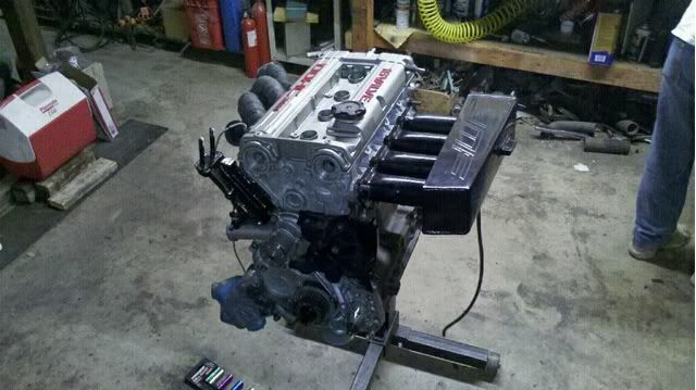

Motors almost ready!

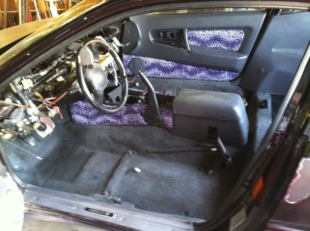

Interiors coming along nice.

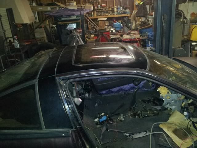

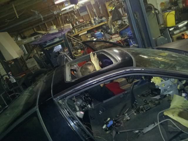

I was lucky an got an aftemarket sunroof in my car... to bad it doesnt work and the tracks were all broken :rolleyes: lexan?

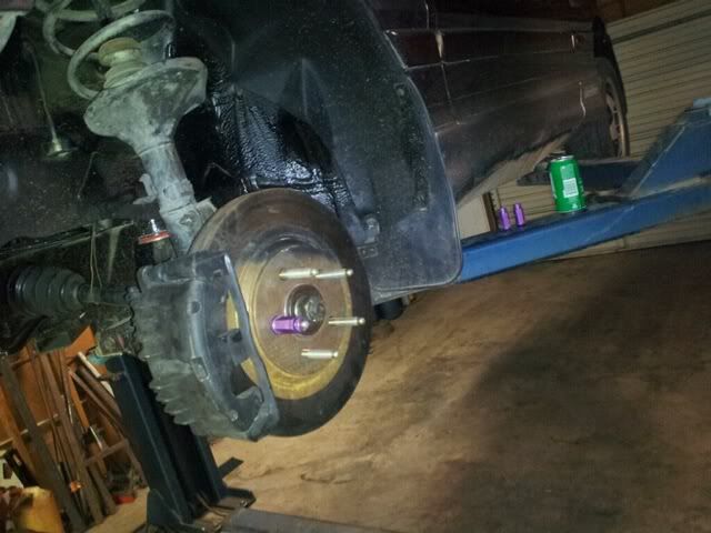

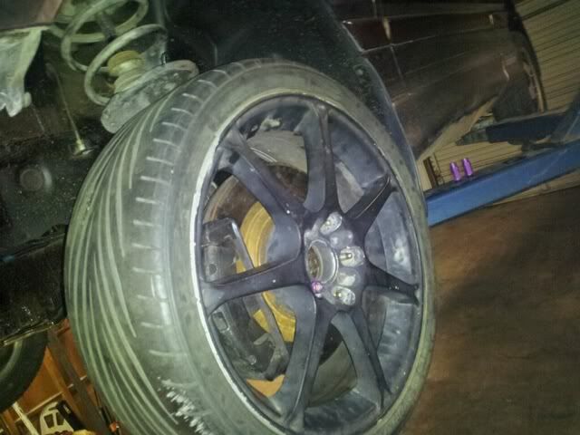

13" big brake kit thanks to kitty! Yes i know some of those parts are looking dirty just threw them on to make sure every thing fit. They all will get some fresh paint.

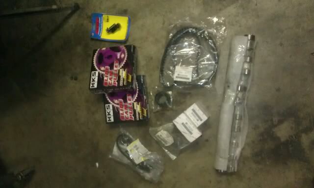

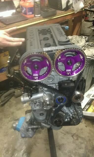

Well I got some free time yesterday an put some time in to the talon. Things are moving along nicely thanks to every one for the help an support! Work is slowing down so we will see how the extra cash flow goes but the stash pile of parts is still stacked high so theres plenty of wrenching to still be done. On to the good part the pics!

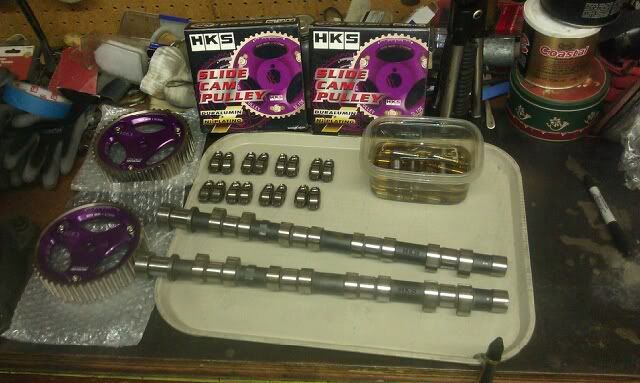

OEM timing goods HKS an ARP
Cleaned an ready to go

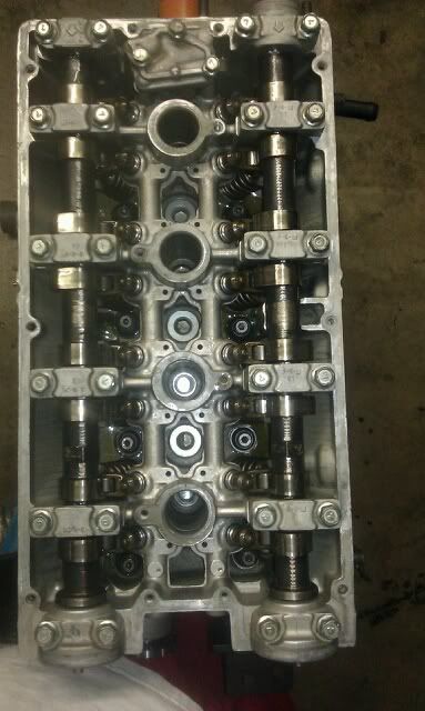

Some good head :D

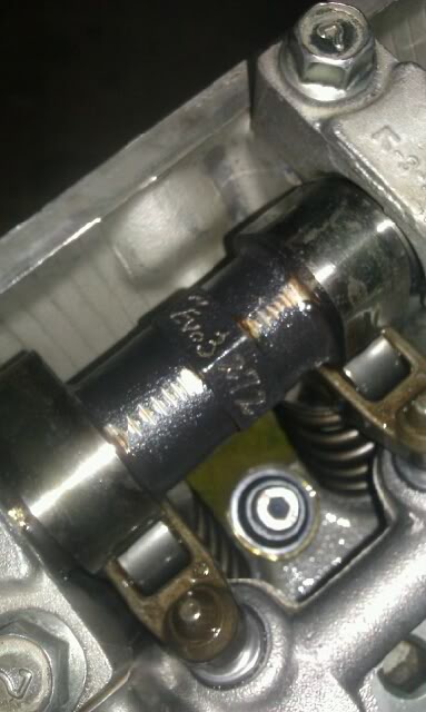

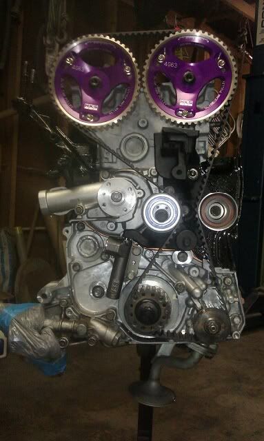

HKS 272
Timing dead on first try!

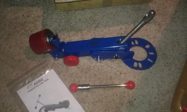

I was tired of hand rolling.... sooo this came in the mail today nice fender roller.

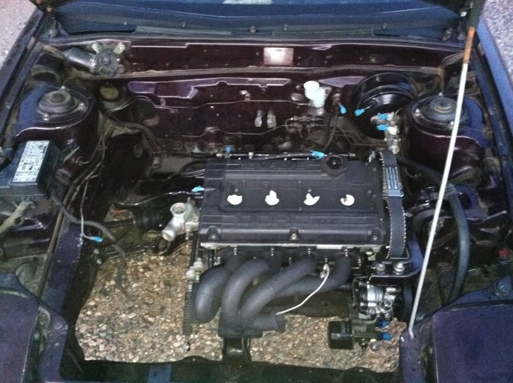

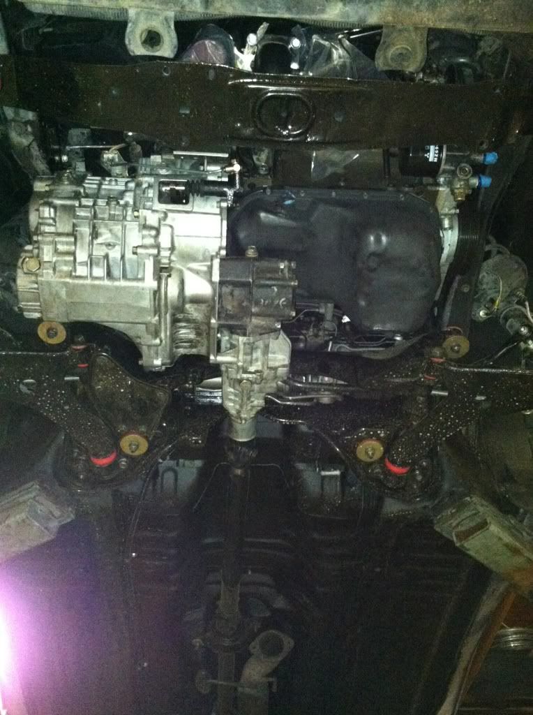

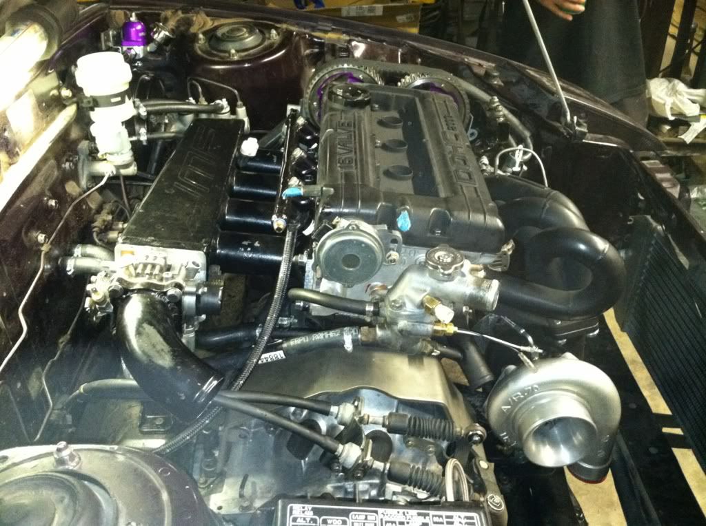

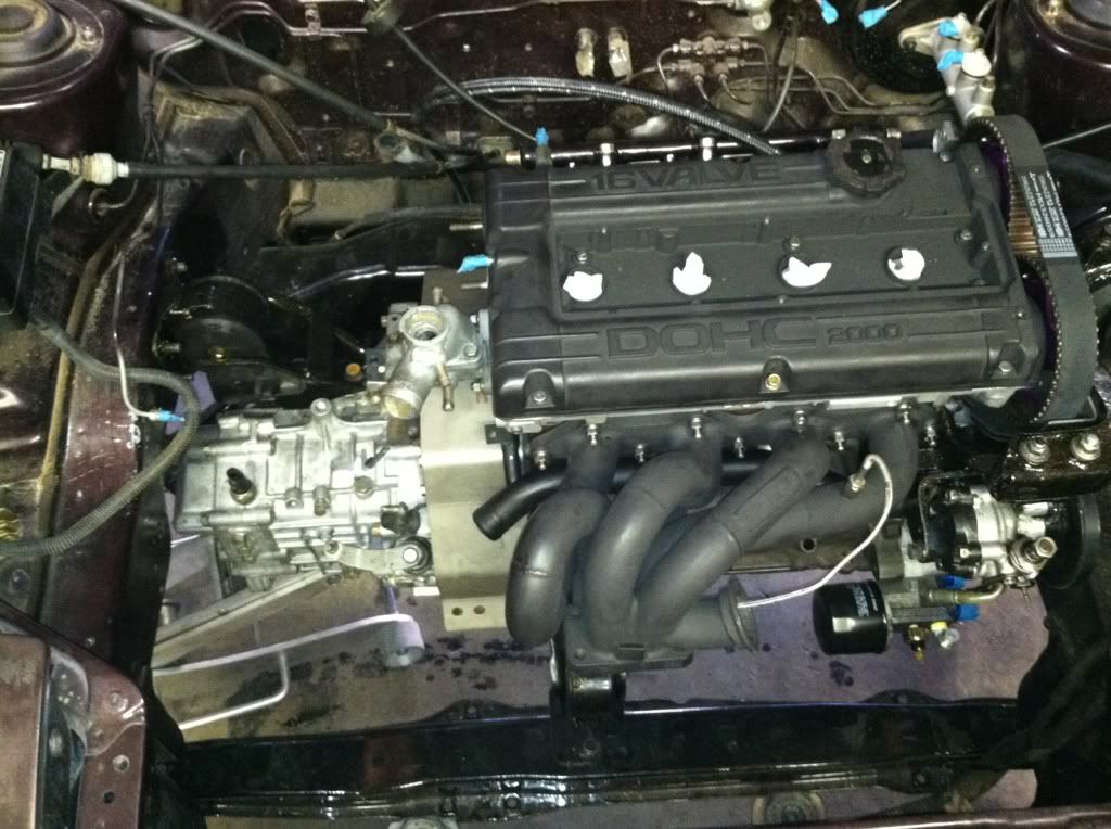

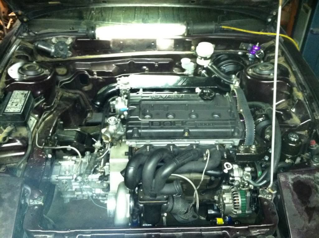

Got the motor in.

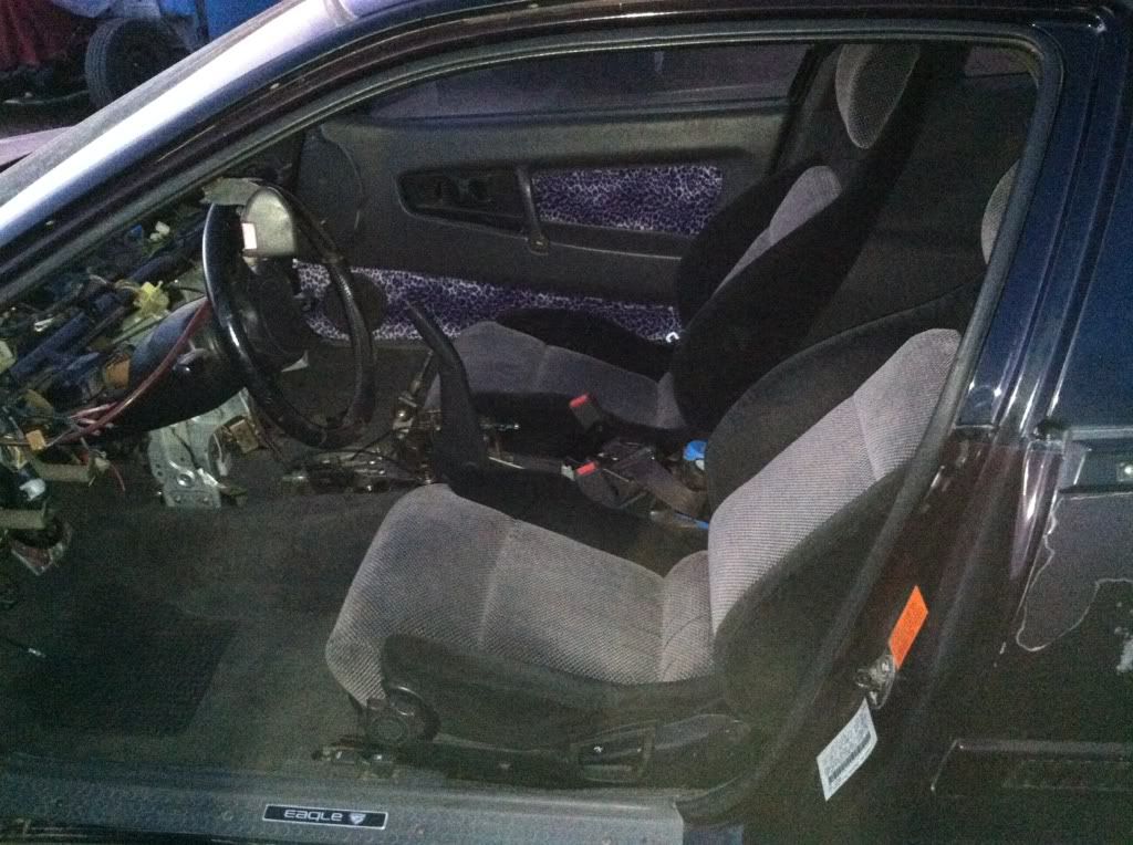

Interior cleaned an putting together.
Cleanest seats i have seen to this day, found them in storage for 10 years!

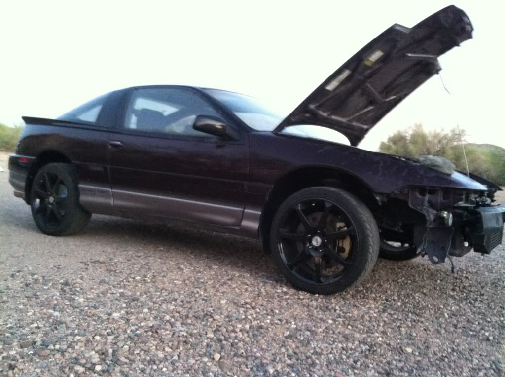

How it currently looks.

Good stuff man, Keep it up. and you are right, those seats look perfect!

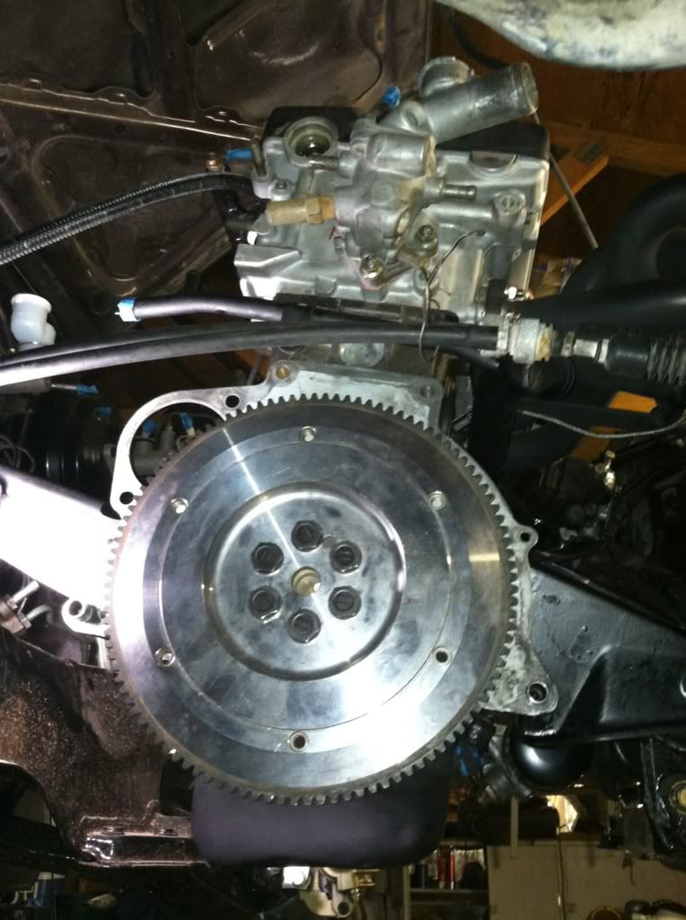

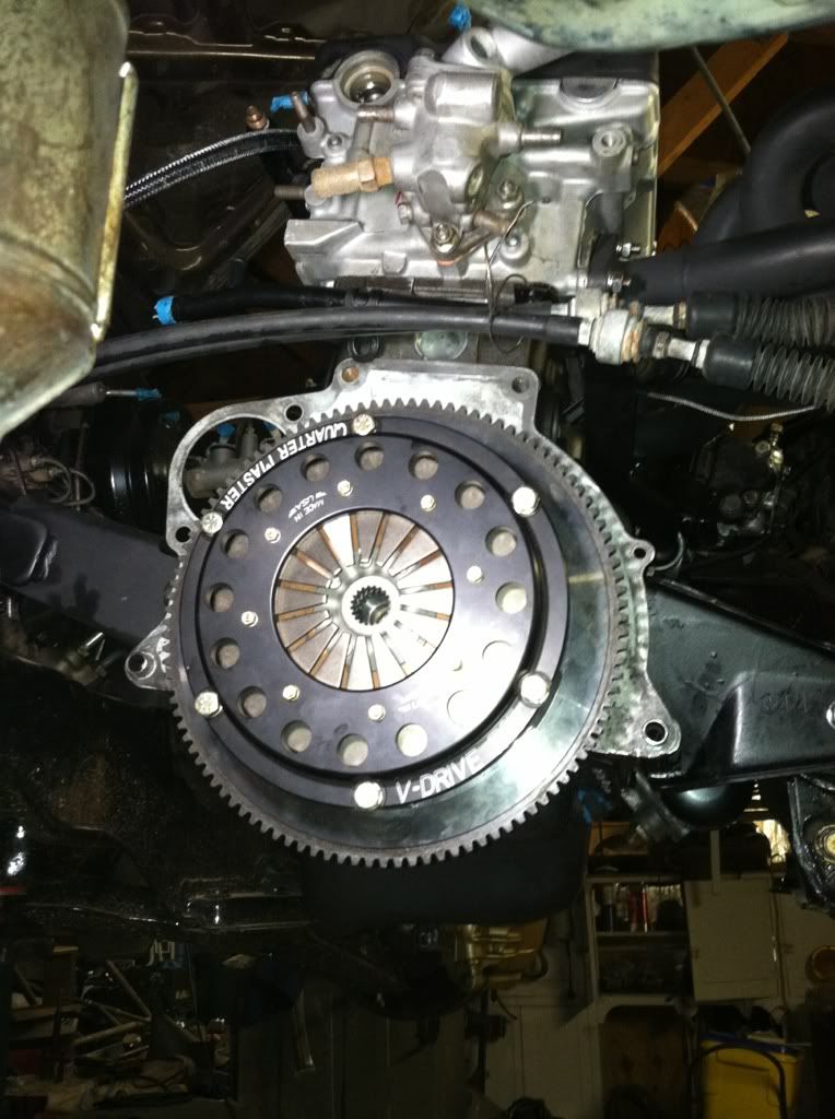

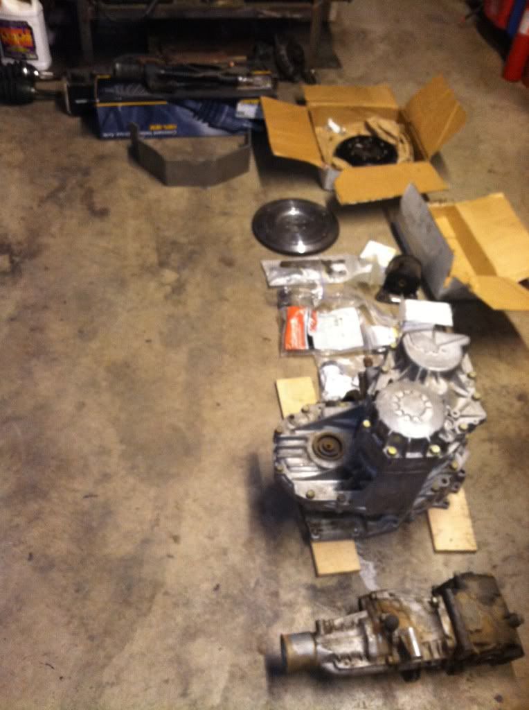

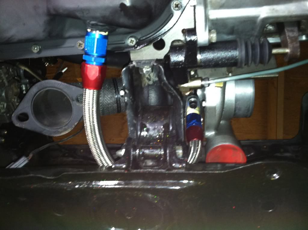

UPDATE for you hardcore DSM'ers! Every thing is going nicely just waiting for a few odds an ends to come in the mail to tie the drivetrain together.

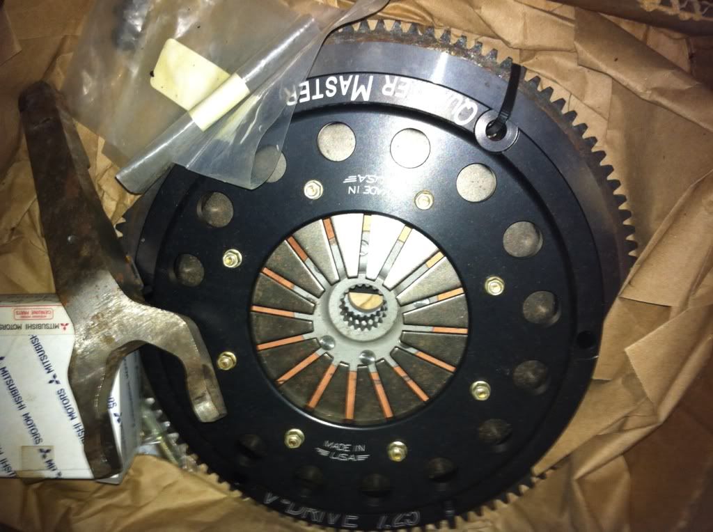

Quartermaster flywheel an new OEM flywheel bolts with thread lock of course.
Lined it up with no alignment tool!
Wait bro are you buffing my shaft? Ummm what the...:tease:
Ready for its new home.

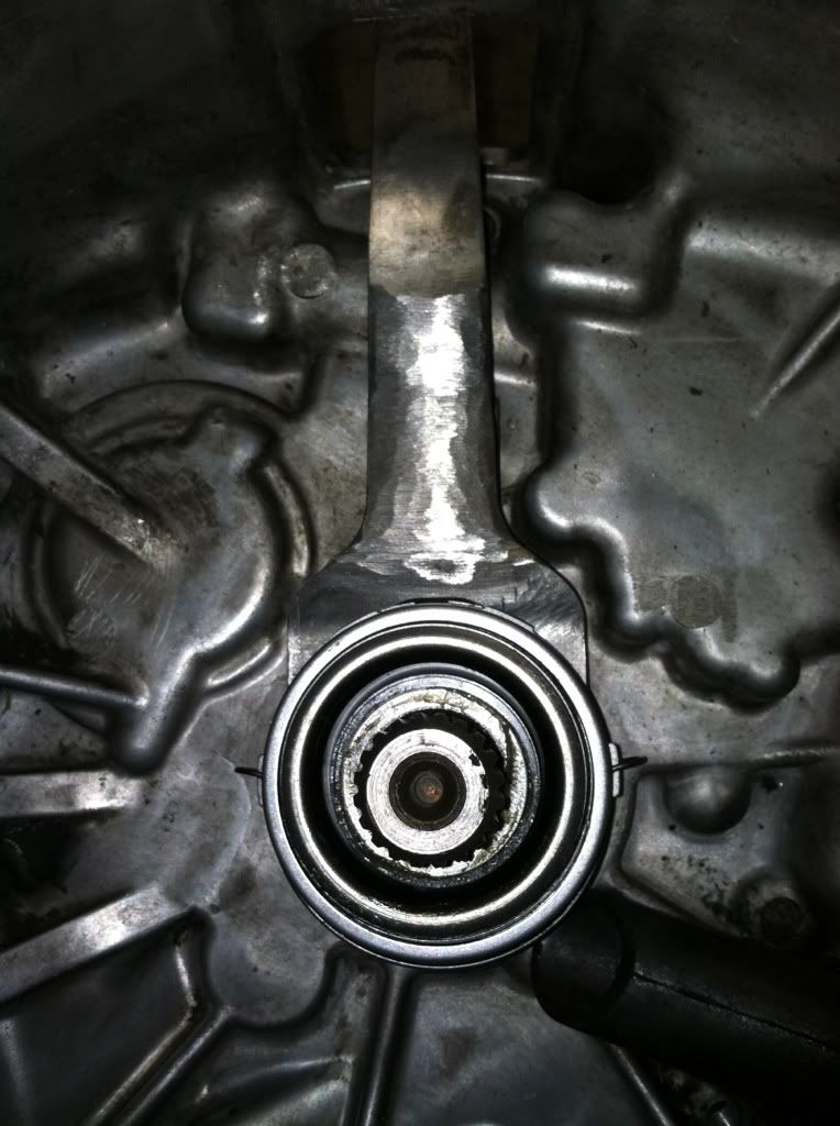

Slight shave to clear the quartermaster PP
An the teaser.
Thanks for checking it out, more to come.

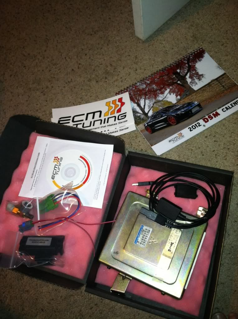

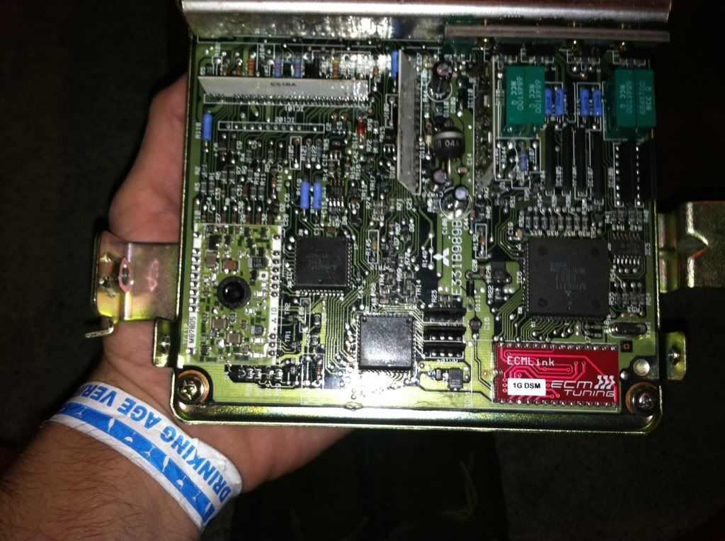

Got my order from ECM Tuning the other day, these guys know there stuff have an awsome turn around time thanks again!

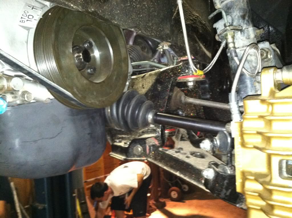

Got another update for everyone. the pics are self explanatory so ill let them do the talking.
10an

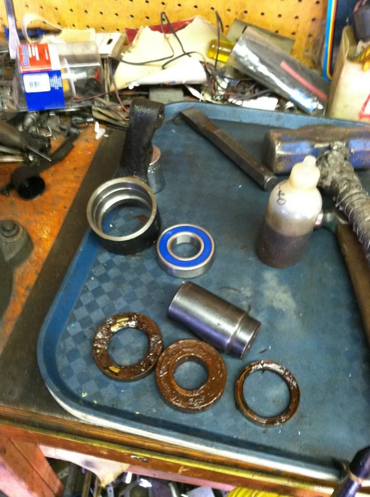

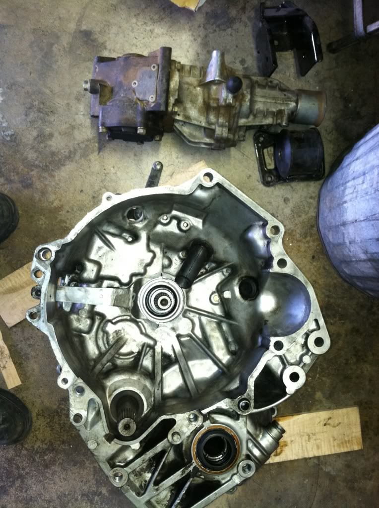

intermediate shaft
New axles an fluidampr

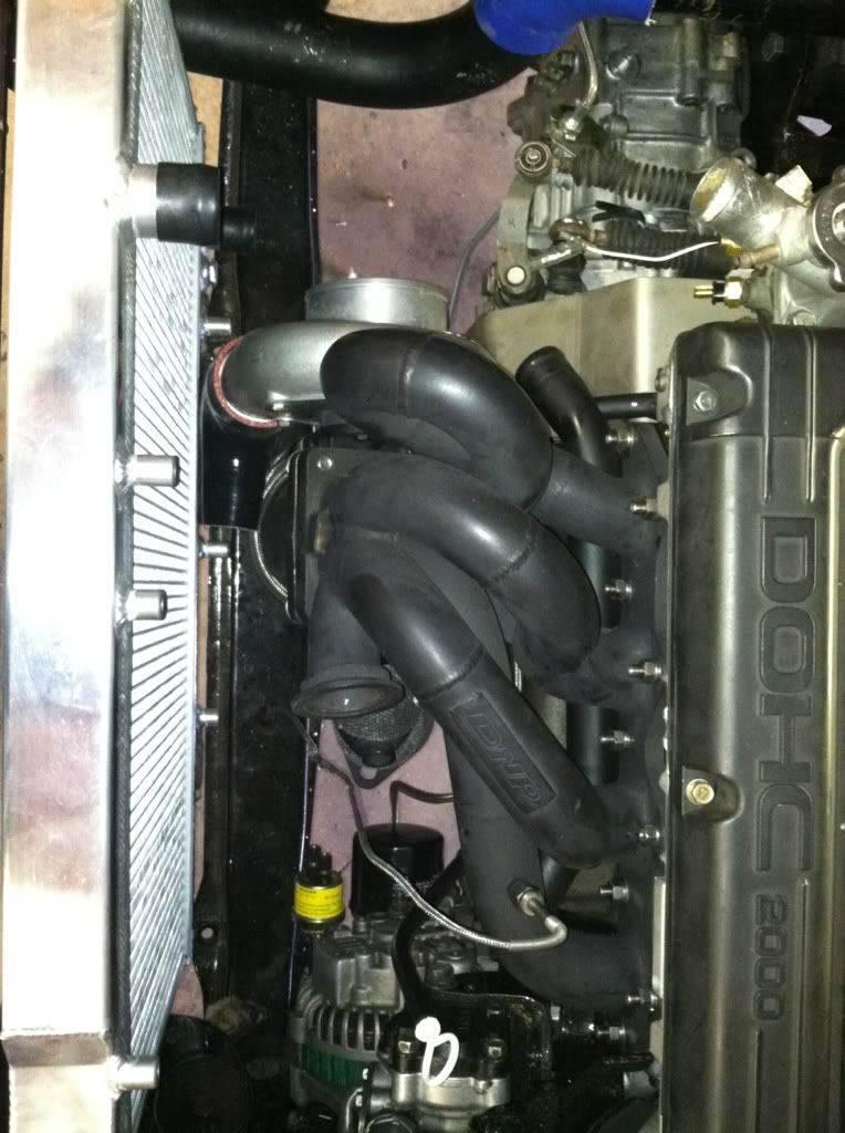

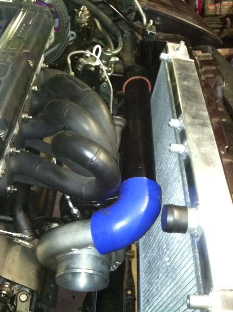

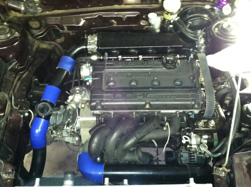

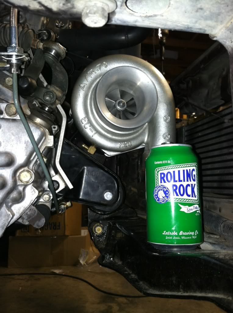

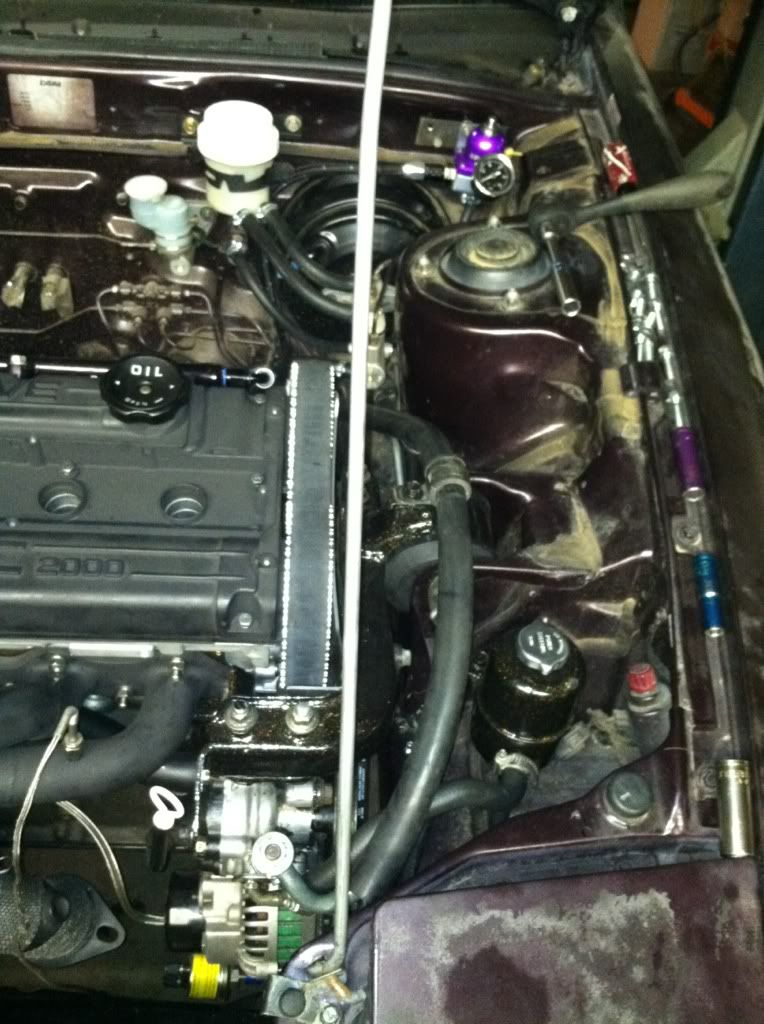

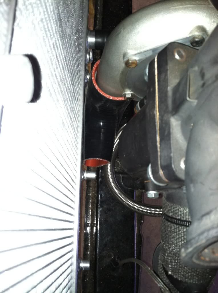

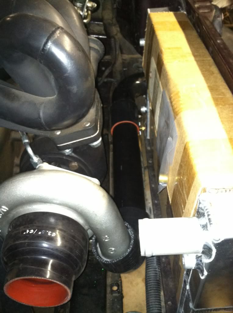

update time! So we started setting up the intercooler piping an quickly came to a hault, We had turbo to radiator fitment problems.
We turned the turbo housing up but that placed it right next to the exhaust manifold an left no room for the wastegate.
I wasnt happy with this so jumped online an searched threw the half sized/honda raditor threads but couldnt find any thing that fit my needs till I came across a afco scirocco. Yeah its a pretty penny for a radiator but hell I had no other way to go an the last thing I want is for my car to over heat. So I ordered that bad boy an it will fit right where my a/c condenser went.
21x13x3

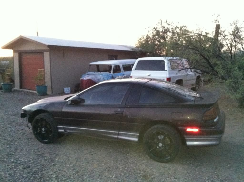

Thanks for looking, an yes my car is a little dirty I live in the desert.

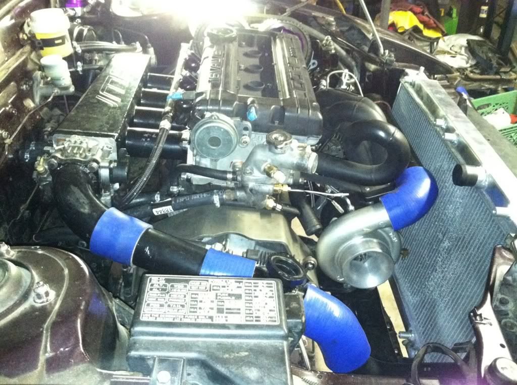

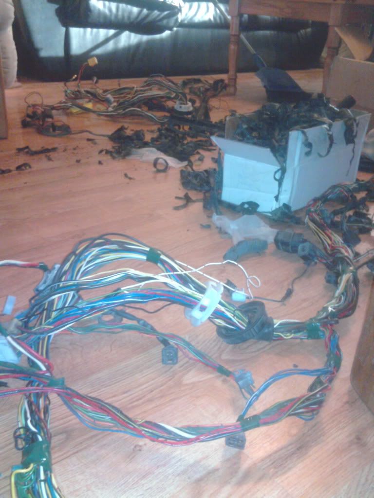

Ill give ya a little taste of whats new.
Ill throw some more pics up once I get the wire harness in.
Awesome, Im at the same point as you.. sort of. Where did you get your silicone hoses if you dont mind me asking. I originally had blue but I want black ones and I was hoping you got them for cheap so you can hook me up with a link. Are you doing a harness tuck or just a wire delete?
Good to hear your build is still on the move!
The black couplers I orderd came from ebay about $8-$12 each all of them are 4 or 5 ply I wouldnt waste my money on 3 ply.
Doing a slight tuck on the harness an fixing a few broken plugs.
