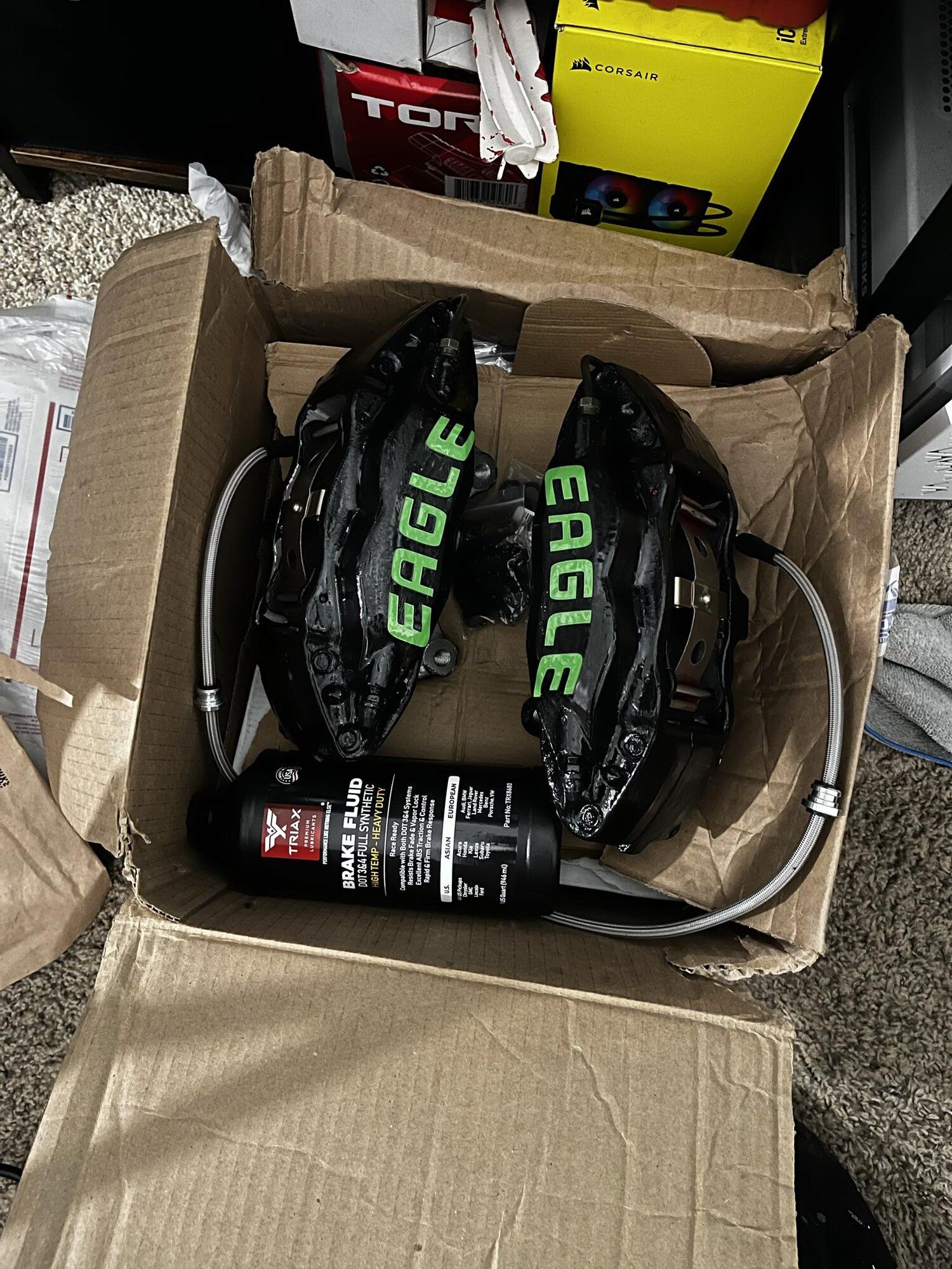

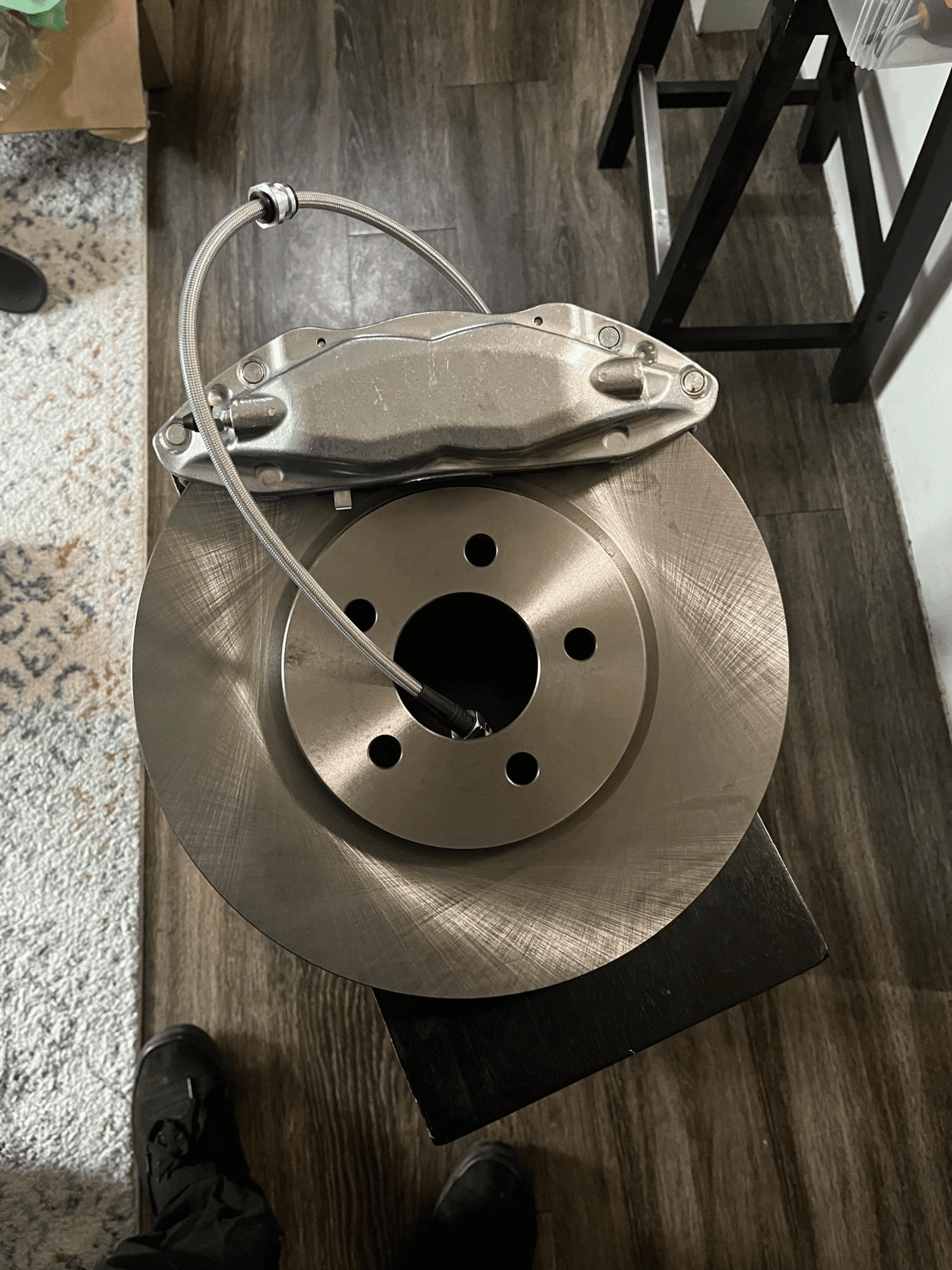

This weekend plan is to install budget BBK.
Calipers - 3312255156367493, 3312255156367483
Caliper crossover line - BM42-CT (Only need if your calipers did not come with)
Caliper bolts - M12-1.75 x 35mm and M12 lock washers
Rotors - BENDIX PRT5271 (x2)
Pads with hardware - DYNAMIC FRICTION 1310100107
Brake line - Evo 8-9 front braided line (Paid $60 on ebay so no part #)
RTM spacer and shim - 1K-RTM-8120
Dot 3/4 brake fluid

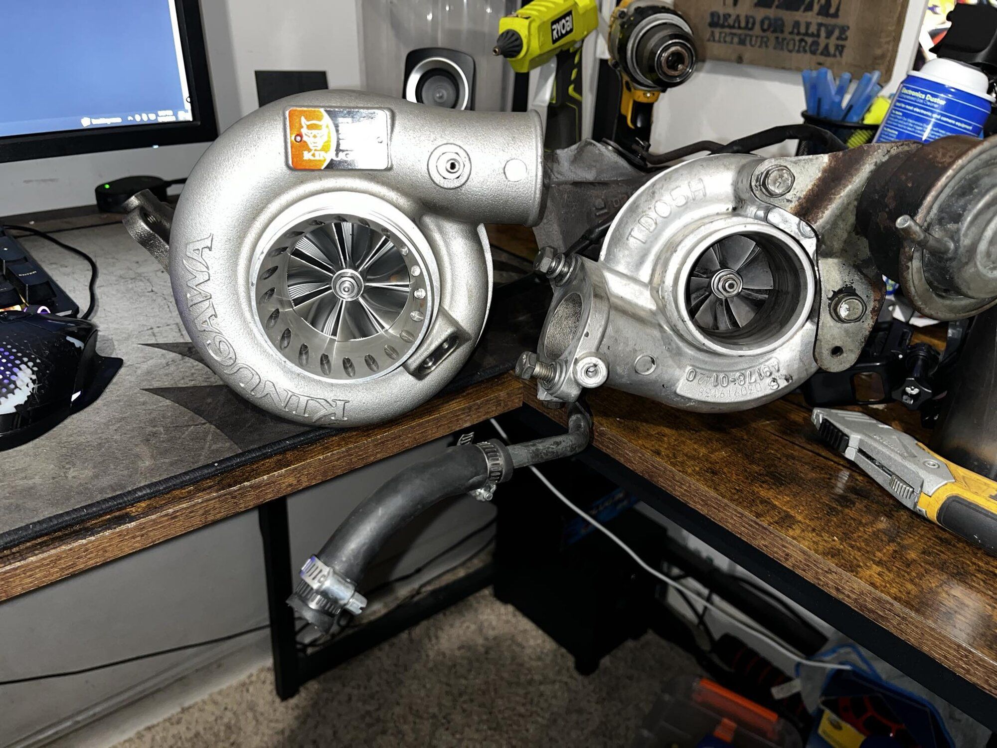

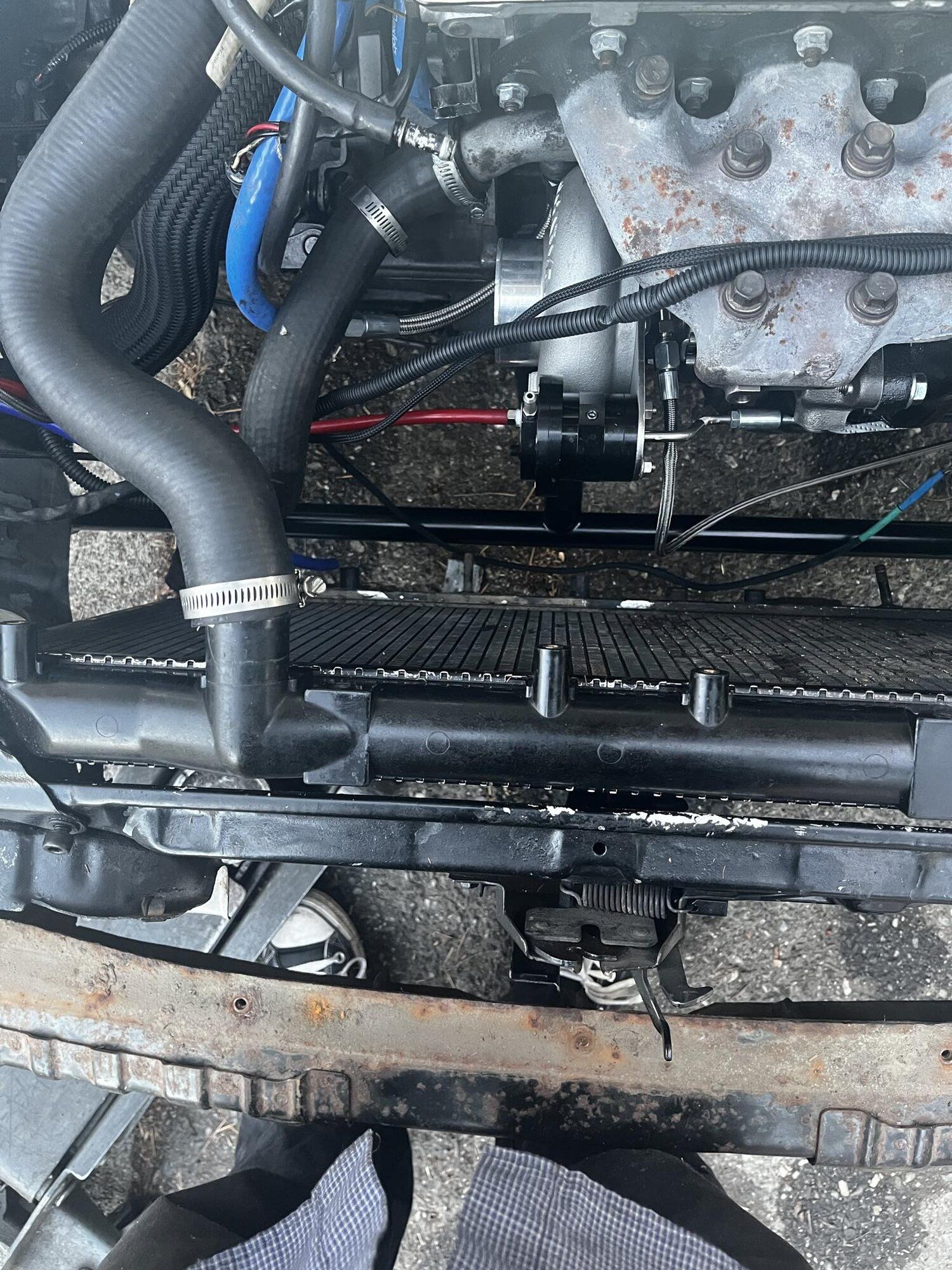

Update on the Taiwan 60-1 turbo ​
Edit 07/22/24 will reinstall turbo and increase wastegate spring preload.
  • Got everything installed and it refuses to boost past 17psi.
    Even went as far as removing the boost source to the wastegate, still only made 17psi and was laggy as hell.
  • Pulled the turbo off the car and leak tested just the turbo.
  • Plugged the compressor outlet and used the compressor inlet for my boost tester.
  • Found a LARGE amount of air leaking in the oil drain and oil feed (Little air is normal)
  • With my compressor regulator at 40psi the turbo wouldn't hold 20psi.
  • Reached out to Kinuguawa hopefully I can get a replacement in
    • For now Big 16g is back on the car
 Turbo is actually good.
I messed up the wastegate preload when I had to reclock the turbo to properly fit.
Good!

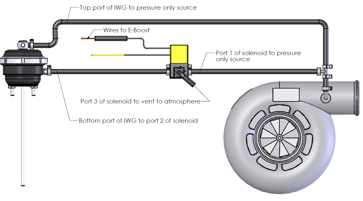

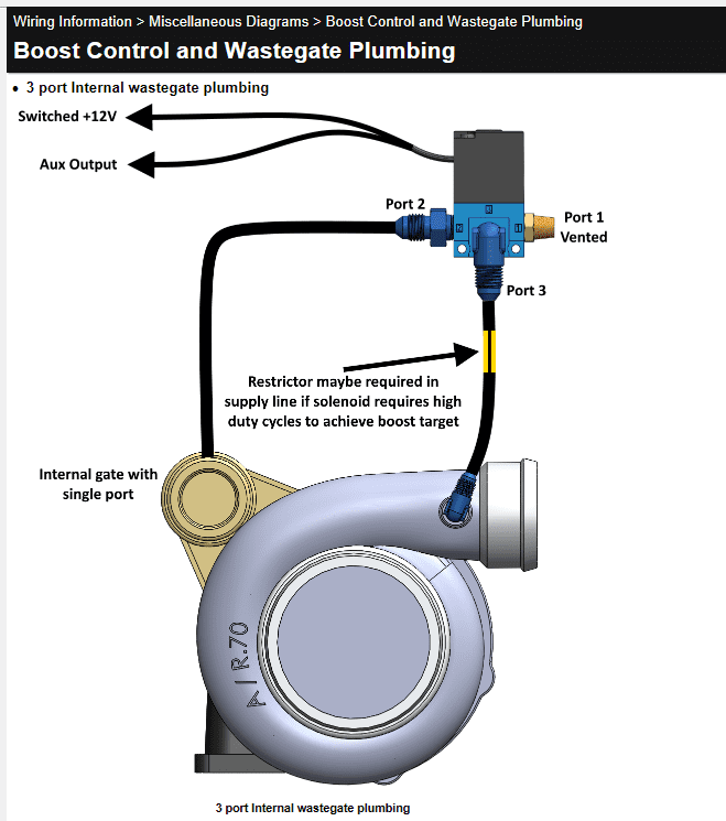

I have it hooked like this
This configuration allows you to run about 1.8-2x spring pressure at 100% duty cycle
Good, thanks for posting that pic of the plumbing. That is about a 1000% better drawing than the crappy one that AEM has in their pdf for their boost controller and their solenoid. Wow. So I'm going to save a copy of this one.
AEM numbers their solenoid ports the same way and they show the same configuration. They just don't do a very good job of drawing it.
One thing OK in the AEM pdf is their wording for how the solenoid ports are connected internally. I'm sure yours would be the same. They say:
"When energized, ports 1 & 2 are connected. When de-energized, ports 2 & 3 are connected."
So basically, when it's energized, it lets air bleed out through port 1 to de-pressurize the actuator, and that's how you get max boost in this configuration.
I did a "search image with google" on the plumbing pic and found it as a post by Adam@Link_ECU. So kudos for the good drawing would go I guess to Link rather than Kinugawa?
Yes that picture can be found in the link software.
Turbo smart actually has the best diagrams for all different setups if you wanted to see how a dual port internal wastegate is plumbed
I'm going to go ahead and post that since it took me a few minutes to find a good copy of it.
It's just the same configuration as it would be to an external wastegate except that it's reversed as far as what goes to the "upper" and "lower" ports.
Turbosmart - plumbing a dual port internal wastegate actuator to a 3-port solenoid valve - img_20:
(this is from their install instructions for the internal wastegate actuator IWG75)
Turbosmart - plumbing a dual port internal wastegate actuator to a 3-port solenoid valve - img...png
