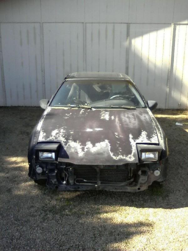

Found 3 DSM's parked on the side of this guys house. knocked on the door and asked if he wanted to sell any?
Out of the 3 I liked this one the best, 1991 Talon tsi awd. Motor condition was unknown had 118k on the car. We settled on $650

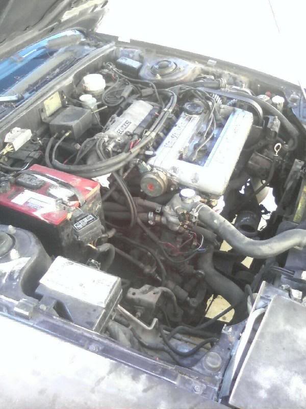

Not complete but most of its there.

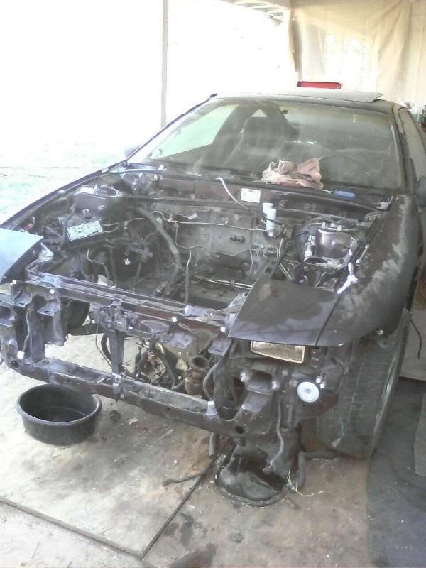

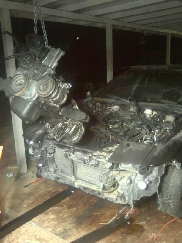

Towed it home and started the teard down.

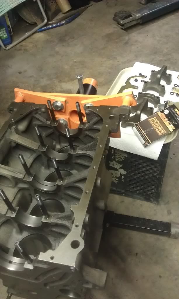

After finding piston 3 melted and the head in bad condition it was time to do more reading and research. Taking up as much dsm knowledge at 17 years old I had no idea what I was getting my self into. 500hp+ is what I was looking for, Rebuilt list started.

2.0 6-bolt 4G63
Ross racing pistons .30 over
Eagle Rods
Kiggly main girdle
ALC race rod/main bearings
ARP L19 Head studs
Cometic Head gasket
BSE

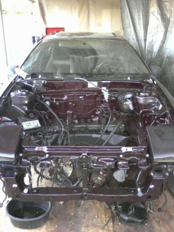

Cleaned up the bay with some fresh paint.
Before
After

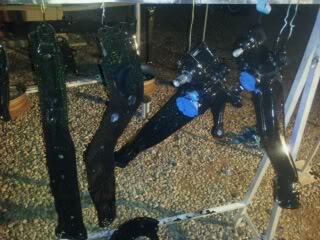

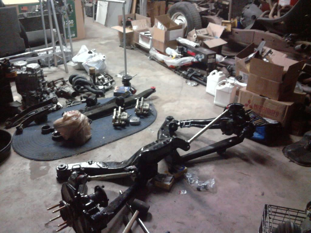

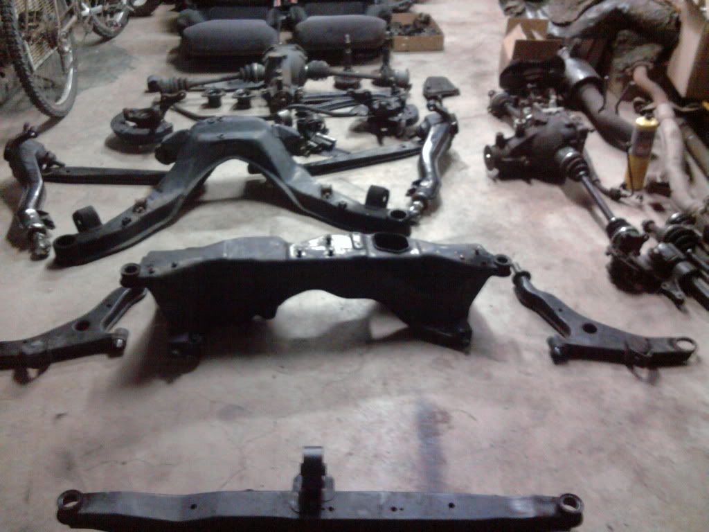

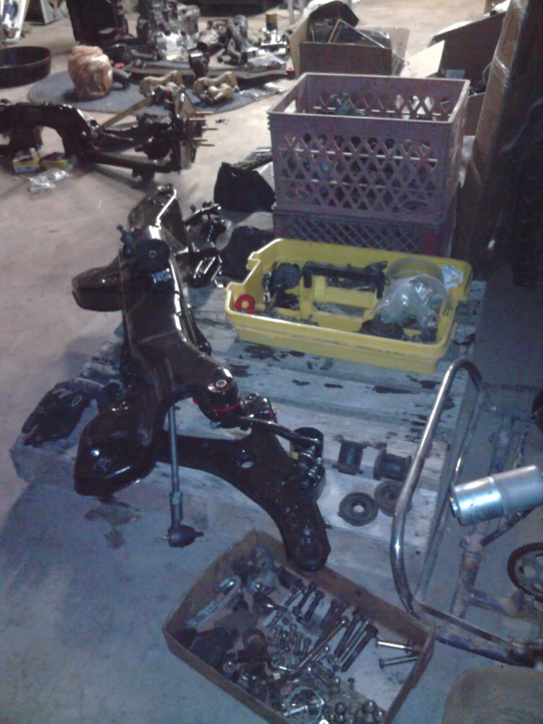

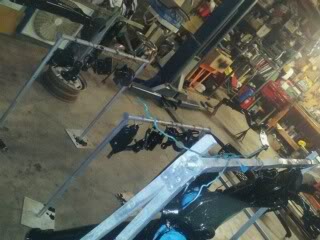

Subframes removed.

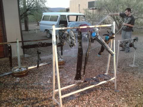

Subframes cleaned and ready for some new bushings and paint.
My buddy JJ working the hose.
POR15

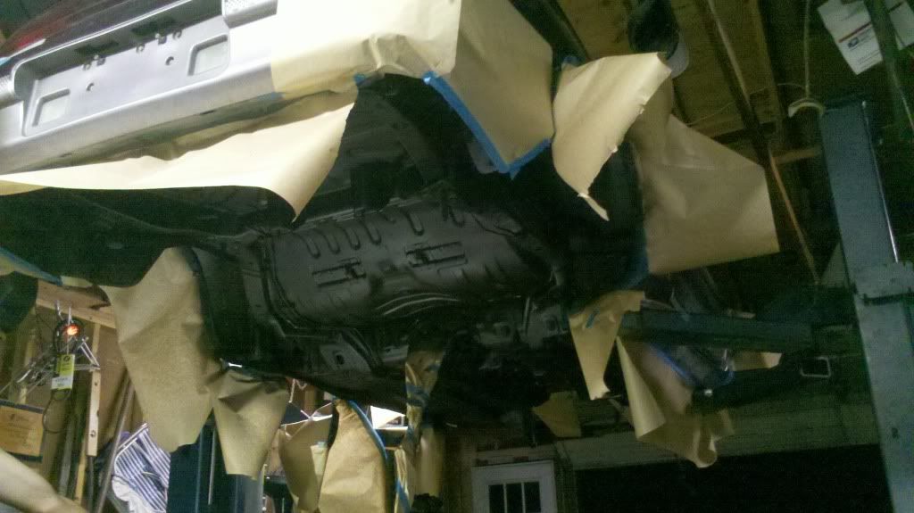

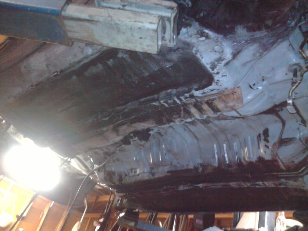

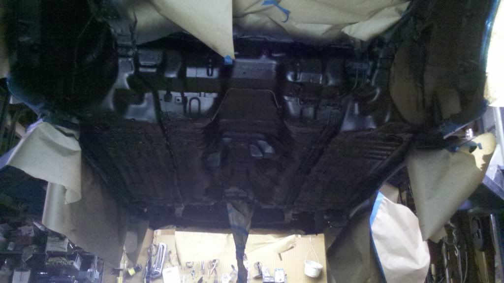

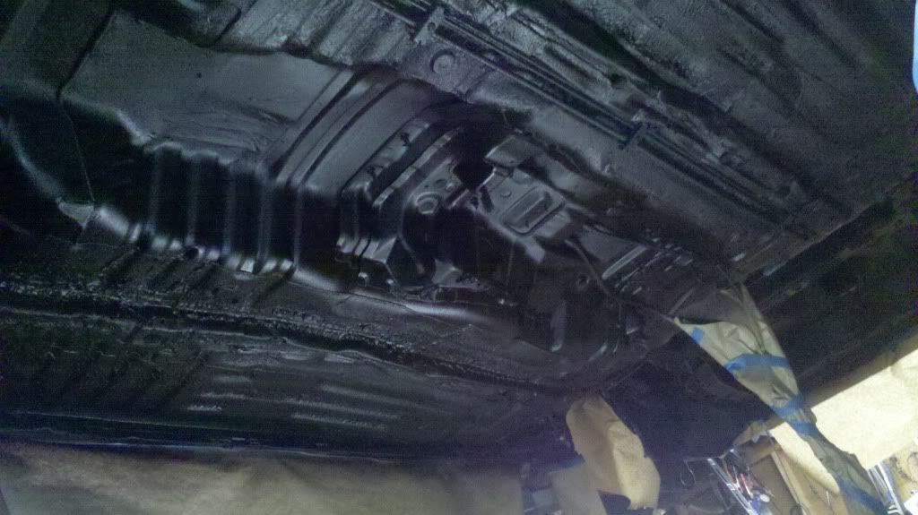

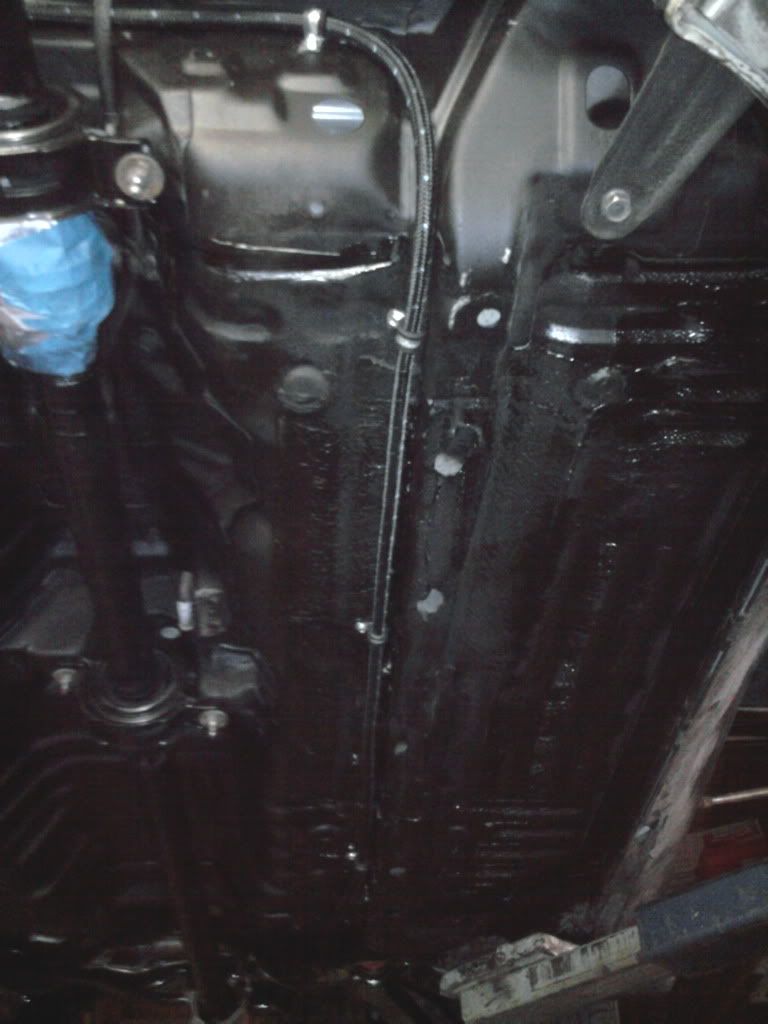

Since the sub frames got a good cleaing I had to show the underbody some loving.
Unerbody cleaning.
Underbody painting.
Underbody painted

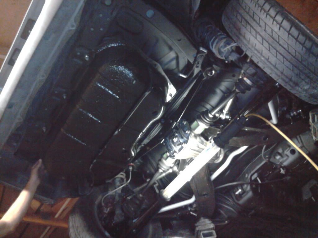

Also got the sub frames and hubs put together with new wheel bearigs, ball joints and tie end rods. New rack an pinion in the front.
Cant wait to get this beast one the road.

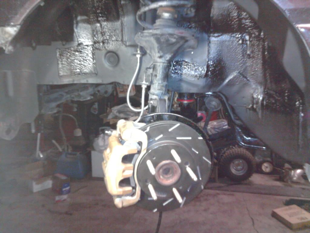

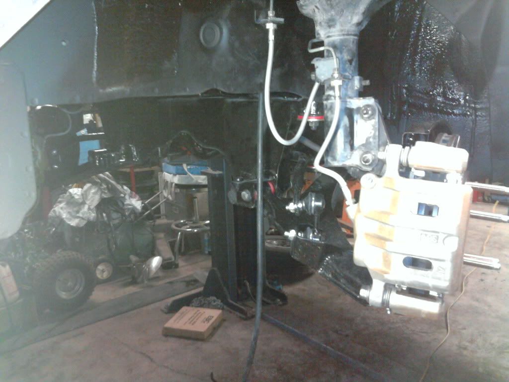

Subframes and big brakes done.

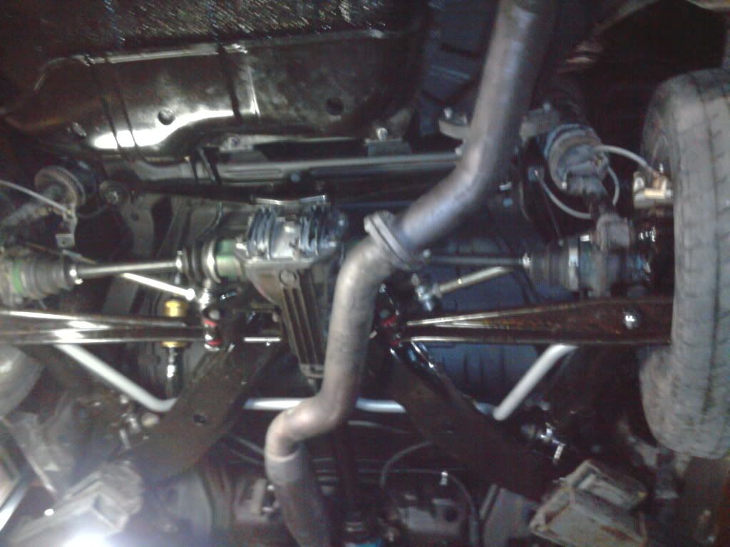

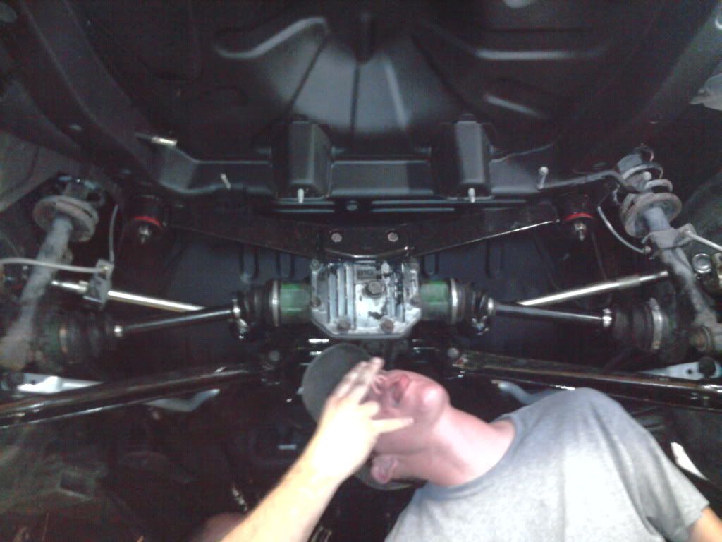

Rear differential in, every lady needs to have a nice 4bolt rear end

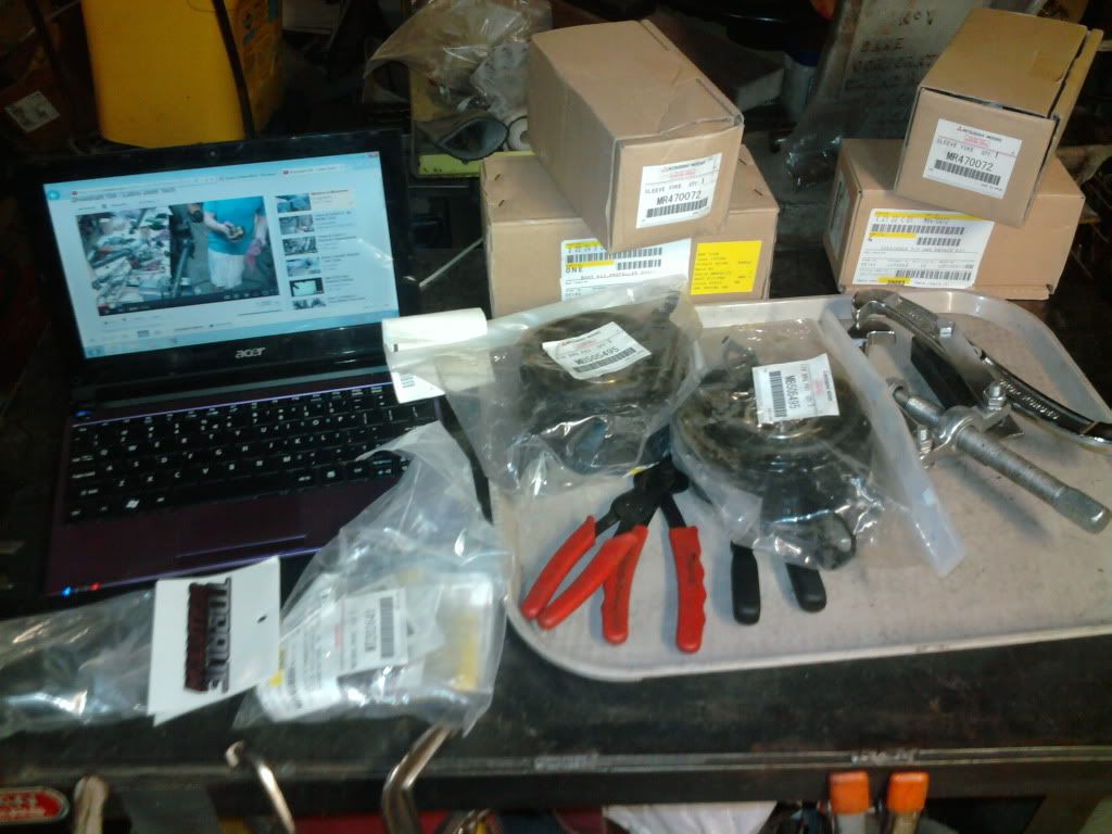

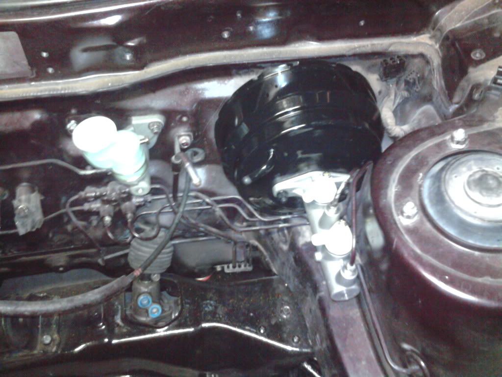

New brake an clutch master cylinder.

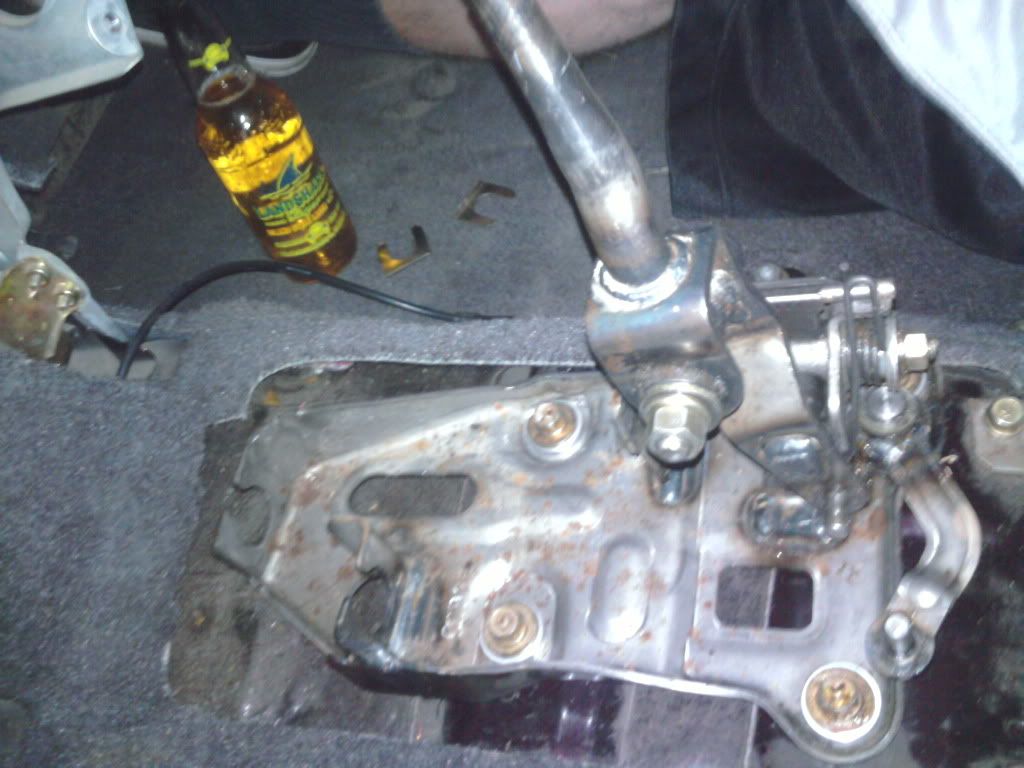

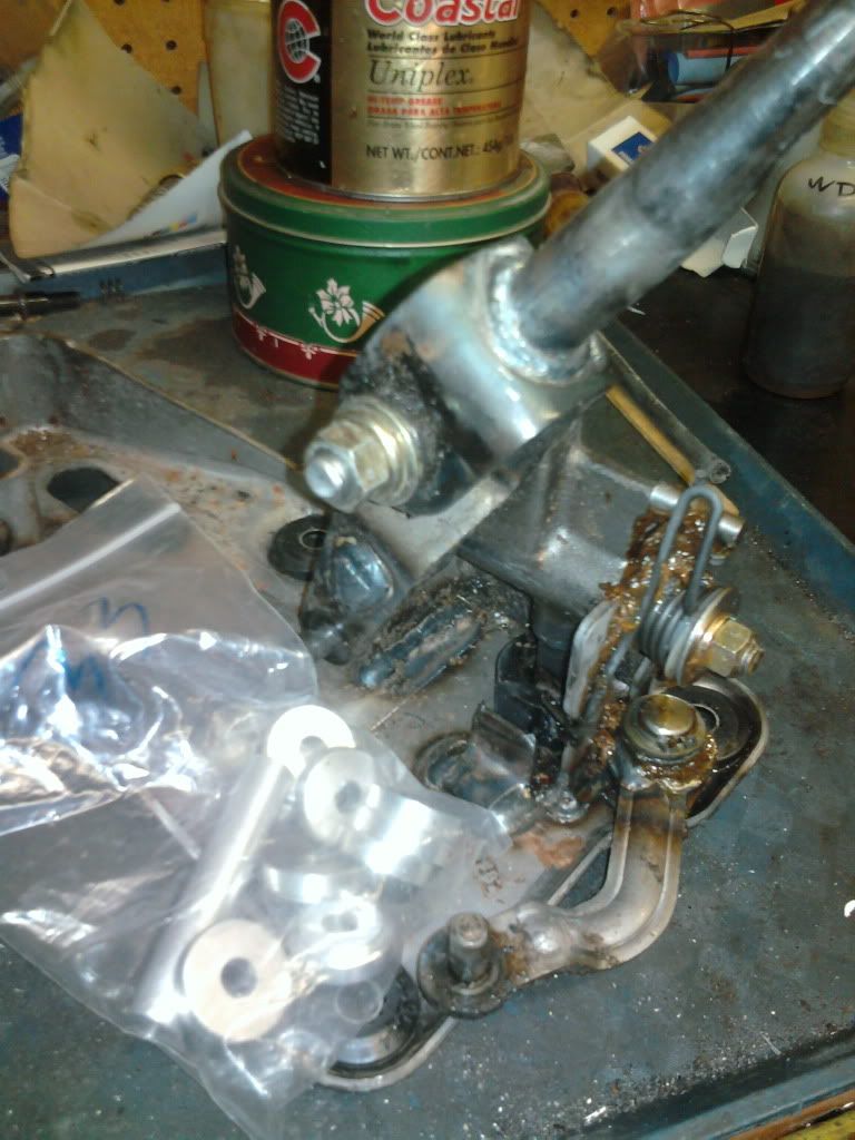

Symborski shifter bushing kit.

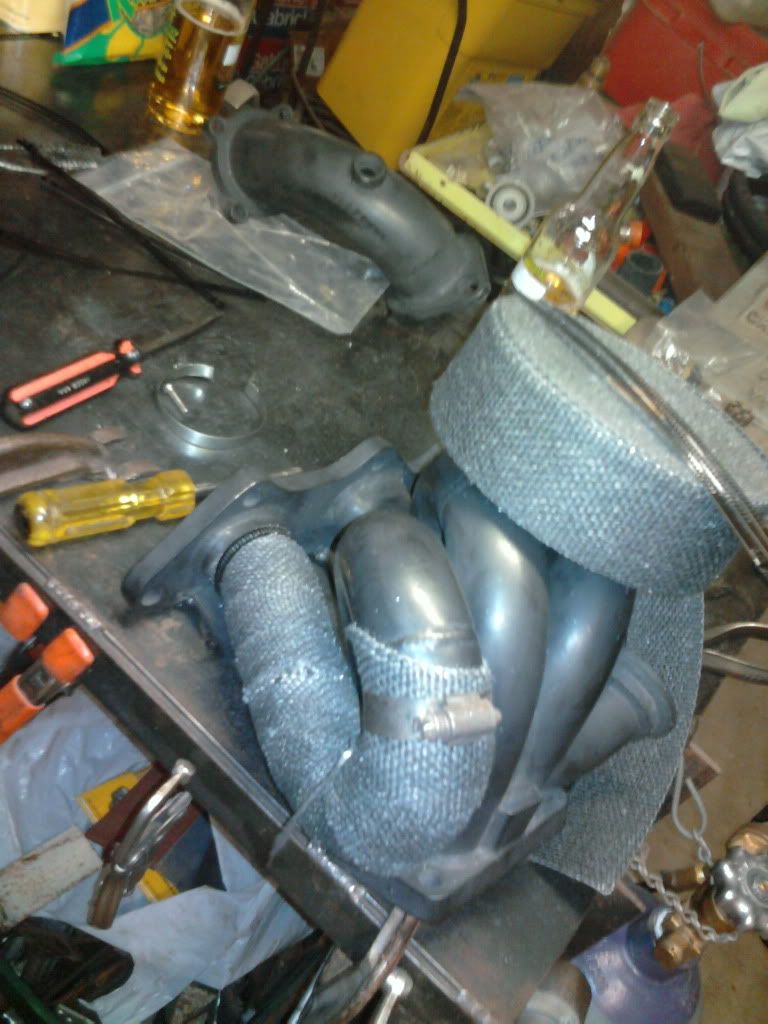

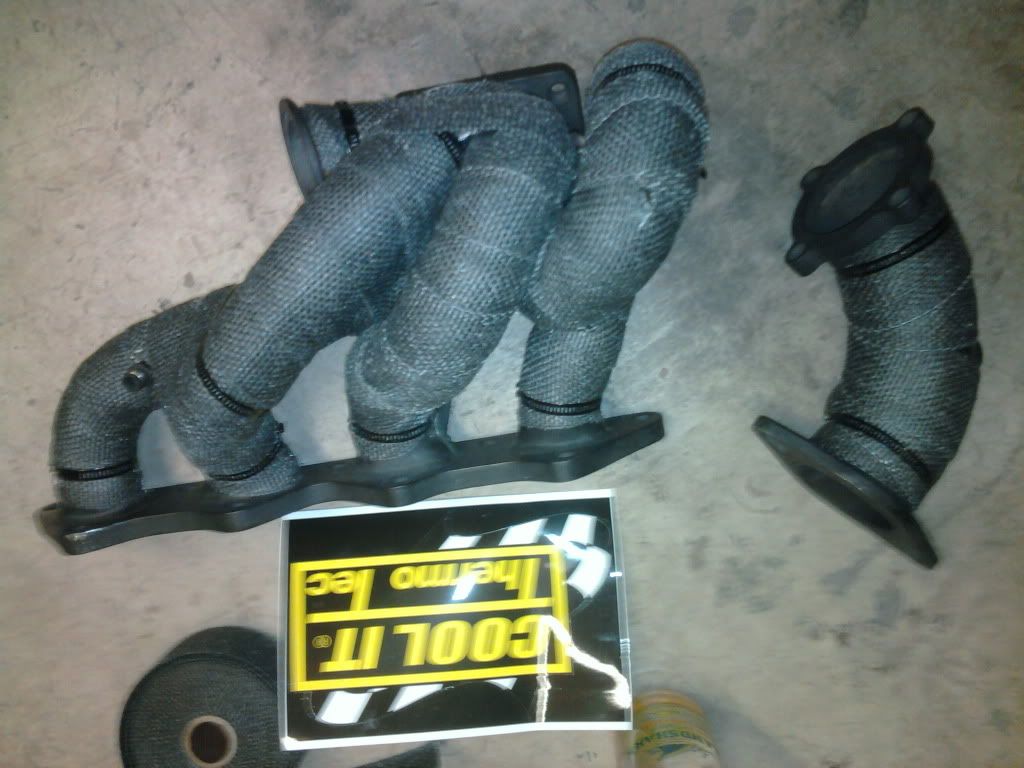

Header wrapped

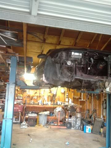

I love the lift in the garage!!!.
its either a badass garage/shed with a lift.
or a shitty looking shop with a lift.
Glad to see a DSM being saved/restored. Expecially by someone with a good head on their shoulders.
Car looks to be rather clean rust wise. Keep it up!
Looks like a good build you have started there!
Keep it up and keep us informed.:hellyeah:
Its my friends uncles four car garage with a two post lift on one side. Has just about every thing a shop does witch makes this build titties:hellyeah: Thanks uncle Jim your the shit!

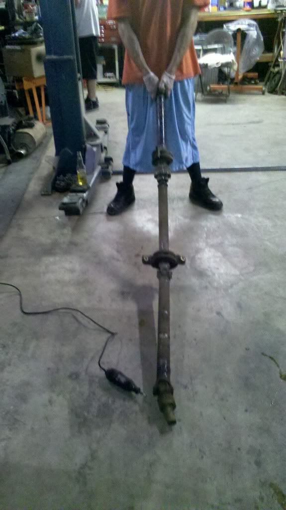

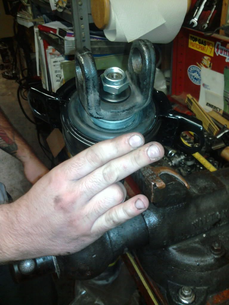

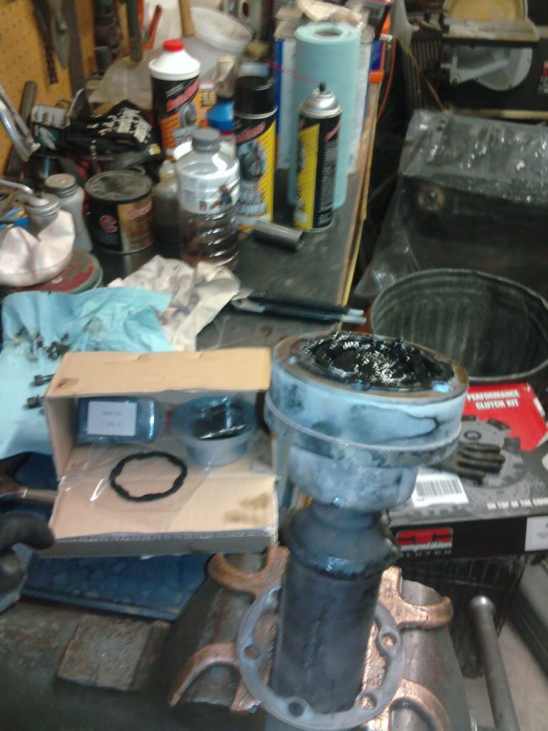

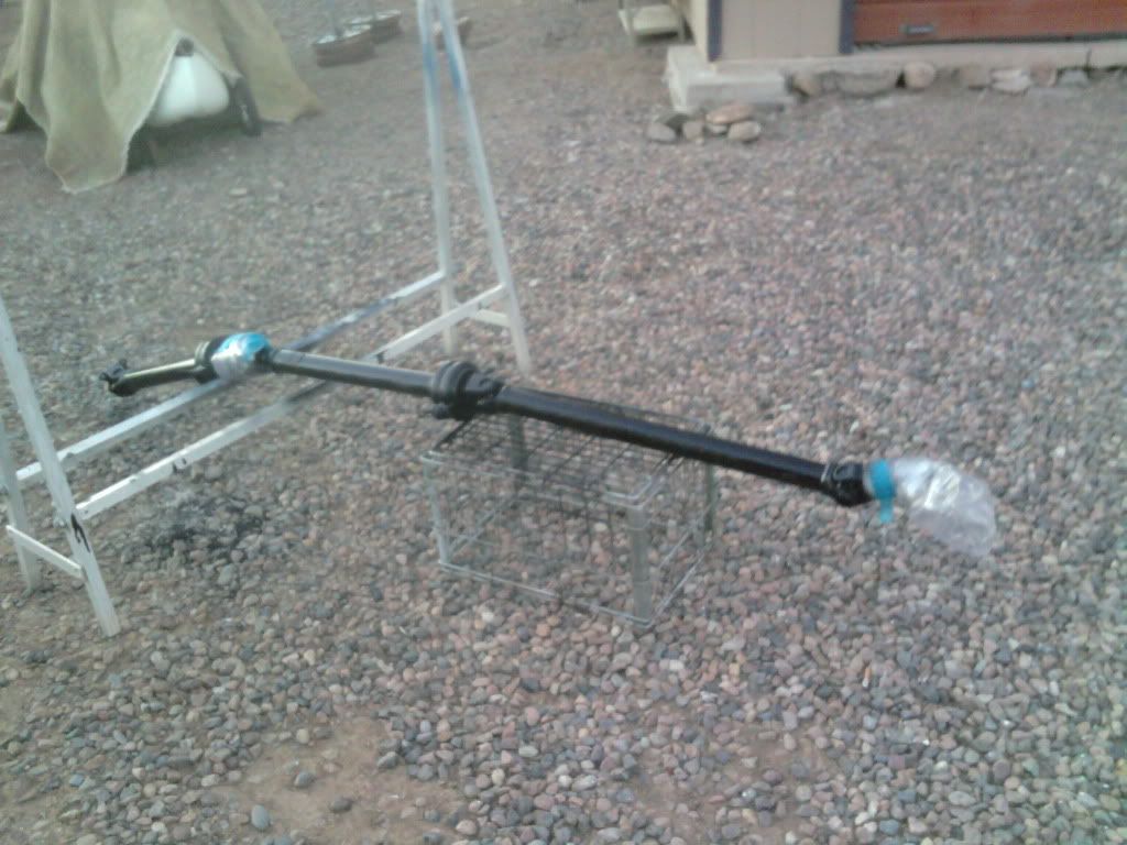

Thats one dirty an beat drive shaft... lets rebuild it :aha:
Then we paint.

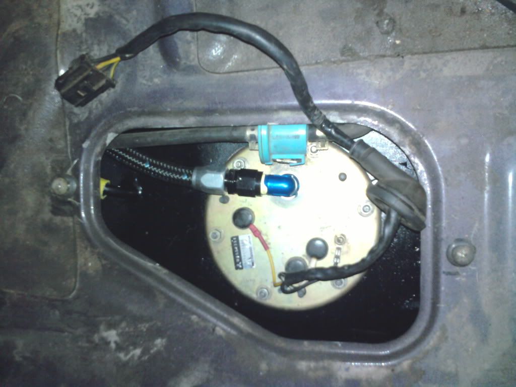

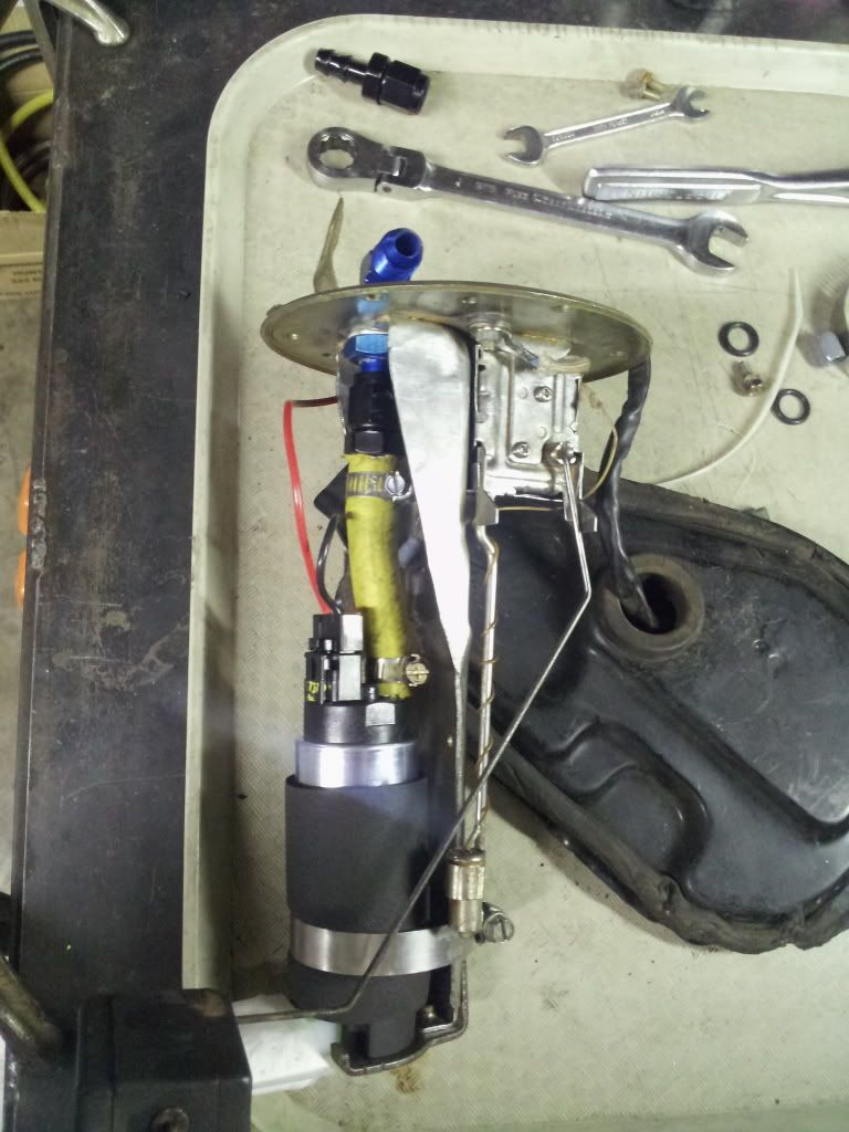

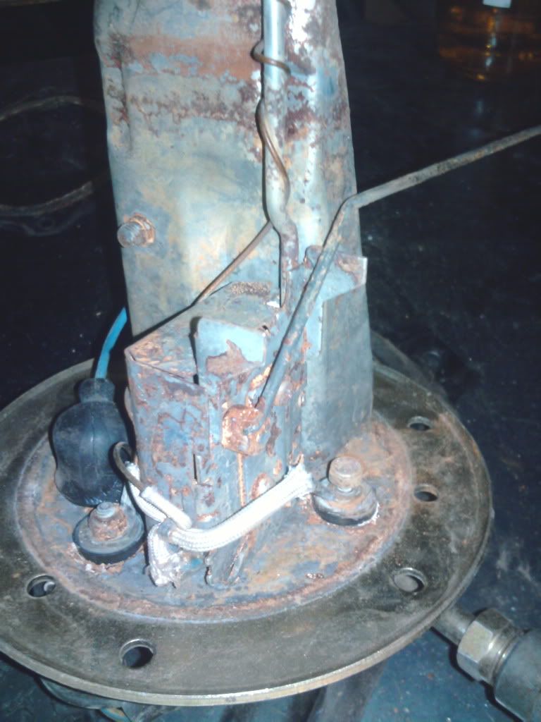

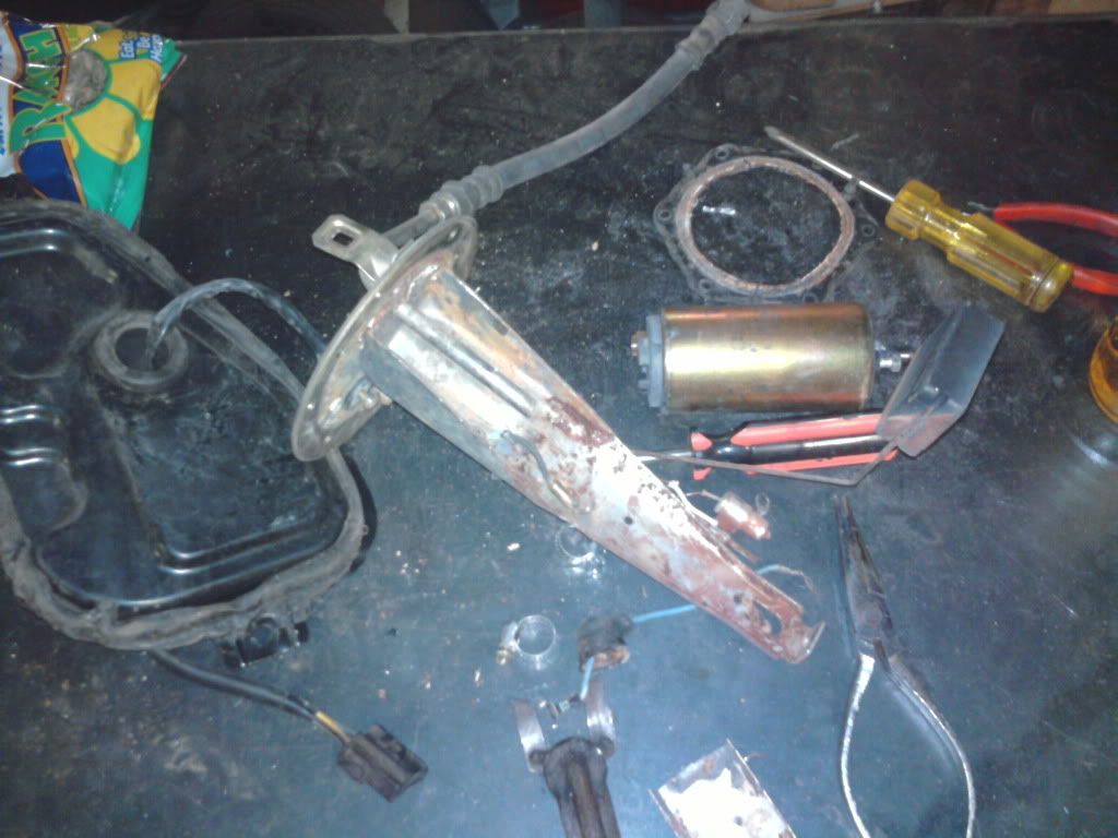

fuel pump / sending unit.
Walbro 255

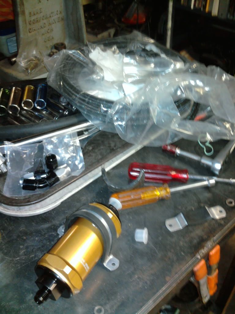

STM fuel tank to rail kit.

Fuel line done.

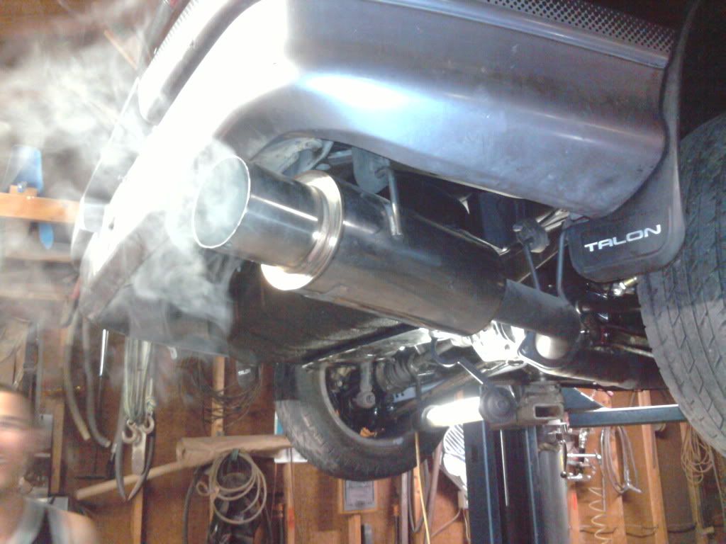

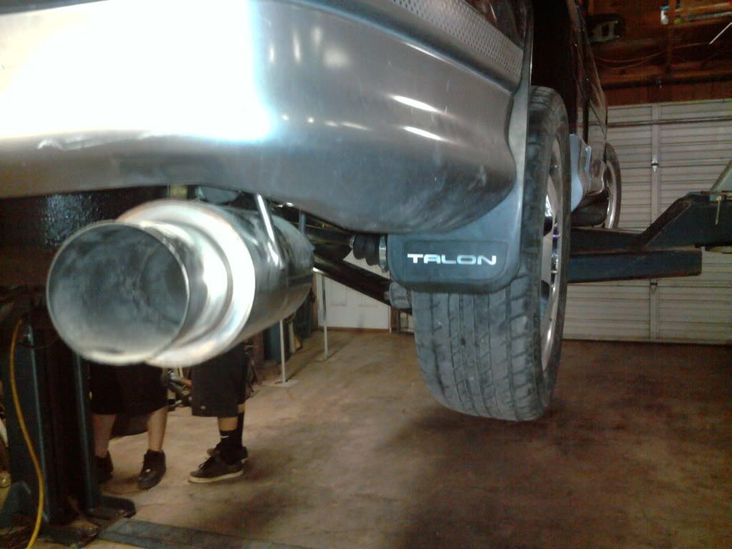

Drive shaft and Apexi in.
Mmmm mudflaps! Took a few years to find these.
PURP SMOKE

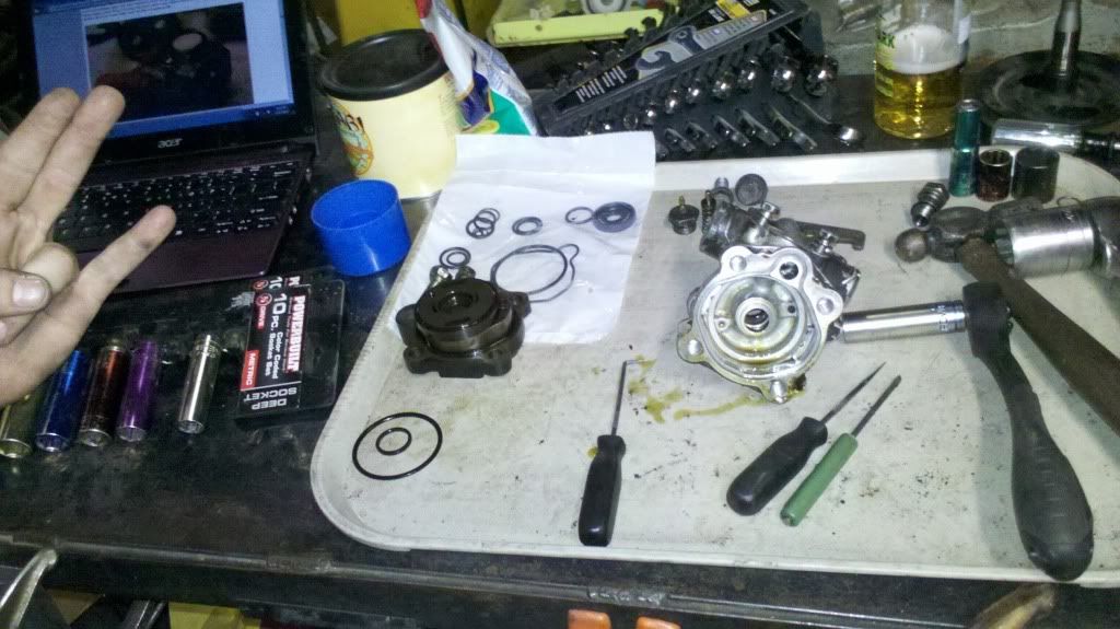

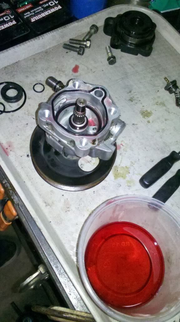

Power steering pump rebuild with hi flow control valve modification

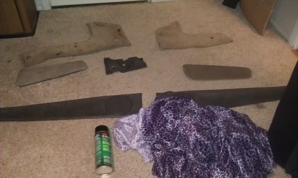

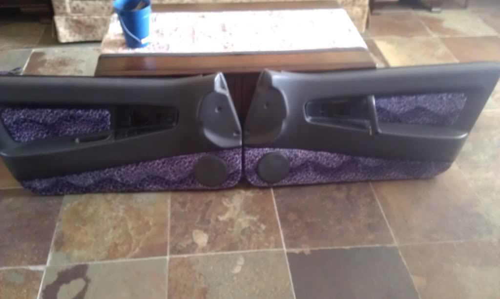

Been kinda busy the last few weeks but I was able to get some interior done. Let me know what you guys think.

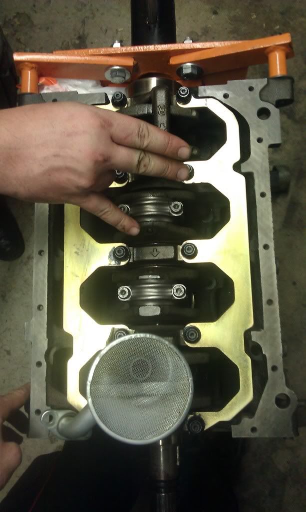

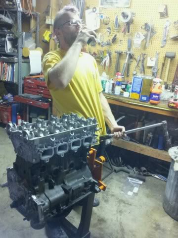

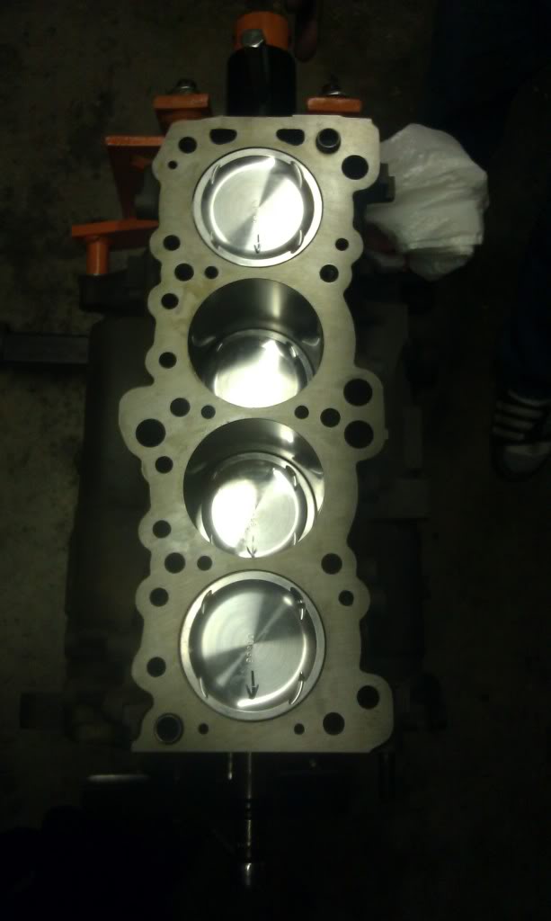

Started putting the motor together an fabing up the FMIC last night more pics to come! Thanks again for the support and stay tuned for more PURP updates.
Hey tuners got a few pics to update this build, Works been crazy so progress on the car has slowed once it gets nice out I will be all over this talon!
Thats me after I gave it a good tourqing!
