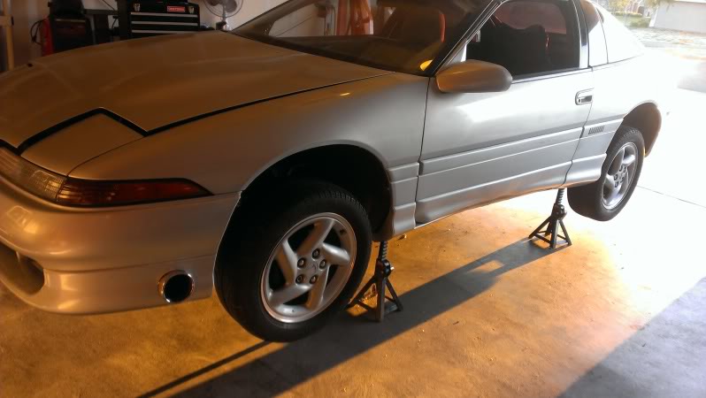

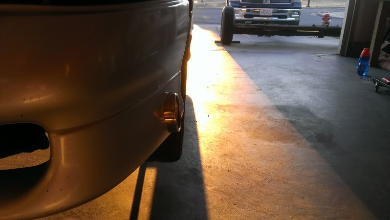

Got the exhaust pretty much finished. I might go back and add a shield around the exhaust tip. The tip is a 3" inlet, 3.25" I.D. resonated tip (barely anything, more like resonated design inside the tip than an actual working resonator) with 3.5" O.D. Should work decent. Just the clamp on type so I can get the tip lined up decent with the bumper and so I can loosen it if I need to pull the exhaust off!
Let me know what you guys think. Track results from a few shakedown passes should be coming soon!!!

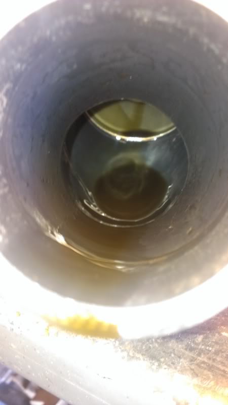

As you can see, the 60' times and 1/8th mile continued to improve, but starting on the 3rd run there, the 1/4 mph started dropping off. That being said, in the last run (I'll post the video) you can see the car smoking through the muffler. Burning oil. Airflow was down from high 180s-190s in 3rd gear to 150s. Thought for sure the turbo was toast. After looking today after work, there was probably around 5-6 oz. of oil in my intake pipe. There was a very little bit on top of the manifold that came out of the v/c gasket. When I checked the oil level, it was just over a quart low!! Did a boost leak test and only found 2 small leaks...one from the j-pipe (which I knew was there) and my fittings on my MBC had a slight leak...both around 13-14 psi. I was running about 15psi at the track. Pulled the intercooler pipes and they were coated with oil. I knew if oil was pushed through the piping, the stock intercooler probably had a bit of oil in it...3 red shop rags worth of oil in it! After looking further, I found that my catch can was full of oil. So it was pulling oil from the catch can into my intake and then blowing it through the engine. My catch can is only about 15 oz or so, however, it pulled this much oil in three 3rd gear pulls on Tuesday (checking the car out before the track) and the 3.5-4 runs at the track (with burnouts). No idea why I am getting so much pressure in the v/c and why it's blowing so much oil through. My catch can runs uses a line from the stock v/c fitting and then to the intake with a filter on top of the catch can. I also have the PCV valve replaced with a barbed fitting and another hose going from there to the intake to pull more air out of the v/c. The stock PCV valve fitting on the intake manifold is plugged off. I'm going to do a compression test soon just to make sure everything is ok. I never saw a single count of knock all night. As Justin mentioned, I'm going to get a new knock sensor to be on the safe side. The one in there now is a 'resealed' knock sensor!
