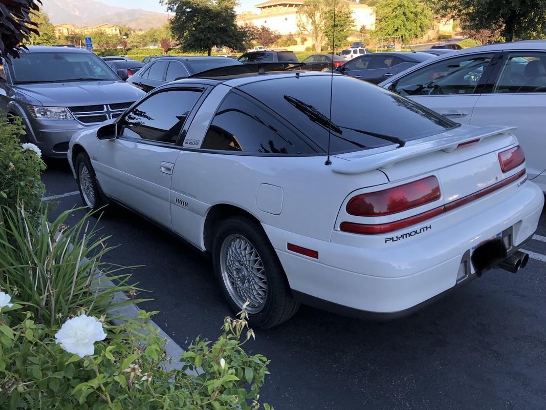

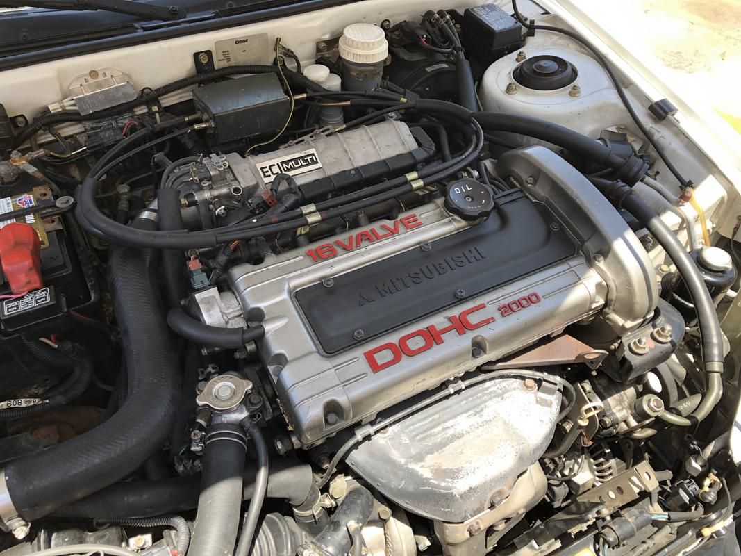

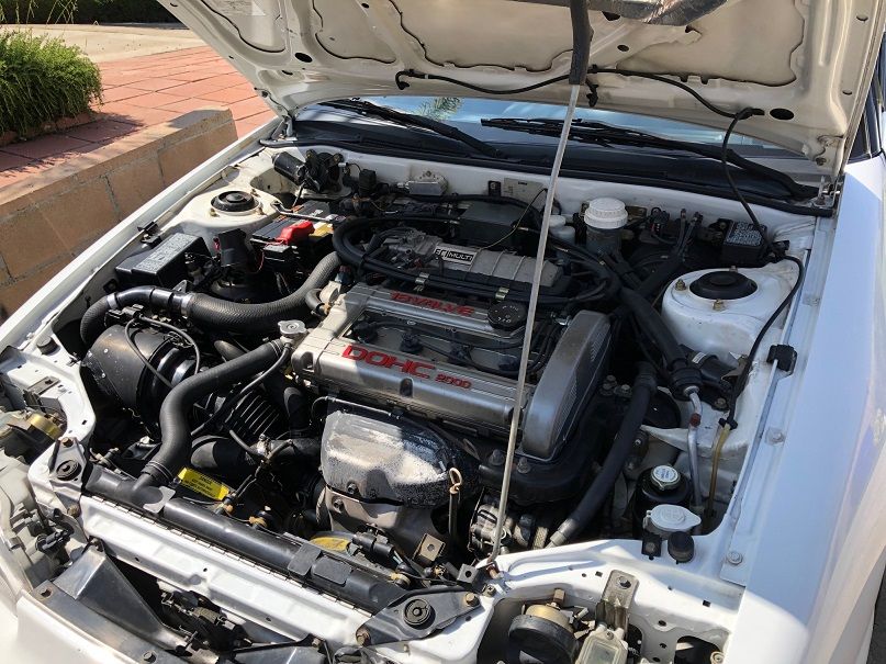

But............... it all changed last week when i stumbled upon title subject 1992 Plymouth Laser RS AWD. This damn thing is honestly the nicest DSM ill have ever had and it took me 20+ years to find it hahaha. It was owned by the original elderly couple who bought it from 1992 until 2017. I bought it off the 2nd owner who had it for the last 2 years. I was able to grab it for $2500 with current tags, a current smog check (California boo), and in good running condition.
It feels like it's pulling timing at low speed before boost so i will dig into that and correct it, but overall it runs fantastic. Over the years i have (like most of us) stock piled endless parts for these cars. I could literally build 2 or 3 complete longblocks and 2 or 3 transmissions from the parts i have laying around.
Plans for this car are a high 11/low 12 sec street bruiser that lives on e85. I would like to run a good amount of timing (21-23*) with e85 and 21-25 psi boost.
Planned parts list for 375-400whp:

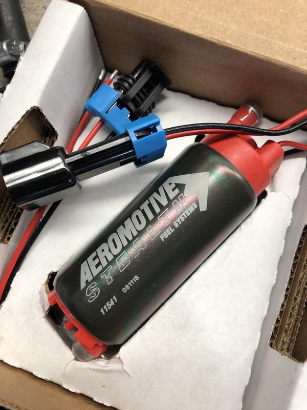

--DW 340 pump

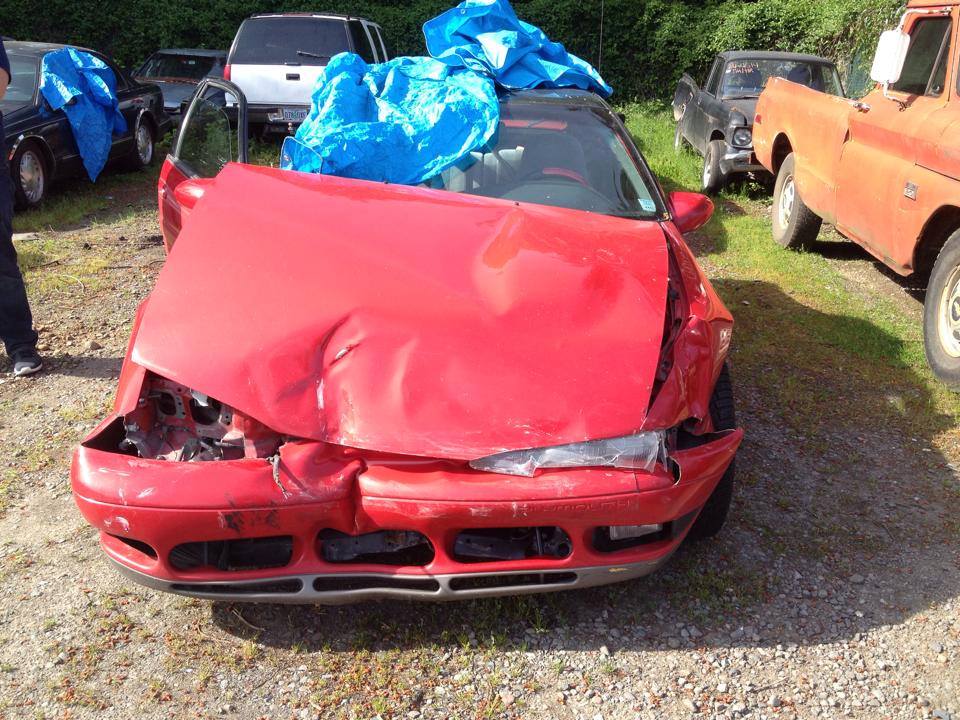

i miss my old 94 awd laser. was near mint condition, like yours. only had 90,666 miles, when i bought her in 2013. my current 94, is sort of that car's offspring. we swapped everything that was left from my wreck (lady ran a red light in a jeep compass and i T-boned her going about 45)... and here we are now LOL

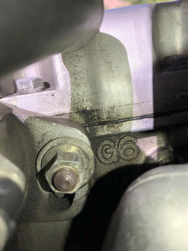

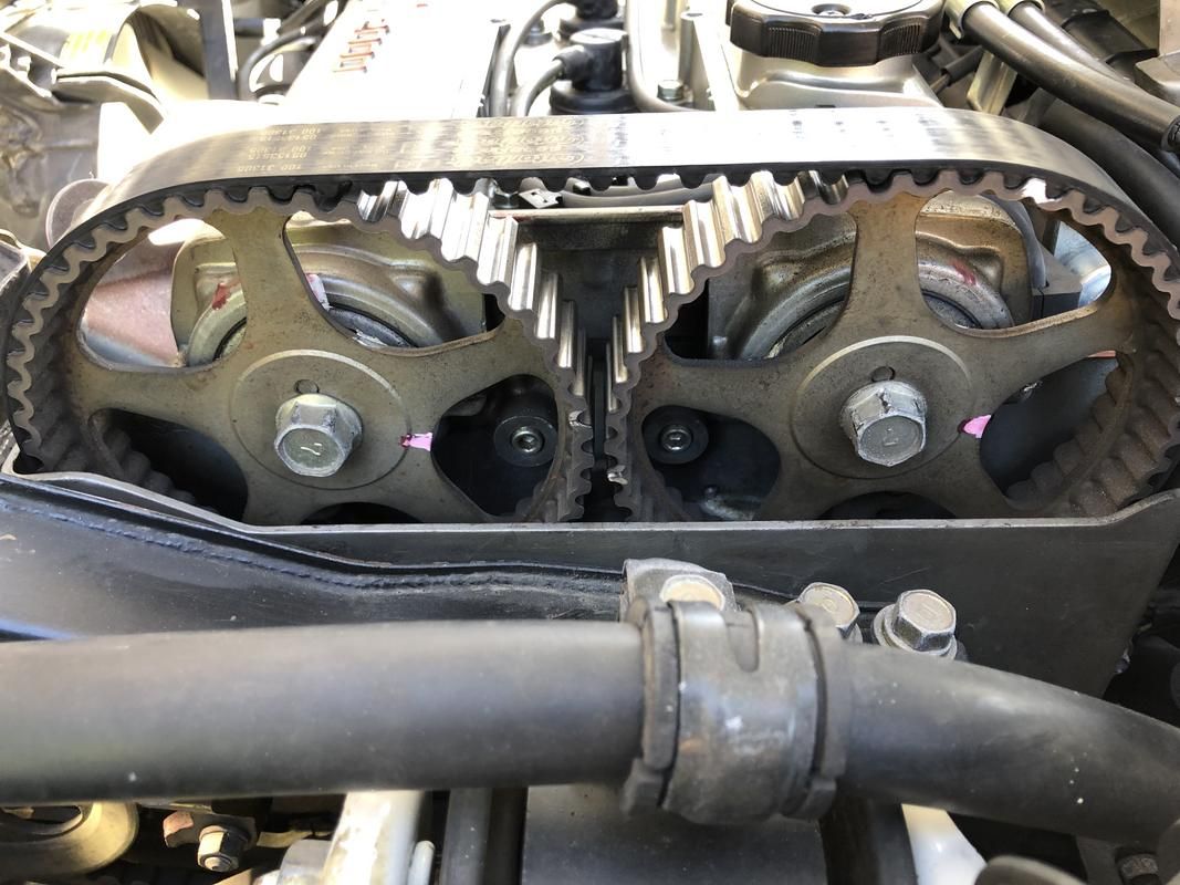

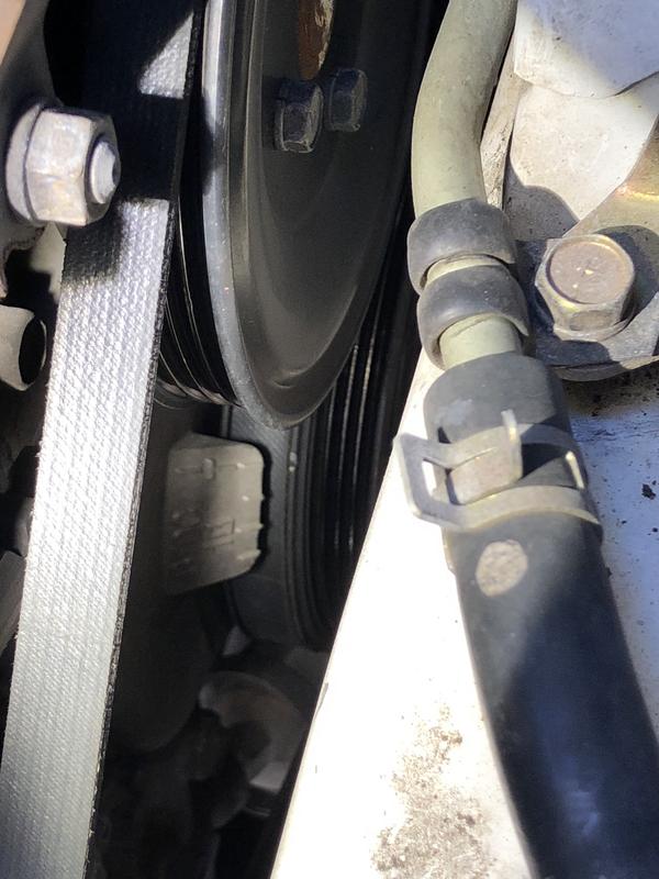

A true DSMer can appreciate this. I’ve built more 4g63’s than I can remember so I know how important proper cam timing is on these cars.
When I bought this car, it was down on power, felt like it was pulling timing. It’s 100% stock, so not a rocket, but still I felt it should have had more power.
So I checked base timing. Was waaaaaaaaaay off and too far retarded. Fixed that but had to almost bottom out the CAS to get to 5* which got my mind spinning about cams.
Anyway... finally got around to pulling the belt cover and found this bullshit. SMH... oh well. Looks like I got me a little project tonight LOL!
Got cam timing corrected and car is good. Installed new gates OEM style timing belt while I was in there.

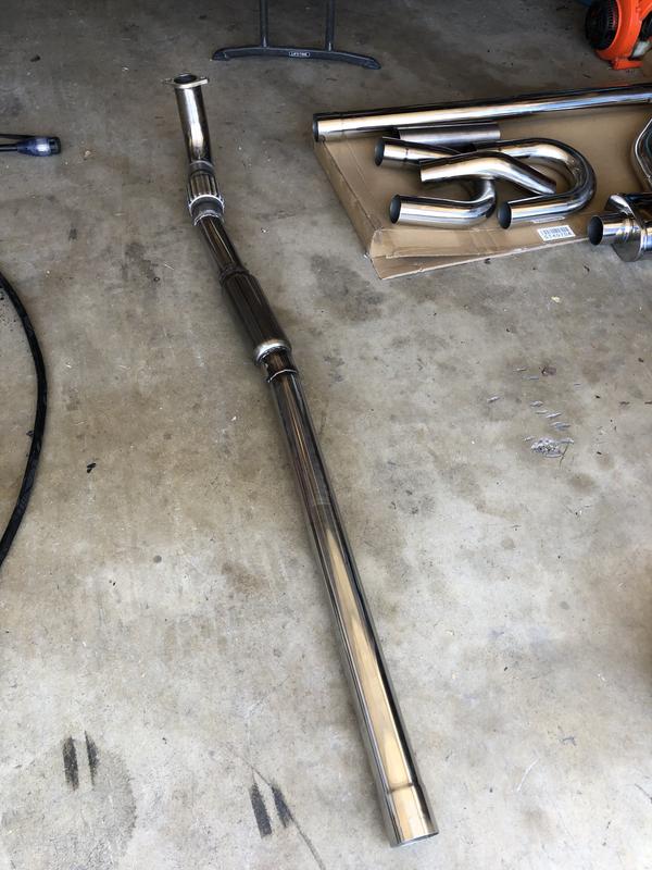

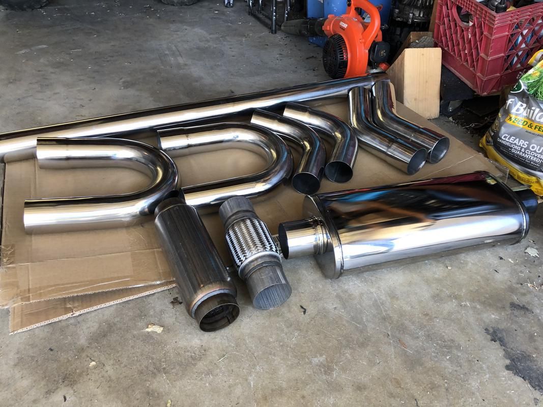

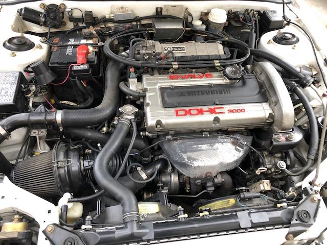

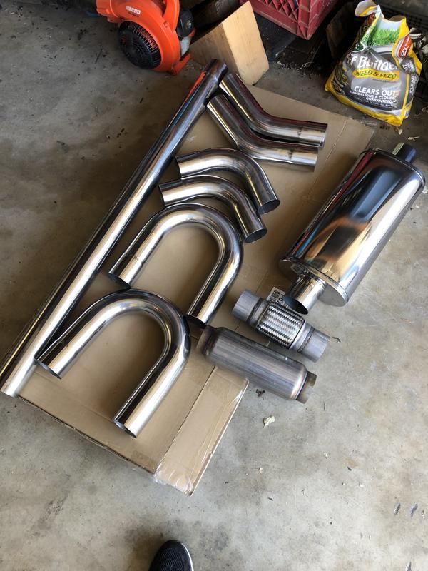

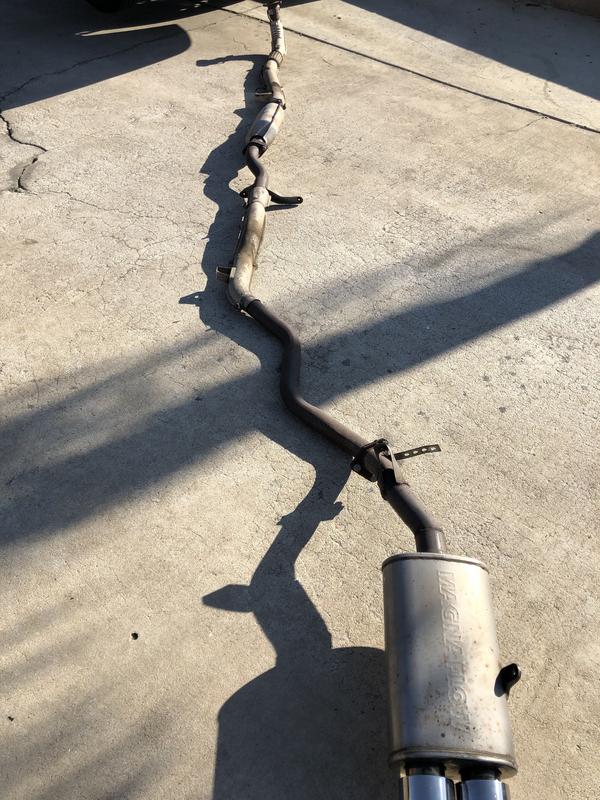

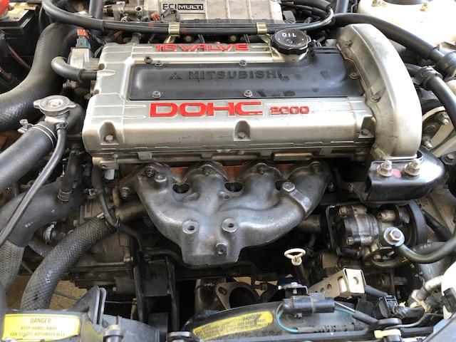

Started on the exhaust last night. Removed everything including o2 housing.
Installing evo3 o2 and all new 3” stainless exhaust. Got downpipe fabbed last night... should have rest done today.

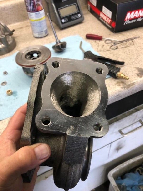

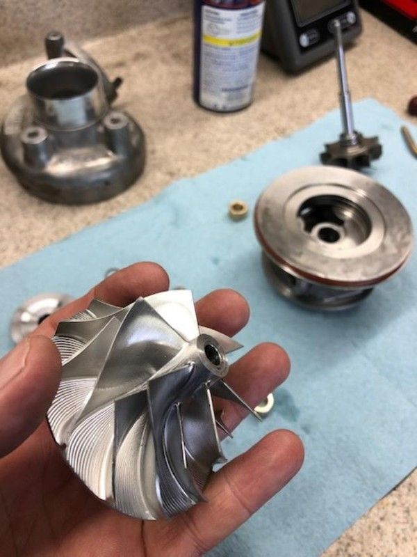

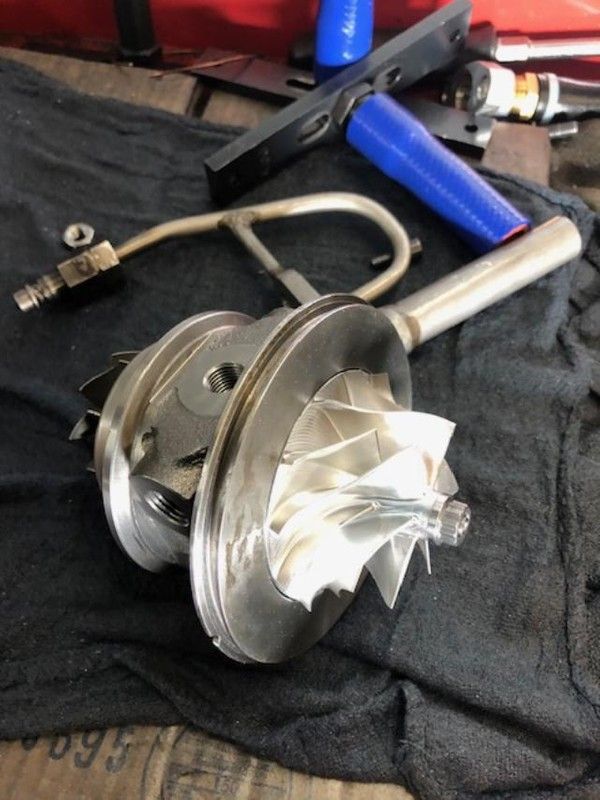

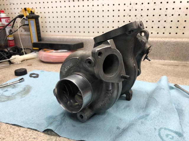

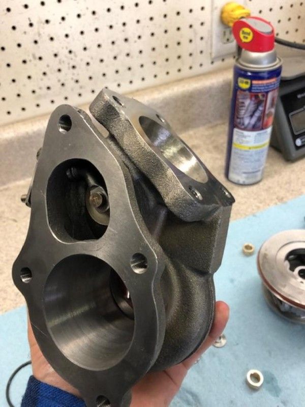

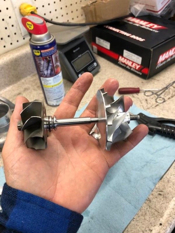

Got around to upgrading the turbo. Bastard (sleeper) billet 20g with a new 9 blade td05h turbine.

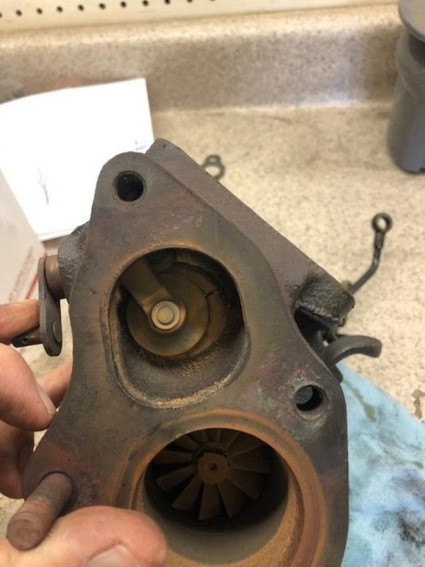

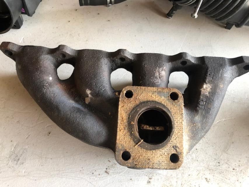

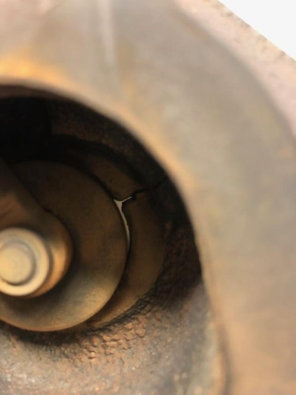

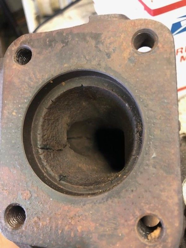

As i tore the old turbo off, i found out why my stock 14b wasnt hitting full spool until 35-3700 rpm LOL. The car had an automatic exhaust manifold LOL! It also had a turbine housing that was badly cracked around the wastegate hold causing the slow spool. Not good!

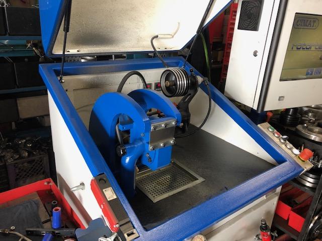

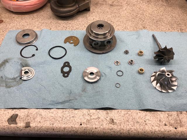

Assembly of the sleeper billet 20g. Had the rotating assembly VSR balanced at the local turbo rebuilding shop. Cost me $75 for the balance job.
Turbo specs:
6 blade billet 20g compressor
new center section

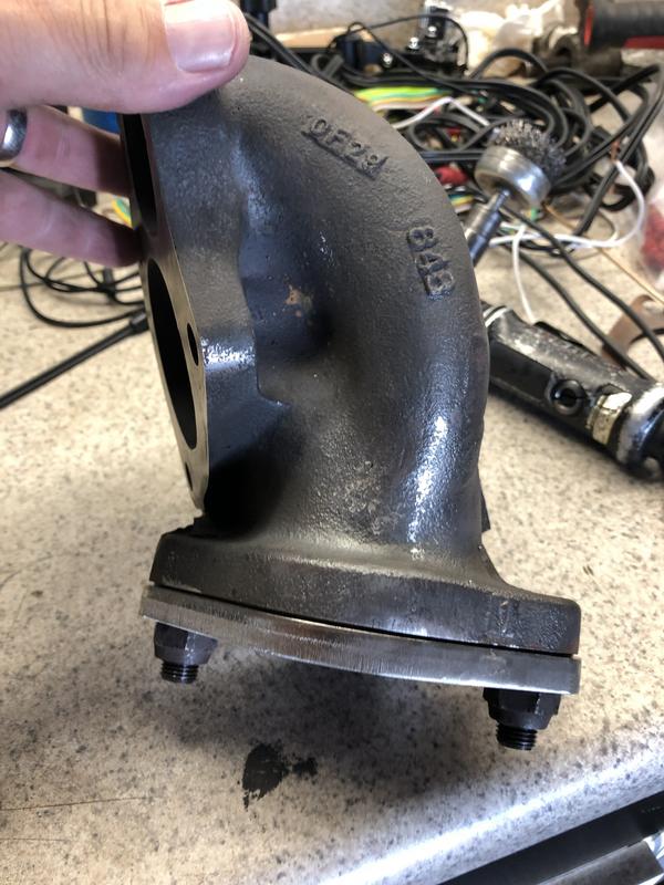

new 7cm ported turbine housing with larger WG flapper

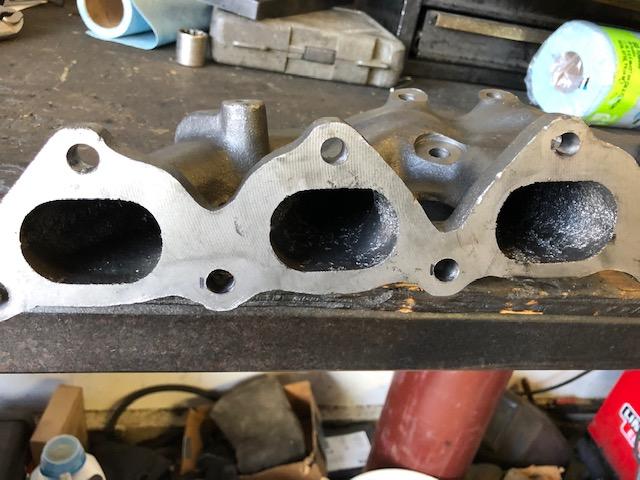

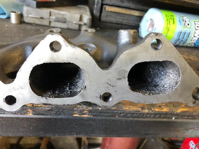

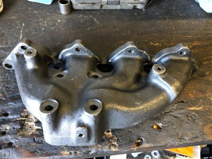

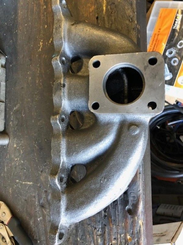

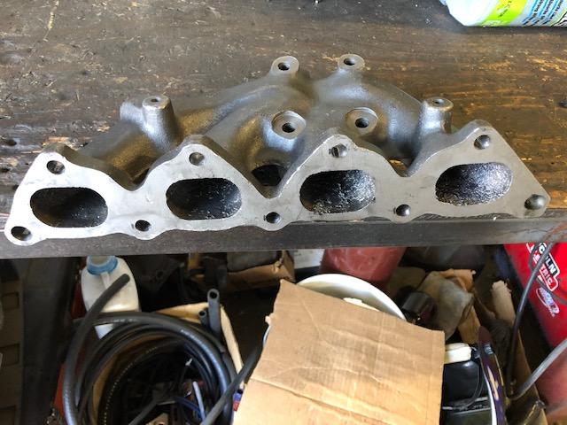

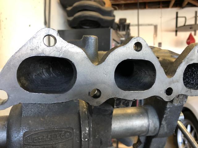

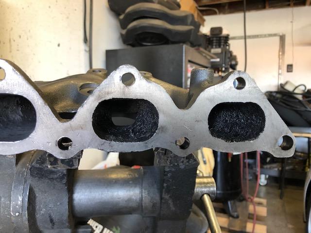

So after realizing i had an auto exahust manifold, i bought a 2G repro (china) manfiold off of rockauto.com for $100.

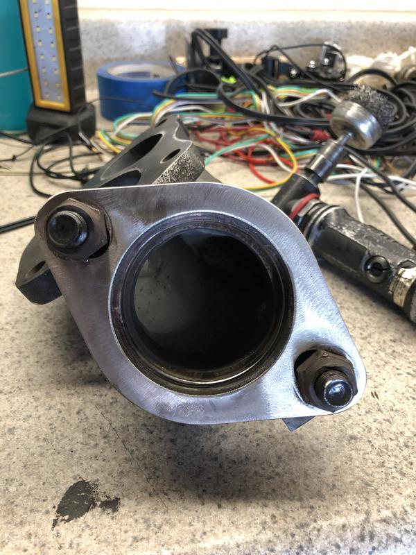

These things come ROUGH... if you dont have a porting bit, dont bother buying it. The runners were real bad and some of the stud holes had to be elongated to get it to bolt onto the head.
Not a quality piece IMO, but for $100... whatever.
After some porting work, it came out just fine.
Pic 6 is after 5 minutes or so of porting.

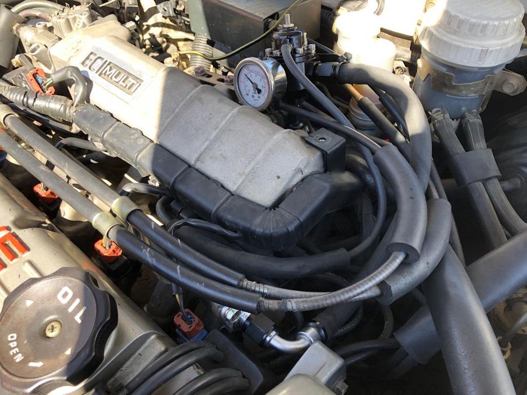

Out with the AFC, and in with ECMLink V3 along with an EVO 8 MAF. Also added new FIC 1220cc injectors and an AEM AFPR.
Car is now on full e85 and runs AMAZING! Good stuff.
