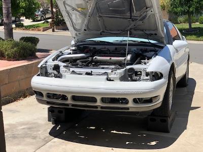

1992 Laser RS build. 2 owner car
Clean, unmolested 2 owner car.

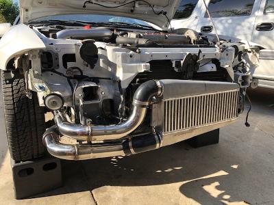

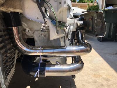

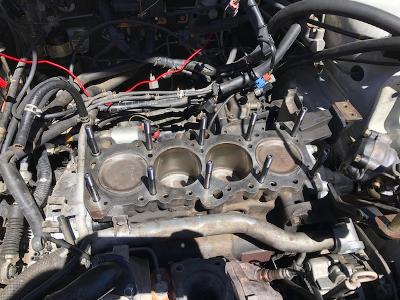

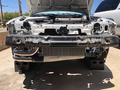

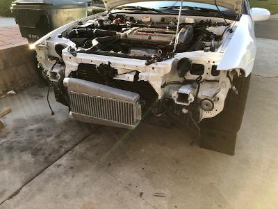

Mod bug has bit hard. I told myself i was not going to go crazy (and still not going to) but ive assembled quite a list so far.
--sleeper 20g
--FIC 1200cc injectors (e85)
--Full ECMLink
--EVO Maf

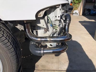

--3" custom turbo back stainless exhaust
--Evo3 o2 housing
And now

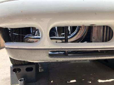

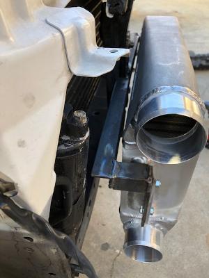

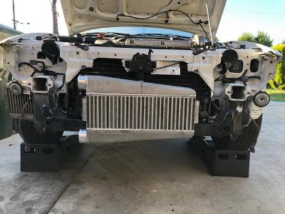

--3.5" Treadstone custom one-off front mount IC kit since it appears the VRSF unit is no longer available. I also wanted to keep my AC so short route IC piping was not an option anyway
--GSC S1 cams
--ARP studs

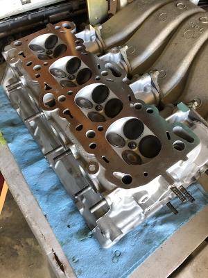

--Fresh head gasket, resurfaced head, fresh valve job, and new water pump
If my car's paint was in better shape our cars would be twins. What part of socal are you in? I'm near long beach. It seems like the community is dead around here now.
Im in the Inland Empire.. Redlands/Yucaipa. DSM'rs have always been a niche bunch around here.. even back in the late 90s/early 00's when I started messing with these cars. Sad because i really enjoy the platform.

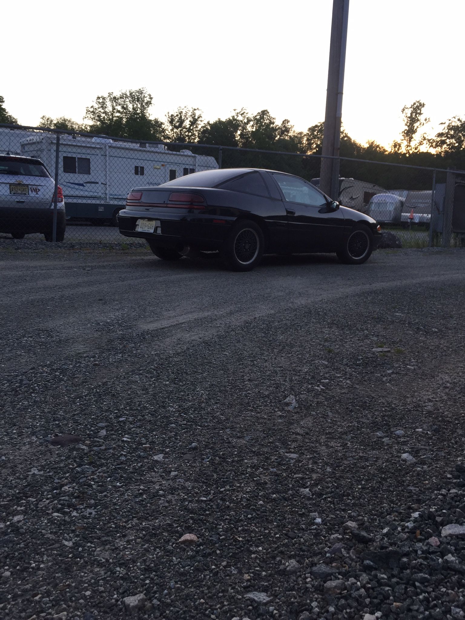

Beautiful car my friend, here is my 33k original mile Laser that will be undergoing a 2.4 swap soon.
Wow.. that Laser is very nice. 33k miles... amazing!
