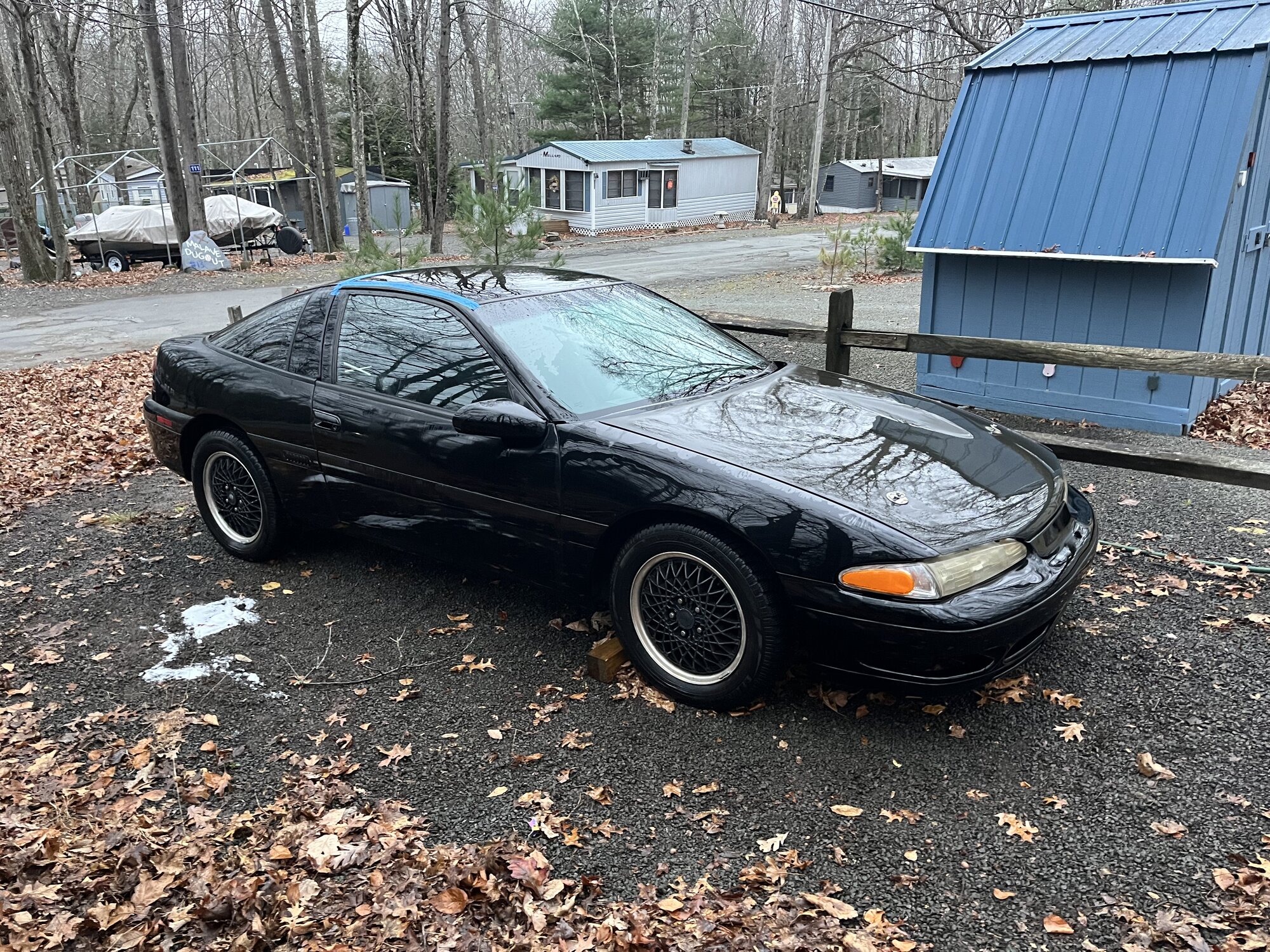

1992 Plymouth Laser RS

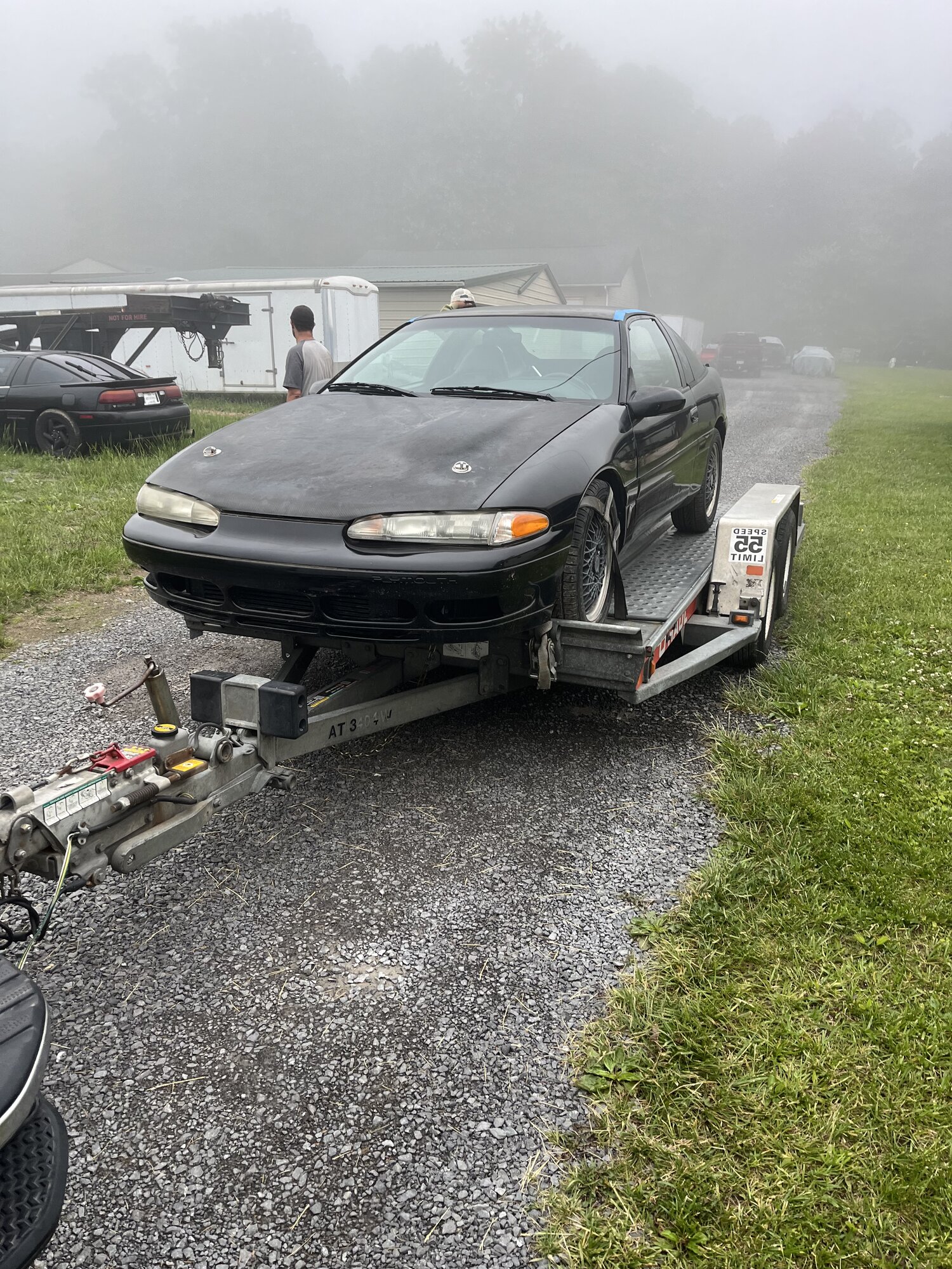

the car has been awoken from a long hibernation, it was transported to RIX RACING. ricky is going to button it up and get her on the rollers.

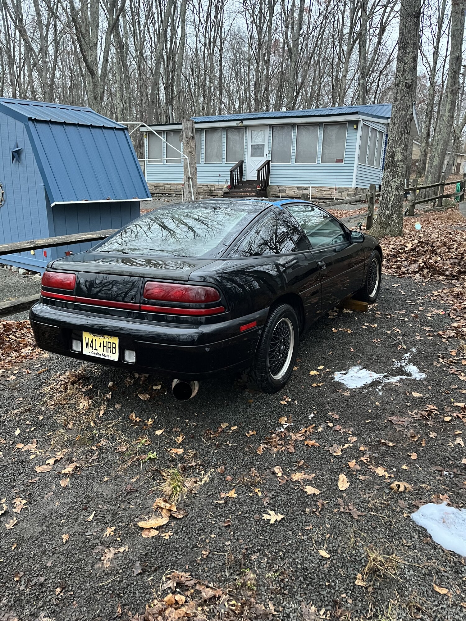

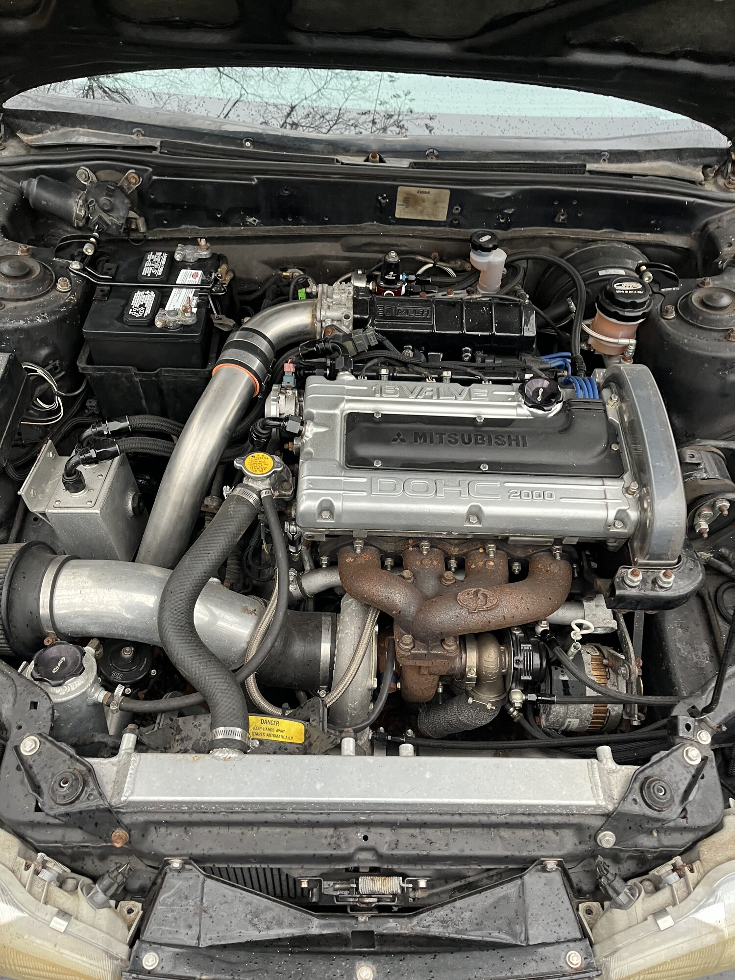

What exhaust is that on the car?
its got fp race manifold, fp vband o2 housing, and 2 1/2 down pipe to 3” flex section then 3” to an old school cool apexi muffler. the down pipe to the exhaust tip is a muffler shop job thats been on my car since i bought in 2006, not an off thr shelf piece.
Man I remember seeing some of those old Laser photos back in the day. Loved it. I currently have a black 92 Laser 6b/4b 5spd combo that I've ignored for the last 8 years. Can't wait to see it when you get it back from Rix

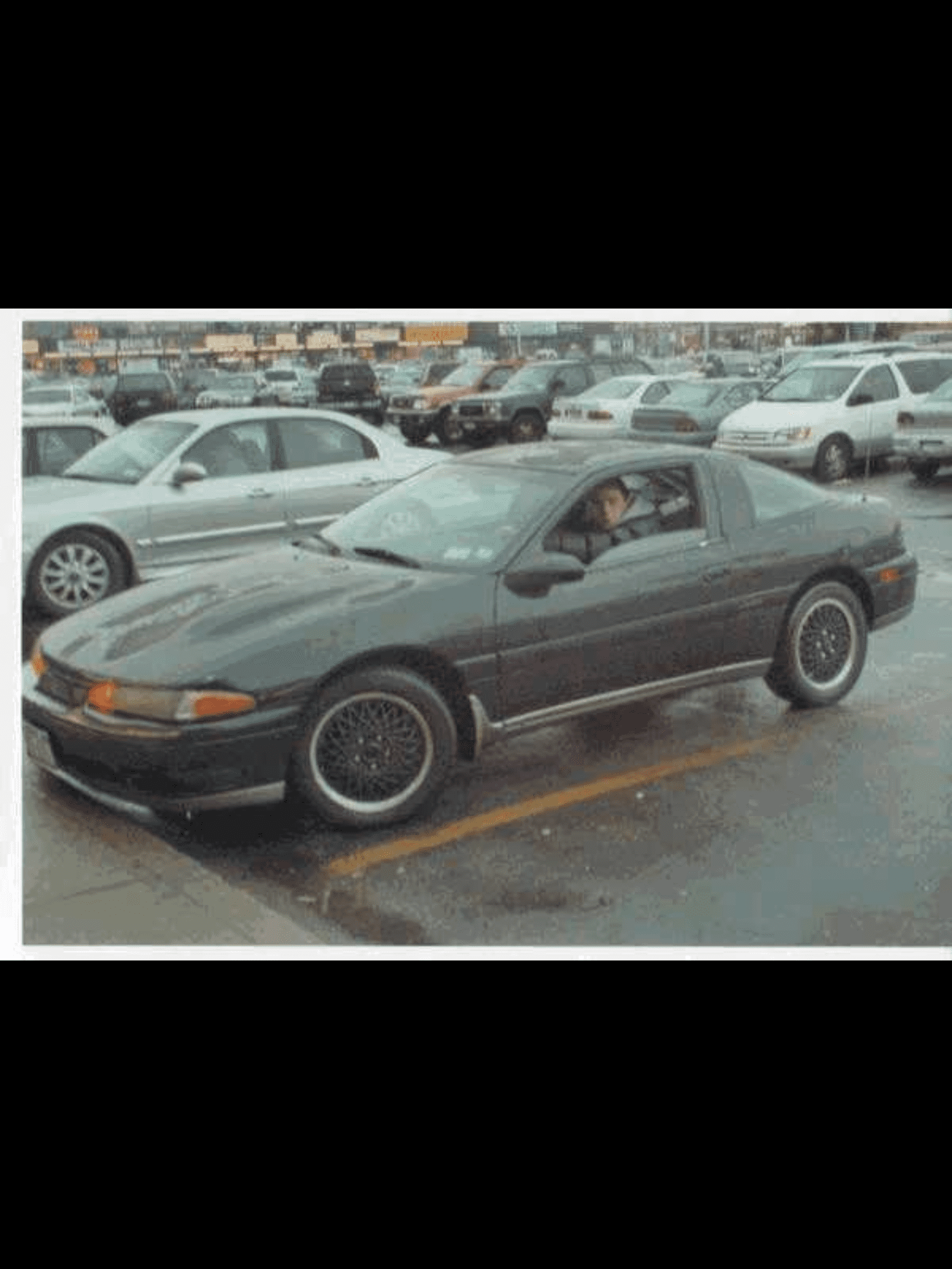

forgot i had these lil gems of dsm from the past.
i present my plymouth laser trading card and something from a forgotten time a post card LOL. 😂

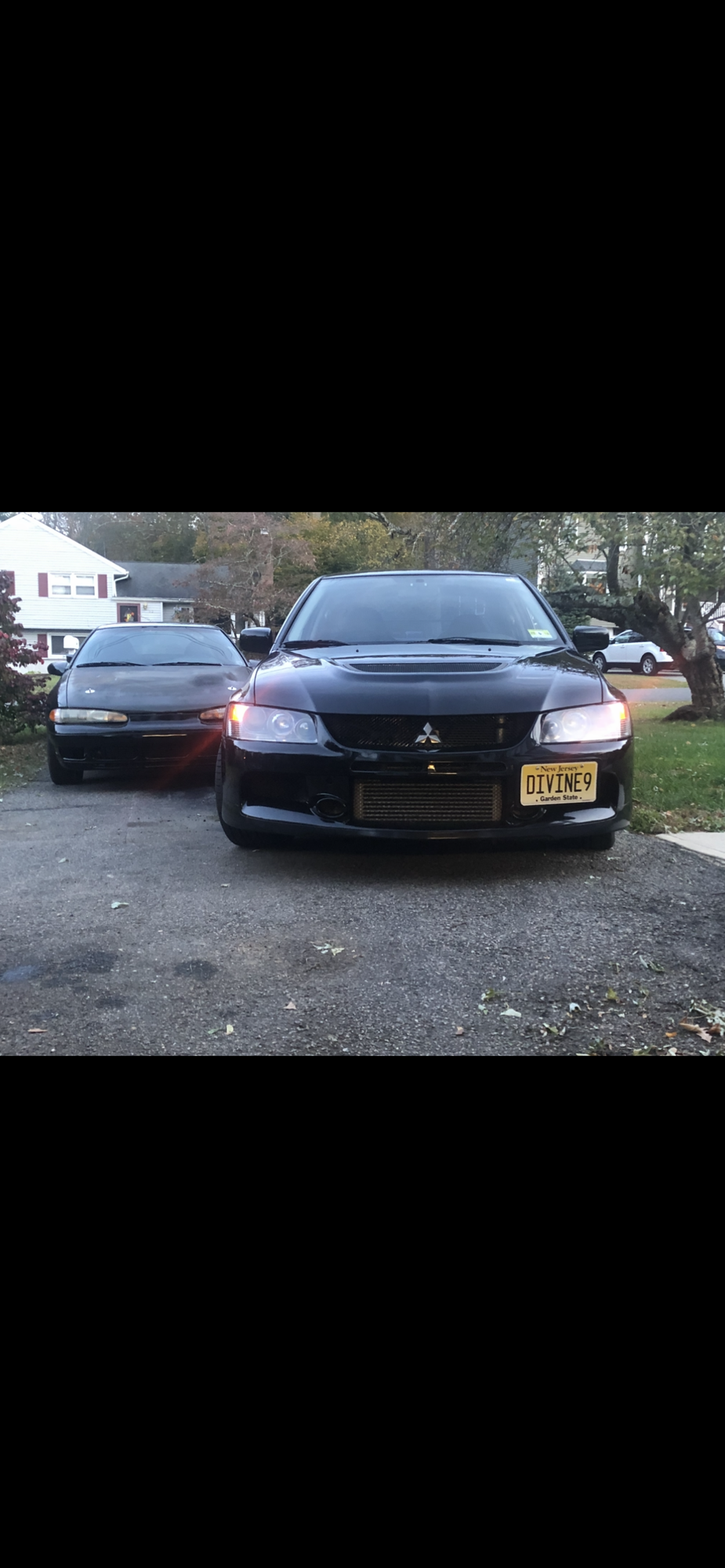

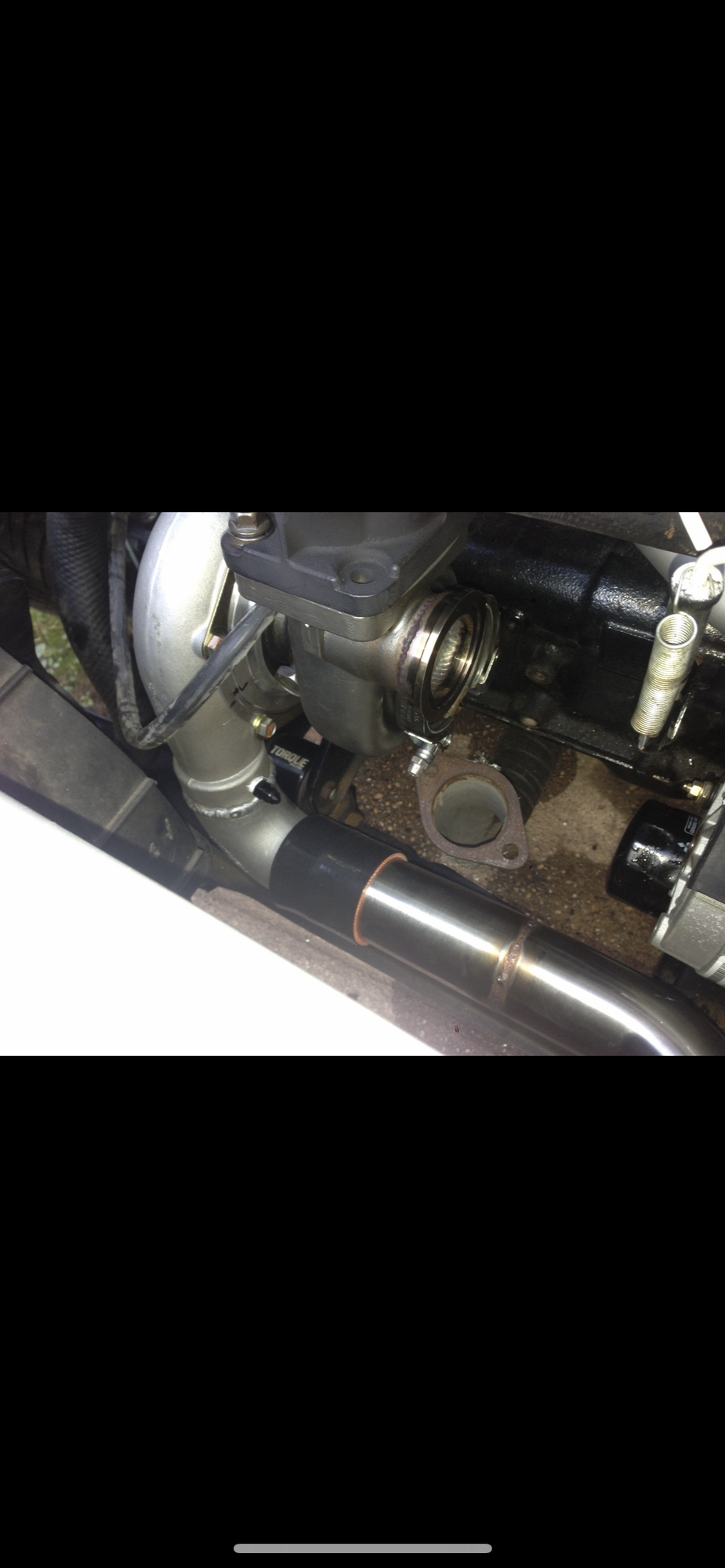

Is the wastegate on the laser mounted directly to the hot side and run inline to the downpipe? Nice evo looks clean and stock from the outside.
Hey sup man, its an old school Forced Performance DSM bolt on SS housing machined to accept a garret gt30 turbine wheel. its bolt on DSM flange with two vbands one for downpipe , the other for wastegate. the wastegate is just a dump tube not recirculated.

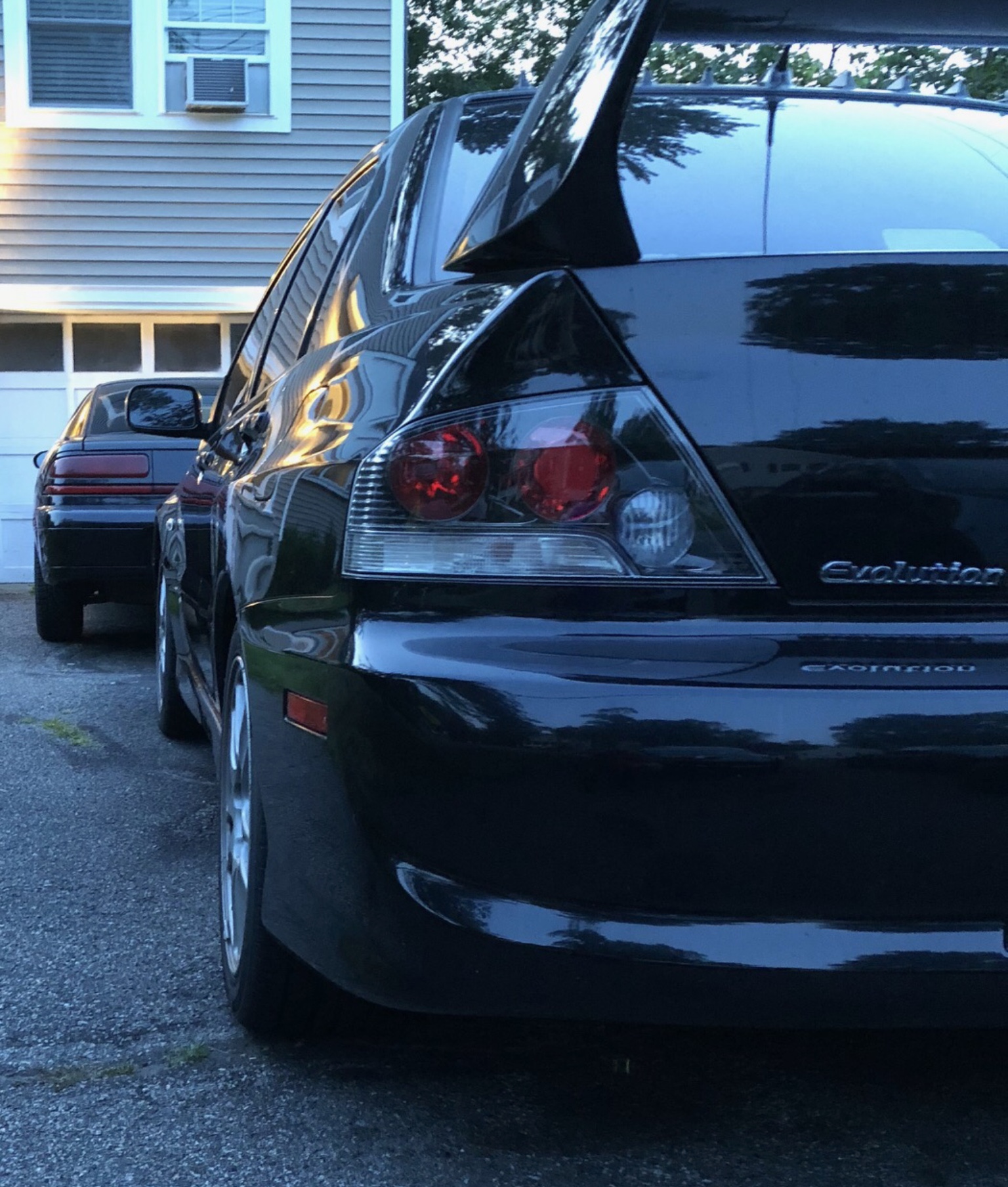

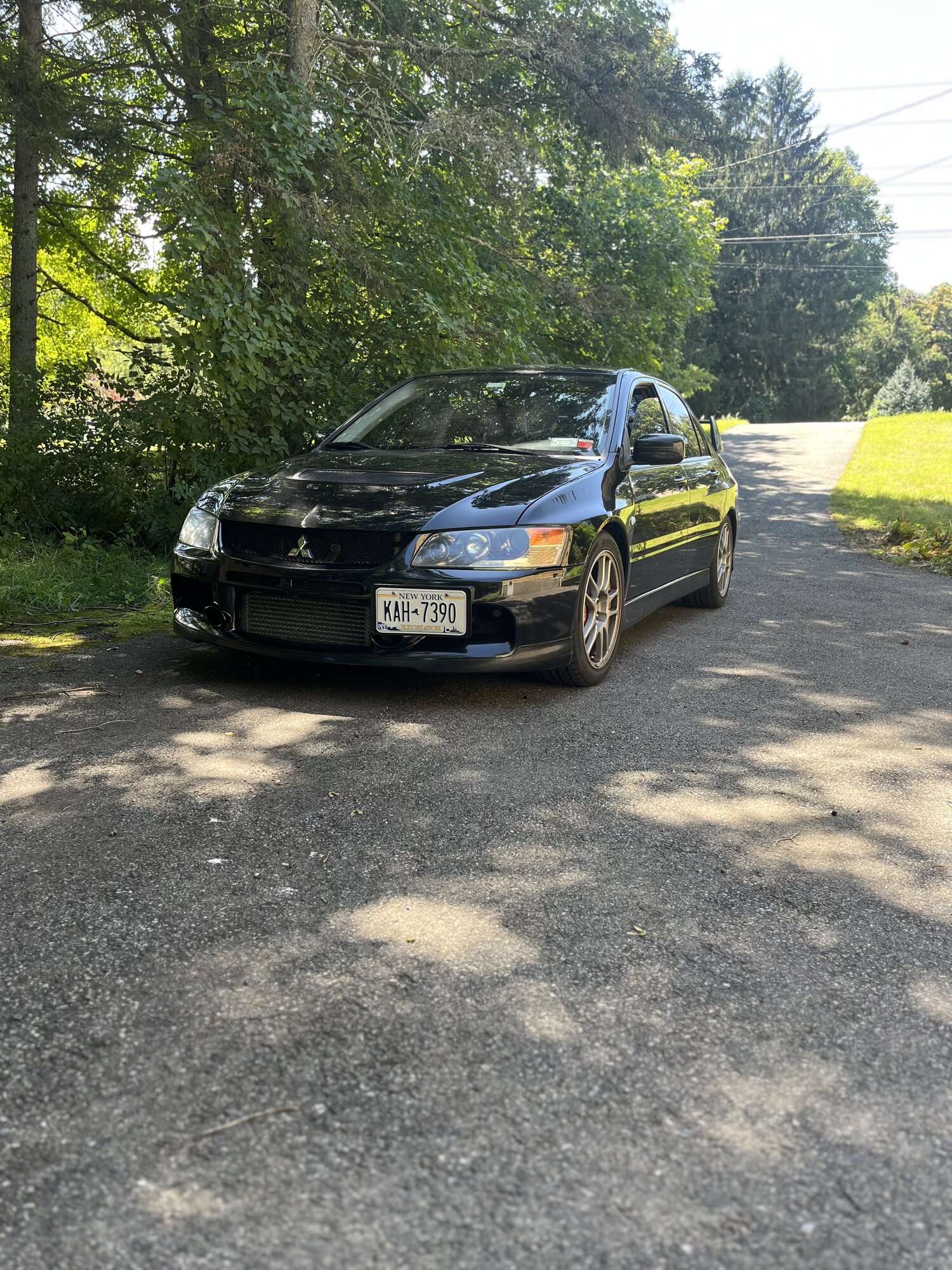

My evo is mostly stock with some tastefull bolt ons, my favorite being the ohlins coilovers.
this is the best pic i have to showing the hotside.
Oh that's cool, you can't even see the downpipe behind it. It looks like there's a lot more than running the o2 housing off it. I had to modify my o2 housing with the wastegate because it wasn't even close the clearing the alternator. My evo is not very street friendly anymore. Sometimes I wish I didn't go balls the walls with and did that with the eclipse instead.

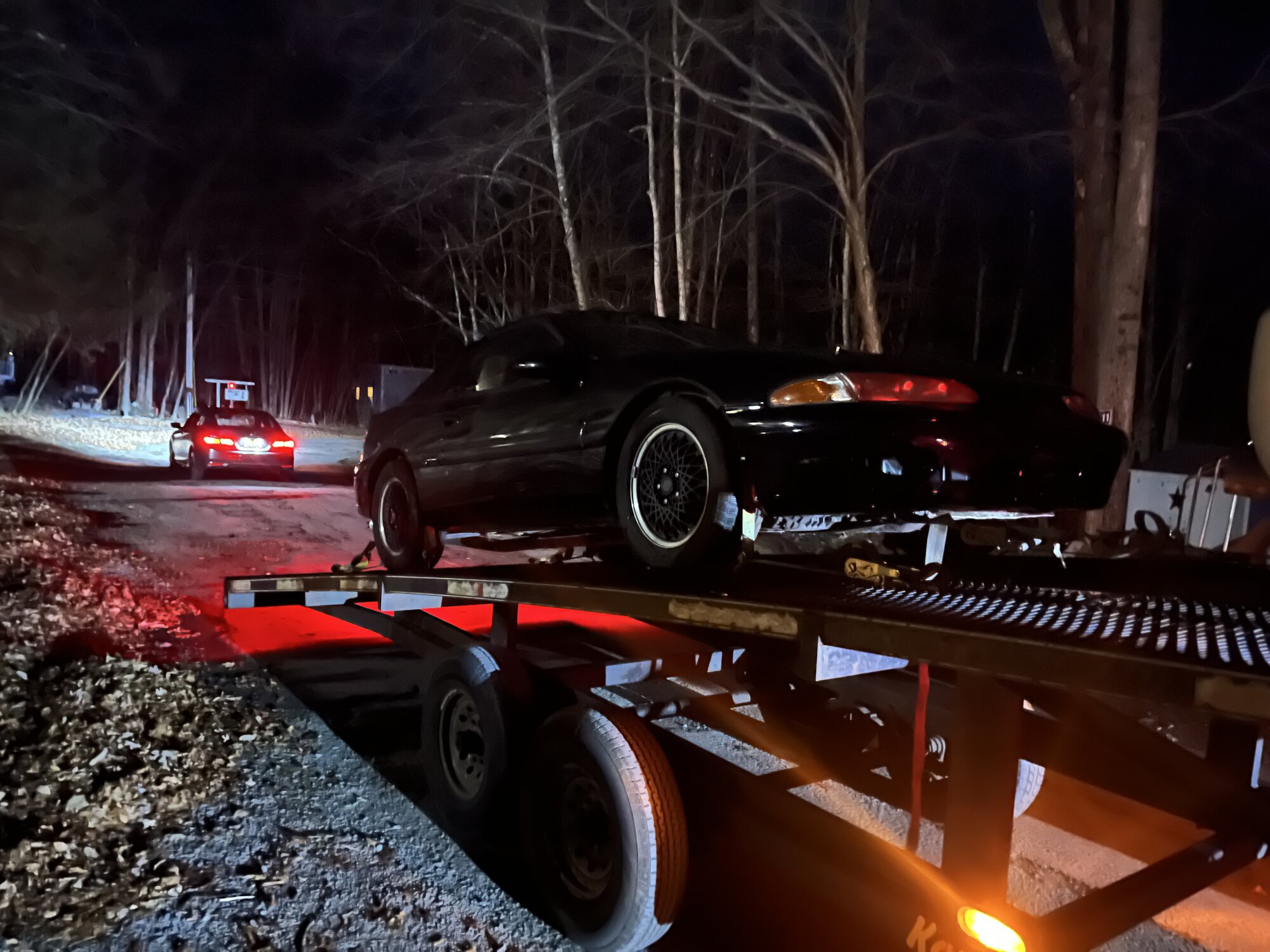

ok the time has finally come to bring my laser home from rix racing, its been done for months but with time constraints it was tuff to get there but shes loaded and heading home more updates to come

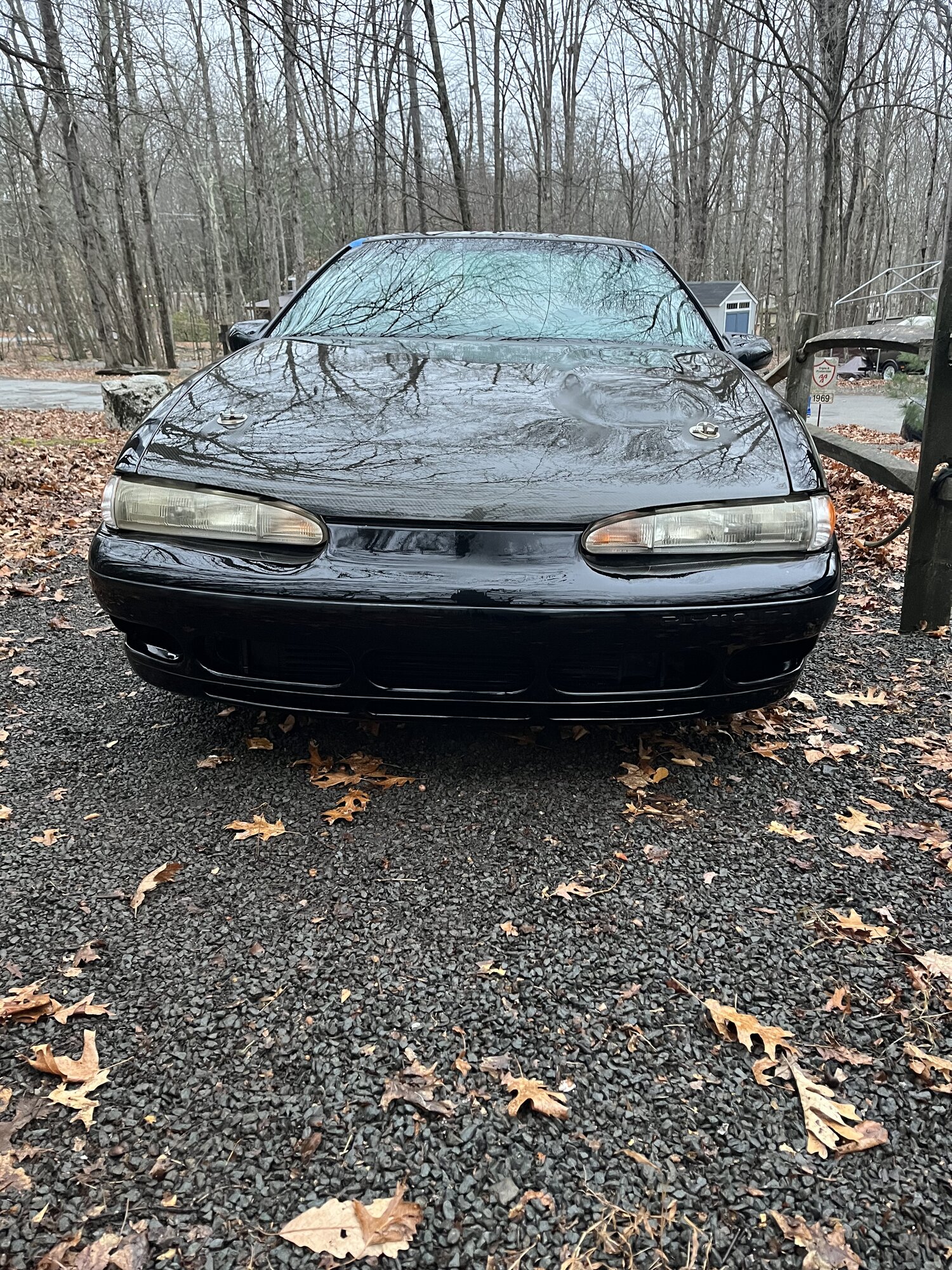

ok laser is home
been putting miles on her shes a ripper
slowly working thru some of odds and ends taking it out people have no clue what it is unless they knows dsms

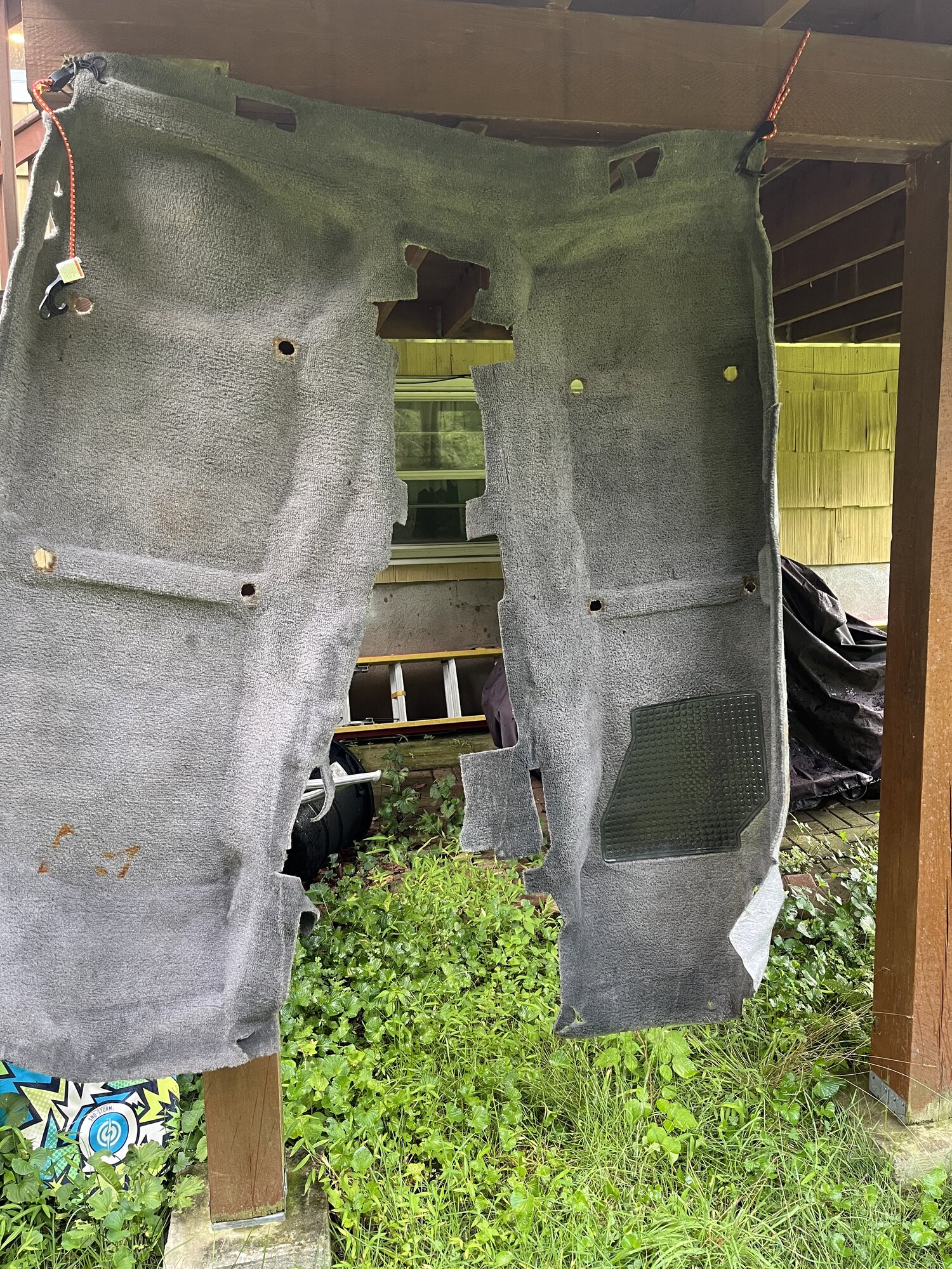

monday today bust out the whole rad test kit and lo and behold the heater core has retired now great loooped the lines finished the leak test and proceeded to clean up a big ole mess
