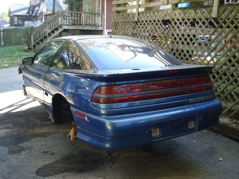

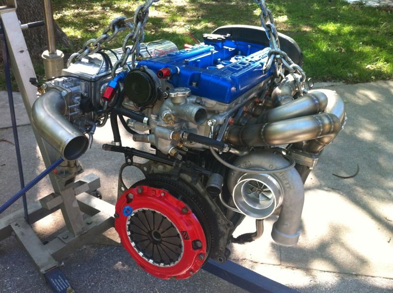

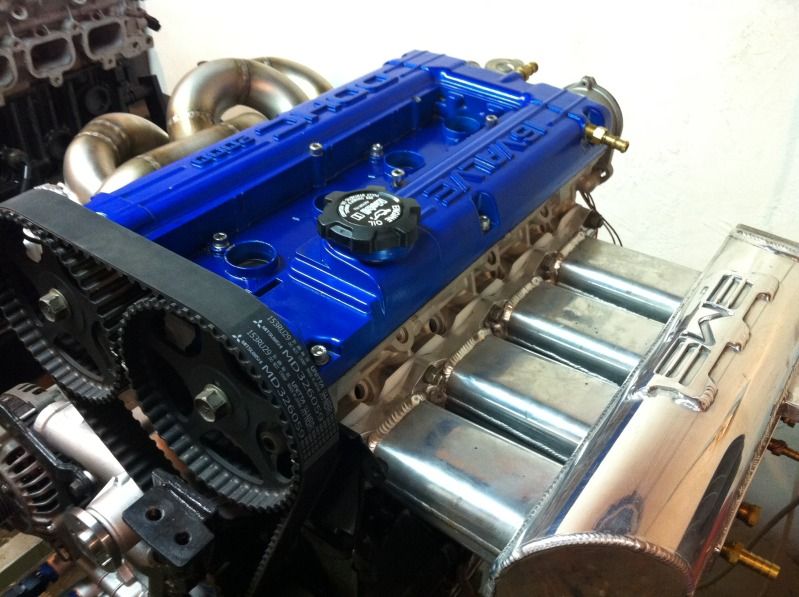

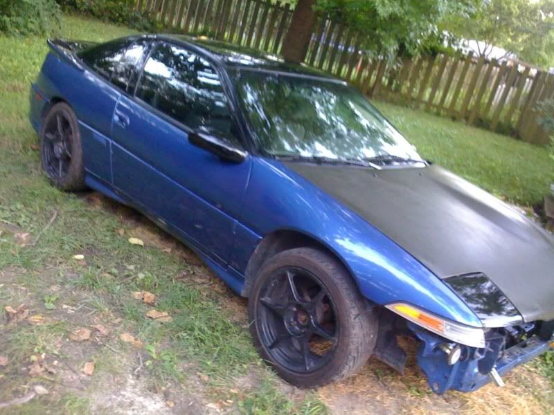

I've been building my friends '90 GSX for the past couple years. VERY slow going together but it should be a beast when it's done.

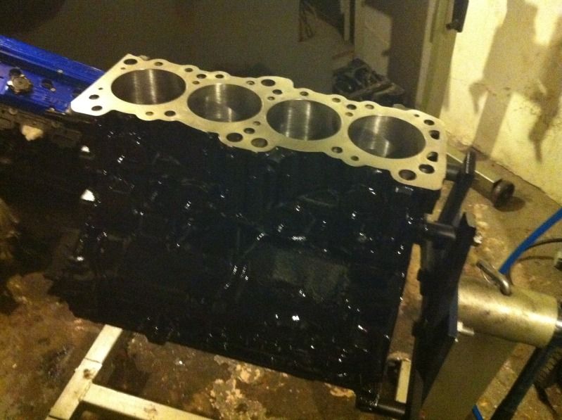

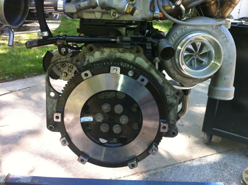

4g63 6-Bolt 2.0
Factory Crank

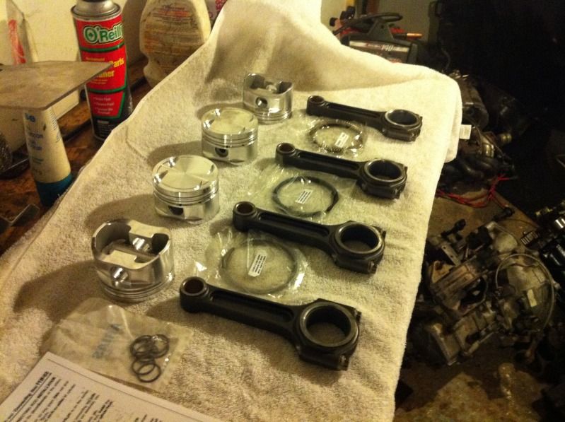

Howard 4340 Billet Steel Rods
Arias Pistons (don't like)

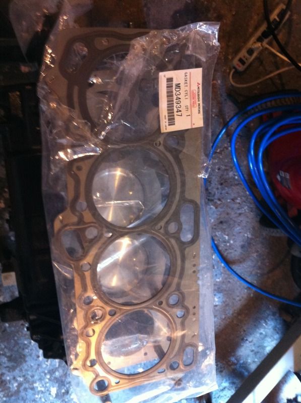

MLS HG
ARP L19's
Buschur Stage 3 Head
GSC S2 cams
JMF T3 1.5" Manifold

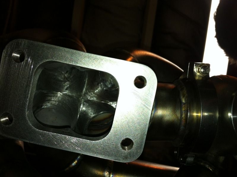

FP HTA GT3586R
Tial MVR W/G
AMS Intake Manifold
Stock T/B bored to 65mm
FIC 2150's
Fluidampr
JayR ARK
Saturn Alternator
EvoIII OFH
ACT Streetlite
Southbend Kevlar
Team Rip S4 Trans
DSS 600HP Front Axles
4-Bolt Rear
Wilwood Drag Front Brakes
AEM EMS v2 (sorry guys)
COP Ignition w/ MSD DIS-2

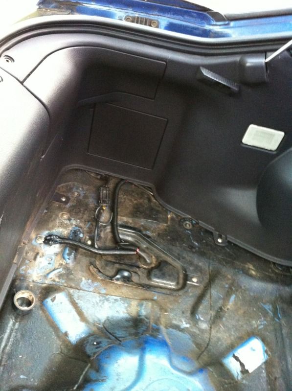

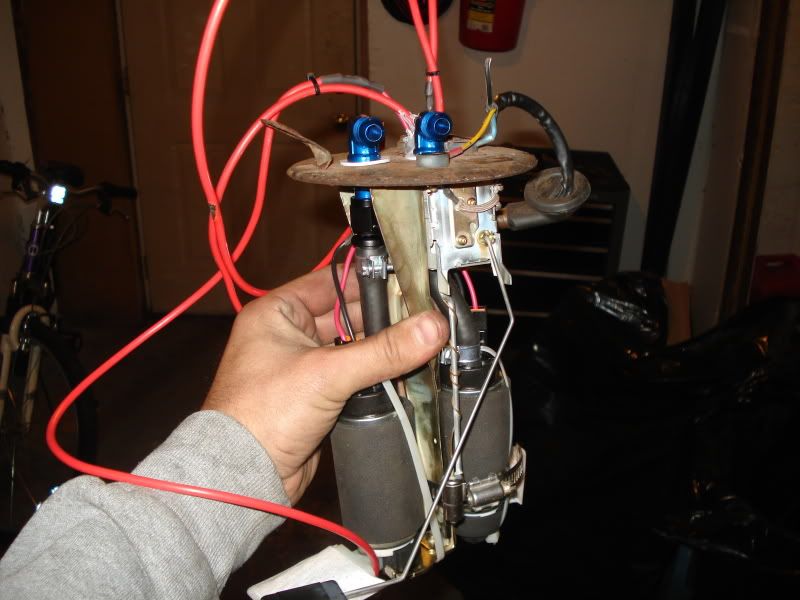

Walbro GS341 255lph intake x2

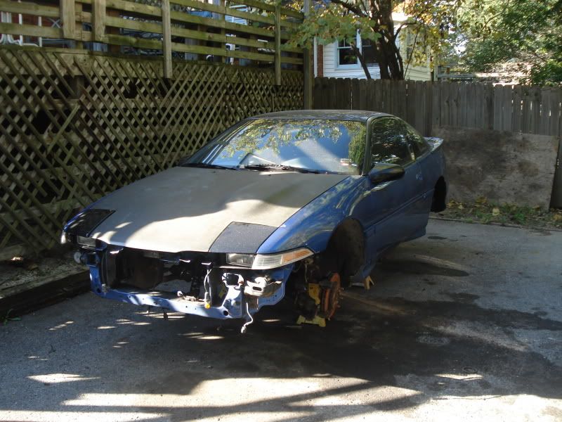

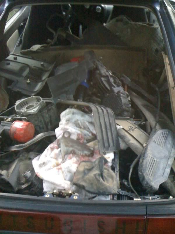

The day it rolled in.

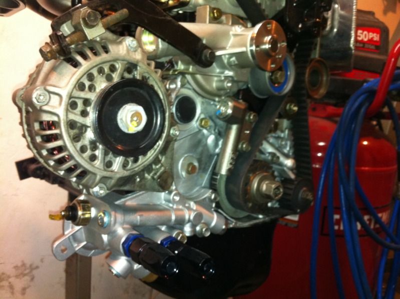

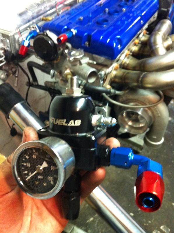

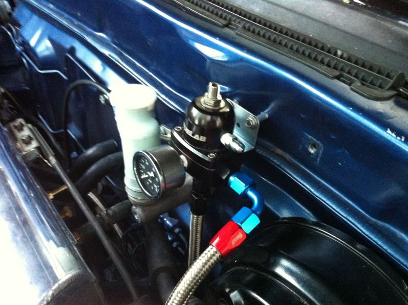

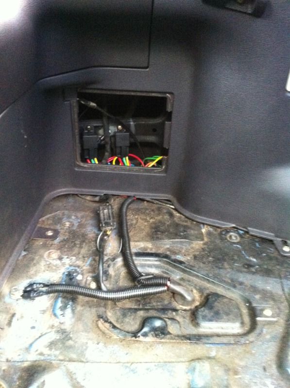

Fuel pressure relief mod on both, dual -6an feeds to a t-fitting then -8an all the way to the rail. -6an return.

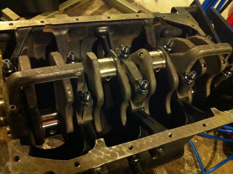

6-bolt 4g63 Crank Installed - YouTube

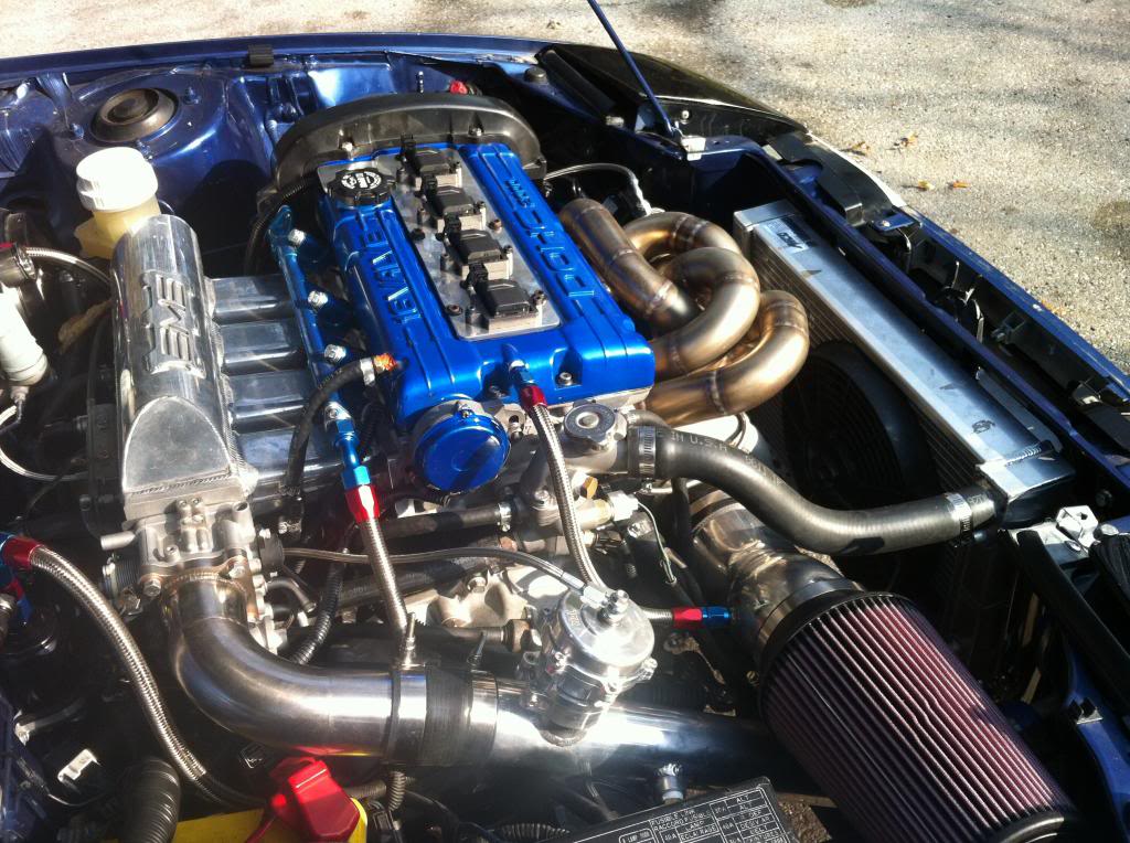

I have 3 orders of parts coming in so I'll update again here in a few days. Trying to get it done soon!

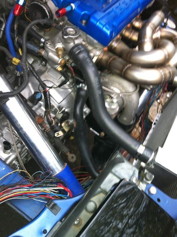

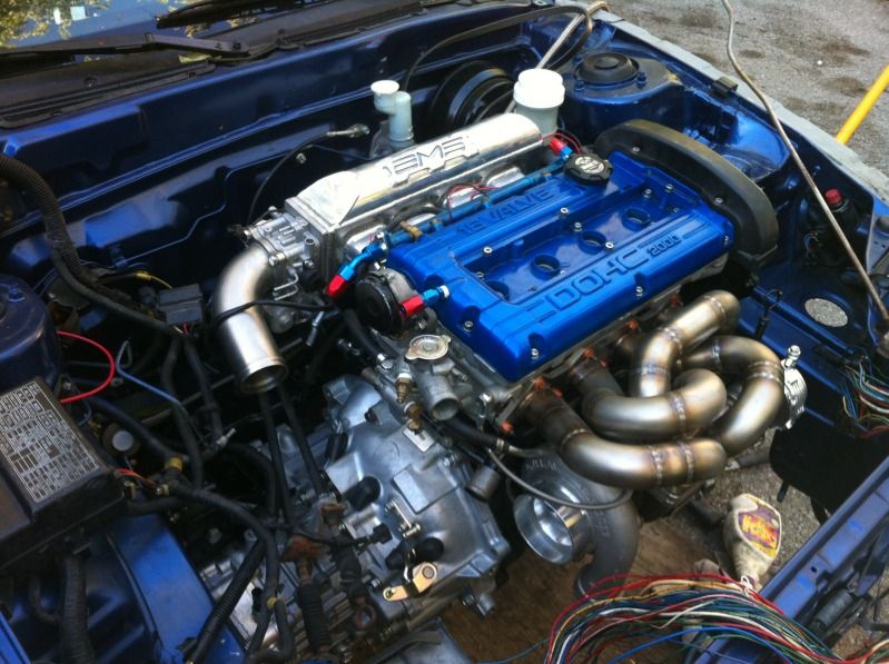

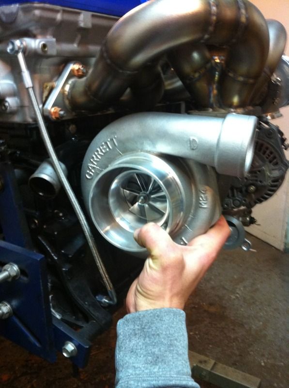

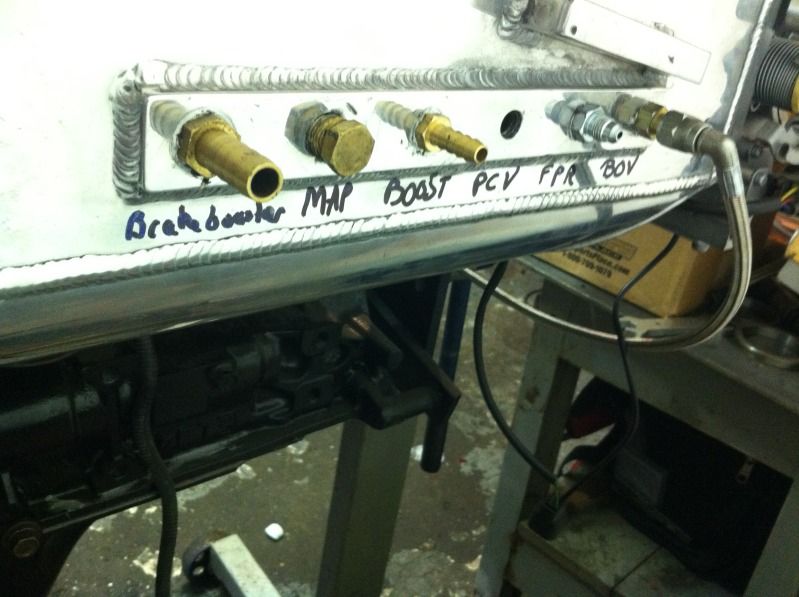

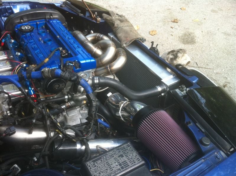

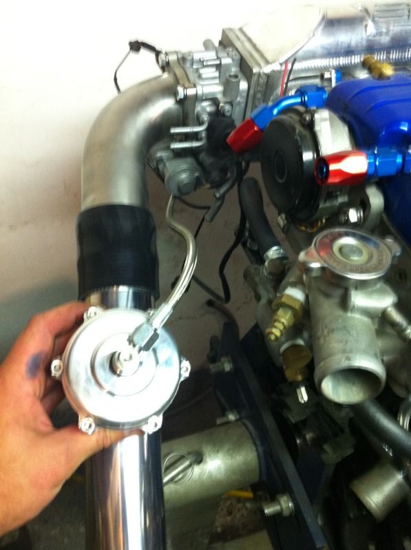

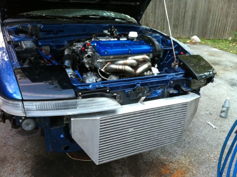

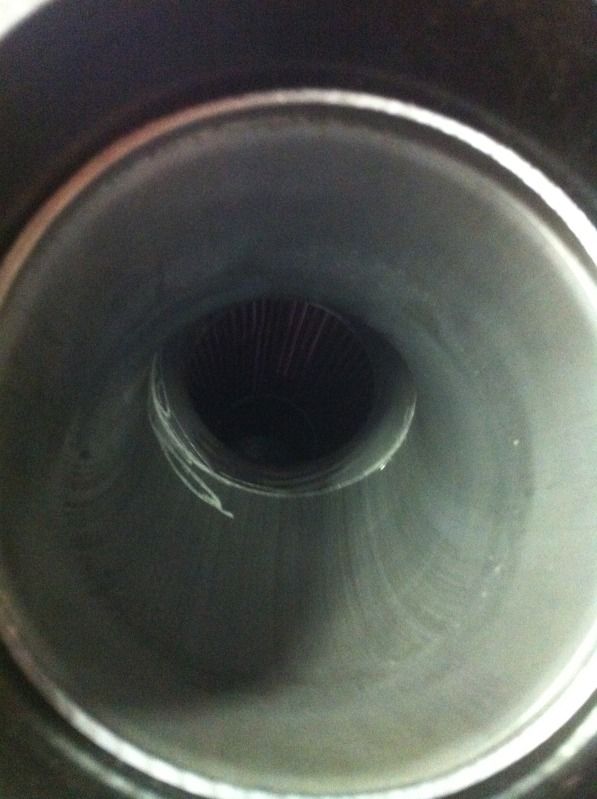

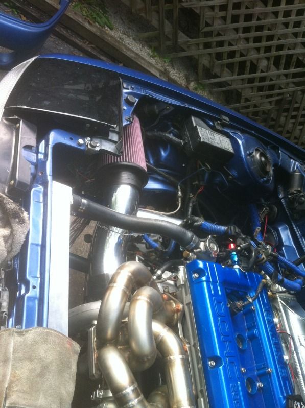

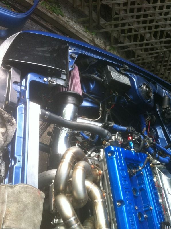

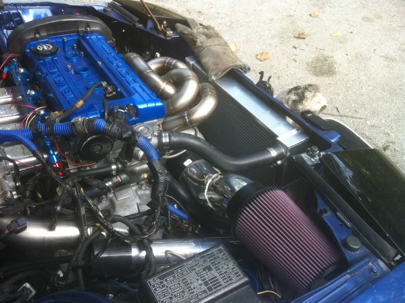

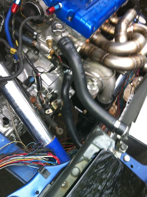

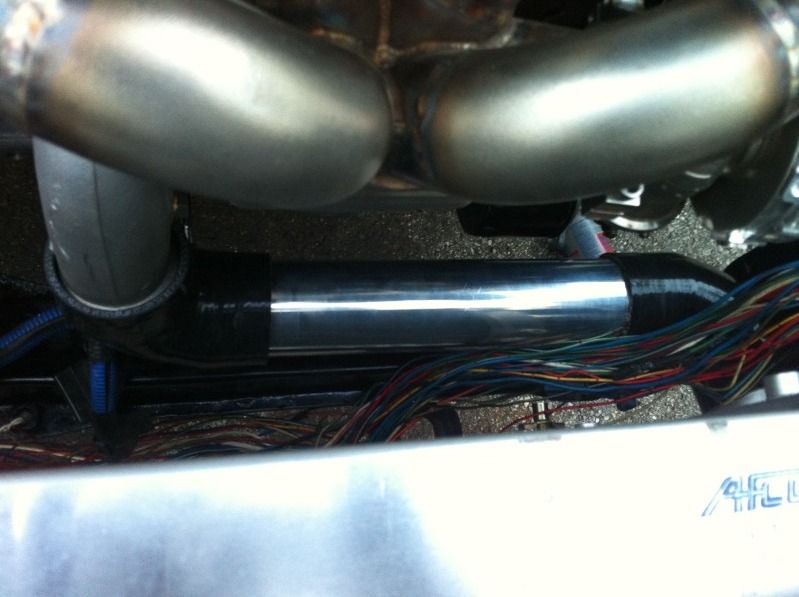

Got the 4" intake fabbed ready to weld. Once again the one-off radiator hoses passes fitment again.

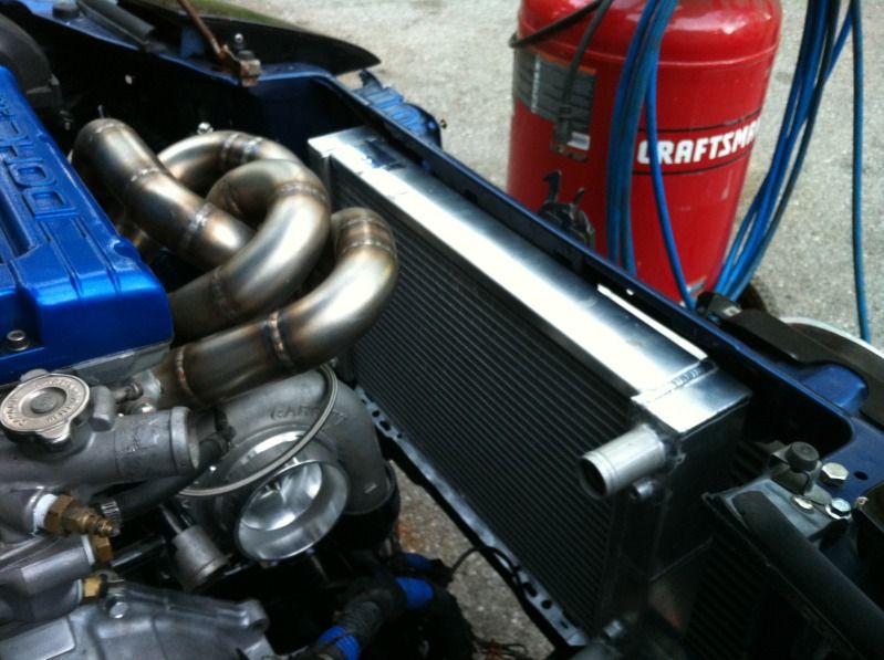

POV from the turbo:

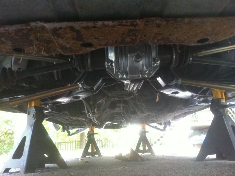

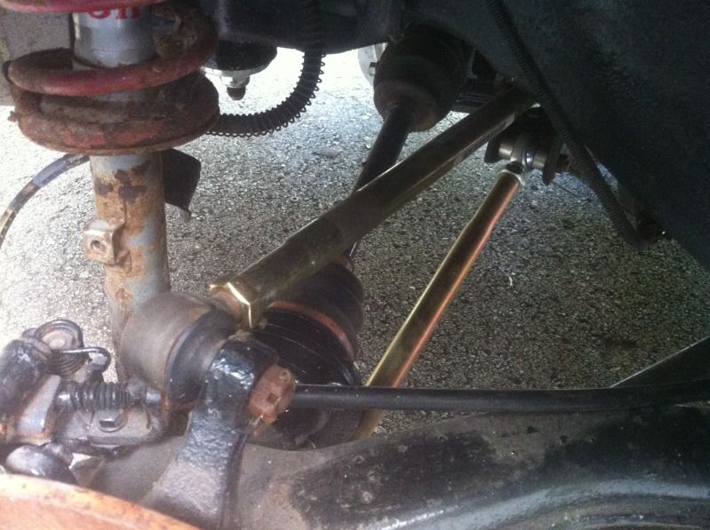

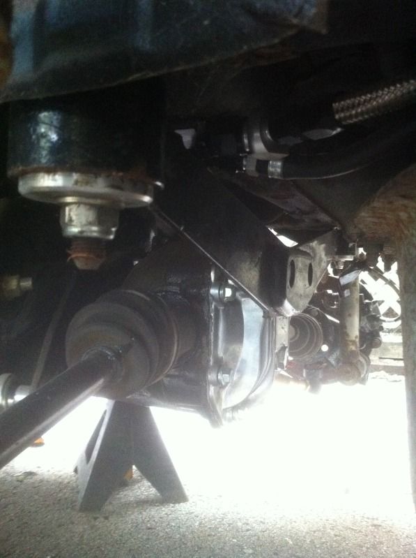

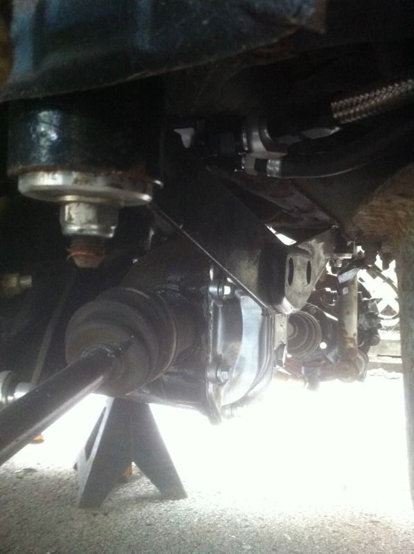

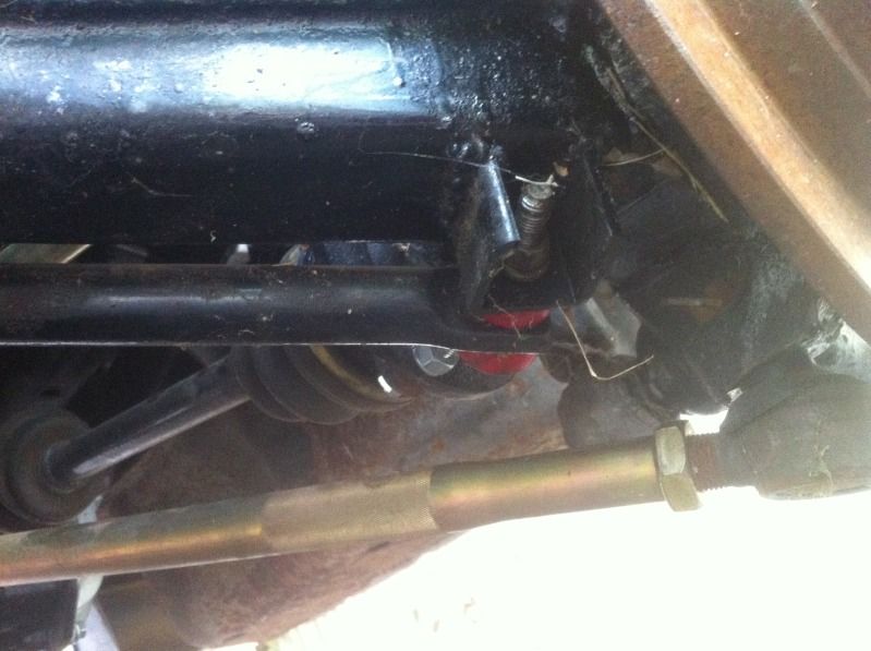

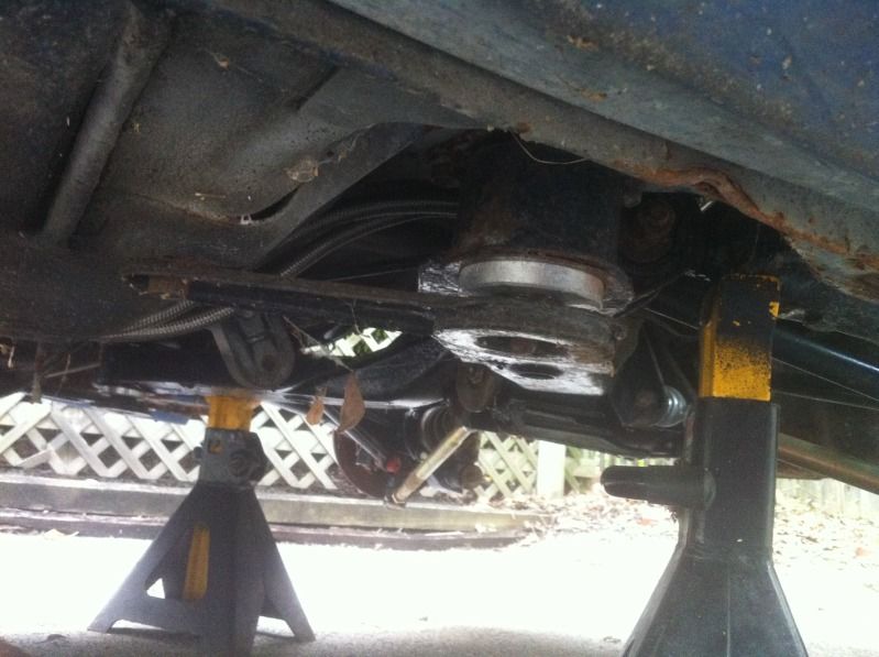

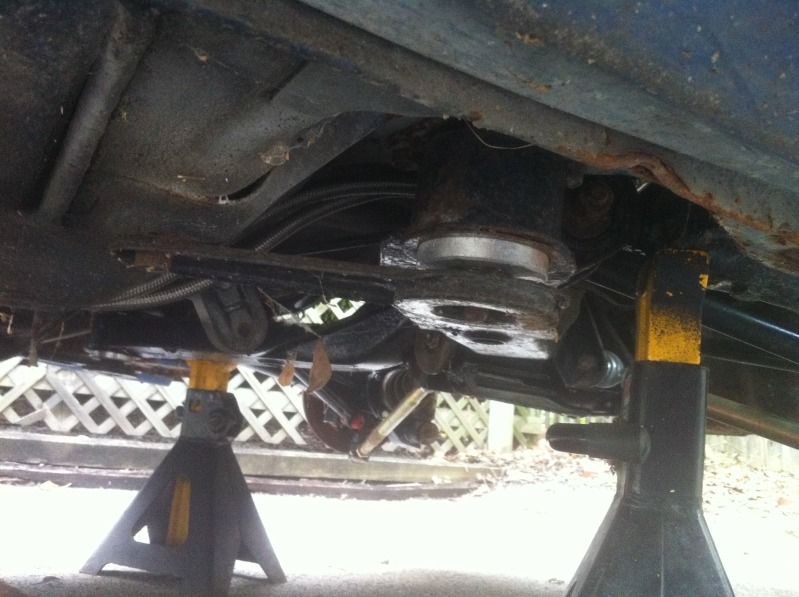

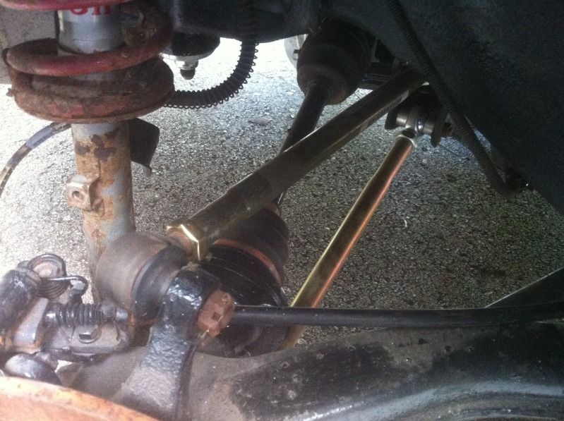

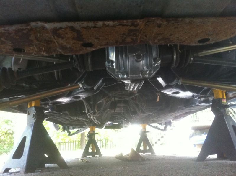

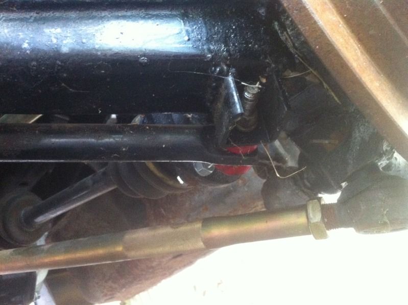

Here's pics of the rear end we threw together a couple years ago. 4-bolt lsd rear with tubular control arms and suspension techniques rear sway bar. I had to relocate the sway bar end links since the new tubular arms didn't have the sway bar end link mounting locations. I designed some billet mounts for the mustache bar and subframe on solidworks and had my friend Jim machine them at his friend's dad's machine shop.

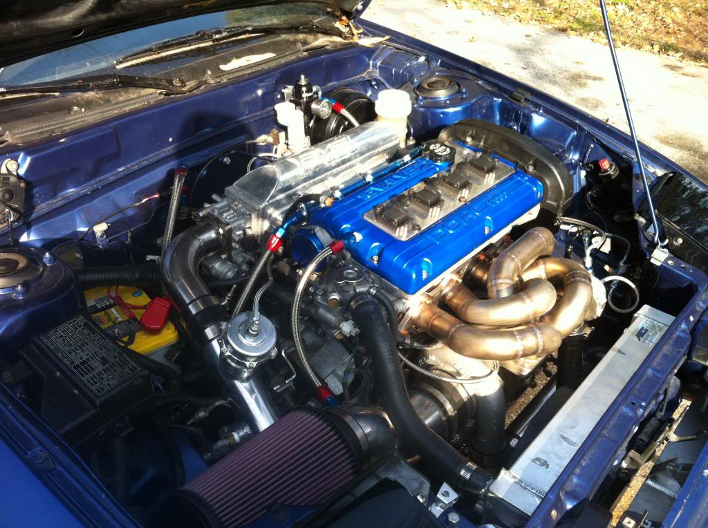

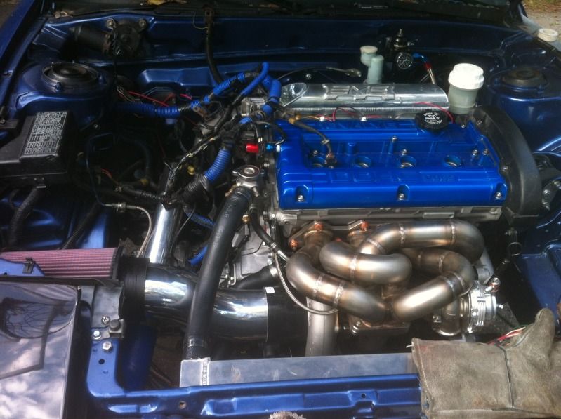

Car is running. I'll be making the exhaust today.
Idle Video
[ame=http://youtu.be/ltomMoOwBaY]'90 Eclipse GSX w/ FP 3586 & GSC S2 Cams Idle Walkaround - YouTube[/ame]

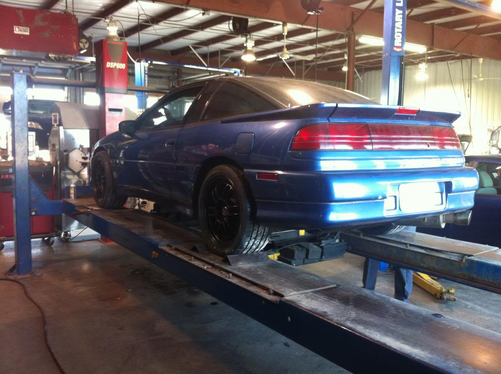

Alignment is done and new tires are on so now this car is my daily driver to put some miles on it. Pretty fun to drive a classic.

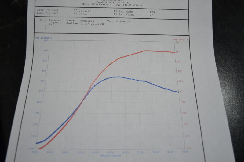

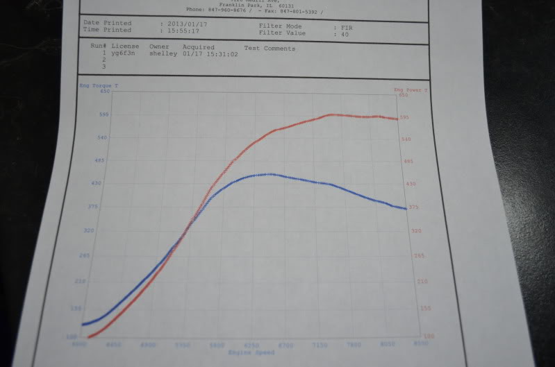

Car put down 606 awhp on a mustang dyno. 43 psi of boost.
Here's the second to last pull we did. We tried 45 psi and didn't have enough spark.
