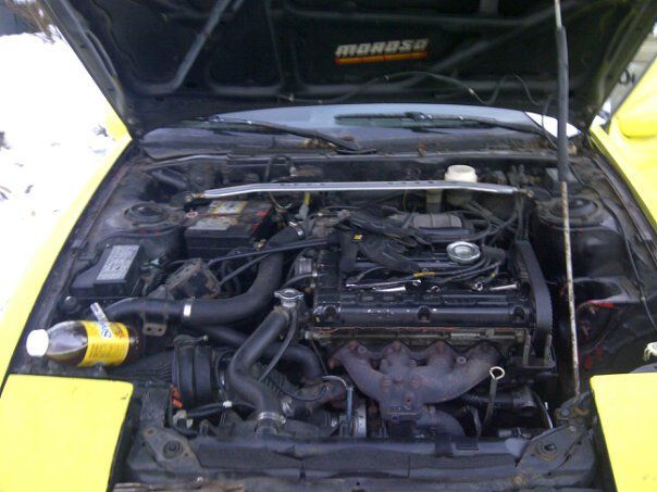

Here's the car when we brought it home:

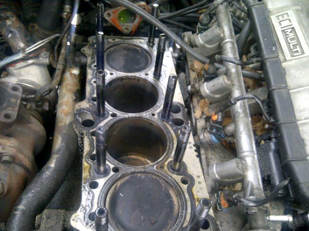

After I bought it we decided to go through the car and do some maintenance and try to get it running better. We did the timing (belt, pulleys, etc), plugs, fixed brake lines, and actually hooked up the wastegate line (the previous owner decided it was a good idea to leave the wastegate line unplugged completely). We got it all back together, after nearly killing ourselves trying to do the timing, and it was a mild failure. The car wouldn't stay running well and just didn't feel right. We did a compression test and got some disappointing results. 145-125-125-150. Here's a link to the thread I started then: http://www.dsmtuners.com/forums/newbie-forum/389622-dropped-compression-middle-2-cylinders.html After much frustration trying to get it set I decided to rebuild the top end.

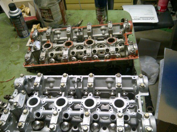

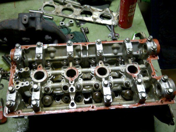

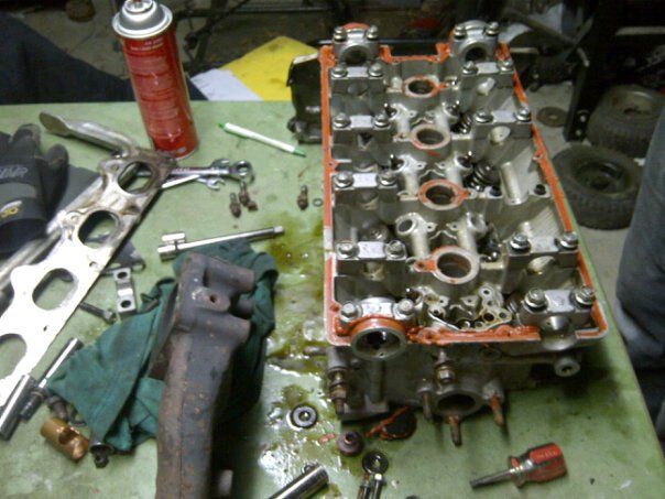

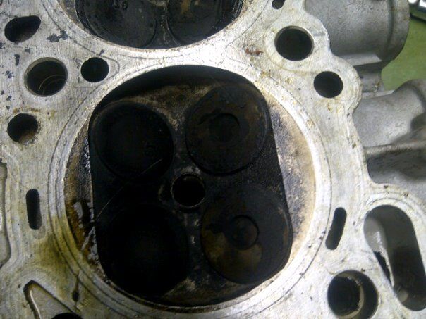

This is the old head:

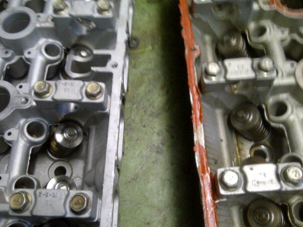

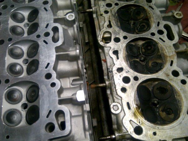

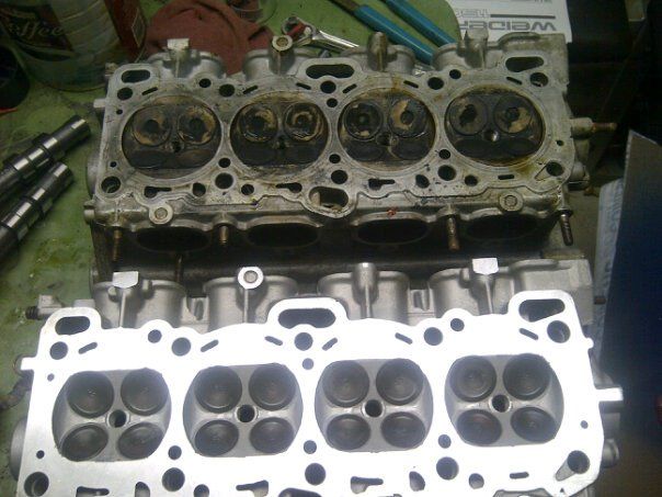

Some of the valves were smoked. Some of the valve seals were smoked. The whole head had serious carbon buildup and looked very worn. The cams and cam journals had significant scoring. This was not what I was hoping for, but doing a top-end rebuild gave me an excuse to buy some fun stuff for the car.

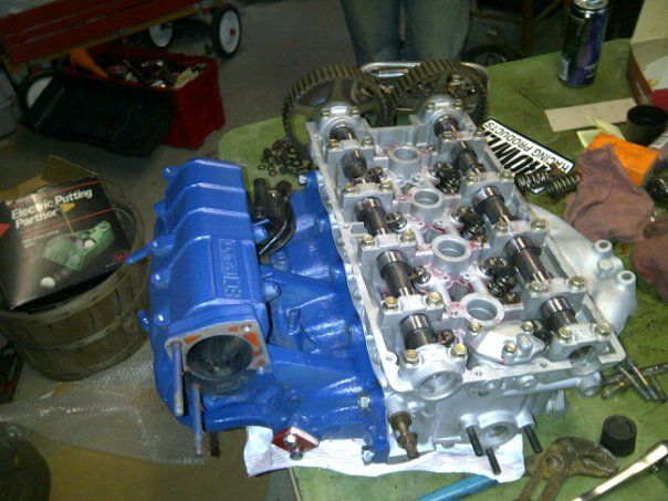

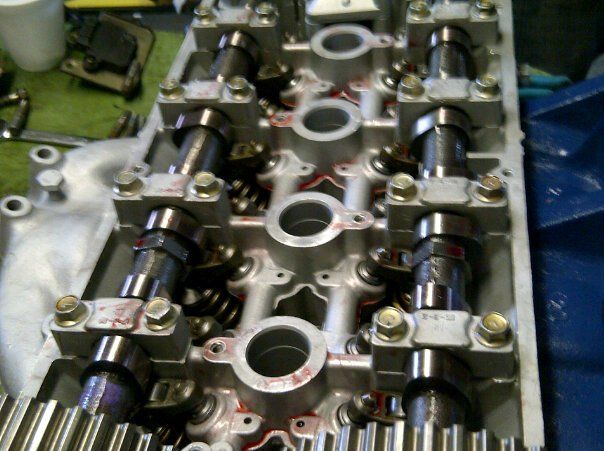

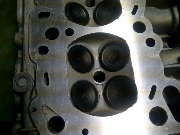

I bought a re-manufactured cylinder head from a shop I found on Ebay. I read a lot of reviews of the shop and they seemed very reputable. I am pleased with the head I got from them. I also ordered Crower 272/272 Cams, Manley Springs and Titanium Retainers, Topline lifters, and a new Punishment Racing FMIC (not related to the rebuild, but definitely needed it). After we got this stuff in and started the rebuild I decided on DSMLink V3 Lite and new FIC 750cc injectors as well.

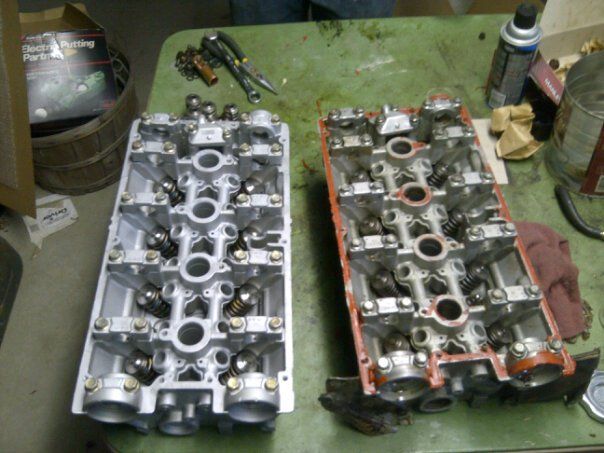

Some Comparison pics between the 2 heads:
The new head being built with the fun parts :)

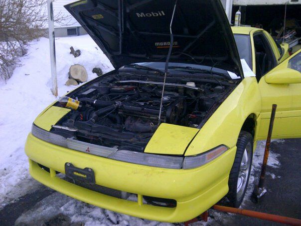

So we got it started... Finally. It was nice to here the motor after two years of working and waiting. It, however, won't stay running long. Our guess right now us timing. We might be off with the belt by a tooth somewhere. That or we ####ed up putting the CAS on. Honestly I'm not very confident in how to time the car properly. Hopefully we can figure it out this Saturday though. Well see LOL.
It is not the factory yellow. The guy that owned it before me painted it yellow. It left the factory red. The previous owner also got in an accident and painted half of it after the accident so it is two different yellows right now LOL.
Long term I'm thinking of vinyl wrapping it...
I know what you mean.I'm thinking about yellow and black cf wrapping parts of mine too.
Looking good tho, cause use some buffing to bring the yellow out.But all and all,I think I just like the yellow.

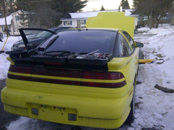

Attempting the timing again today.. Hopefully I can post a video of it running later today.
So, we took off the timing covers and looked at the timing again. It didn't look wrong. We spent a little time screwing around and checking things over, and tried to start the car again. Now, no start at all.... :confused:
