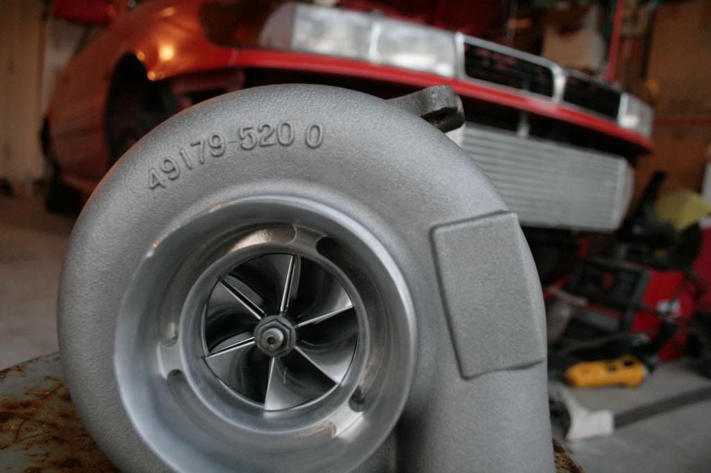

The Billet 20G/SL2 is here, now I just need to figure out where to mount the wastegate actuator. Which is already proving to be a PITA. I have to drill out the spot weld on the actuator arm and reposition it about 45 degrees and make a bracket to hold the actuator.

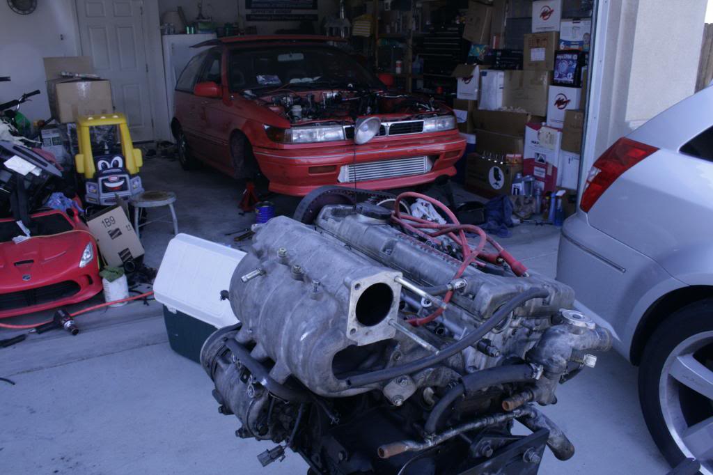

I decided to keep the Colt so I started swapping the engine, ECU, and brakes over the weekend.
Spun bearing engine is out

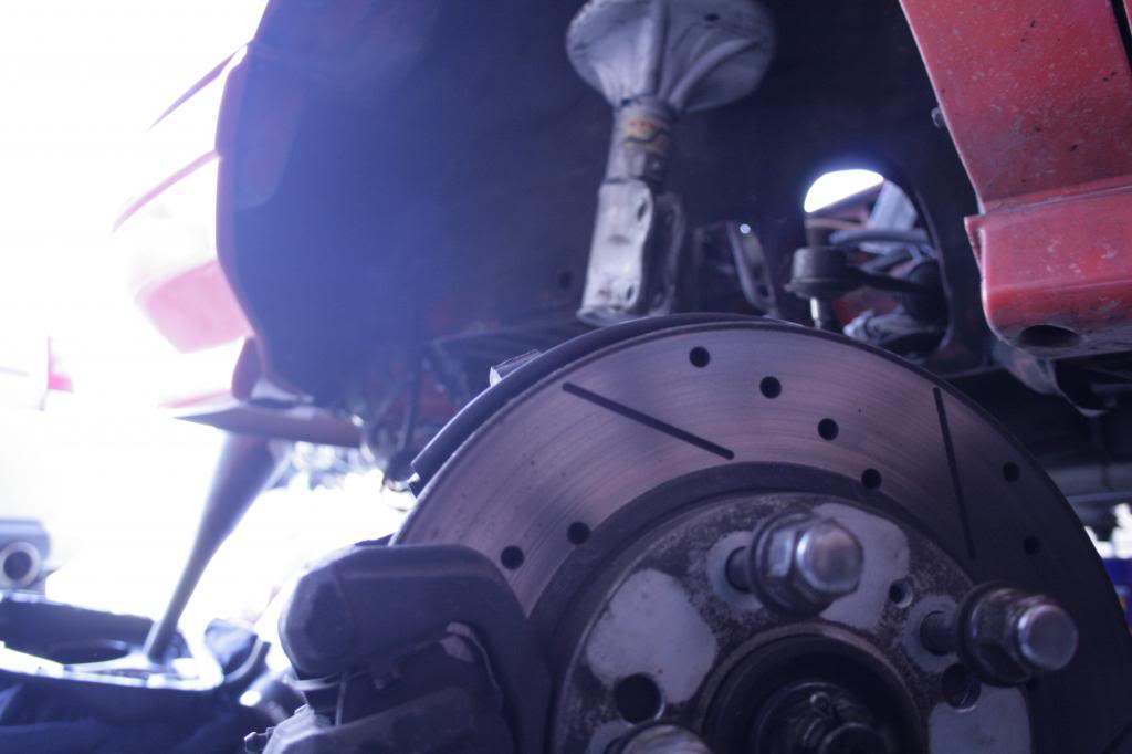

5 lug and big 2 piston calipers going in
I gave up on the 5 lug conversion. The front went pretty well until it came time to retaper the tie rod end hole on the hub. I have a tie rod end reamer here at work that I used. I had my doubts that it would work and those doubts were confirmed after I started reaming it. The reamer was not able to penetrate all the way down the hole without making the hole too big for the tie rod end. I wasn't about to only ream halfway down the hole and leave half the shank unsupported.
Last night though, I started fiddling with the rear brakes after reading around that others have redrilled the rear hubs. I had to see for myself so I tore apart one side of both the Colt and the Talon. The face of the hub just doesn't have enough meat to redrill them safely so I just put the car back to 4 lug. Like others have mentioned the Talon hub is too large to work on the Colt.

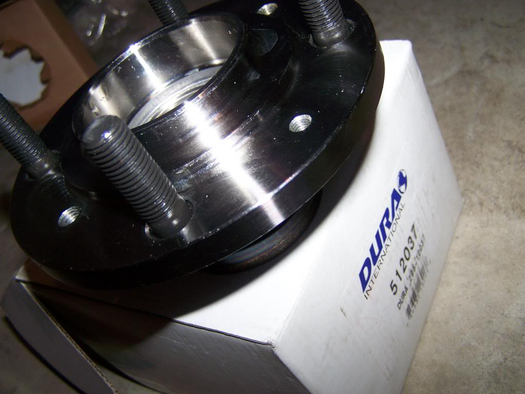

I also spent the week brainstorming this whole 5 lug issue. I just bit the bullet and ordered the '92 Sedan rear hubs and a Mustang II bump steer bolt kit from AFCO. We have a reamer at work specifically designed for the Mustang II Tie Rod taper so I feel a lot better about going this route. I just needed to get a couple 5/8" rod ends (also from work) and then I threaded a sleeve to couple the rod end(5/8 LH) to the inner tie rod(14mm x 1.5). So basically I ended up with a complete bump steer kit just to fix the tie rod taper issue I was having.
Unfortunately, I solved one problem but created another. The new tie rod set-up is longer overall than the OEM tie rod end. So now I will have to cut the inner tie rod to get proper toe.

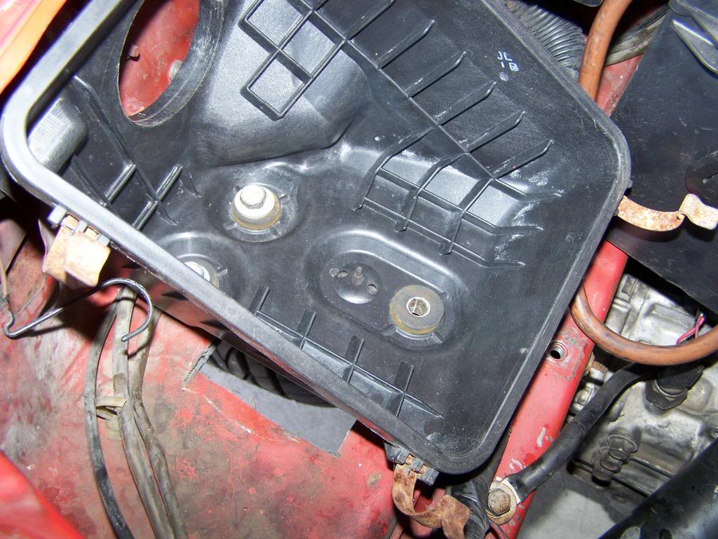

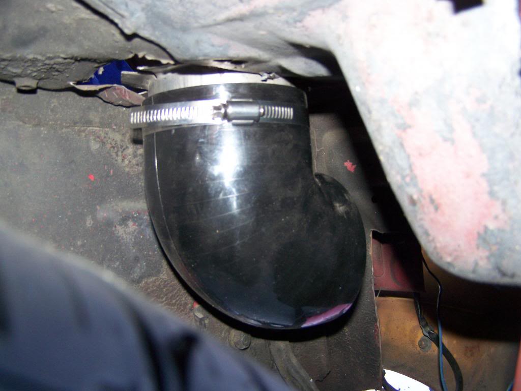

I've been wanting to put the 2G airbox back on the car because the intake air temps have been crazy high with the open filter. So I took a little time today and made it happen.
I had already made the mounts for the box a while back.

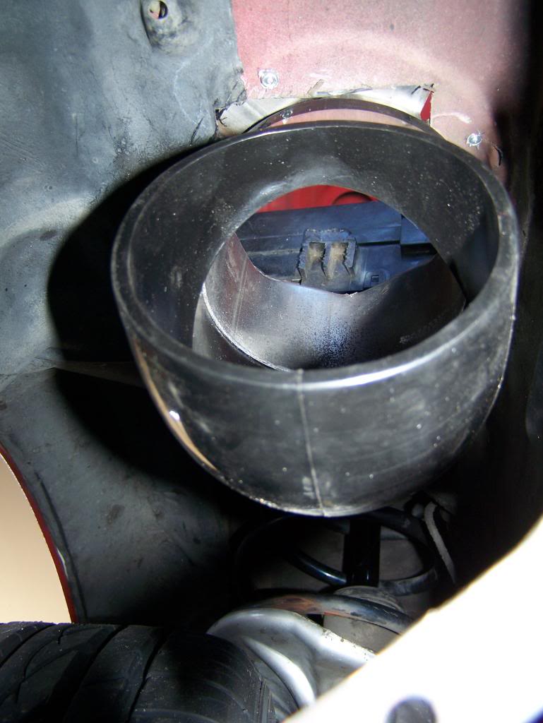

The previous owner had already cut this rectangle opening I just modified it a little bit to fit a 4" round tube.
I used a 3.5" hose to make the template. (better to start with the hole too small and slowly work it to the proper size)
I had some 4" pipe sitting around to cut up.
Here it is riveted in place. Eventually I will weld it into place and fill in the holes.
I also had a 4" 90 degree left over from another project. I just turned it forward away from the tire. In the future I could make a ram air with a funnel mounted in the blinker hole.
Bottom view
Top view, looking through the now modified air box.
The fuse box had to be moved and I still need to make a proper battery tray but I managed to cram 10 lbs of ish in a 5 lb bag.

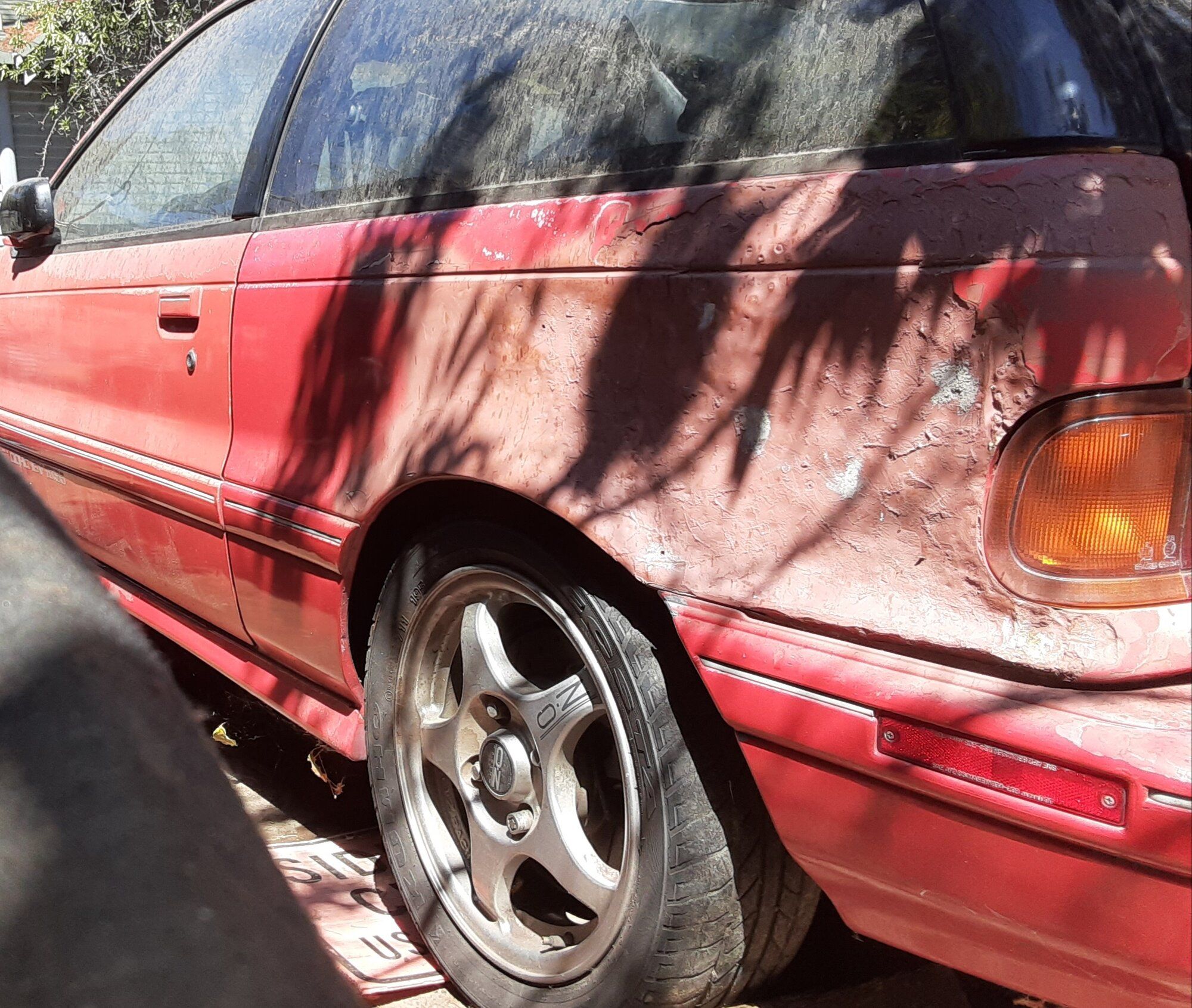

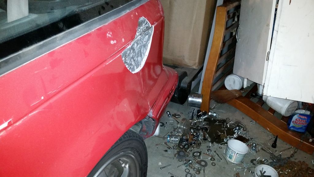

It's been forever since an update but a week or two after my last post I killed the engine. The cars been collecting dust as I've been working on the house. Well, to my surprise I open the shop this weekend and find one of the cupboards came off the wall and fell onto the rear fender. I am honestly glad it was the Colt and not the IS but it still sucks. Especially when you find 1/4" thick bondo from a poorly fixed previous incident. I usually take these moments and turn them around into a positive so I am very seriously thinking about installing fender flares. Now that I have a proper daily I think this car is going to get a bit of a race status transformation.
