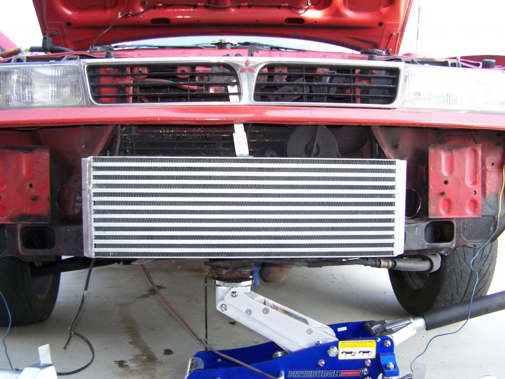

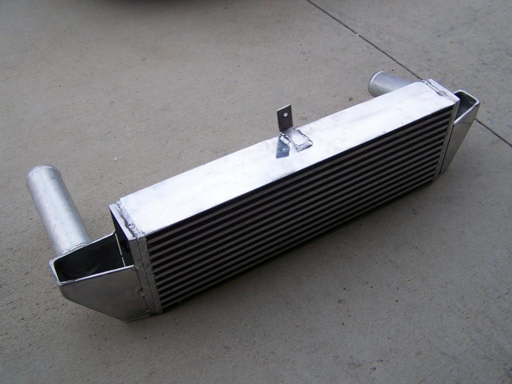

Oh yeah, and I also picked up a bigger intercooler but the end tanks are going to need a rework. The car is going to be down for a few weeks so I went ahead and yanked the ECU to have it socketed.

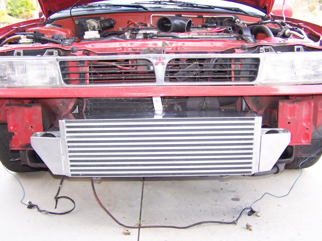

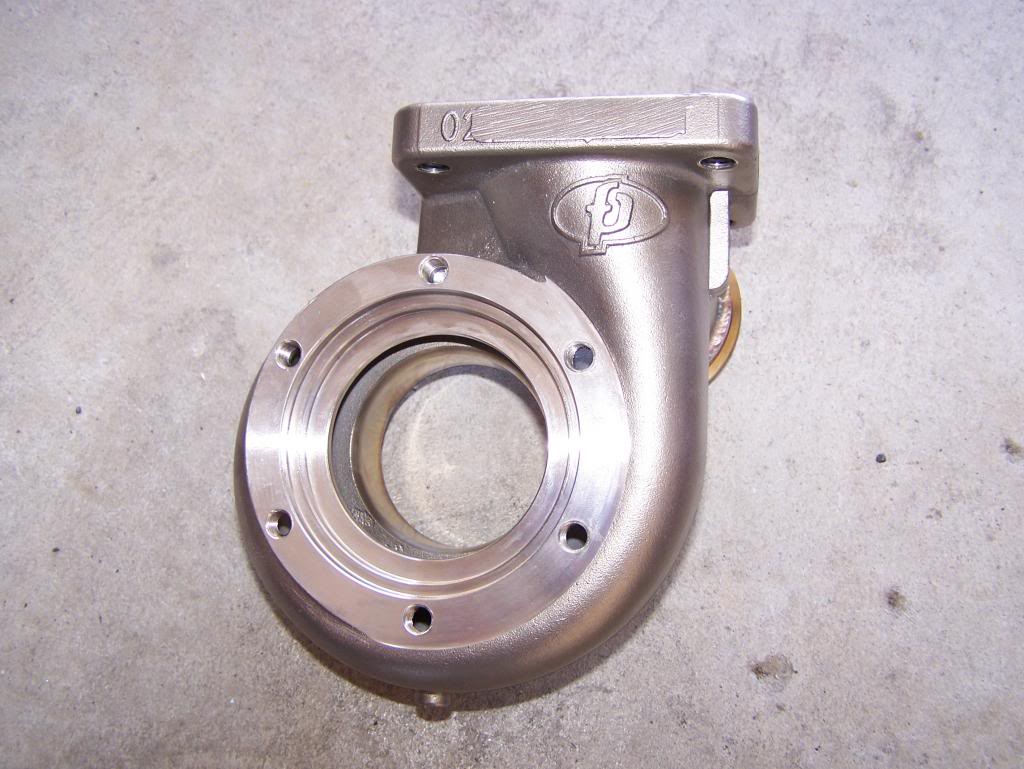

I started working on the intercooler end tank change this past weekend. I also picked up a 44mm wastegate, 2.5" v-band, and a 3" v-band. Still waiting for the FP turbine housing to get started on making the 02 housing.

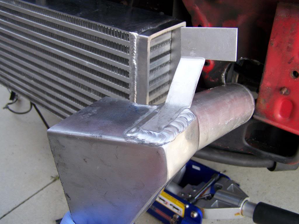

first mock up without end tanks
Each end tank will need to be moved down

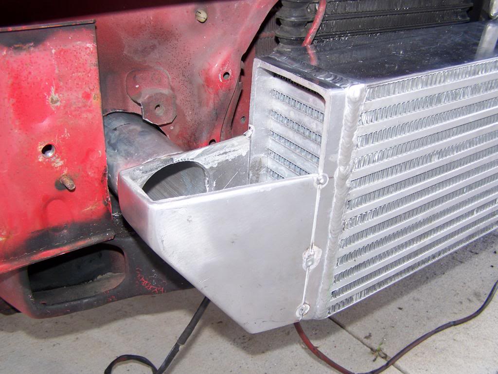

The driver's side is going to need a little extra work. The pipe still interferes with the alternator so the pipe will need a little more angle. The entrance hole is already as low as it will go so I can't just bring the pipe down farther.

The driver's side pipe won't be as bad as I originally thought. I think that if I ran a 90 degree cast aluminum piece to mate up against that side it would save some space in the alternator area. I will try and run it with a silicone hose though.

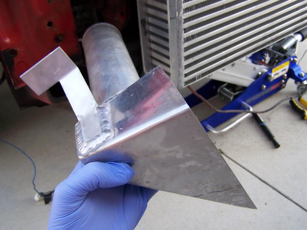

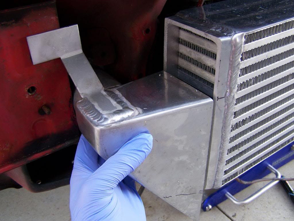

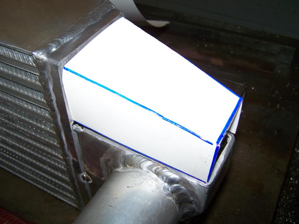

Making a little progress today at lunch.

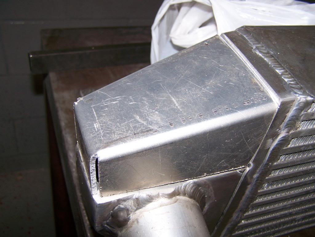

Template for the end tank pieces. I made it just slightly oversized to account for the bend radiuses and also trim to fit.
The two ends pieces plus two bottom caps.
Trimmed up and ready to be welded

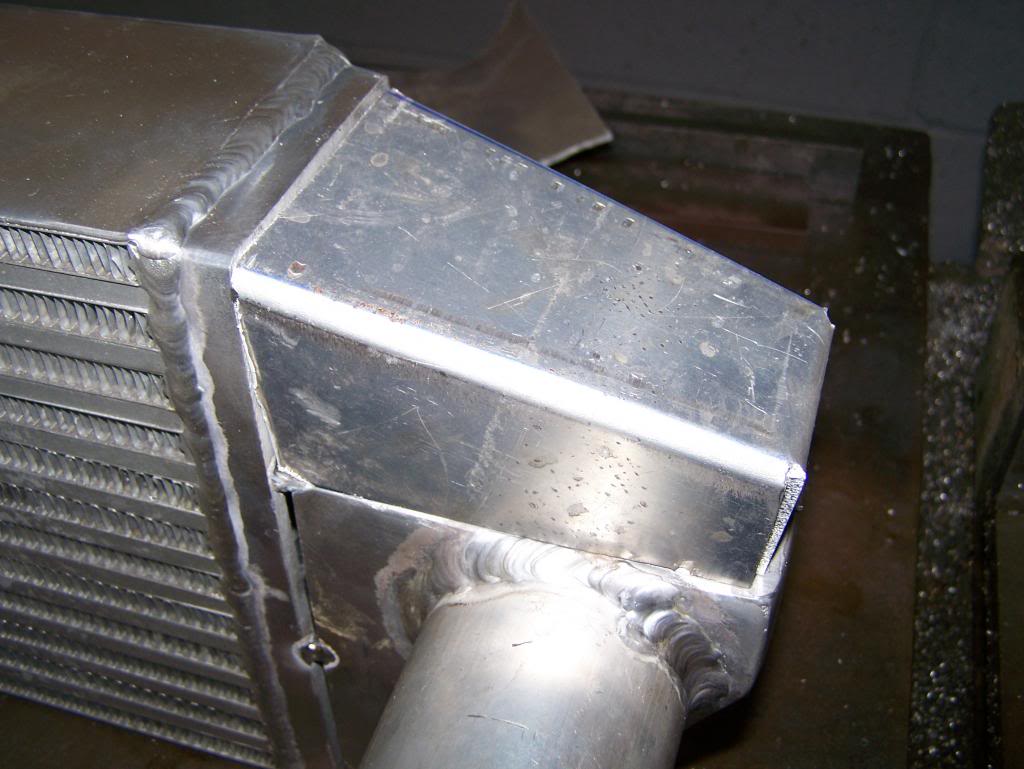

Template for the end tank pieces. I made just one but I oversized it just slightly so I could trim to fit.

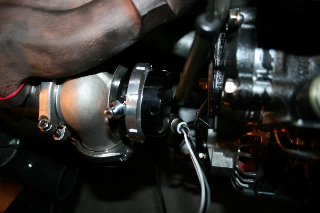

Cheapo 44m wastegate
Initial mock up
There is 1/4" or so of clearance at the radiator fan, 1/8" at the water pipe, and nowhere for the discharge to go.

I started working on the 02 housing

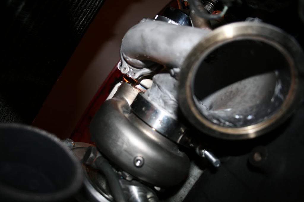

I have been busy with work so I haven't had much time with the car. The 3071 had a major exhaust leak at the primary v-band that I couldn't fix with the turbo on the car. After reinstalling everything that leak was gone but now the wastegate v-band was leaking. I tried tightening the clamp and it just broke. I had to yank everything again. Basically the two flange mounting surfaces are slightly off so I need to cut one of the pipes and reweld them to relieve the tension the clamps was putting on them.
Long story short, I deliberated for weeks as to whether I was going to run a billet 20G or the 3071 before I pulled the trigger on this set-up and I think I made the wrong decision for a daily driver. For servicing reasons this tiny little engine compartment is too much of a pita. The 3071 will be for sale as soon as I fix the v-band situation and I am waiting on a billet 20G with 6SL2 wheel & 7cm housing.
