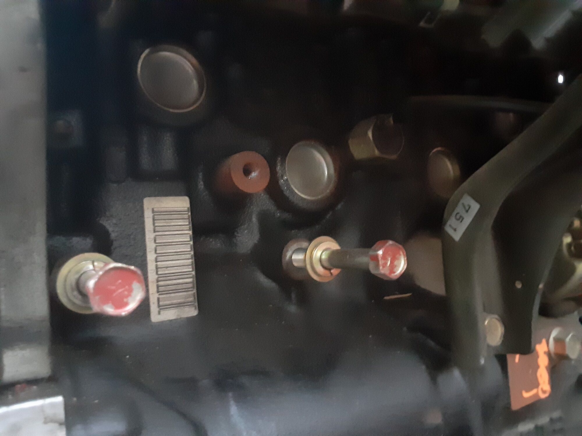

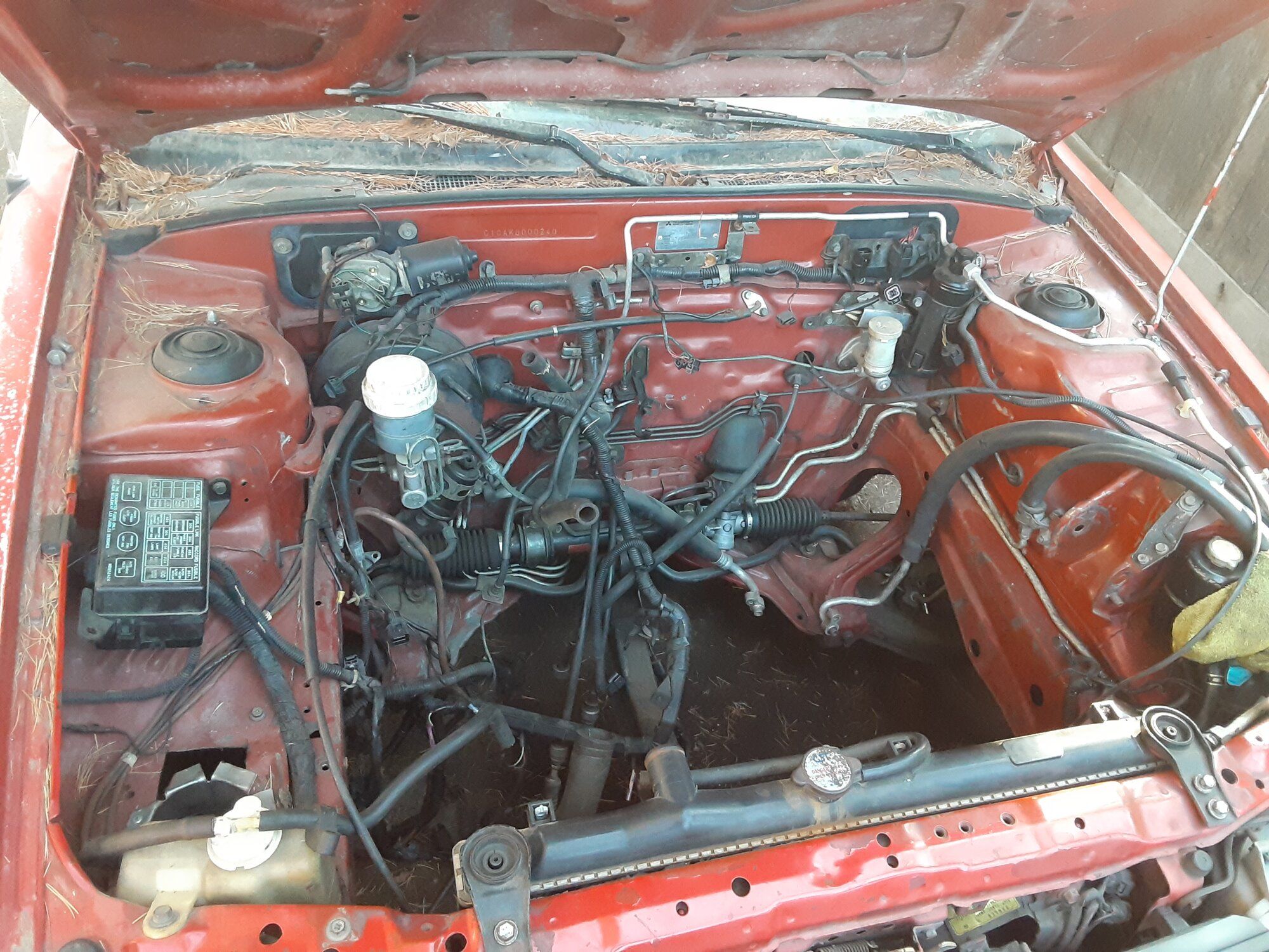

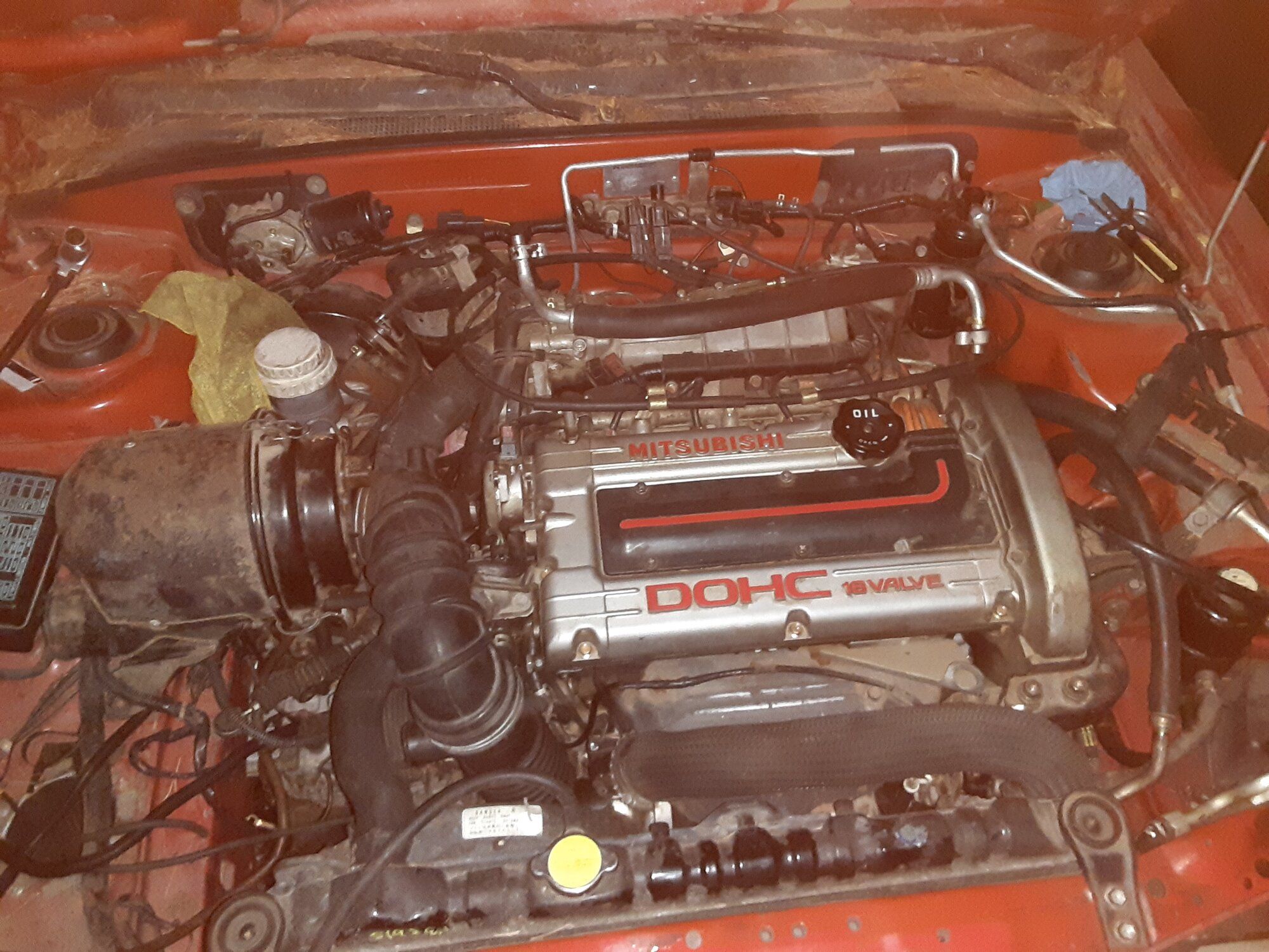

I happened to have this mint '91 talon 86k mile 4g63t engine and transmission to drop in.

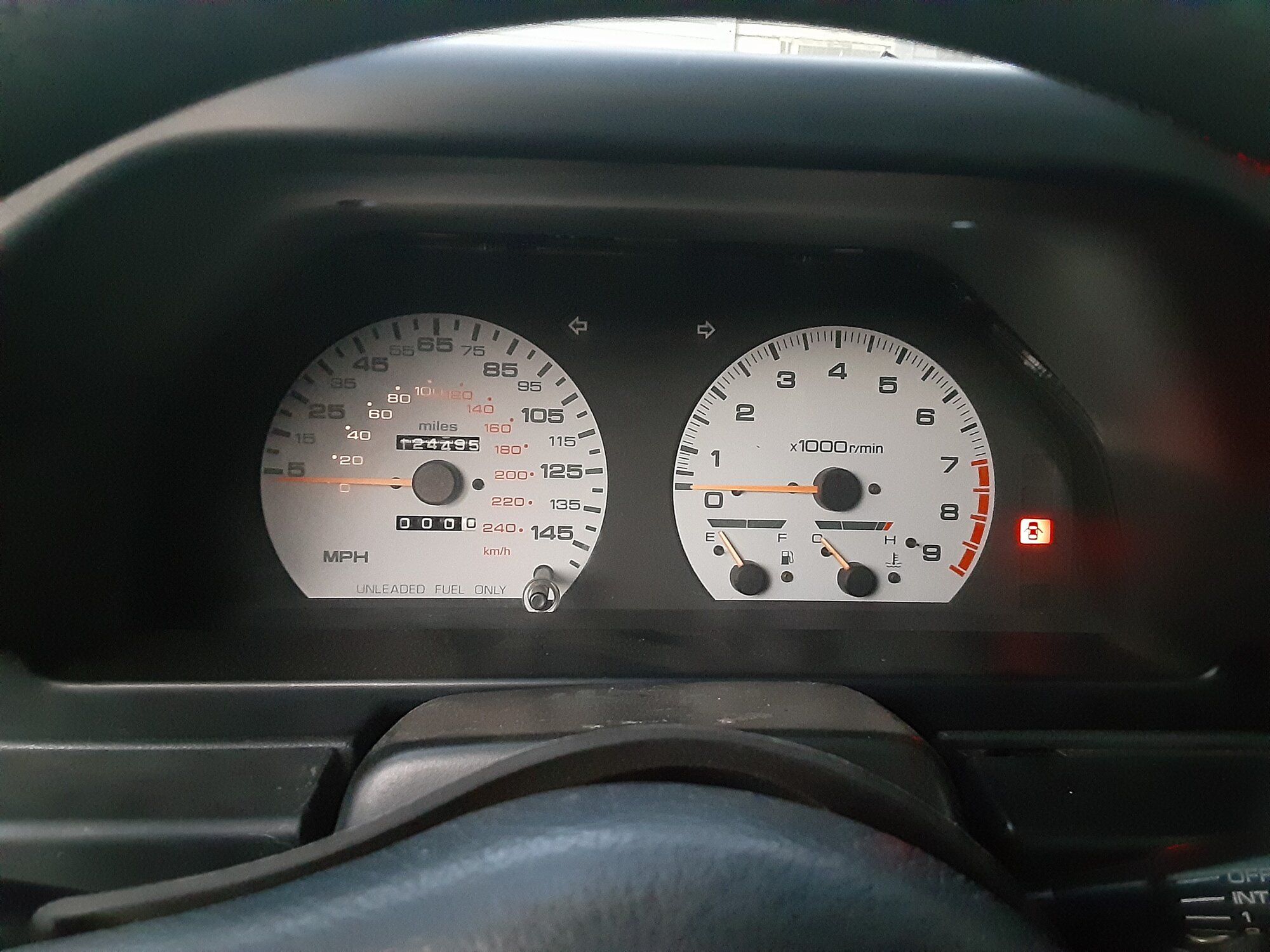

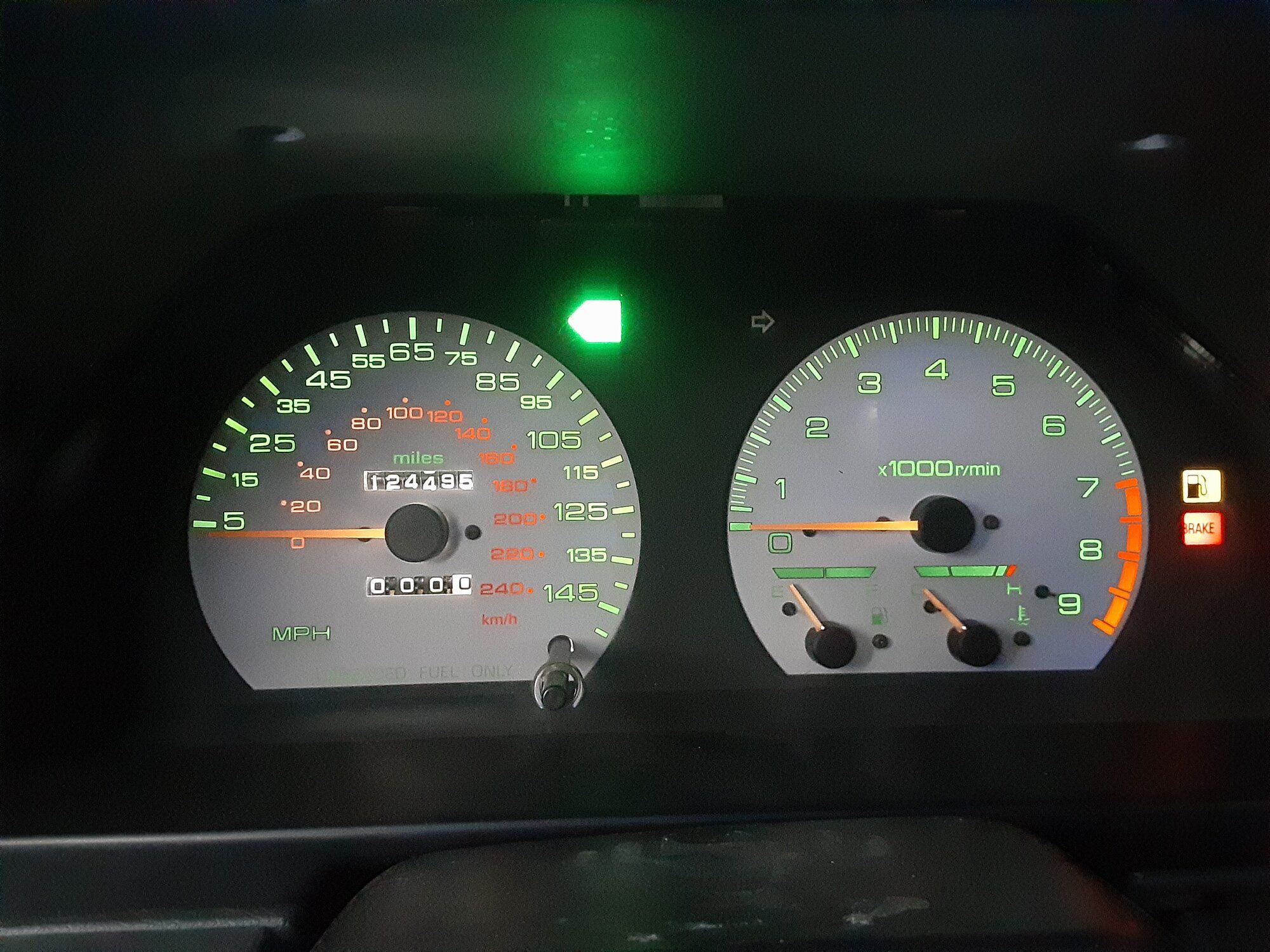

I plan to delve into my stash of CSM goodies and make it awesome again, i put in my white face gauges with led bulbs to kinda make it look unique.

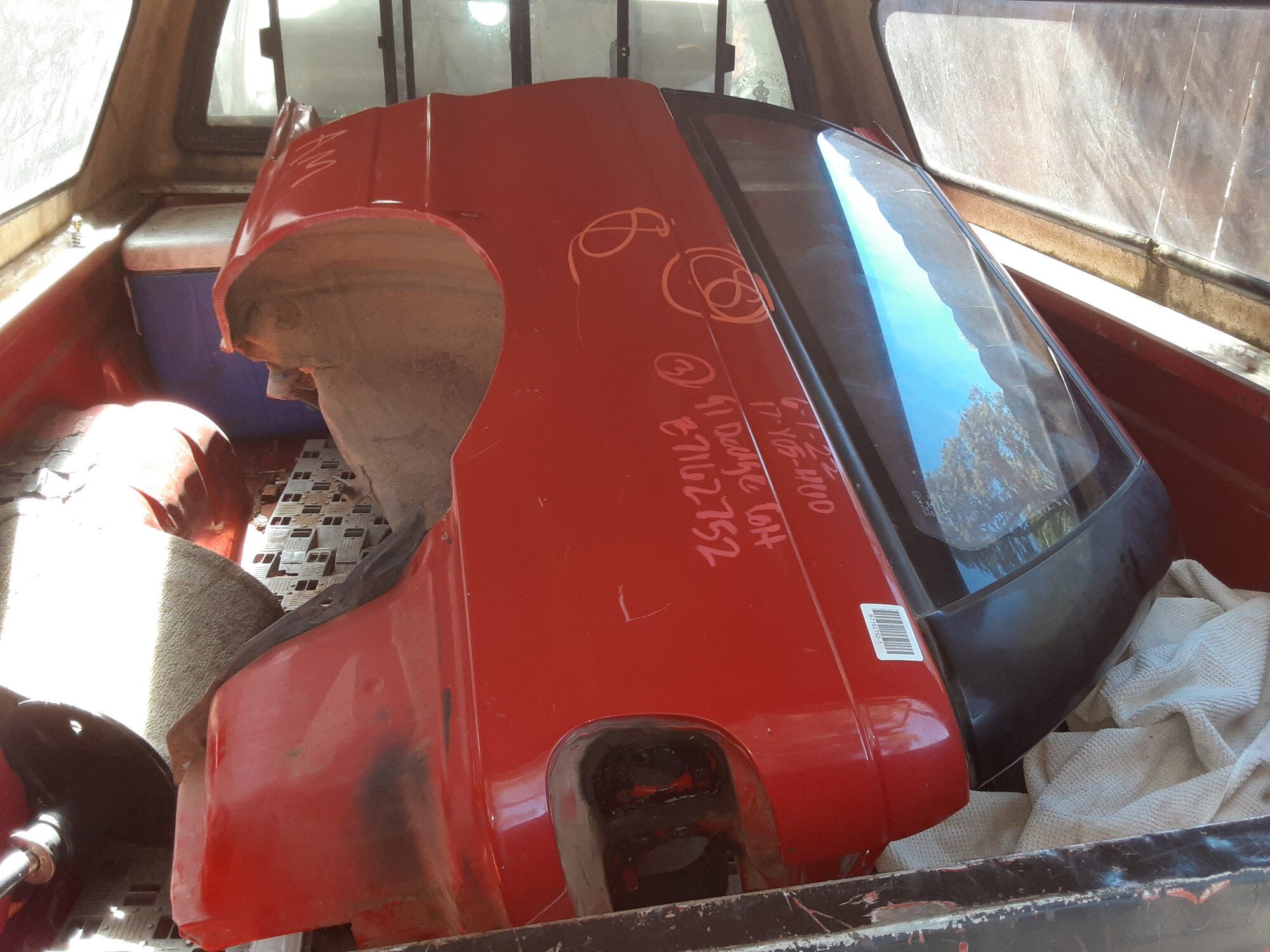

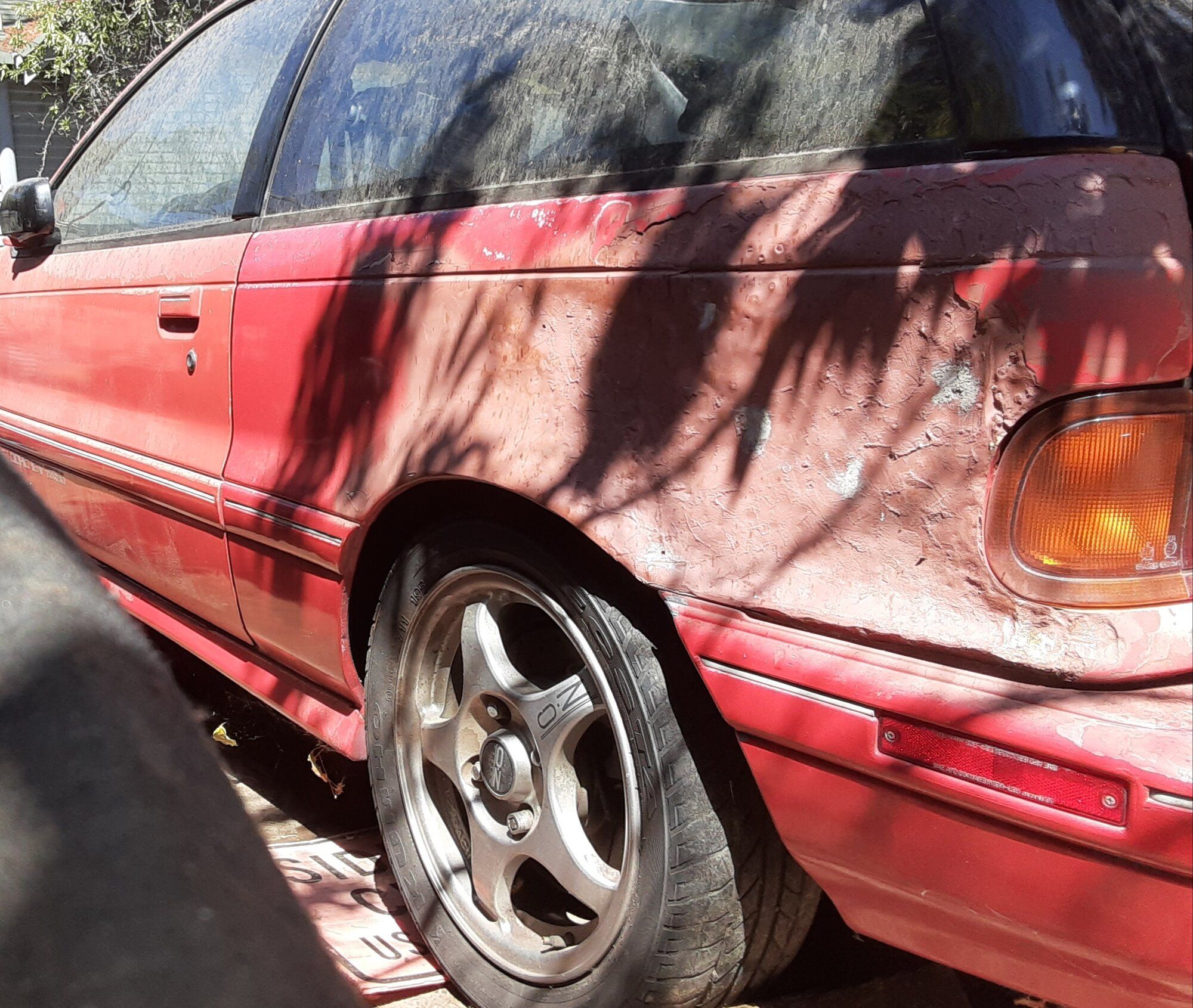

Glad to see it getting some love with the new motor and especially the much needed quarter panel. I still have the FMIC from it and most of the IC piping too if you need it.

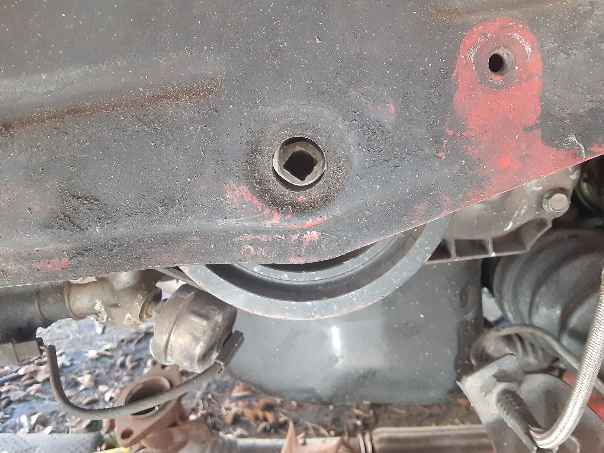

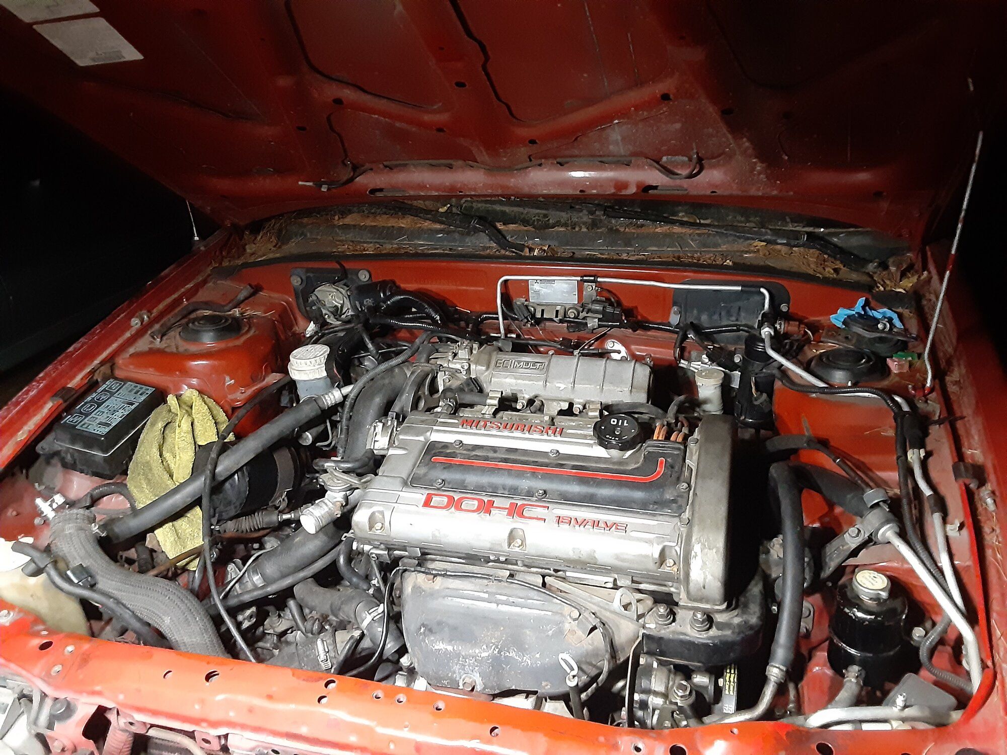

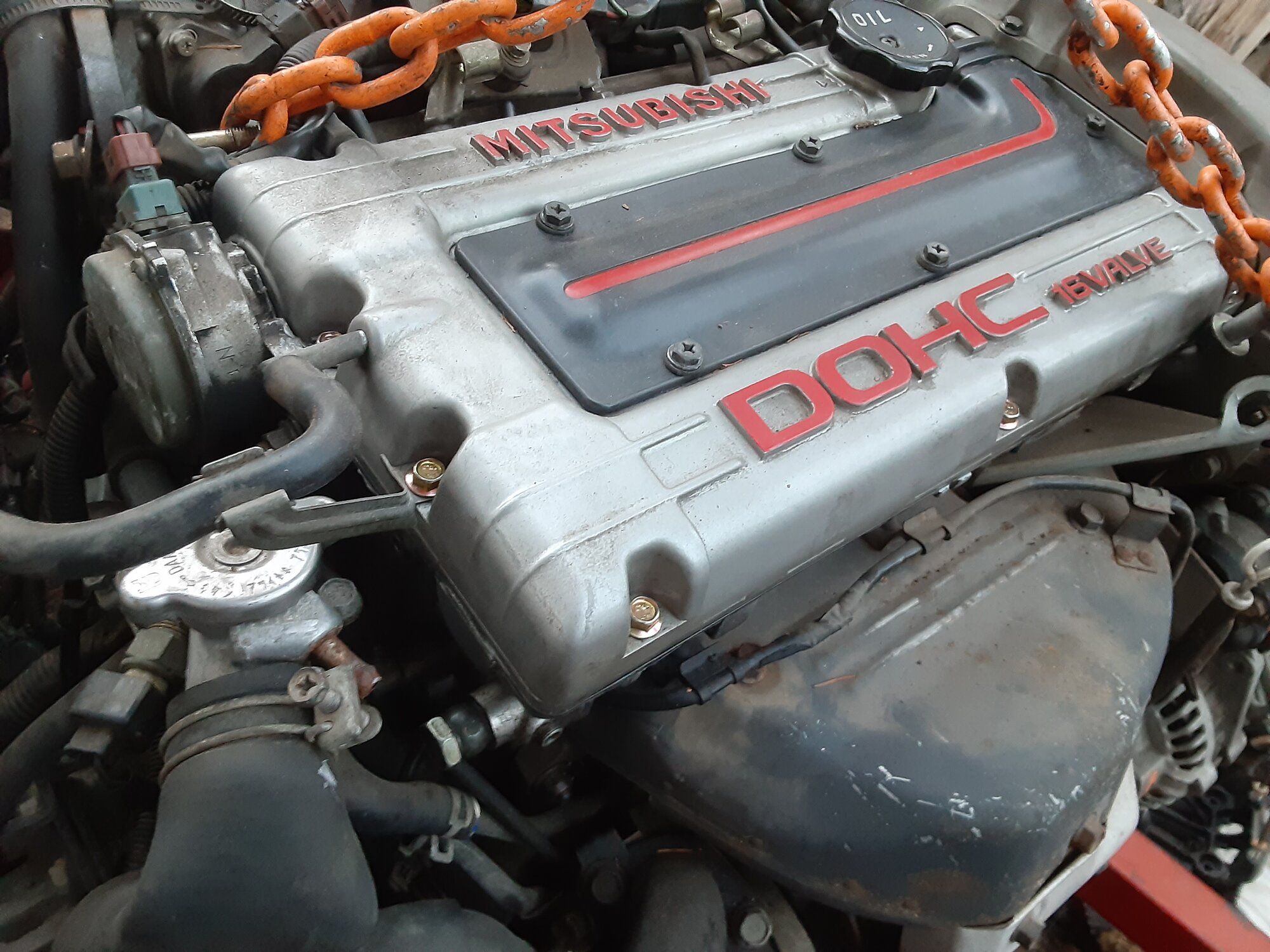

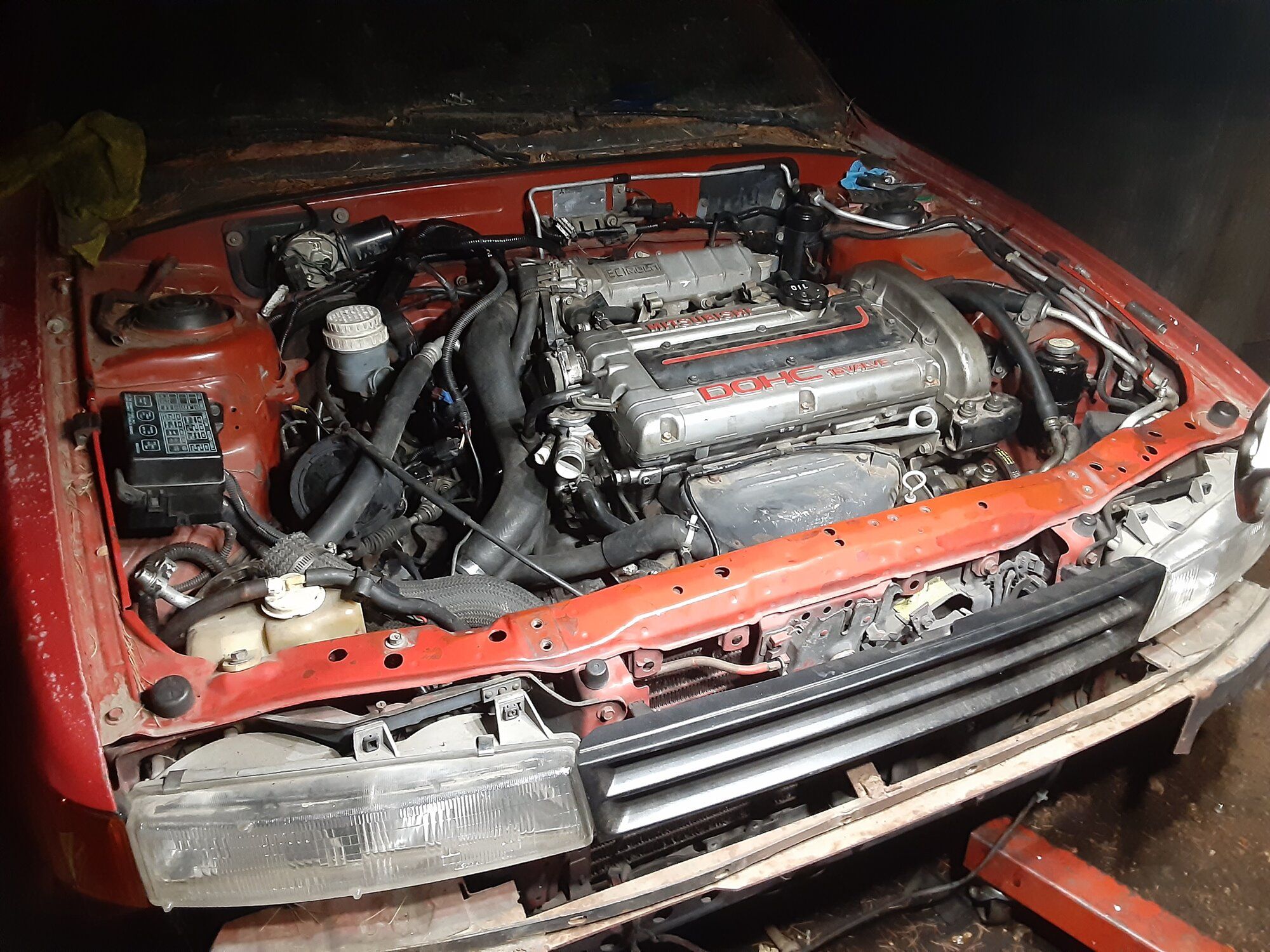

I figure it's a good idea to focus on making it run first, so i can get the car registered, i got the engine refreshed new water pump t belt etc, i got the engine and transmission mounted, i also had a spare set of nos UK amber side markers that i installed, i still have a lot more stuff to do but this was a big step.

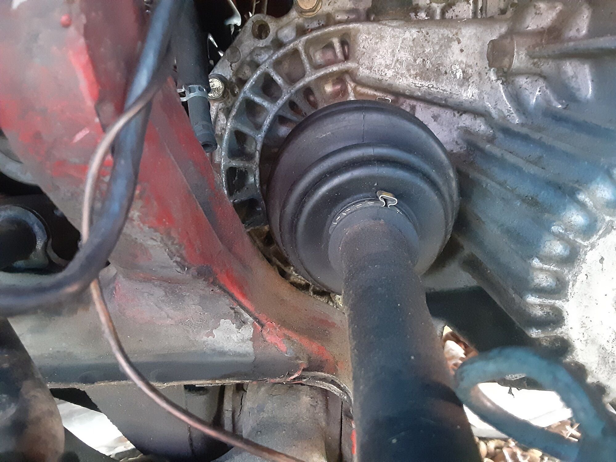

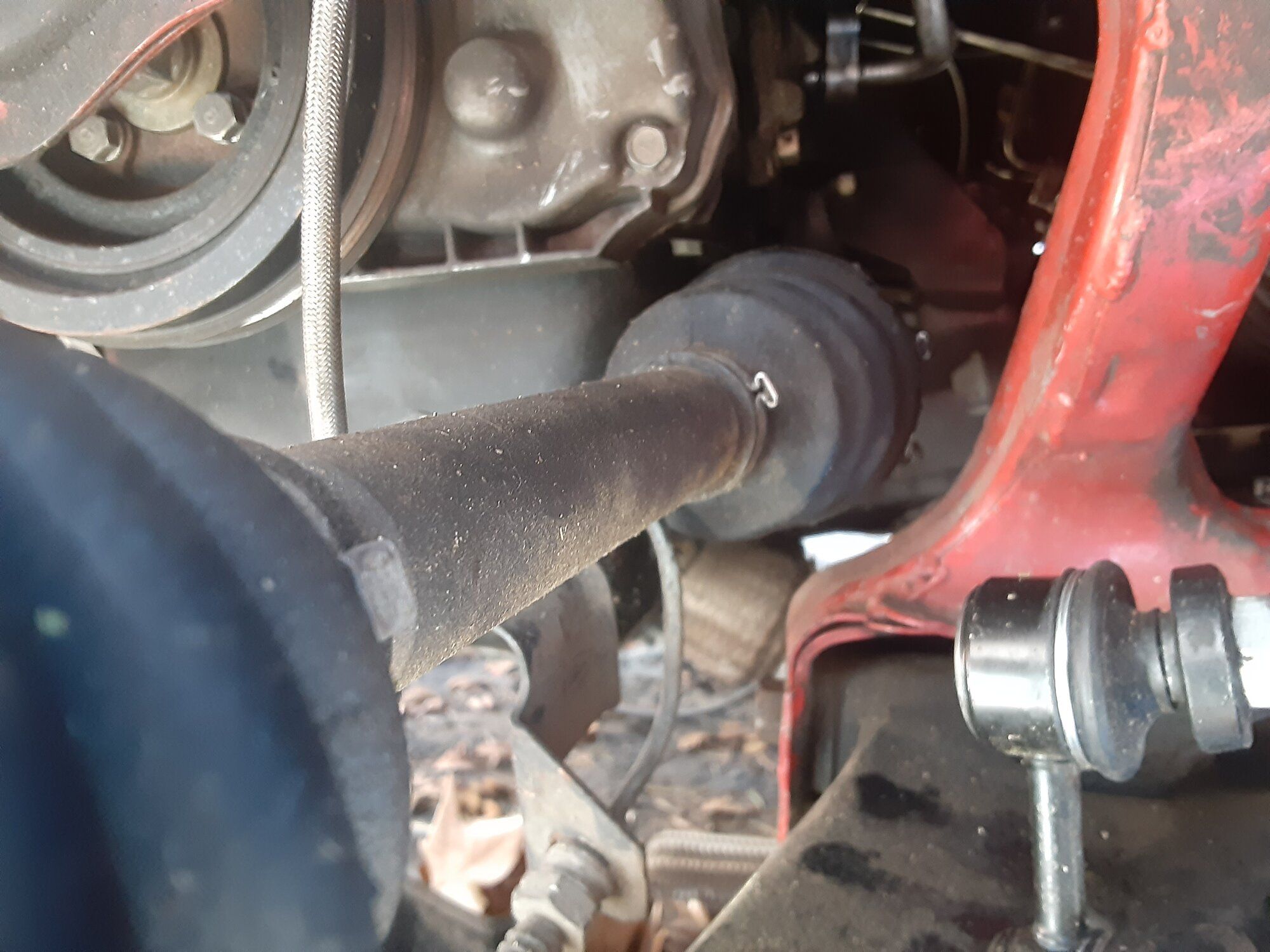

Decided to try and modernize the a/c setup i bolted an early 2g a/c bracket and tensioner on to the block, i may end up having to crimp 2g hose ends onto colt lines in order to run a 2g compressor, but will update if that ends up being the case, i did it also so i could bolt the halfshaft up at the same time.

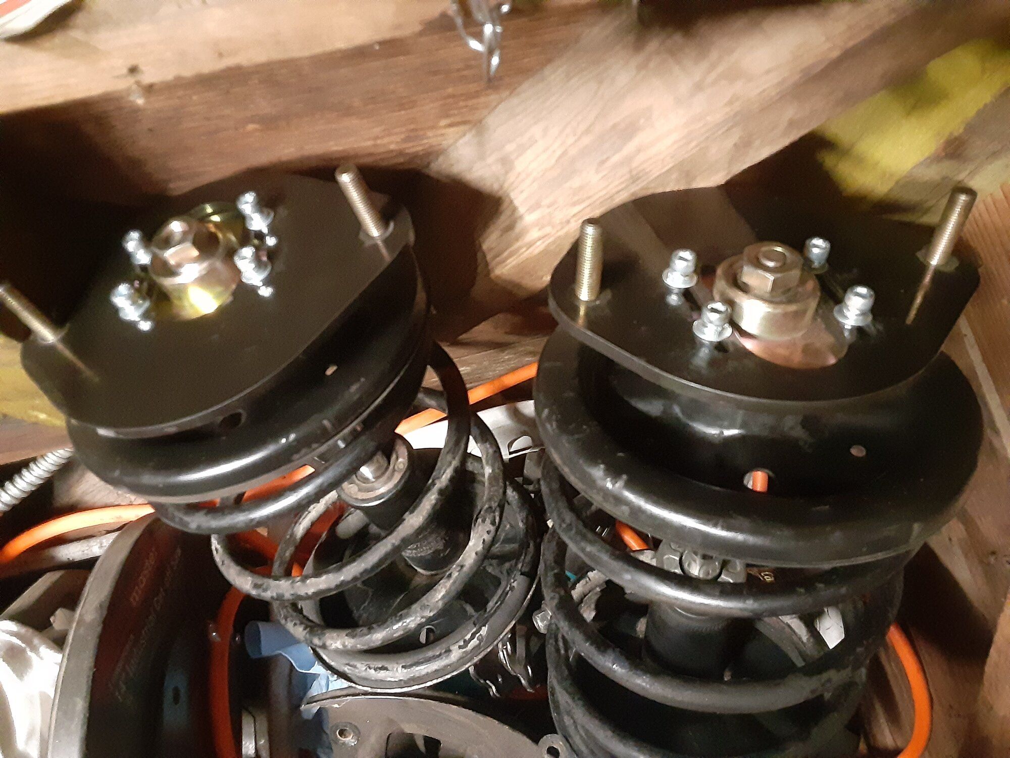

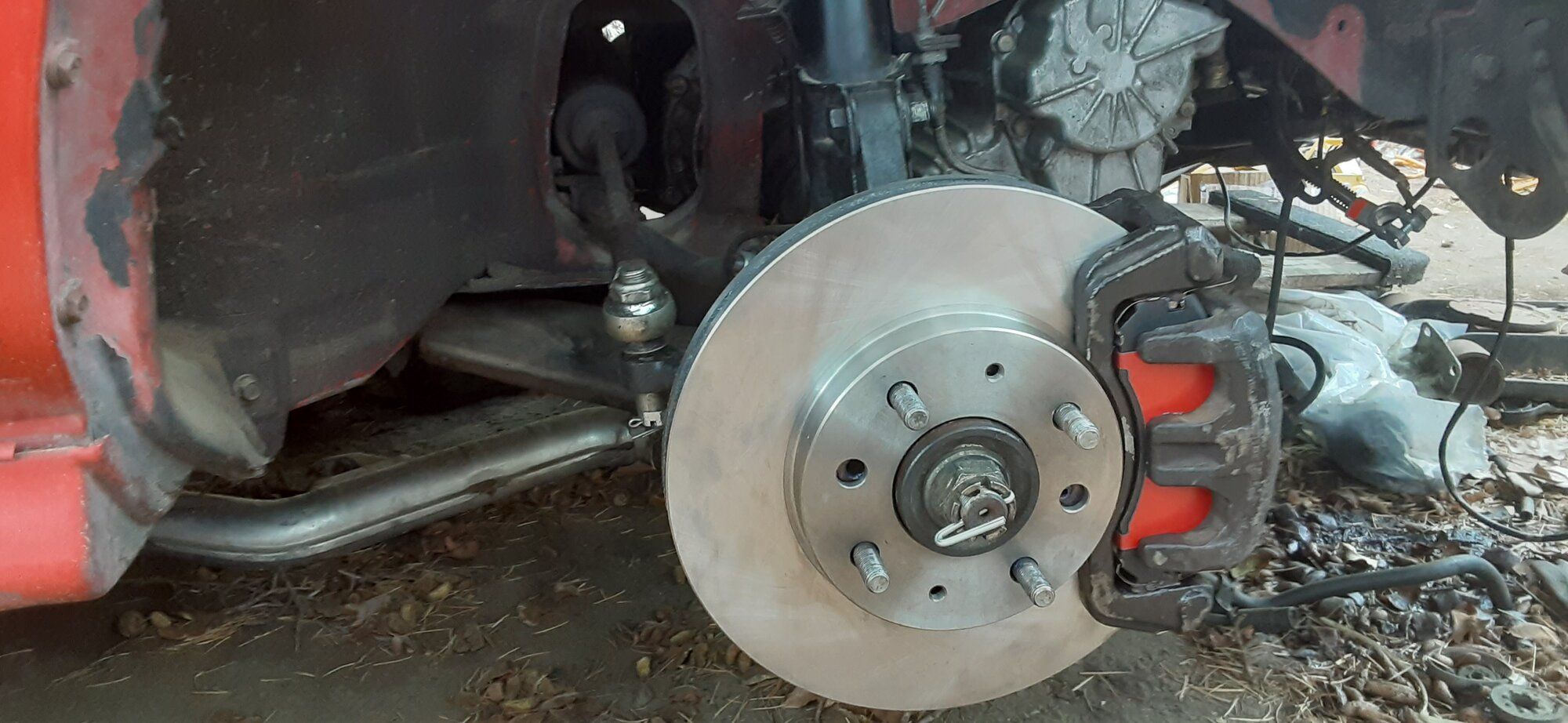

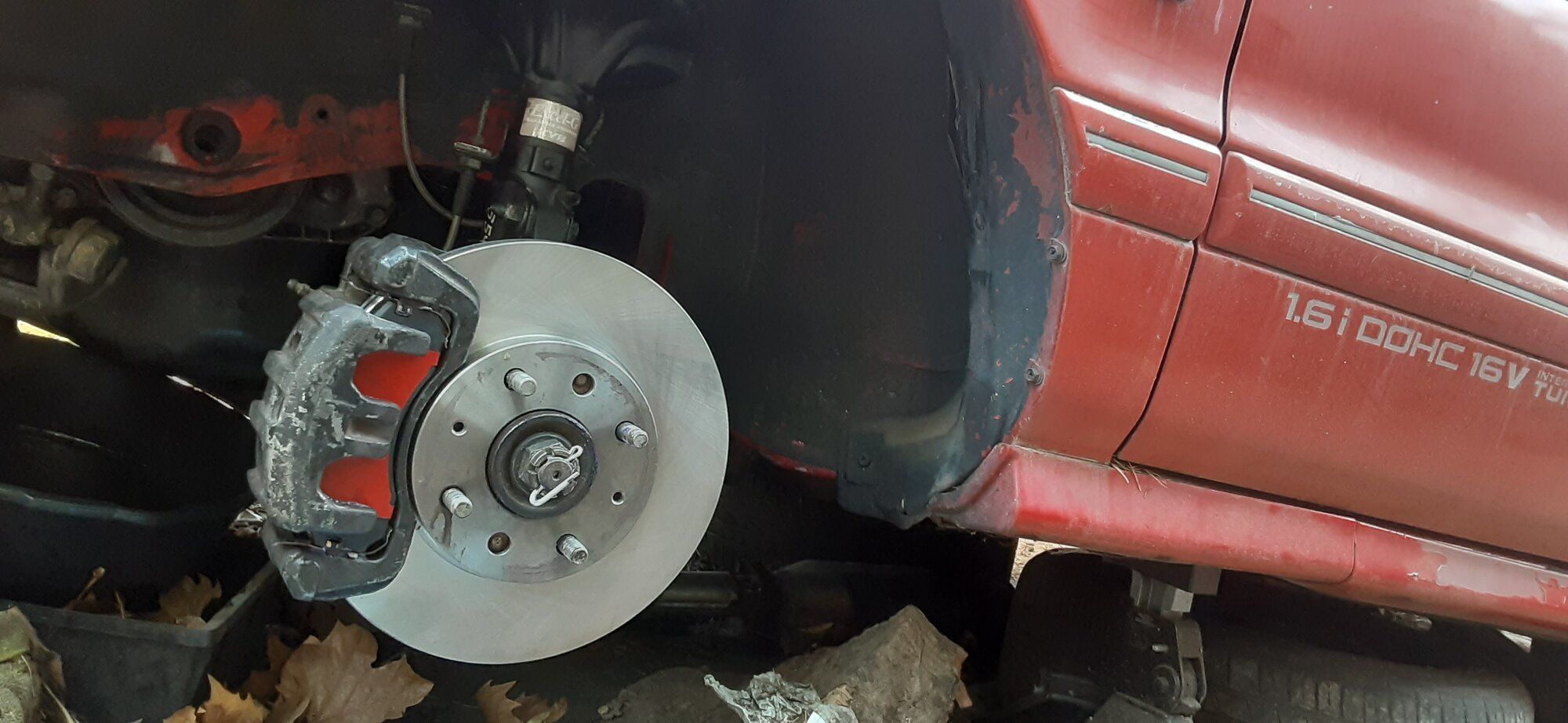

My plan to get the camber fixed major thanks to josh at yoshifab.

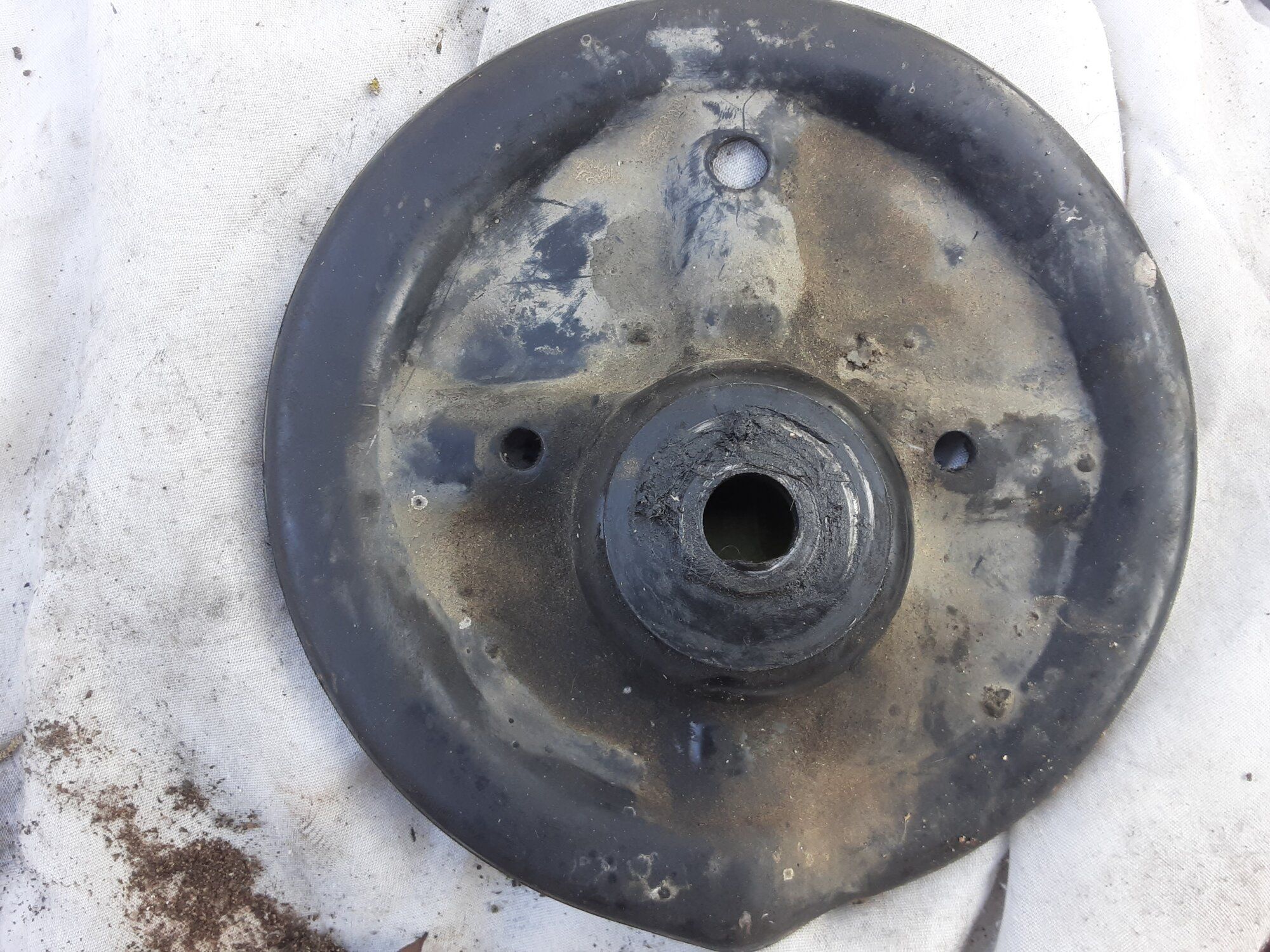

i found out one of the top spring plates was rounded out and as a result it was hitting the inner fender well area of the car when turning and created play in the steering.

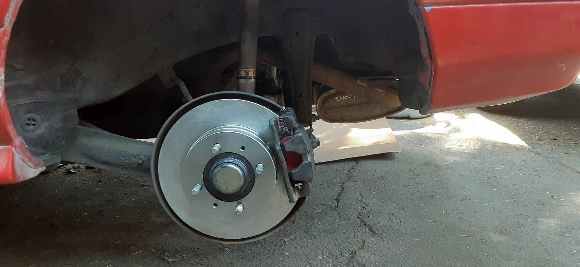

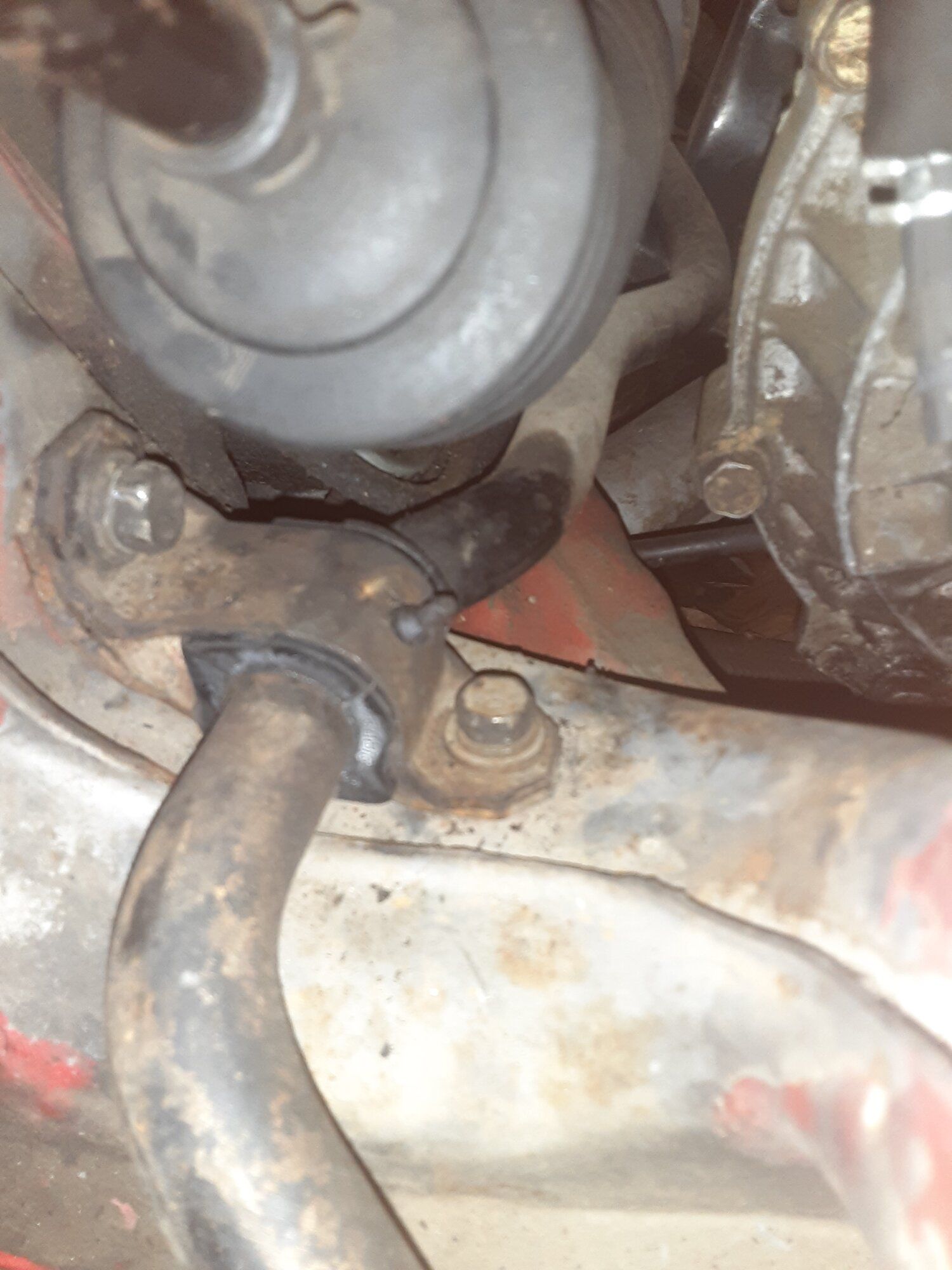

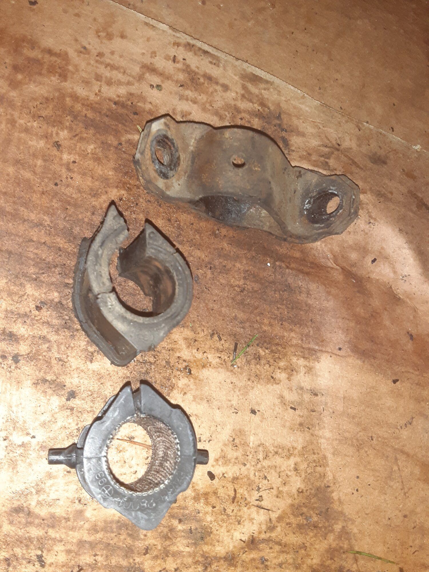

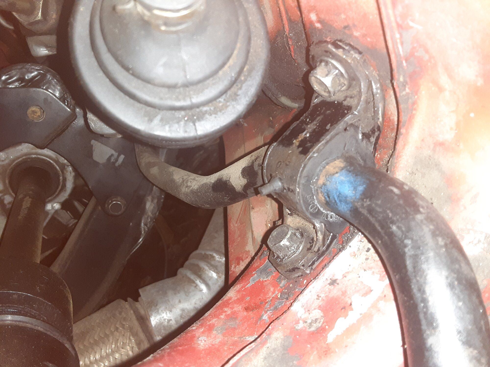

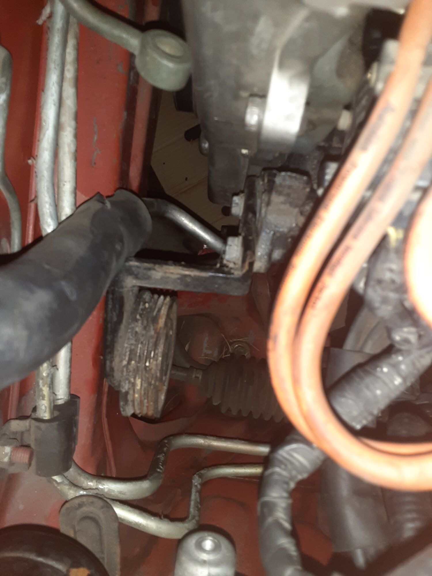

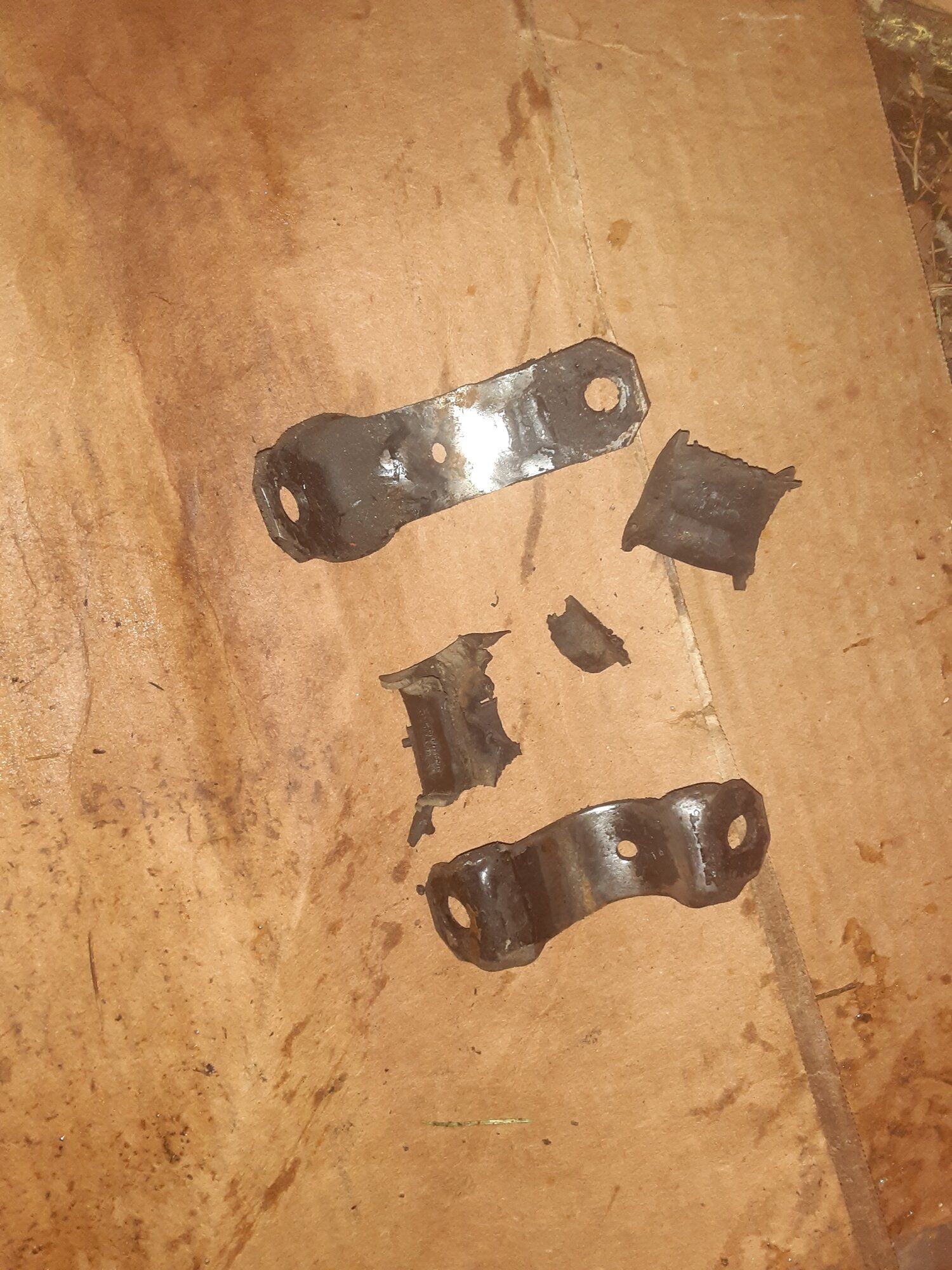

More progress i replaced the sway bar end links and the mounting bushings, i vary much doubt the sway bar was doing it's job, based on how sloppy and brittle the rubber bushings were, I probably will go back in at a later date to clean the grease and grime under the bushings and repaint the frame and the firewall.
