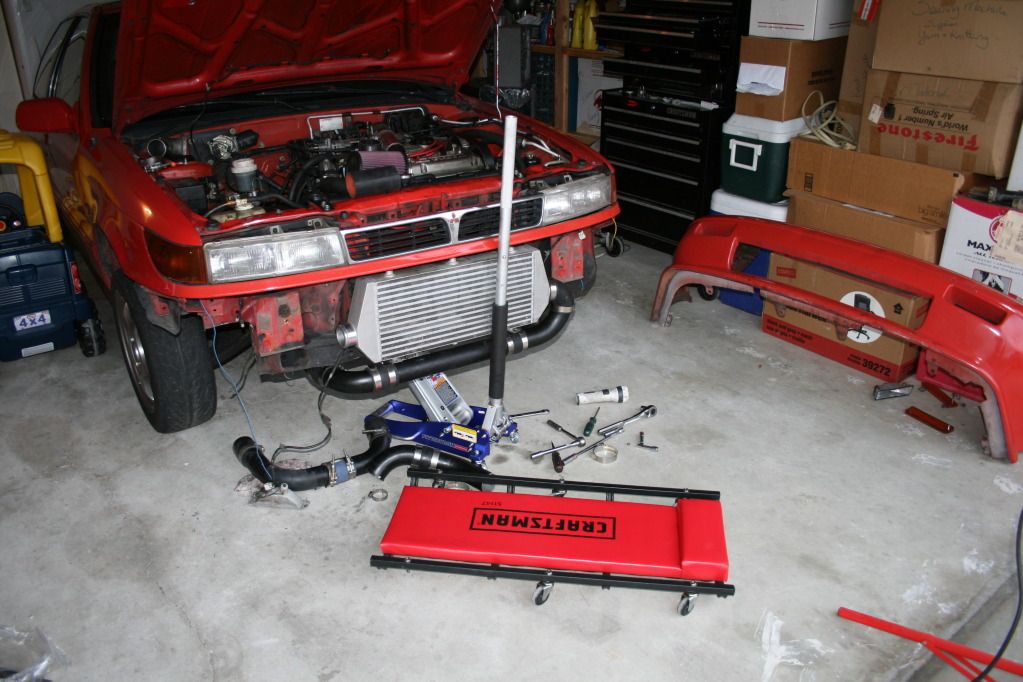

I spent the last few days reworking the cold side intercooler pipes. I was able to reuse some of the existing pipes so this didn't cost anything but my time. Actually, I did cut up the stock 2G throttle body adapter and welded on a 2.5" inlet from one of the unused pipes. I didn't take any pics of how it was before but I eliminated 4 bends and made enough room in the engine compartment to actually mount the air filter where it belongs. Previous owner also had the BOV on the hot side pipe which was corrected.
It needs engine mounts something fierce. I have a friend that works at Energy Suspension so that will be addressed shortly.
I am also on the hunt for a Colt grille and rear taillight insert. I found a grill on ebay last night and it happens to be red but it is chipped and IMO too expensive ($40).
The battery is ghetto mounted in the hatch. That will be addressed shortly. Honestly, that was the main reason why I rearranged the intercooler pipes because I was hoping I could fit the existing battery in that space.....NOT SO MUCH. I need to find a tiny battery like an Odyssey, Braille or equivalent to fit it under the hood.
There is an issue with the driver's side window motor and also seat belt tract. These issues were a little lower on the priority list.
Pile of aluminum pipes being eliminated one by one
Used some 1" wide aluminum bar to make a MAF bracket
The hot side pipe still bugs the hell out of me. What a terrible way to route that pipe. The thing had been dragging the ground and was in terrible shape. One of the clamps literally broke from being ground down so far. I replaced the clamps and the pipe with a steel piece. I'll eventually reroute the piping around the driver's side of the radiator but that will have to be done at the same time as a compressor housing upgrade that has an outlet pointing the proper direction.

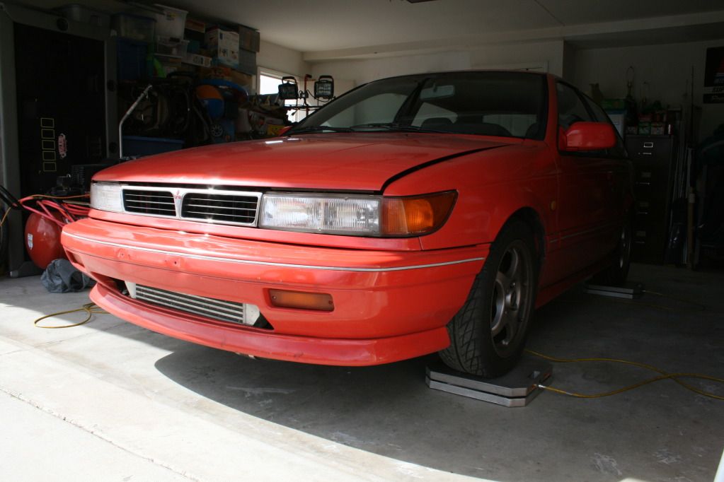

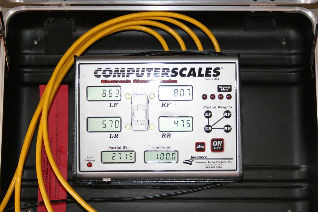

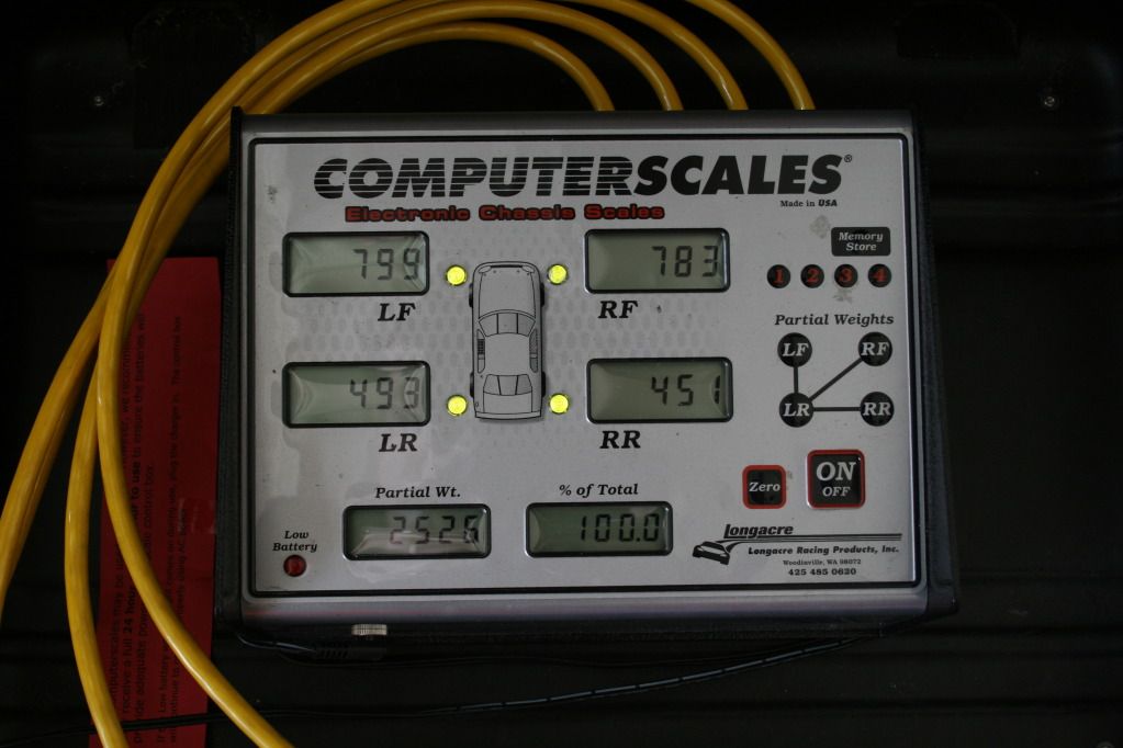

Curiosity got the better of me so I borrowed the Longacre scales from work. My garage floor is not perfectly level so it was reading a little heavy on the driver's side.
Without me in it
With me in it

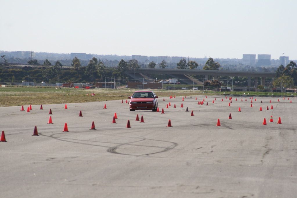

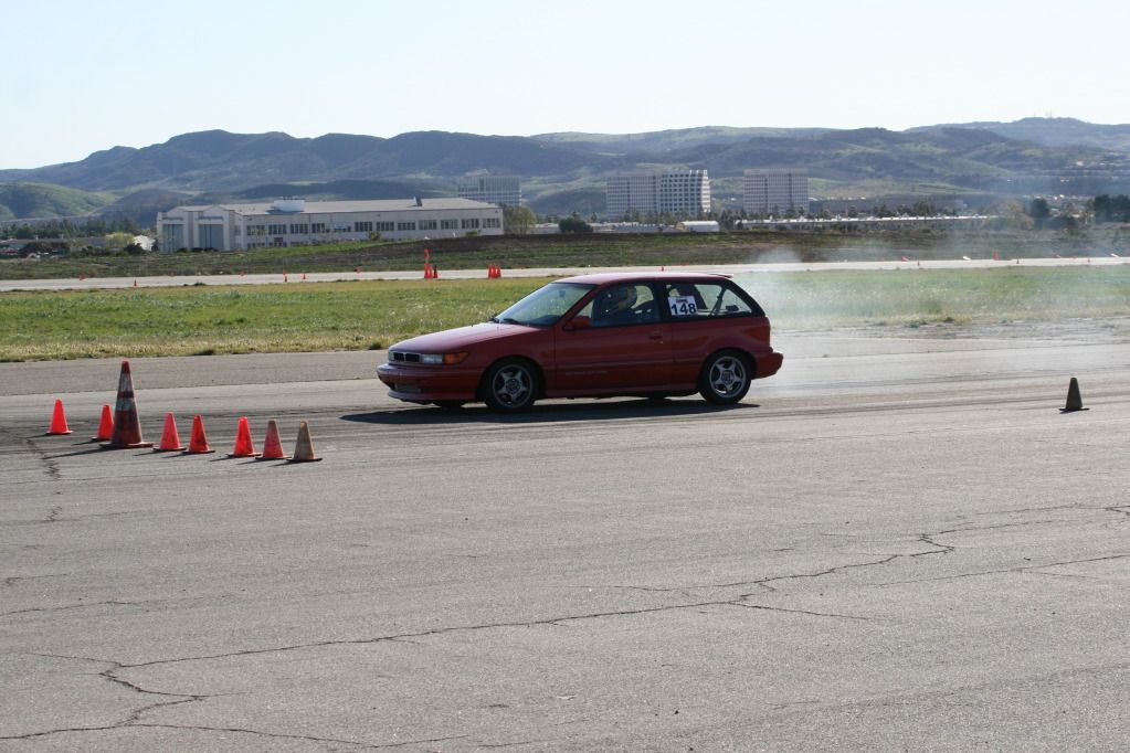

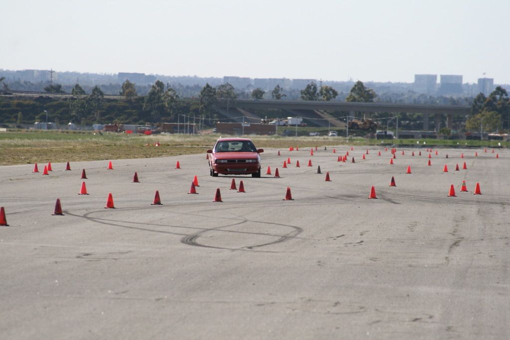

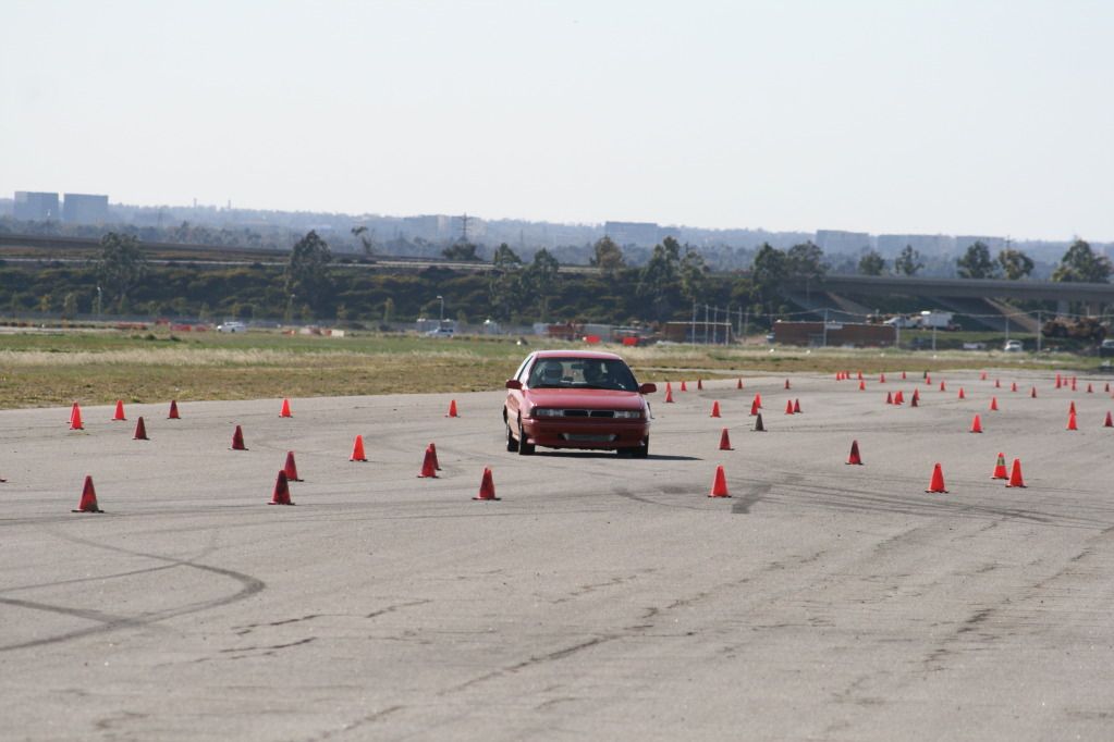

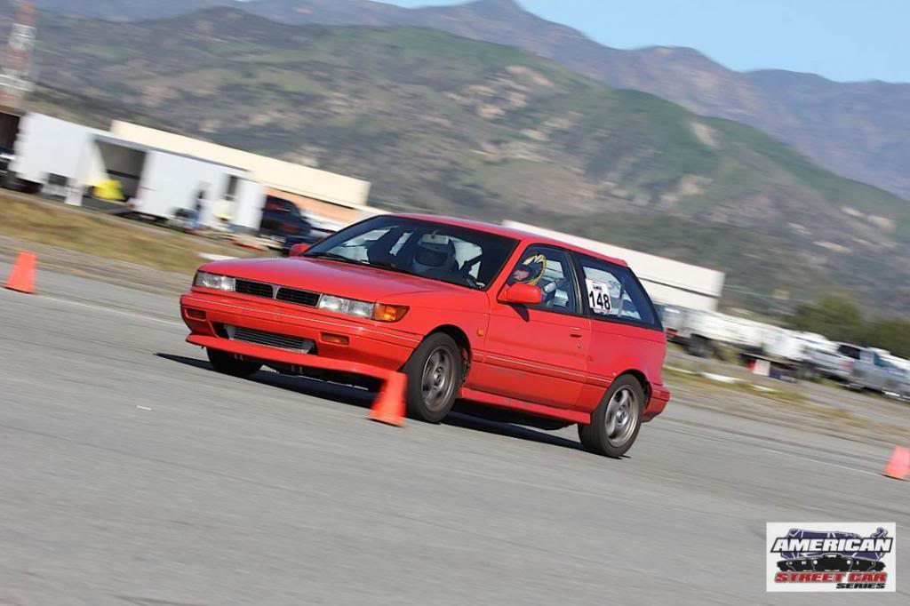

Got a chance to kill a couple cones this weekend. The American Street Car Series | guys were in town and our shop Camaro and a customer's '32 Ford were already racing. We had a 3rd entry that had some tranny issues so I went ahead and used his registration for my car. I was too busy Saturday to actually make a few runs but Sunday wasn't as hectic so I made 3 runs on the Speed/Stop squared and 3 runs on the autocross. I wasn't expecting to set the world on fire (which I didn't) but I got my feet wet and know where to proceed from here. Had a ton of fun too.
Speed/Stop squared is basically a short drag race, followed by a slalom and a stop box. The fastest car of the weekend ran a 20.9, our shop Camaro (pictured below) was 2nd with a 21.122. Most cars were running 22-23's. So I am off pace by a few seconds but considering the level of competition I have no worries. I finished 70th out of 84 cars on the speed/stop.
Video is uploading now
Our shop cars are heavily guarded by management so I have only ever autocrossed once before and that was in the '32 Ford I mentioned above. That car was a handful being 48/52 % weight distribution, 2800lbs with me in it and 450HP. The Colt was even more out of control than the '32. It was a wild stallion that just didn't want to be corralled. The tires are basically bald so I wasn't expecting much but this was just crazy. The first lap I was playing it safe maybe driving 8/10ths and spun at 50 mph trail braking into a left hander. *note to self* need less rear brake bias. Long story short, At least I wasn't in last place. I ended up in 60th place out of 65 cars.
Here is my car sitting behind our shop car
Getting ready to run the autocross.
No videos of my car on the autocross but here is a sequence shot
