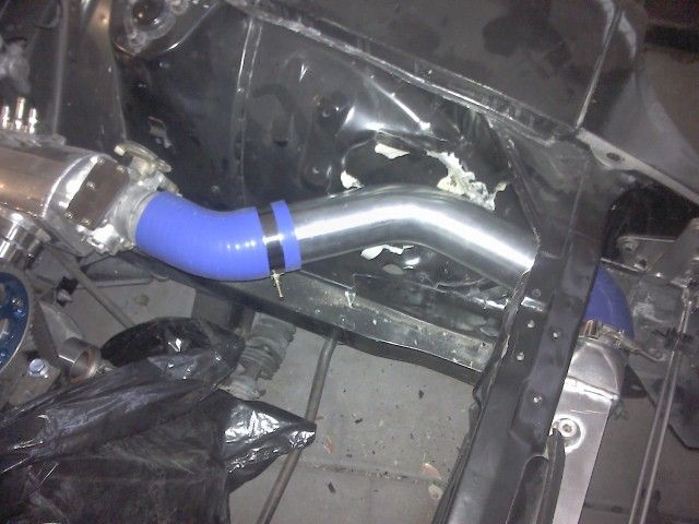

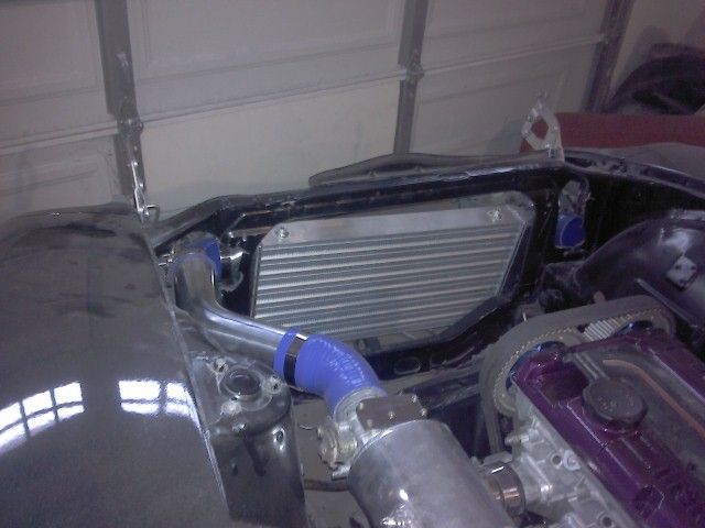

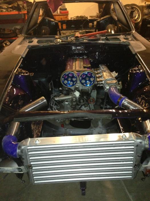

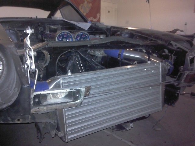

Haven't been able to do much between school, work, and personal life stuff. Been working on little things that need to get done but not worth mentioning LOL. Here are some pics of the intercooler and the cold side of the piping (can't do the hot side yet because i don't have a turbo or manifold). I had to dent the wheel well a bit in order to fit the 45 degree bend. After some paint it should look nice. NOTE: the intercooler is not mounted yet, just chilling there.

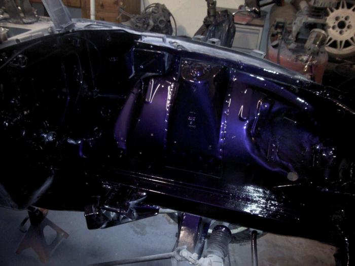

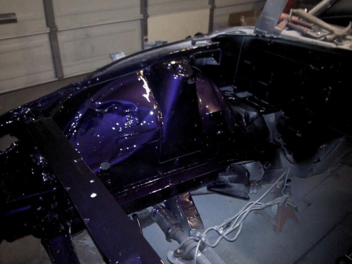

So I've made some progress on my car. I painted the engine bay the final color of the car. Car should be painted in the next couple weeks. Heres some pictures:
The car will be a darker shade of purple when i paint it. i want to get it as black as possible with only a hint of pearl. I will add way less pearl to the clear when i do the whole car.

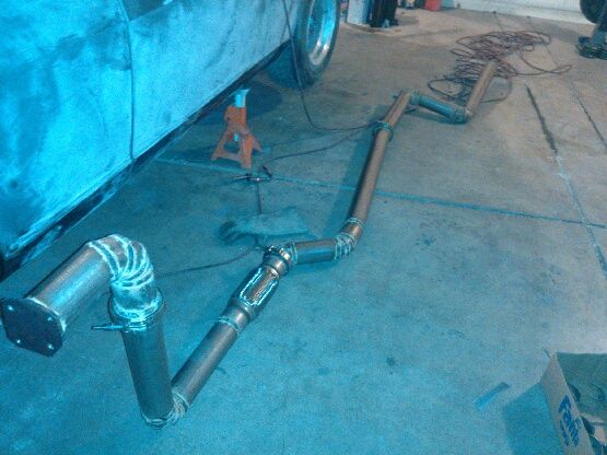

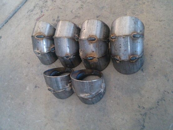

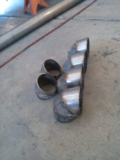

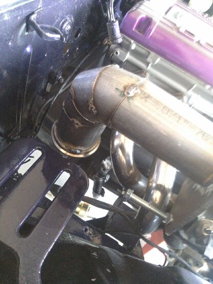

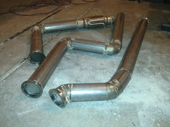

Well, i have good new! I had some time today and i thought id tackle my exhaust. I began with the down pipe from the turbo, top mount turbo :hellyeah:. then i made the rest but was so caught up in making it that i forgot to take pics while i made it LOL but i have pics of it all tacked together. Im welding it all right now but taking a break to eat and post this... Keep in mind this it the first time i ever made an exhaust, let me know what you guys think. oh and its a 3" turbo back :D, and all V-band! ...PS ill try to post pictures of it installed in the next couple days.

Lookin good! If the back end is sealed up nice and tight I'd make a seperate v band "section" and just have a turn down where it goes into the two 90's at the back. Then if emissions are required you could swap it to run all the way back to exit out at the bumper. It just seems like a lot of sharp bends.
Looks awesome though, man. Always look forward to seeing an update!
It is a lot of sharp bends but the way the car is its kinda the only way i could make the exhaust because i need it to come out of the driver side and the exhaust comes down from the passengers side and i have to leave room for the gas tank so those 90s at the end are needed to fit the gas tank.
I do think ill do a cut out valve one day, using an external waste gate. And emissions aren't a concern because i have a guy that'll pass it for the right fee LOL
Once i come up with an idea for the hangers (might just go get some stock ones from cars at the junkyard), ill install it so you guys can see how it looks in the car.
Yeah, a cut out valve would be sweet! I figured the reason for the 90's was from the chassis design, and it looks really good. All the custom work going into this thing is amazing!
Thanks! hearing comments like yours makes the building worthwhile :rocks:

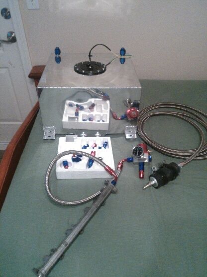

Got some parts in the mail :rocks:.....
10 gallon fuel cell
walbro 255 inline pump
-6an fuel line (15')
AFPR, no name-hopefully it works :pray:
Should install either this weekend or next.
