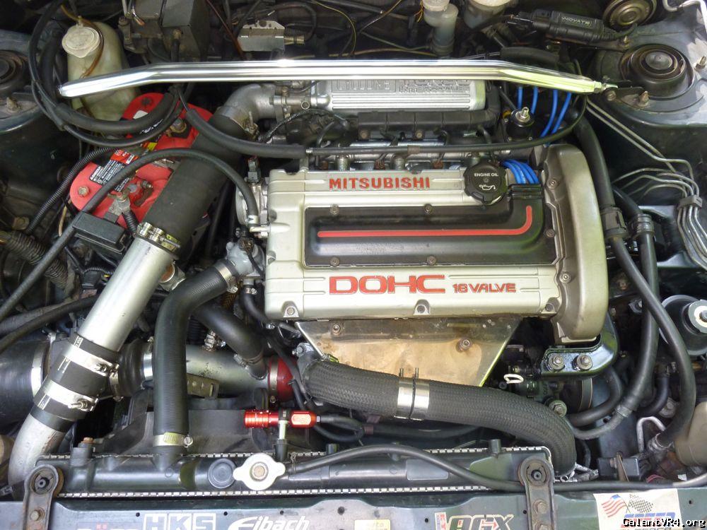

1. Get the cyclone intake functional
2. Replace rotted vacuum lines
3. Replace the leaking Turbo XS BOV with an NGR I have laying around
4. Turn the factory BCS into an electronic boost controller
5. Install Walbro 255lph fuel pump and rewire kit

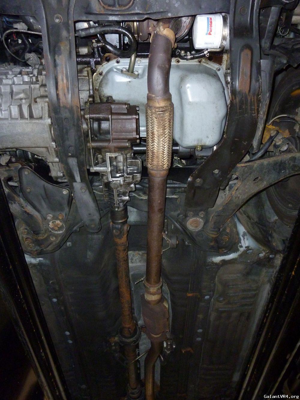

6. Redo exhaust, my cat is shot and some welds aren't the prettiest

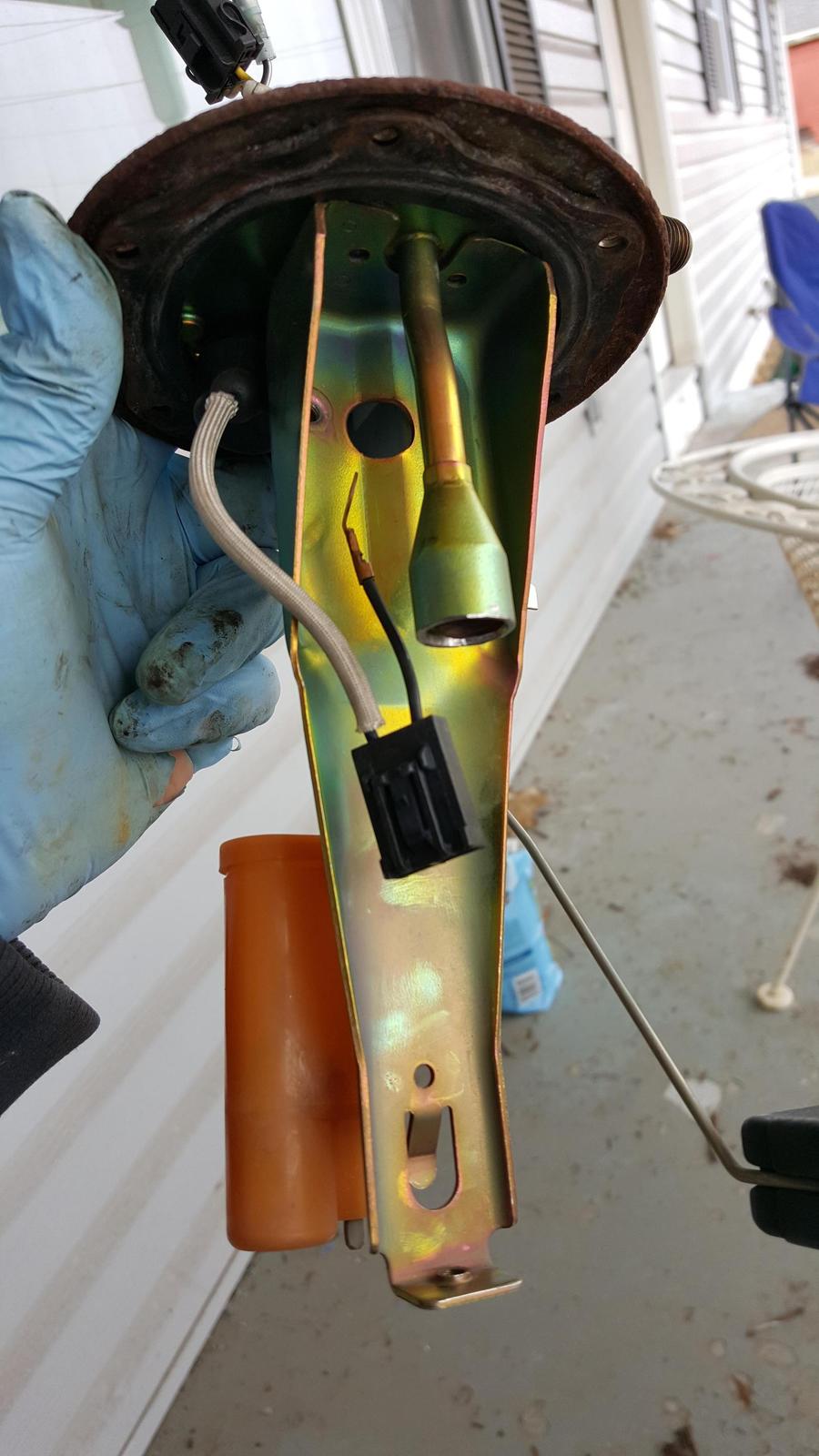

Went to install my Walbro 255 today. Good news is inside the tank looks prestine. Bad news is the pump hanger outside the tank is rusted pretty bad. I'll have to fix the rust another day, the feed line is still strong so I'm not worried about leaks just yet. But it will need attention.
For GVR4s, they say to cut the flared end of the hanger and run a fuel line between the pump and hanger. I couldn't bring myself to hack up my hanger, so I just pushed the o-ring supplied in the kit into the flare and used a smaller isolator at the bottom. It seemed to fit and make a decent seal so I'll see how it holds up. If it causes problems I'll break out the dremel.
