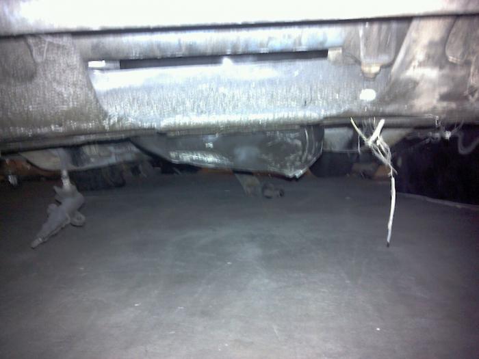

And for my oil pan i not sure what you are referring to but I'm keeping the stock one. Should i not run the stock oil pan?
You now have a front sump pan. just watch the oil pressure during acceleration thats all. Hows the ground clearance?
Oh i see what you mean and started thinking about that once you mentioned it. I hope it doesn't mess with oiling or oil pressure during acceleration. Ill watch the oil pressure and if it drops during acceleration, ill try to make a custom rear sump and extend the oil pick up tube. And ground clearance is pretty good, i didn't want to put the motor too low for that reason. Its about 2" lower then the cross member. I plan on putting sheet metal under the length of the car and hopefully that protects it enough.

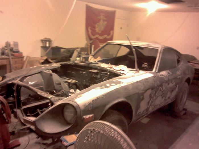

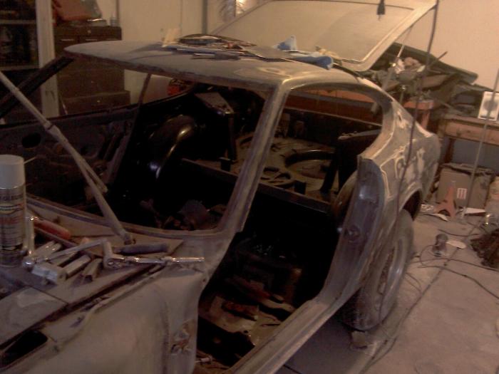

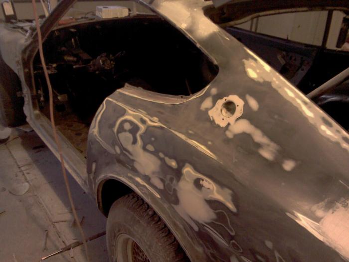

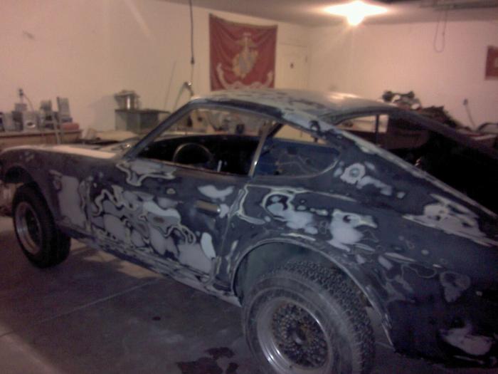

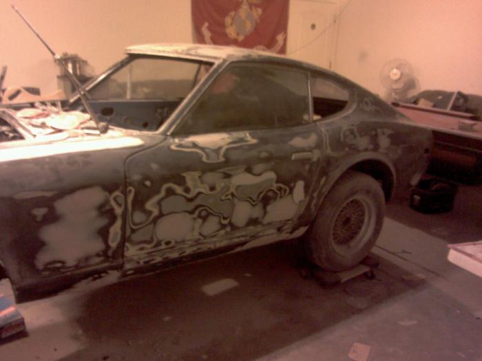

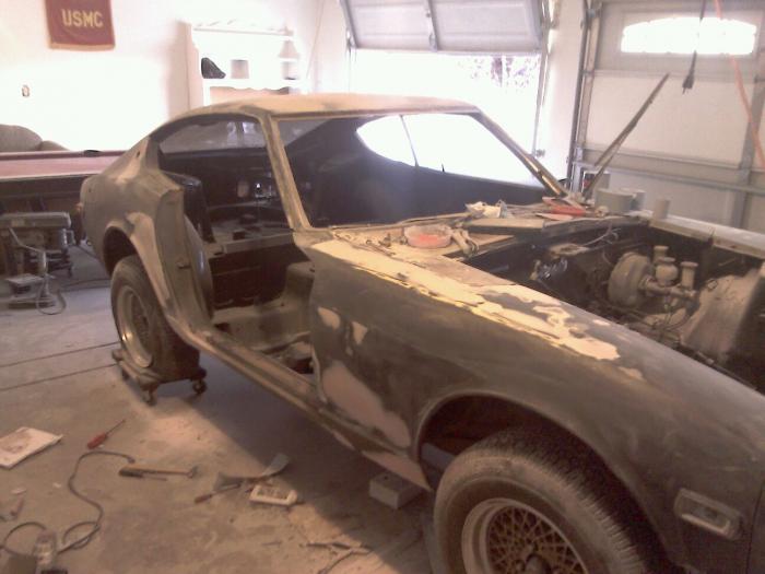

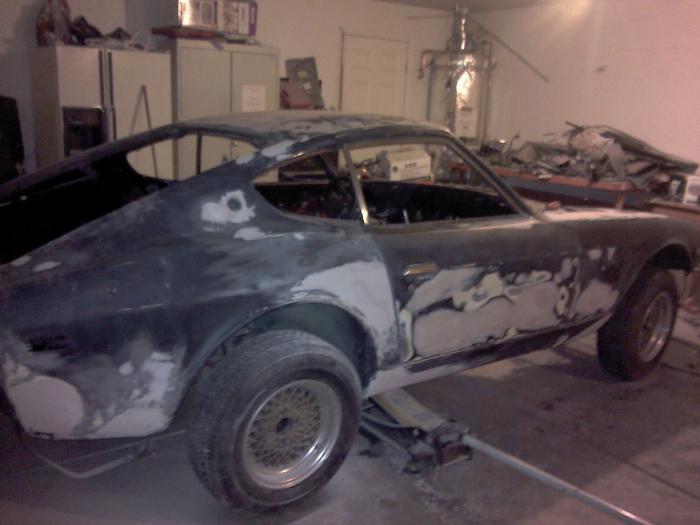

I haven't posted on this or updated in a while but i've been busy with the body work, a lot more was needed than expected :sosad:. I think its taking longer then normal because I'm hand blocking the entire car.

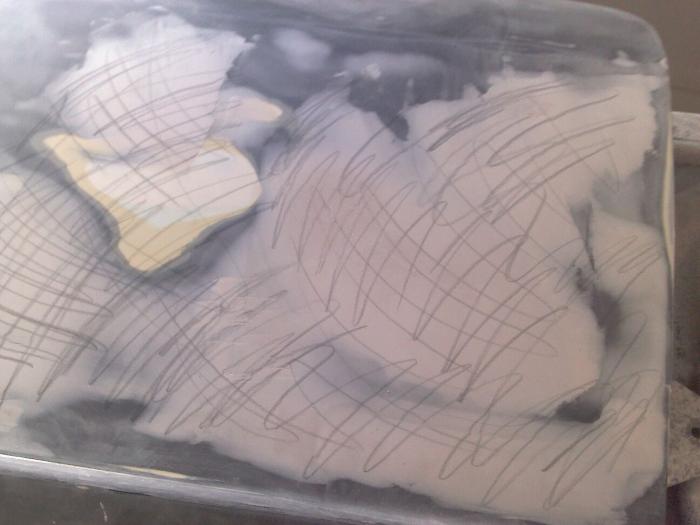

i thought of a great idea that was faster then using a guide coat, I got an ebony pencil and write all over the area thats going to be sanded and it shows you all your low spots :sneaky:. i know a guide coat does the same thing but this way is faster because no drying time is needed.
I want to primer the car with weekend but there is still a lot to be done and I don't know if it'll get done by then, time will tell.

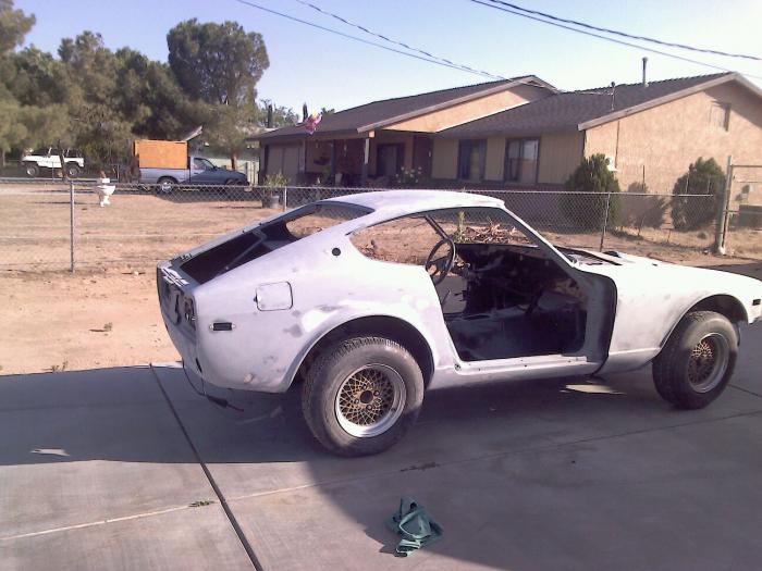

Any way here are some pictures of the progress...

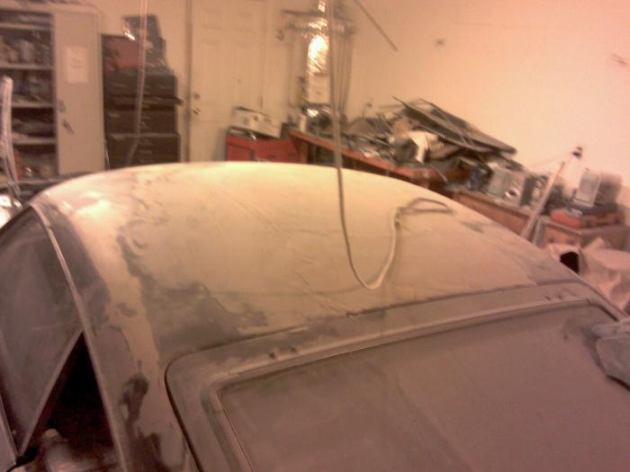

Also does anyone have any tips for large areas such as the roof? i have a 14" block sander but that will take forever and i want it to have a nice finish when its done.. is my block sander the best way to go for that area?

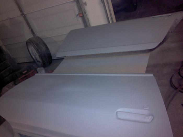

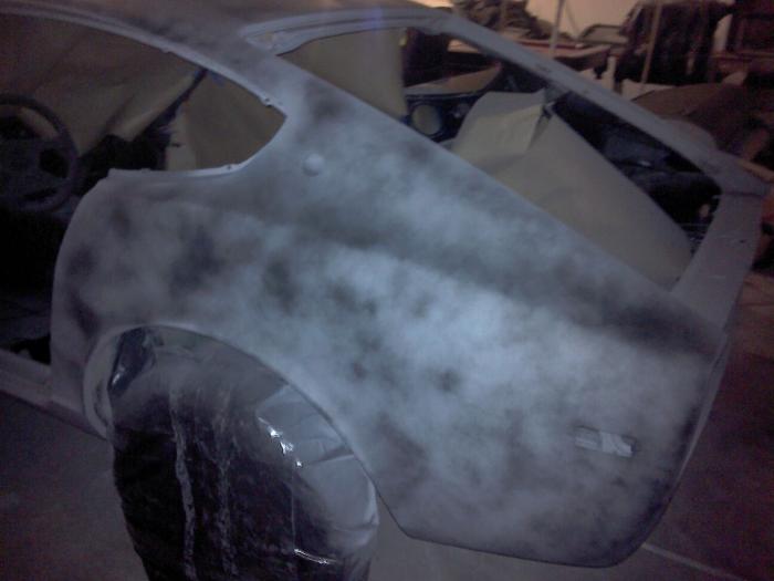

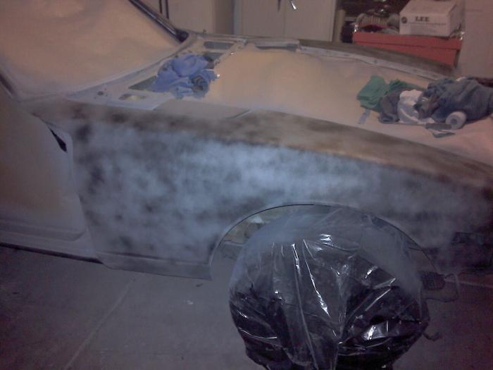

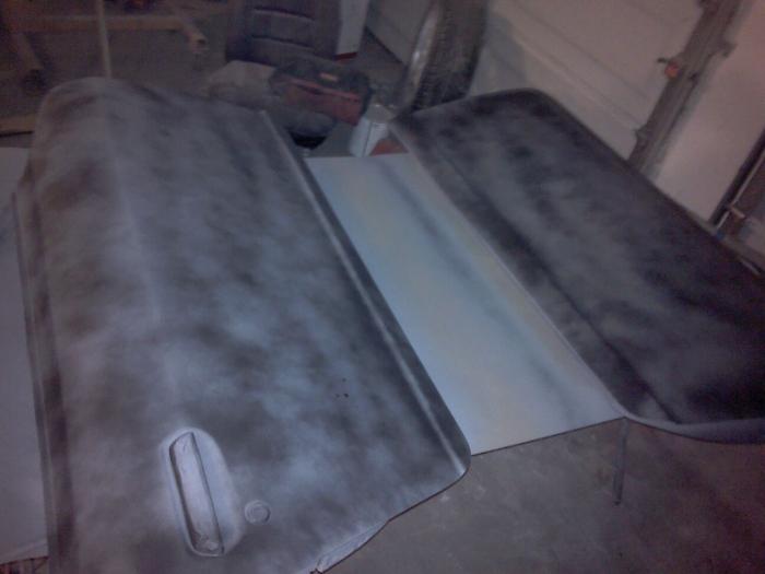

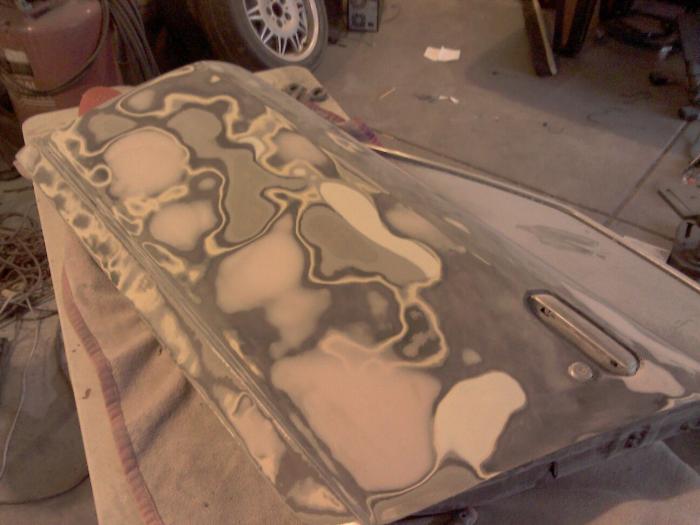

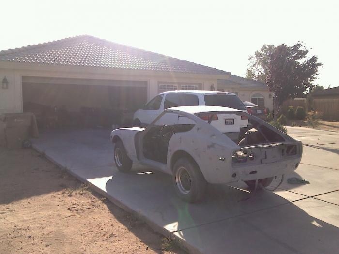

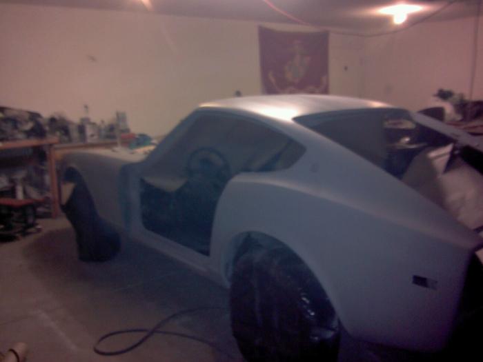

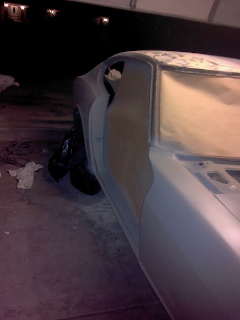

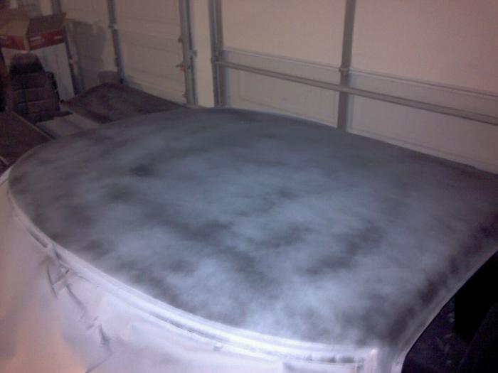

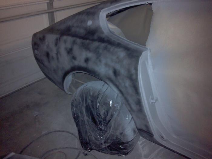

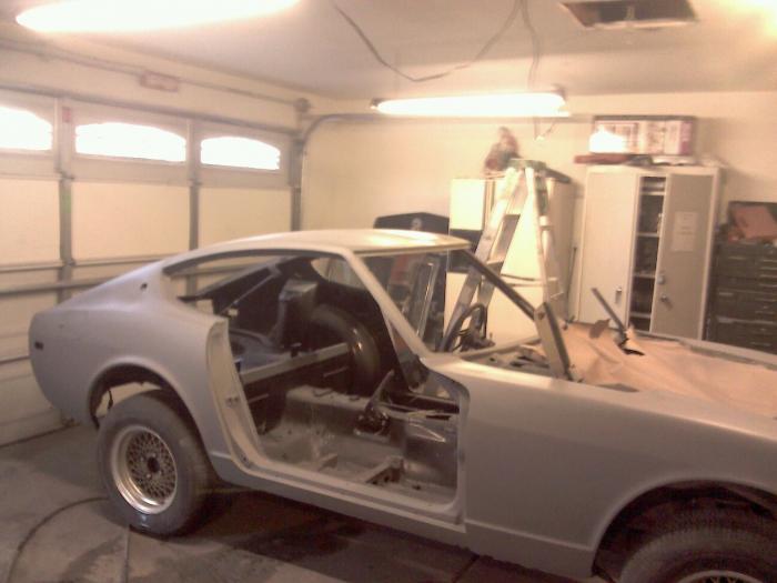

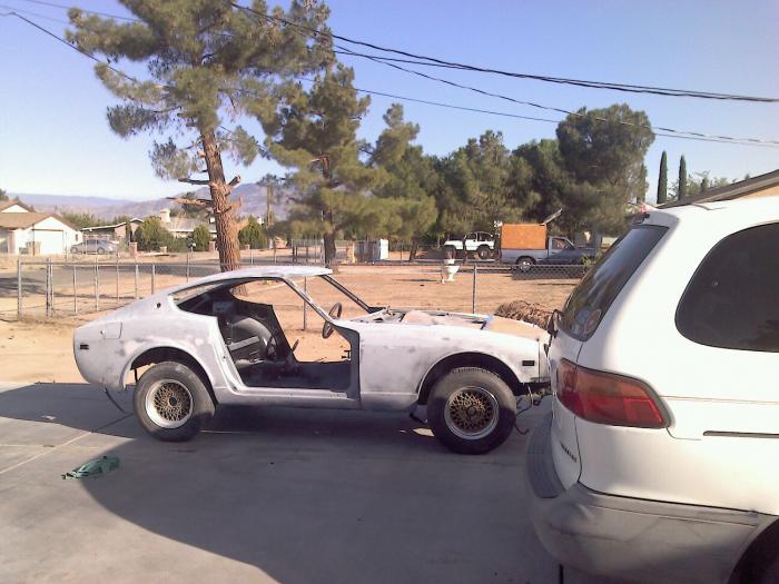

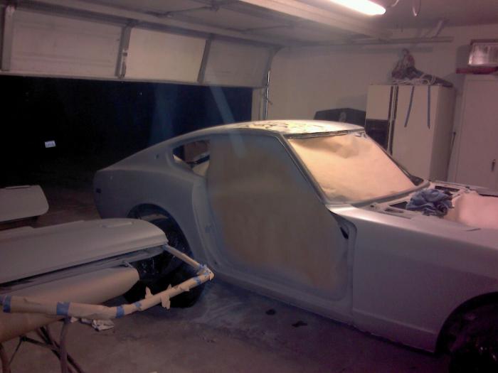

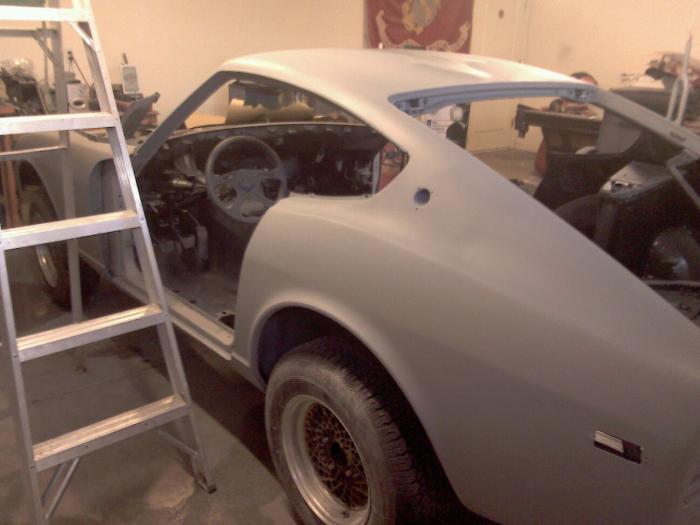

I was finally able to do the first coats of primer to my car.. its been taking WAY longer then i had hoped :(. I got a guide coat on (take pictures tomorrow when I'm home from school) and will start the block sanding again :notgood:. some pics as of tonight..
Guide coat..

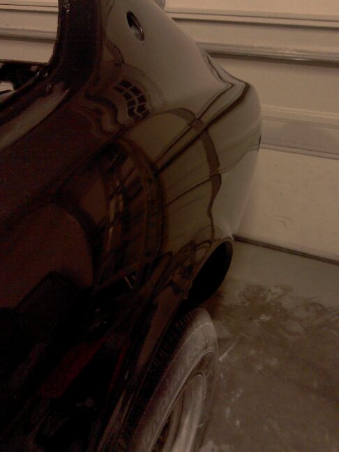

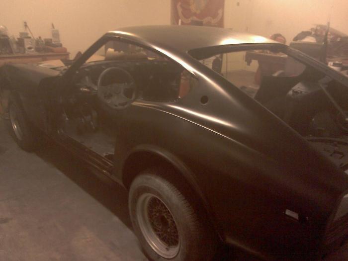

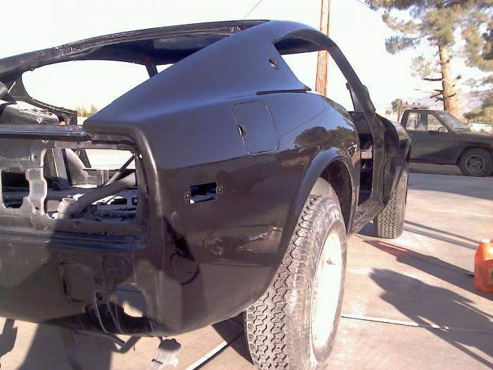

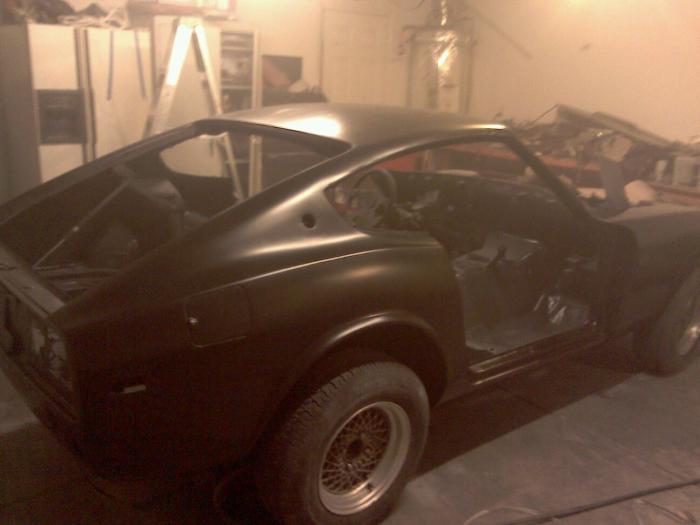

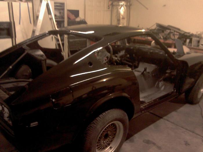

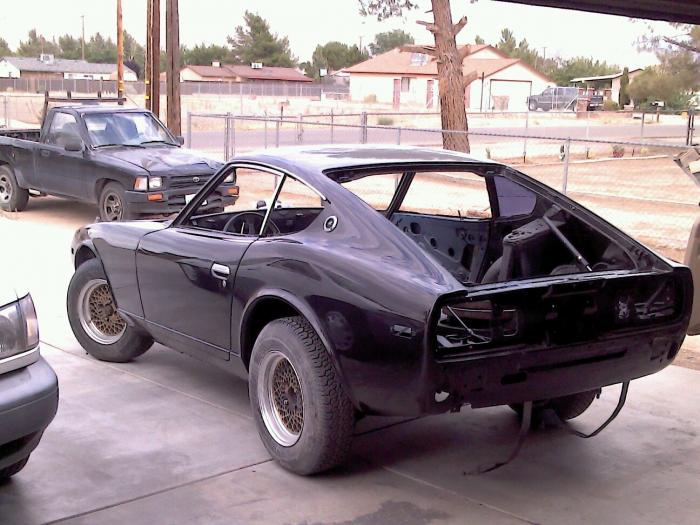

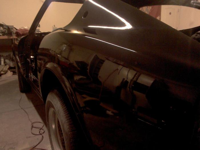

Got some progress done this weekend. Painted the car and I'm working on cutting and buffing over this next weekend. There was some orange peel in the paint but thats not a problem, i buffed the driver side rear quarter panel so you guys can see what it'll look like. :)
some pics..
Starting to look gooood!
Thank you :thumb:
Looks great. I too have been contemplating this build. I just wonder if something with a backseat might be better, but weight is what its all about, and these don't have a lot to em :) paint looks great
Yeah man these things are LIGHT LOL and Thank you!

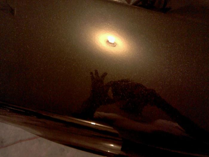

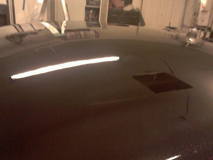

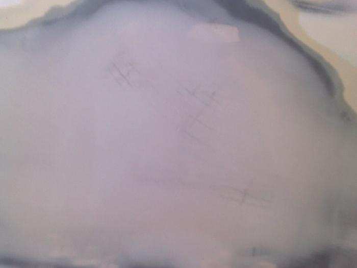

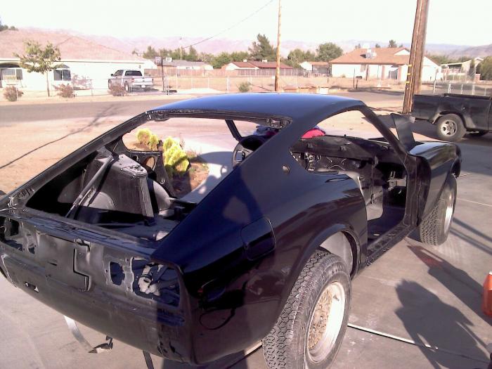

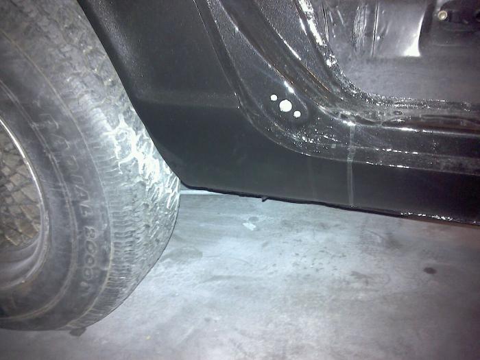

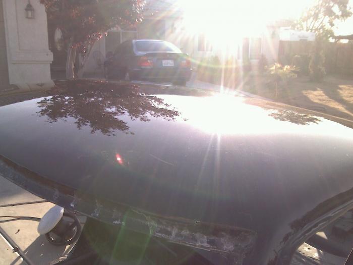

Finished all the buffing today, I'm very happy with the outcome. I don't think its bad for my second car I've painted and given that it was done in a garage :coy: Theres a picture of the rust hole it had before, fixed now of course :)
Looks great man. I'm supremely jealous. One question I've always wondered about. Why does everyone ditch that 2.8? Is it that bad of an engine?

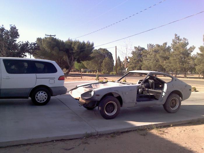

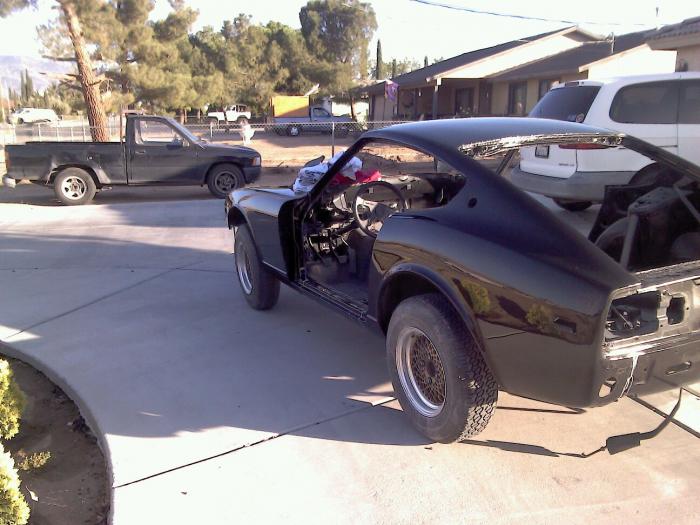

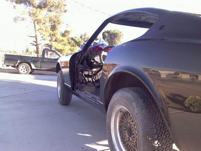

Its not much of an update, sorry about that, but i just wanted to tell who ever is still interested in this build that i haven't done anything really to the car. There have been a few personal things lately and i just haven't been motivated enough to work on the car, i even wanted to sell it :coy: but thats not happening :hellyeah:. This car will be completed someday, but hopefully running by the end of this summer :pray:. and ill just put up a picture of the car in its current state :)....more updates coming soon LOL
