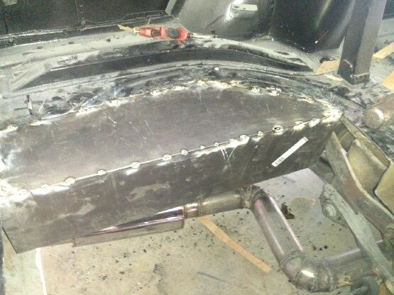

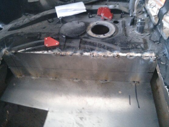

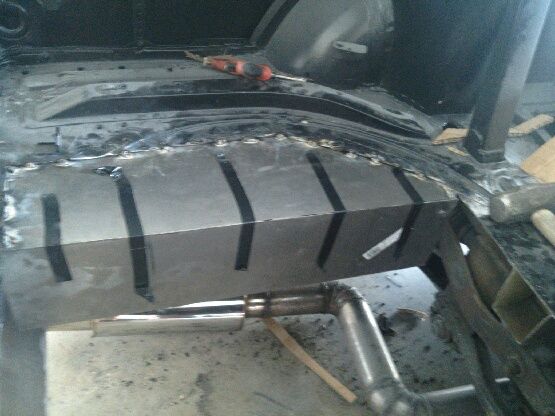

Got some work done, mostly mock up work... let me know what you guys think. Im waiting on some an fitting i ordered to install the fuel pump and lines after i do all the welding

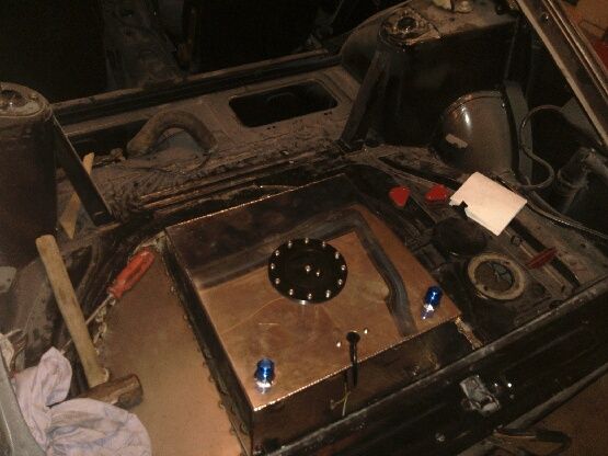

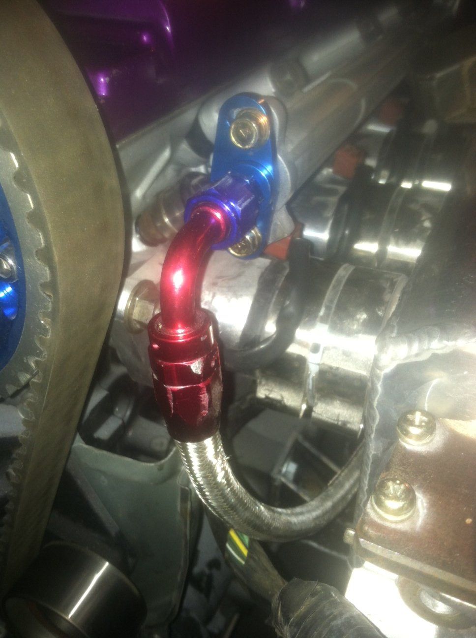

Finished up the fuel system:

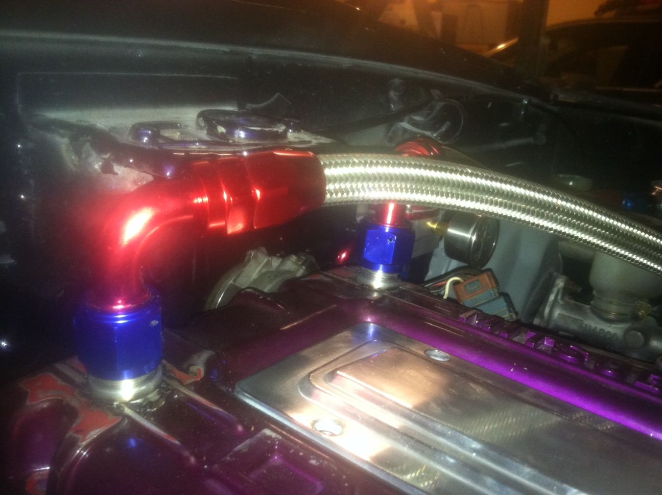

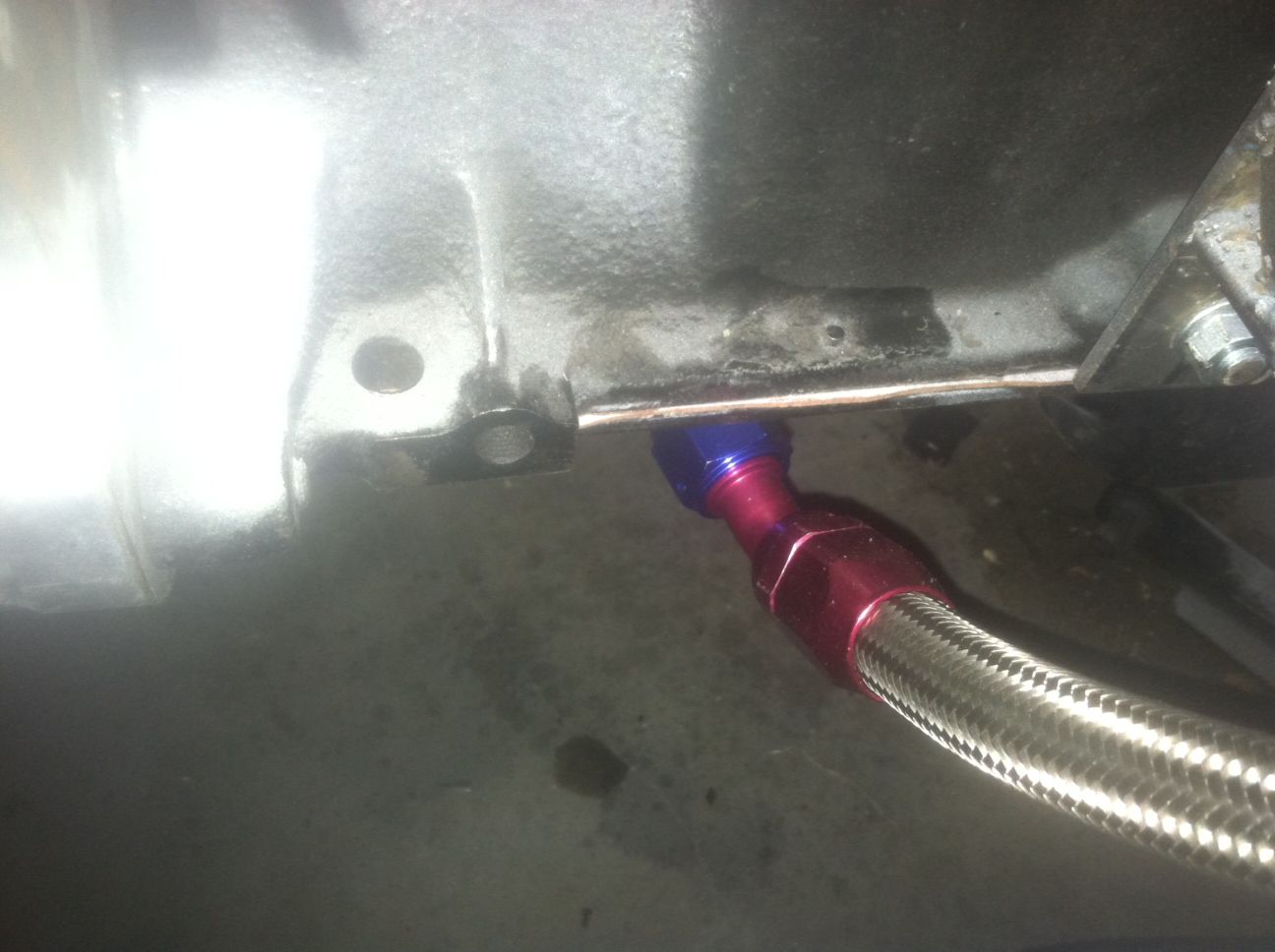

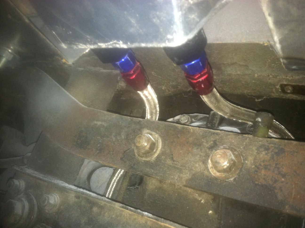

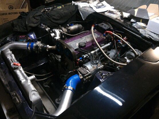

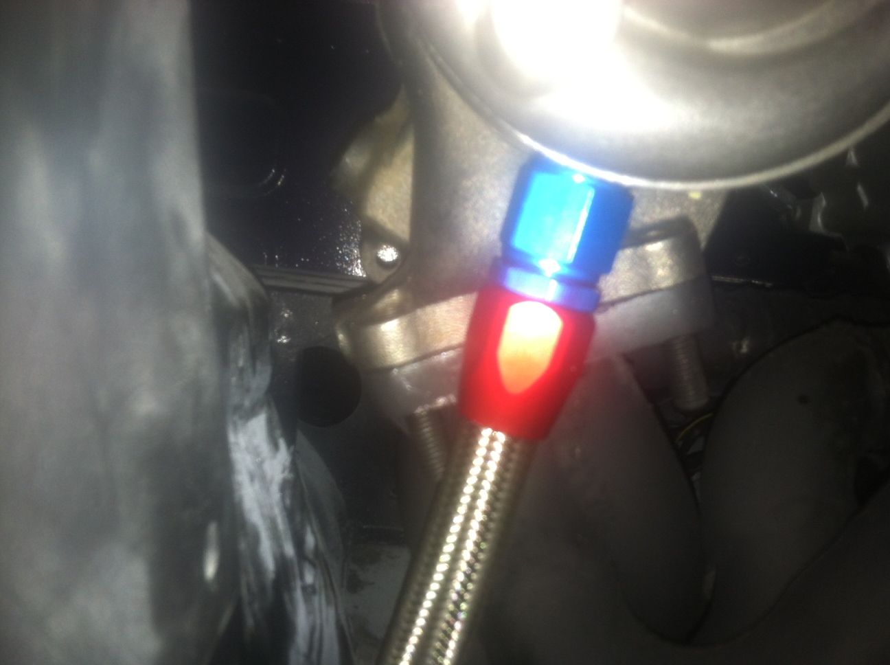

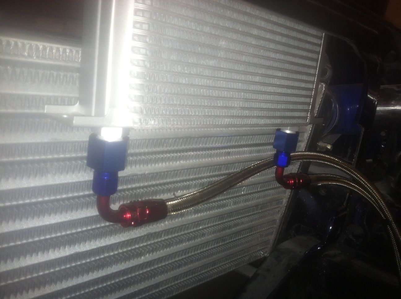

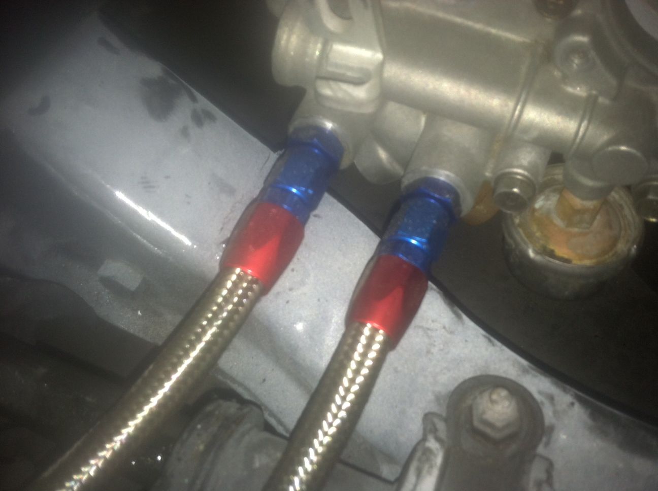

Started and finished the oil lines: -6 AN lines for the oil cooler w/ -10 female to -6 male fitting from the cooler, -4 An (i believe) for the oil feed, -10 AN lines for the oil drain
I need some advice on what i should do to keep the hose from heating up too much, its about 3/8" away from the manifold... I'm thinking of just wrapping the hose with header wrap... let me know if you have anything in mind.

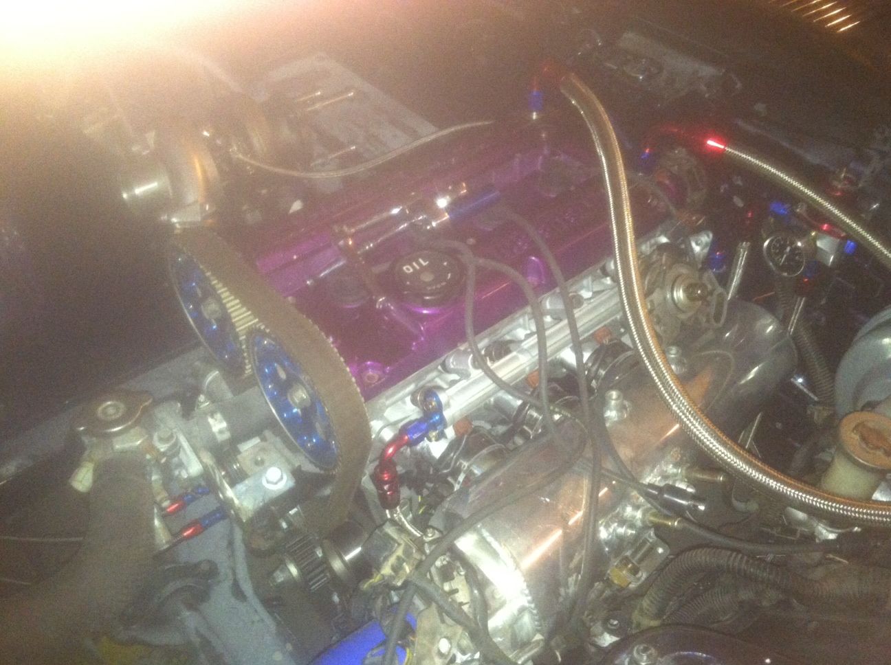

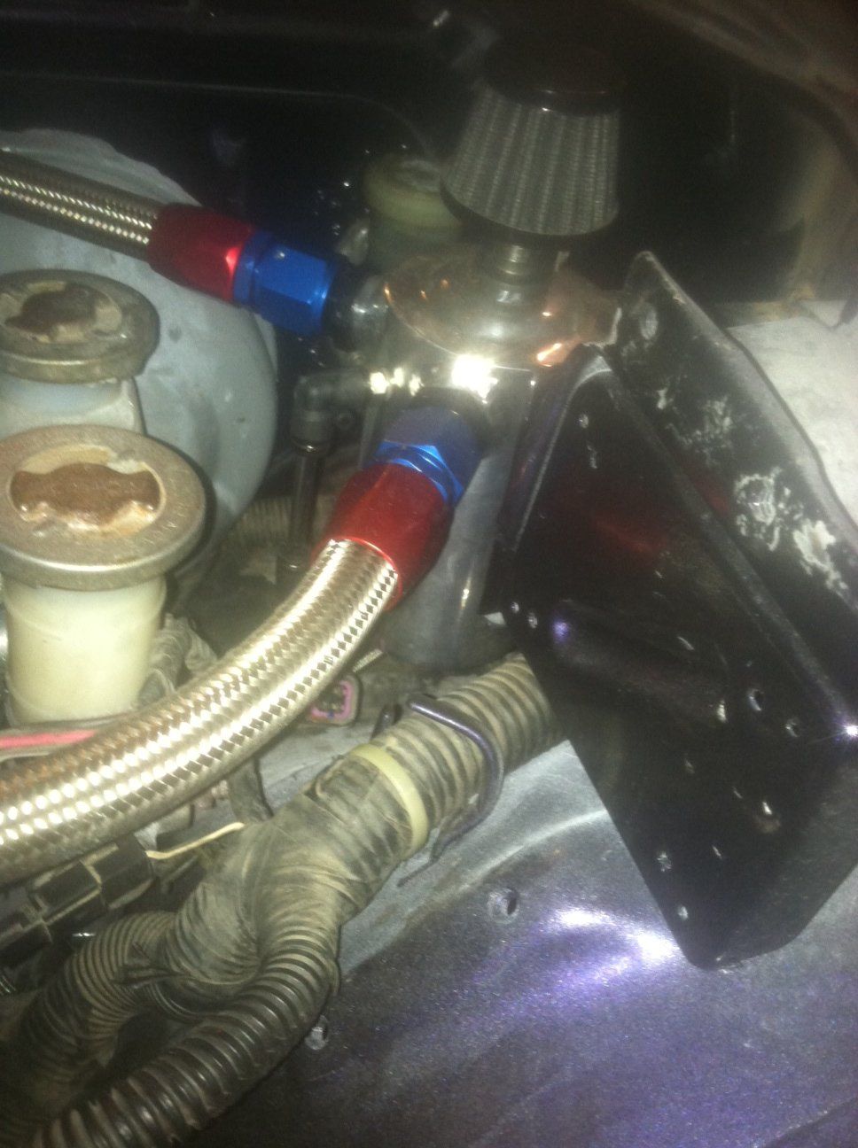

Once i had the oil lines figured out, i started the Catch can lines: really wish i had photos of everything being assembled and such but like i said, the SD was damaged..

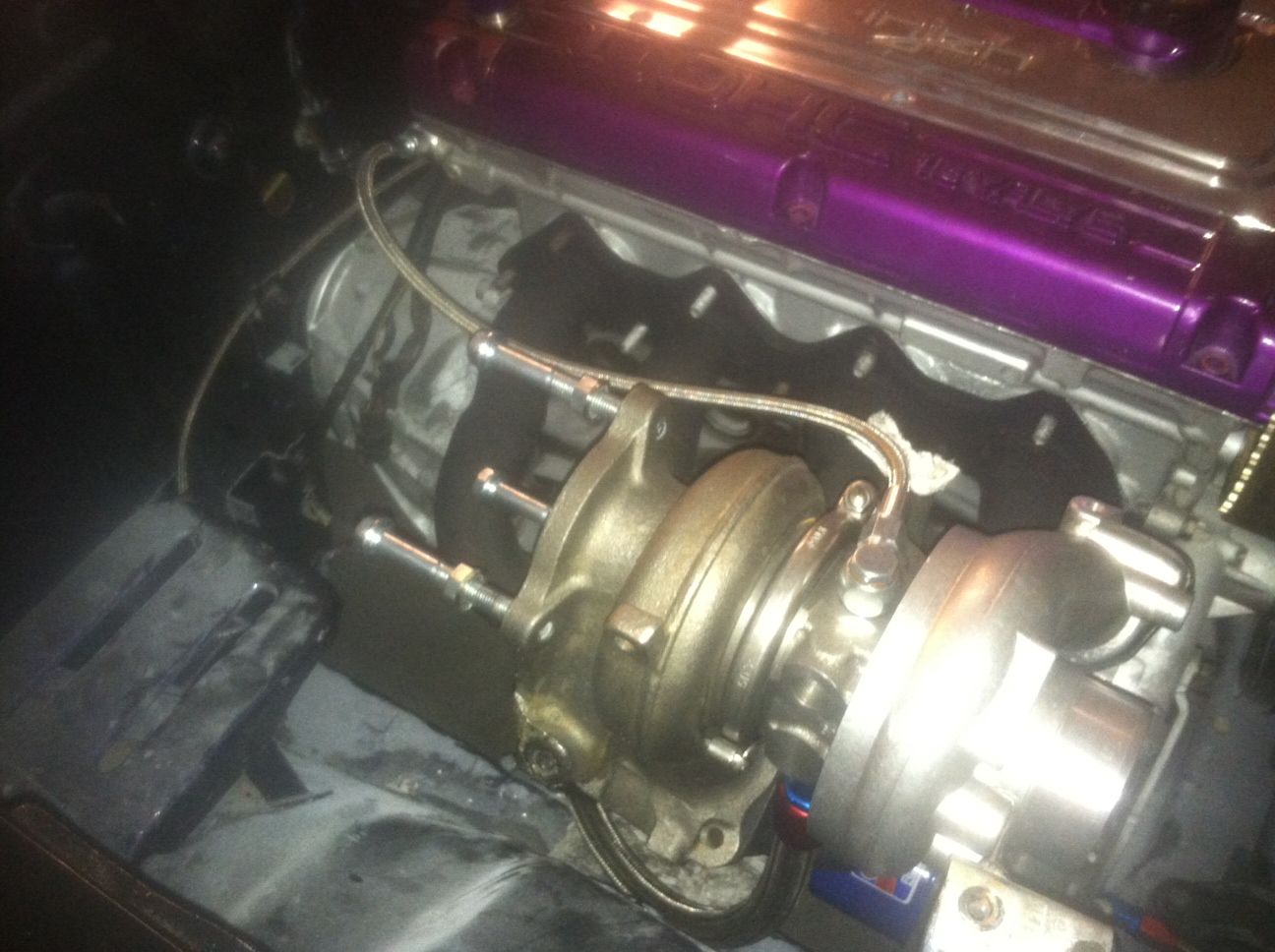

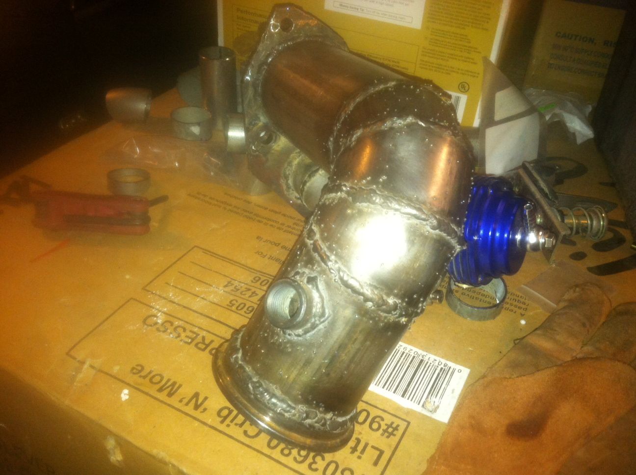

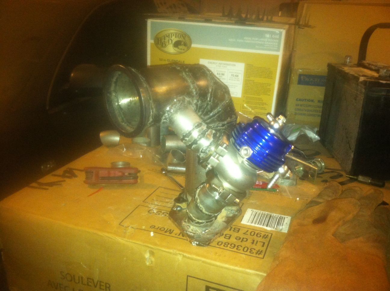

Then i started the wastegate, knockoff tial, set up (PS im a horrible welder)

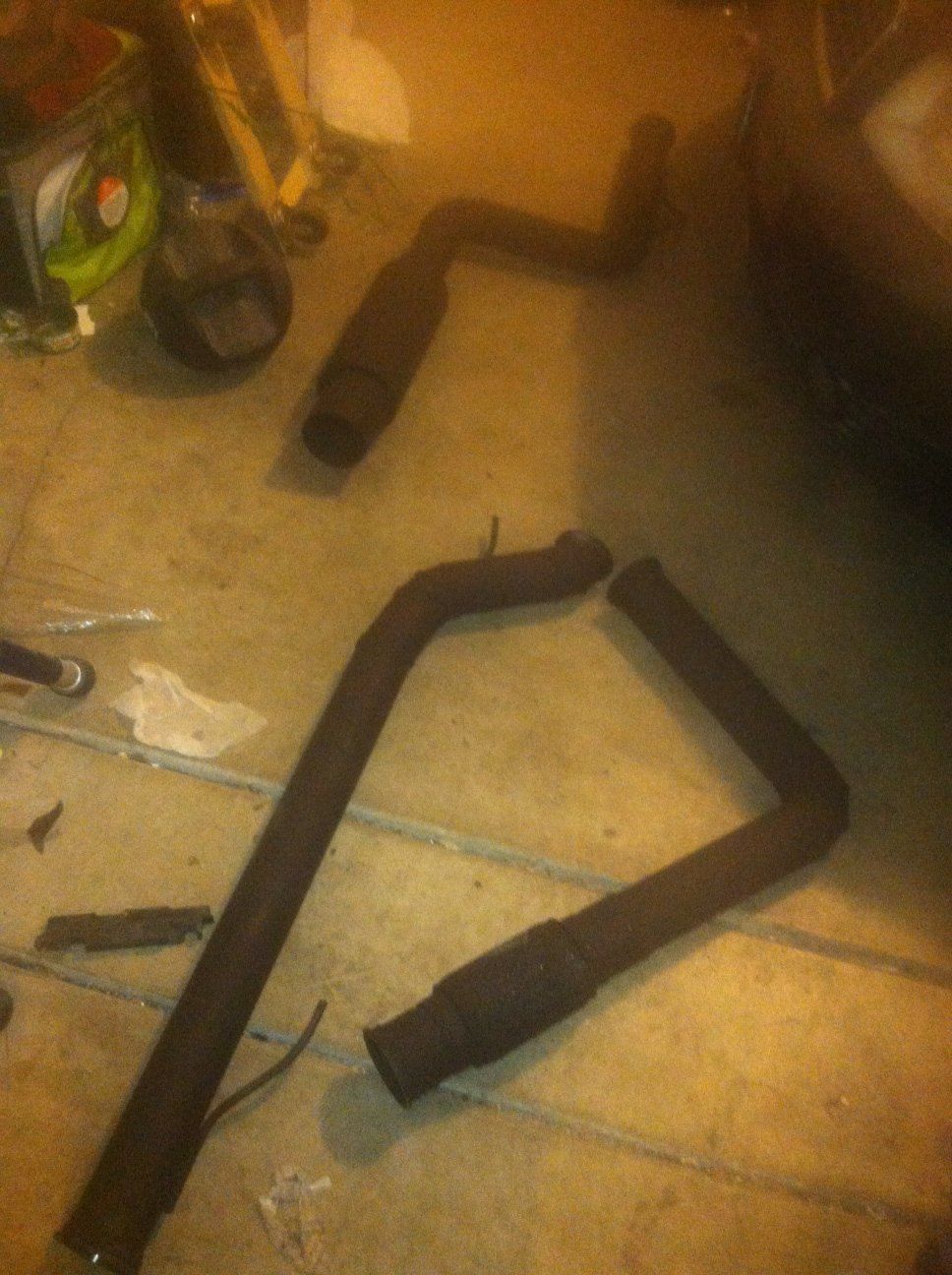

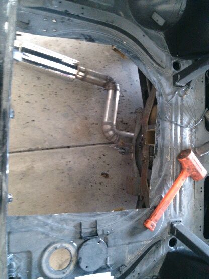

Painted my exhaust with some autozone 1200 degree paint, Hope it lasts past start up...

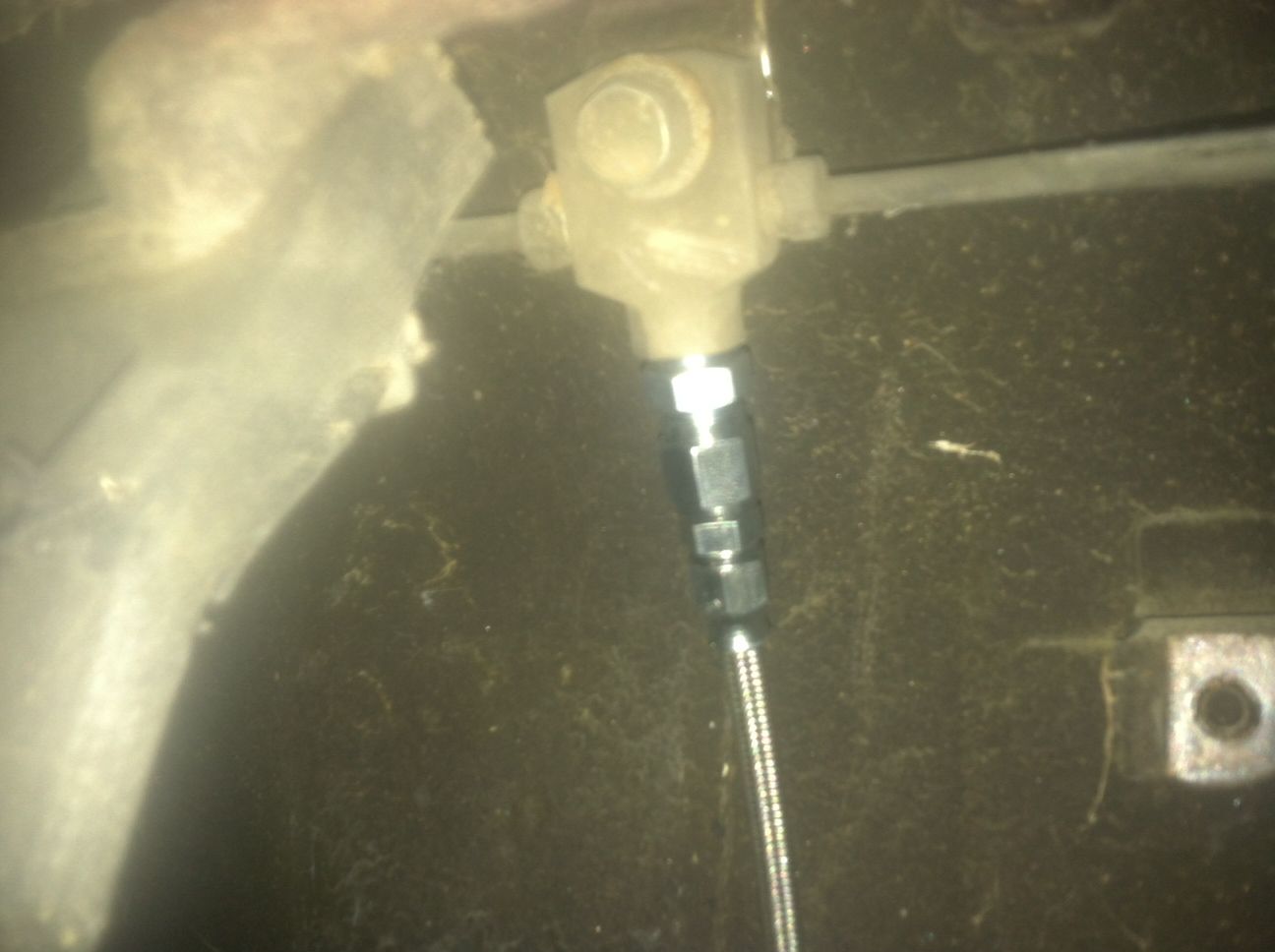

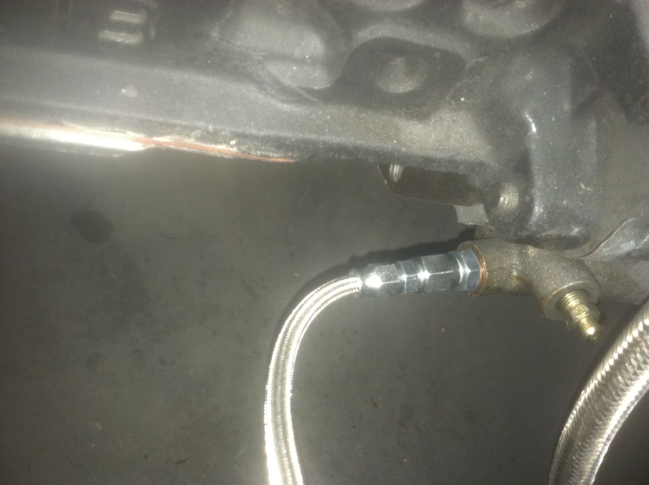

-3 PTFE brake lines and fittings, only have the rear line installed so far

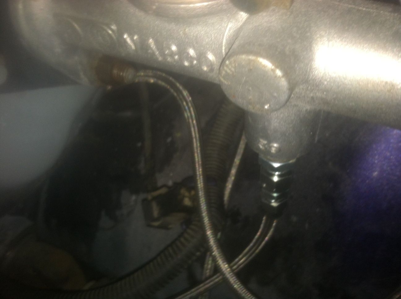

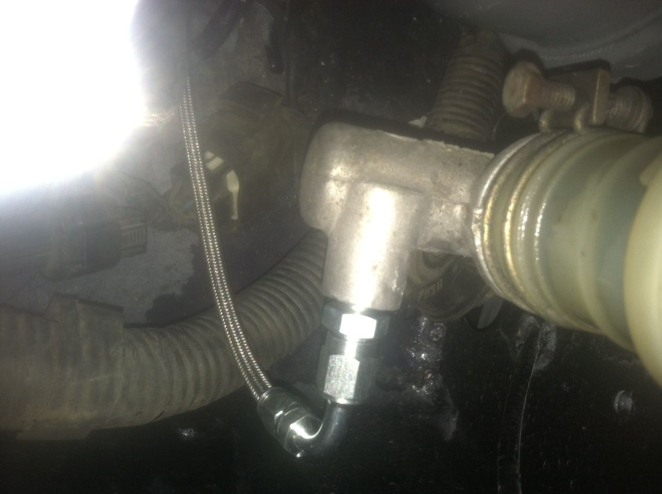

Clutch line

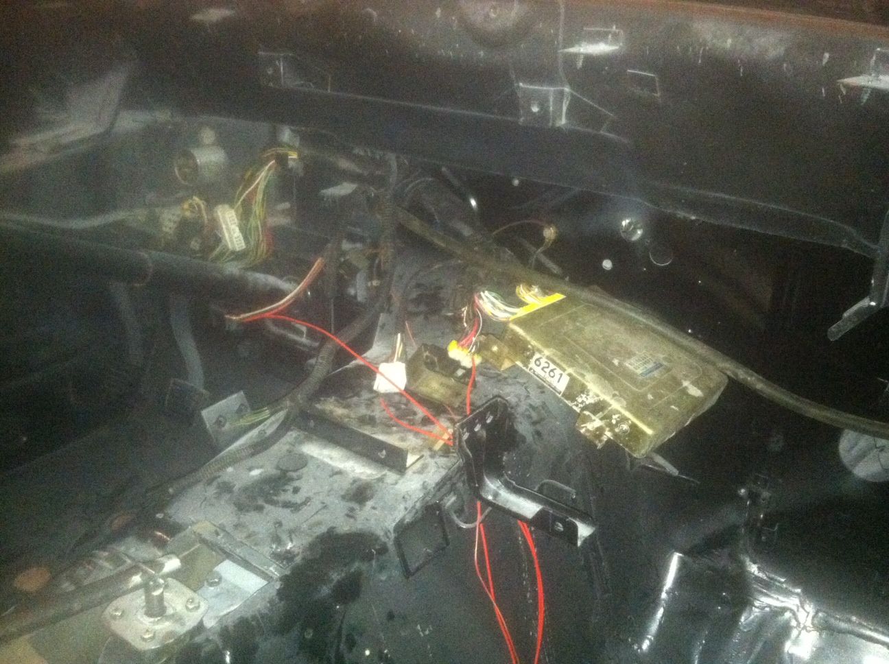

All the wiring, I finally got all the wiring to work and ECU powers on and have spark and fuel injectors are firing..

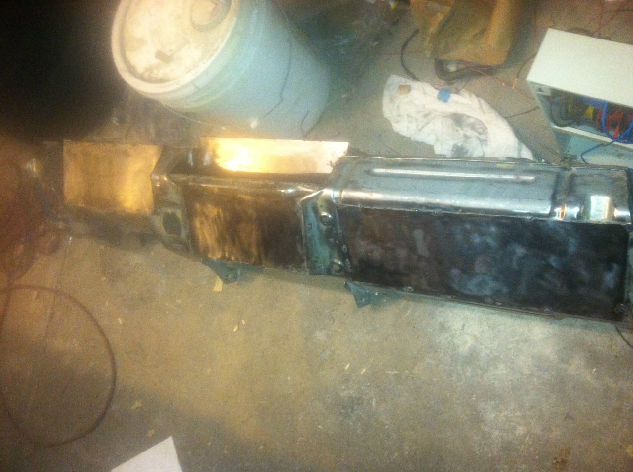

Finally, the dash:
Still needs the gauge holes cut out, grind down some ugly welds, then some flat black paint..

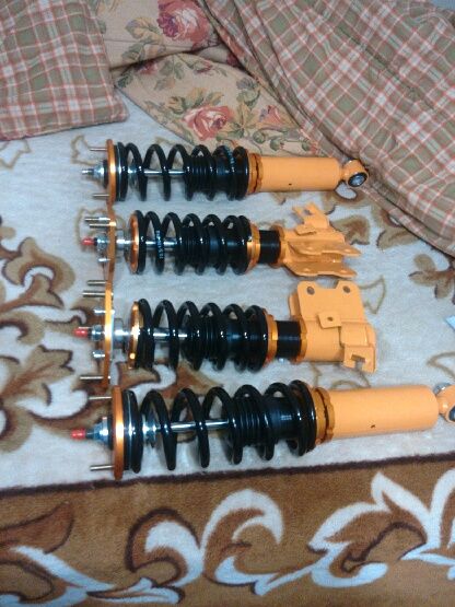

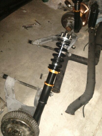

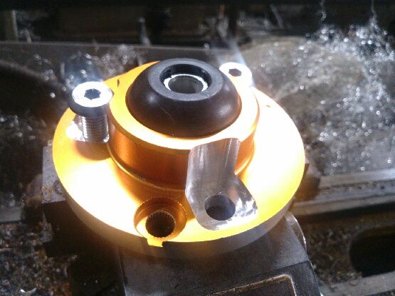

Finally got some coilovers. Only they're for a 240sx...

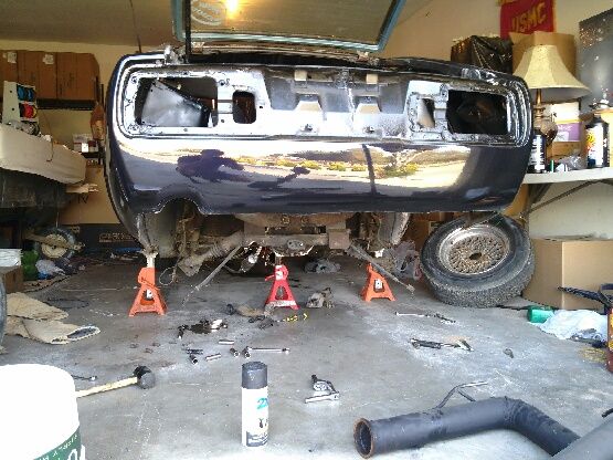

Jacked the car up and took it apart

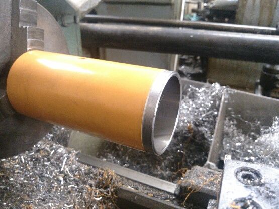

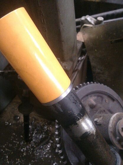

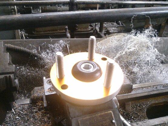

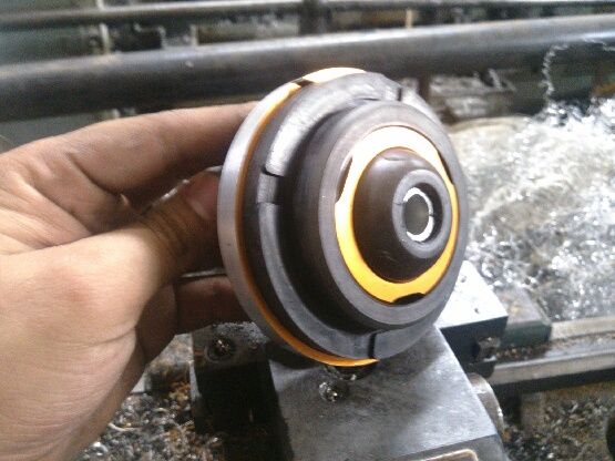

So, I had to do some fabrication work. I put the top hats on the lathe and turned them down to the correct diameter, then i drilled out the holes for the 3 bolts and milled out a step so the bolts can sit flush with the bottom of the top hat.
Then I had to cut and square the lower part of the coilovers
Basically how its cut.

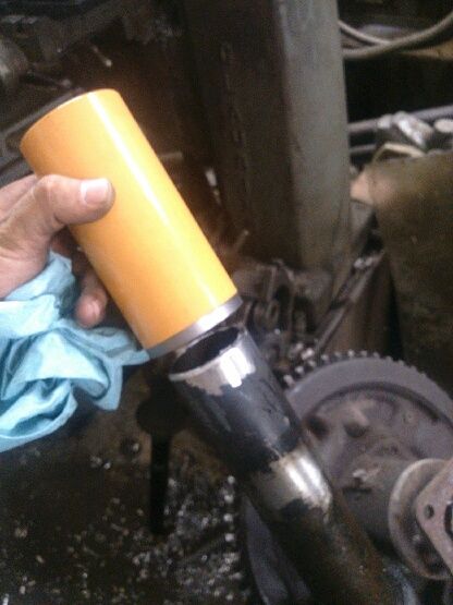

Was very fortunate that the outside diameter of the old strut tube just barely fits in the inside diameter of the new tube. I didn't show the prep, but basically used the grinder to clean up the surfaces. Inserted the yellow tube about 1" over the black stock tube. This may the tube should sit straight
Looking at this picture you might think the overall length of the tube is WAY to long.. and you'd be correct. Somehow during my measurements i wrote down 27.5" length when it should have been 22.5"!! So when i tried to install them, the damn things didn't fit and i realized that they were about 5" too larger.. figures LOL
So I removed the assembly and recut, remeasured (3 times), rewelded, and reinstalled them

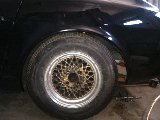

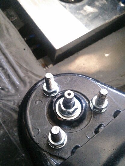

This is how the car sits, it still has about 2.5" of drop but i like how it looks with this height and will keep it
Adjustable dampening
This is only the rear install because I don't have time to do the fronts until finals are over.
