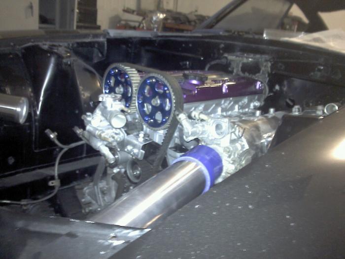

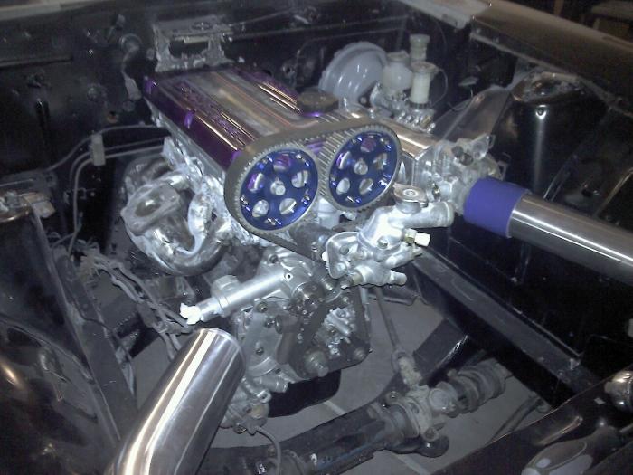

Sorry for the lack of updates. I failed to get it running by the end of summer but thats fine :coy:. i have all winter to get it ready for summer. Ive just done small things to it but no pics :ohdamn:. Ive gotten the Driveshaft, all the drivetrain, some more engine stuff and repainted the interior again :ohdamn: (looks good though). Im spraying the car again however and it should be a real nice color :cool:. waiting on a couple of things to start the paint job....again. Im looking for a good 16g so i can finish routing the intercooler and then ill work on the wiring, finally. Here are some teaser pics of the bay:
P.S. i know my engine bays dirty LOL but its getting painted along with the exterior.

Why repaint? What color are you going to repaint it?

I liked the black but it was too plain for me. Im going to paint it jet black with a purple pearl clear over that. Im only waiting on the pearl to come haha. I could only find it in australia (the color i wanted) so it'll take like 2 more weeks to get here. The only reason i went with the w58 was because price and availability and rebuild kits are dirt cheap haha. A better stronger trans will go in once I'm making enough power. The rear end will say stock (i hear of people going 9s on the diff so I'm not worried) and suspension will be an s13 240sx set up.
