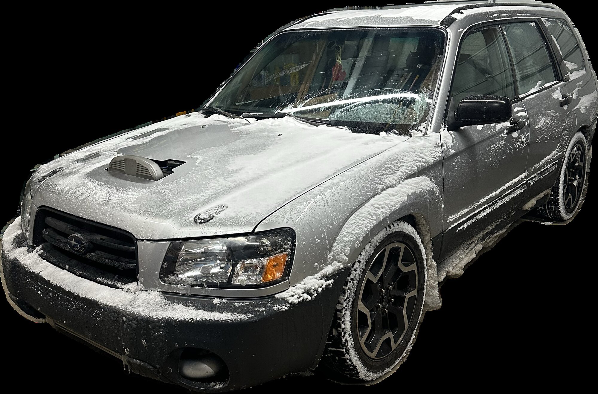

4g63T swapped Forester

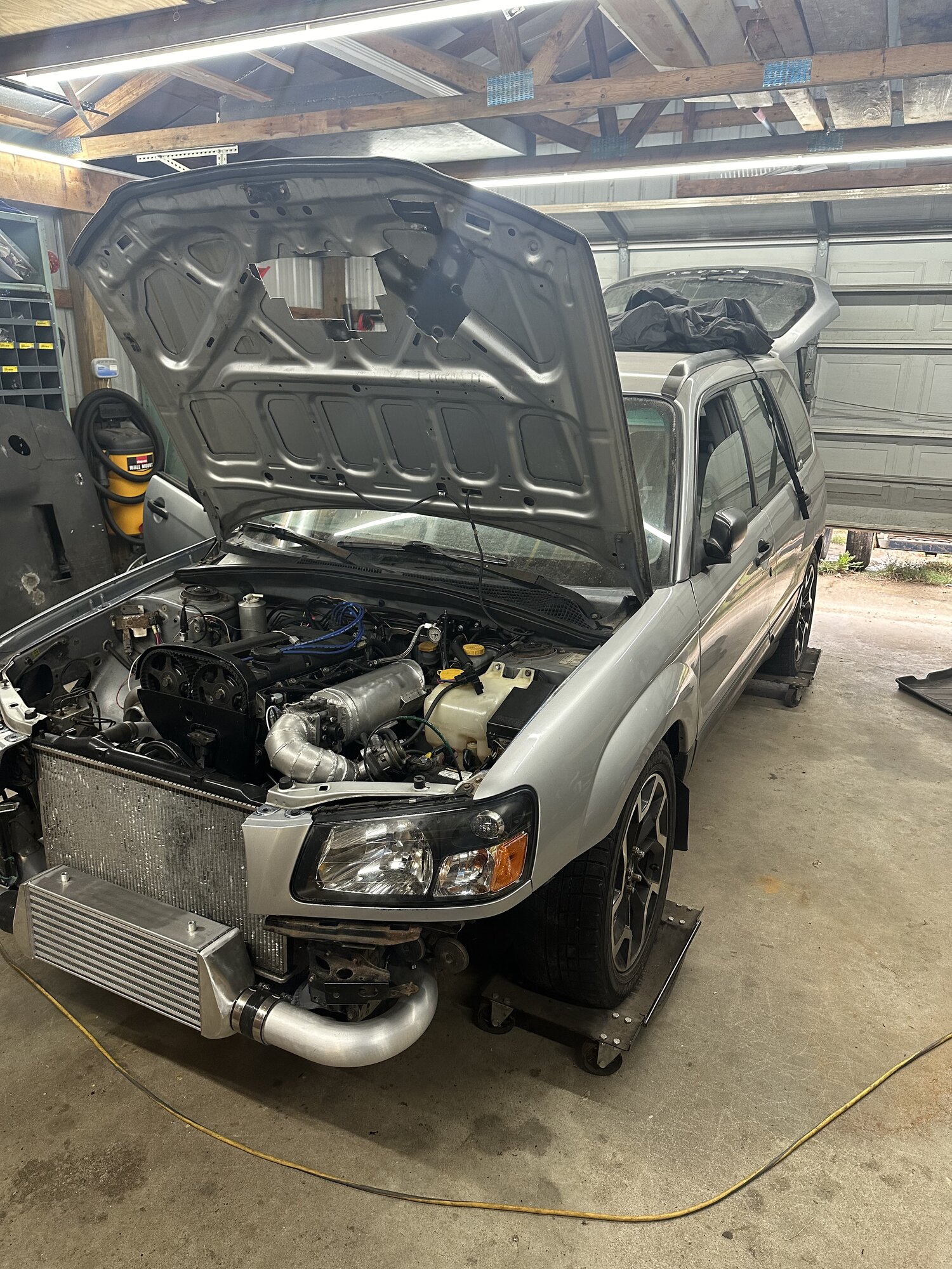

2004 Subaru Forester swapped with 4g63T

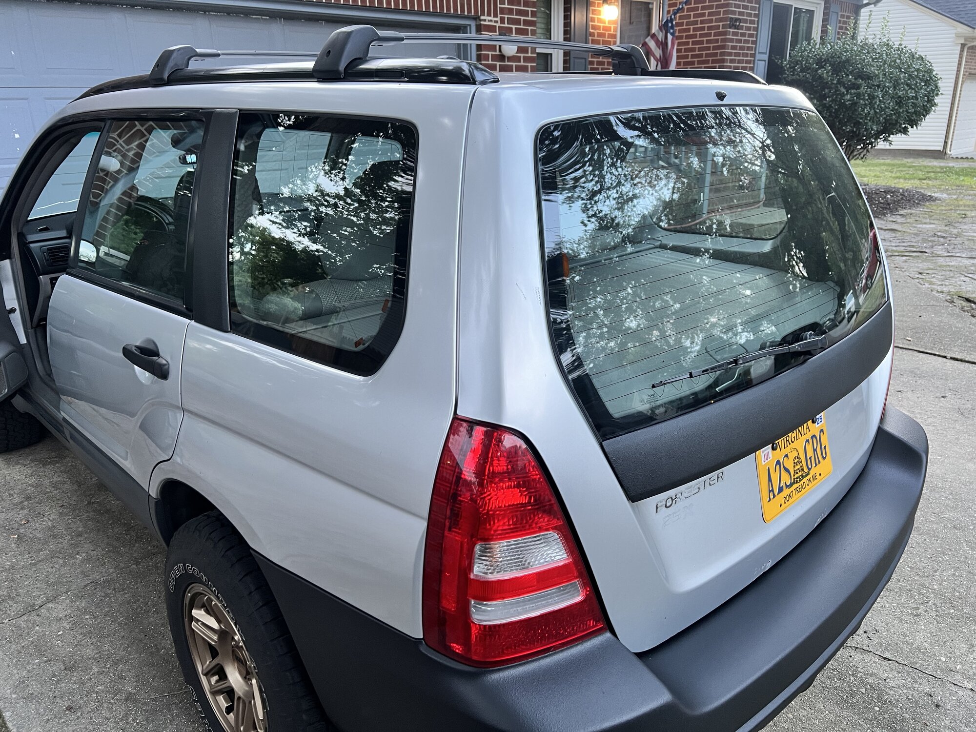

i daily a Subaru Forester myself, make sure you thoroughly check the rear strut towers from the inside for rust!!
otherwise it will separate from the vehicle LOL

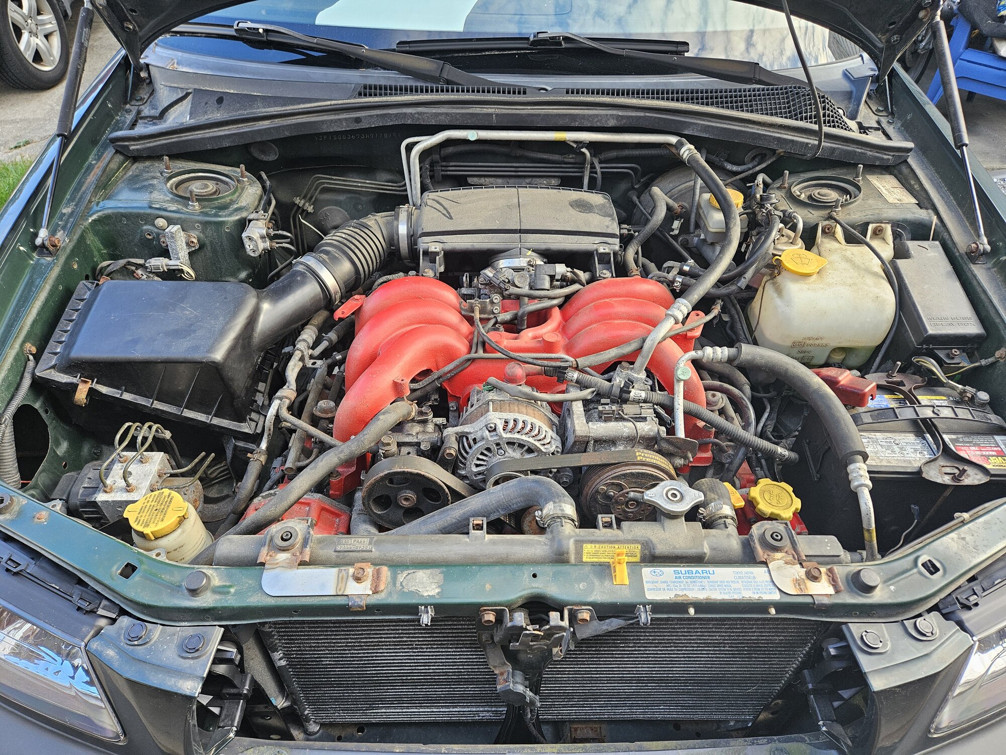

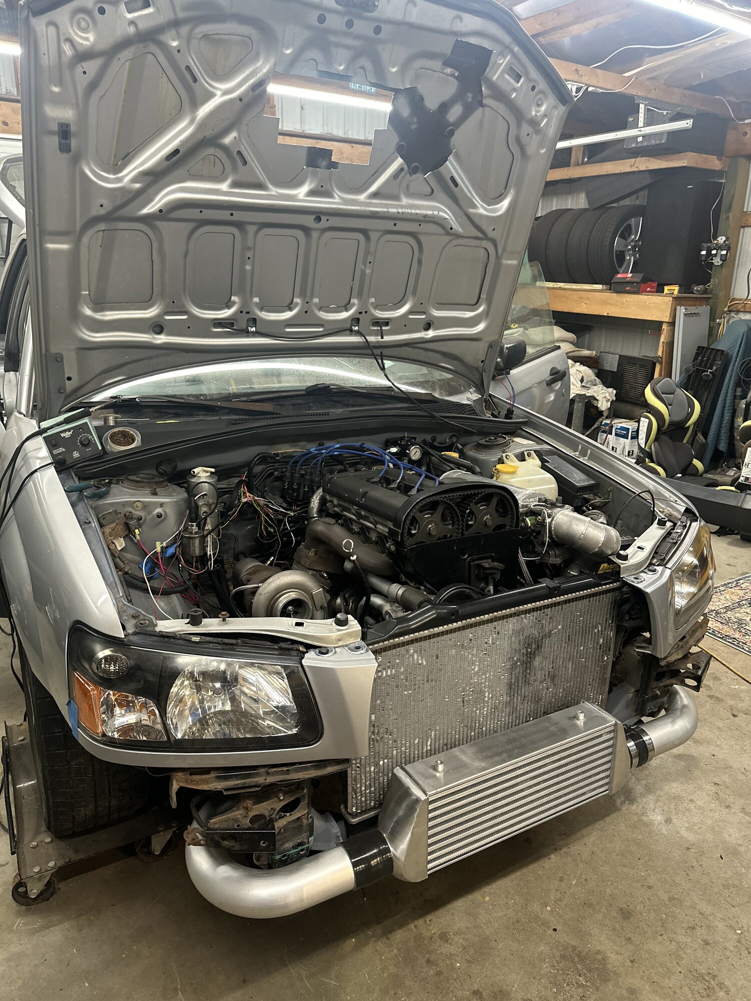

I probably wouldn’t do this but I think it’s very cool, regardless! Would love to see more pictures of the engine bay!

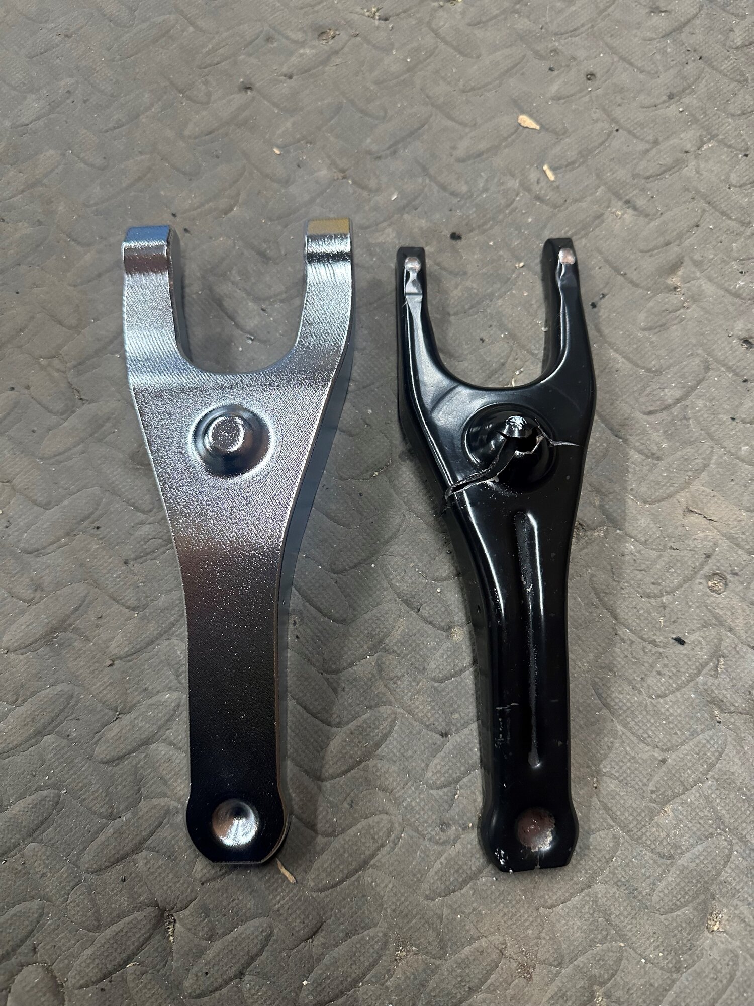

Had my first major part failure recently, stock subbie clutch fork did not like the act 2600 pressure plate. Did find this appears to be common issue when putting HD clutch in the subaru. Got HD clutch fork and just waiting on the new throw out bearing to arrive.
Just sent you a DM. Would love to do the same thing for my GC8 stage car. Hoping to build off what you've done here to put a "Mitsubaru" on the ARA stages in 2026.
