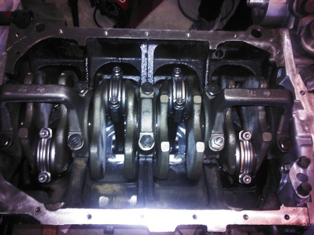

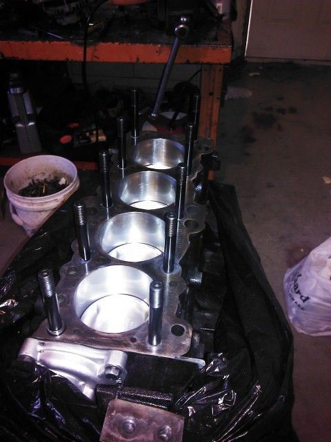

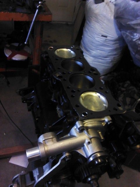

Back in january i bought a stock 6 bolt motor from someone on craigslist and tore it apart and decided to build it properly LOL.

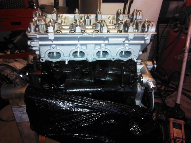

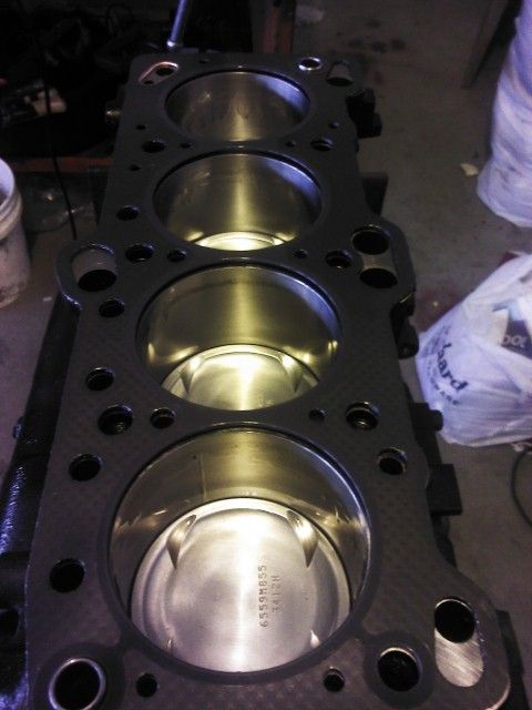

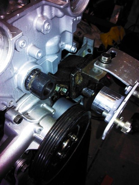

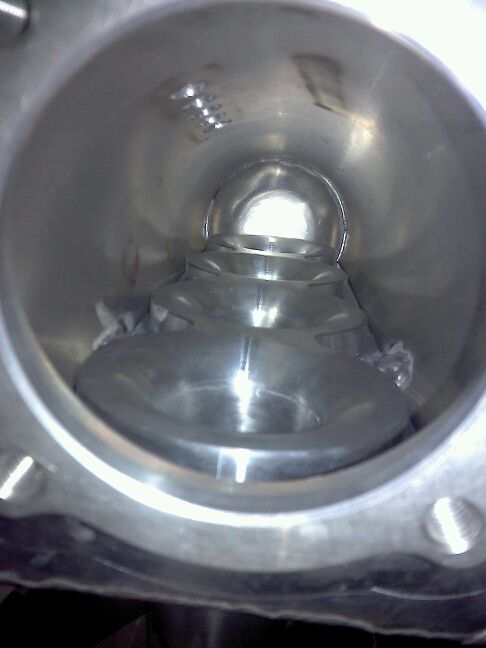

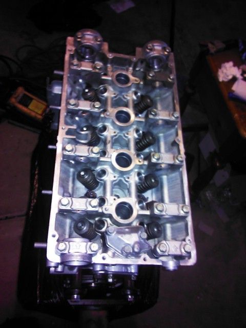

Engine: Wiseco 8.3:1 .020 over, Eagle rods, ACL race bearings, ARP head studs, and the head is stock for now. and some pictures of the engine...

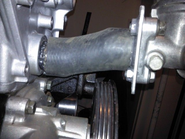

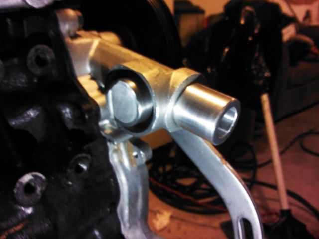

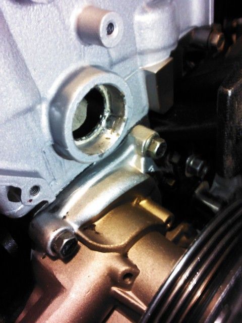

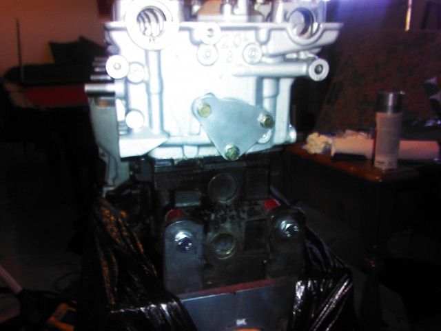

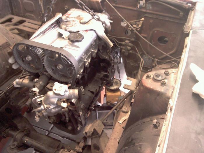

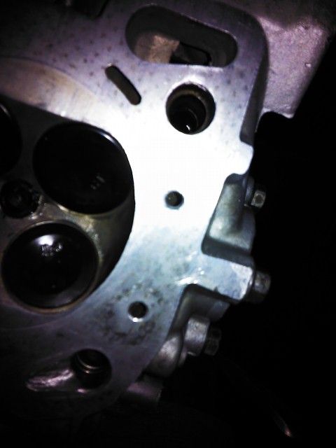

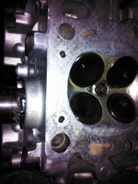

From there i had to work on the cooling system and after many hours of research i decided to do one of Bill's ideas and block the front coolant holes in the head and drill an extra hole in the rear to move the flow from the front to back, to the back to front. so hopefully this works for me LOL

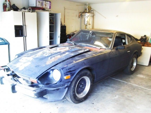

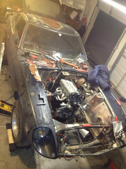

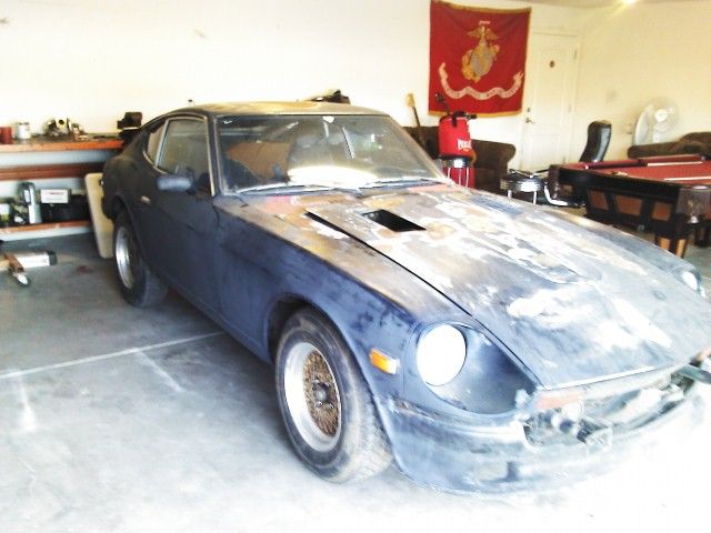

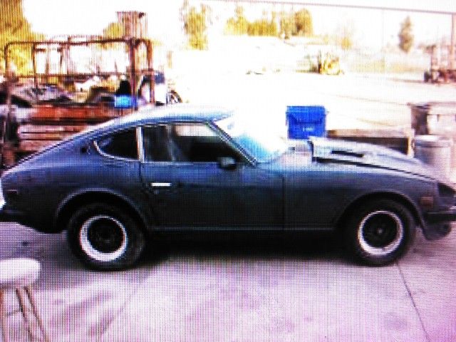

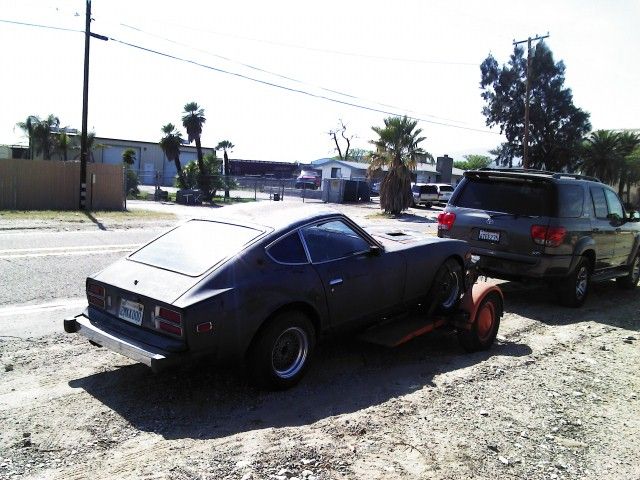

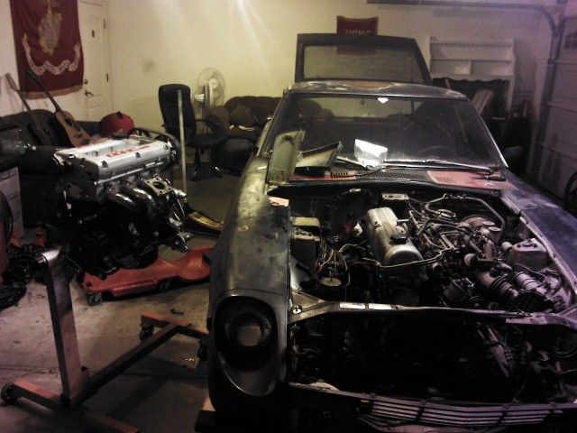

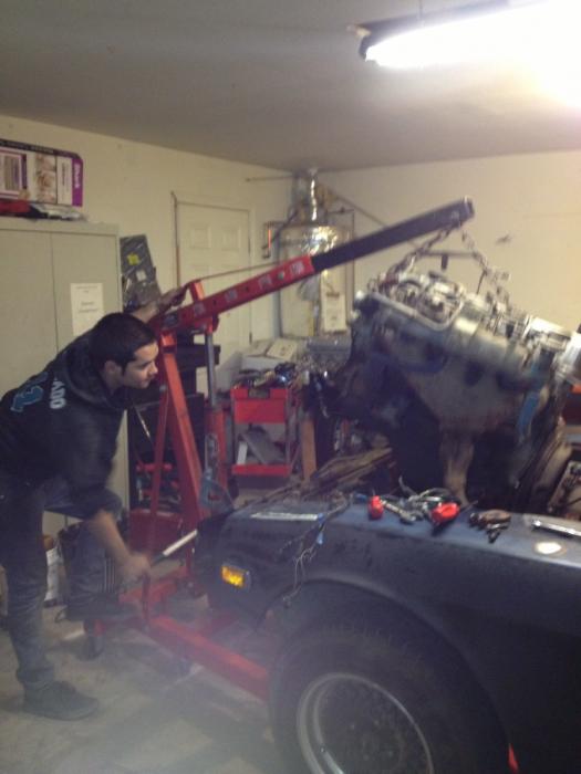

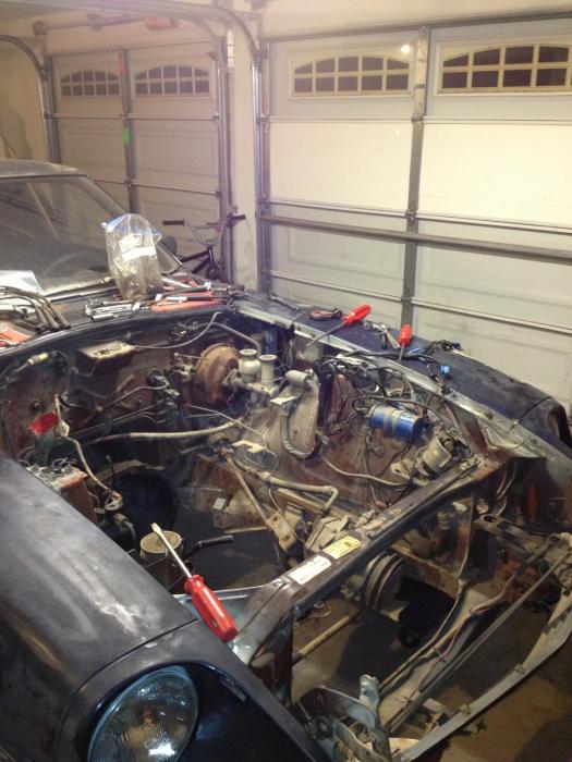

some pictures of the car when i saw it online, towing, and in my garage.
The beast motor along side the car.

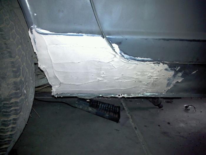

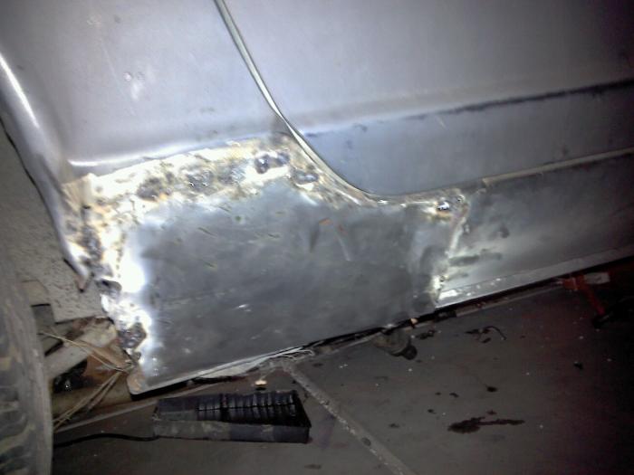

Currently i am fixing rust spots and getting it ready for paint. heres a picture of a patch in the rear quarter.. Its not completely done but thats where I'm at.

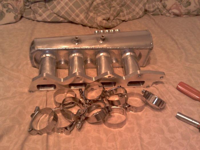

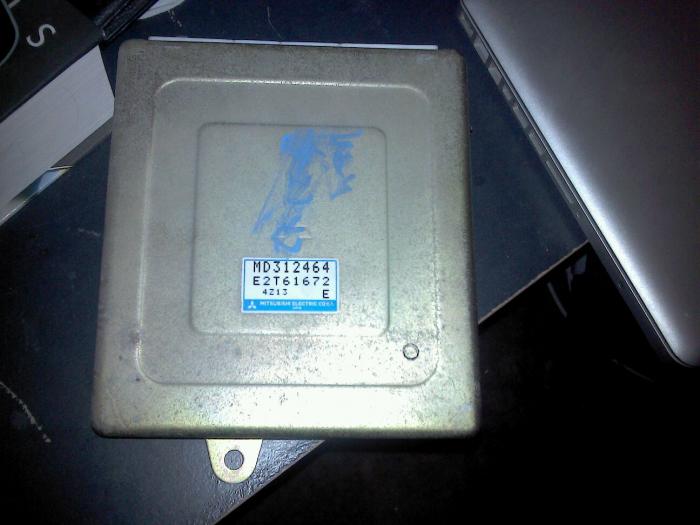

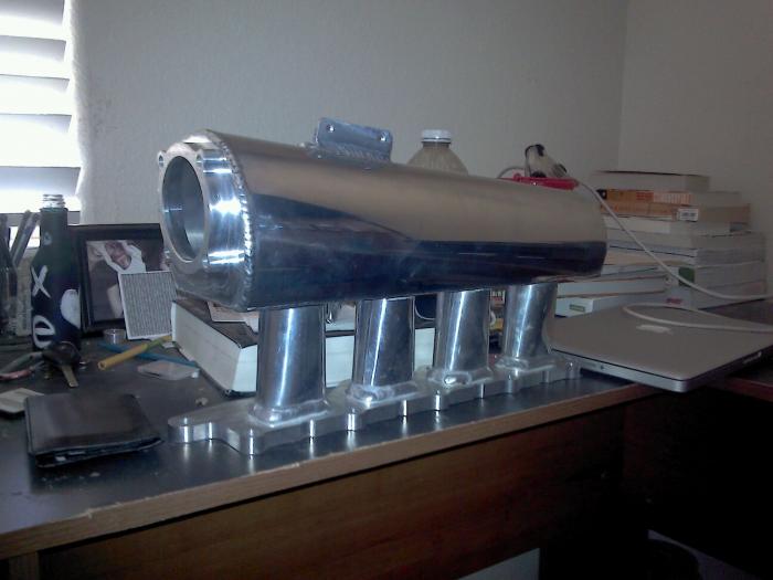

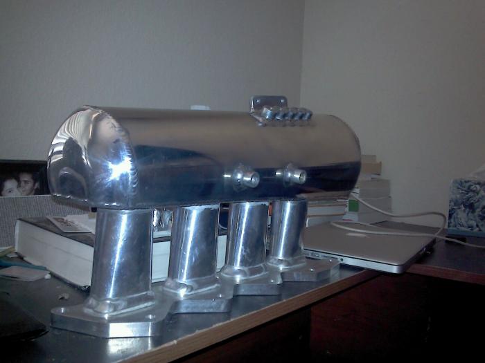

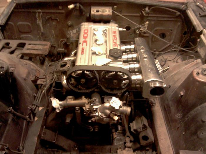

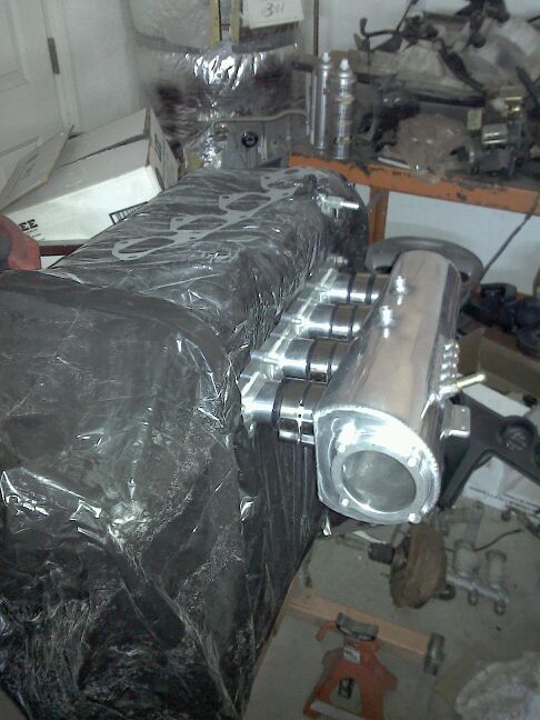

Got some parts in the mail today and thought it would be a good time to update. Got my Eprom ECU and my sheet metal intake manifold i found an awesome deal that i couldn't pass up..

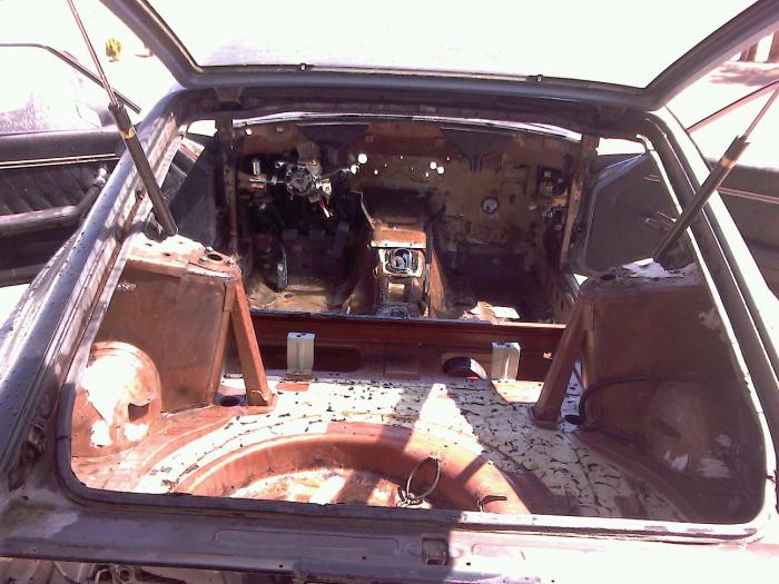

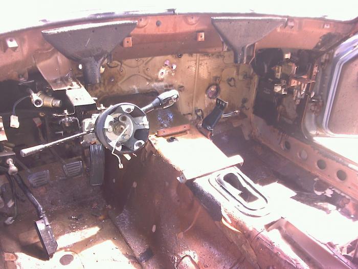

And I'm still working on getting the interior stripped.

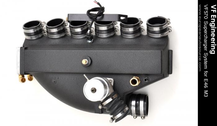

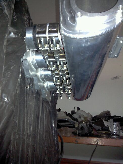

Below is an intake manifold off an e46 M3. i was wondering if it would be a good idea to do that to my sheet metal manifold? I'm talking about the couplers at the base of the runners.

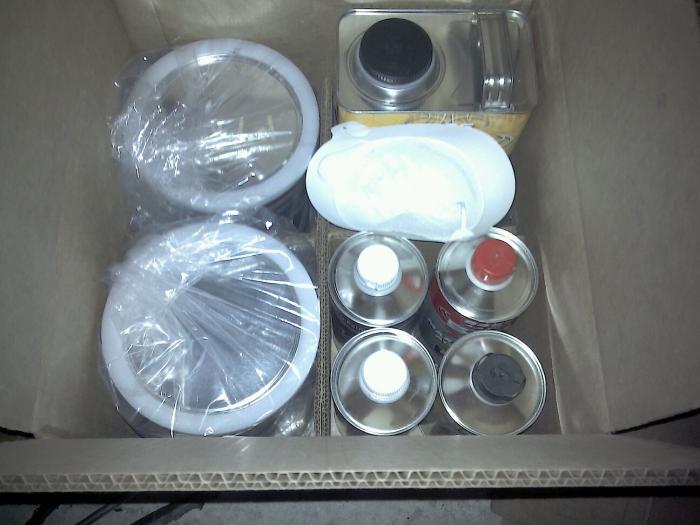

Got my paint today. 1 gallon of metallic black, 1 gallon of clear, and a gallon of high build primer. and all the hardeners and activators.
Had a friend do that with his manifold definatly dropped the intake temps but every time we pulled the manifold we had to retune because of the runner length difference. Made it a pain to get consistent results. Not to mention when you pop your IM off from boost pressure.
I ordered the 2" couplings and clamps and I'm going to do it. mainly to turn the throttle body around and make the manifold RWD (its a FWD/AWD manifold). I got such a great deal on it that i couldn't pass it up :coy:. I plan on flaring the edges of the runners if its possible to keep them from popping off :).

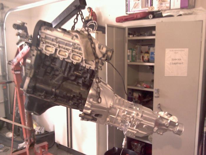

Got my coupler and t-claps in the mail today along with my bell housing :hellyeah:. Bill does and Amazing job! fitment and casting was flawless:thumb: Highly recommend his adapters!

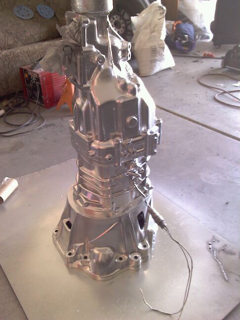

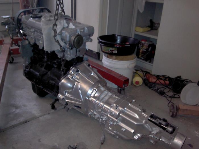

So today i was about to finish up my interior and have it all painted, that was my goal at least, but then i remembered that today a junkyard near me was having a 50% off sale today and thought it would be a perfect time to find my transmission. I did and it was only $97 after taxes so i couldn't complain.
My RWD manifold :sneaky: i guess time will tell if it leaks or pops off, but its on there fairly strong.
and my W-58 out of an old non-turbo supra, with bills adapter. I painted them both, once i cleaned the transmission. It should last for my current goals and when it breaks i should be getting an R-154 :).

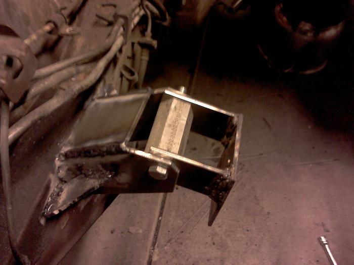

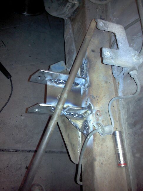

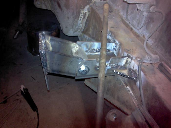

Making the motor mounts..

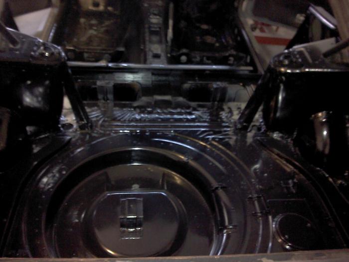

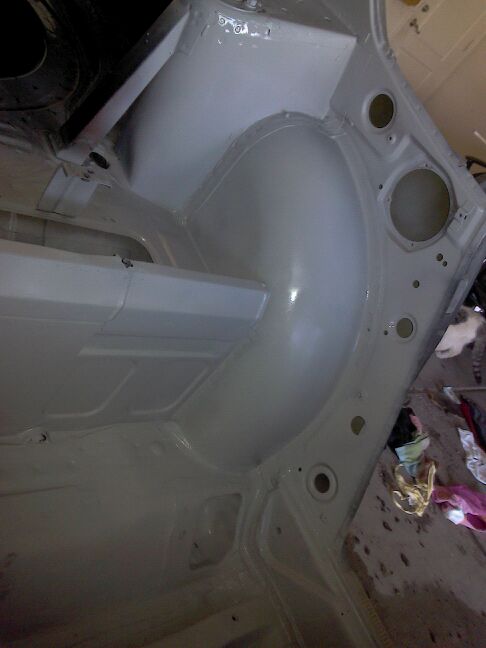

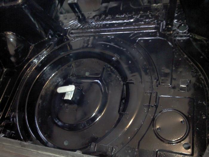

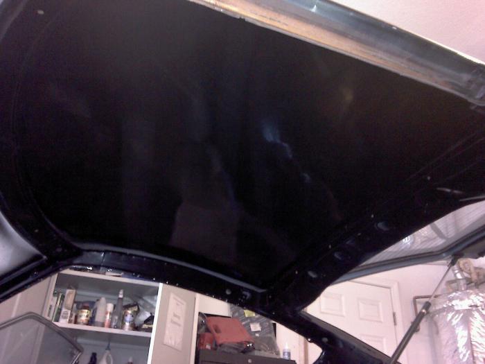

Got the rear of the interior painted black. working on the passenger side, fixing the rust spots :nogood:.
some pics..
Ps. i suck at welding and i know i do LOL

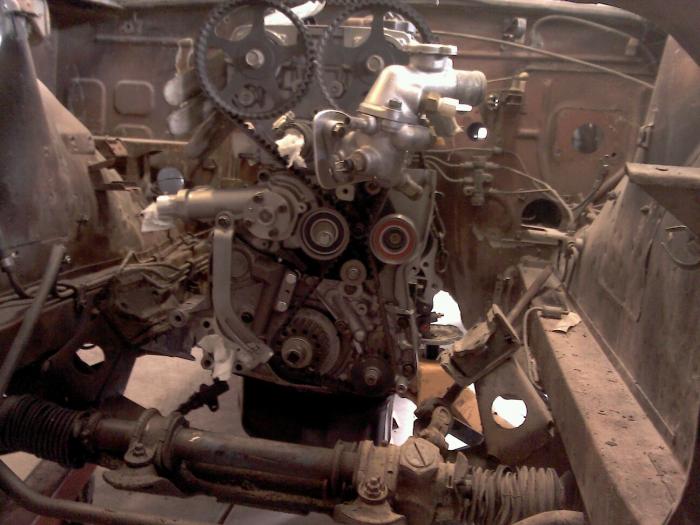

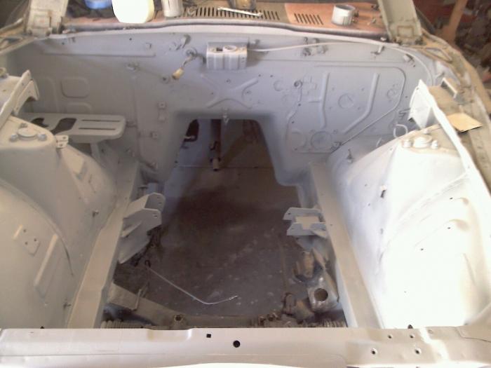

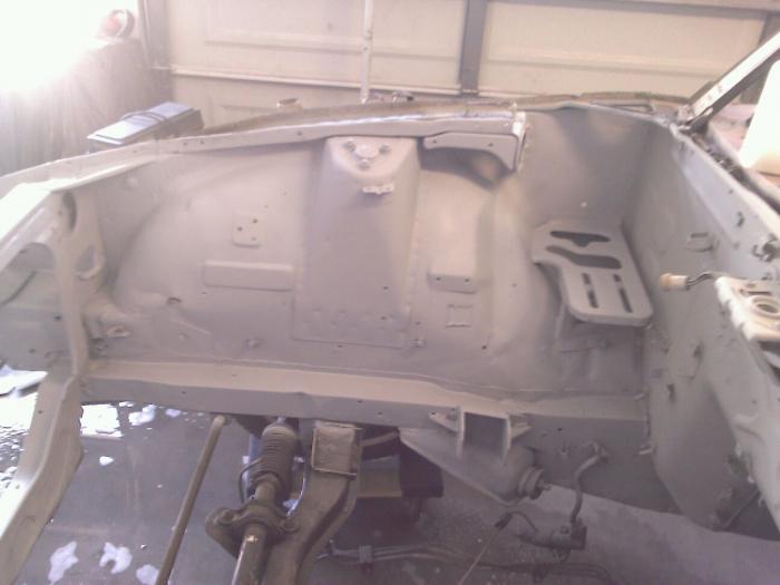

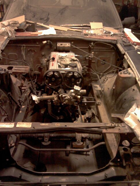

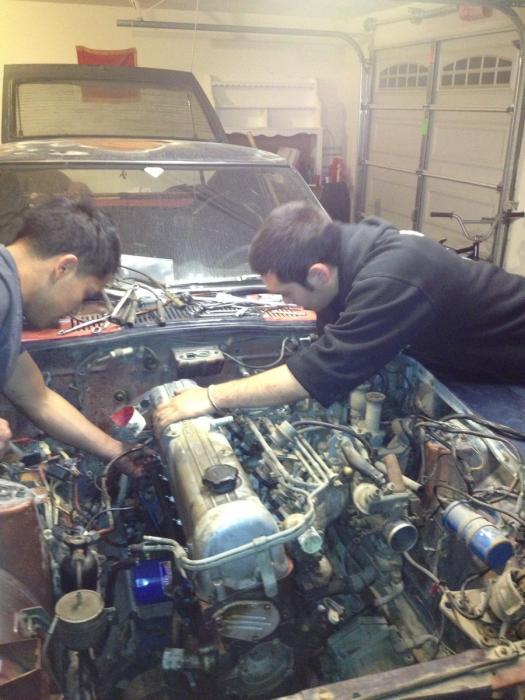

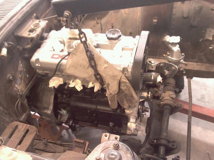

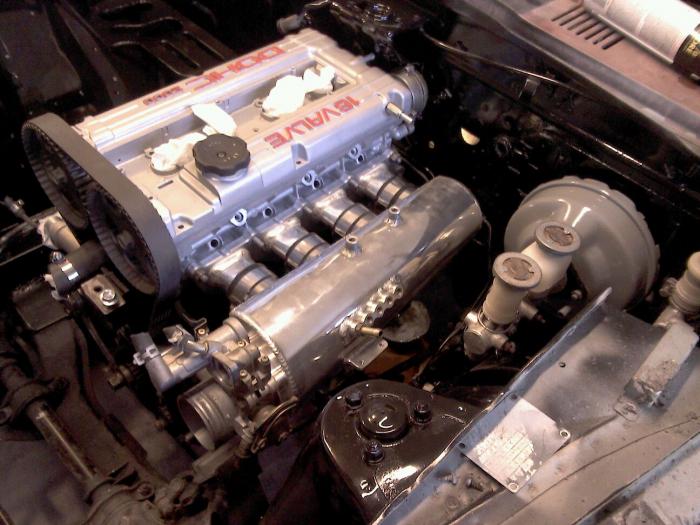

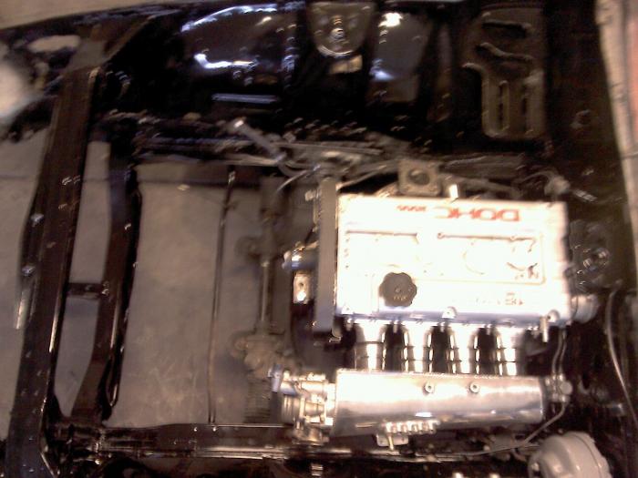

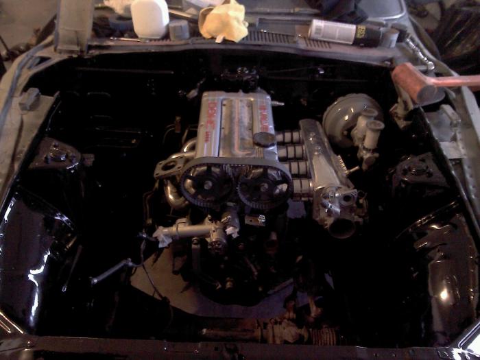

Got my engine bay painted and engine mocked up.
Now i can start on the body work and get this bad boy painted :rocks:

What intake manifold did you start with ?
Its an evo 1-3 JDM manifold. got it from Japan :). It says "velocity" on it Not sure if thats the brand or ??

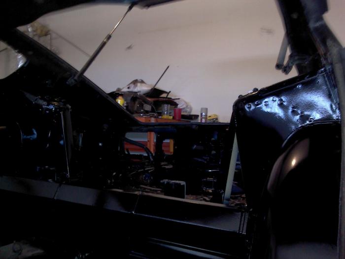

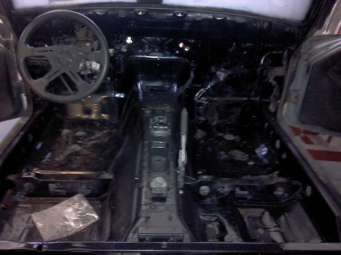

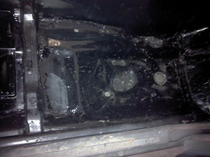

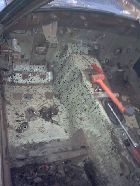

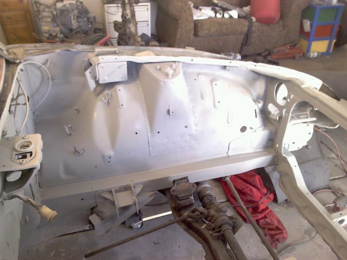

I just realized that i haven't posted pictures of the interior. Here are some pics of the interior, sorry that its dirty LOL. fixed all three rust holes in the floor. cut out the rust, welded another piece in then bondoed over it and painted.

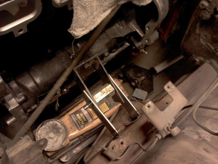

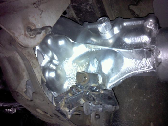

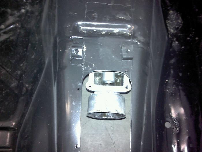

then theres my transmission mount, modified the old existing one.. and look how short my transmission is :ohdamn:... that should be fun shifting :rolleyes:
