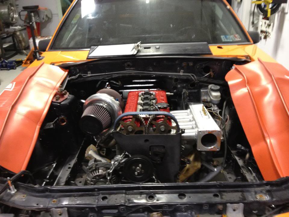

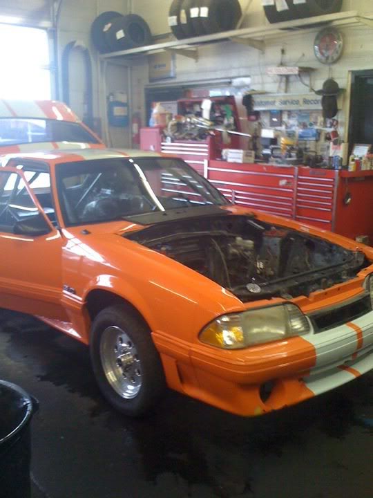

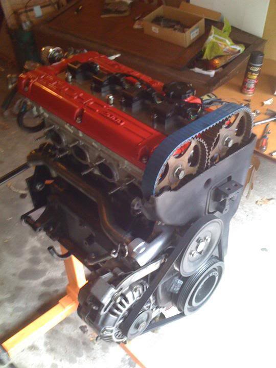

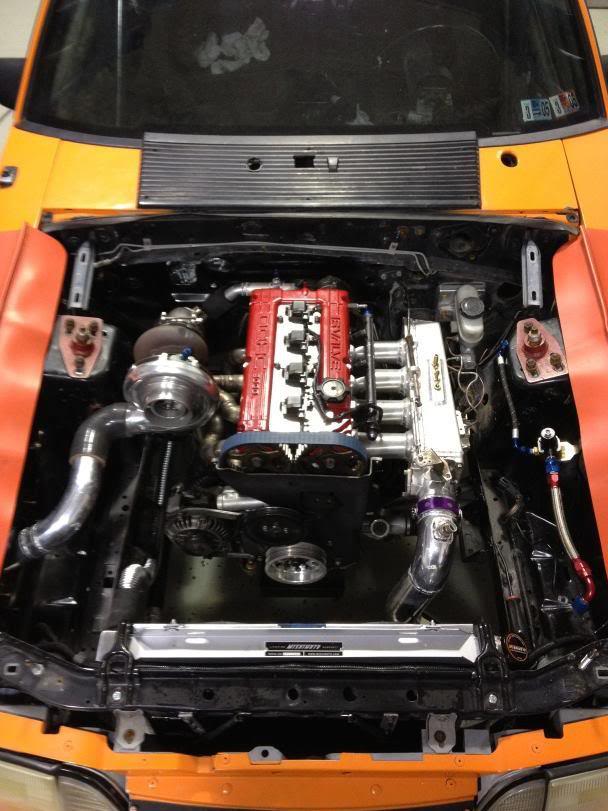

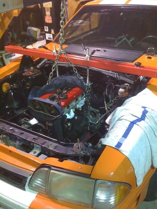

After I dynoed my Talon @ 440whp I thought I hurt the engine so decided to pulled it out and get it checked. Turned out to only be carbon build up on the valve. Instead of returning it to the Talon chassis I decided to go a different route by putting the engine in a fox body. Excellent drag race platform, easy to find parts for, and CHEAP. No one likes to constantly replace drive line parts in a DSM or go buy way expensive trannys and axles so I found a guy in Ohio who makes adapter plates from Mitsu to Chevy which was perfect for what I wanted to do. I talked a local guy down to $700 for a caged Mustang shell with no engine, no trans. Again, perfect. After I sandwiched the engine to the Turbo 350 trans, and put the power house in the car, I took it to World Motorsports to do all the fabrication work. As of now, it is at the shop getting the wiring harness put in and then re-tuned.
Here are some pictures to date.
