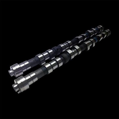

So, these are what I'm looking for? If you can link me to the correct stage 2's that be awesome.
No those are for a Honda. What you need:
Brian Crower part # BC0166
Crower part # 64462
If I'm not mistaken, production of both of those has been discontinued. But many places still have them in stock. There's a set of Brian Crower stage 2 on Ebay right now.
Something else to note is that "stage 2" are different for each manufacturer. Brian Crower will give the best results. They are 264/264 compared to Crower 241/241.
Crower part # 64462
I searched the 64462 and found this one? I can't find a NA like you want me to purchase so, if you could link the one you found that you recommend that be awesome. I'm sure it's gonna be hella expensive since it's ebay unless you find a online shop that has the one I want and link it below.
This is what I'm looking for correct?
You may be able to find a set cheaper but this is the first result when I searched Google for the Brian Crower part number.
Same here! The only one I found was ebay. If you can fins another place that sells a set brand new that be sweet.
You probably won't find a set much cheaper than those on Ebay unless you buy them used. That's because when the part got discontinued everybody jacked their prices up. If I were you, I would call Brian Crower customer support and see if you can still order a set and wait for them to get produced. If they can do that, they would probably honor a cheaper price than others but you will have to wait for the backorder to process which can take multiple weeks sometimes. I found on Google their customer support number is (619) 749-9018
But honestly if you don't want to deal with a hefty price or a backorder process you could just try to find and buy a set used. It won't hurt anything as long as the cams are still in good shape. Just look for the lobes to be rounded off, scoring on the cam journals, or broken dowel pins.
And really if needed, I'm confident you could use the Crower stage 2 turbo grind cams and reach your power goals. With enough boost she'll breathe. I'm just telling you what is BEST to run and will make more power easier. Hell there was a member on here making 300+whp on the stock camshafts. The Brian Crower stage 2 BC0166 camshafts just have the best airflow characteristics for a street-able 420a. But you can always use a less aggressive camshaft if needed and counter it with boost.
What about Stage One's!
Would these be fine?:
I wouldn't bother with stage 1's personally. It's a lot of money for very little gain. At least stage 2. Personally I would go with a stage 3. You pay the same for them whatever stage you get so 3's are the most bang for your buck while still being driveable on the street
EDIT: Actually being crowers the stage 2's would be the best. Stage 3 is their highest lift so the stage 3's would not be streetable. I was thinking of Brian Crower cams which have 5 different stages available if they even make them anymore
