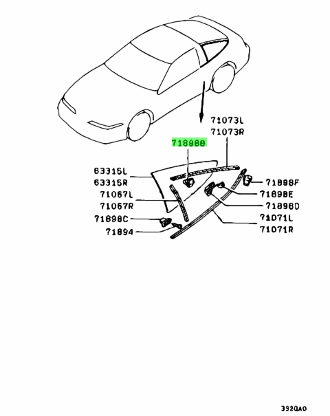

Has anyone printed the various 1g drip rail and other windows lining trim clips like the following?
That's not an exhaustive list of parts as there are lots of them... I live out in the desert and these are all totally busted on every car out here.
If there aren't any, I may try to design and print some.
