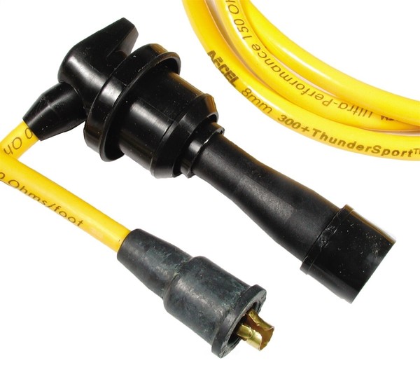

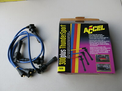

I have these on my car..
Blue:
Red:
Yellow:
