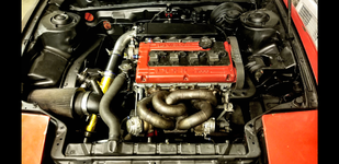

I've been reading for weeks on how to fix this problem and I still can't figure this out. My 98 gst just shut off on me one day while I was driving it and wouldn't start back up. There is no power going to my fuel pump and so far I have changed the "mfi/fuel pump" relays, I am getting power to both of the relays, change the "engine" fuse in the engine bay. I ran a 12v power supply to the fuel pump connector under the hood and I got power to the pump but I don't understand why I am not getting power the normal way. The pump is also rewired and I've changed the inline fuse and the relay on the pump. There is also power going to the relay on the rewire kit also but not going to the pump. I am also getting spark to the coils and kind of lost at what to do at this point.
