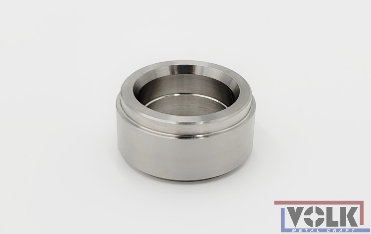

Yes it will. The block itself is the same between manual and auto. But the crank in the manual short block will require a pilot bushing. You can remove it from your old engine that was with the auto trans and reuse it. But usually it's a PITA to remove since it's press fitted, so maybe you should prepare another one. Like the one in the link below. (OEM is discontinued)
