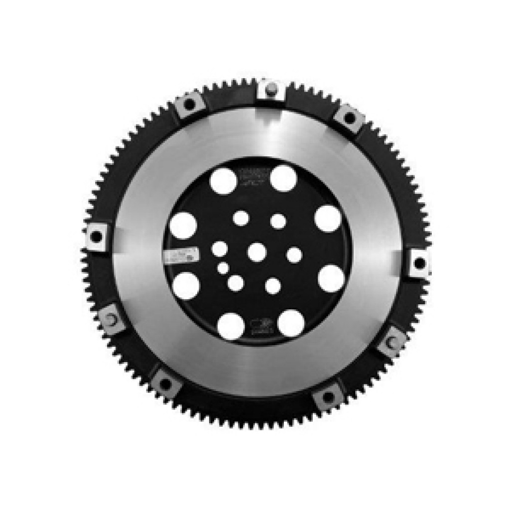

For clutch recommendations. I wonder if @twicks69 could help? Based on previous threads, I've seen you recommend SBC SS-X TV/B-Series clutches which I think will meet my end goal of ~400awhp after further mods are complete. Would the items linked below be the correct ones to order? I want to make sure I get the correct ones for my 7-bolt AWD. Not sure if I need a replacement flywheel to run the SBC clutch.
https://www.tmzperformance.com/shop...ishi-galant-vr4-1992-1995-mitsubishi-evo-1-3/
Have you checked front right axle is fully engaged and locked into place in the front diff? Have you drained your transmission? Have you pulled it yet and inspected the clutch? If you didn't destroy your clutch, then I am guessing your center diff just died by broken cross shaft / spider gears internally and you have a wiped out viscous coupler, or you wore off the splines for the output shaft to the transfer case which would still point to dead center diff and viscous coupler. Otherwise, you could have a front right axle failure, or you sheared a tailshaft on your transfer case. It depends on how much abuse the components had in their life. At your power levels, I would not expect a transfer case to shear the tail shaft unless there was an internal bearing failure; it would be a higher likelihood of worn off splines on the tcase input sleeve and transmission output shaft which both happen from center diff failure. If the splines are wiped out or saw toothed, I would recommend disassembling the transfer case to inspect. It is fairly easy to do a quick inspection by removing the 5x 14mm side cover bolts, hitting the input sleeve with a dead blow hammer and removing the side cover and pulling out the drive gear assembly (inner tapered roller bearing, input sleeve, drive gear, outer tapered roller bearing). Inspect the bearing condition, more specifically the inner bearing that is much smaller is notorious for failure, especially when the input sleeve splines are worn out from the center diff failing inside the transmission.
I would recommend starting with draining and removal of transfer case and transmission getting pulled, inspecting the clutch for a disk failure or hub failure and inspecting the output shaft splines and tcase input sleeve splines.
Yes, for the clutch / flywheel stuff, the SSX w/ TZ/B disk kit and ACT Streetlite flywheel will do the job. If you need new flywheel bolts = MD302074 x7, pressure plate bolts = MF241251 x6.

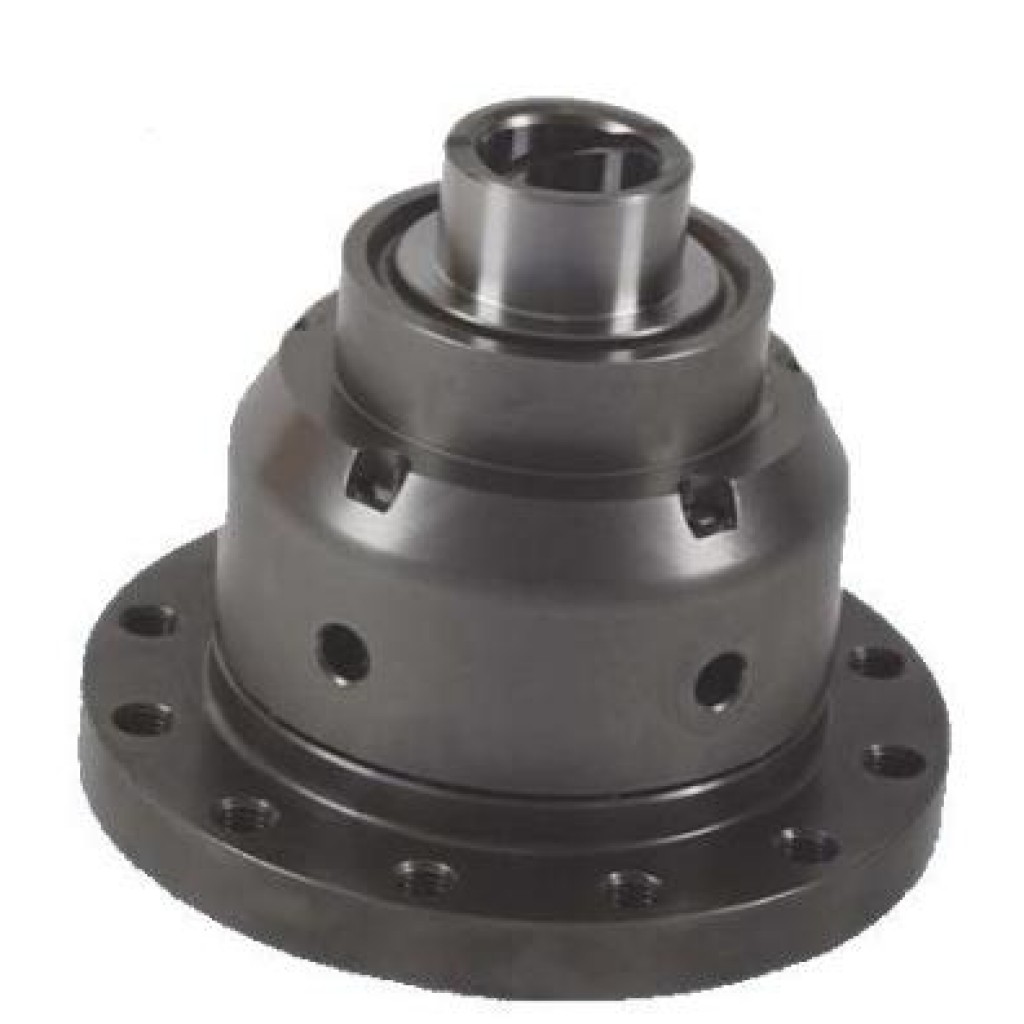

If it turns out to be the diff, may go with the Quaife LSD so I never have to worry about it again.
Not sure about the options listed on this one though regarding the bearings and speedo gear. I assume these would be required.
