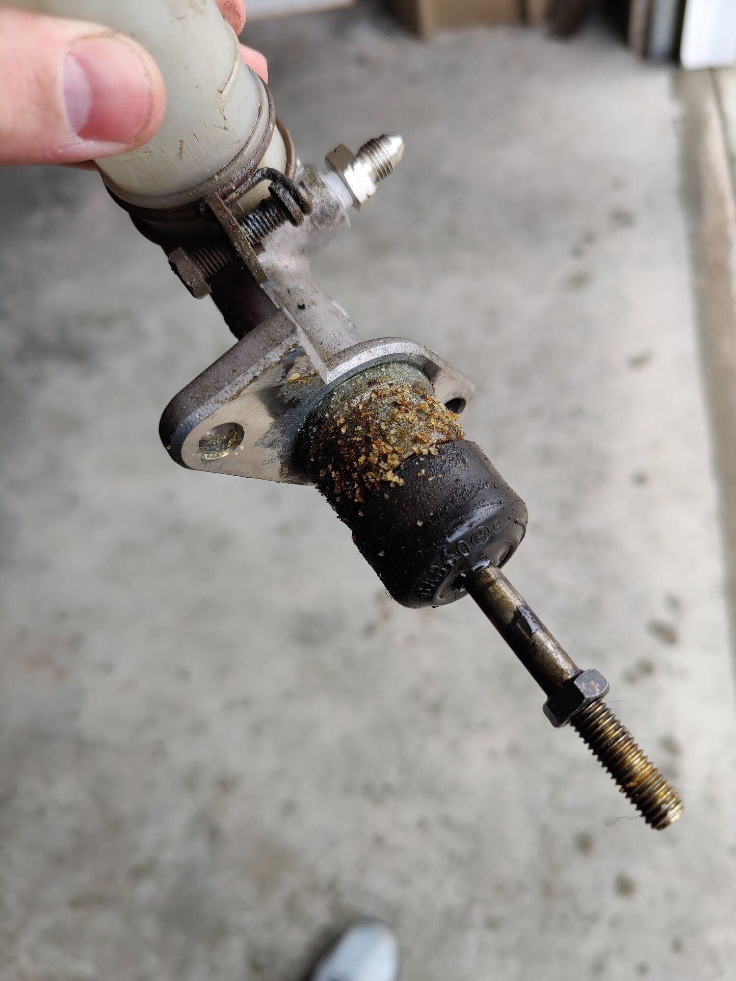

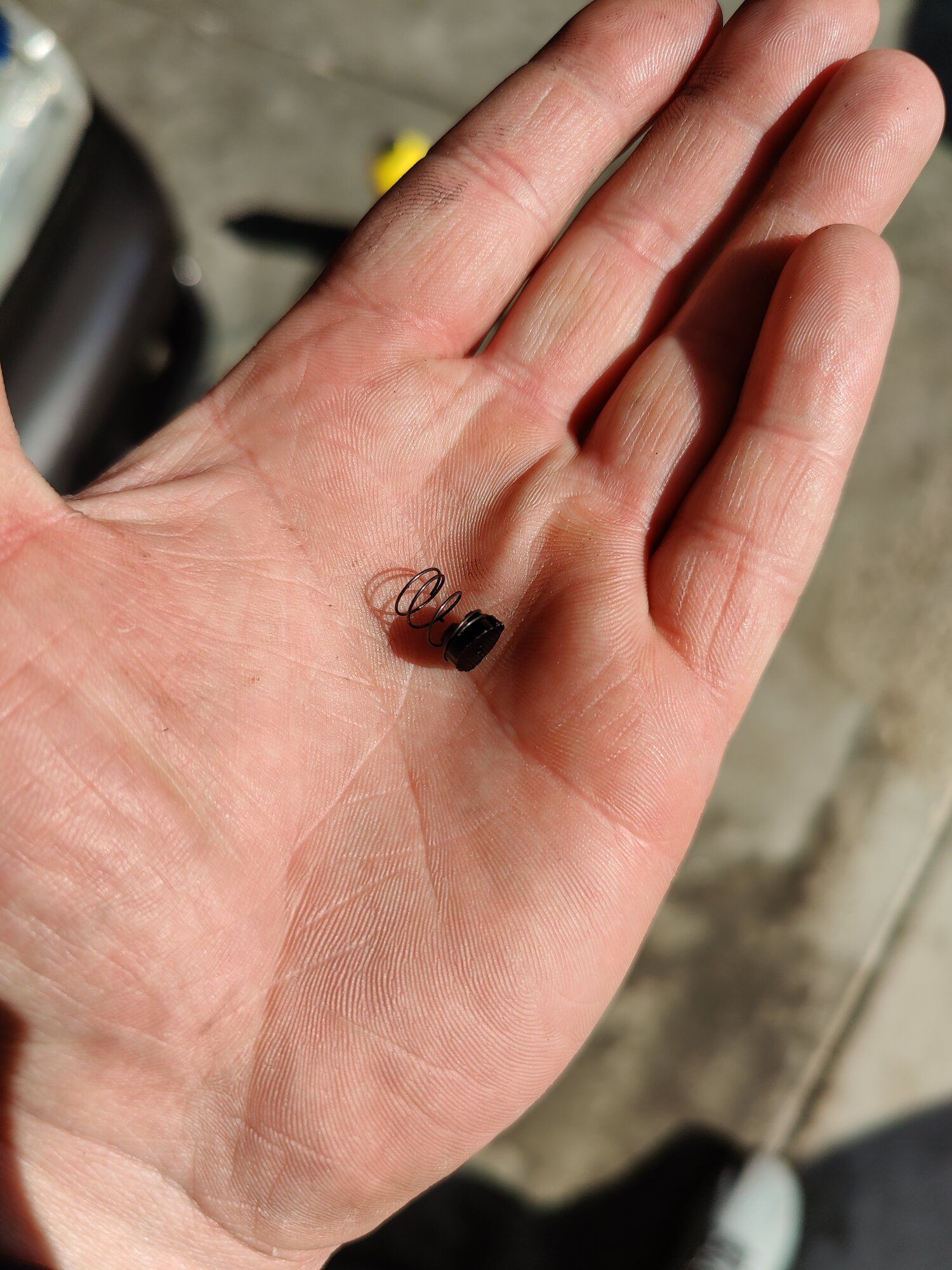

Well new master cylinder came in. Got the old one out with relatively no big issues but it was crusty as hell. While replacing it I decided to replace the master pin, plastic washer, and plastic insert and a new cotter pin. That plastic insert was such a pain to get in without taking anything apart but I got it after awhile (and almost losing it when it slipped out my fingers 3 times)
Also, SCREW using a cotter pin up there.. I just swapped the cotter pin for one of these push retaining pins from my shift linkage on the trans. SO much easier than having to try and bend the pins up there.
New master in, I made sure to extend the rod basically so it was flush with the inside of the "U" shaped.. bolt?

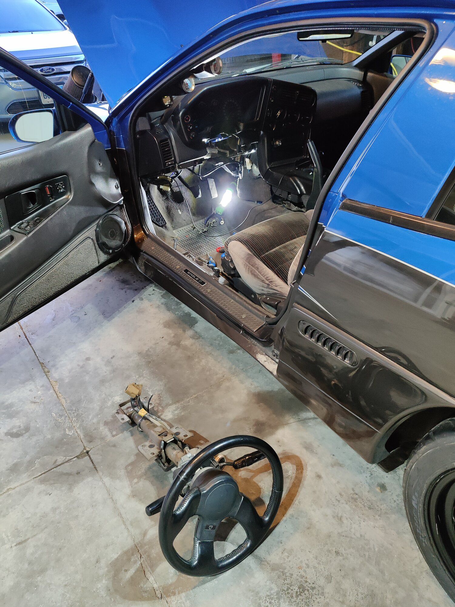

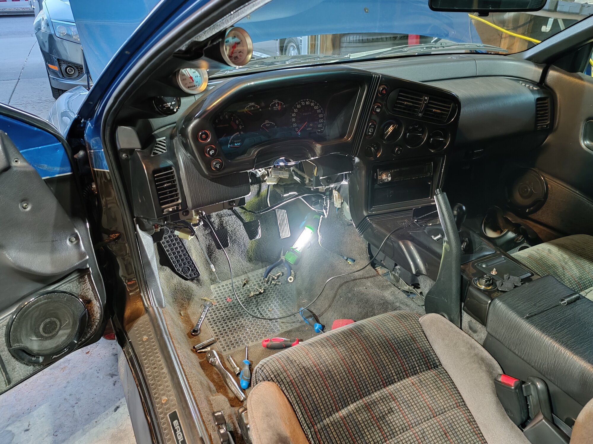

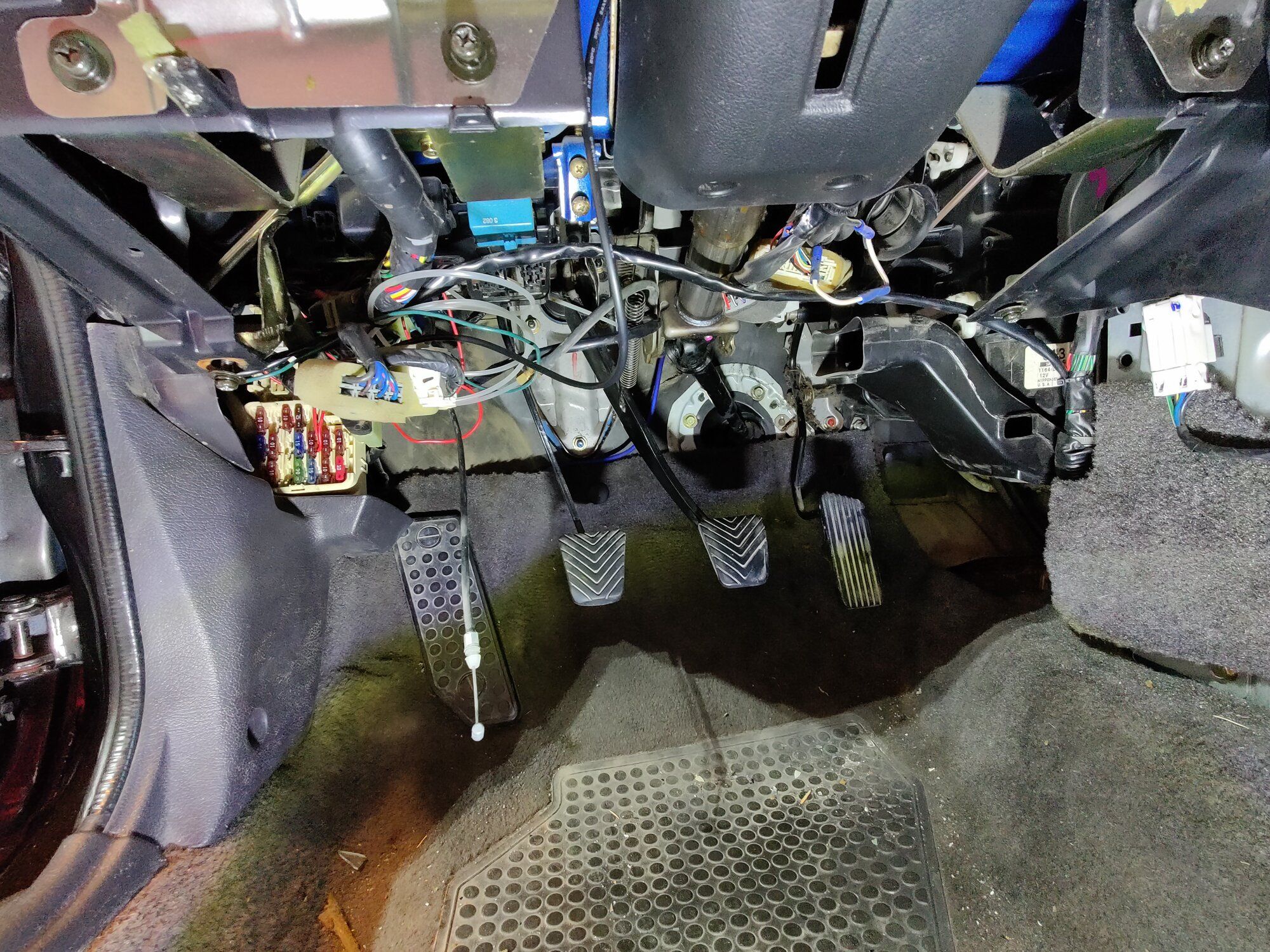

So I started the steering wheel delete mod to take out the pedal assembly last night. got down to the point where I need to remove the little fuse panel on the driver side and need to pull out the brake booster and the clutch master and then the few bolts on that far left side and it should be ready to come out. I got in on the group buy from Pats all bronze bushing pedal assembly bushing kit here: https://dsmmachining.com/product/1gen-dsm-pedal-assembly-bushings/ and i think ill have it welded and pray that it doesnt weaken anything and cause issues down the road.
going to try and knock out removing the assembly today after work.

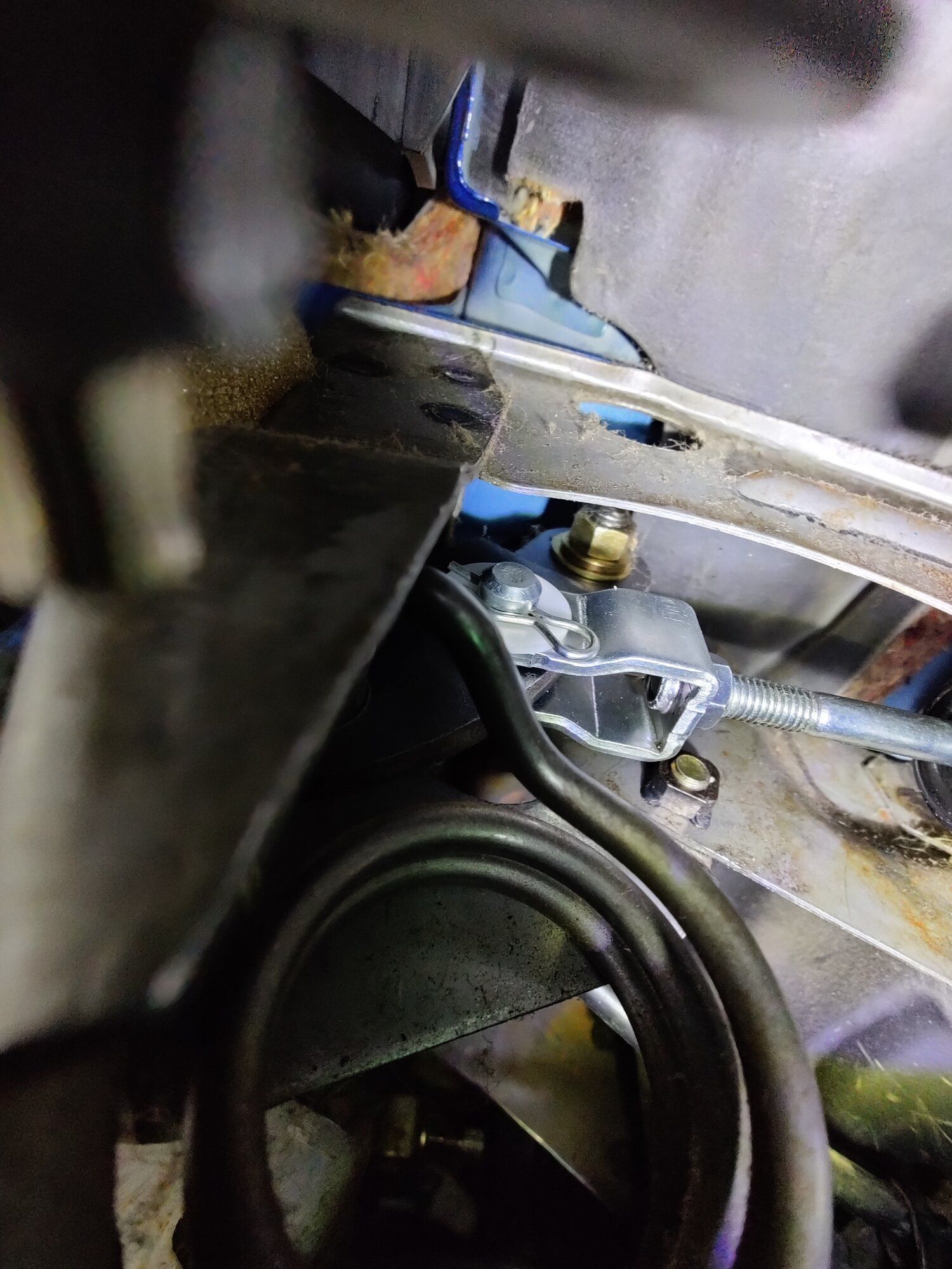

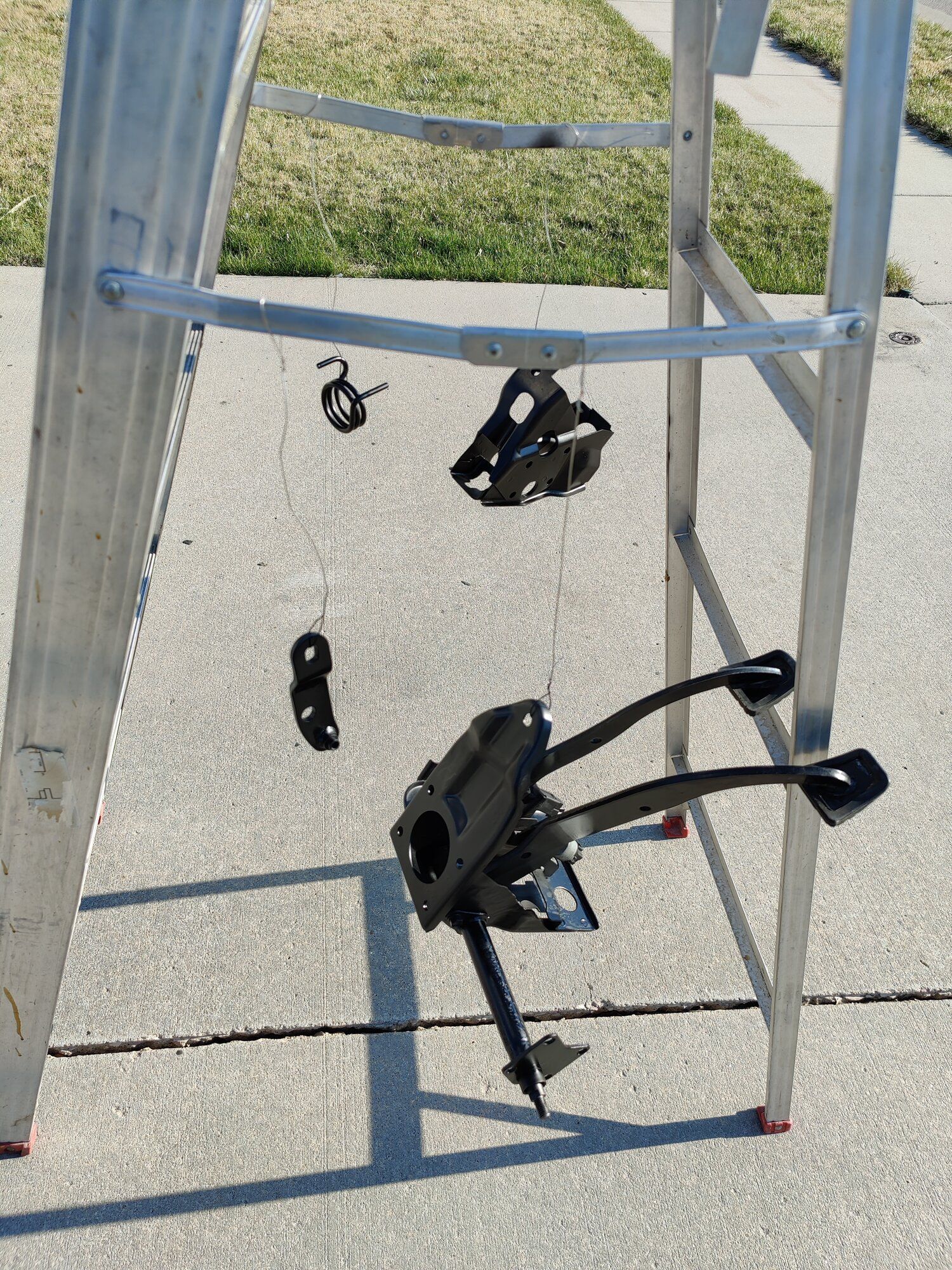

So i got the pedal assembly out. Honestly, this wasnt that hard. I think putting the turbo in was much harder and more frustrating that pulling the assembly.
The most frustrating part of pulling it was getting the brake booster far enough away from the firewall so that you can slide the assembly down.

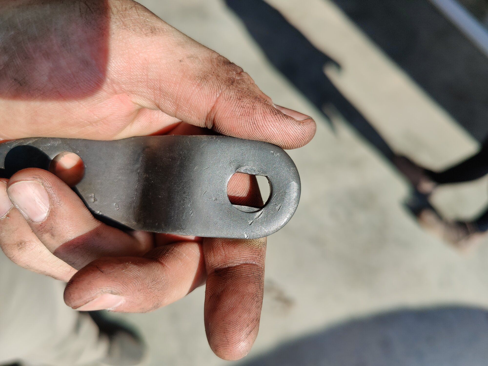

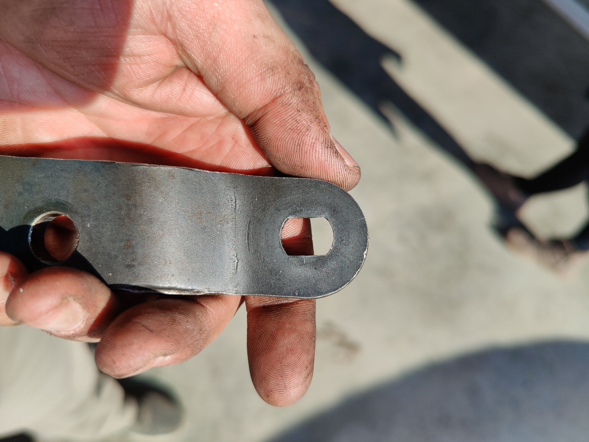

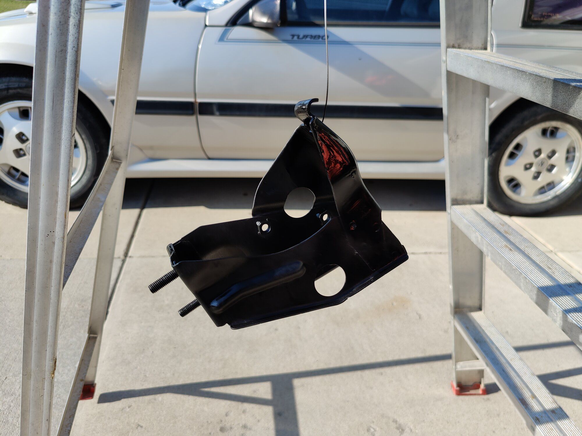

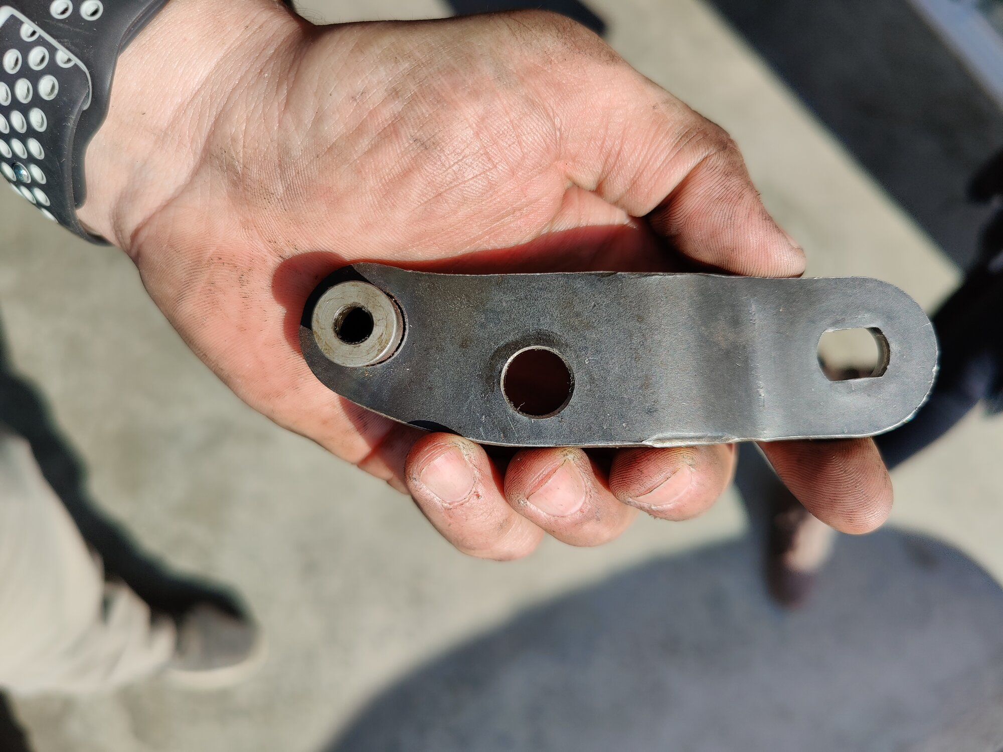

Anyways i took it apart and surprisingly, it looks okay. The keyed (for lack of better term) part of the lever isnt wobbled out or anything and neither is the clutch master dowel spot.
I actually put the lever on and it still moved.. so hopefully i dont need a whole new clutch rod. I guess if i do, its not that big of a deal since im waiting for the bushings anyways. I took a video and ill link it.
With it out of the car i cleaned up all the grease, oil and dirt that was all over it and i painted it black! Theres some runs, but it looks much better and sleeker than it did before. Im pretty stoked about it.

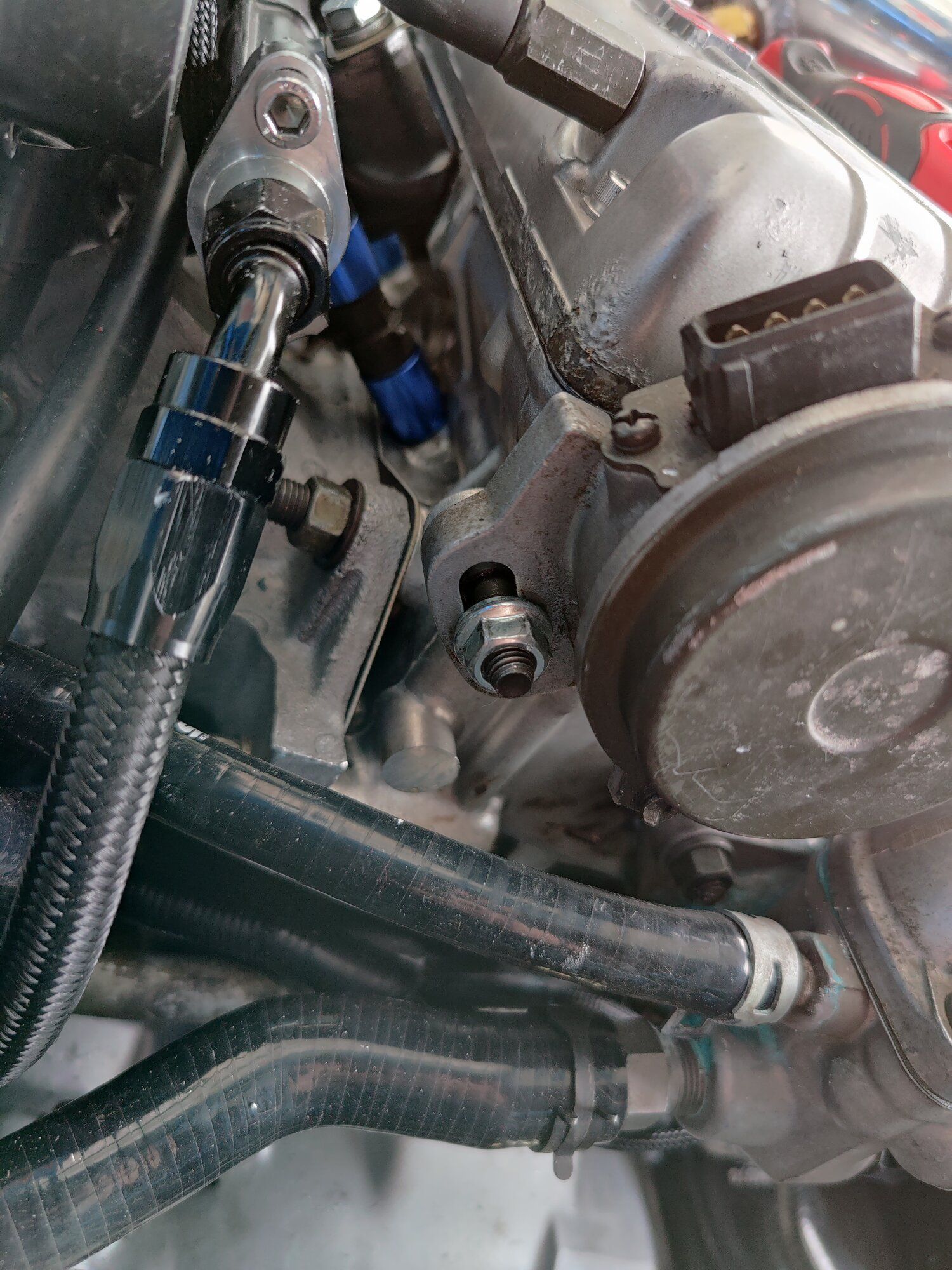

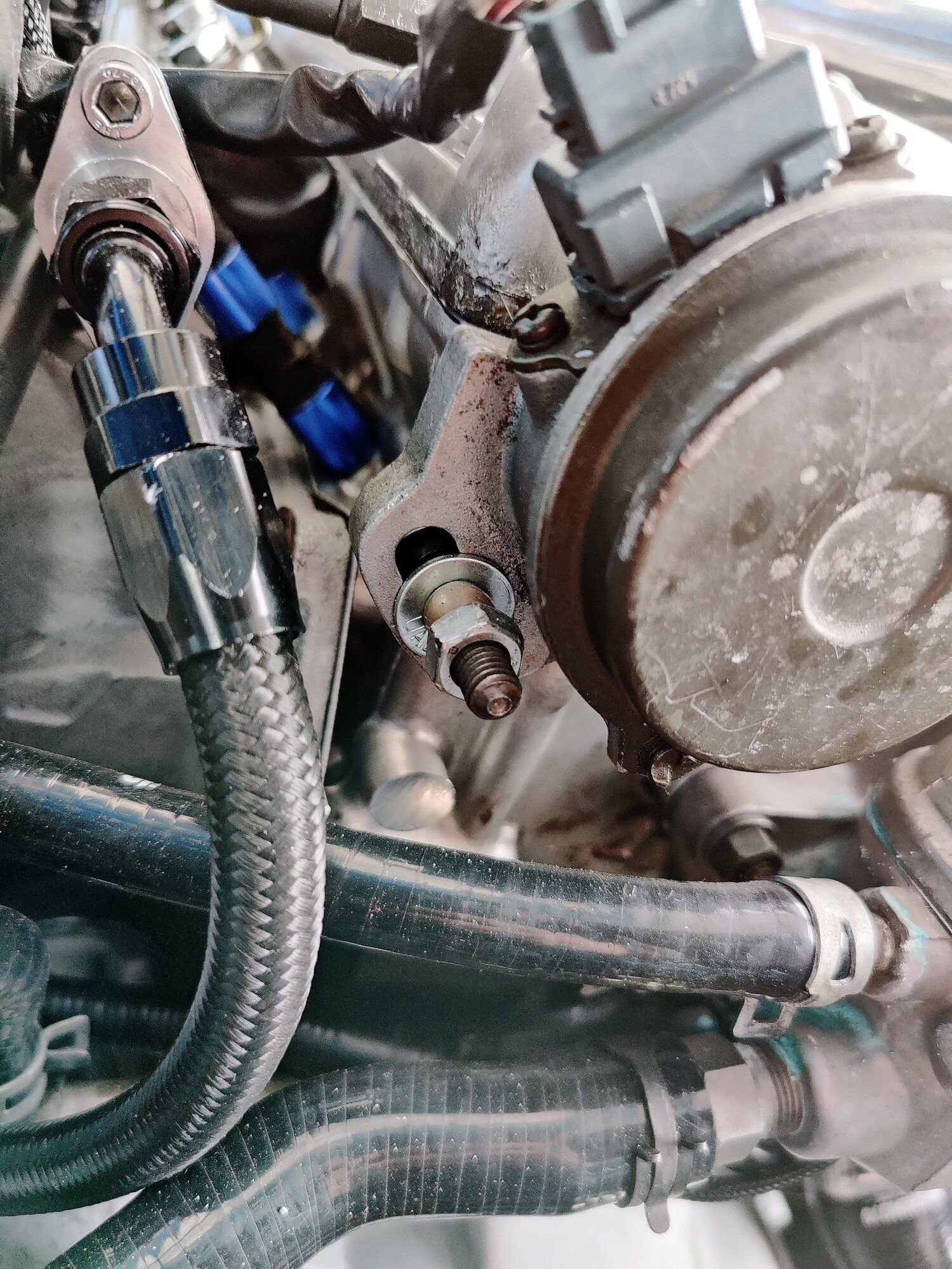

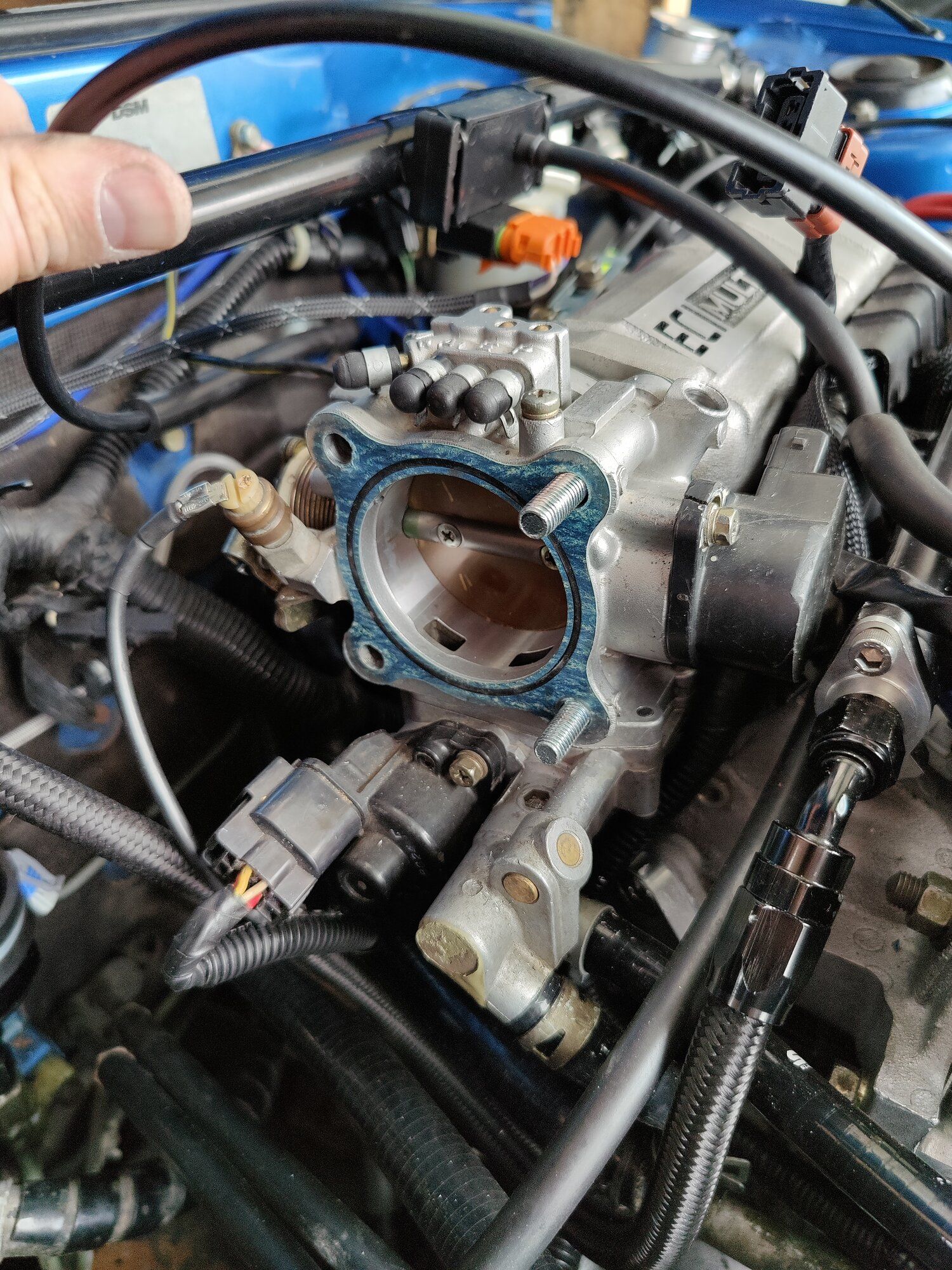

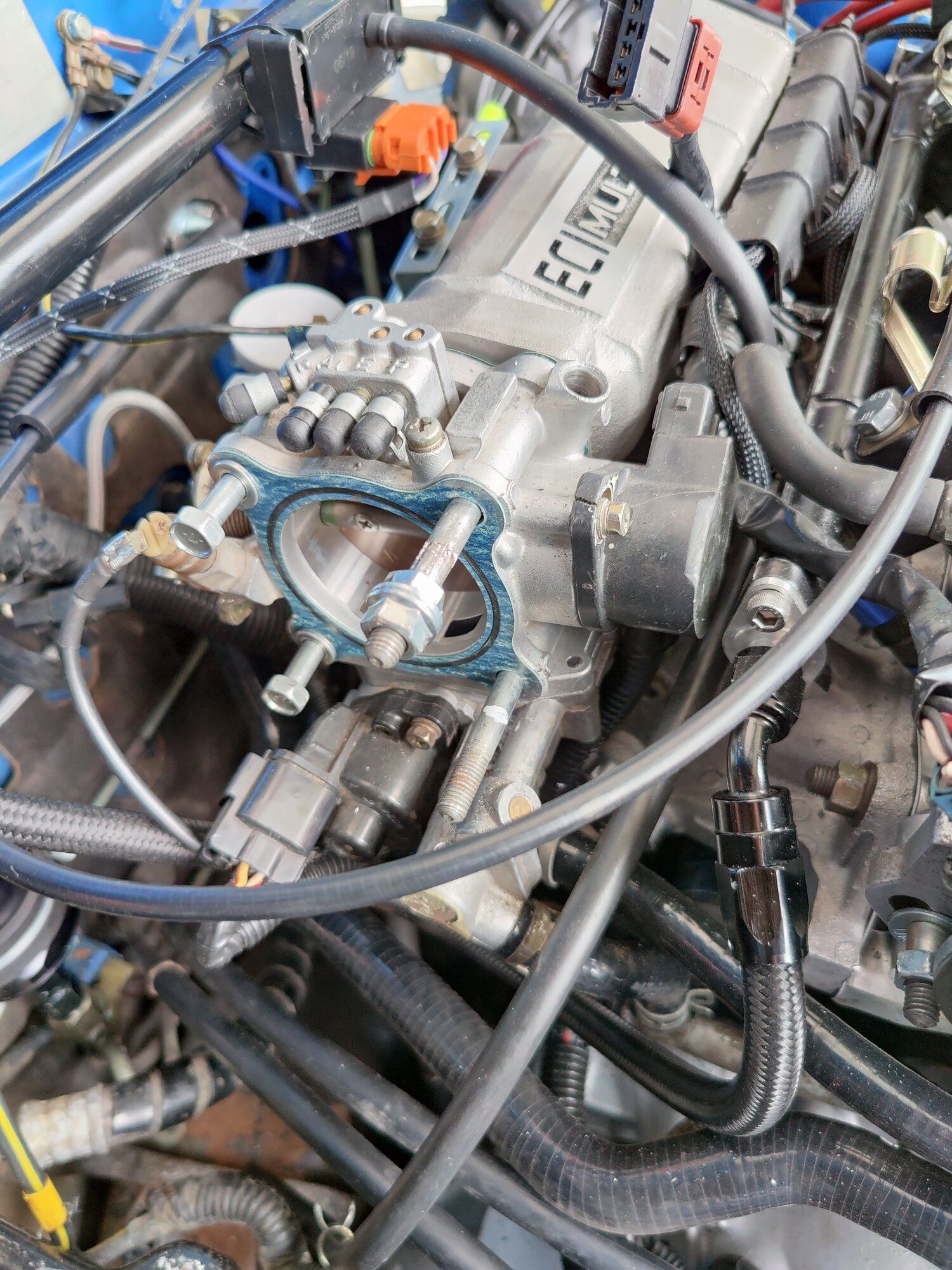

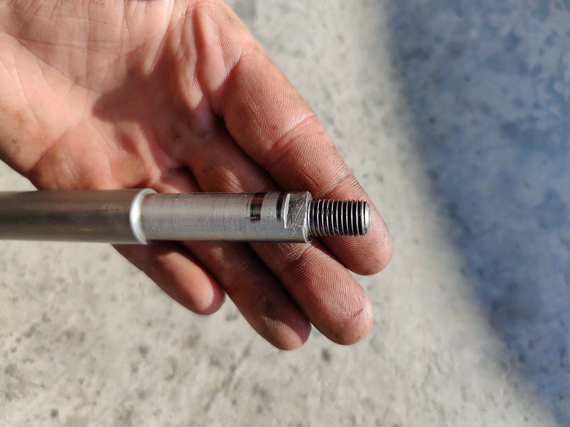

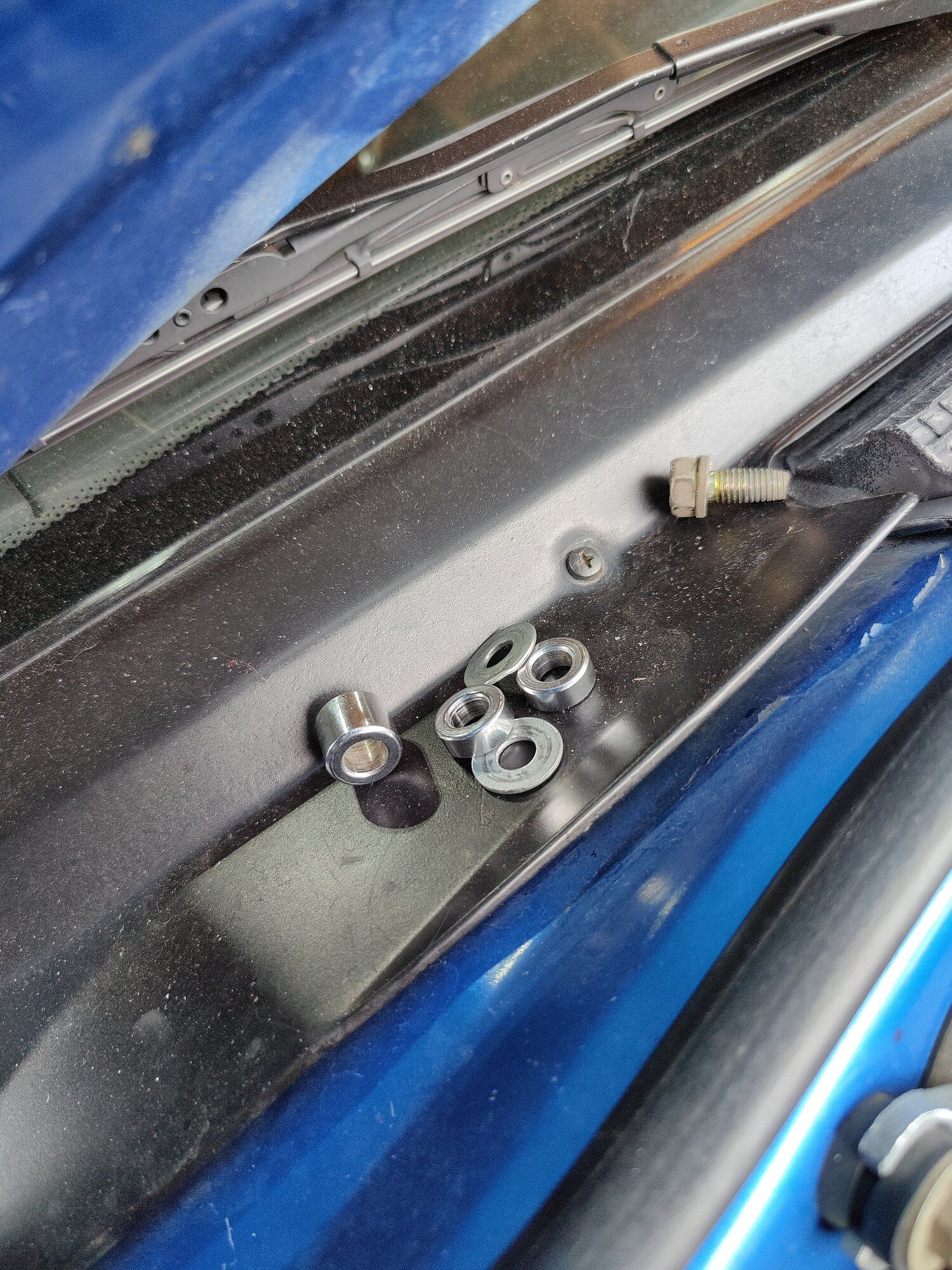

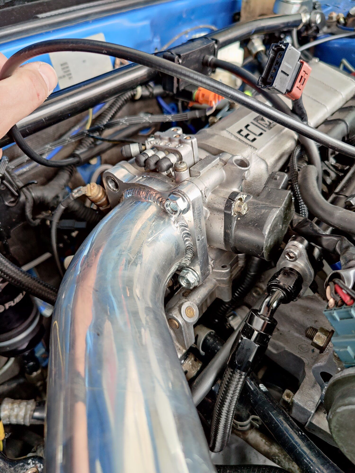

Well while the car is down for a little bit, I'm taking this opportunity to fix something's that were supposed to be temporary fixes. Such as the spacers on the throttle body, and CAS studs. Since the engine hoise bracket doesn't fit because the AN lines on the passenger side, I had to improvise and buy some spacers so that the nuts would torque.
MAN breaking all of those studs loose absolutely sucked. I had to heat the head and manifold where the threads went into and use vice grips in order to break them out. The double nut method did NOT work, right off the bat but did after they broke loose.
For anyone wondering, the throttle body AND CAS studs are all m8x1.25 size.
I used a 38mm long stud for the CAS and I'm going to use a 90mm for the throttle body. I'm assuming these sizes should work for most anyone, obviously give or take a few mm depending on your throttle body flange thickness too. I got my CAS studs from Ace Hardware, but they didn't have a 90mm stud or a bolt for that matter that was long enough AND had threads on both ends.
Menards is where I'll head next, and if they don't got it maybe Fastenal
Oh, a neat thing too. If you're in a pinch, you can use your exhaust manifold studs for your CAS studs as well.
Man I have been all over town trying to find a long m8-1.25 x 90mm stud, or at least a fully threaded bolt I could cut the head off and NOTHING. I have seen some Allen bolts though. Anyone ever convert to those? Seems like a Allen socket could fit on the front side ones easy enough. Is there enough of a clamping difference that someone couldn't just swap to Allen head bolts?
I ended up going back to menards and they actually had some 100mm threaded rods, unfortunately only a 4.5 grade.. but maybe they'll hold up? If anyone wants to know the info here it is:
https://www.menards.com/main/p-1444440231394.htm
Anyways I said I was going to use a 90mm stud and I did..it's a little short. 95 or maybe even 100mm is pretty much perfect I backed my stud out about 2 turns from being bottomed out and it seemed to be okay. The picture with the nuts on is before I backed the stud out.
I used red locktite.. hopefully that wasn't a mistake.

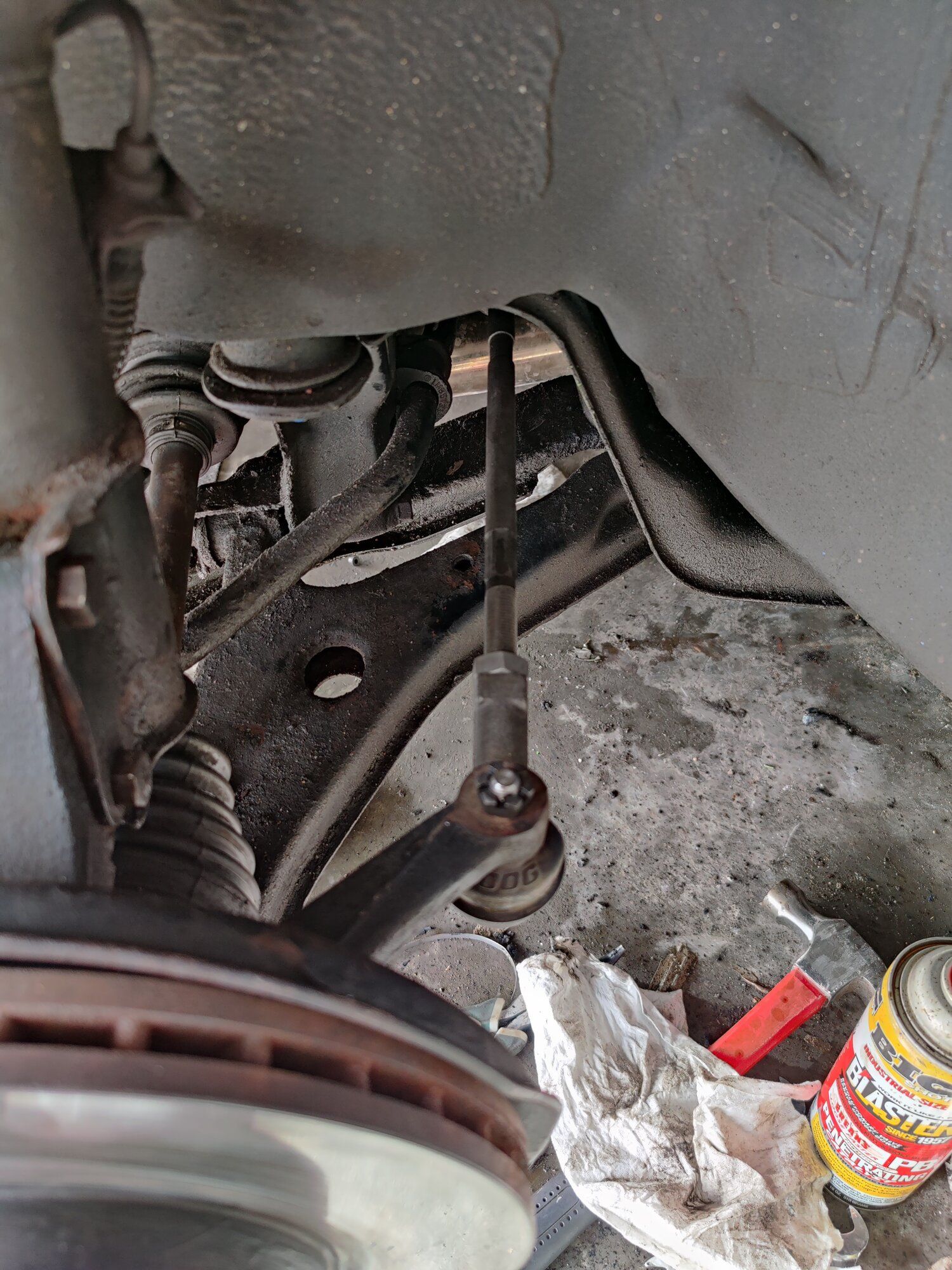

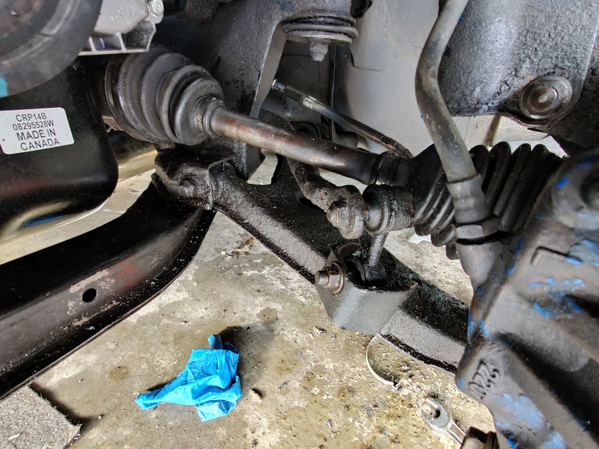

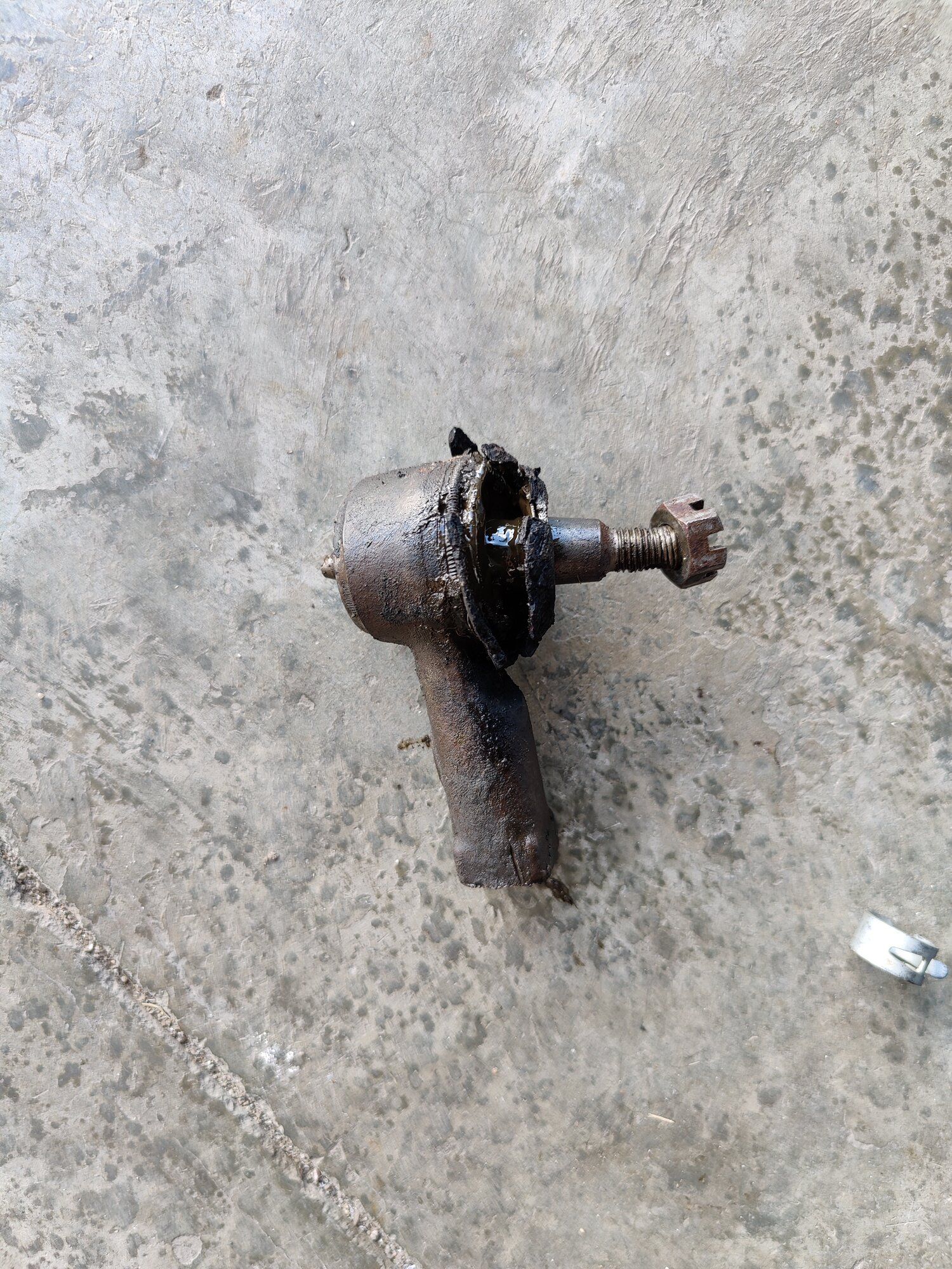

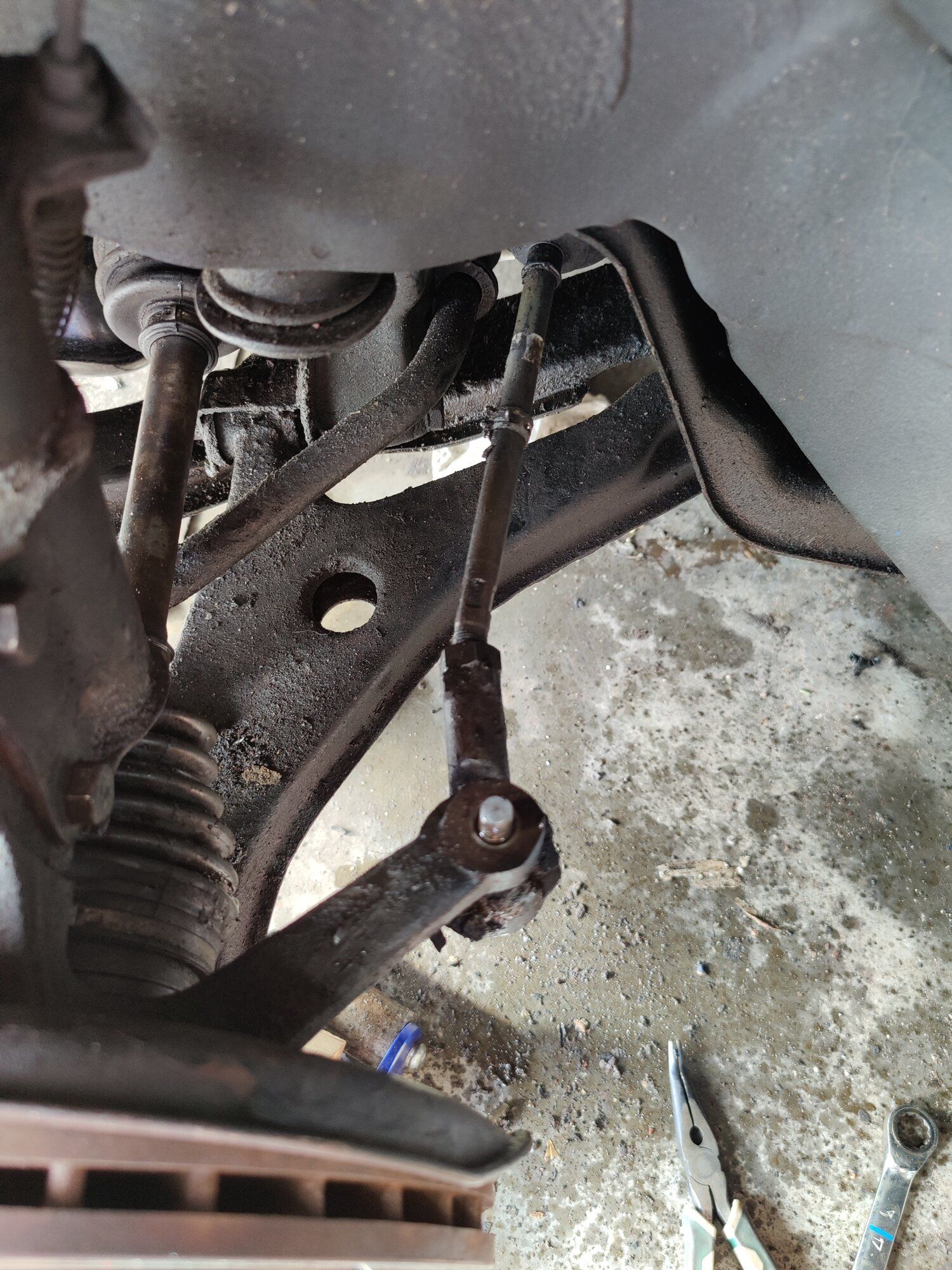

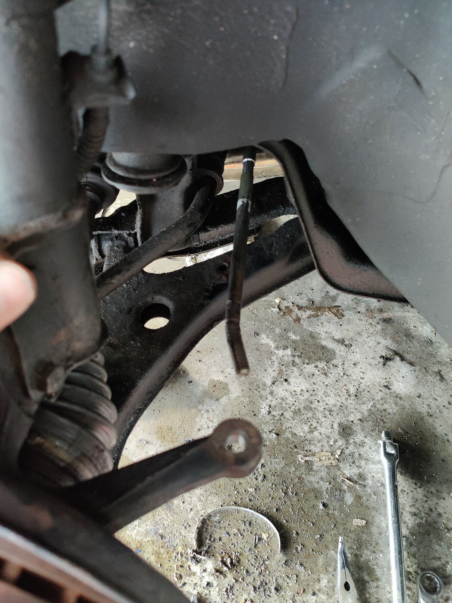

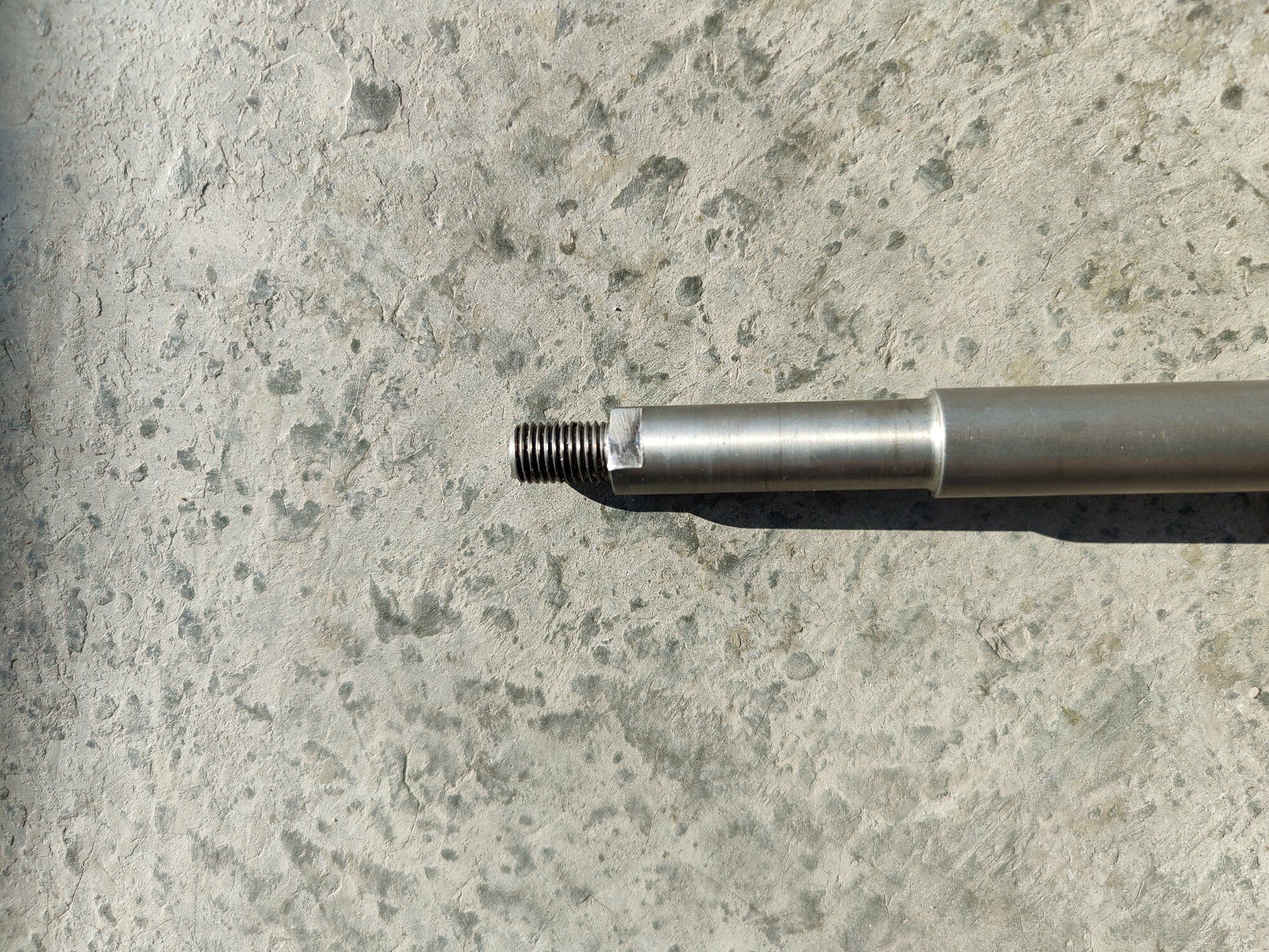

I finally got around to pulling the inner tie rod and end. This thing is so trashed.
it took me like almost 2 hours to break the damn thin out of the knuckle. Alternating between dead blow, regular hammer, a torch, penetrating oil. I finally got it out by heating the kuckle up good, spraying some penetrating oil, wedging my 3 ft breaker bar under my sway bar and on top of the tie rod and smacked it with the regular hammer and it FINALLY came out. I have a new Moog inner and outter to replace it with. Im picking up a tool today to get the inner off.
