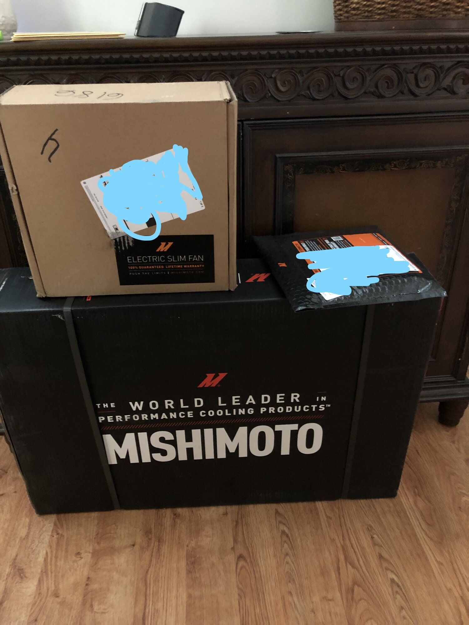

Bit of a parts haul here! The Mishimoto stuff is to replace the 1 radiator fan I currently have (the AC condenser fan up front quite literally melted due to an exhaust leak near the turbo) and overall just help the heat under my hood dissipate a bit more.

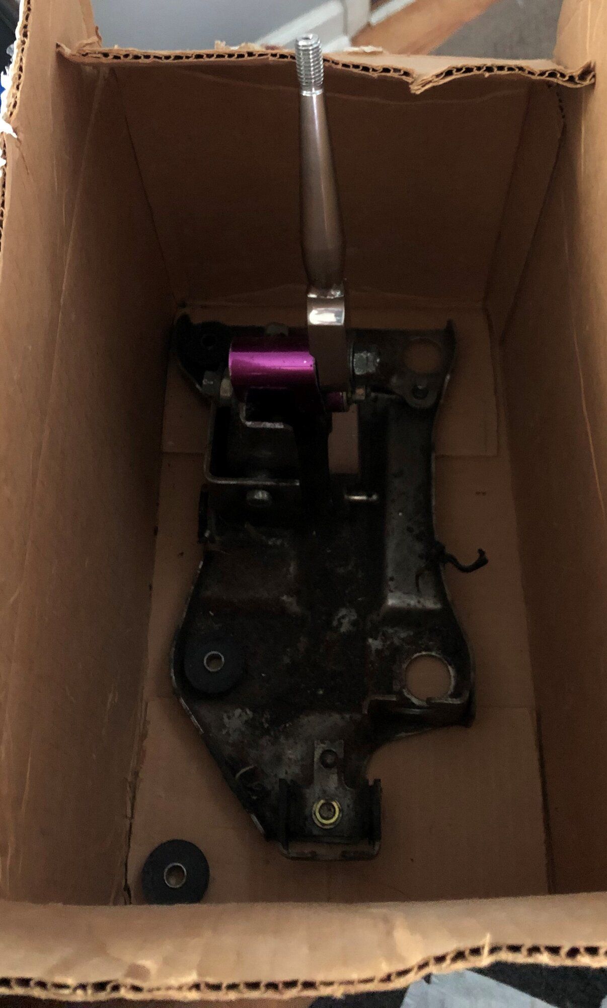

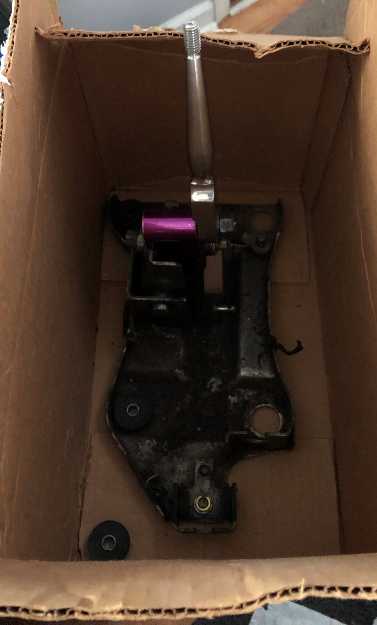

And, the real B&M short shift kit will be a nice touch for the transmission, although its probably going to have to come off that shifter base :barf:

Are you sure that's real? I've never seen a B&m with any other color than blue. Purple is used by Megan racing...
same for this, never got the notification. must have gotten buried in a bunch of others.
Yeah there is potential i got burned. I bought it off of tuners a while back figuring mostly everyone on here is honest/knowledgeable, but who knows. Even if i did get burned, i dont really care at this point since i have MUCH more to focus on for this car.

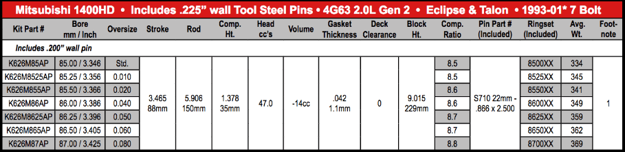

The reason I asked is because I was hoping that the nominal compression ratio on your car would be 9:1 or lower. Because that will make it easier for you to avoid detonation (knock) in the tune of your car, especially on gasoline.
So I read the numbers off the Wiseco box in a picture you guys showed a while back, and it looks good.
Looks to me like yours are the 1400HD part # 626M855AP which STM shows in a chart that I'll post here.
It's the 3rd one down from the top in this list.
They show the compression ratio as 8.6 to 1. So that is good. You really wouldn't want it any higher than 9 to 1 on pump gas.
Wiseco piston chart with part numbers for the 7-bolt DSM 1400HD pistons like on TheDude and TS...PNG
Here's the STM page:

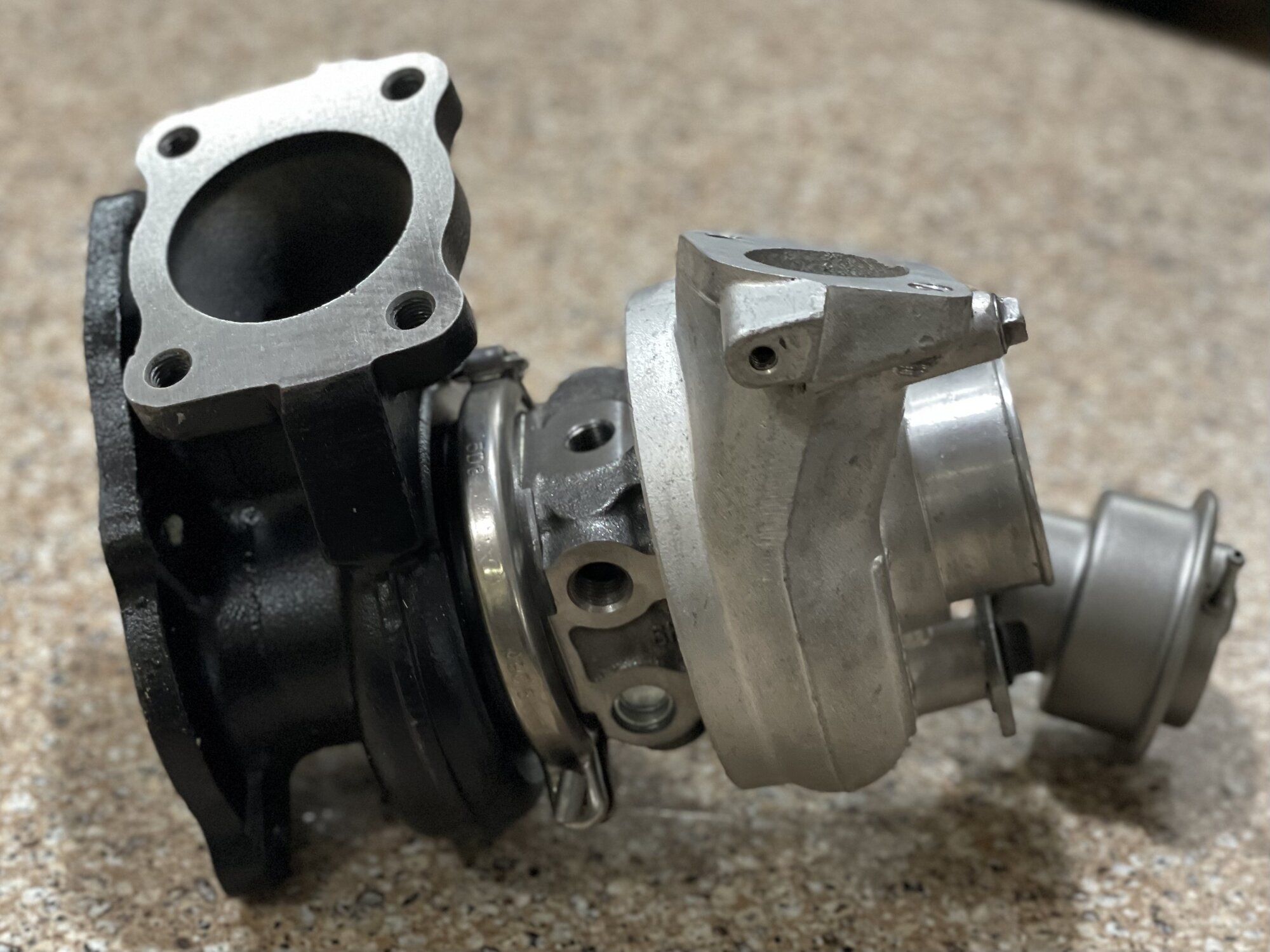

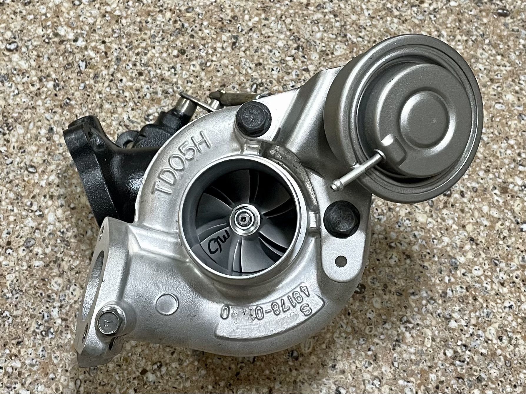

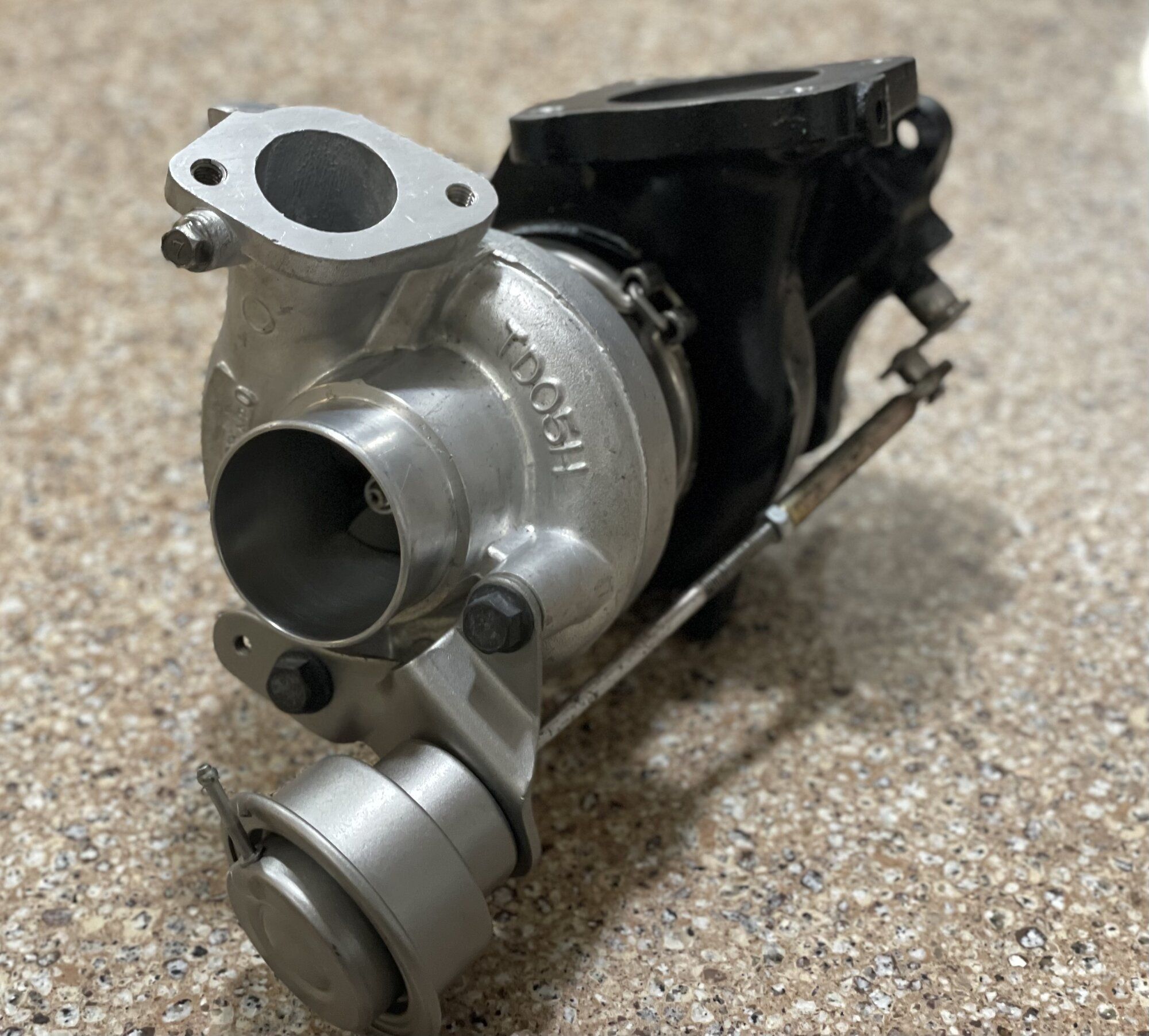

Collecting parts slowly and surely. Getting a radiator and fan in here soon, and look at this pretty little piece that showed up today :p
Onto work on it this weekend! Its truly been too long…
Gorgeous. And those eBay turbine housings flow so good, especially when you port the wastegate hole(which I assume he did). Should be a fun street car!
