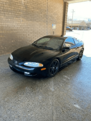

An Eagle Talon TSi AWD coupe with a beige interior and a slick-top. She's almost a 1 of a kind. (No, I'm not selling any of the interior)

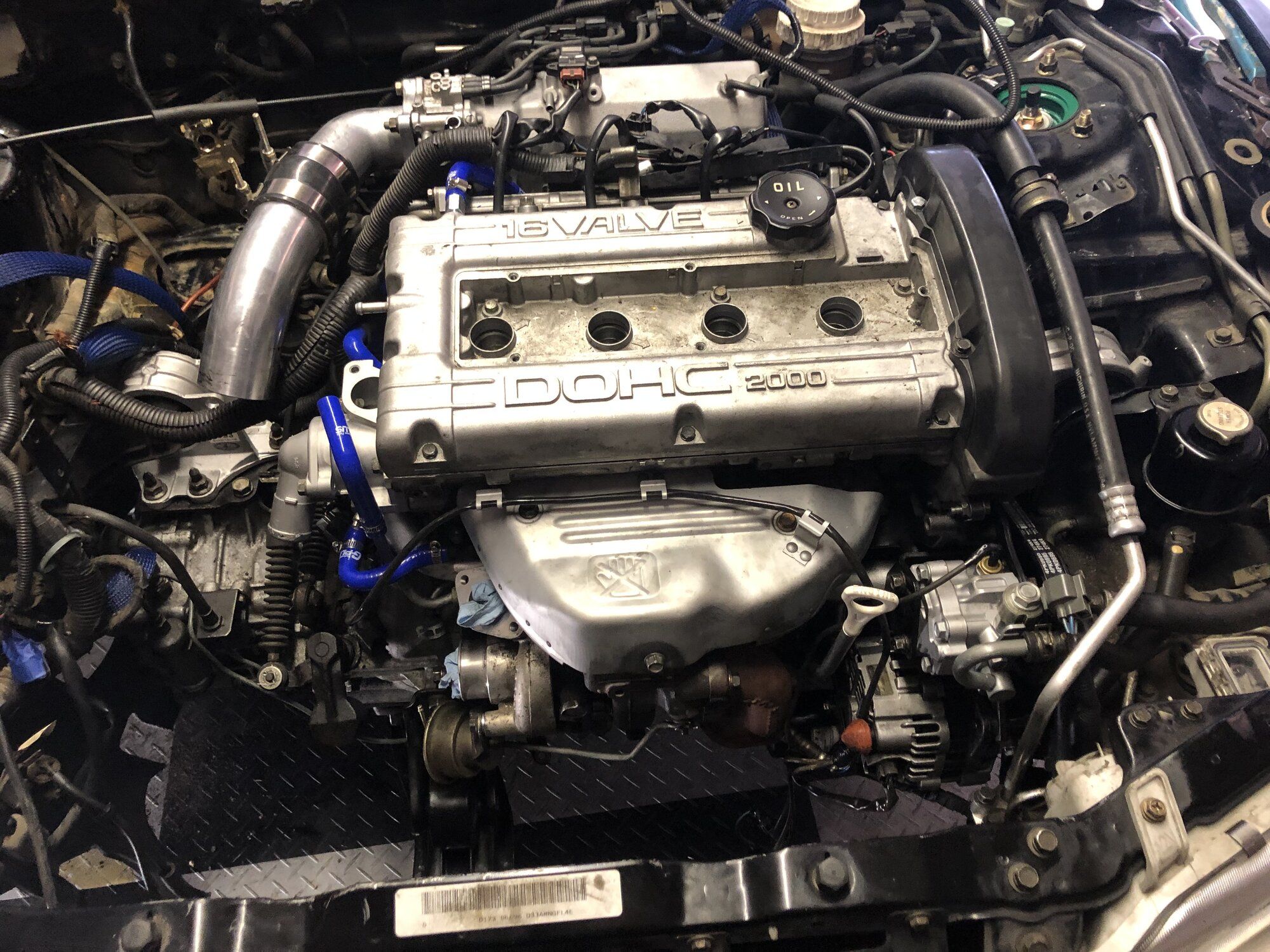

Once I got home from college me and my dad started work on the car. We put the engine in and that was a long day's work.

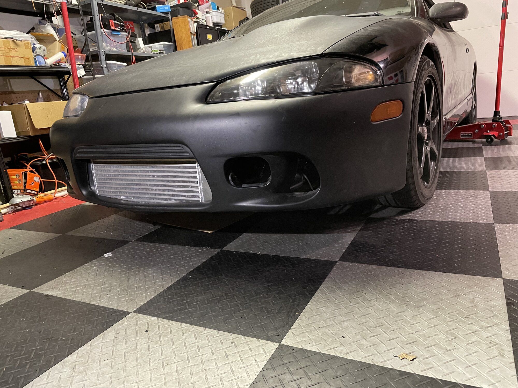

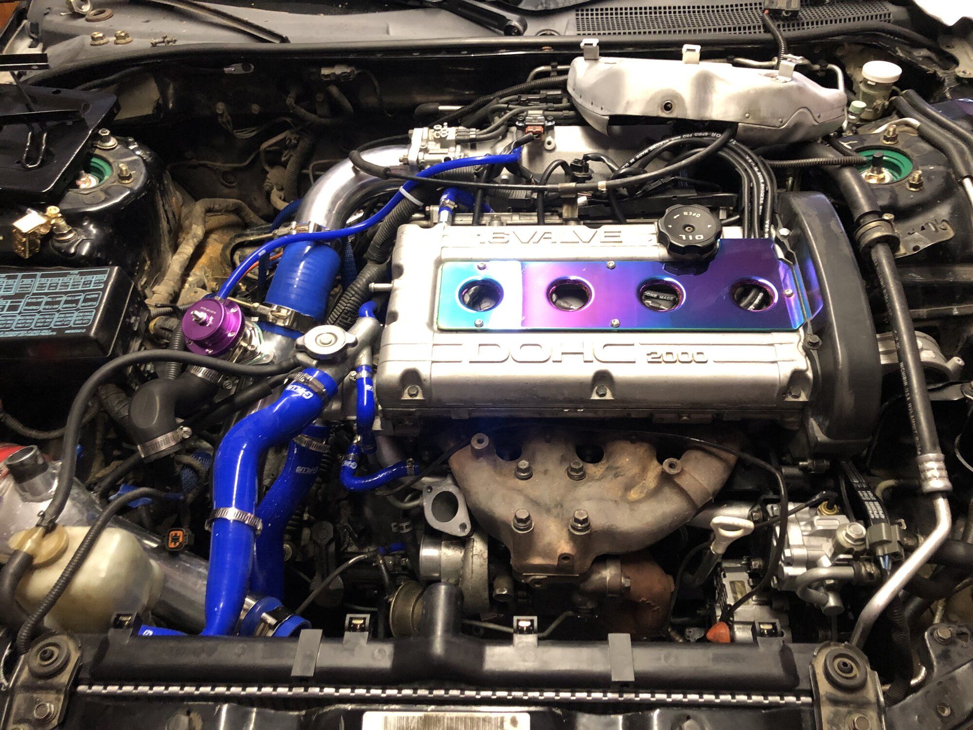

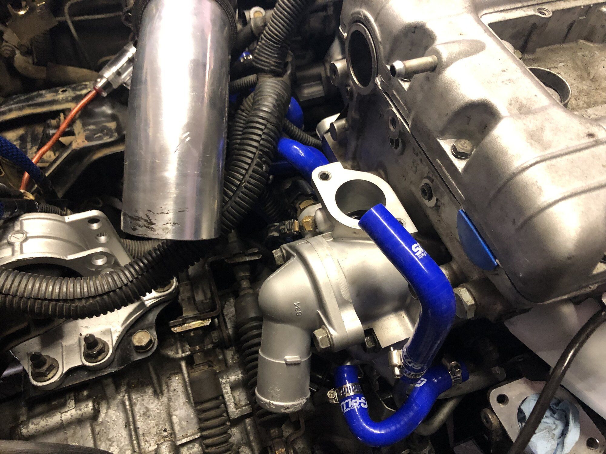

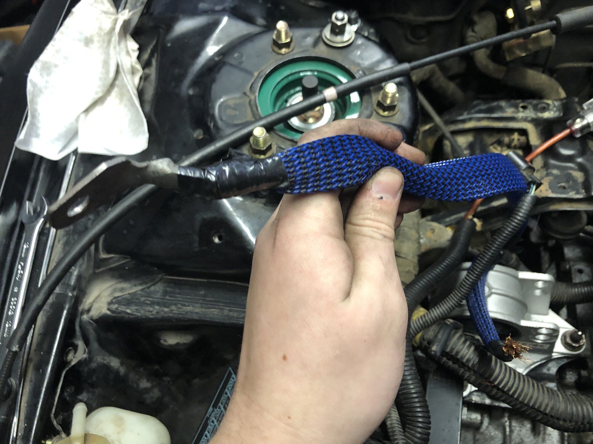

The engine is back in the car with the transmission and transfer case/driveline attached as well. Lots of hoses are attached back where they are supposed to be and I even bought a blue hose kit to replace the 25+ year old hoses in the car. I also got some wire sheathing to clean up the admittedly crappy looking electrical wires. Currently, the Talon is pretty close to being roadworthy again, these are the things that I have left to do
3" downpipe and test pipe fitment issues

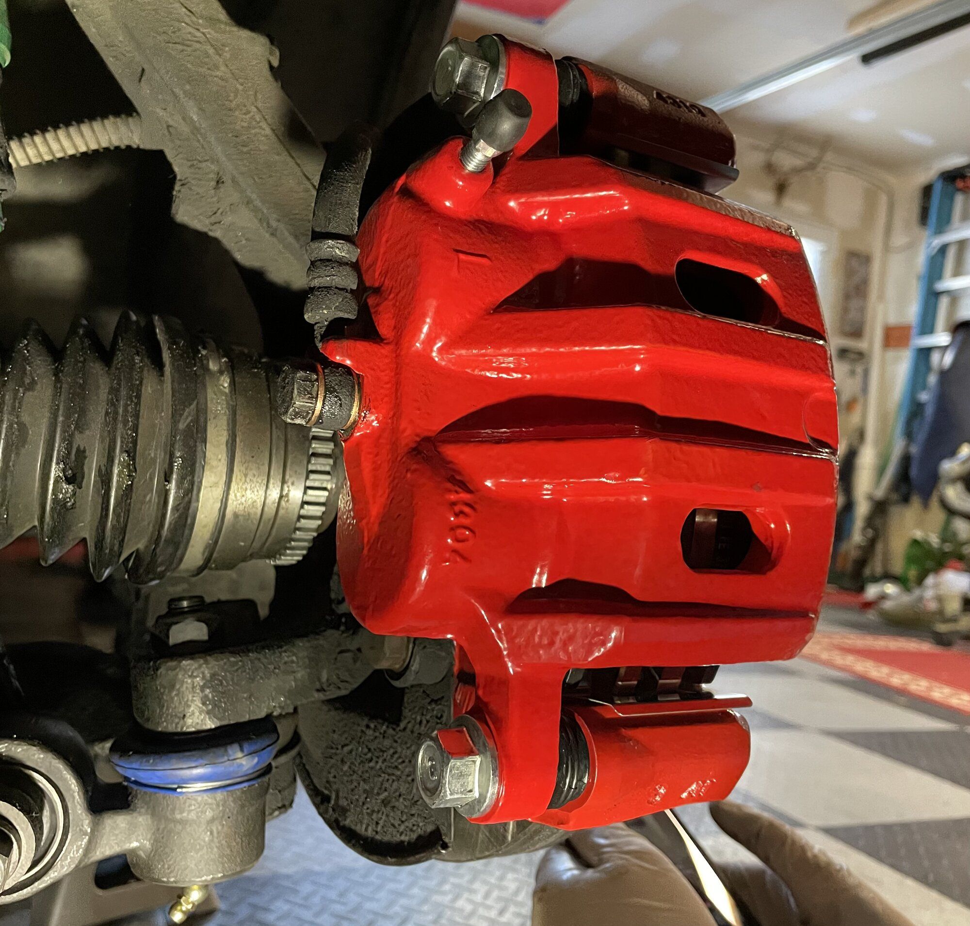

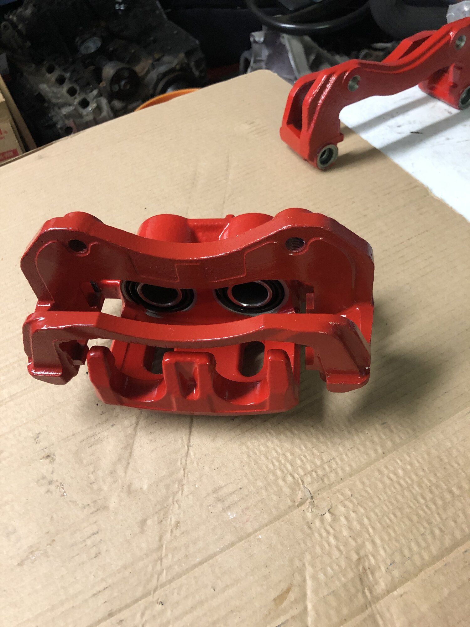

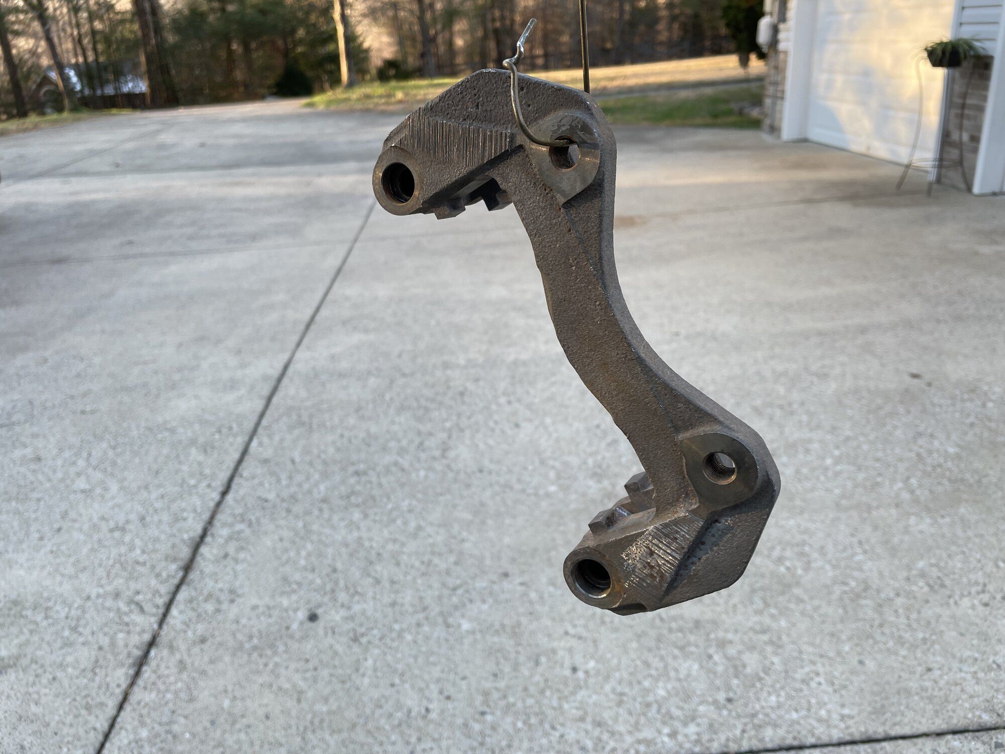

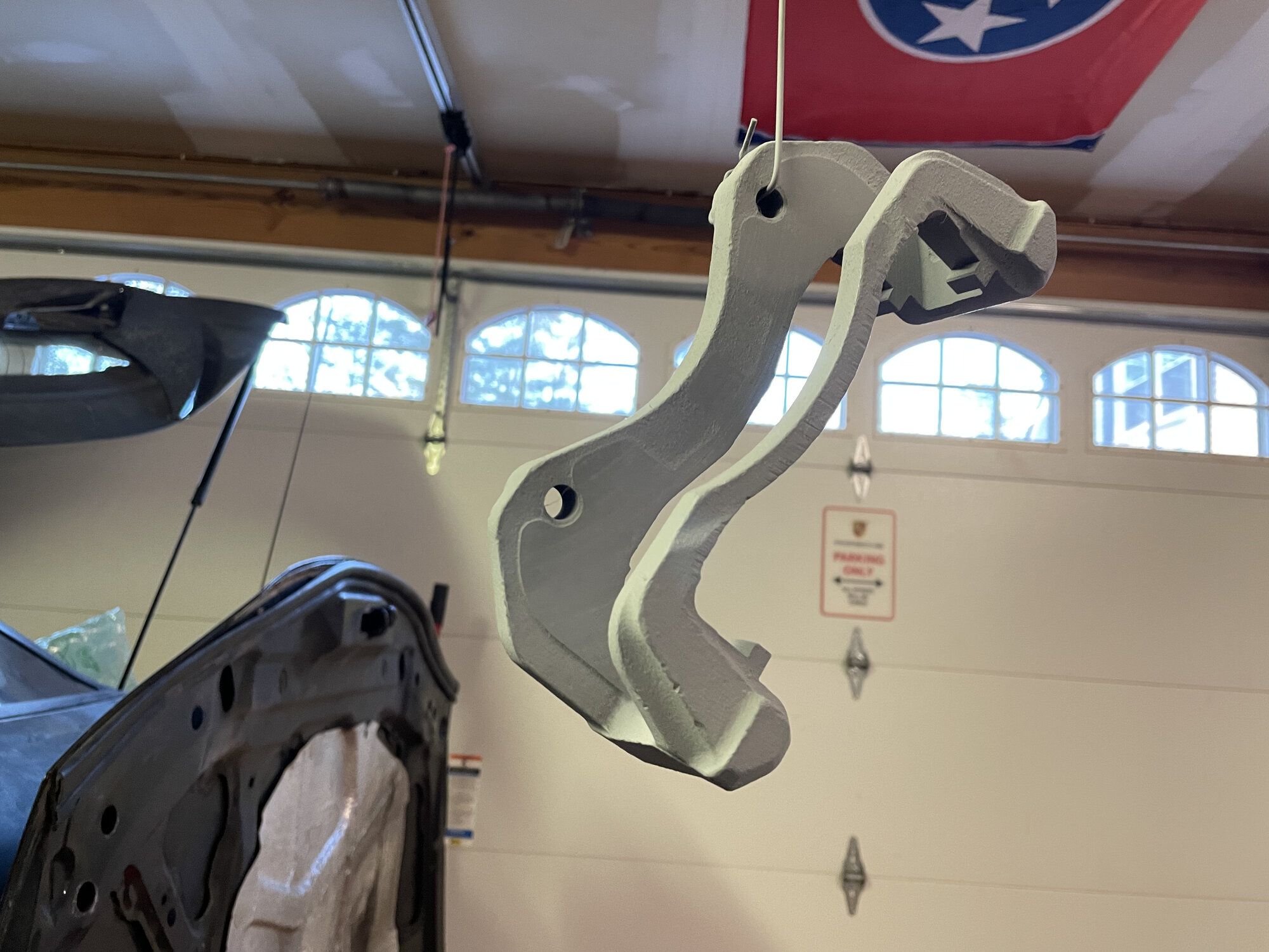

paint my outlander caliper brackets to make them look like they didn't come off of a junked car
replace the pads, front rotors and calipers

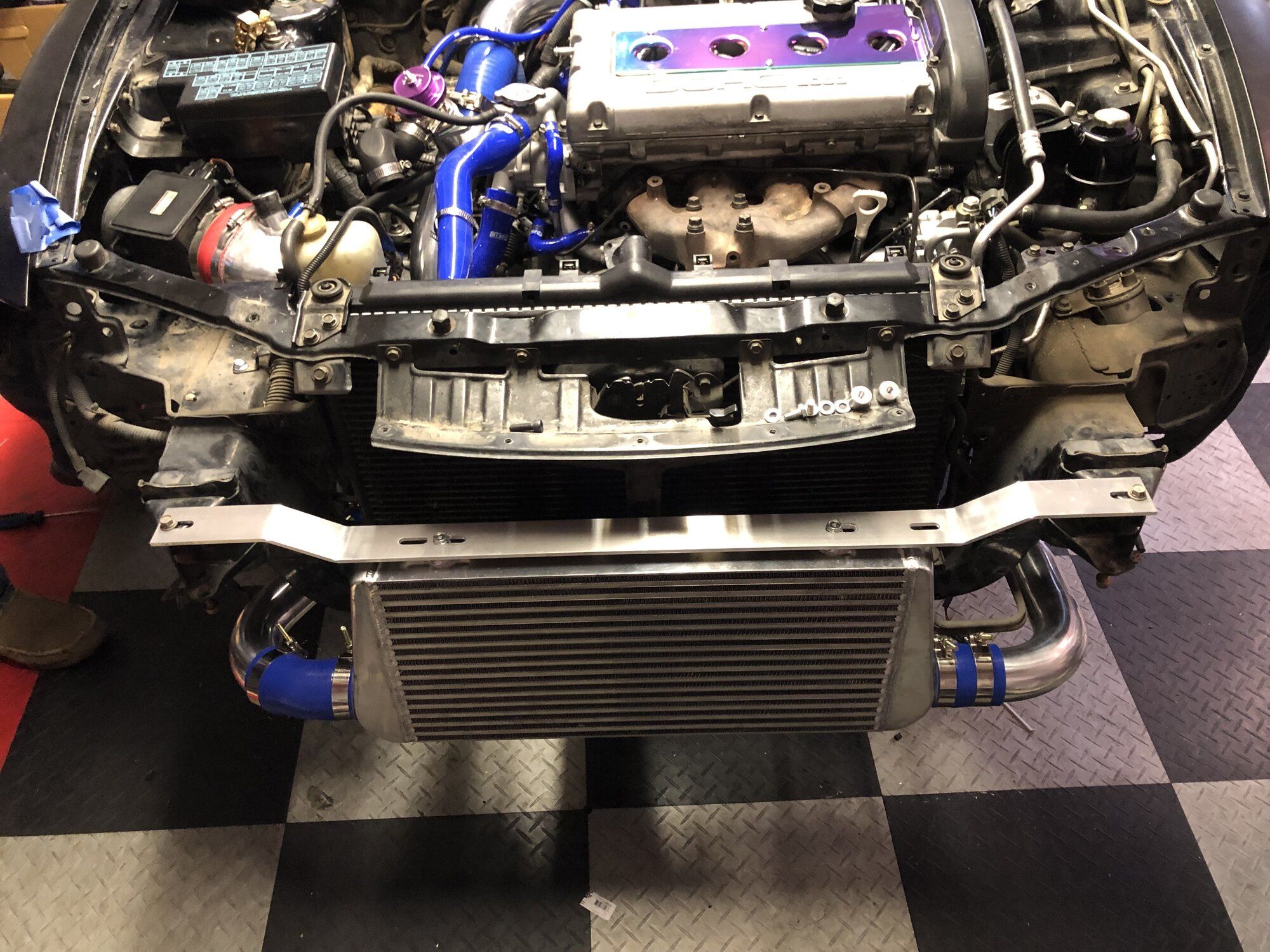

finish the FMIC piping for the 14b
re-attach the cold air intake
mount the radiator and fans back on
wire the coil pack to reflect the 97 ECU in my car
fill the car with pretty much every fluid aside from windshield washer fluid
re-attach my 95 bumper until I have all the goodies to put on the 97 bumper

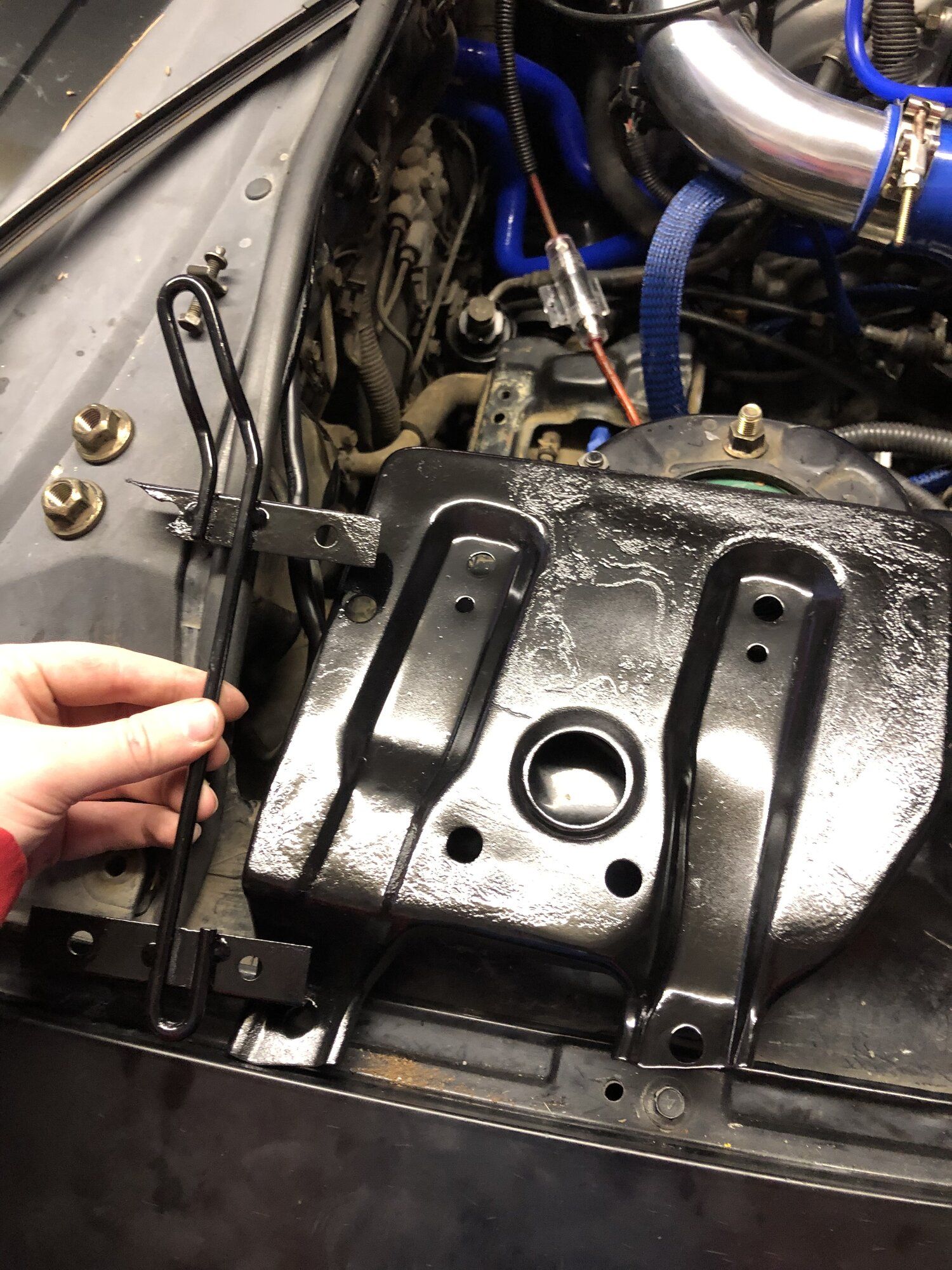

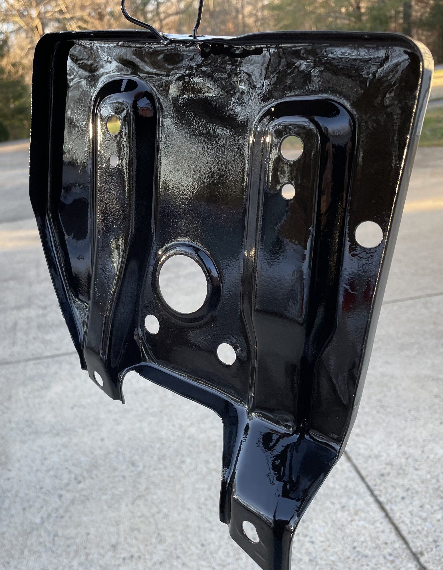

de-rust and re-attach my battery tray
quintuple check and pray that I have all lines and plugs connected and in the right spots
cycle through the break in oil and hope for no leaks
It's been quite the journey with this car, and I'm pretty excited to get it back on the road after months of sitting! Life and school happened so it was hard to get a lot of work done on it at all, but finally its all coming together. Enjoy these pictures:

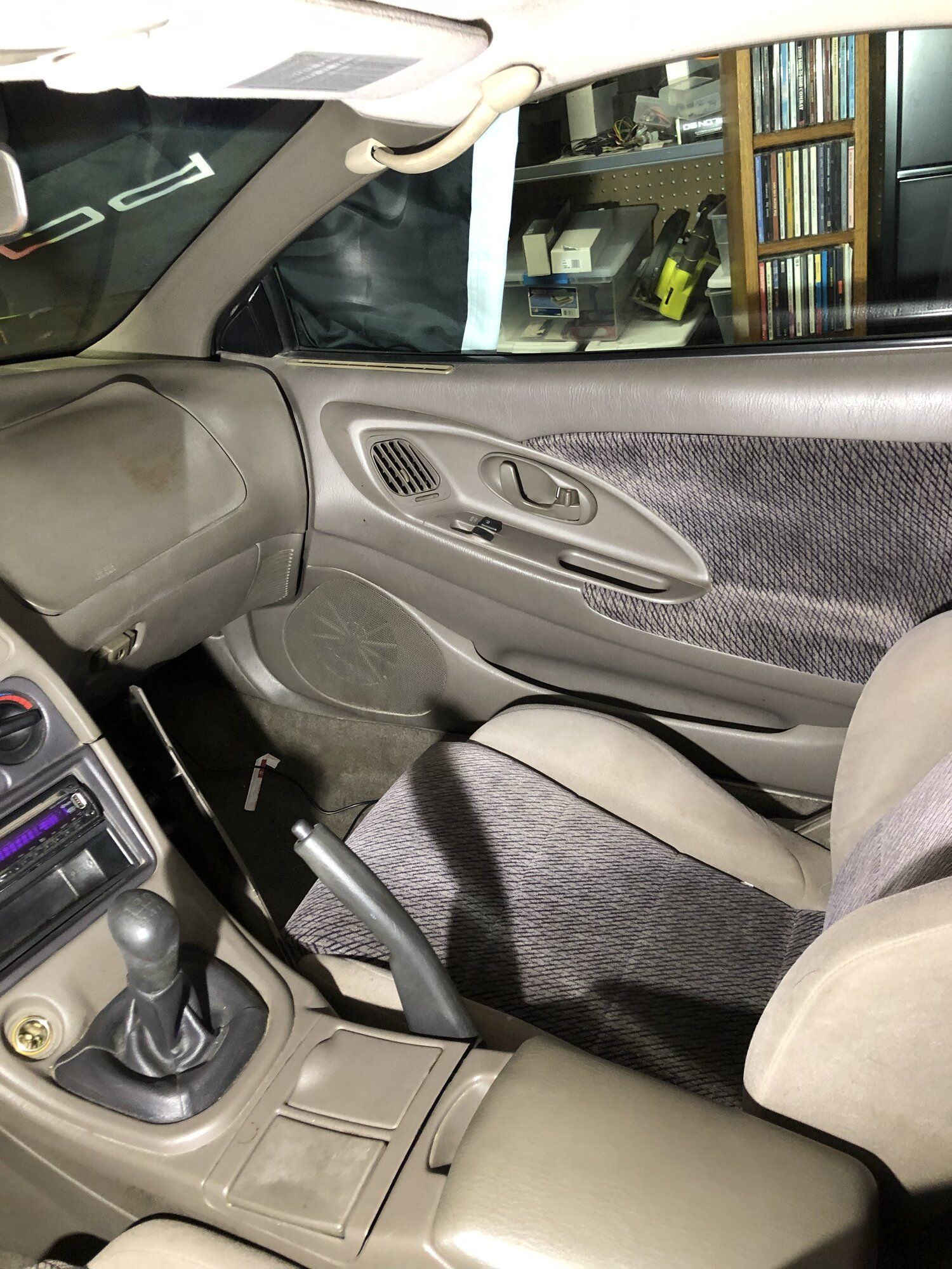

(Also to those of you who want more interior pics, I'll be sending those sometime soon)
I was this close to finishing the car. All that was left on it were some small things like exhaust, downpipe, and FMIC fitment. However, one of the bolts that attached the J-pipe to the 14b wasn't going in straight, and stripped the hole. That isnt a huge deal really, but after an attempt to fix it with a helicoil it made the problem a lot worse. Luckily, there was an extra 14b cold side nearby and I also got my 2gb headlights. Wasted precious time though, so it'll be a while before I get to work on it again since I start my next semester of college. Those interior pics I promised aren't delayed though, as I can go grab some today for all you Pulsar Beige people out there :thumb:

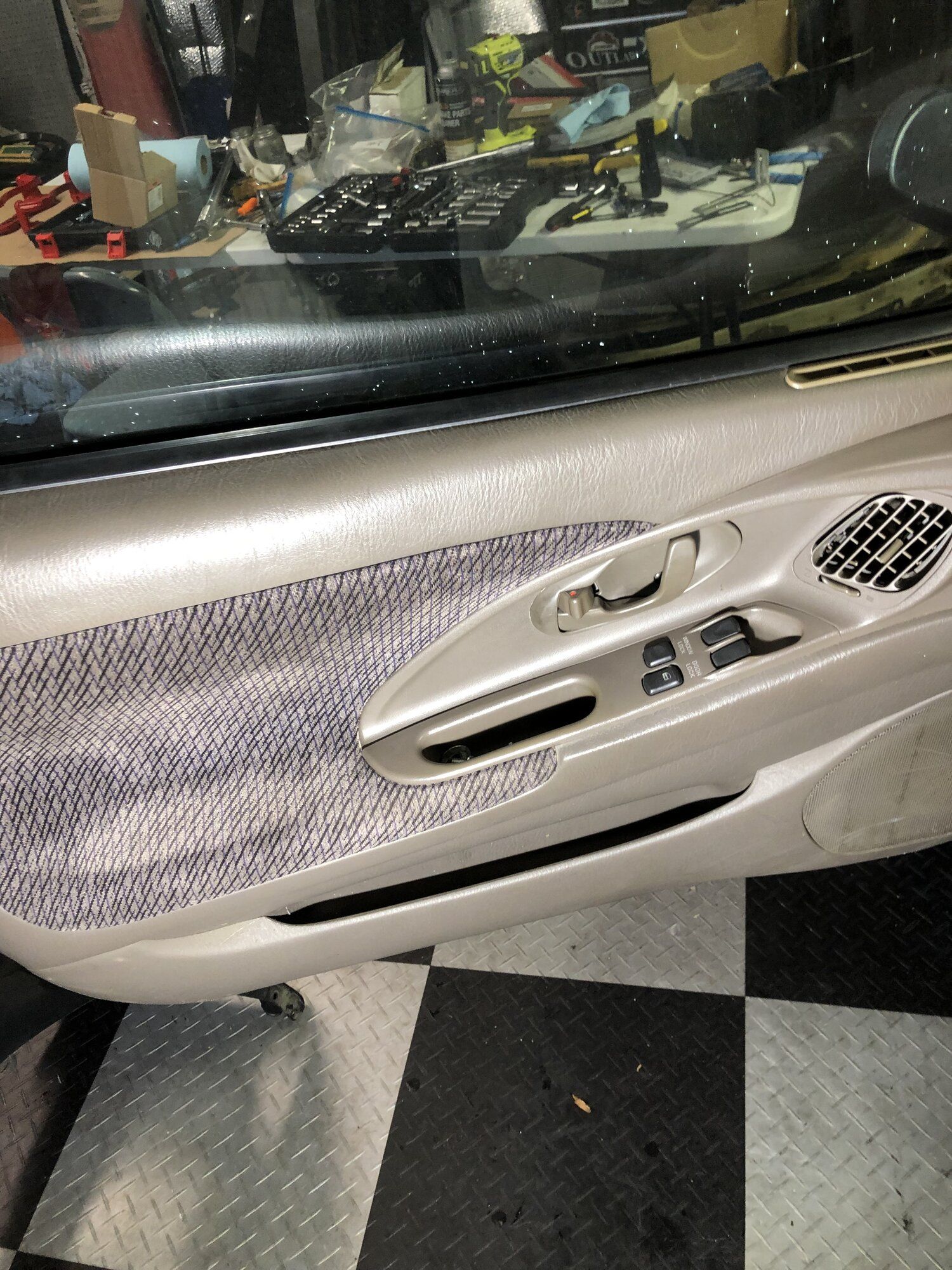

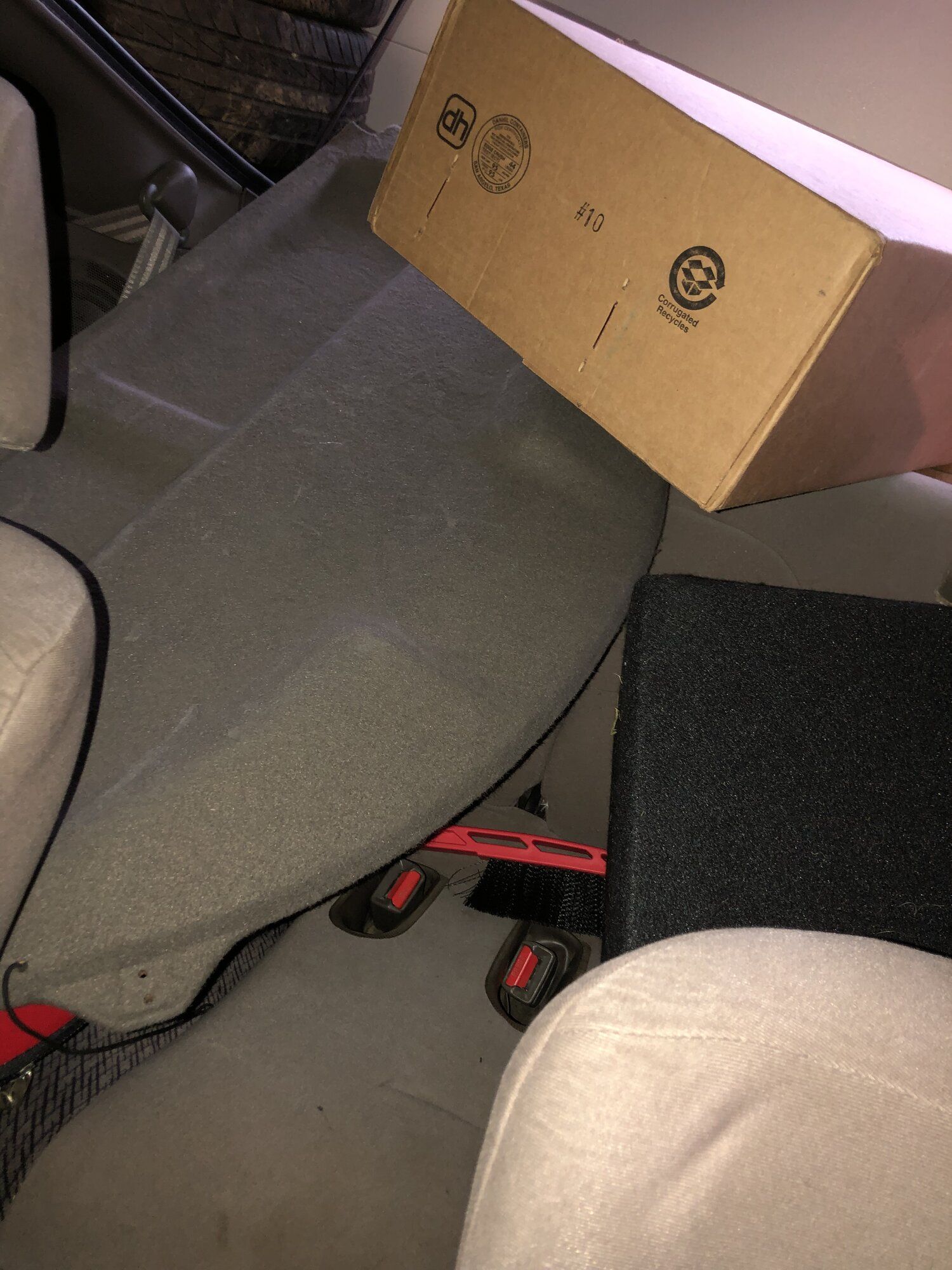

Big photodump here. The brown interior is entirely complete including the privacy cover, and you can even see my sub box in one picture.

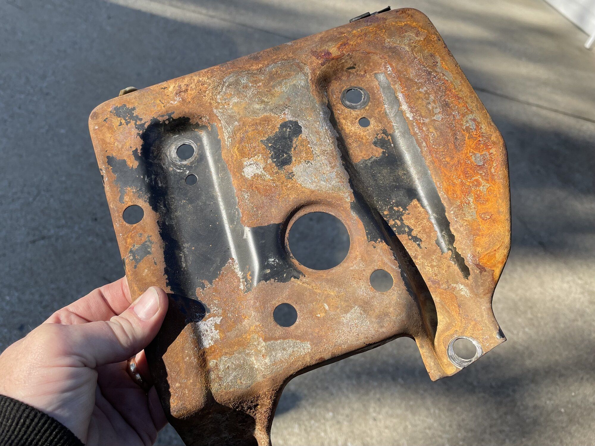

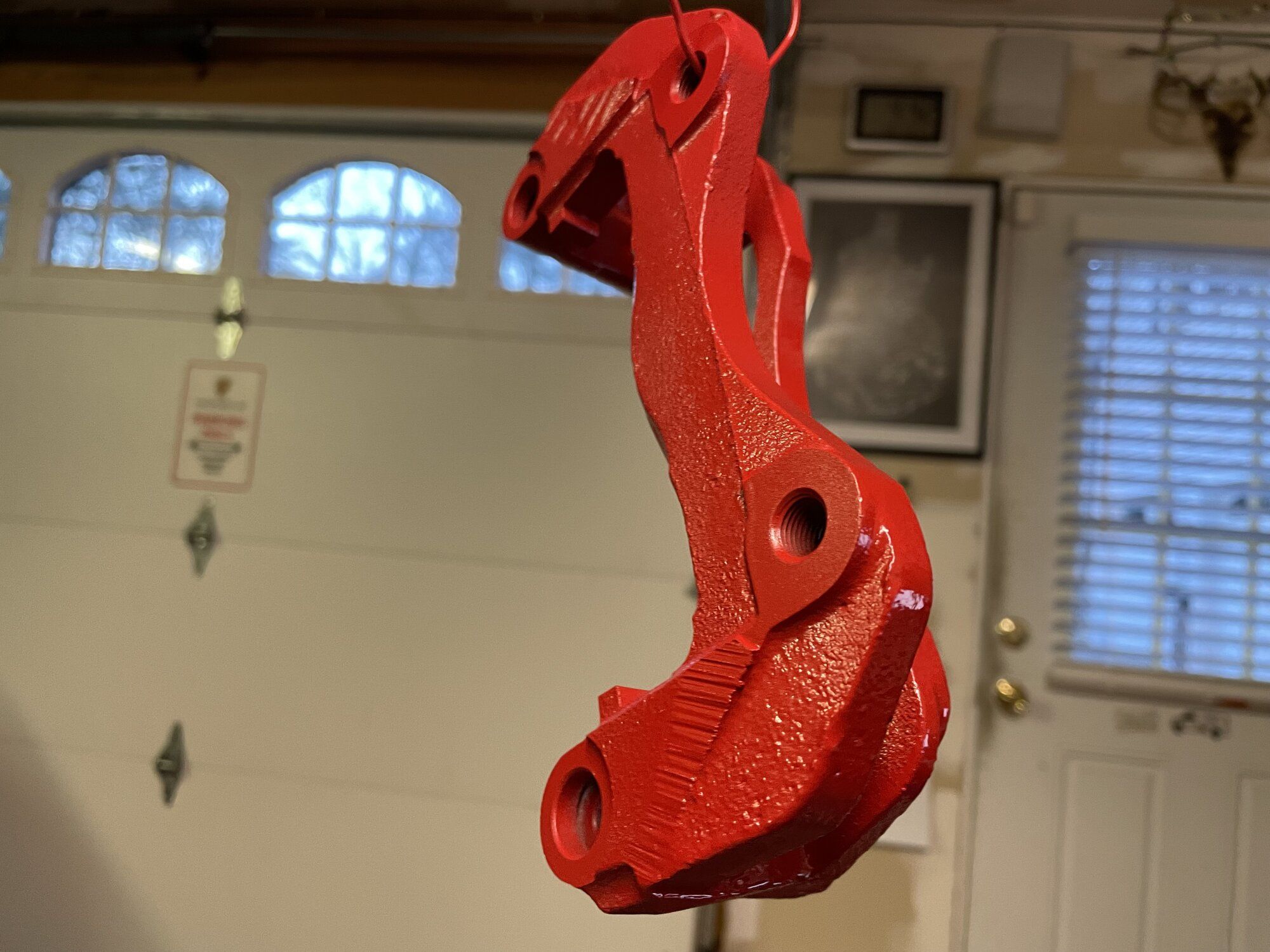

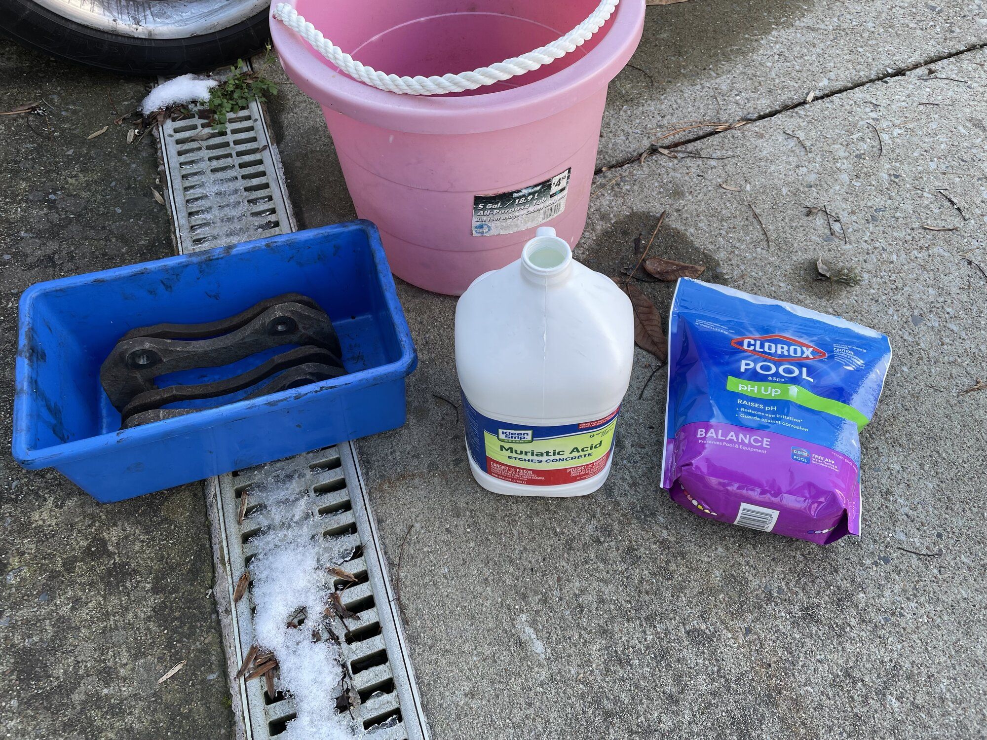

Dipped some of the rust parts in muriatic acid and cleaned them up to paint. I love the results.

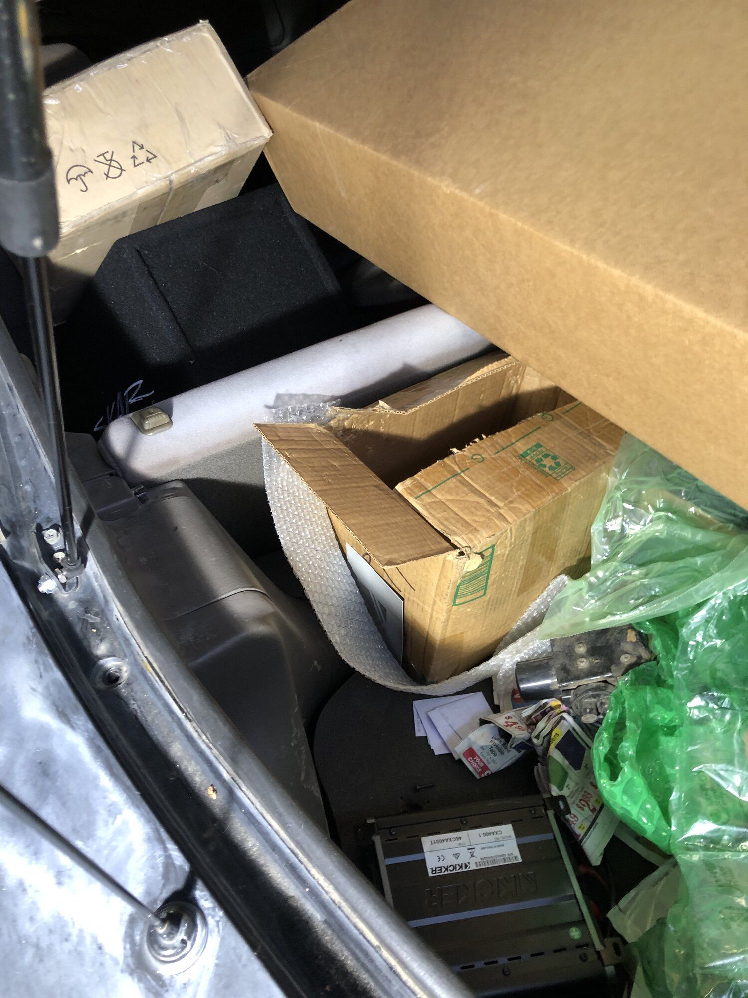

(Sorry about the trunk pics, its a storage unit currently :D)

What a journey this car has been! I pulled my first engine from this car, and even put the engine back in as well. Connected everything back up and even pulled the turbo at one point to replace the cold side due to a stripped bolt housing.

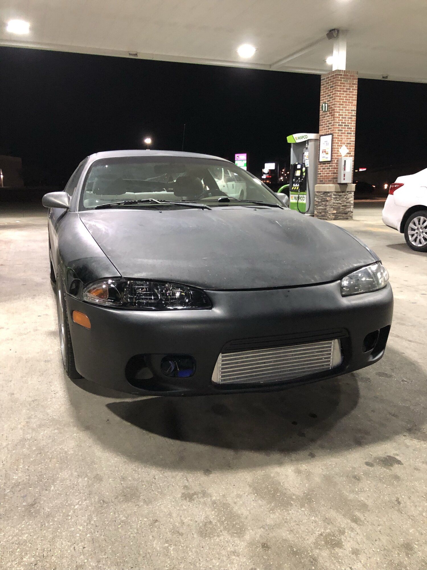

AHHHHH its all coming together! Got it to an exhaust shop today and here is how it sounds (and looks)
Edit: Aside from some throttle adjustment and power steering issues, this car is completely drivable, and I might get some new professional pictures taken of it this Sunday
Nice job on the calipers! Almost looks as good as what I do :p:D

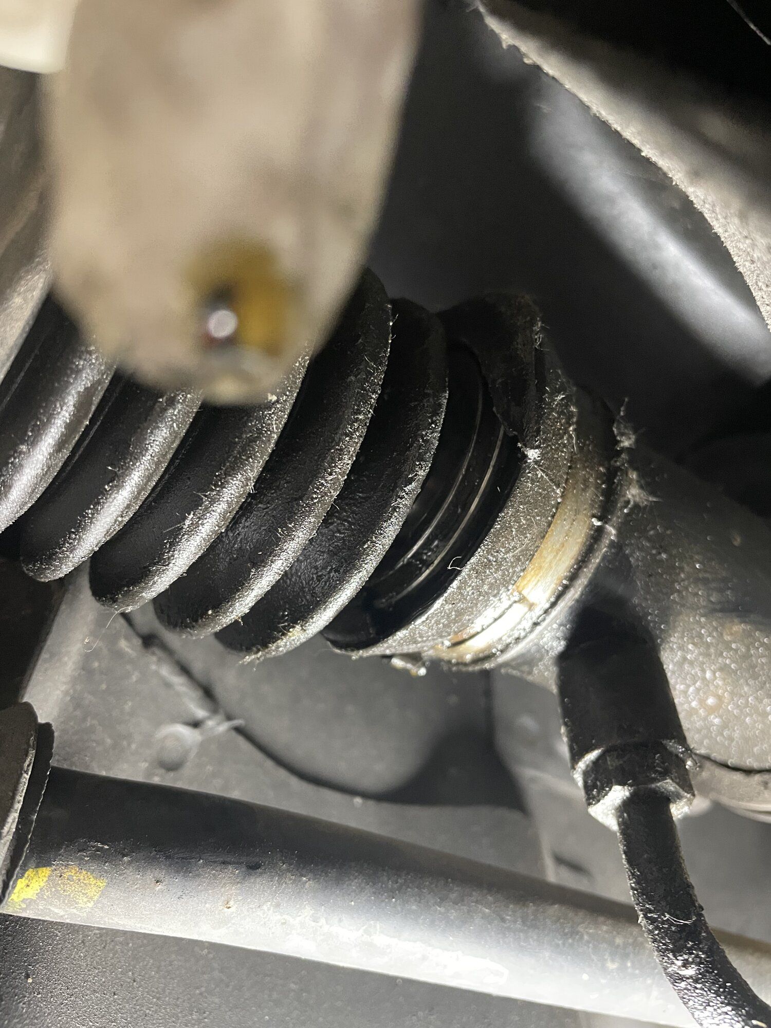

A substantial leak just started coming from what looks like the T-case or transmission. Wasn't able to drive the car back to Alabama again, so it's chillin in TN waiting for me and my dad to look at it this weekend. #DSMlife, amirite?

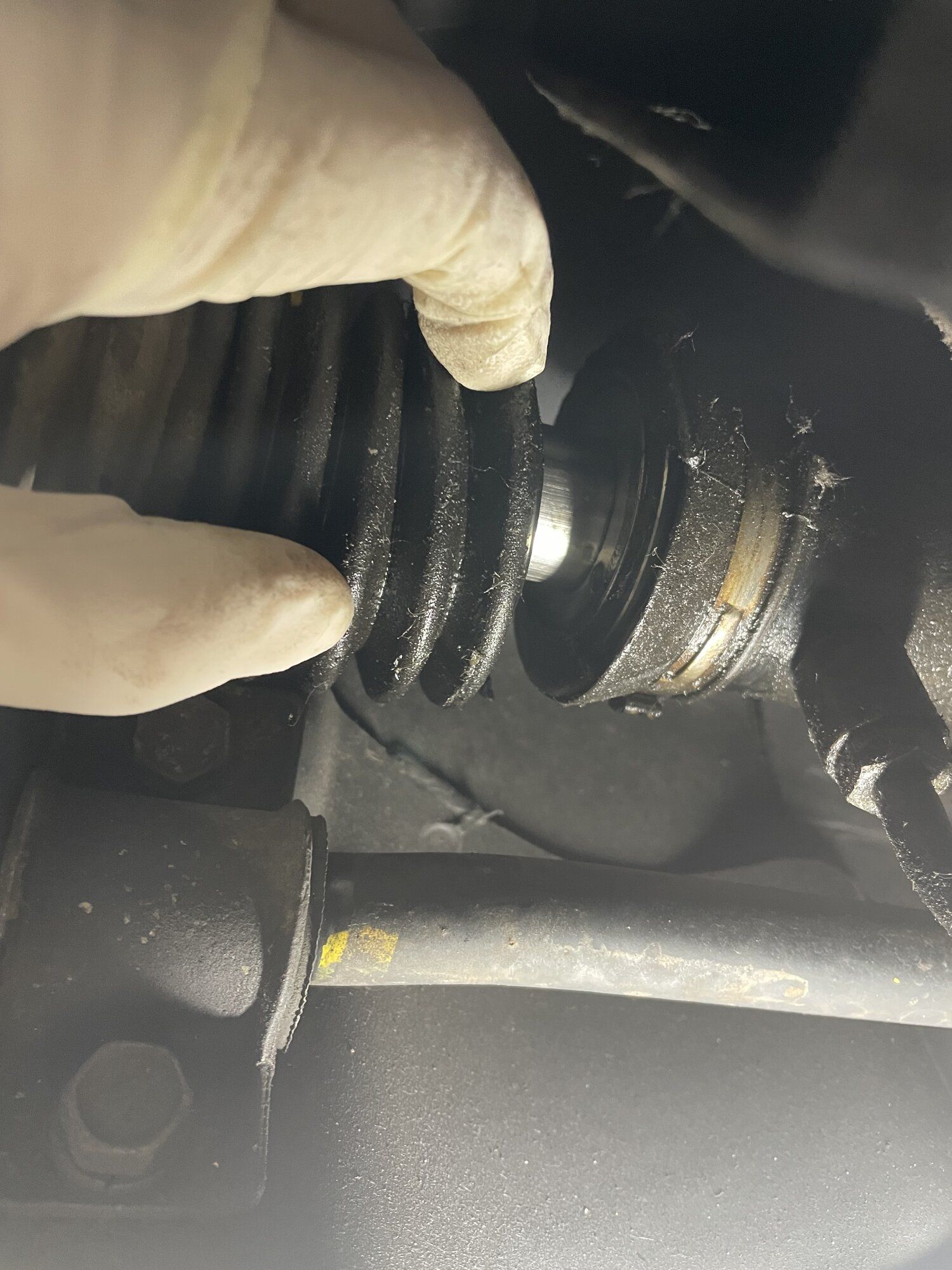

Well, luckily I was able to get further under the car this weekend.
Turns out the leak wasn't from a leaky transmission or t-case, but actually just a mangled rack and pinion.
While the price tag of one of those new still hurts a bit, its much better than the headaches that come with a problem related to the trans or t-case.
Oh, and I got new lugnuts for my wheels, which is likely how the rack broke in the first place... Very nice
I'm not sure if the rack is the same for FWD and AWD models, but after my core return I was only less than $200 deep in a rebuilt one.
