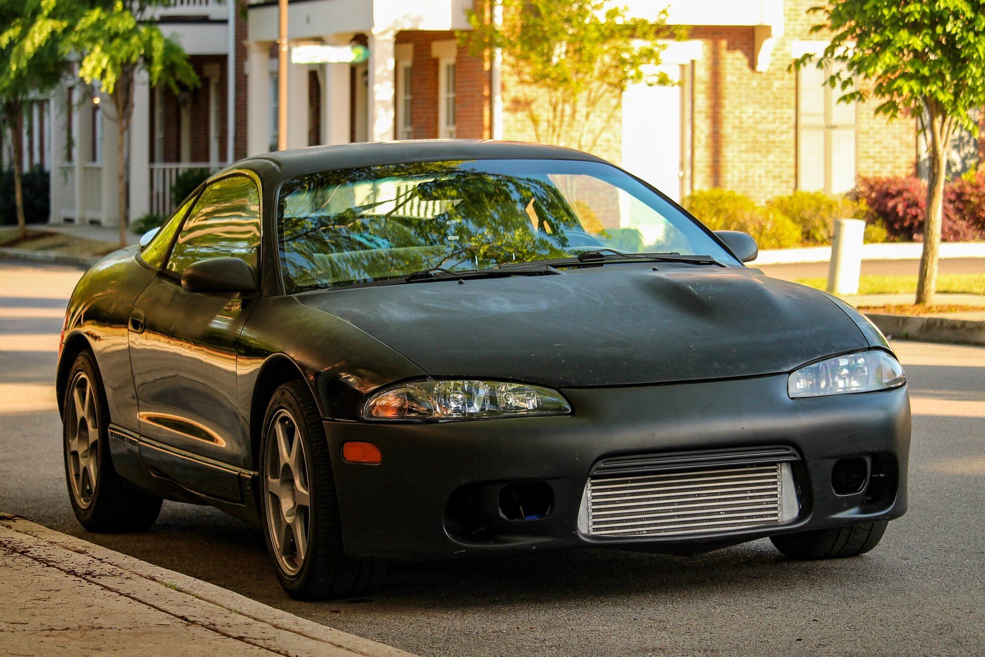

1995 Eagle Gigglebox
An Eagle Talon TSi AWD coupe with a beige interior and a slick-top. She's almost a 1 of a kind. (No, I'm not selling any of the interior)

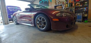

And now I keep looking at this Spyder when I drive home from my college. I haven't driven a DSM in so long that my brain has half-decided on buying another one. I need to go into the building and ask the guy what he wants for it because it appears to be in horrible shape. If its under like 1500$ I might jump on it.
