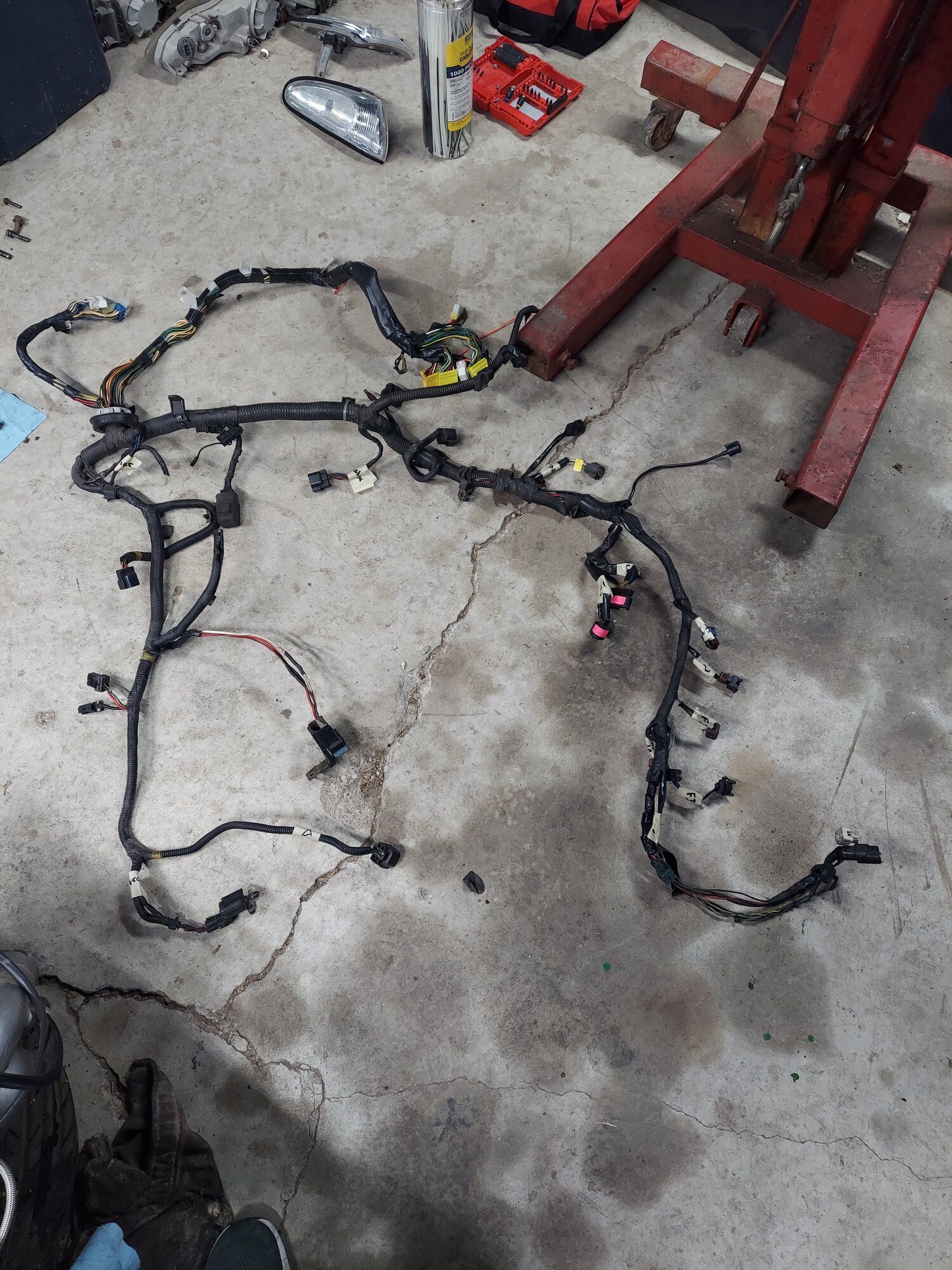

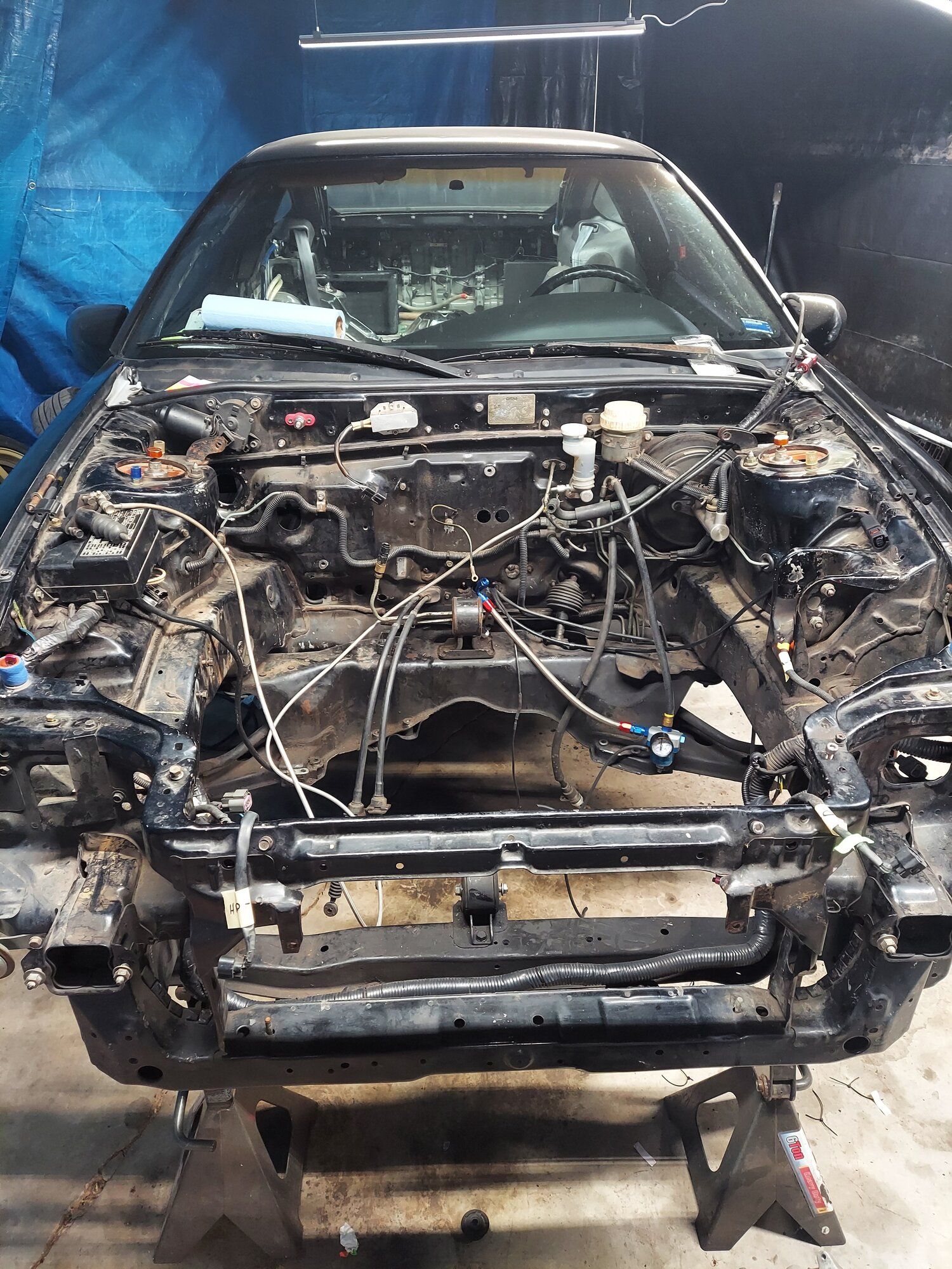

As I was following the wires around, I noticed that the wires that come through the firewall on the passenger side, lead all the way around the front then back into the driver side frame hole that looks like it leads to inside the car for the fuse block under the driver side dash. Is this correct?
If so I might bite the bullet and just re-wire everything. Because some of these plugs have to be rewired and if I have to pull the wires that are on the driver side I might as well do the whole damn car. Even though that is not what I want to do right now. What does everyone else think?
The harness on the ps splits and goes to the all the wires around the intake manifold and the fuse box. From the fuse box it runs to the front under the radiator support to the other side. Then to the drivers side, through fender and back into the drivers side fuse box. You have to remove the fuse box on the drivers side.
Awesome thank you! That helps out alot, exactly what I was trying to figure out. Tha will make things alot easier.

Well I did do a little bit today, wasn't much, haven't had alot of time between work, kids and holidays. I got something accomplished today. I retagged all of the wiring as the first tags were falling off or already did.
The bay is starting to look cleaner, really need to clean it all too. Still need to pull the driver side harness as well.

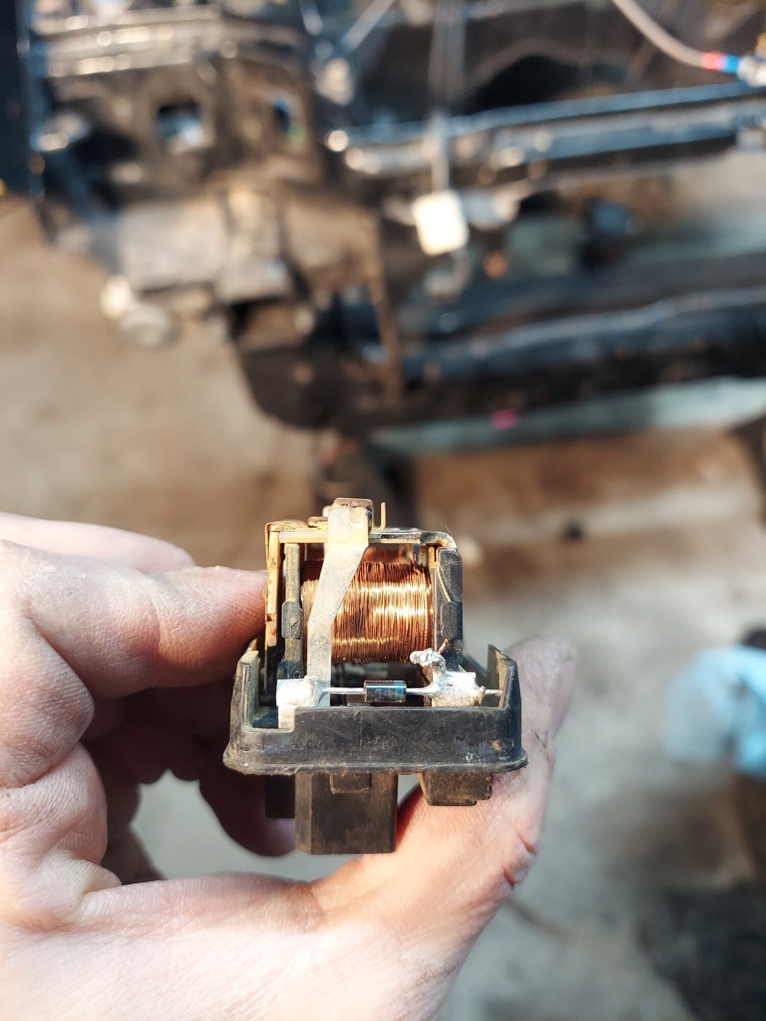

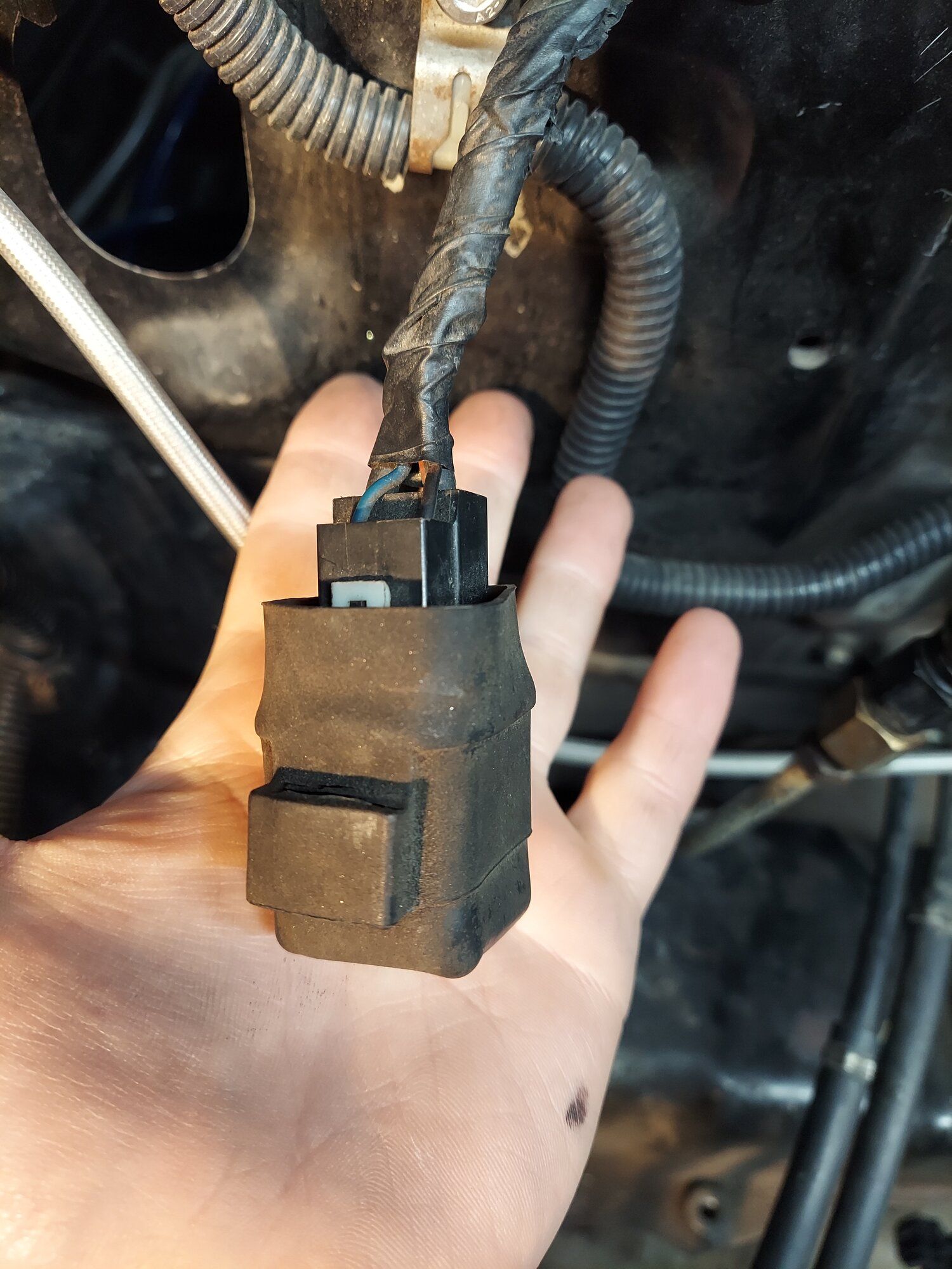

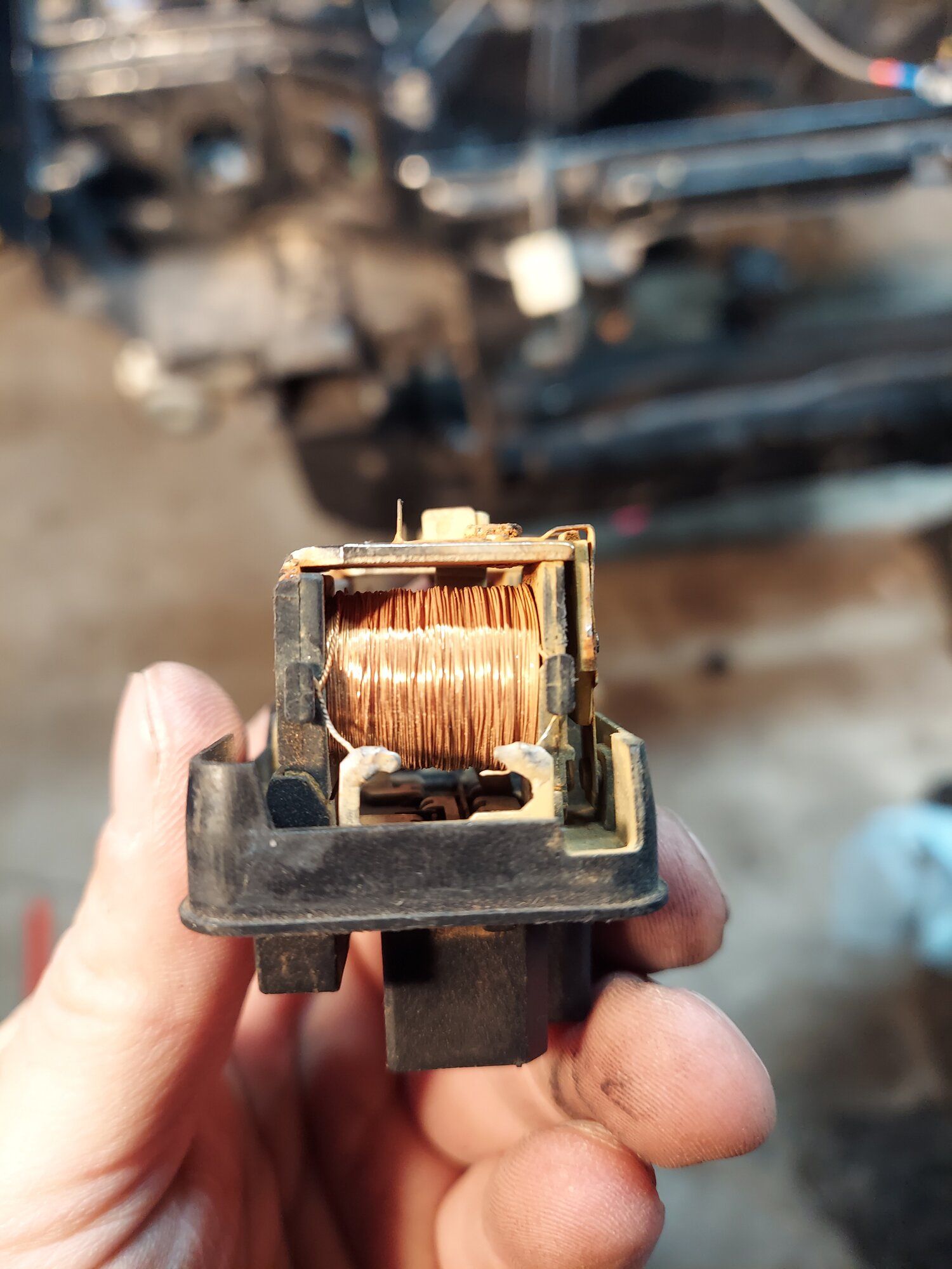

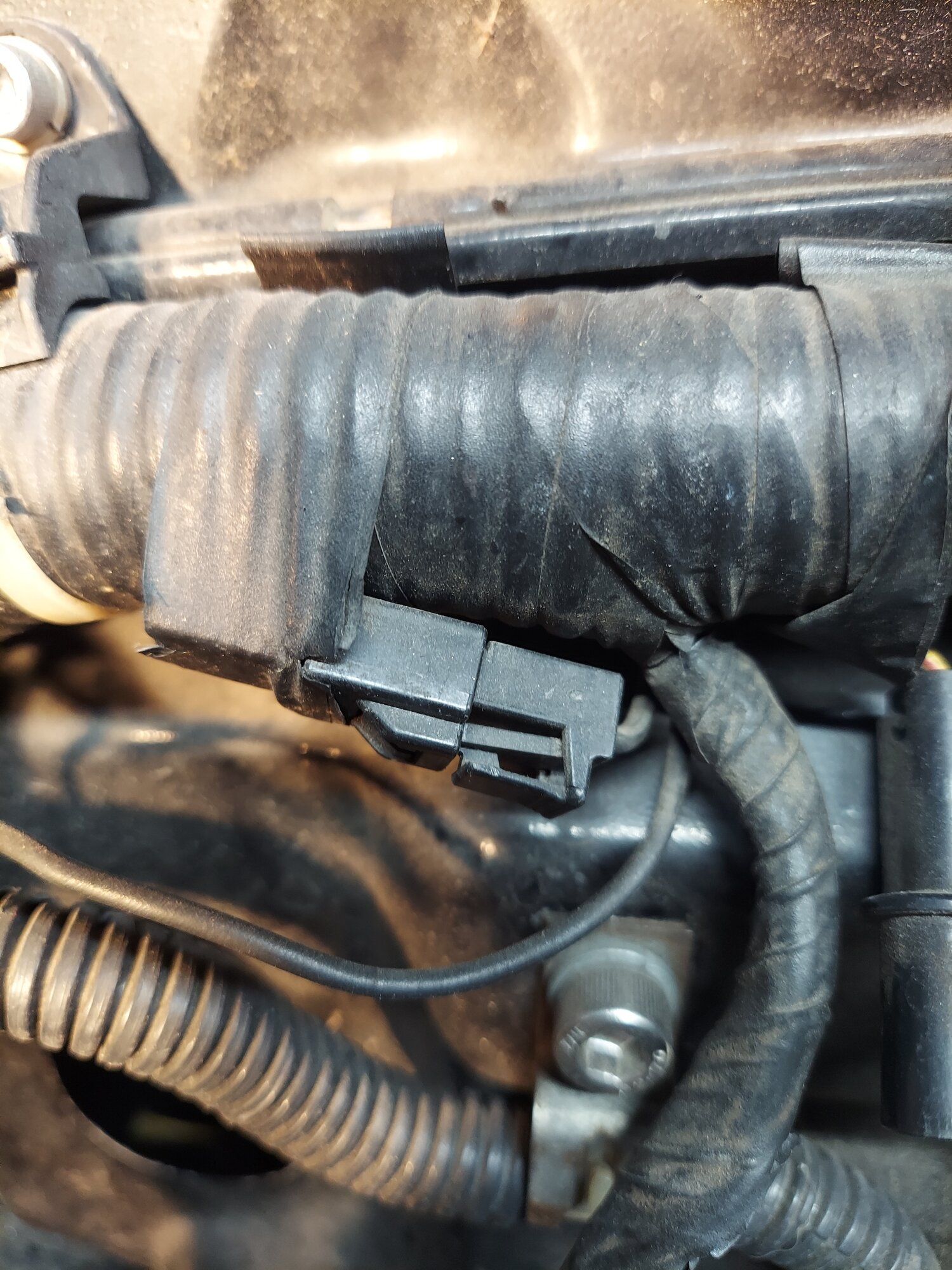

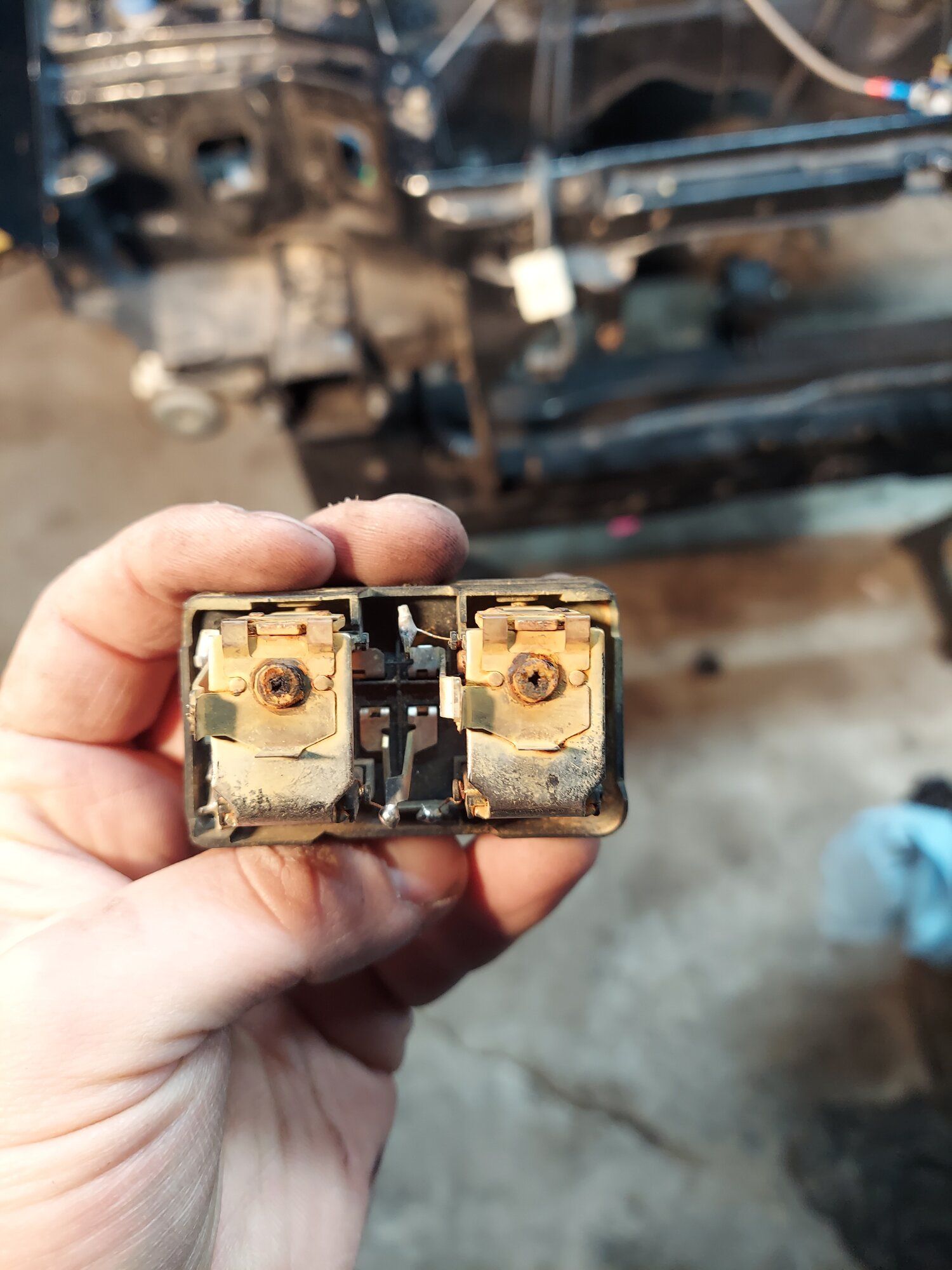

No clue on 1st pic of connectors.

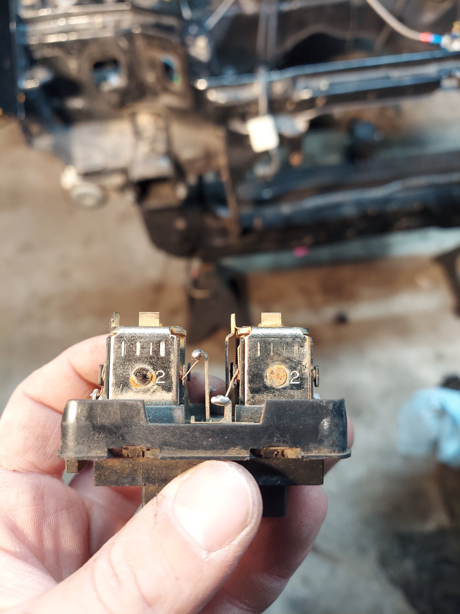

2nd - Fuel pump check I believe

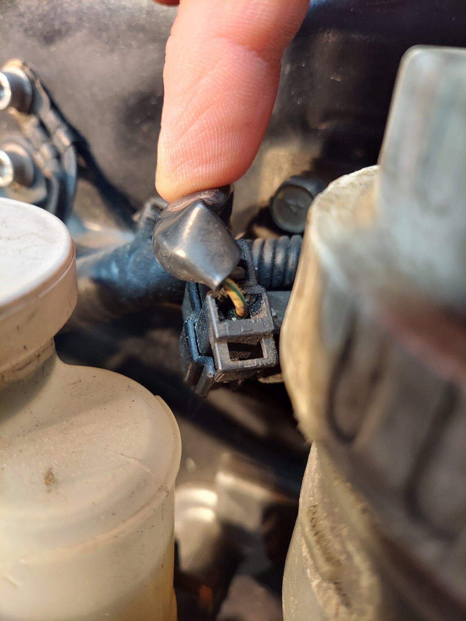

3rd - Brake Fluid reservoir low fluid switch - controls the idiot light on the cluster when you have low fluid
1st pic is for windshield wipers I believe.
Sweet, thank you guys! More that seems like I have to have, but can hide under the dash.
