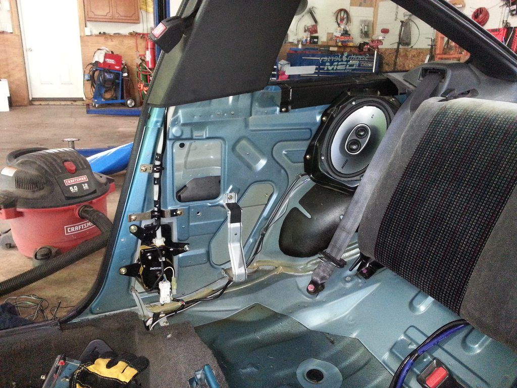

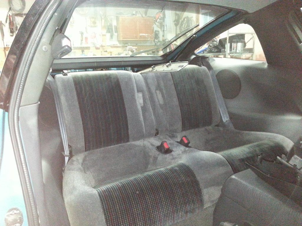

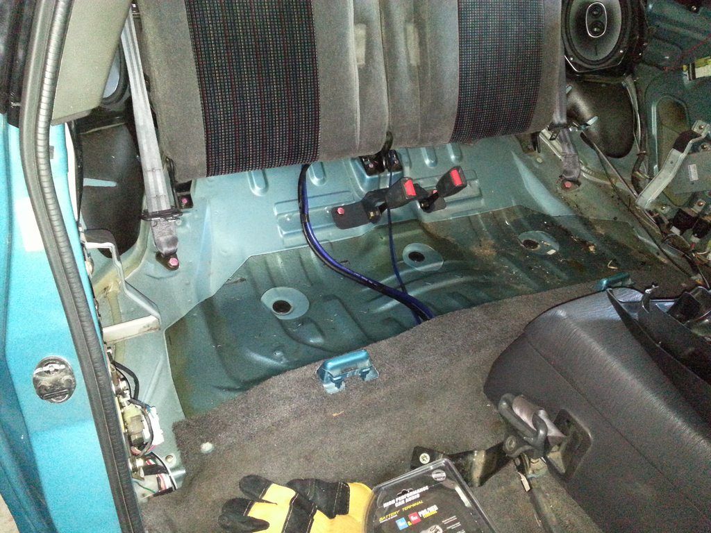

Man, I'm really enjoying my staycation for the week :) More interior fun. Vacuumed and simple greened the body under the rear seat, gotta have it all nice and clean!

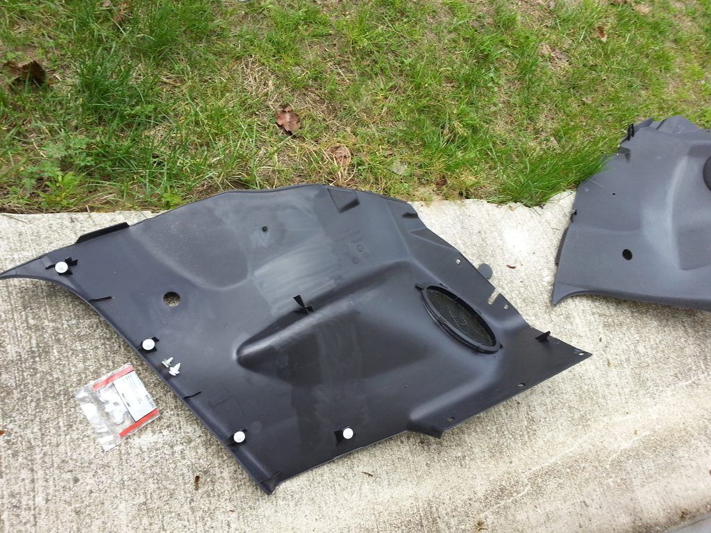

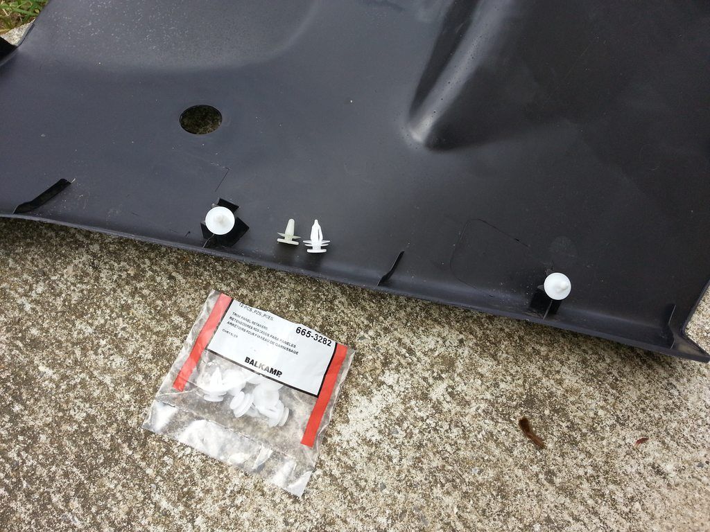

I was missing a couple of the retainers, so I picked these up from NAPA which seemed to work well:
And you can see the comparison of oem (left) vs napa. Just to keep it consistent, I swapped out all the oem's for these on the 2 big panels that cover the 6x9s:
Cleaned up all the panels and let them dry, scrubbed the rear seat bottom down, then installed them:

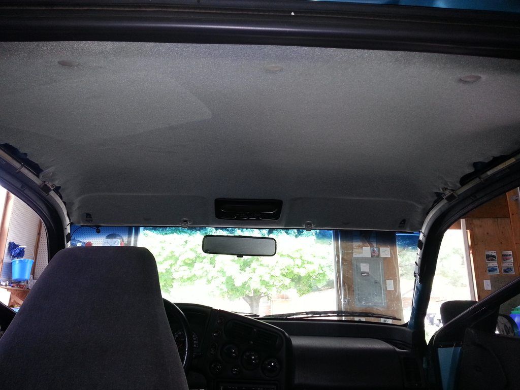

And a shot of my redone headliner that I put in last weekend:

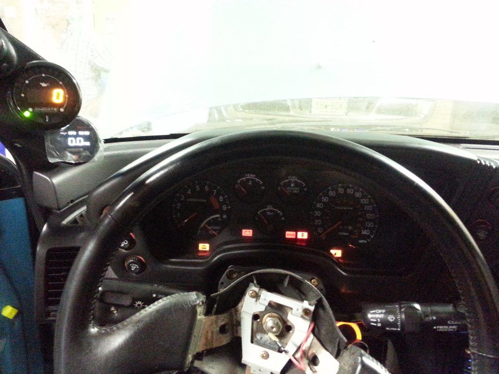

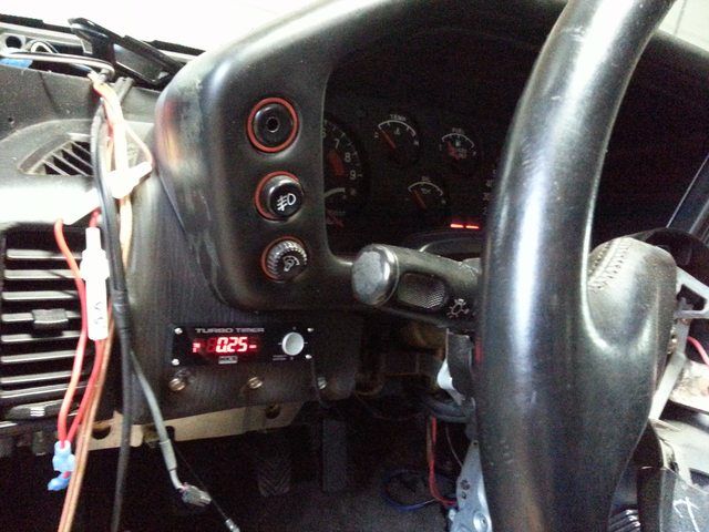

More interior fun. Ordered the HKS type-0 timer and MIT-1 connector for it from extremepsi using some of my points that I've been saving. Installed that first today, plugged in and mounted the ecu, and hooked up the jump box for testing:

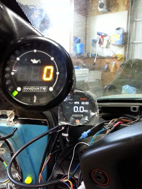

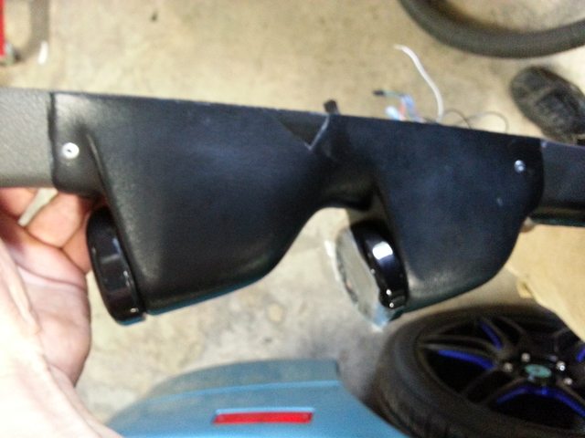

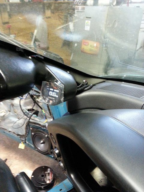

Works! Now back to A-piller final installation. I was tired of those dinky little push-pins that hold the gauge pod to the pillar, so eff it, it got riveted:
1/8" x 1/4" long rivets, worked perfectly.
Another test to make sure everything's still working:
Then I pain-stakingly pulled all the wires thru, hooked up, jammed that back over to the side, between the dash and body. I trimmed a little piece out of the dash where the wires went, and also a little bit of the speaker cover, and now have about as tight a fit as possible:

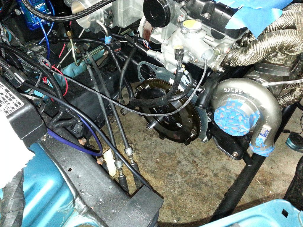

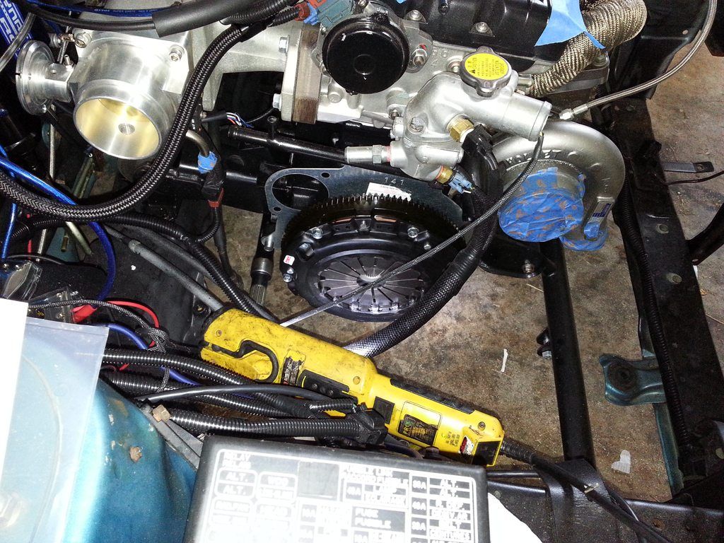

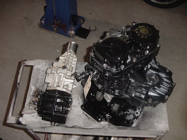

So on to a little more weekend progress, prepping for my trans/tcase arrival on Tuesday, competition clutch steel lightweight flywheel installed with ARP hardware, installed per arp's instructions to 95ft-lbs:
CompClutch stage 3 clutch installed:

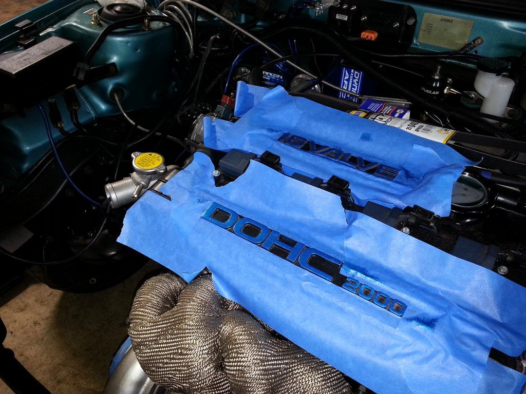

Sanded the red off the valve cover and applied a coat of bahama blue metallic, more coats to come:

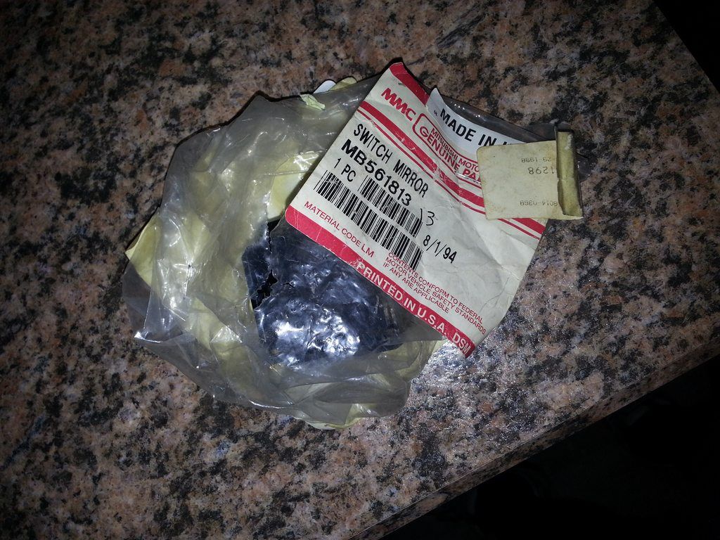

and another box of parts from JNZ, including a BRAND NEW 1g power mirror switch, on clearance in the warehouse for $21. Its new-old stock from 1994, LOL. How good is that?

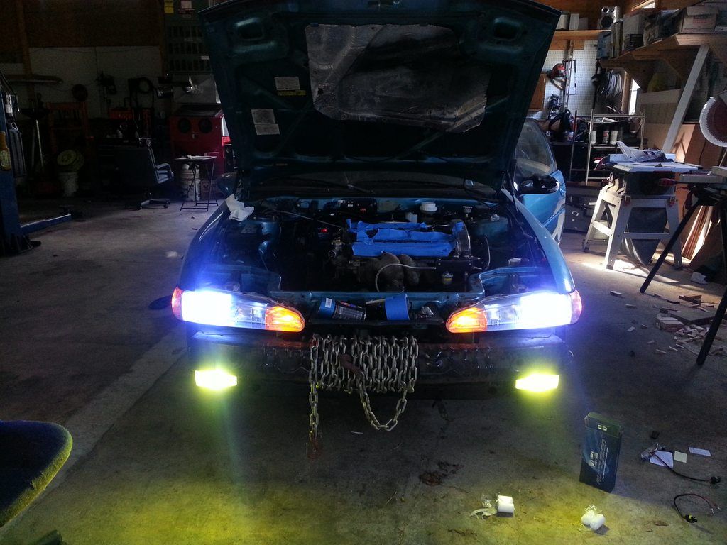

And another interesting find, my fog are the stock "cat eye" foglight housings, but for some reason there are 880 lamps in there instead of the specified H3's:
I actually like this better, so I ordered HID kits for low beam (10k blue) and fogs (3k yellow), so I have that total ricer look when it comes to looks. Just a little hint of bark to go with the cars bite :rocks:

Up until today, did a few things... Let's see... Ordered 10k blue low beam and 3k yellow fog light hid kits:

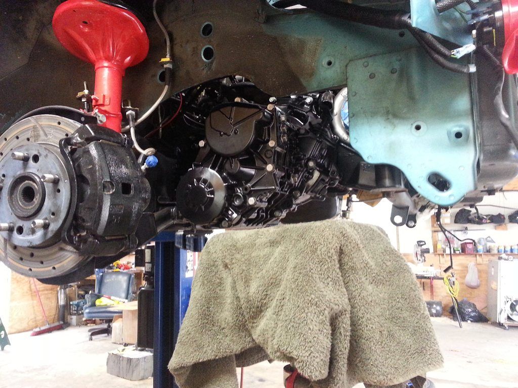

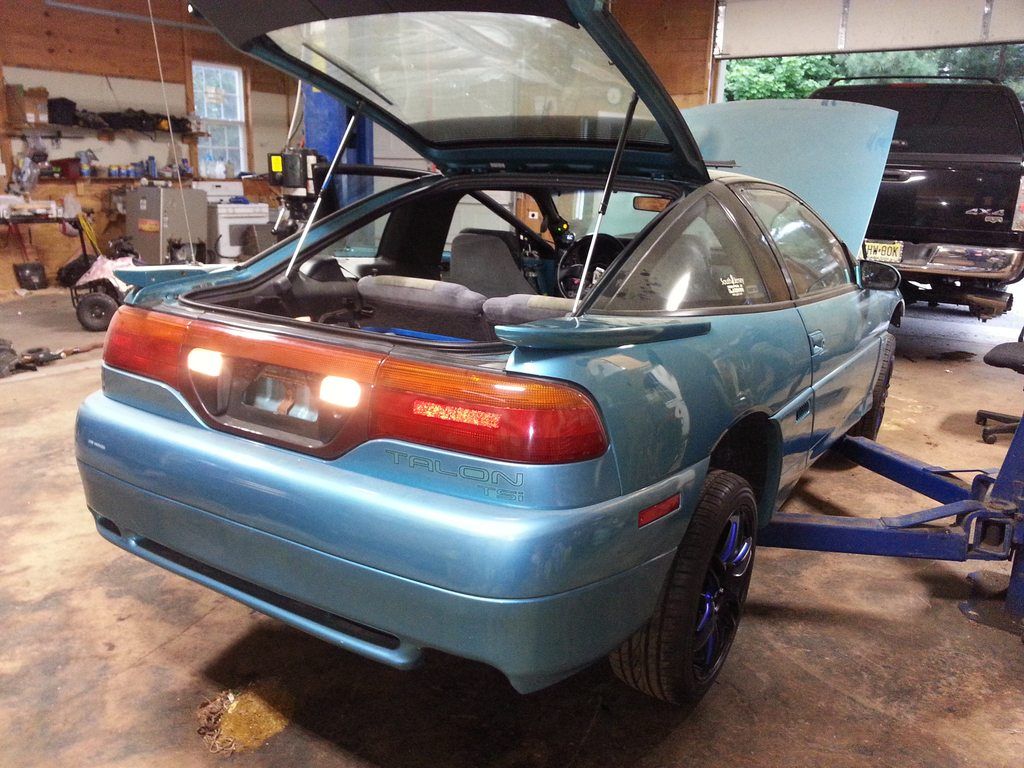

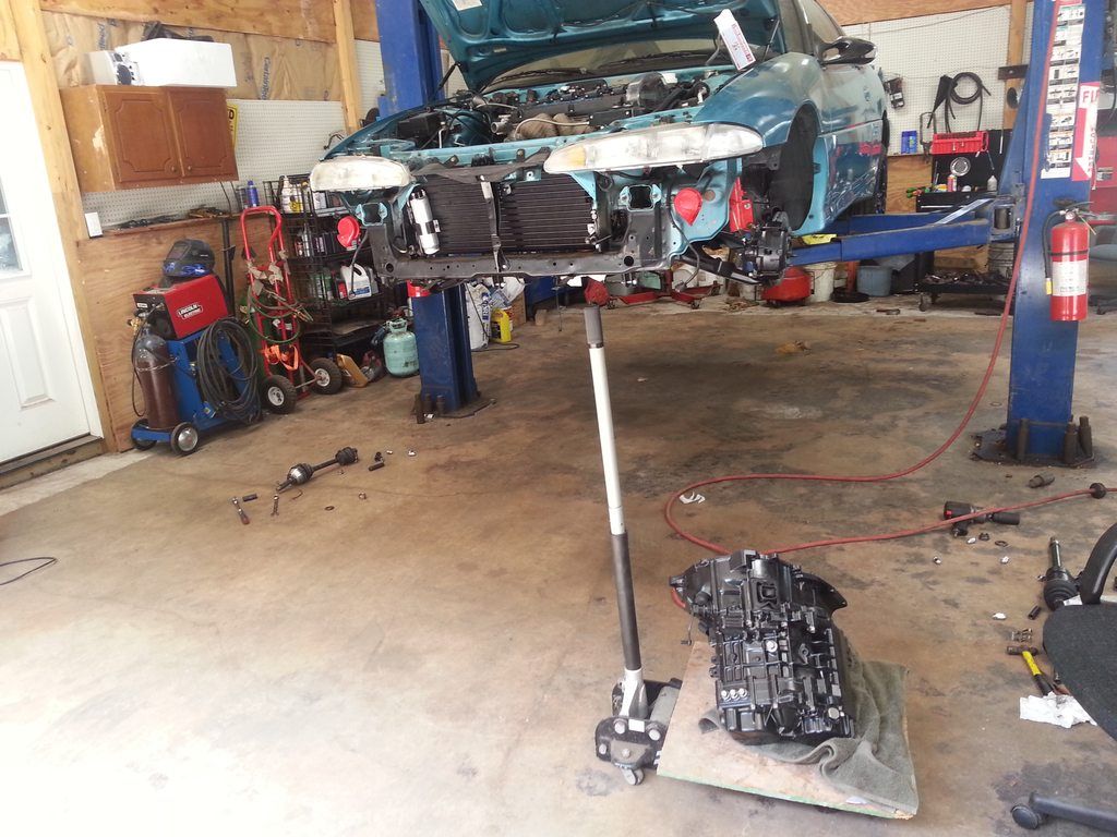

Put the car on the lift, put the trans on the trans jack, and up she went, slid in nicely:
Oh yea, as you can see from the car-on-the-lift-pic, also have all the A/C refrigerant lines and condenser installed. I sandblasted the cap for the compressor so I'm letting that dry. I'm pooped for today so that'll go in tomorrow, then passenger axle, and I'll throw the vacuum pump on the system and see how I make out.

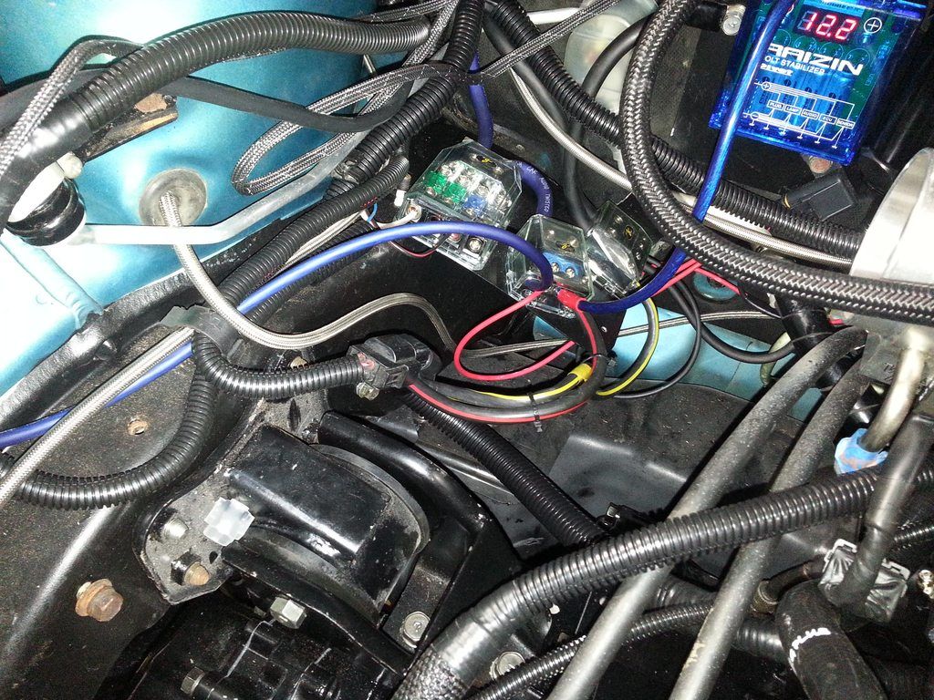

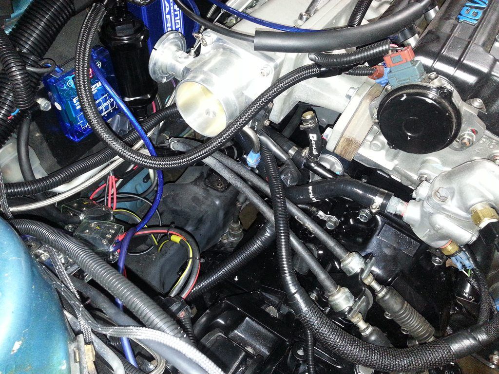

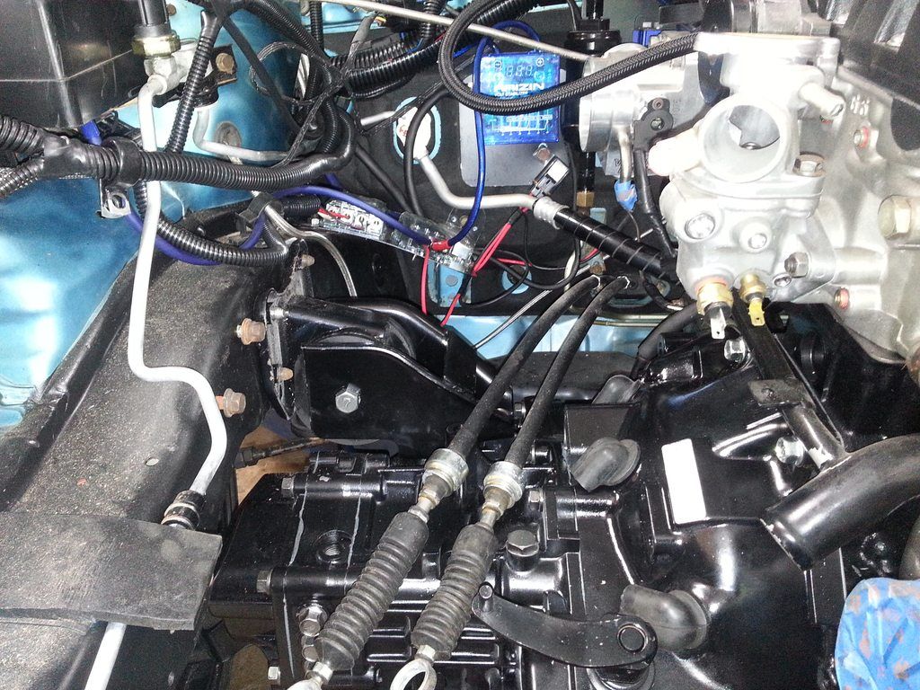

Had to re-arrange my little power/ground distribution center to avoid the fat a/c line at the firewall, so I flipped the mounting tab upside down
and remounted it, sorta at an angle now, but still functions the same:

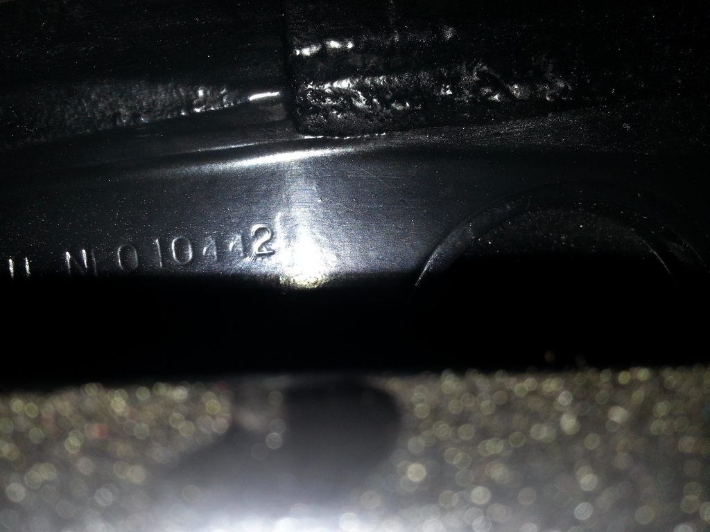

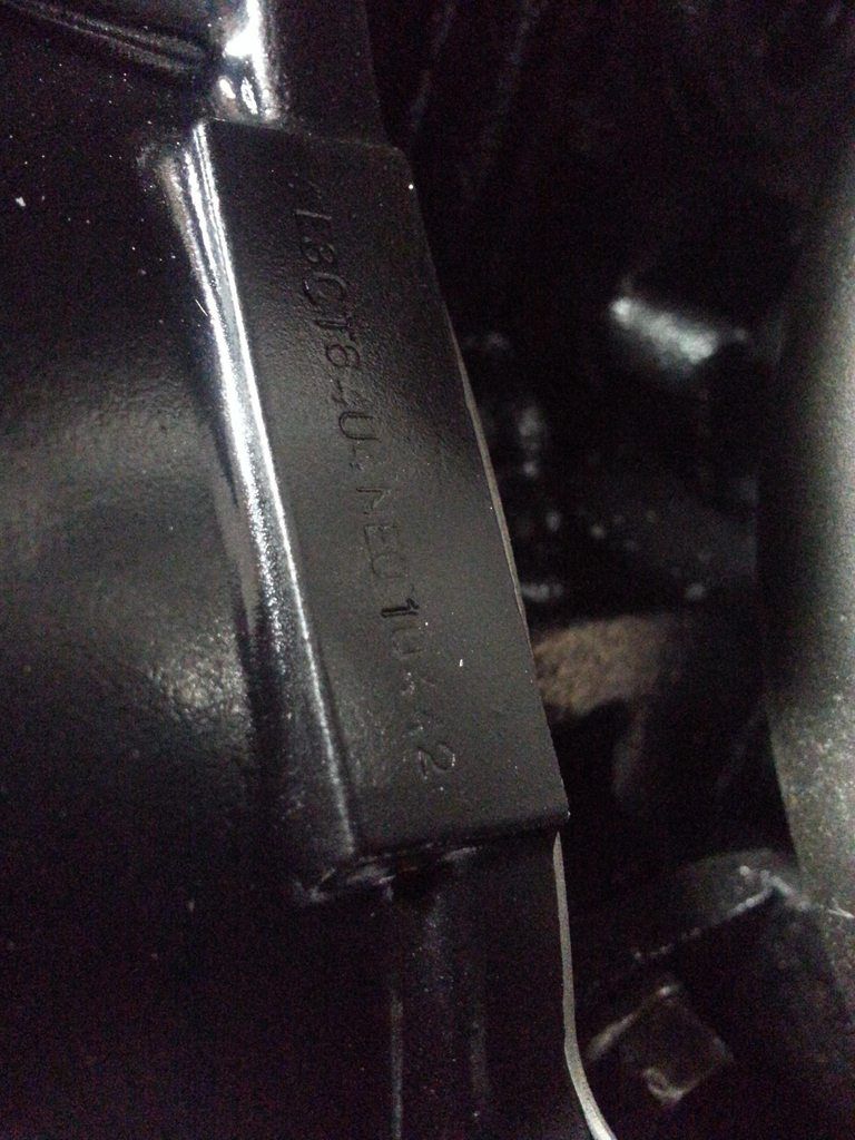

And because I'm a bit of a whackjob, I now have my matching numbers car proof, here's the block:

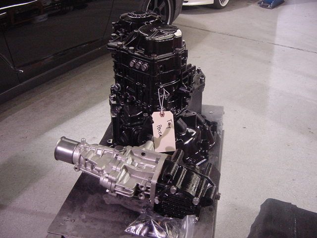

Here's the trans:
Kinda silly we're talking about matching numbers on a DSM, but whatever, mine's "all original" :)

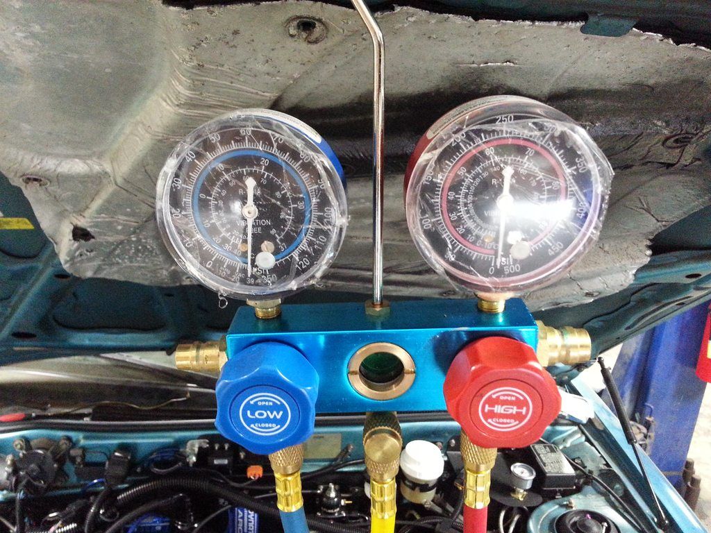

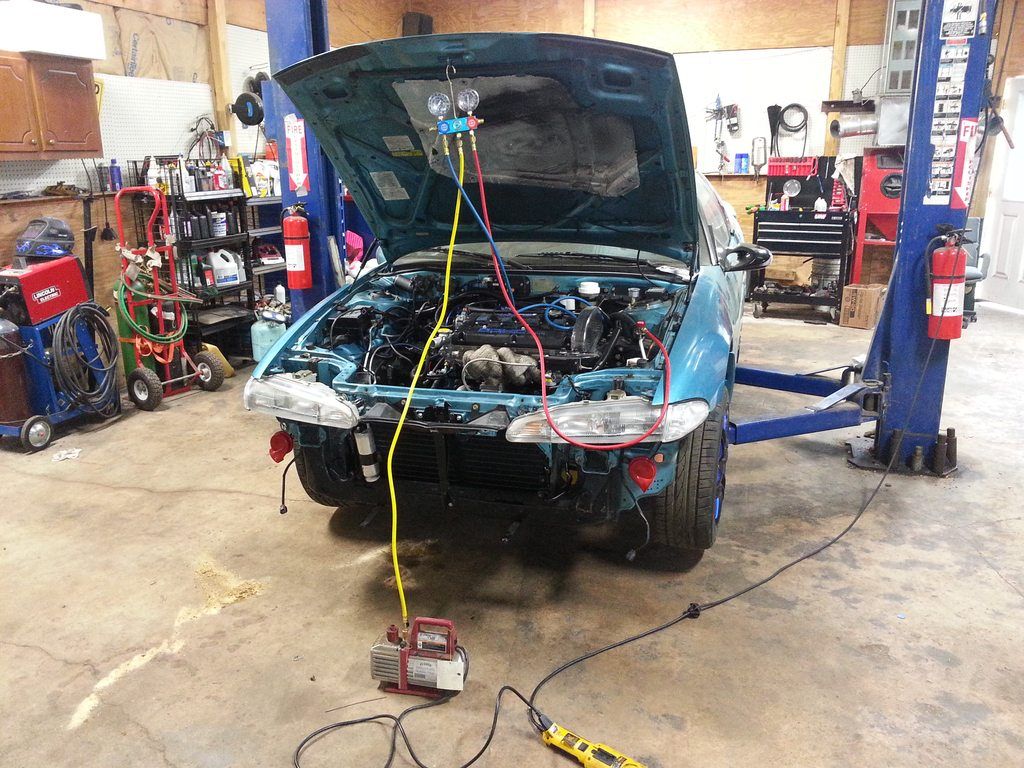

But before I got to that, I wanted to throw some vacuum on my newly installed A/C system. Hooked up the gauge manifold and got the pump ready:
Started up the pump and followed the FSM instructions to let it run for 10 minutes. Then shut the pump off and waited. After 10 minutes, rock steady -30psi minimum:
I let it sit like that for about another hour and it still didn't change, so I think I'm good on the a/c system sealing :)

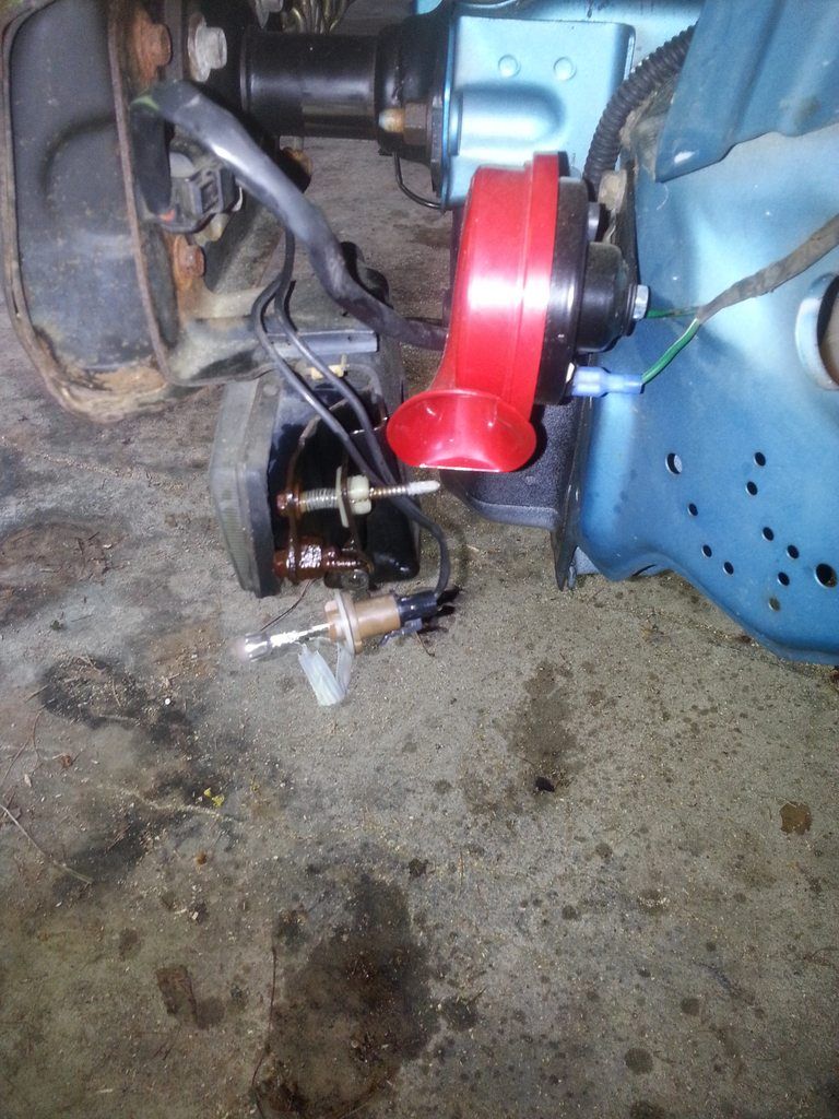

Next up, installed the starter. But first I took that piece of wiring that's all loomed together, removed the loom, degreased it, and re-loomed it. Cut the existing ends off on the battery/firewall ground side, since they'd be going into my little setup:
With that harness connected, +12v applied via jump box, and shifter in reverse, we get.......... reverse lights!

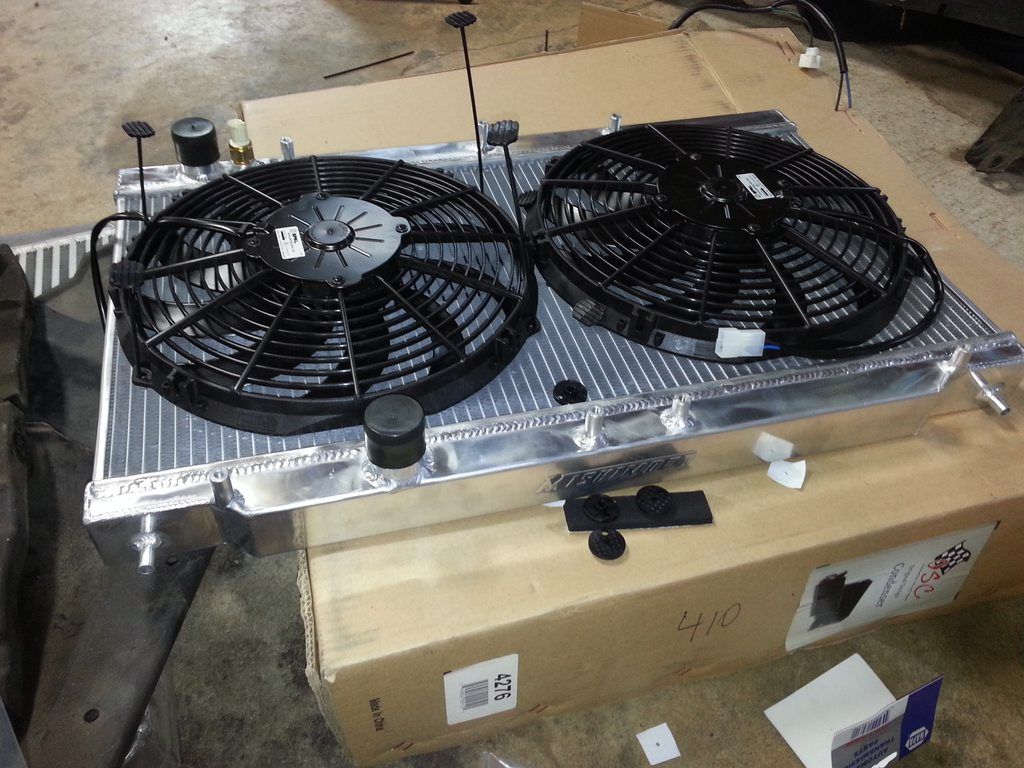

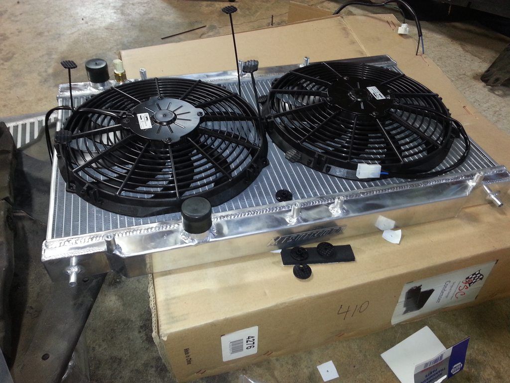

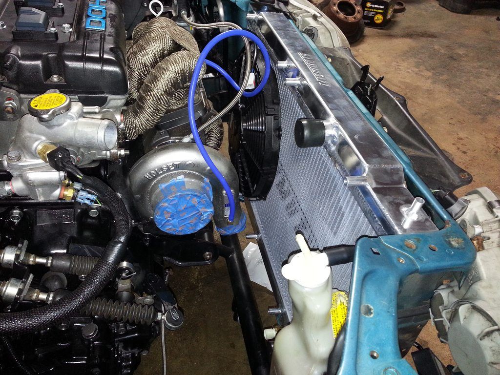

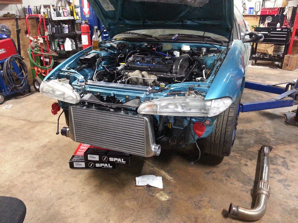

And finally for tonight, some test fitment of the Mishimoto rad and SPAL fan, looks like we have a lovely amount of clearance:
Another angle:
5/19/15:

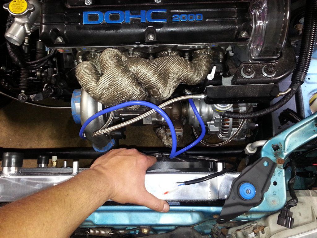

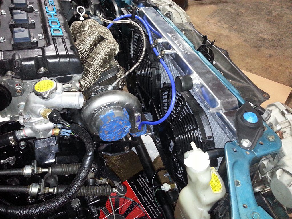

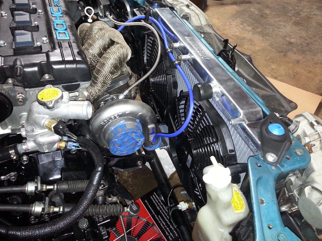

Continued playing with the radiator tonight, mounting the fans:
Installed radiator assembly, wired up, tested working with the a/c switch, both fans operate :)

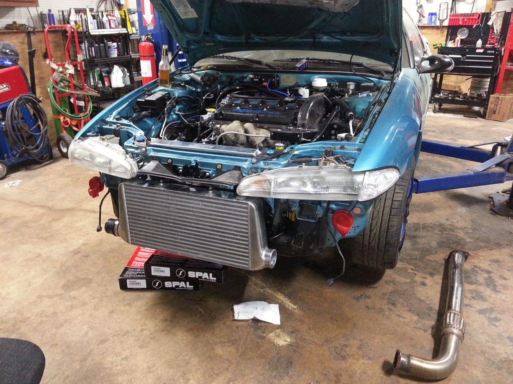

Cleaned up the fins on the FMIC and removed all the rocks with a little pick tool, gave it a little exterior cleaning and mounted it up:

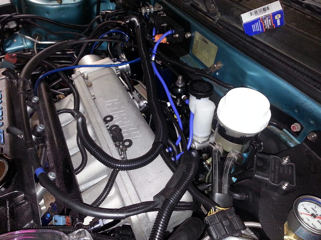

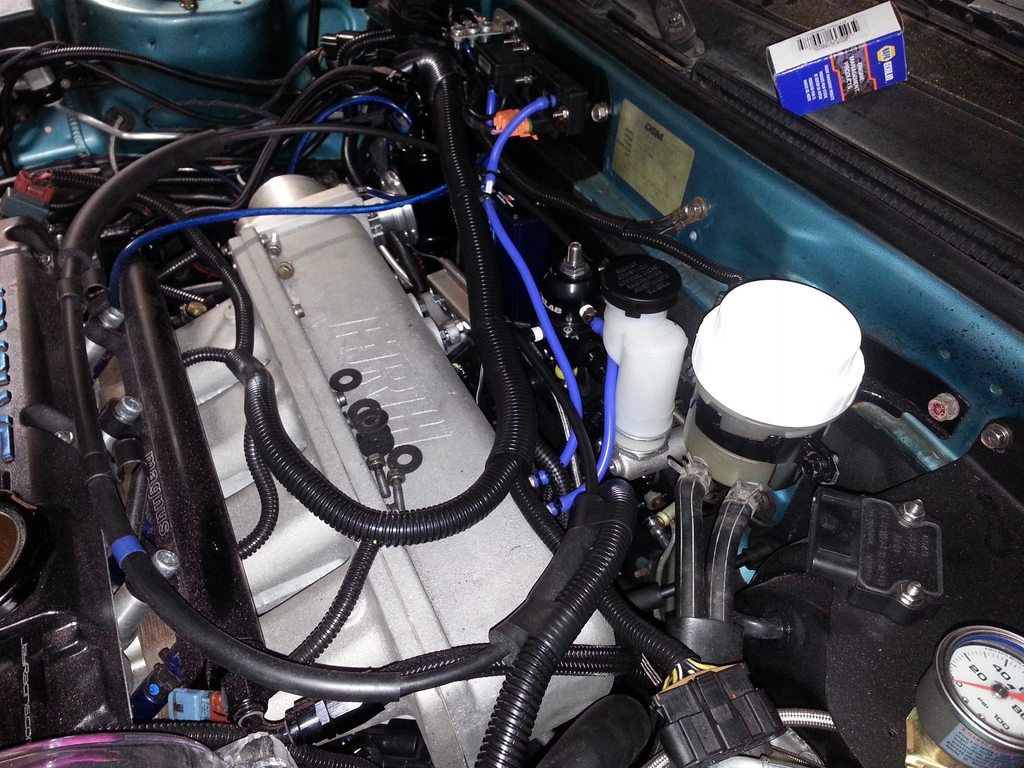

Also ran 2 of the 4 vacuum linesets so far:
Last 2 are the the brake booster, which I'll tee off of before the check valve to bring in the idle air from the nissan evap valve thingy, and the other remaining will go to the bov.

Car is looking very good. Love the attention to detail. What brand and size fans are you using on the radiator setup?
They fit absolutely perfect, and I wanted those cool looking submarine propeller looking blades, so that's what I got. I snipped off the factory wiring harnesses at the factory fans, so they are in full use, including the resistor on the a/c fan harness.

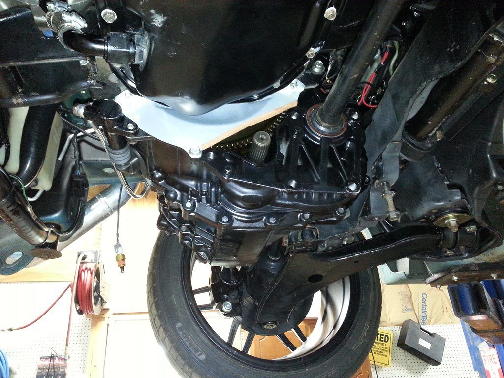

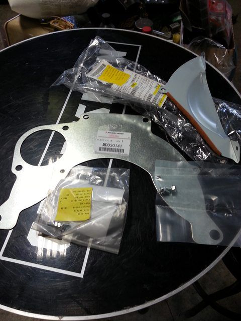

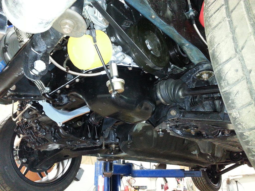

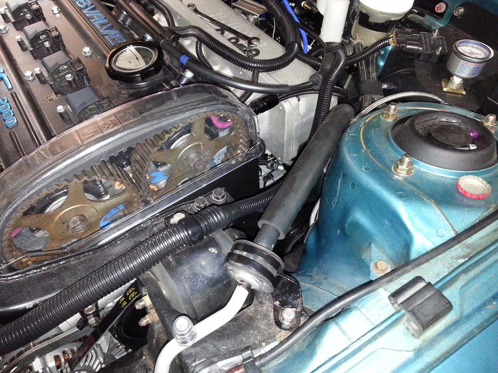

Working under the car right now. Just wanted to post a couple shots from underneath. For some reason the oem specified length for the Alternator Belt wouldn't fit, it was too short. So I went with a 40-3/4" belt from NAPA, seemed to fit ok, and still gave me about 1/2" of extra room to tension it up if it stretches a little. Could be because the Gvr4 alternator has a 5mm larger diameter pulley, but even then, the specified length for both cars is the same. But whatever, its on now:
And here's 1 of 2 brand new inspection shields left in the US, it's been a week since @jnztuning grabbed this for me, so the other one probably sold already:
PS, don't mind my IAT sensor hanging there, LOL. Also routed up the jnz ss clutch line from master to slave, and I'm using a new Aisin slave.
