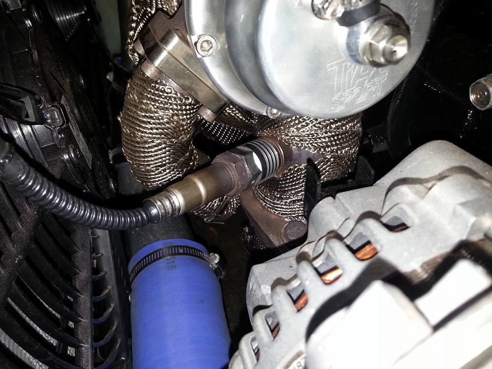

For some peace of mind, I received it over the weekend, and installed tonight, the Innovate HBX-1 heat-shield bung extender thingy :
and 10 minutes of your life you'll never get back, installation video:

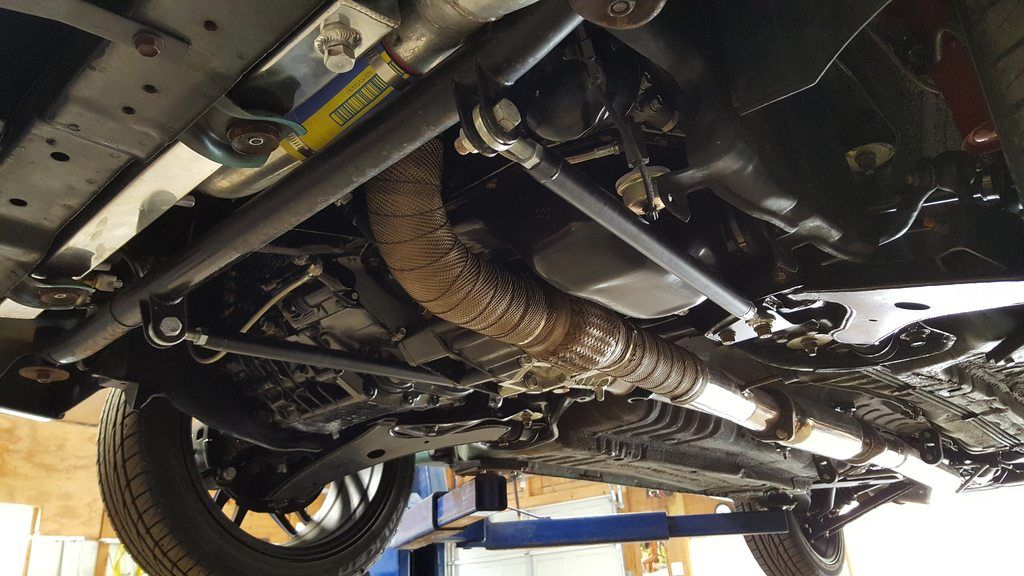

My car had been acting up with the SCG-1 randomly resetting power. Sometime's I'd see it just before it happened, and it would peg full lean for the blink of an eye

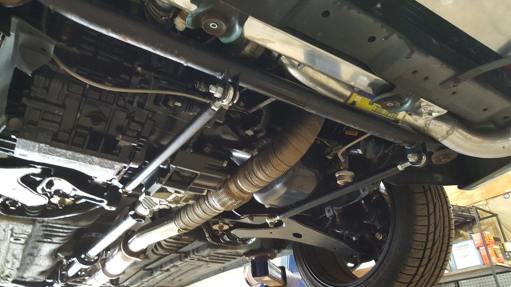

shut off, turn back on, do o2 htr, then work fine till it did it again 5 minutes later. So I figured maybe it was those push-pull type glass fuse holders. ripped those out and soldered in blade-style fuses. Still reset power. Then I added a relay in for power direct from battery instead of tapping gauge power direct from the ECU, still did it. Unplugged the boost solenoid from the gauge. Still reset power. Last thing I could try on my end was a new o2 sensor.

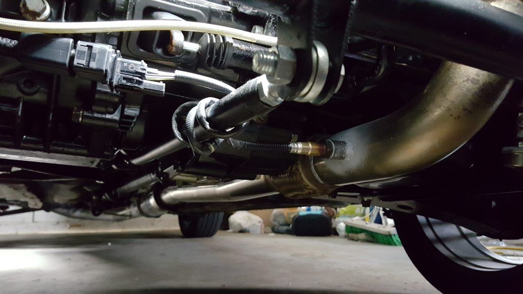

So far, ran the car twice. Idled for about 10 minutes, didn't reset. Drove it around the corner to my buddy's shop yesterday to throw it on the lift and install the N/S bars for the 3pc crossmember. Drove it back after install, didn't reset.
So maybe the o2 sensor was shorting for some reason, momentarily? Just weird just about every error built into the SCG-1 has to do with the o2 sensor, and I get no errors, it just shuts off.
So here's the N/S bars installed:
Next up is just keep driving it to verify SCG-1 operation, again. I just don't understand, it was perfectly fine for 5 months, then all of a sudden that reset problem started happning. Very mysterious.

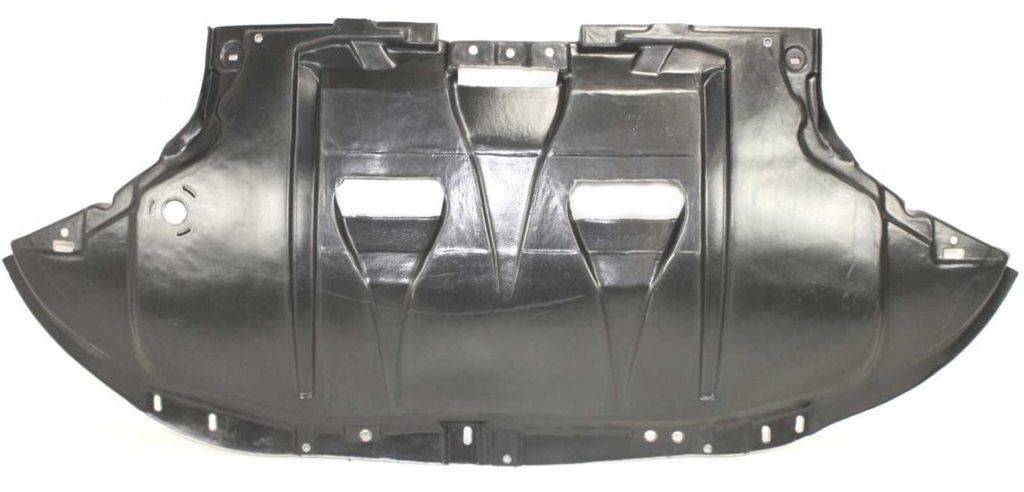

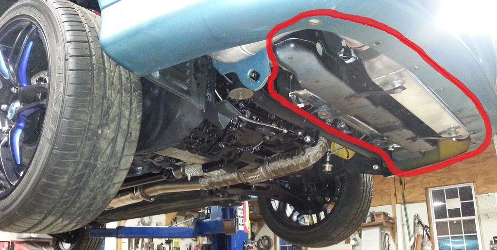

Next project, aside from WOT tuning, is front lower air dam. I don't have any cooling problems, but I do have a huge FMIC, A/C condensor, and radiator, so that's a good bit of stuff up there and usually does present a problem in hot weather. Thankfully I don't have those problems, but just in case, I'd like to embark on a journey to close this area off:
I was thinking sheet-metal, just cut to fit. But that'd look so, homemade, and could possibly rattle and rust and who knows what. So I started browsing ebay for lower shields, air dams, etc. I came up with this guy from an Audi A4, which seems to have a similar front end to ours, so I ordered it and she arrived yesterday, so I'll play with that this weekend:
It was under $40 shipped, so I won't feel so bad cutting it to fit around things.
So are you going to close off that gap and force all the air through from the front? Just wondering. I put a 86 Camaro air dam in that spot to force air up and into the radiator, I think you can see it in my avatar. It helped keep the car cooler. It probably would work even better if I removed the weatherstrip from the back of the hood to let it flow. I'm watching your progress and of course wish you success!!! :thumb:
My assumptions are, this would help create a non-short circuit while the car is at rest, so that mostly fresh air from the front would be sucked thru, versus the rad fans just sucking hot air in a circular motion thru the rad, then right back thru the rad.
And while in motion, this would help create negative pressure at a point behind the i/c,rad,condenser cores, so that more air flowed thru them.
Gotcha, so it would help "suck" the air in and through where I am forcing it through. Sounds like a well thought out plan!

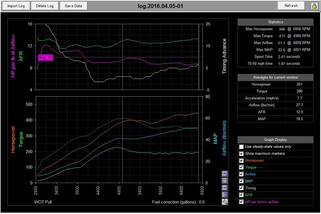

Went to another car meet Tuesday night, pulled this:
On the way home, pulling into the garage, the SCG-1 reset again. So I think I'm frying the o2 sensors having them in a tubular o2 housing, right in the stock location with a very short bung.
So today I took my DP over to a guy to get the bung in the SCG-1 kit installed further down on the DP. Test fitted and seems like a pretty good spot to test out without the Heat Sink for now, and have a couple more o2 sensors on the way...
