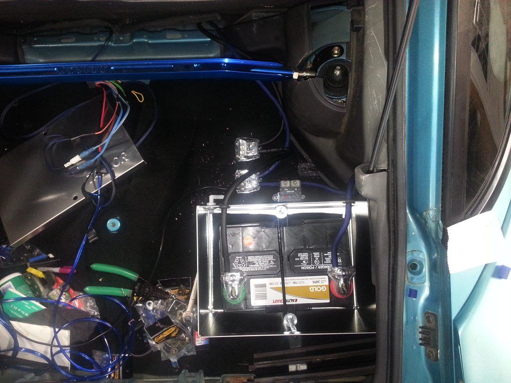

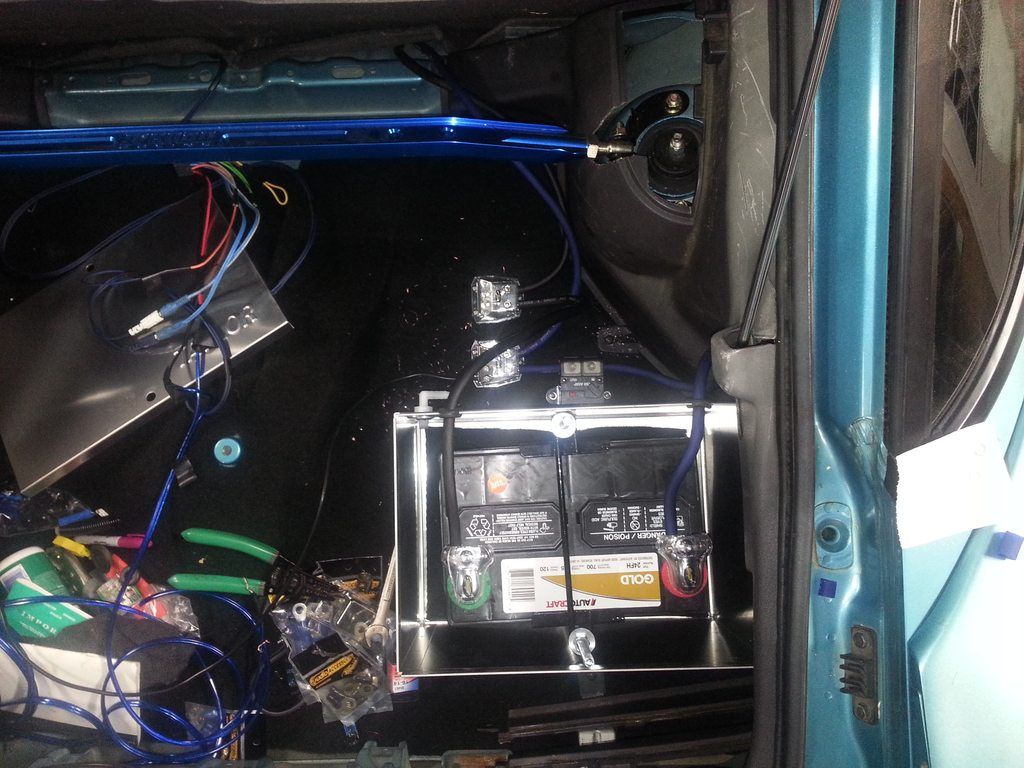

I ordered 2 more distribution blocks which came in yesterday, then I cut a little piece of 1/4" plywood to go under the carpet in the back, mounted up the dist.blocks and wired up the battery with the 150amp circuit breaker as well:

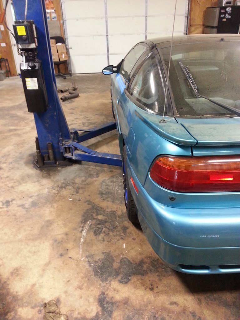

Is this your own garage Tony?
@just2point0 i wish, its my friend's place around the corner. he does freelance mechanic work every other weekend, hence the lift and all the nice tools. only thing is its between his house and his father's house, so I have to respect whatever their rules are, and I can't be there late at night, out of courtesy.

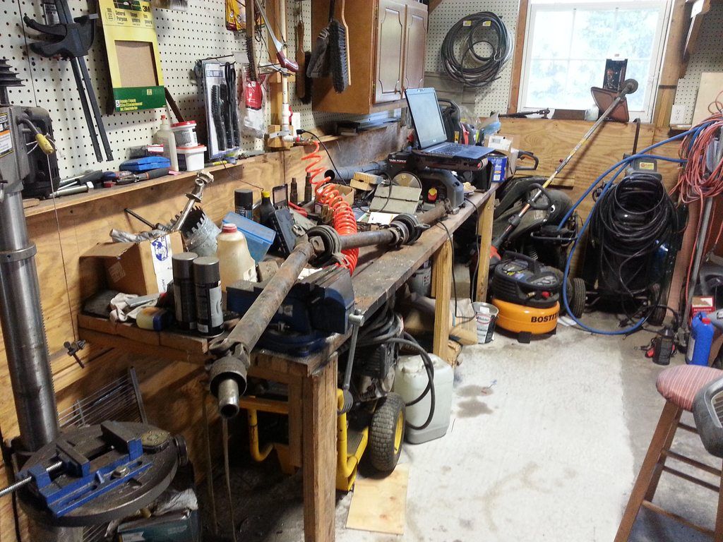

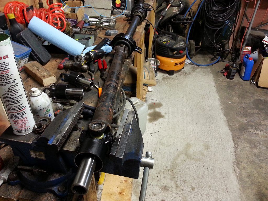

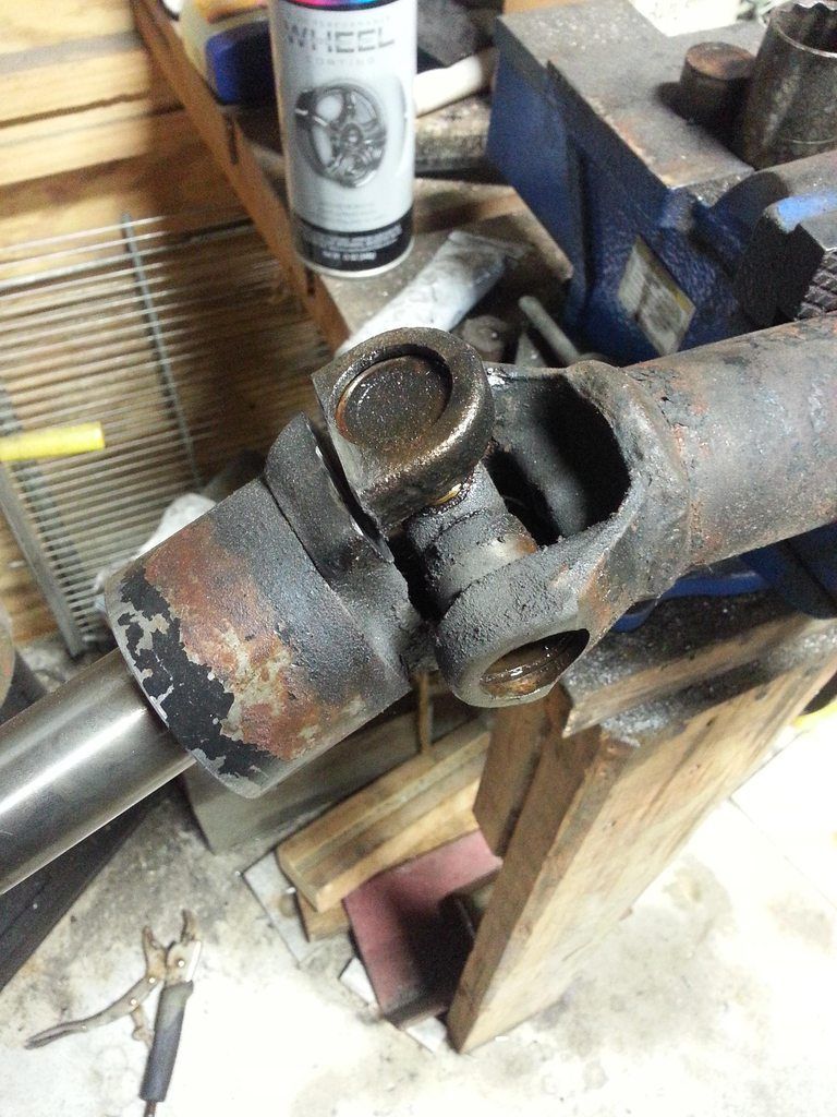

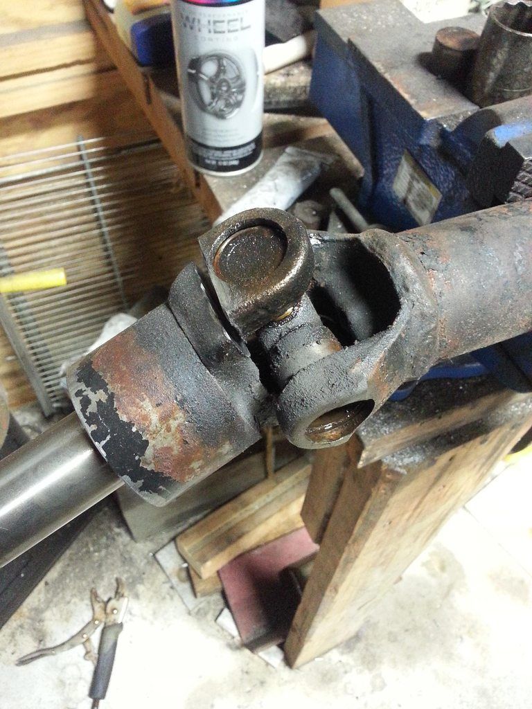

Started operation driveshaft. With laptop in tow, containing downloaded jafro rebuild vids, I took some time to assemble all the tools I would need. I've had all the parts sitting in a box since last summer (3 yoke kits, 2 carrier bearings, 2 propeller nuts and 2 washers)
Started on the first u-joint, pushed it too far, got pissed off, called it a night. I'm working on it alone, so the 2-jaw puller is kinda fumbly in my hands. Might switch the setup around and use the shop press instead, just for more control. To be continued...
Side note, the lobro boot is perfectly in-tact, so no need to touch that, which is good. The 2 end u-joints are totally shot. The yoke u-joint moves nicely on one axis, but almost not at all on the other axis. The rear u-joint is notchy on both axisisisisis. So this will be nice to have it almost new again.

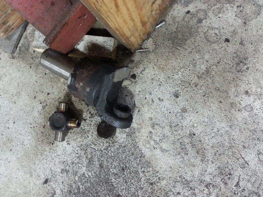

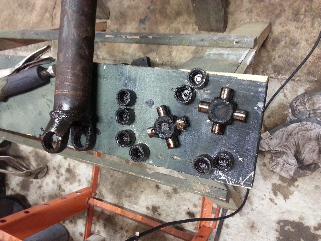

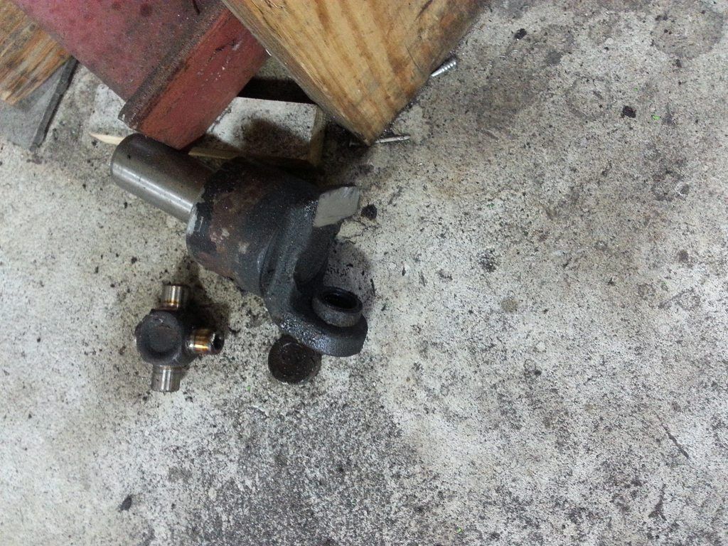

Because @BoostedBeaver is a huge inspiration to me ;) I wasn't gonna let last night get me down. I pulled out the cutting wheel and went to town. Why not cut it the hell off, i have 3 brand new yokes anyway:
So screw you mr. yoke and mr. u-joint!

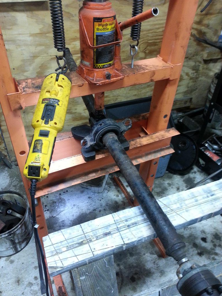

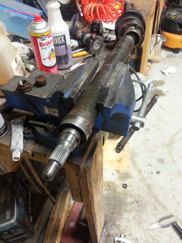

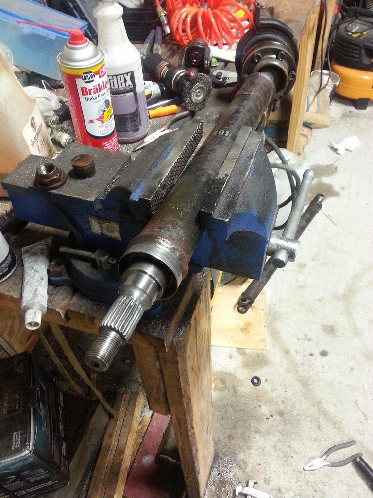

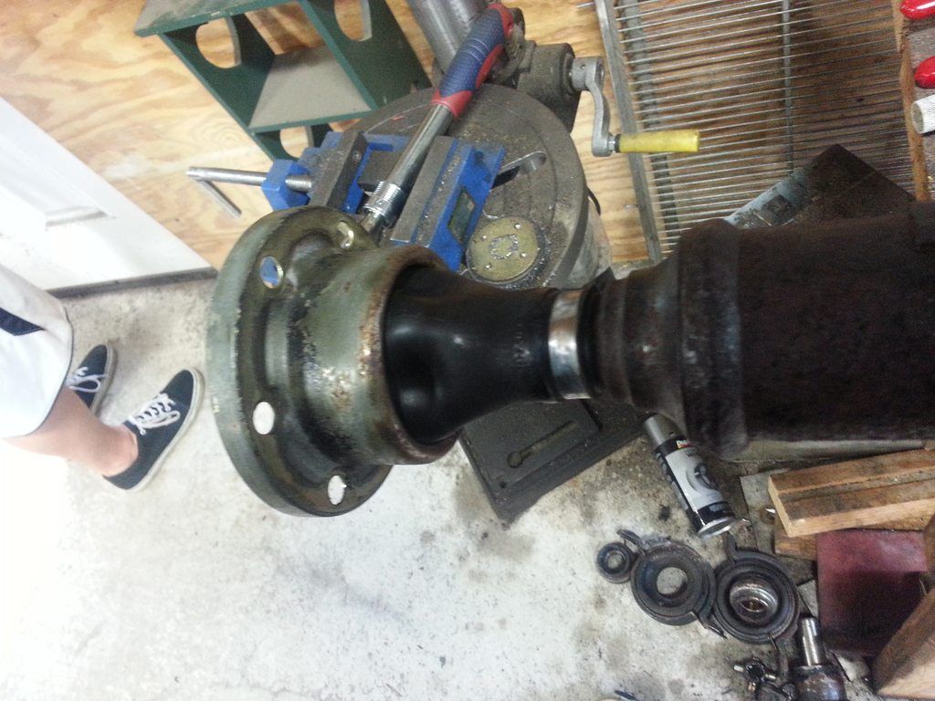

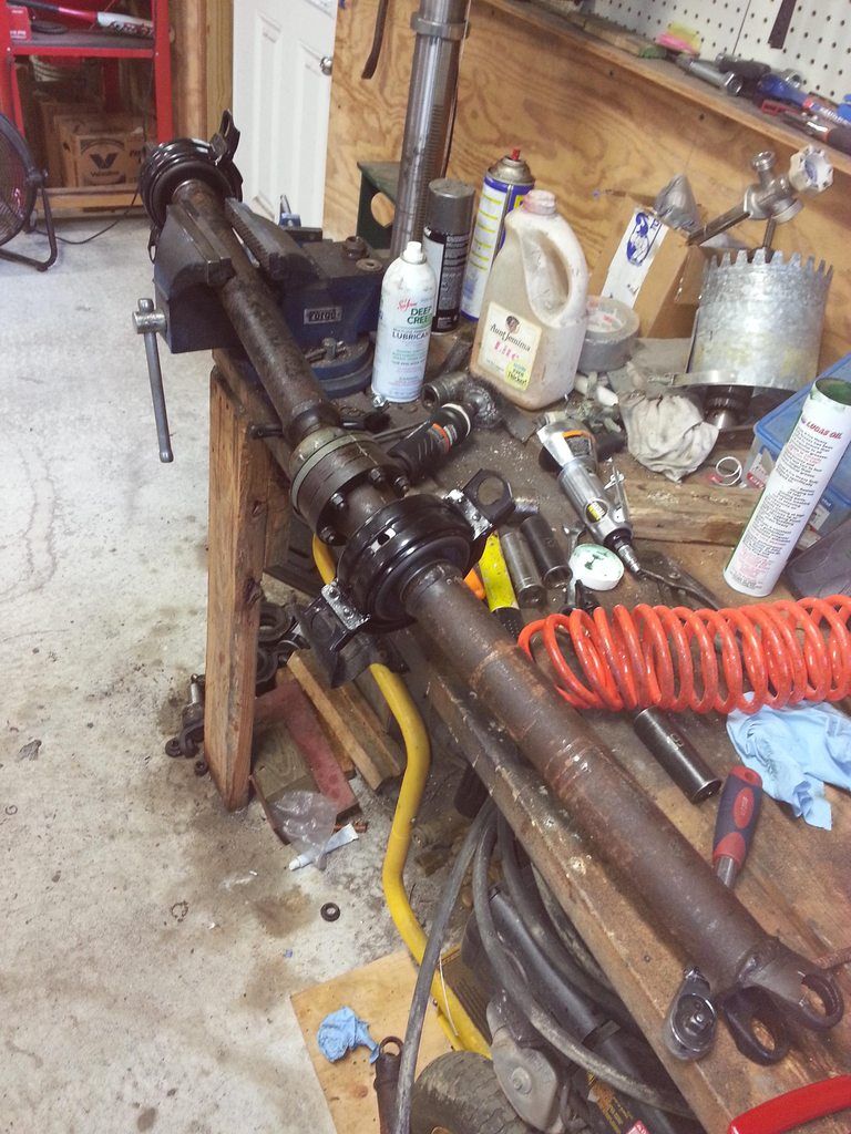

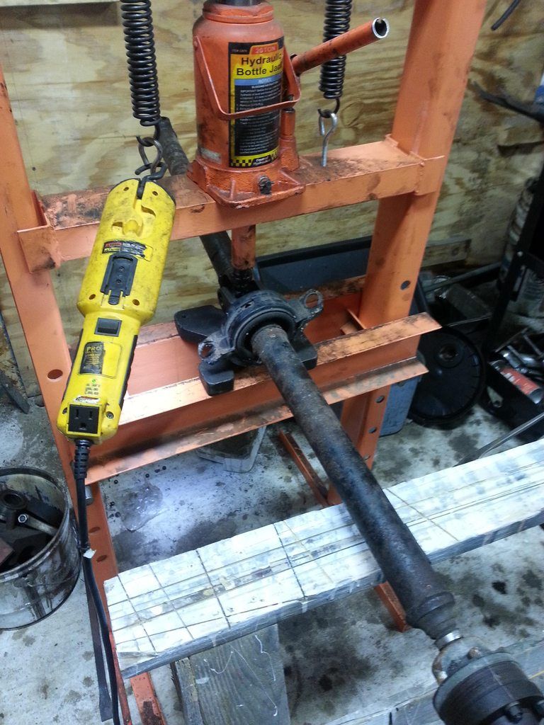

And the vice is nice, but I'm alone, so I wanted more control. I got that via the shop press and some saw horses:
Yicky u-joints are out:
and got the 1 carrier bearing off so far, and cleaned up the surrounding area:

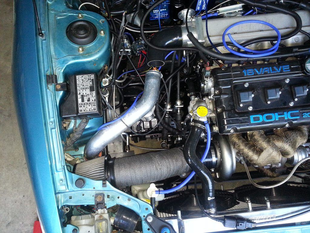

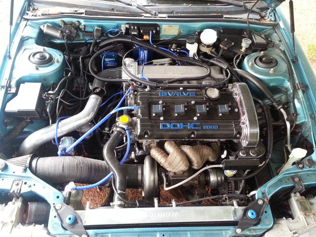

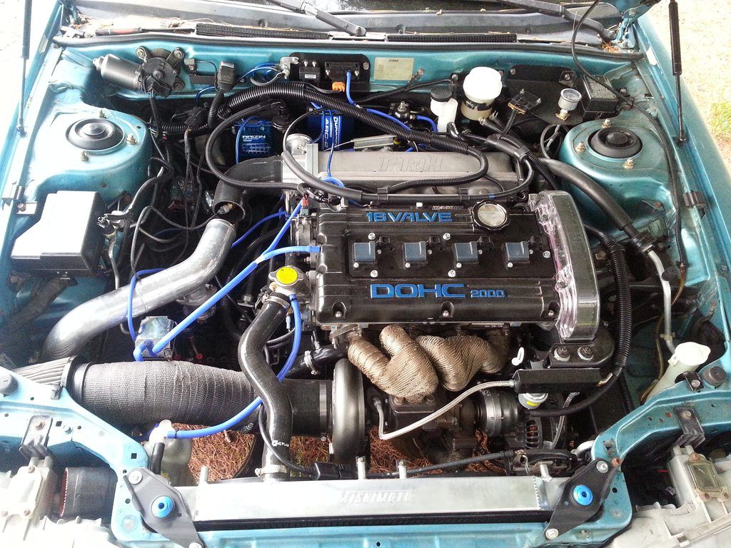

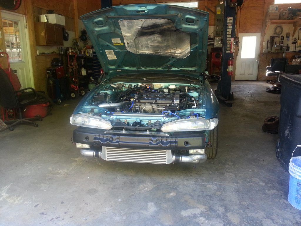

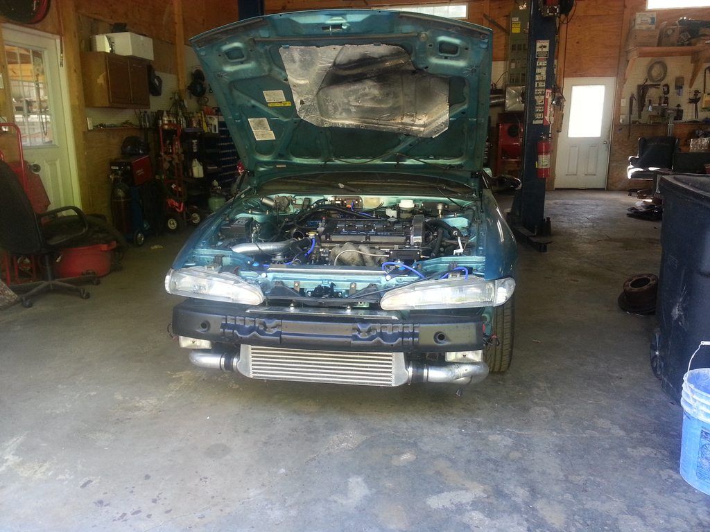

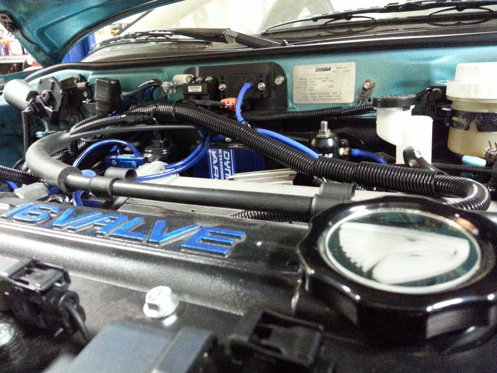

and lastly, an updated overall engine bay shot, installed the catch-can, just need a little longer hose from the can to the intake so it's not kinked, and some small black zip ties for the connections:

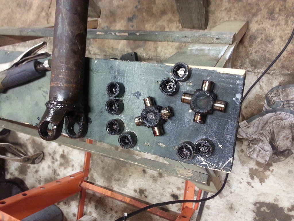

Great engine bay shot , I'm curious to how your coolant overflow is mounted

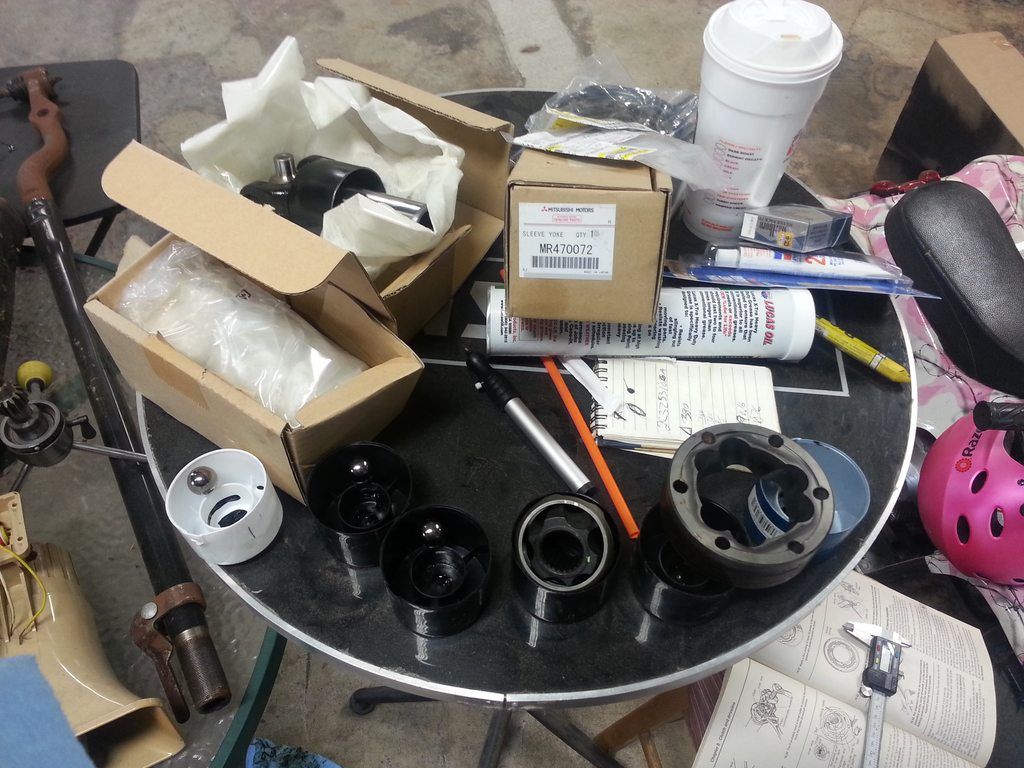

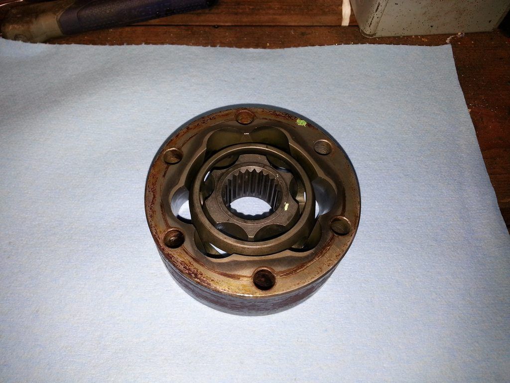

Driveshaft progress. Here's my boot, looks fine, so I'm just gonna give it a gentle cleaning:
Lobro all cleaned up and put back together after inspection:
As instructed, I cupped the balls:
And so far, lobro greased and re-installed, both new carrier bearings are on, and 1 u-joint so far... 2 more to go:

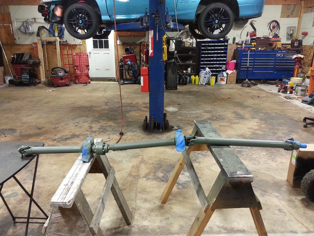

All u-joints done:
Taped off the yoke, lobro boot, and both carrier bearings, sanded, and etch-primered:

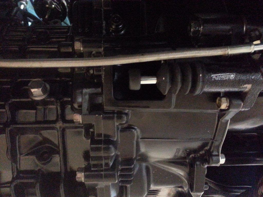

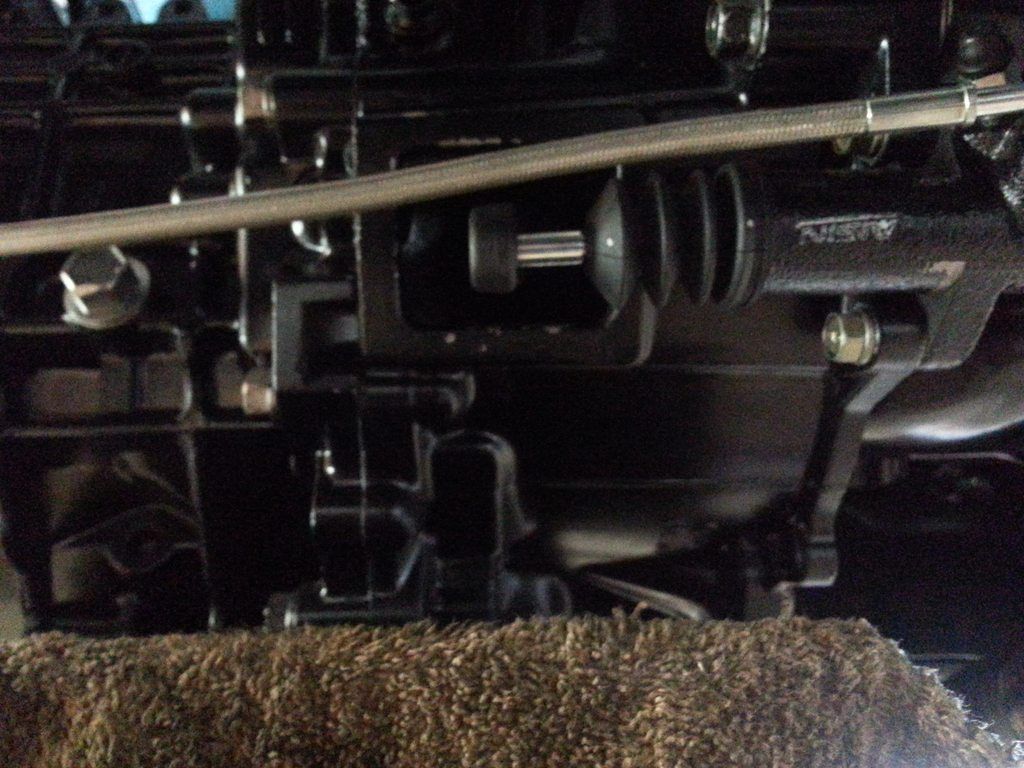

Before I went ahead and put the driveshaft in, I wanted to check the pivot ball's position. Here's how it looks with the existing ball, which jack's left in and just painted over, new CC fork, cc stage 3 clutch, cc lightweight steel flywheel:
It's my own fault, didn't think to ask if they installed a new one until after I mounted the damn trans. Welp, that looks a little too far over to the passenger side. So took the trans off, installed the CC ball with nylon bushing, which came with the CC clutch fork, and here's how it looks after:
Not much of an improvement. Guess that's just how it's gonna be.

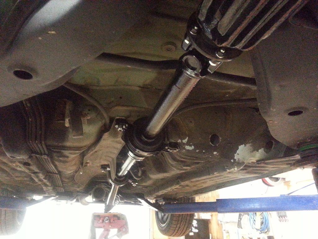

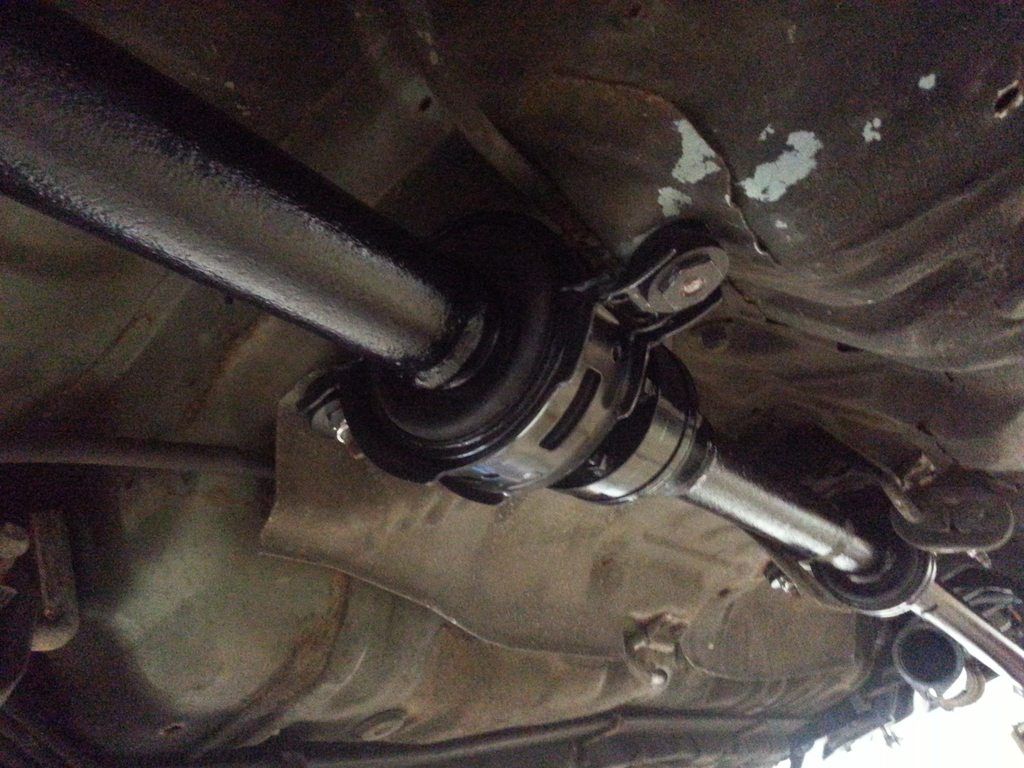

So let's install that driveshaft then! Started at the back and worked my way forward:
Used rust-oleum industrial gloss black spray paint on it, even 6 hours later, its still a little tacky.
Here's my custom-made fastener for the one driveshaft stud I sheared off last year, used loctite on this one:
and finally my pretty 2-tone transfer case:

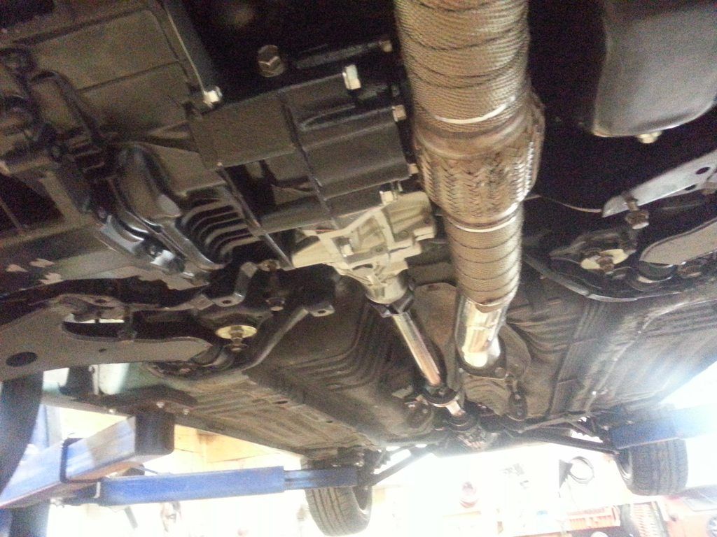

Torqued to spec with new bolts from JNZ, filled with lucas 85w140, and re-installed the downpipe.

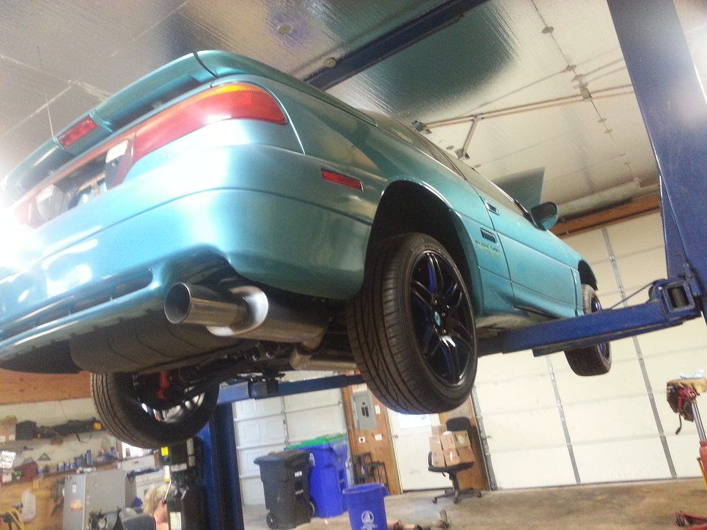

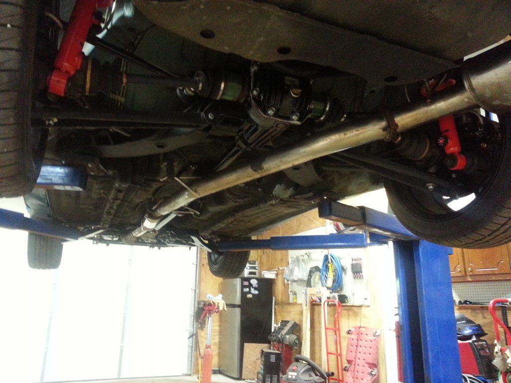

But wait, there's more! Let's go full bore and install my exhaust too? Sure, why not.
Ordered a megan 3" test pipe, so bolted that up to the Thermal that came on the car, then worked from rear to front again:
Just need 1 more hanger for the rear of the muffler, not sure where that got off to:

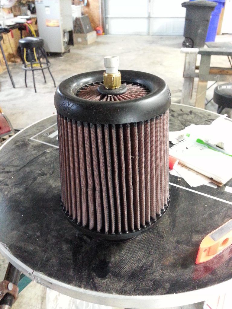

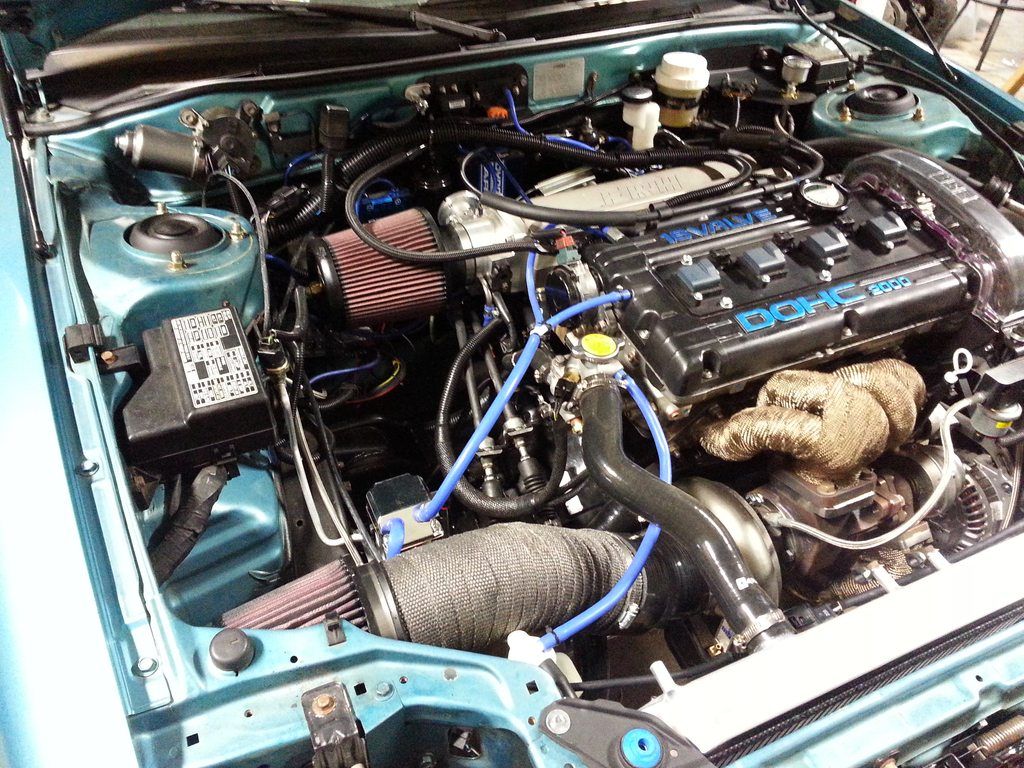

And since I'm just idle tuning right now, and my I/C piping isn't hooked up, I thought this would make me a little more comfortable. Found this k&n filter in my garage, decided to drill a hole in the top so I could insert the AIT, then mount the filter right on the Wilson throttle body:
Bro, do you even 2 air filters ?
