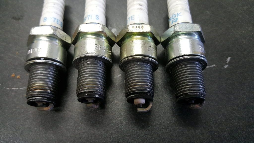

Anyway, decided to also pull the plugs and see how they looked, and time for a WTF moment:
One of these things is not like the other....... it appears i had 3 BR7ES and 1 BPR7ES in there. Not sure how the heck I missed that, and I've been running like this for a year now. That aside, plugs look relatively nice. Gapped a new set of 4 BPR7ES and installed. Now to re-calibrate the o2, just because, and go tune idle.
Anyway, decided to also pull the plugs and see how they looked, and time for a WTF moment.
Well that's interesting haha. I did a job for a freind with a legacy gt recently, complaining of multiple misfires, super rich and crap mileage (~10mpg). Did some live data collection and it was all over the place for timing and afr. Did plugs/coils in addition to the t-belt job I was originally doing. Had that same kind of look on my face when I pulled the plugs and they were short thread. Putting still plugs in a 2.5LGT is a no-non, haha. Needless to say it ran much better after it left my place.

Fun discovery tho! Love the car t-money
That "p" plug is nice and clean. It wasn't too hot was it? Doesn't look like it so that's good. I run the plain 7's right now. I used 8's for a short time but No noticeable difference. They stay'd clean though. I went out and stirred things up tonight too. I just love driving the car after so much work as I know you all know too! Had fun with a new GTO. Hahaha

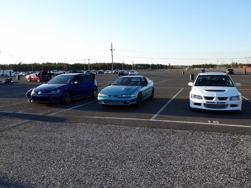

Picked up a new sensor Thursday morning at pep boys, came home after work and installed that, fixed the hoses, and now we're on to Friday. Decided I'd hit the track, for the first time ever, in a 5spd AWD car, along with my buddy Scott (evo8) as photographer, and Geoff (Golf R) who wanted to run his car too.
Got 3 runs in, all were terrible. Learned a lot of things that have to be done on the 1/4 with this car, so I'll go back soon. Best time? A whopping 14.7 @ 106. Remember that dsm I had about 12 years ago? That was fwd, and I pulled a 12.7 @ 113 with that on slicks, with a best mph of 115. I know this current car has way more power, so to be continued....

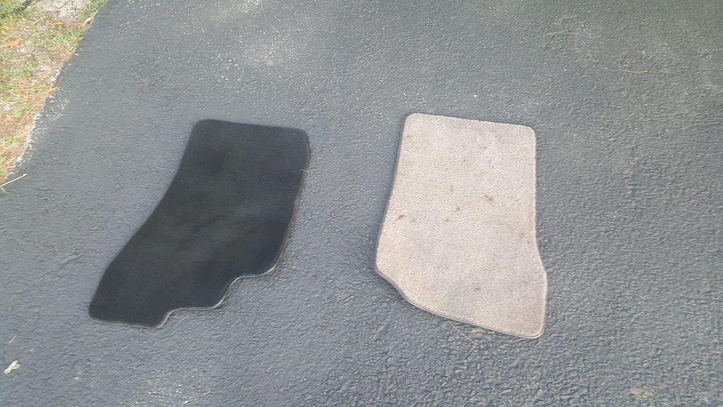

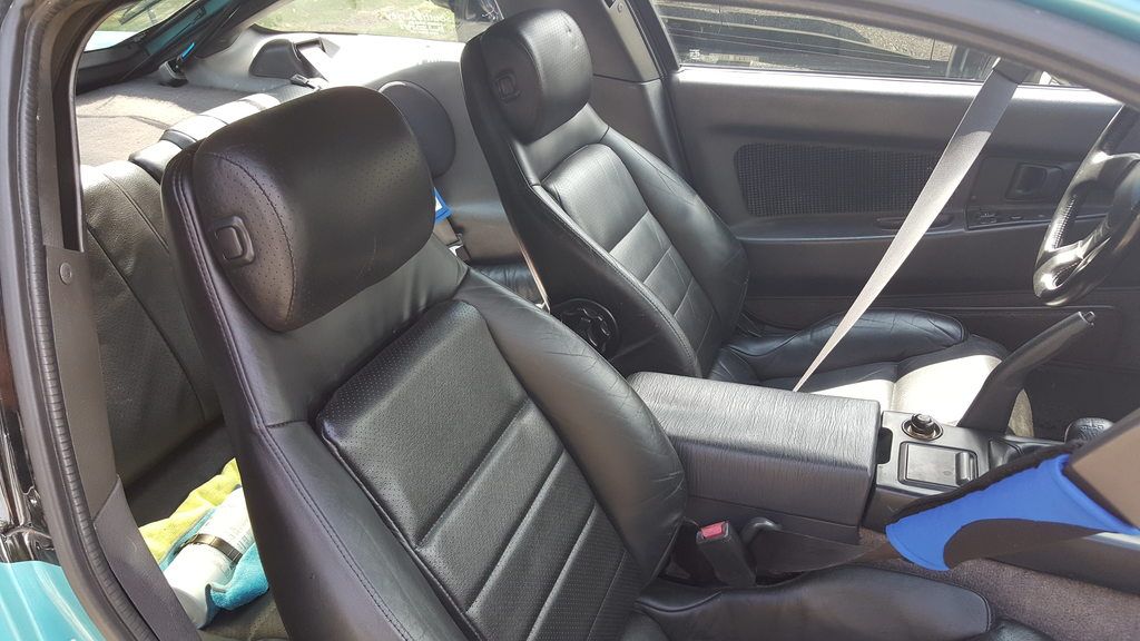

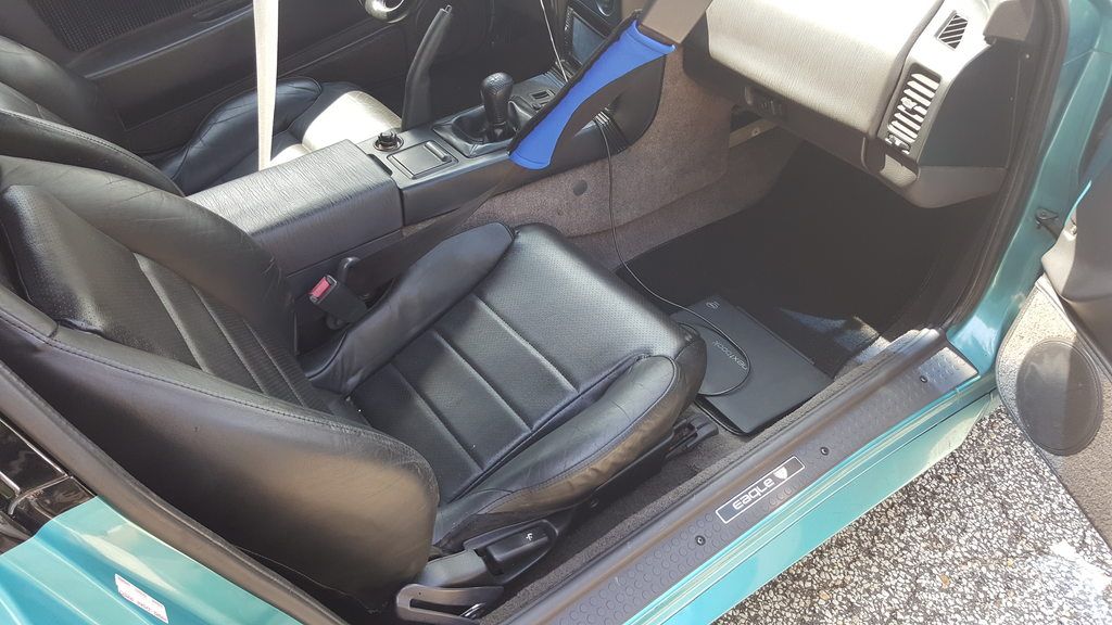

She's finally cooling down a touch. Yesterday braved the 100F feels-like temps and drove to philly for MoD2016. Water temps weren't a problem on the drive, but oil temps got up there, figure mid 200F's after cruising at 60-65 for a half hour. Winter project will be the oil cooler. But, to prep for mod, took the cloth seats out, and put the 1g leathers I had redone in, and fabric sprayed the floor mats black:
http://i.imgur.com/rLeb95bh.jpg
here's an after/before pic of the mats.
seats installed:
I think they're great. However, the rest of the grey interior now pales in comparison. So this winter I might just black out the floor carpet, the center console sides, and cargo panel too.
If I really want to get carried away, I'll do the interior plastics, just not sure on that one yet.
