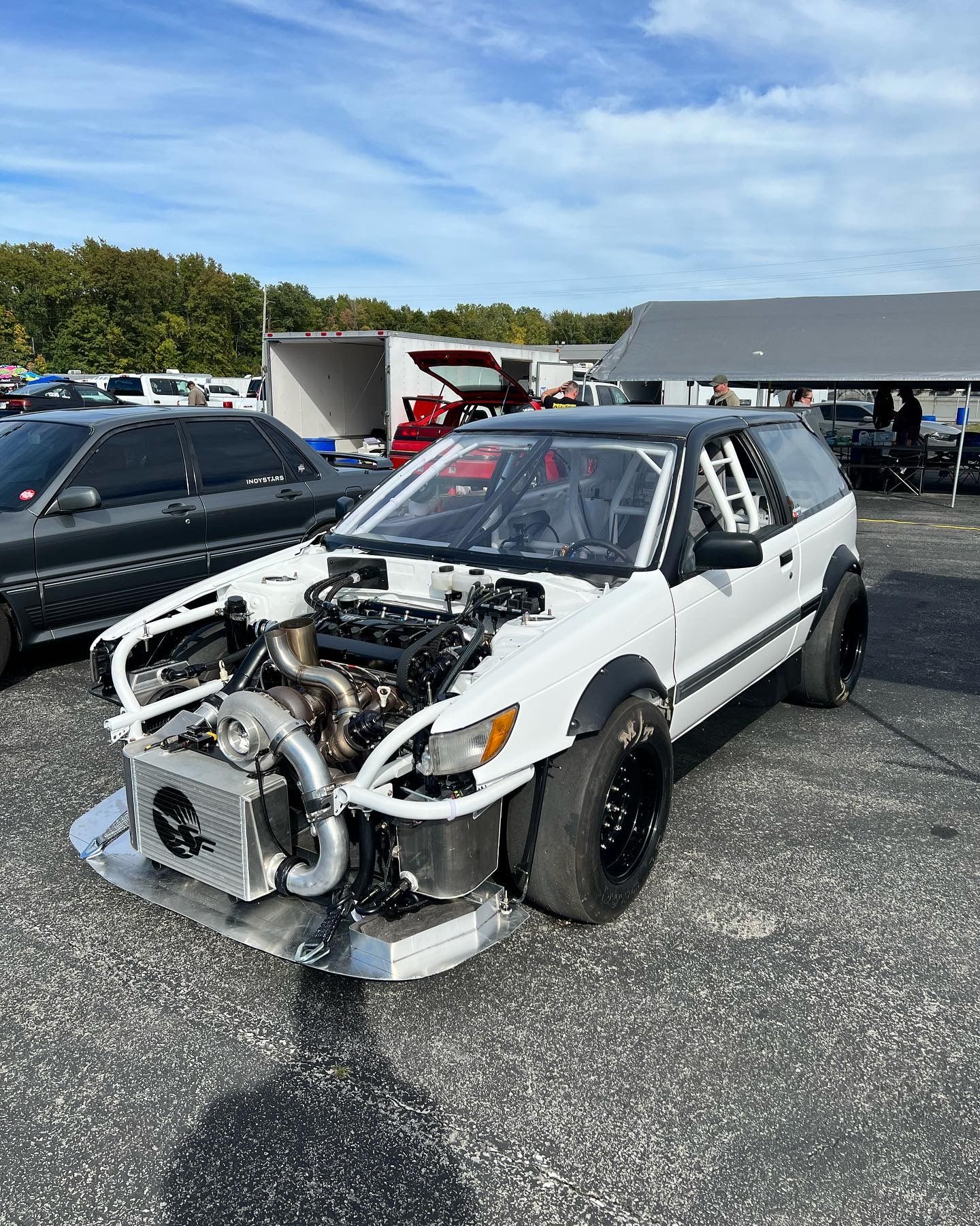

Alright I started a build thread over on 4g61t.org (colt forums)
Some stuff I will copy over
My original plans for this car were to keep it fun... and then the competitive side in me came out and i went full Race Car. Its basically setup for drag racing... just because the cars going to be a great sleeper (besides the gigantic intercooler<will be painting black> and side exit)
Care is a 1992 base model decently clean for being a 1992 beater
I want to get the car to 2000 lbs if i can.
Car is completely stripped
No ac/heater
Still working on the website but domain is reserved!

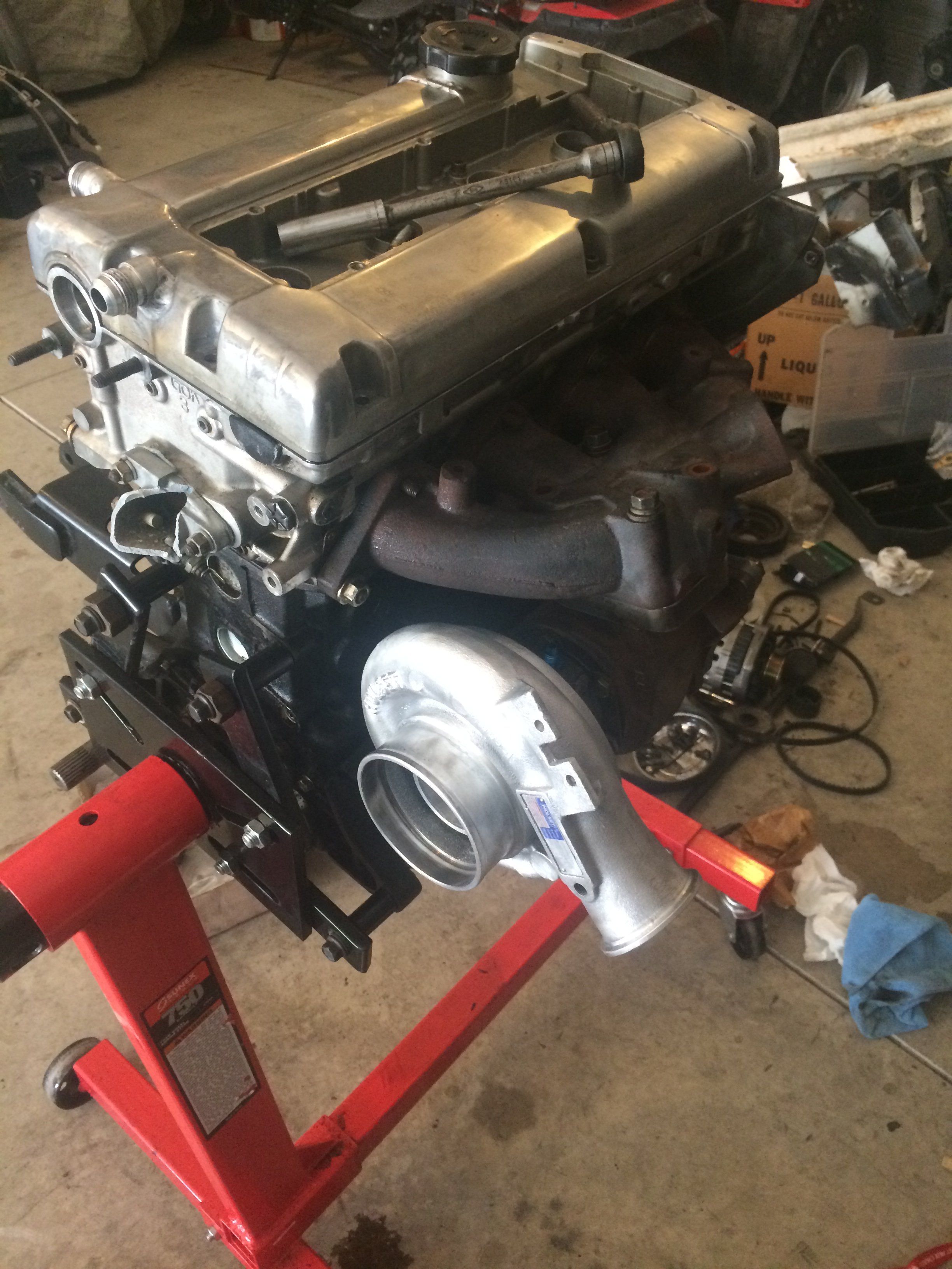

Motor:
Stock bottom end 7 bolt 1994 (1g)
New front case with Balance deleted
I switched the case to 1990 straight cut gears
Arp head studs
Cometic MLS head gasket
Head:
2g Head
comp state 3 cams
Dual valve springs and titanium retainers
3g lifters
Trans:
IPT shift kit
IPT end clutch kit
Kigly front clutch basket
Forced four shift box
Arp flex plate bolts
stock converter :/
Turbo
Hx35 with fresh rebuild from justin
-12 an drain welded to oil pan
-4an feed from ofh
Oil pressure gauge to check to see if i will need a restrictor
Bep .55ar mitsubishi bolt on housing
SBR Manifold with 2 bolt wastegate
Custom 3" v-band o2
Side exit

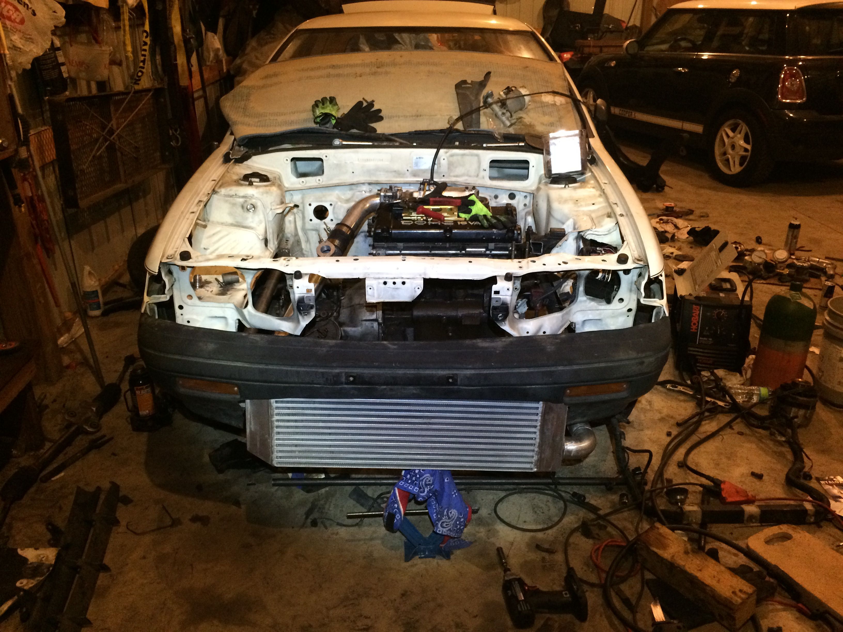

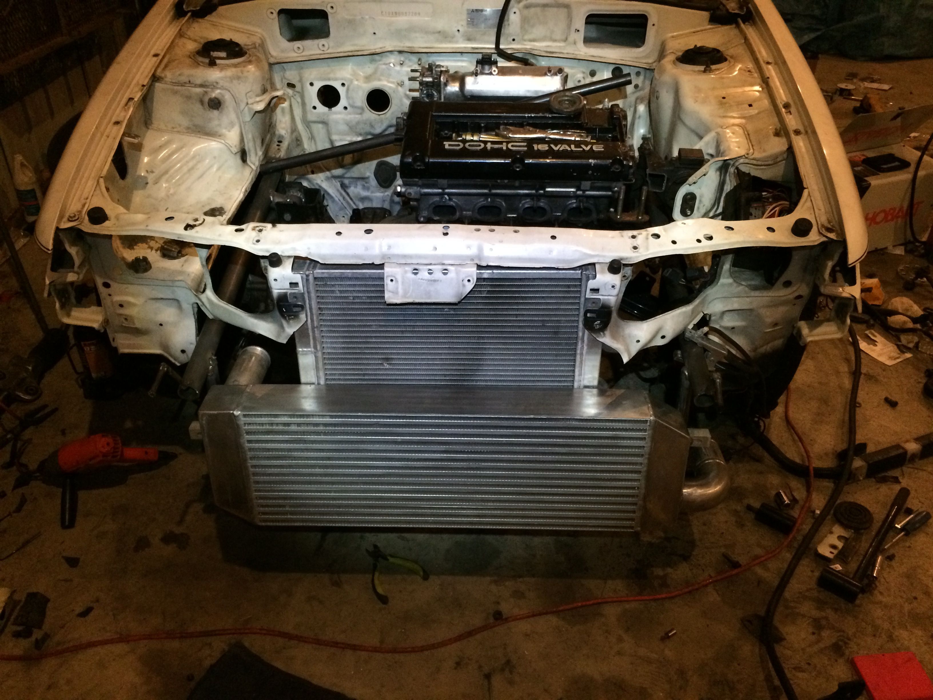

2g VRSF Intercooler
Tial Bov

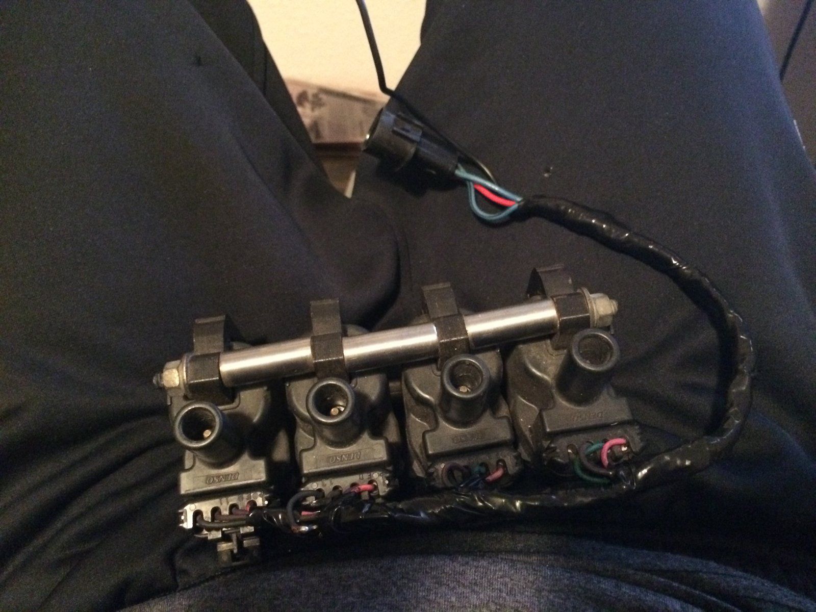

LS1 Coil pack

ITS OUT! Time to multiply its HP by 5x

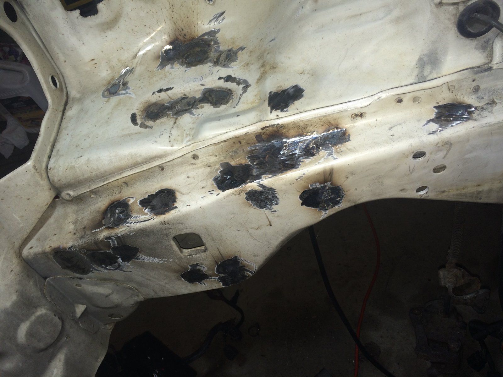

this rust really scared me... but its still solid and pretty much on the surface.. my roll cage should mount up in those spots any way... (after i weld in the steel plates)

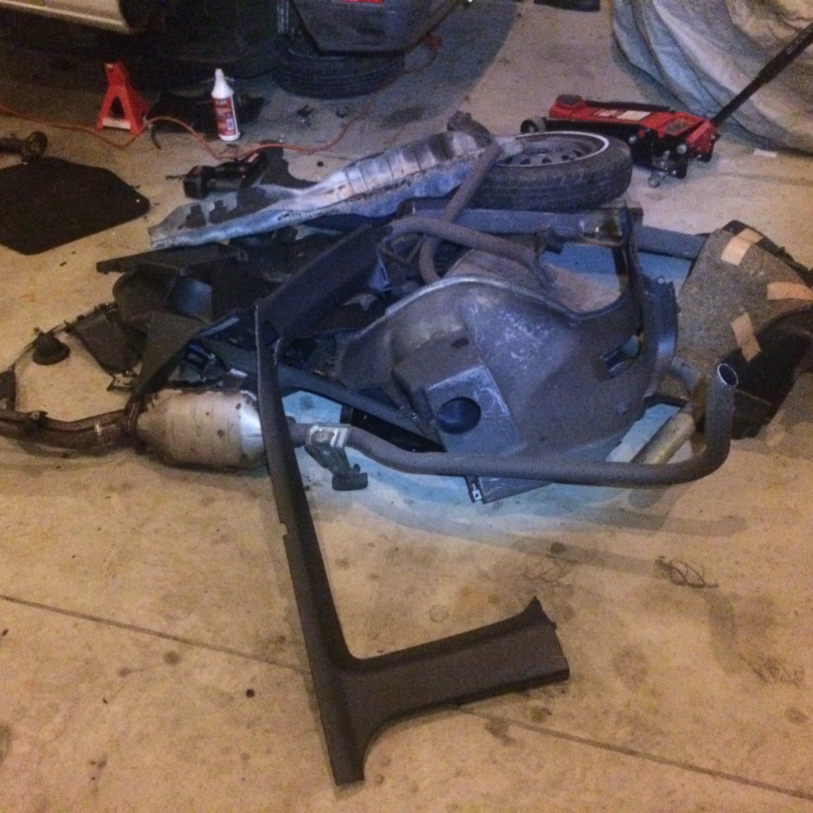

BOOOOOOOOOOM Rear suspension is out.
One major step.. Cutting out the spare tire well for the rear end to fit..

This car claimed a lot of cut off wheels...
Its out!!!!!!

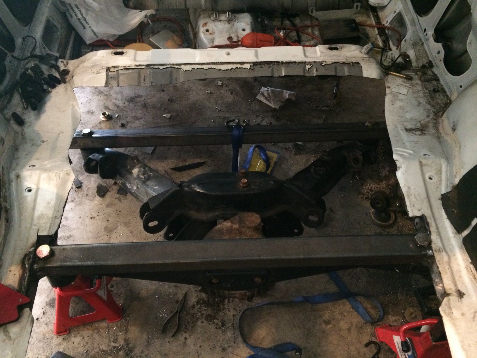

Starting to mock up the rear end!!!

TUBEFRAME!!!

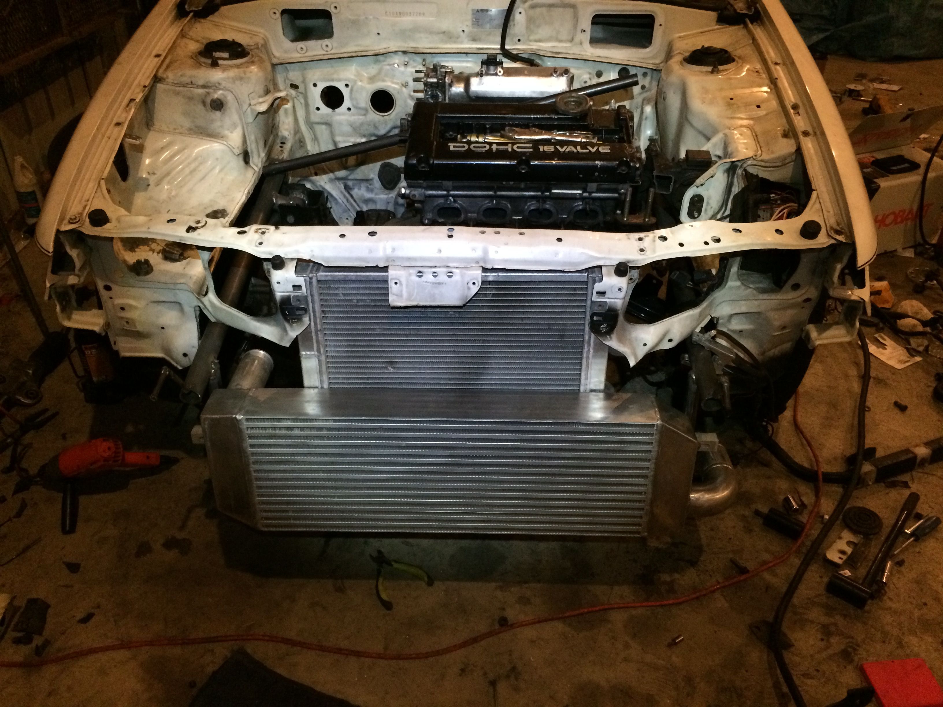

All cleaned up and chopped the frame rails out
Such an ugly weld on this side...
was still learning how to do major gaps
But im really liking how easy it will be to access timing/front case
This was honestly a pain in the ass to mock up...
The finished product
front motor mount turned out decently.
Rear end is completely in and bolted up!!!
