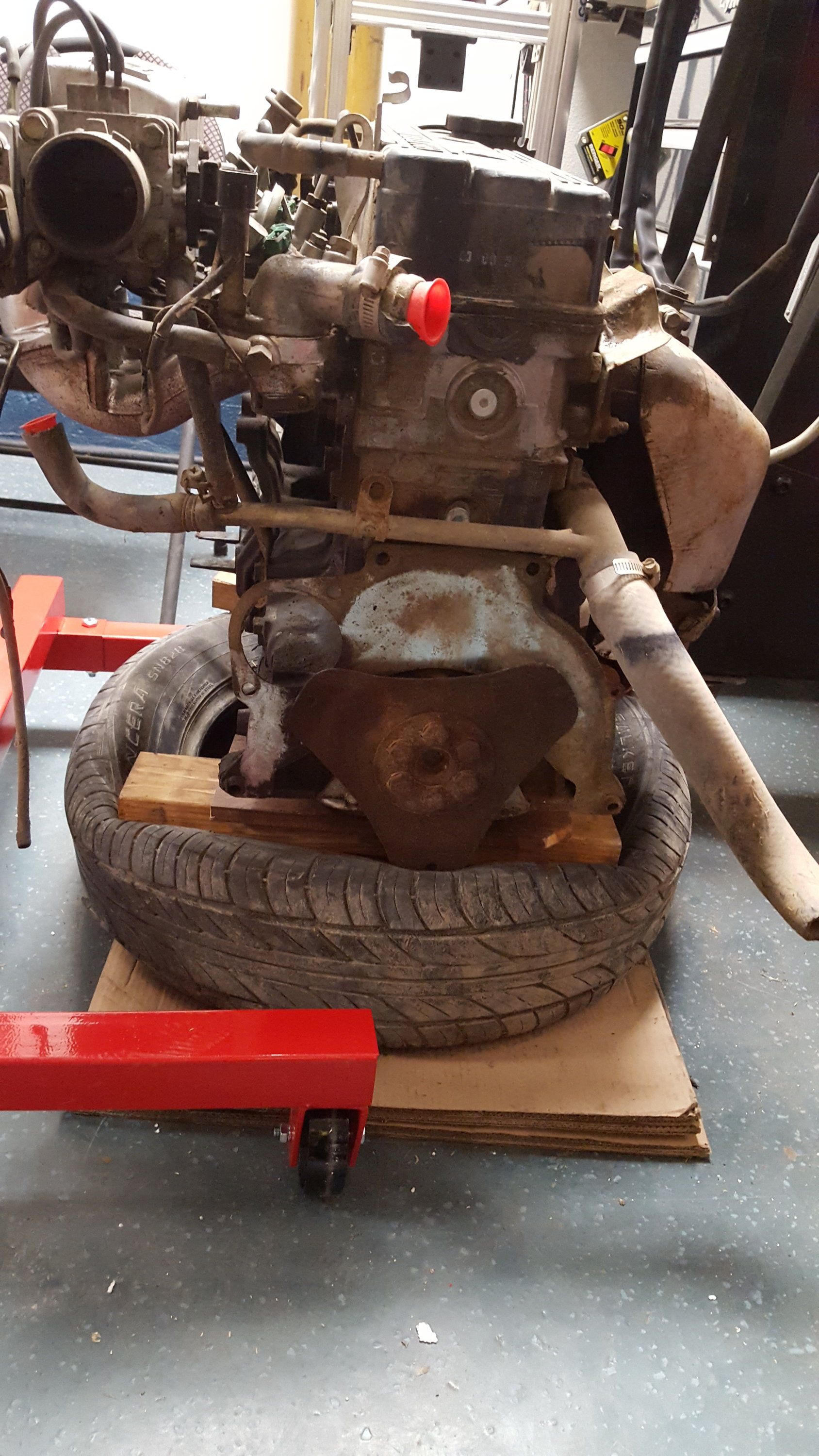

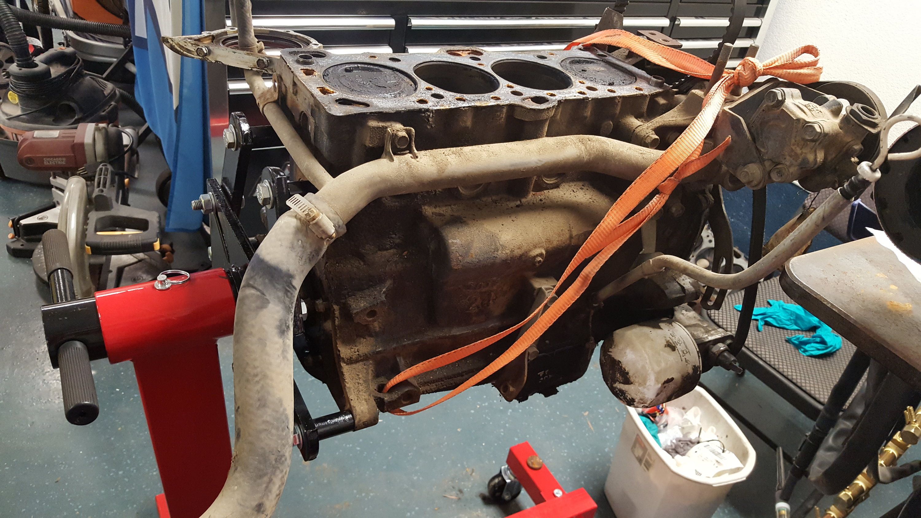

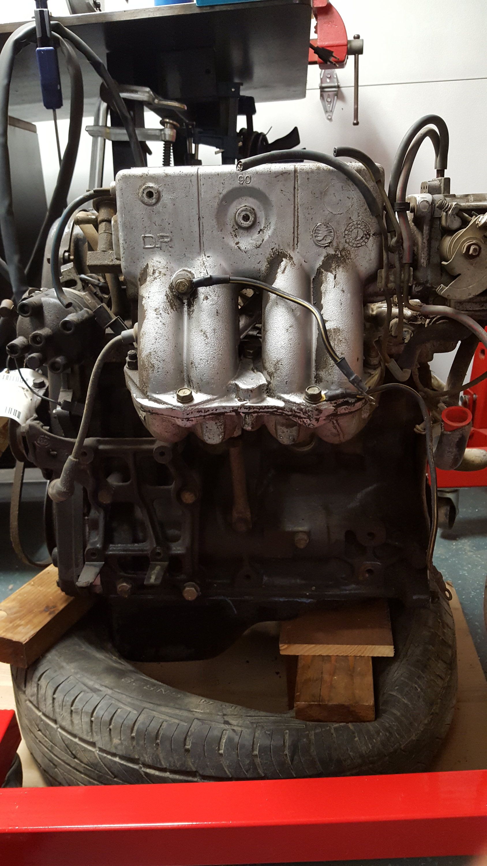

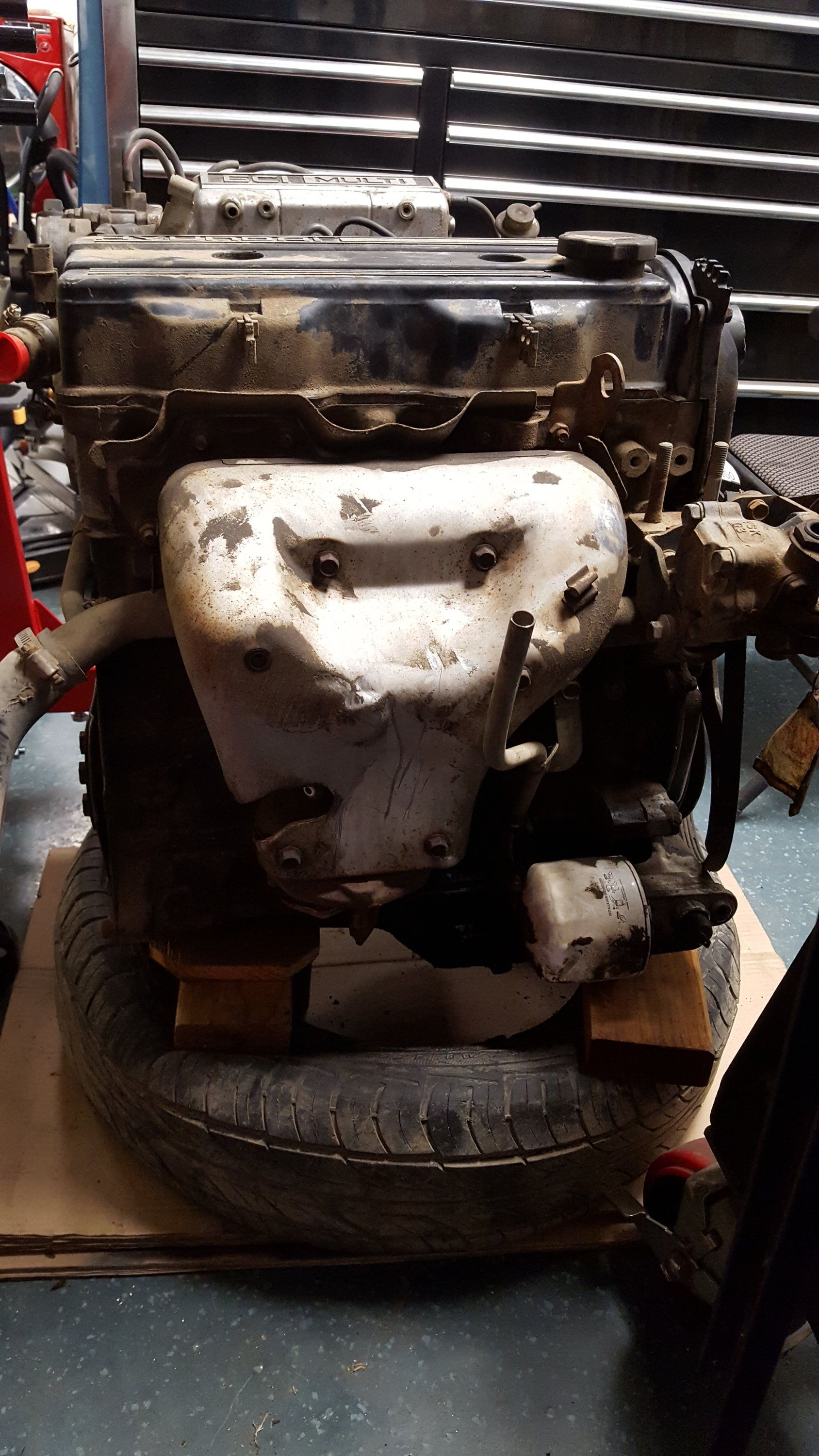

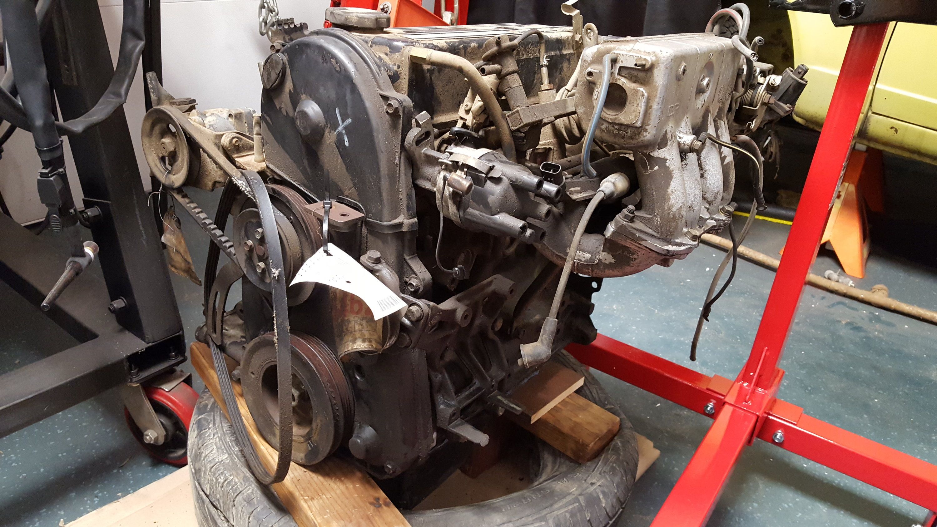

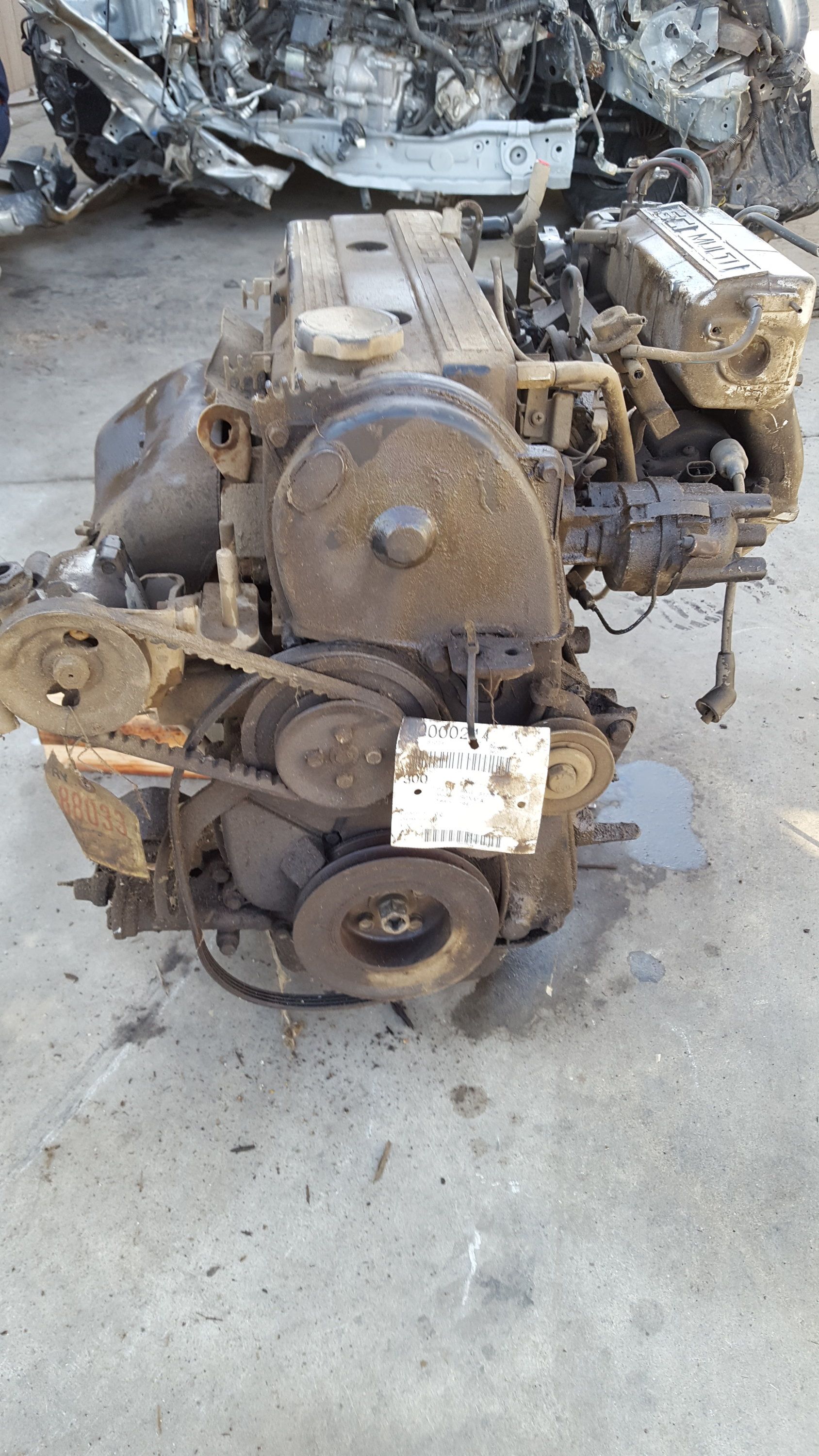

Just found a 6bolt G4CS ('91 Hyundai Sonata) motor. This is my first time seeing one in person. I'm posting pics in case anyone is interested in what they look like if you're in a yard and the block stamp is under caked grease layers. I was eventually able to find the G4CS stamp.
I will be breaking it down for inspection over the next few weeks. If anyone has any insider gremlins (non-service manual lessons learned) they'd like to share when breaking down this assembly, please share.
Stock G4CS motor out of '91 Sonata.
Original G4CS head removed.

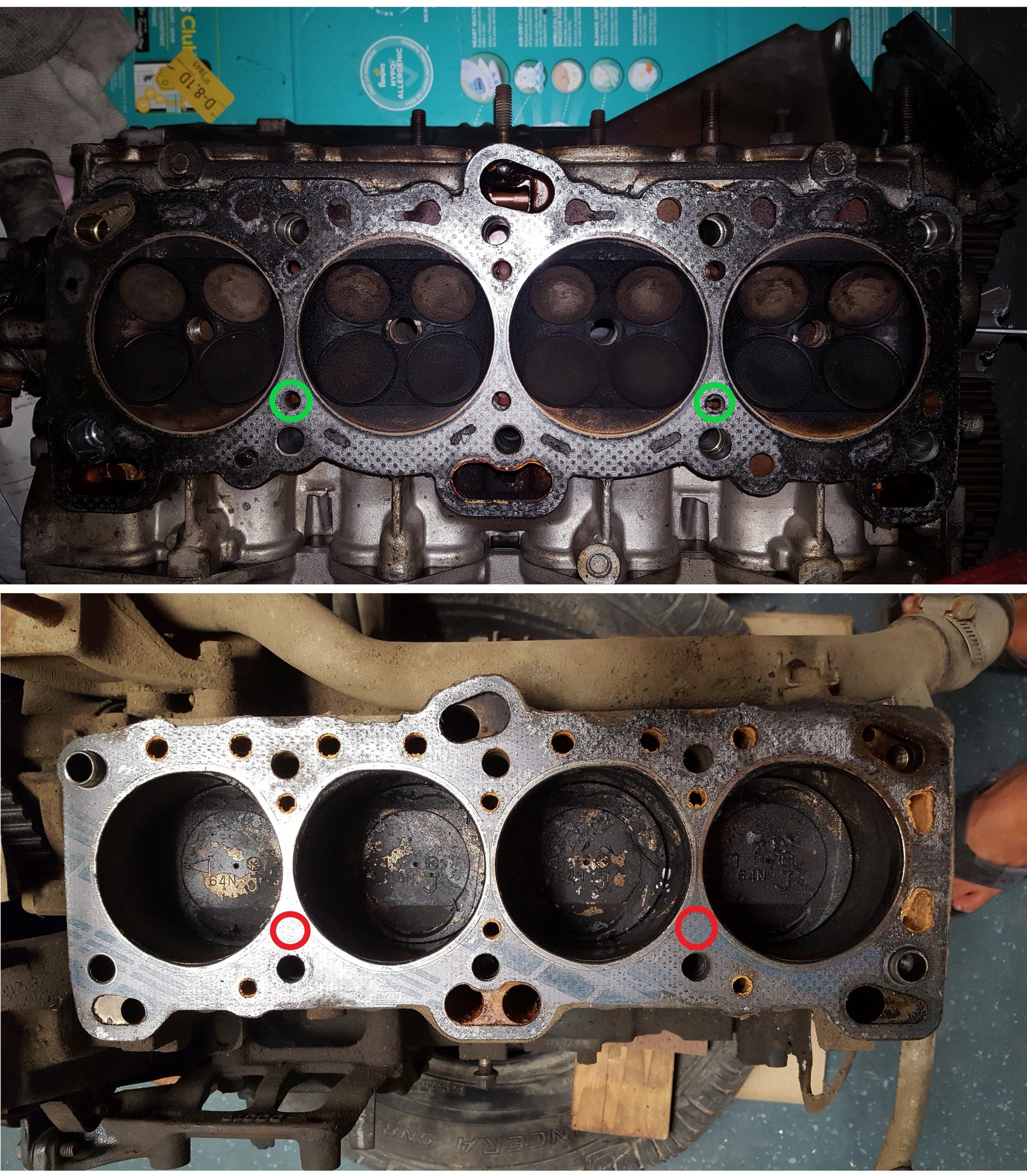

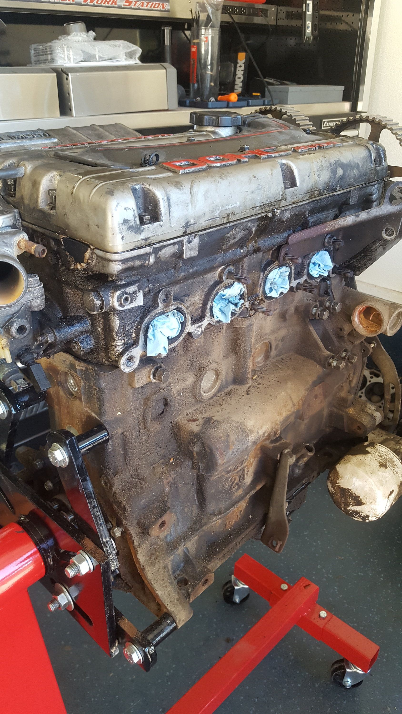

Alright, this needs some context before asking questions. I am using a '91 G4CS block with a '94 4G63 head (originally from OEM 7bolt NA engine). With that said, I am now looking at the head and block passageways for comparison. I noticed that on the 4G63 head, there are a couple of waterjacket passageways that don't match up with the G4CS block. The block simply doesn't have them machined. All other oil and water passageways seem to be present.
So I guess my question is... Do these missing passageways make much of a difference for, say, 600-650 hp applications? I am thinking it might be better to leave the block deck as-is to to keep as much block stability/rigidity/stiffness. Or are these missing passageways paramount to cylinder head performance? Please let me know if my logic is on track, or if I am missing some other performance parameters.
Installed the 7bolt 4G63 head onto G4CS block. It looks like this is infact not a mythical setup. I'm actually pretty excited that it wasn't a bust (knocking on wood as I type this). Anyhow, please don't grief me for assembling extremely dirty subassemblies. My plan is to assemble the engine and transmission assembly for fitment checks in the '74 Colt engine bay before committing funds to an actual performance build. I am now keeping the feelers out for a usable manual 2g AWD Transmission. Anyone have one laying around???
The missing water ports are the same as the 4g63, so no worries there. IIRC it's to force more coolant around the exhaust side.
Otherwise the engine is virtually identical to a standard 6 bolt.

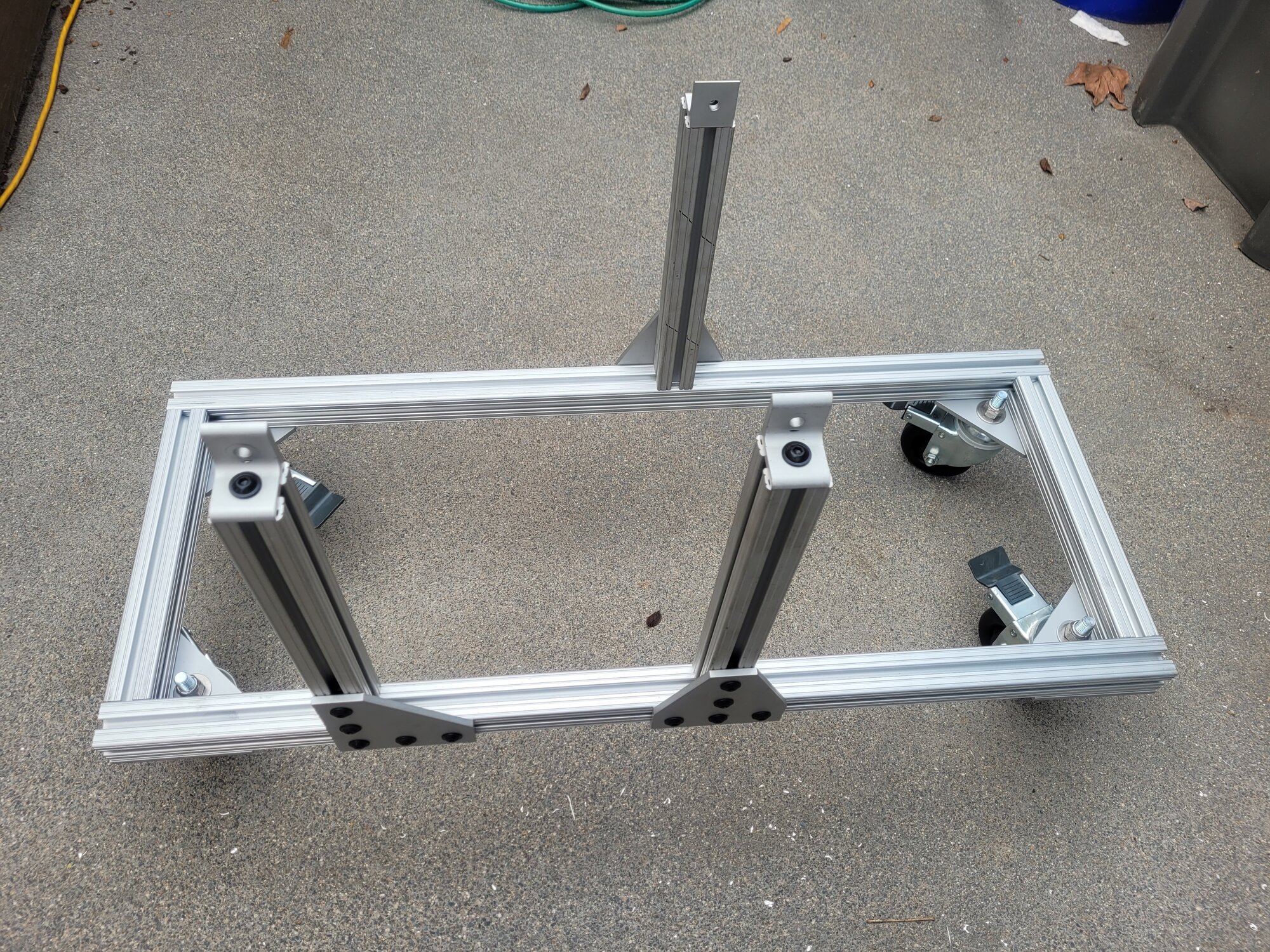

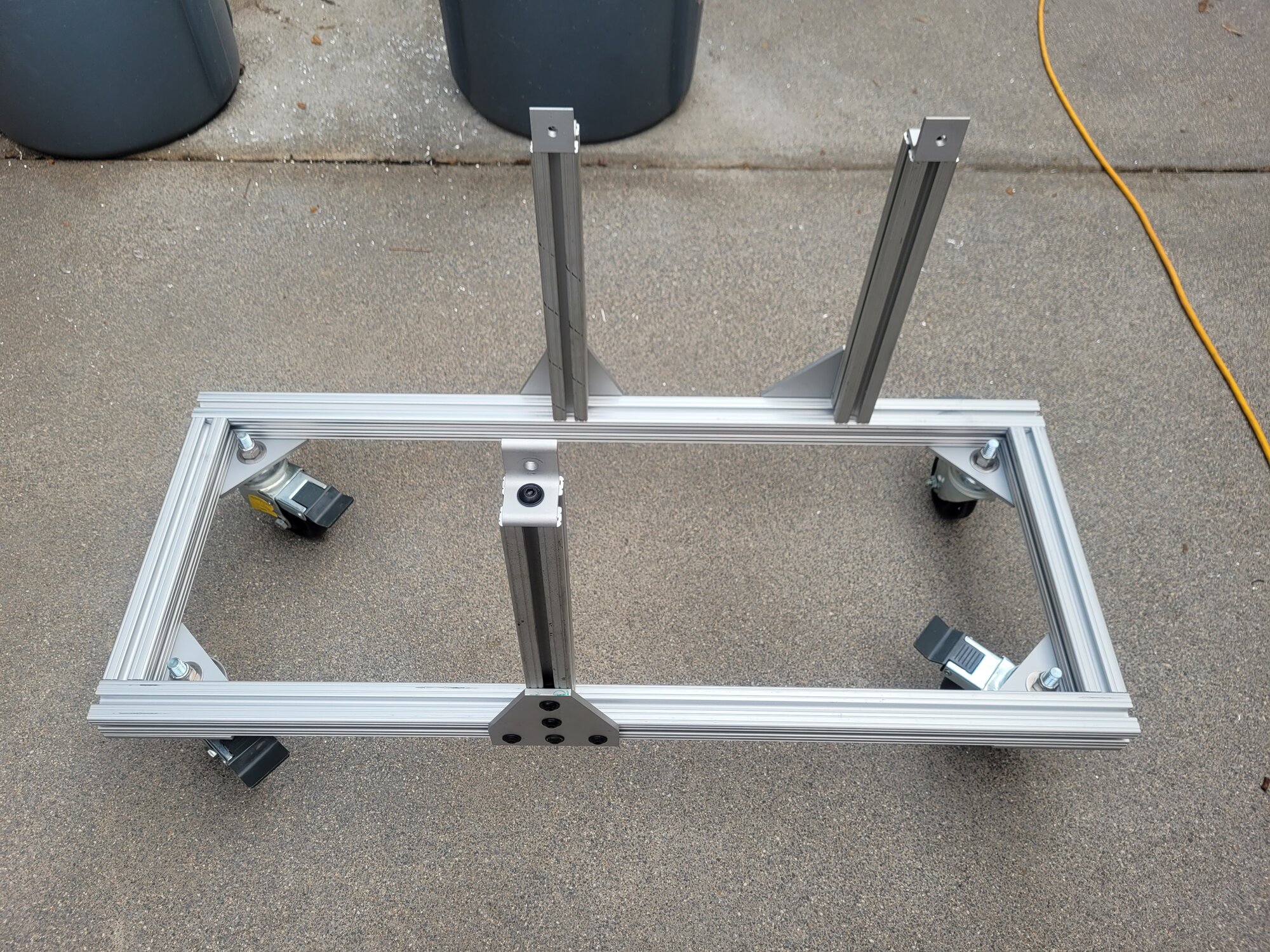

Life's been busy and has taken time away from the build. Add that to the impossible issue of parts scarcity and the the process has all but come to a halt. Alas some progress has been made. Proud dad moment... my 4 yr old and I built an engine cradle to mount the G4CS block and eventually the 2g trans for more mockup capability. We'll see if we nailed it or not in the next couple weeks.
