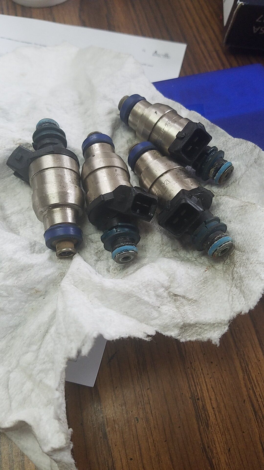

Well it's been almost a year since I was able to drive this car in my collection so today I went out and pulled the old fuel injectors, sure enough they had E85 crud on them. I grabbed a fresh set of 1100 FIC's and put them in with the injector resistor delete plug, hopped in the car and she fired right up. It's time to go for a drive!
I had to redial in the tune as we are back on Gas now but she feels soooo nice! :thumb:

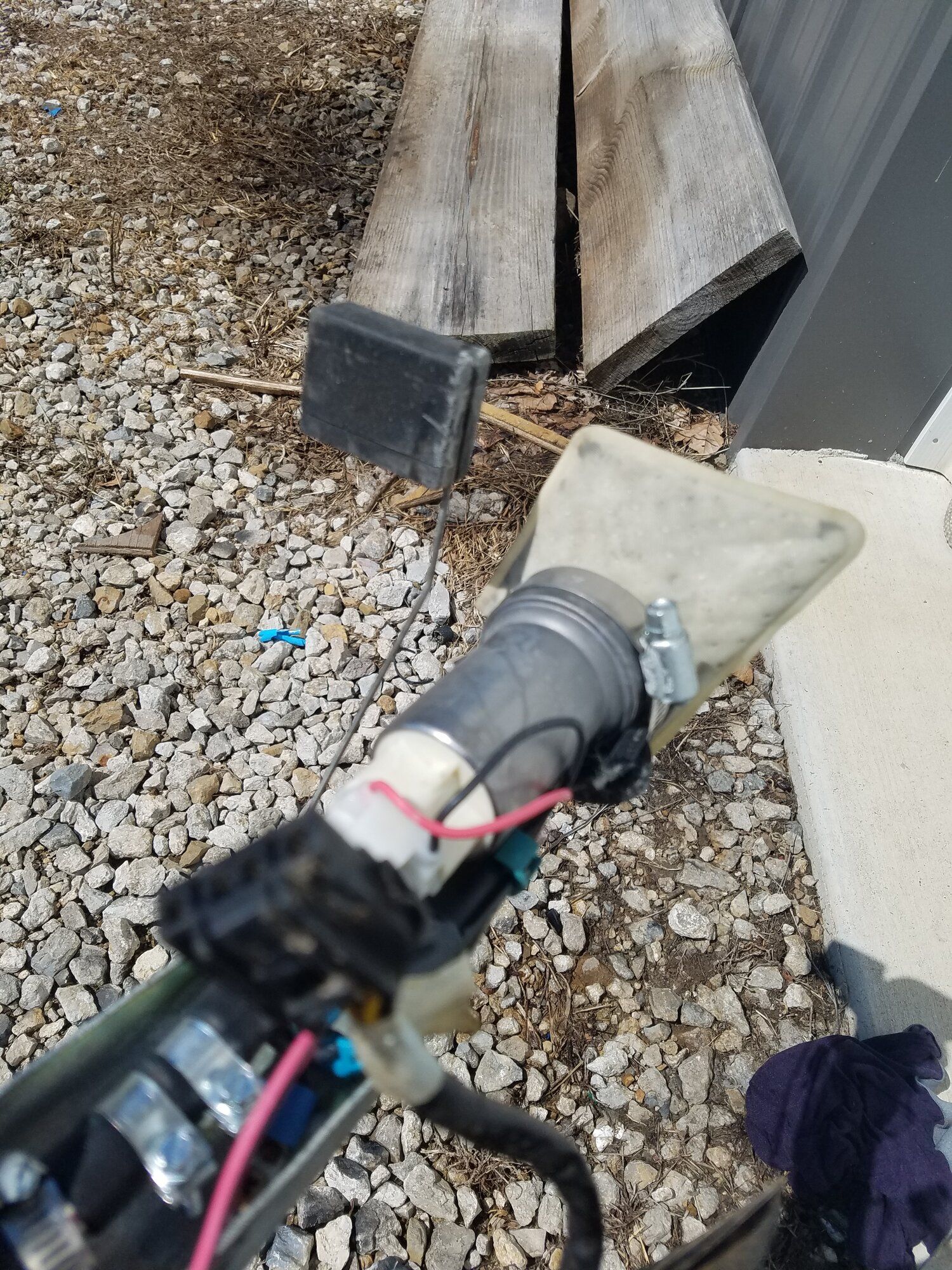

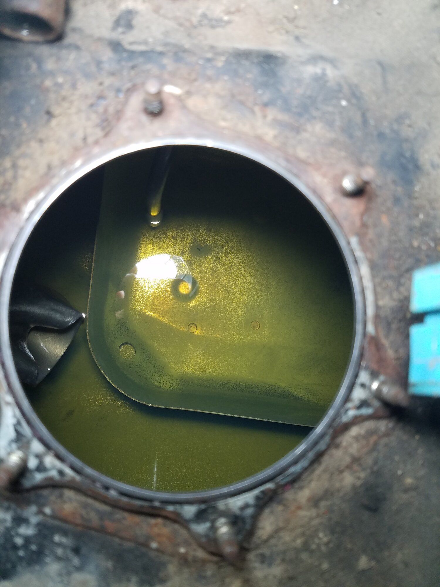

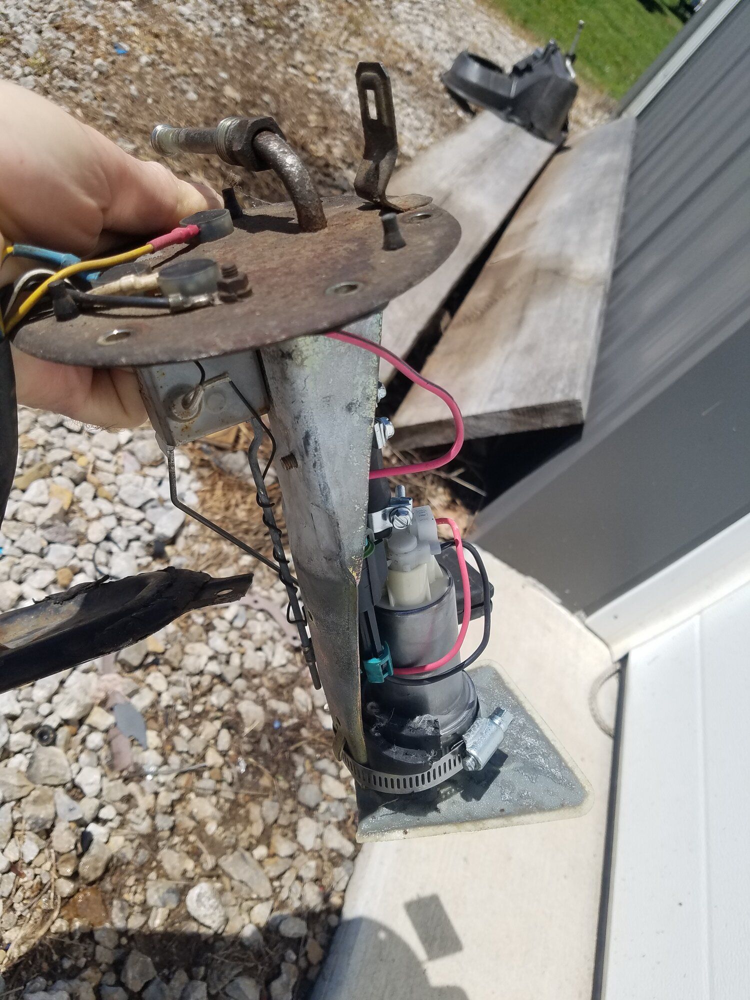

The cruise showed a few issues with fueling still so I need to pull the pump and clean the sock then retest. It was running pretty good then geadually deteriorated. Just a update. Thx for following!!

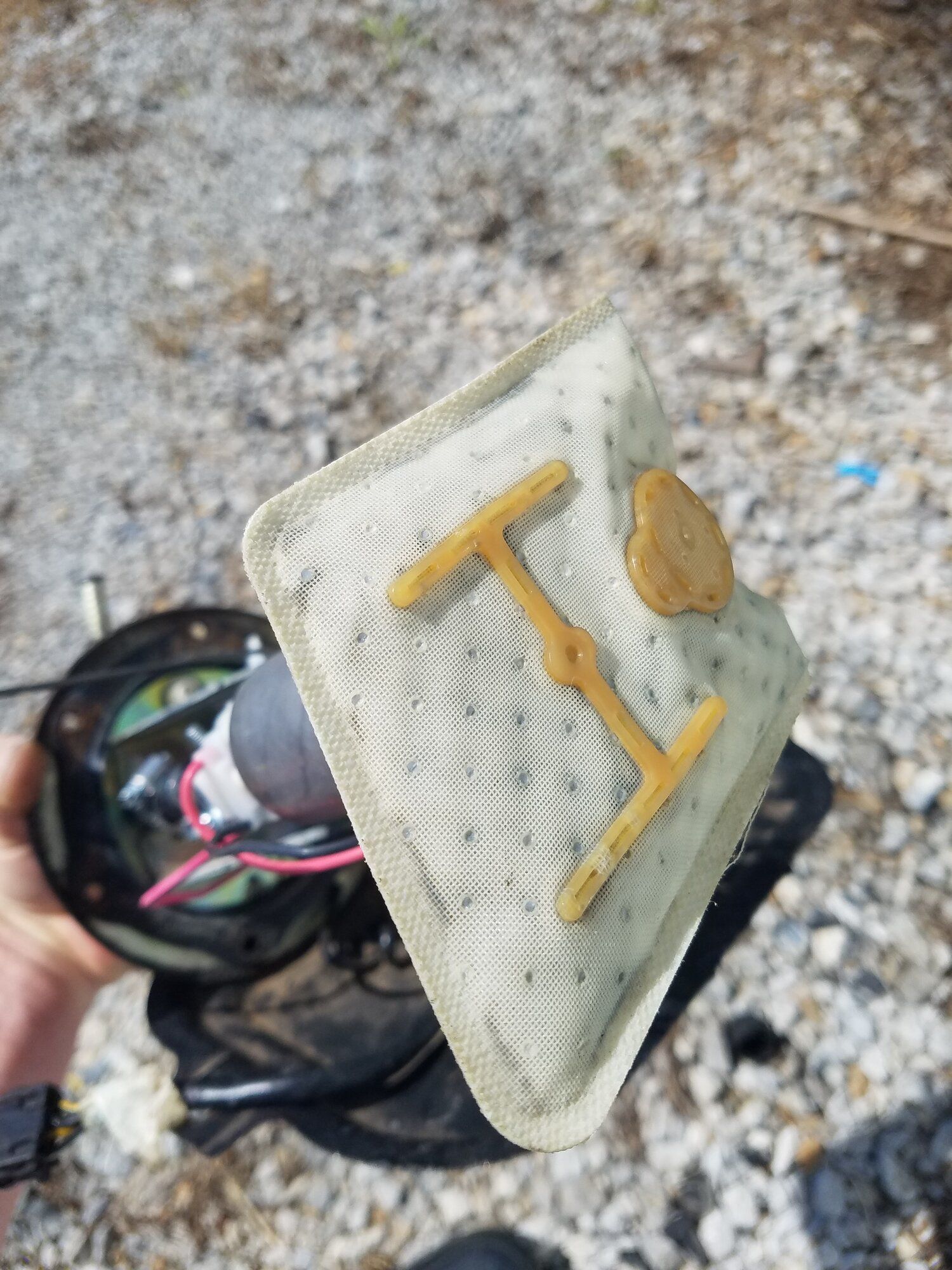

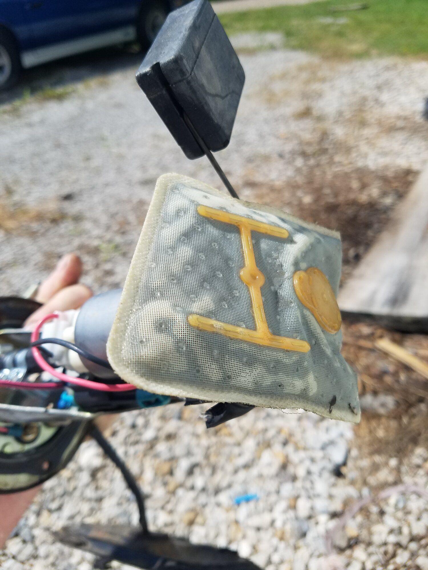

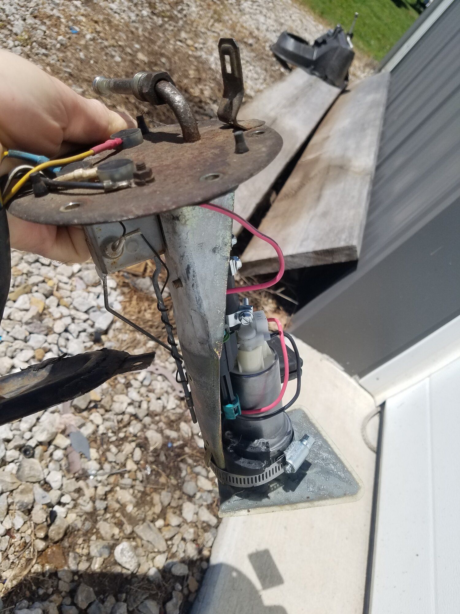

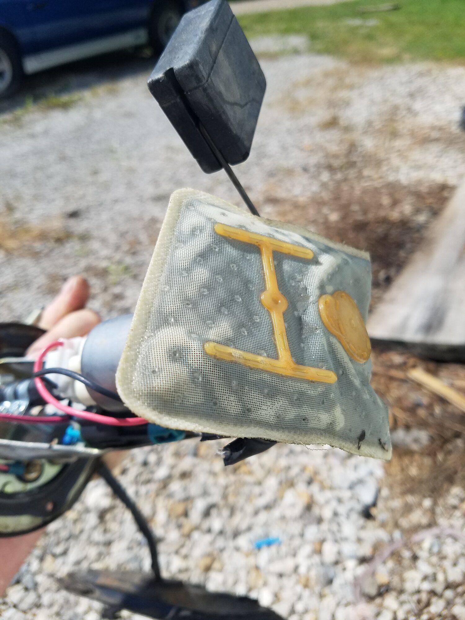

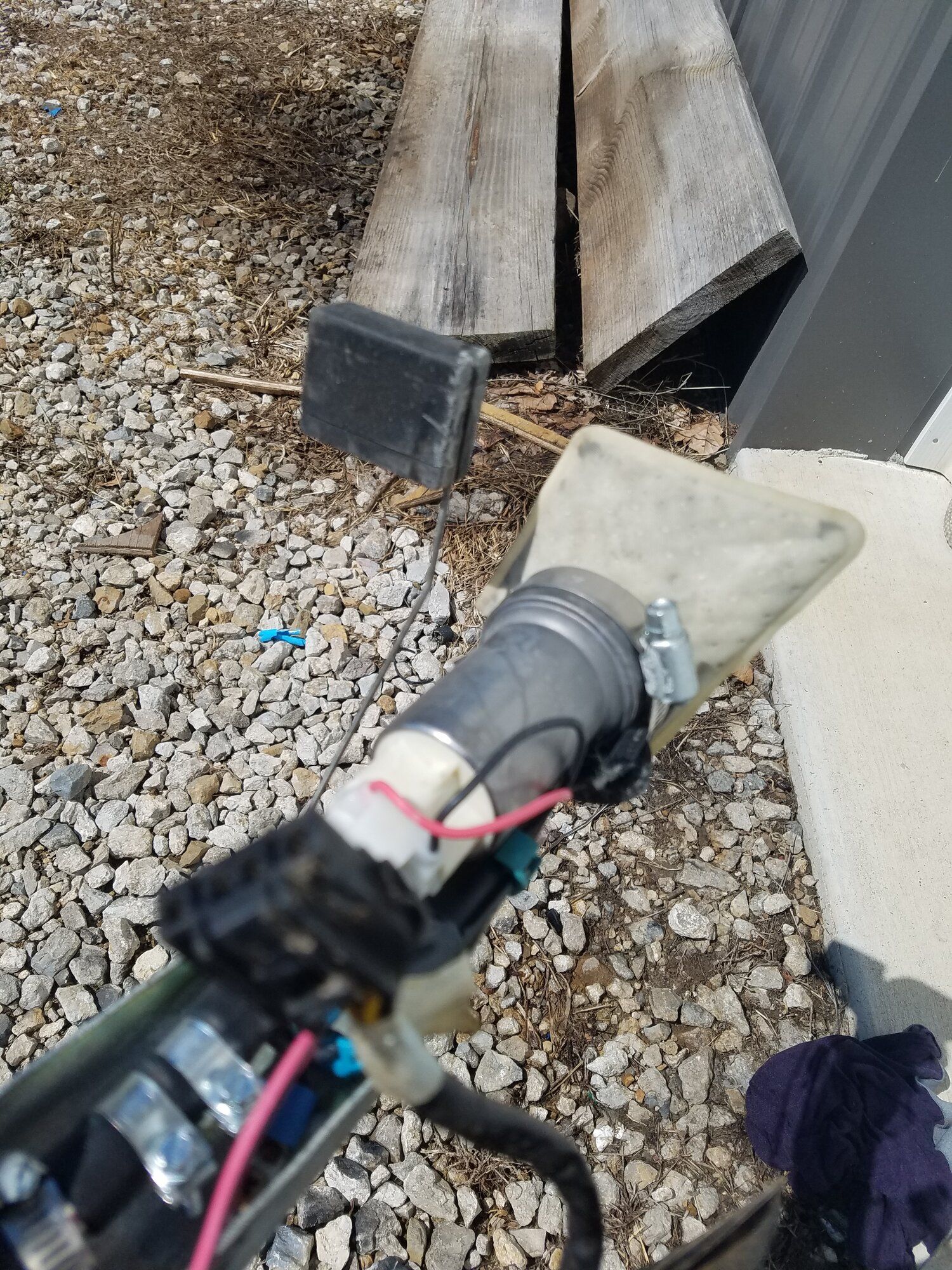

If it QUITS RAINING today, I will pull the pump (since I seem to have A LOT of experience at it), clean the sock or put a new one on (Rockauto Clearance Item). I just want to drive my car and I put her on the back burner all last year when the Blue 92 was giving me this issue (same fuel, I'm sure the tank needs cleaned). Soon to be solved and running and dependable but not fast (because we can only have 2 out of 3). Fingers crossed! 🤞🤞
Marty
Seems like there must be some kind of additive for Ethanol that keeps the jelly from forming. Seems like a real PITA if you have to keep breaking open the fuel system and scrubbing it out. Maybe a bit of methanol??
I really think it just came down to old fuel and in an environment that wasn't climate controlled guys. Fresh E in the Blue 92 and 91 Gas in the White 90. :thumb:

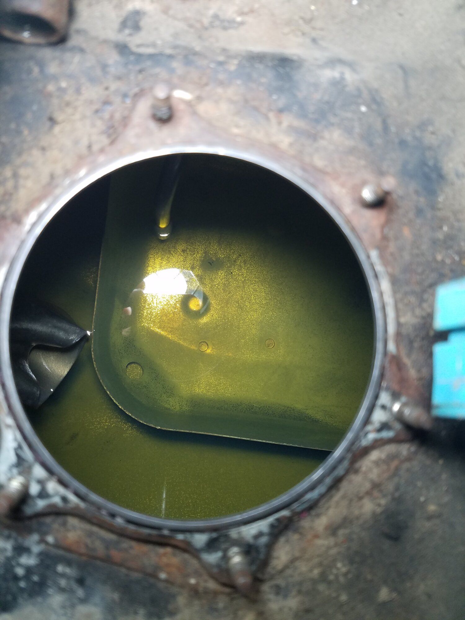

I cleaned the pickup and what I could reach with a rag in the tank today, same slimey shit. I then pumped all of that out and put 5 gallons of fresh 91 in her after cleaning the pickup and the parts of the tank I could get too.

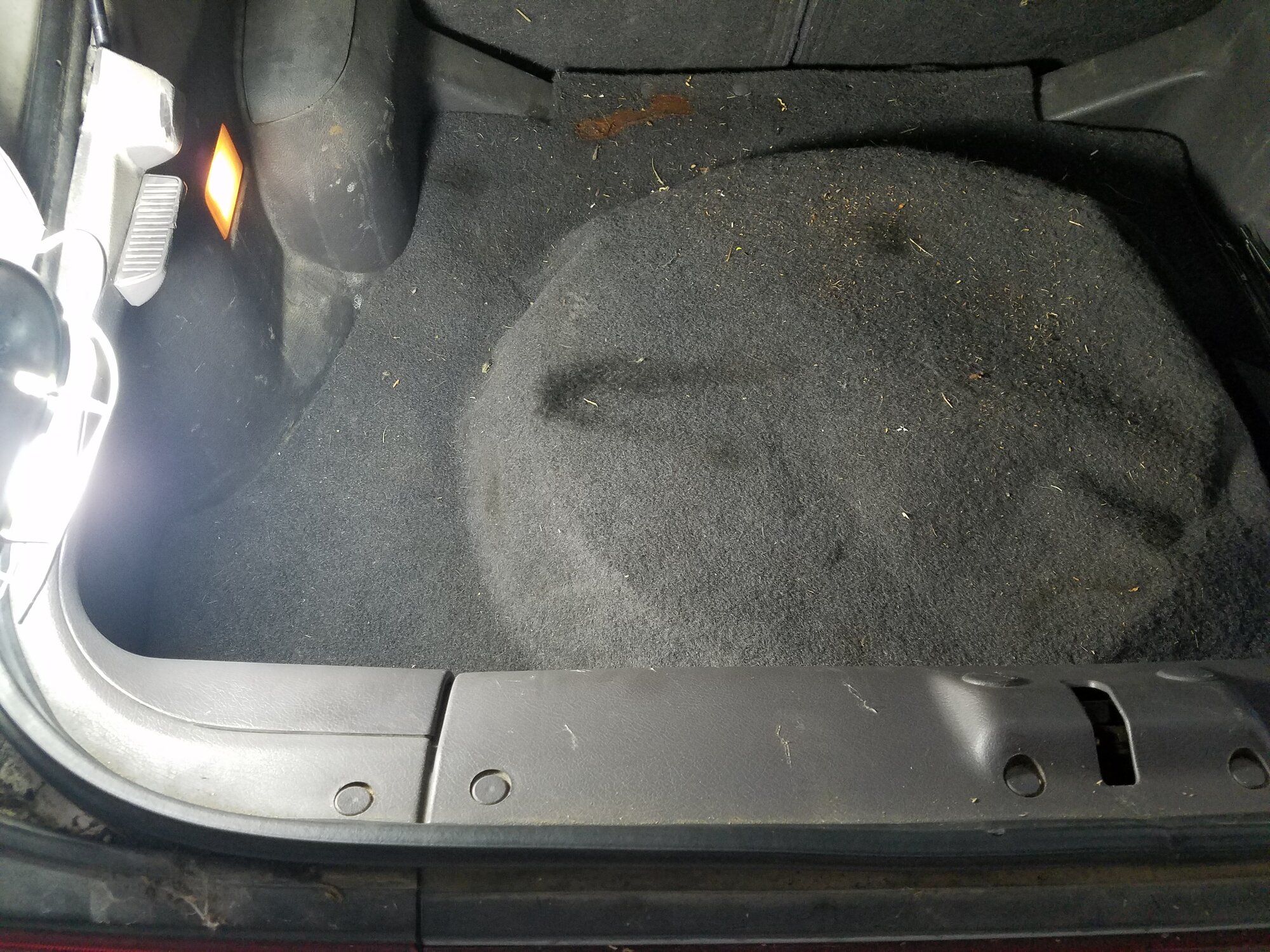

I forgot how "stock" she still was ROFL
Old ramps for my mower sitting outside my shop door and new gravel coming for the front of the shop whenever it quits raining! :)

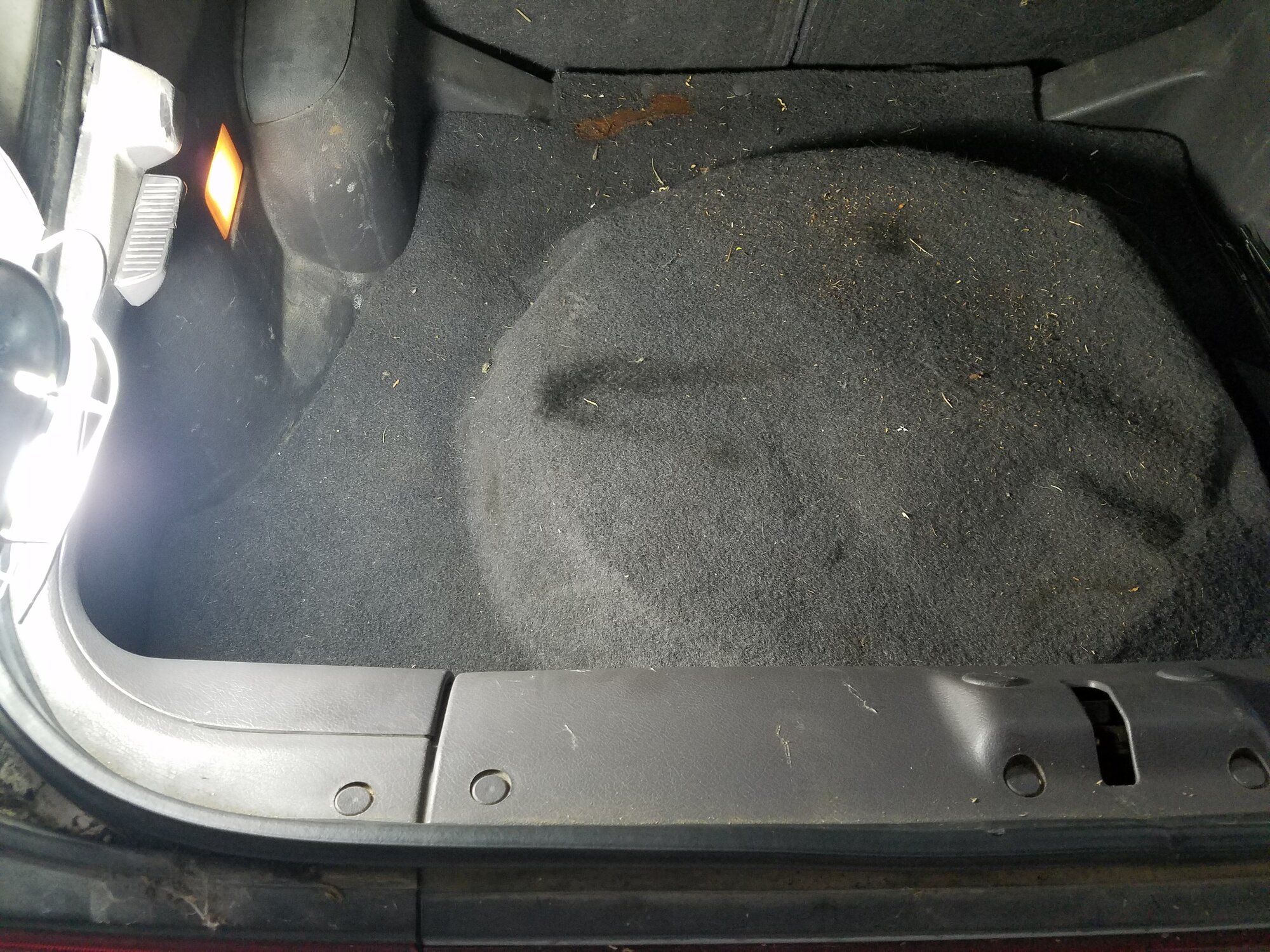

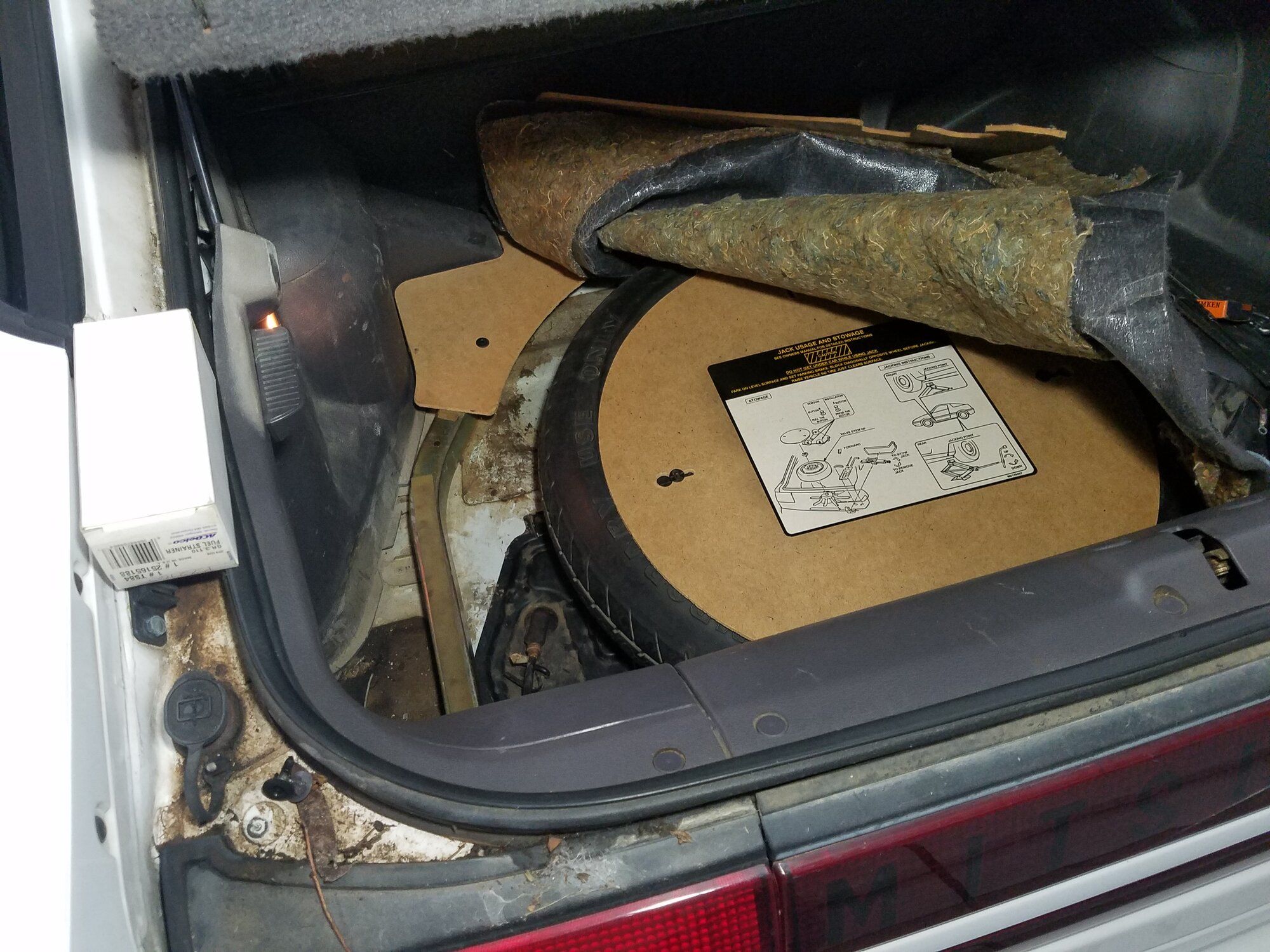

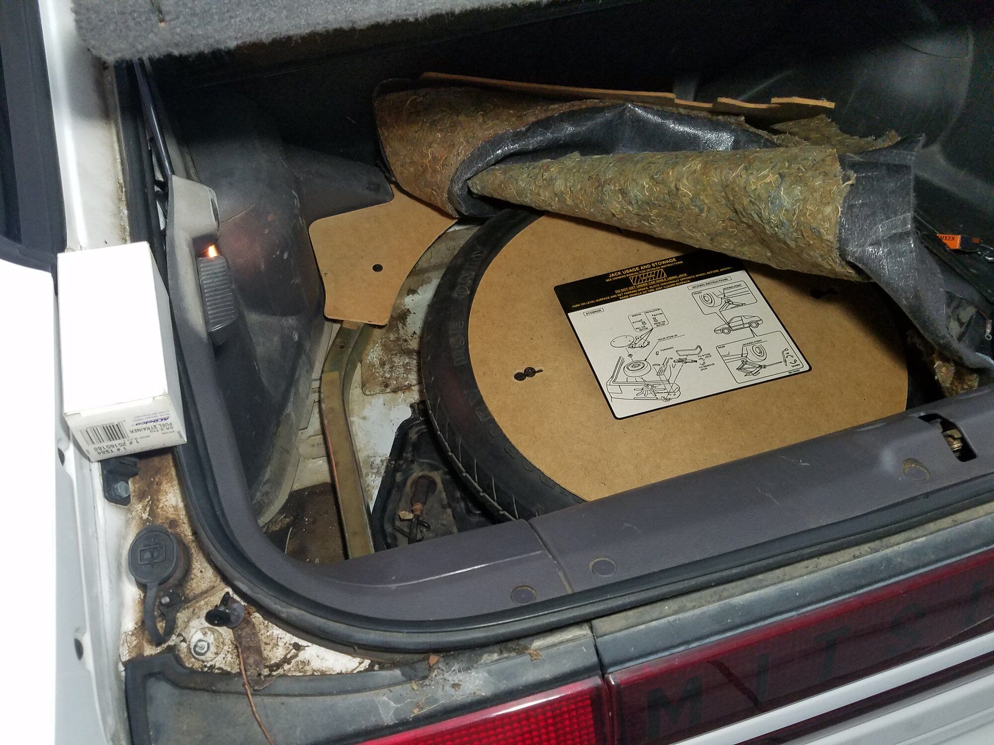

You have all the original parts for the “luggage room” as the parts catalog describes it. I have one of those same mini spares. Not sure that 30 y.o. donut would be better than riding on the rim.
