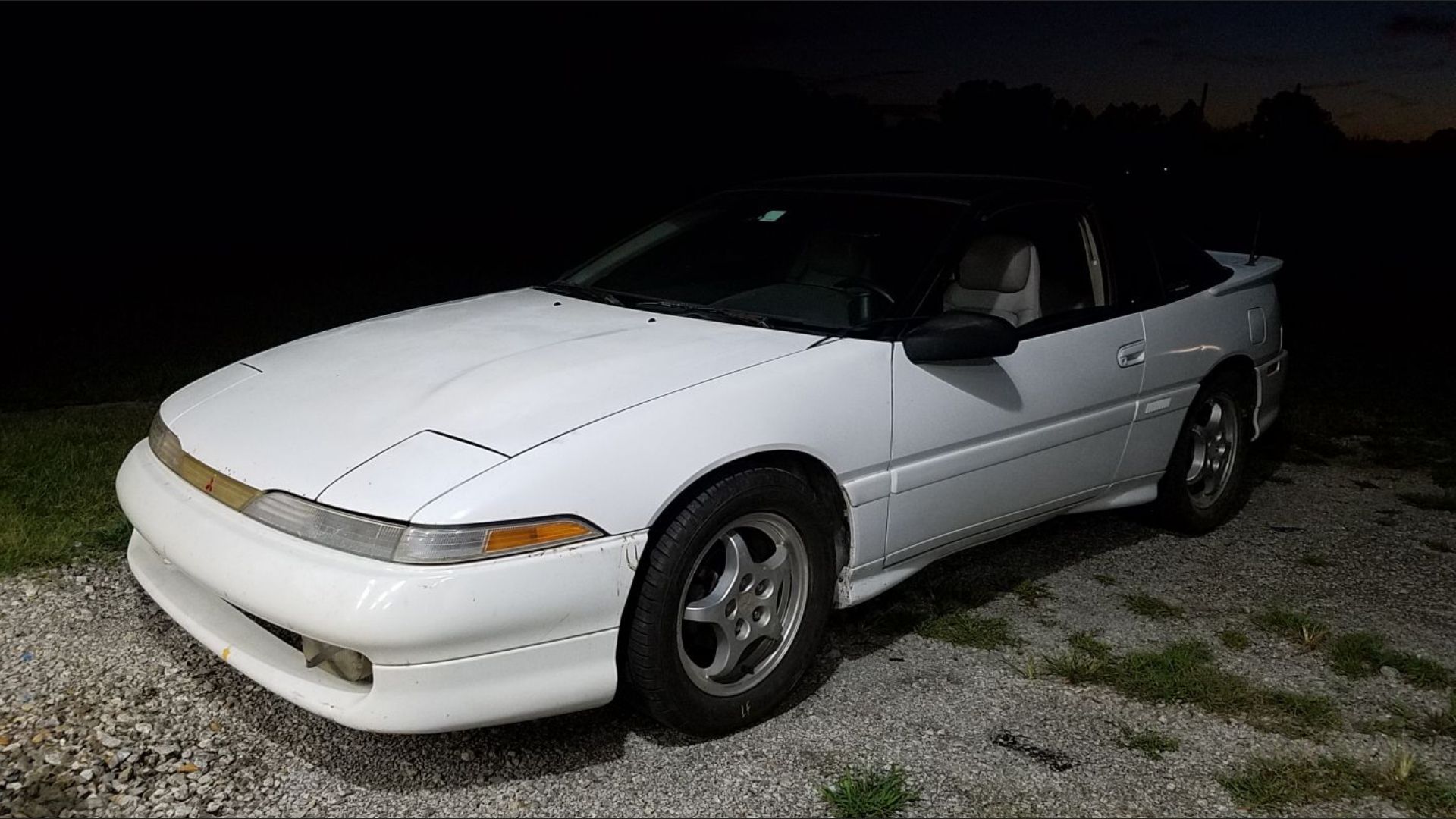

1990 Mitsubishi GSX
Nice clean stock (almost) survivor car that the guys just didn't know how to work on so it came to the 1990 DSM Graveyard (My Place) to get freshened up and enjoyed!
"Project unknown". Ahh yes, sounds very familiar!
There was a mods list that included things like "Tine Coilovers", "Fuelube FPR and Filter", "blown turbo with zero shaft play", LOL
I have a parts car to finish pulling apart before I dig into this one. I actually raced him a couple weeks ago and this car was very quick. Not quite as quick as mine (also 50 trim) but quick enough that I knew he wasn't on a 16g. The car wasn't smoking at all, at that time. Since then it started pouring smoke, and it looks like the exhaust is getting oil dumped straight in. The turbo is toasted, but maybe rebuild-able.
I initially wanted it for parts, but after seeing how straight the sheet metal is, there is a chance I send it off for paint this winter instead of my silver car. then ill swap it all over into the painted shell in the spring.
Or maybe it will end up a drag shell?
Or maybe it will end up a parts car?
Or maybe I will fix the oil leak and sell it as is?
Project Unknown!

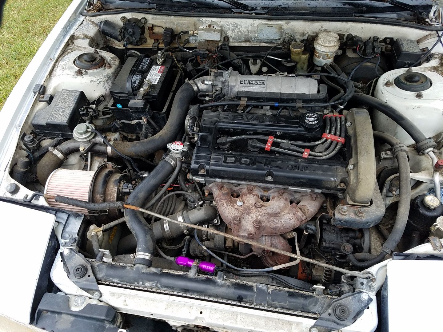

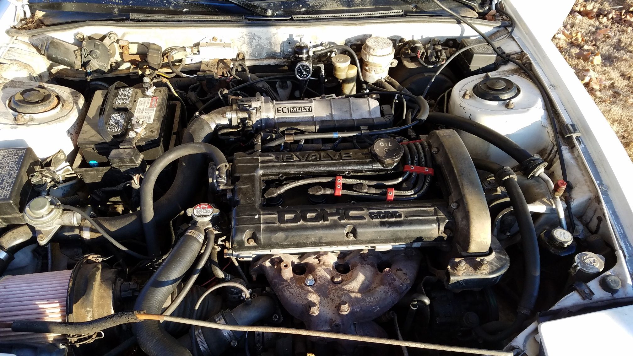

Well......after fixing ALL the stuff.. she runs good.
New HKS 264/272's, a timing belt job AND putting the CAS into the correct orientation sure helps them run better.
I am just rolling my eyes AGAIN...about previous DSM "mechanics".....but its a good feeling knowing you saved a car that shows over 200k on it.

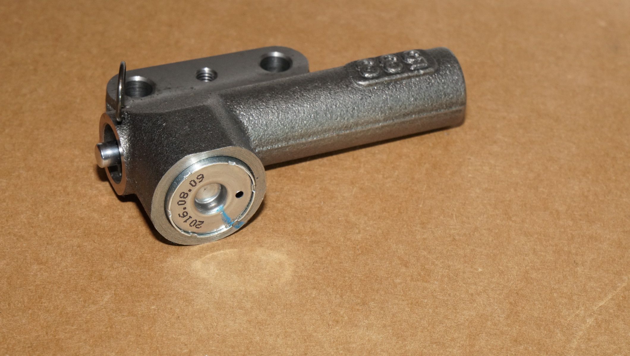

Last week I ordered a new OEM timing belt tensioner, partly to see what date would be on it. Would it be newer than 2015?
It says 2016.
Kind of inconclusive as to whether production has ended or not.
Here’s a photo. This tensioner came from STM.
It came in a bag that says “Made in Korea”. I noticed that the Gates and ACDelco tensioners shown on Rock Auto say “Made in China”.
I’d be interested in knowing if anyone gets one of these newer than 2016!

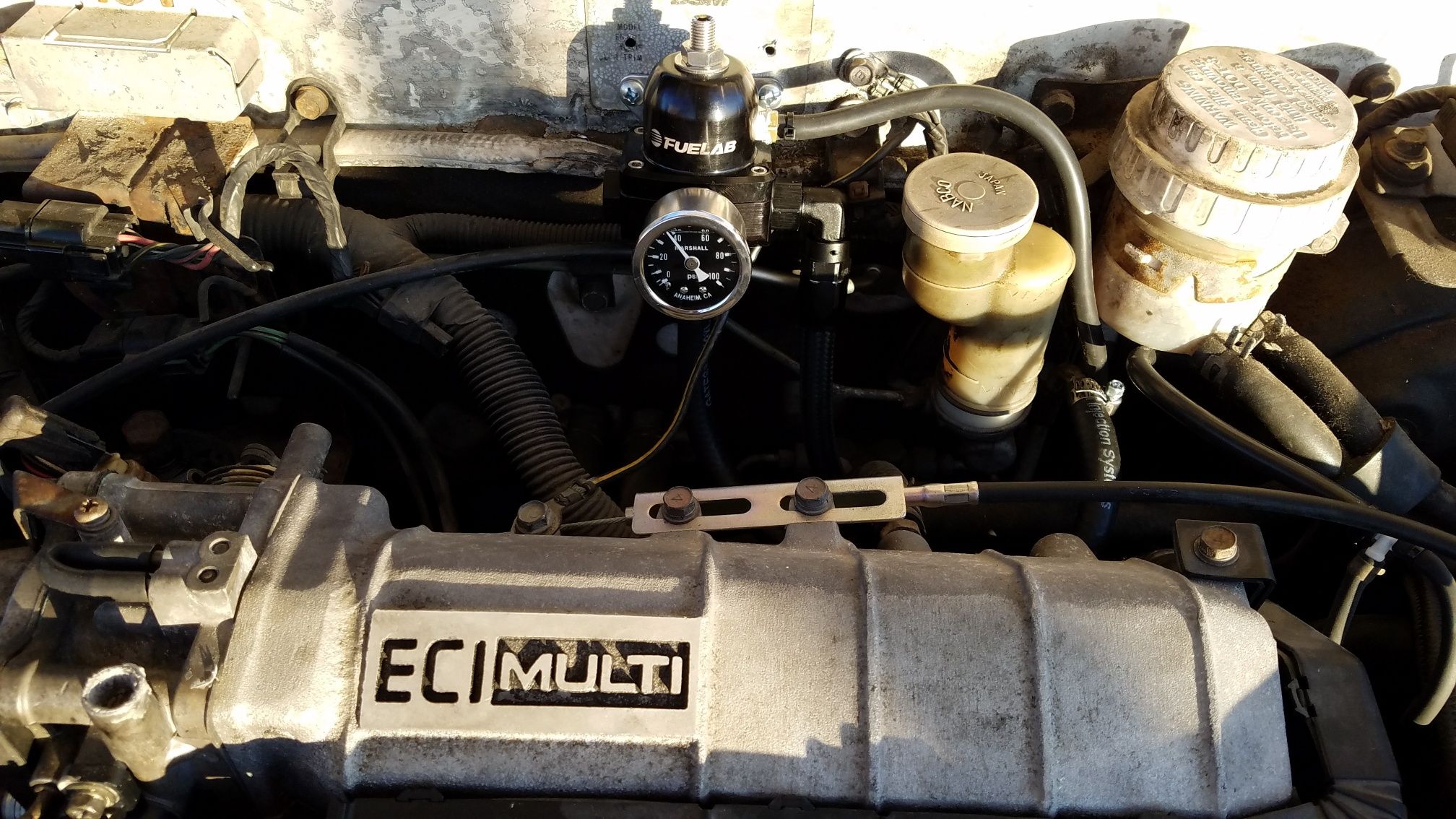

So the "Phantom" GSX had a fuel pump that was loud when I got her and has become very quiet now so I swapped in a Wally 255 that I had and put on the AFPR that came with the car. Got in a hurry as I wasn't feeling the best and forgot to put the Ethanol sensor in line, I will get that in. Adjusted FP and took her for a drive only to have the radiator spring a leak (the odometer says 294k). I had been smelling anti-freeze but couldn't find it anywhere so it must have been seeping. Well that went to a trickle last night so back into the shop last night, and a radiator swap is going to happen today or this week so I can drive her again, which is so much fun now. I had to put my spare 90 GSX shifter in, as the original was the sloppiest I have ever seen (I will rebuild it for later use). I have all of the parts to put the FMIC on and an FP mani/16g setup just laying there off of my Blue Talon, so that is going to happen very soon also, with the FIC 1120's and then she is done with upgrades and going on SD. I have one last gauge to install and that is the AEM Wideband. As soon as that is in, the rest of the stuff will go on! Thanks for following along!

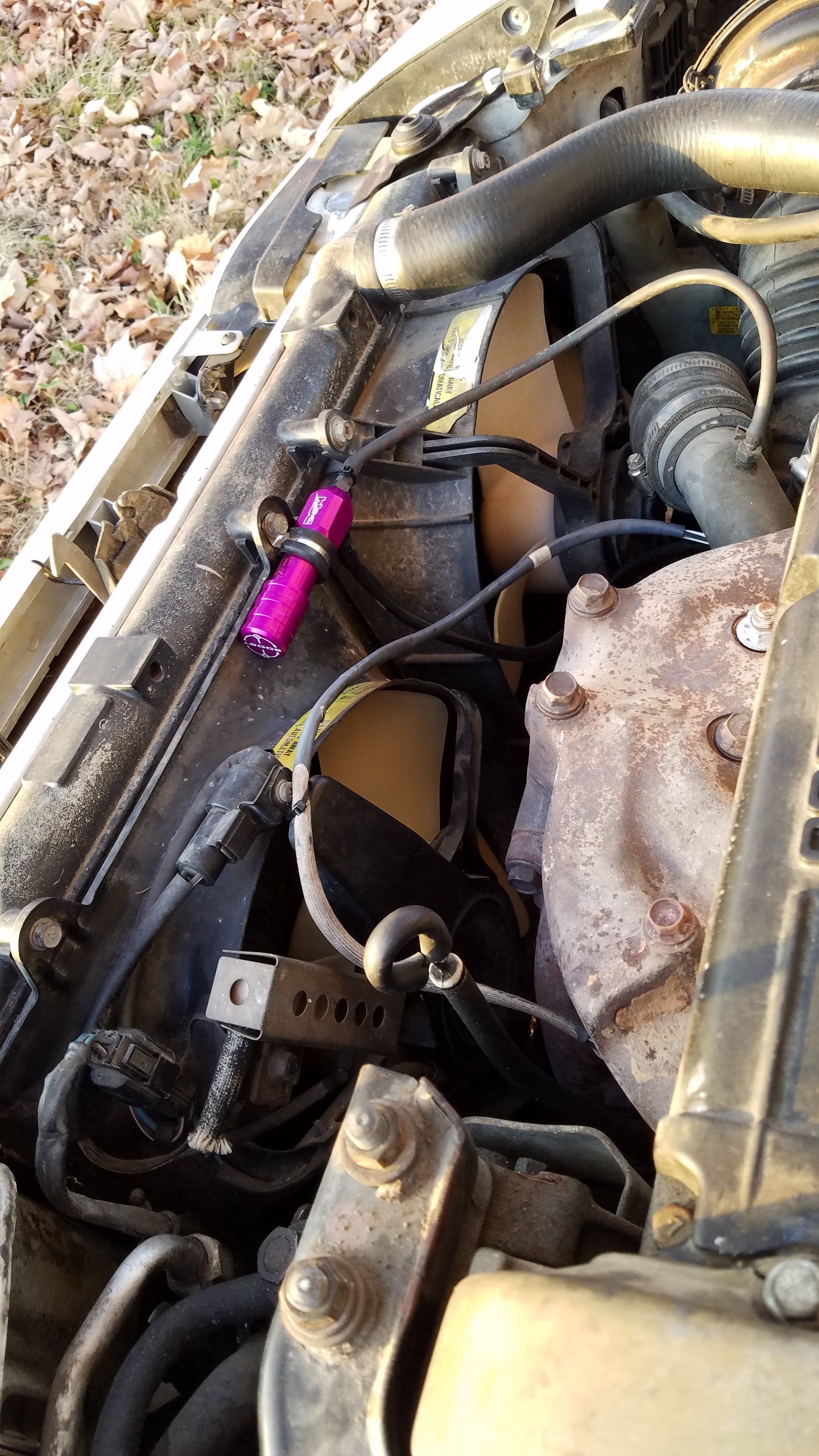

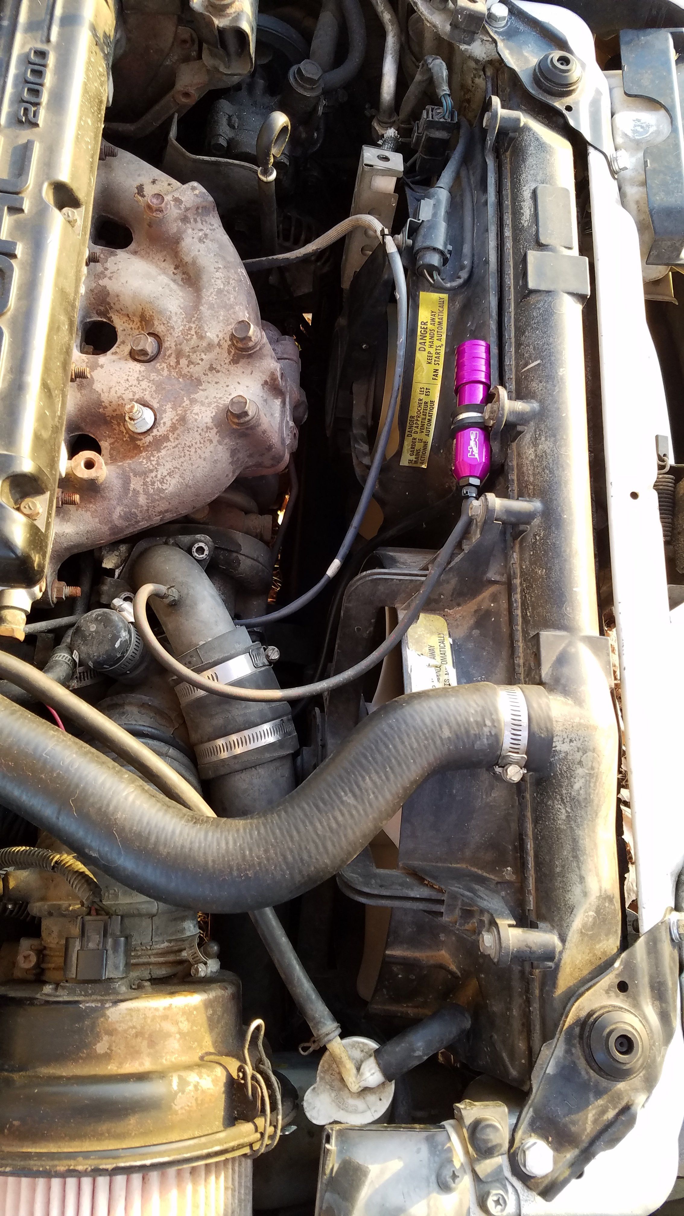

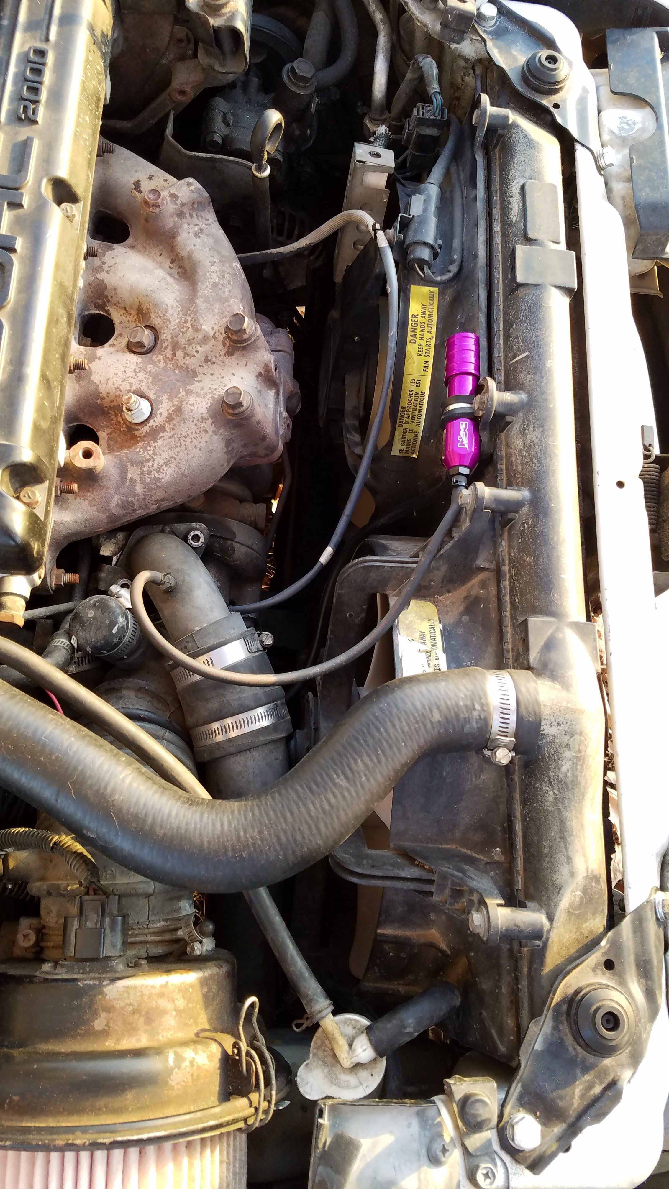

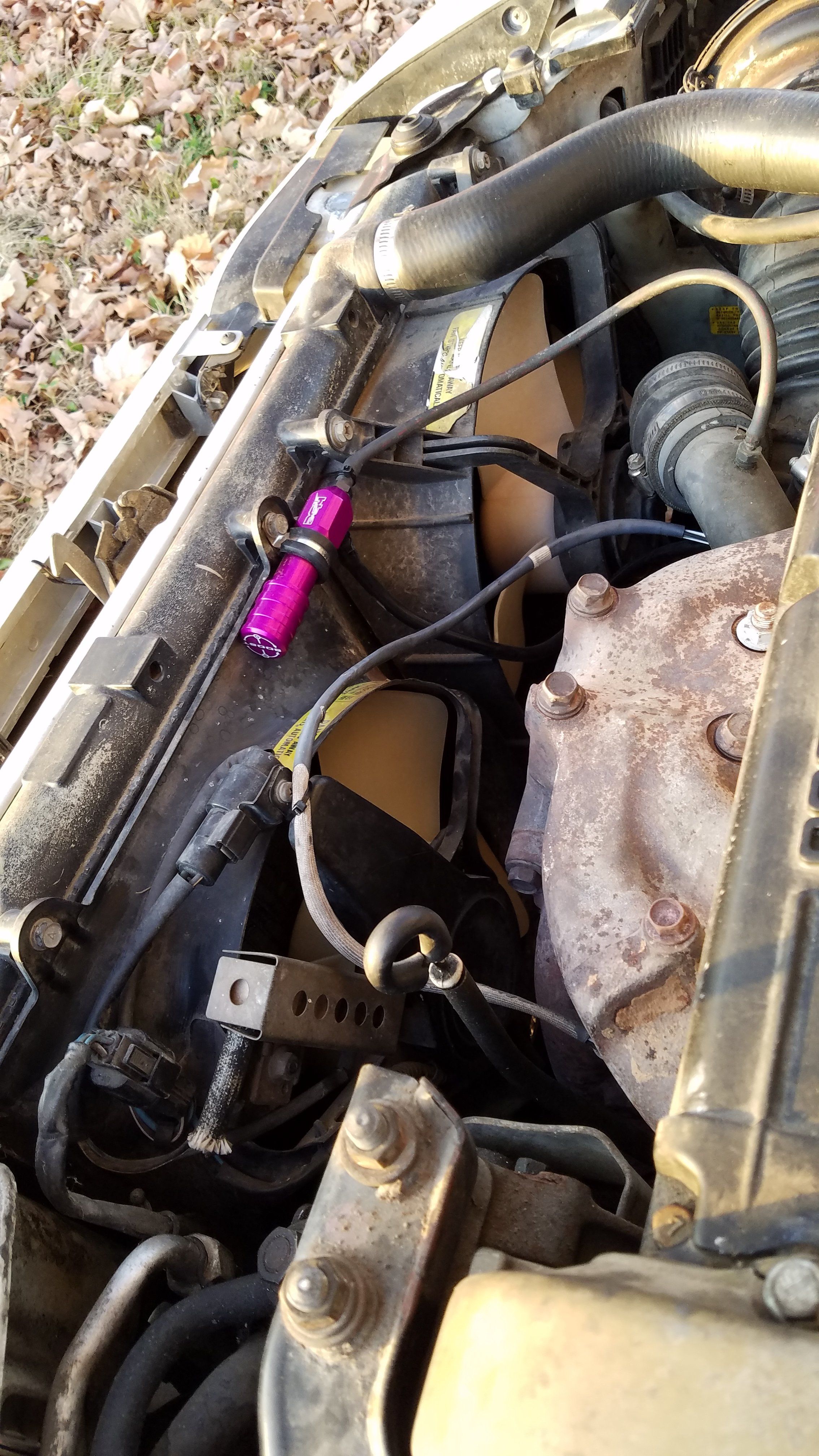

I came home from work today and my son, Trevor, had removed the old radiator (wasn't the original, nor original fans, some ebay fans with a shroud) that was leaking on the bottom and or side. I grabbed my 92 Talon radiator and started to put it in since I am running an aluminum radiator in it and the original was sitting against the wall. We start to move stuff over and we see a blueish cast on some of the fins. I am pretty sure that was showing signs of a leak too. I told him, "hang on, let me check the parts GSX" and came back with an original 100k radiator with STOCK FANS AND CONNECTORS. Thank the DSM gods for that and the fact that the owner hadn't hacked the plugs off of the cars harness.
I blew it all out with compressed air and installed it AND THE STOCK FANS and plugged them in and VIOLA, we are back in business!

Couple pics of the STOCK SETUP!!!

Ok so we had an Aeromotive 340 for the GSX but it ended up being locked up so I threw a random Wally 255 I had into her and I think she is now running OUT OF GAS.....DAM.
No wideband yet but one came with the car, an AEM unit so I need to get it wired in so I can log and see what the hell is going on. She feels like she is starved for fuel at 5k, just stumblin now at that point. Idk what exactly is goin on but my next project is wiring in that WB so we can make sure its just runnin outta fuel.
I still thank my son for all the help, we're gonna get this into a fine DD with a bit of "ump" :thumb: but I'm feeling like she is just plain ass runnin outta gas at the moment and the tank is at 3/4. Bummer for a day or so.
